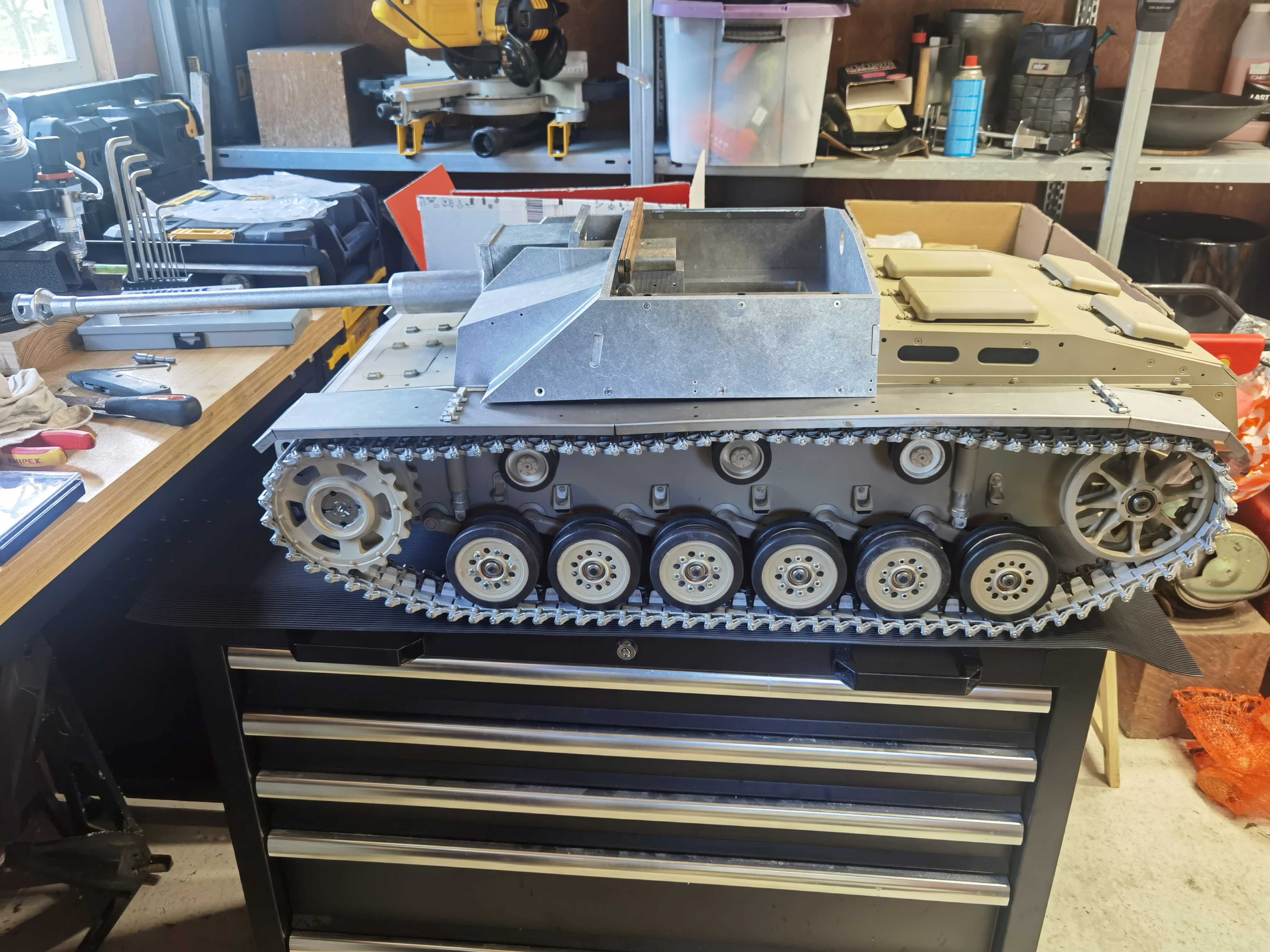

just a few more pictures of the progress i made since the start of the build.

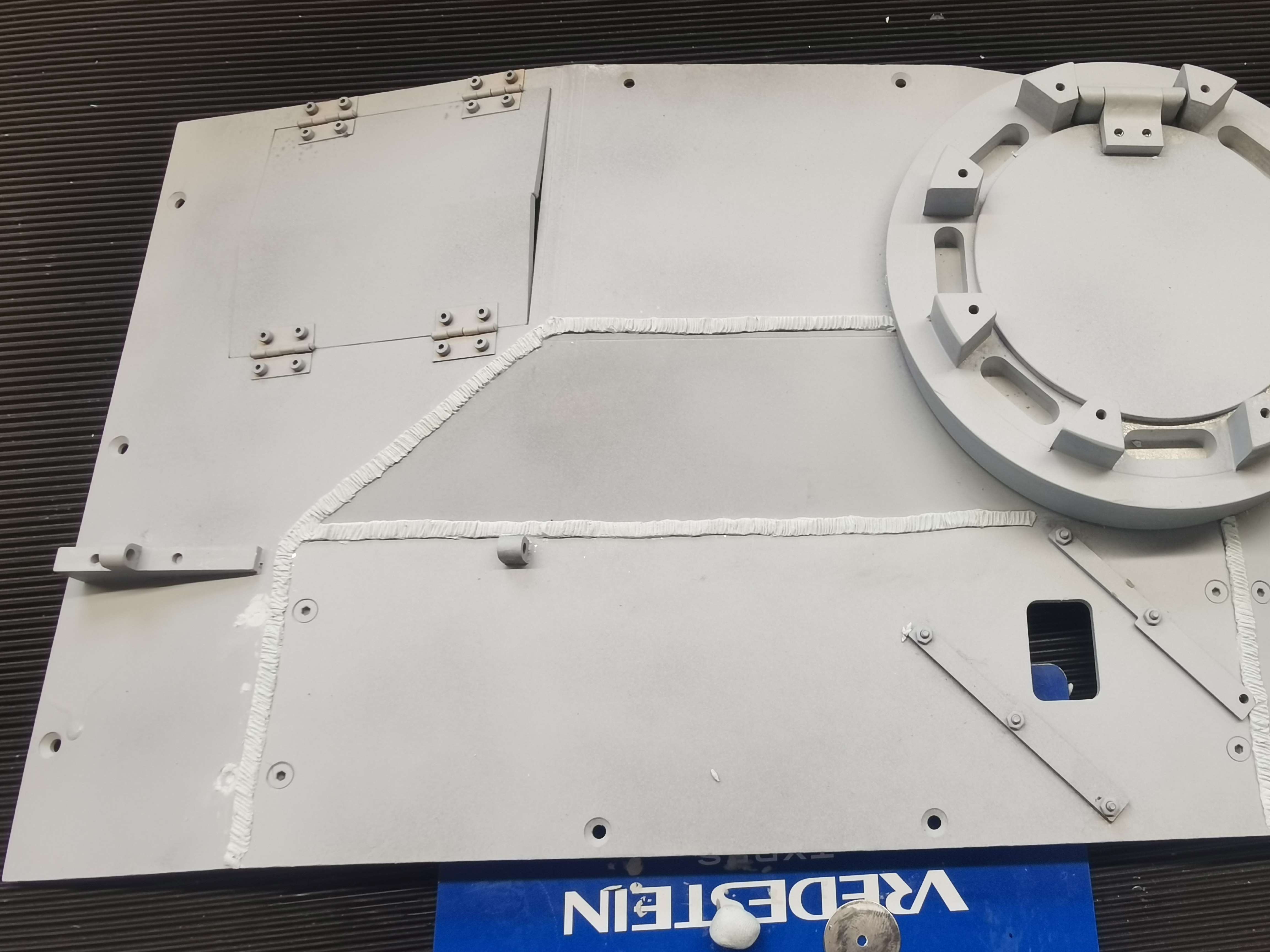

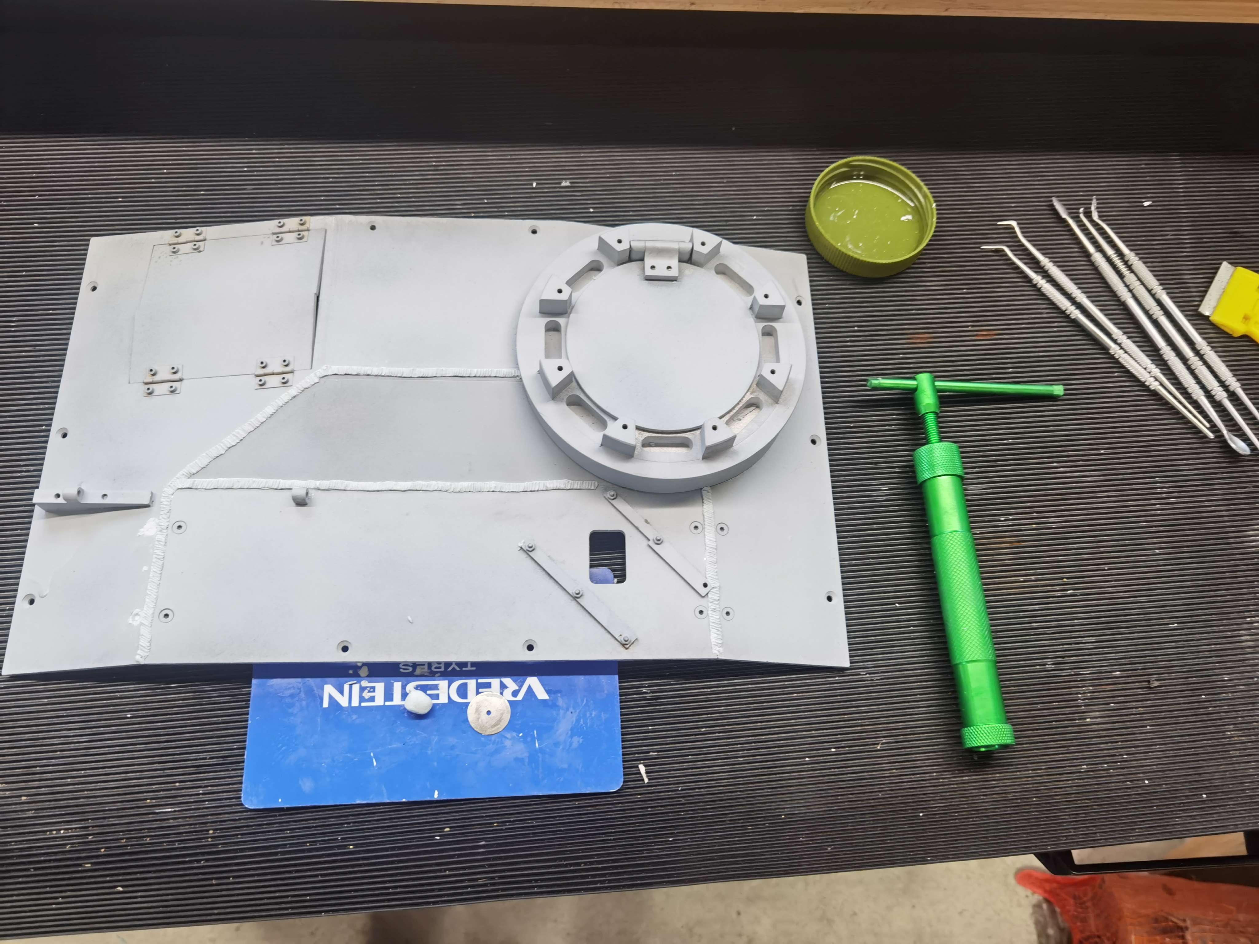

after a long time of having a cold shed and some health issues ... finally i had some time to do some work on the Stug
I saw a few guys here get a nice piece of equiptment to make uniform strips of milliput (thnx gents) wich inspired me to order one aswell and it's amazingly handy
first time fake welding ... let me know how i did please :)
Stug III no 54 "Helga"
bryan massie
Posts: 17
Joined: Sat Oct 13, 2007 11:10 am
Been liked: 4 times
Re: Another Stug joins the chat
Post by bryan massie »
Hi Sjouke
I'm not an expert by any means but you may want to flatten the edges more, it looks like the welding is almost floating if you see what I mean, what did you use ?, a good friend of mine told me to use the top of an empty pen, it gives you the curl shape and really press down on the milliput to fix it to the metal
cheers Bry
Sjouke Kooistra
Posts: 32
Joined: Tue Sep 03, 2024 4:54 pm
Location: frysân NL
Has liked: 210 times
Been liked: 36 times
Post by Sjouke Kooistra »
Thanks for the comment :) I'll try your tip next time (there is enough welding still to go :P)
I used the picks on the second photo on the top right.
I saw the straighter welds on the stug at the bastogne barracks wich is why these are pretty straight. :)
