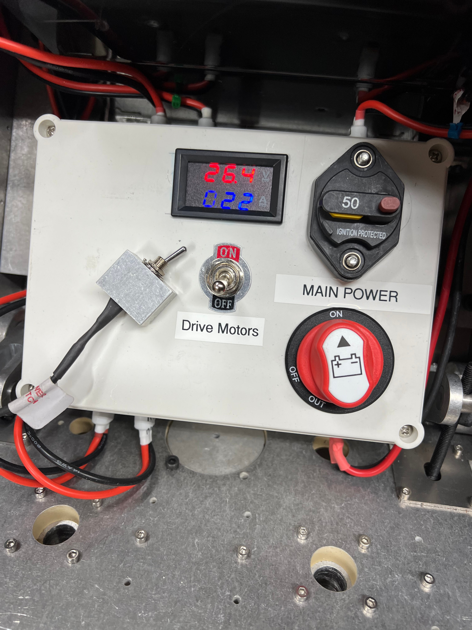

I wanted to get some feedback on an issue I have been experiencing with the new motion packs. I am building a jagtiger for a friend and I am using Dakota 25Ah lithium batteries. Dakota is known for making really good batteries in the US. I am also using a battery power switch between the 2 batteries to disconnect the circuit and to be able to charge each battery individually. And I also use a Power Meter to monitor voltage/current/power. you can see the connection on one of the images for the meter link. I use this setup on multiple tanks without issue. With the new motion pack, I first connect the connection with the meter without connecting the armortek power module. So, the only thing that should come on is the the power meter, which it does. I then proceed to connect the power module without anything connected to it. Again, I get power to the power module voltage LED and my power meter. I then connect the 2 motor ESCs and to the power module and receiver. I also get power. Please NOTE that I power down prior to each step. After the initial power ON of the ESCs, the batteries get bricked. when I try to repower ON, nothing comes on. The battery voltage drops from fully charged 13.3V to 12.8 or 12.9V without load. I can no longer charge the batteries and I have tried every trick in the book. whenever there is a load on the batteries, the voltage drops to zero. This has happened on 2 different set of batteries and Dakota is sending me a third set. I have verified my setup is corrected by powering the circuit with an external DC power supply, and with 2 lead acid batteries without issue. My guess is that after the initial power ON of the ESCs, the large caps on the terminals discharge to the batteries and must brick the BMS. Has anyone had this issue or any insight onto what may be happening would be greatly appreciated.
also, when I powered down, I powered OFF the armortek power module first and then the power switch. for powering ON, the power switch first, then the armoetek power module.
this is the link to the battery.
https://dakotalithium.com/product/dakot ... 4-battery/
the link to battery power switch
https://www.amazon.com/gp/product/B07T2 ... =UTF8&th=1
Power Meter
https://www.amazon.com/gp/product/B07T8 ... UTF8&psc=1
Power Meter

Thanks for the comment. The manufacturer says you can put up to 4 of these in series. They do have a BMS and the previous batteries of the same MFG in my other tanks work great.
Wael
Wael

I'm very curious to know where the failure in his system implementation turns up. I've used one of those 'power' meters but only temporarily
directly inline with the battery(ies) for initial testing to determine current draw. In the control unit I made for my King Tiger I have a volt/ammeter
that provides useful information when static testing:
meter
But I'm using the previous generation of 'red' units...

My first response (which I deleted not long after posting) was skepticism as I find it difficult to believe BMS units have much or any smarts in them but who knows I'm not an EE myself and I've never written any firmware modules although I did spend quite a few years as an application dev...
My first thought was to eliminate the BMS and wire in an appropriate jst plug so a smart charger can maintain the cells.
Looking out on the web there's all manner of hits on dead batteries/BMS issues and a few even refer to them as 'bricked'.
It seems to me though most of the 'fixes' are essentially snake oil as I didn't find one, in a quick search, that actually did any diagnostics
on the BMS itself. It's worse when a battery under no load conditions shows a full charge yet under a load collapses like a cheap suit.
So either eliminate the BMS and use a external smart charger or use your EE superpowers to diagnose the BMS.
Even when it comes to batteries, the KISS principle still reigns supreme...better to offload the management of a battery to something external that
is easier to see and work with. BMS units buried in a battery just isn't the best when we have other options.
Just MHO...
Just MHO...
