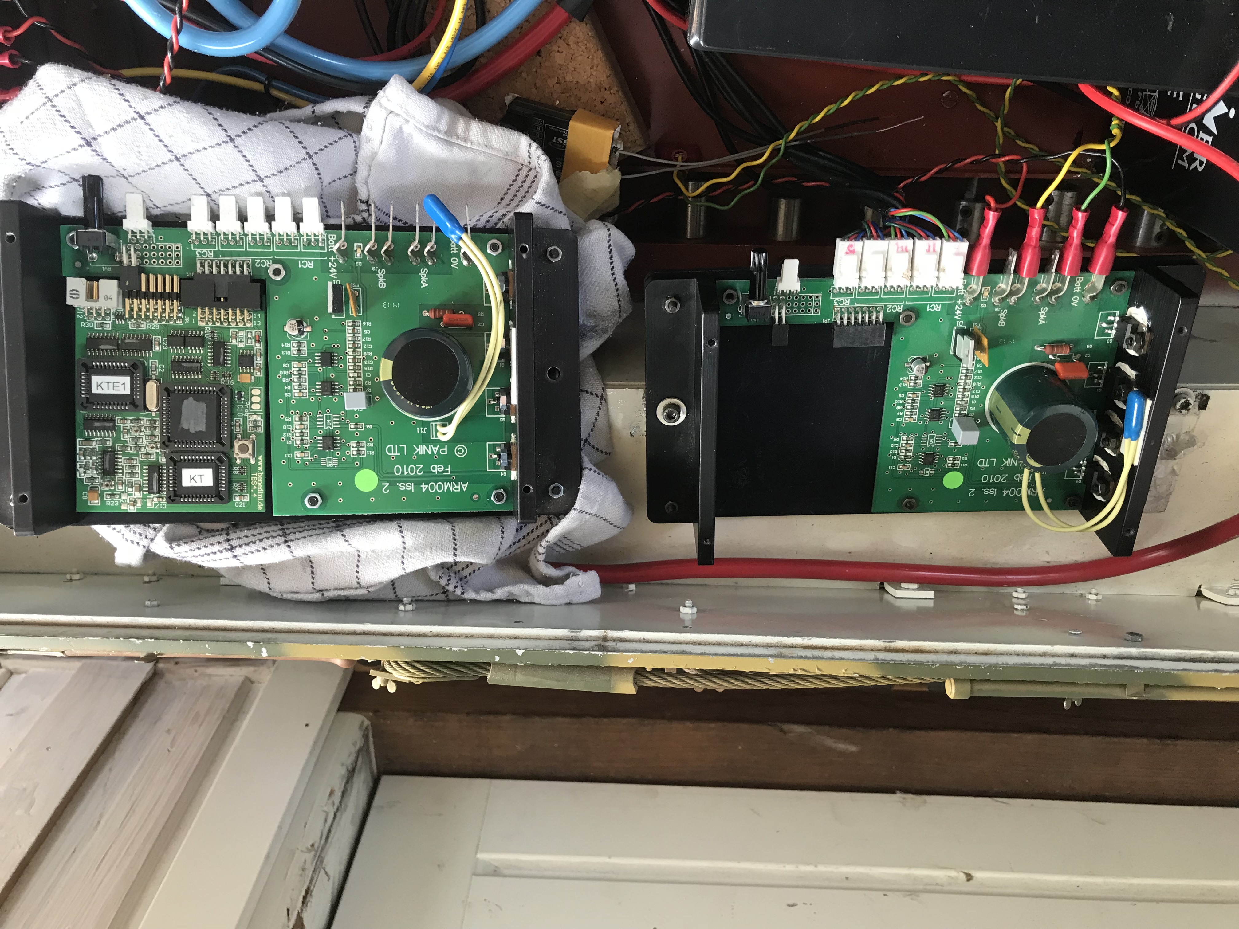

Left amp module is mine and yours to the right.
Regards Allan
Yes I can hear hiss from the speakers.To Adrian Harris

If I click on the picture they reverse position so not sure which is yours and which is his.
One is definitely only the amplifier section and is missing the sound board.

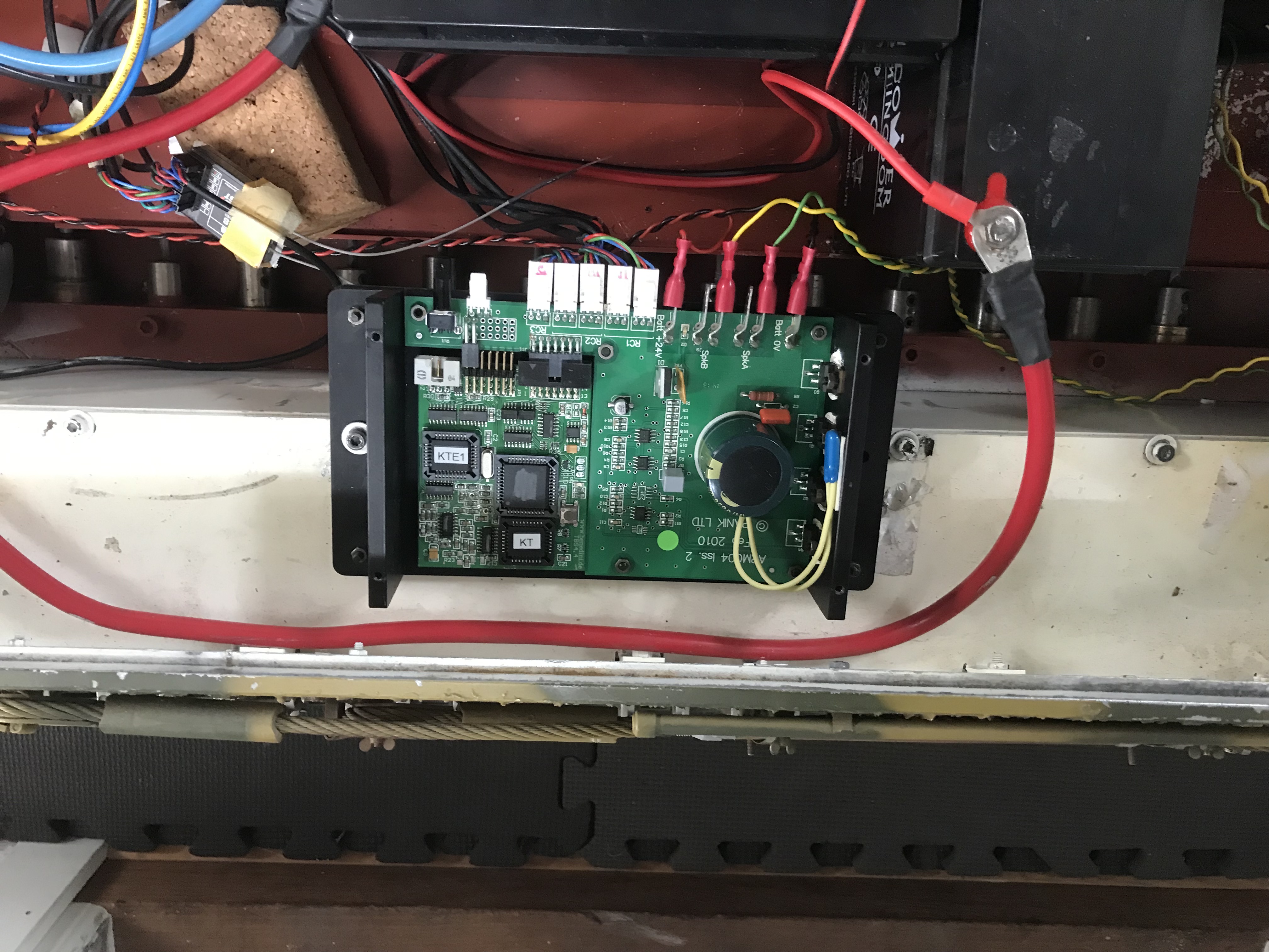

No luck, after have move the benedini card. No clicks whwn power is on.
Do you have some good ideal.?
Here picture after I have move the card: Regards Allan

YES YES - IT WORKS NOW......
Took the card out and discovered that I had set some pins to low.
Thanks Adrian for the card and tips.
Regards Allan
Regards Allan
