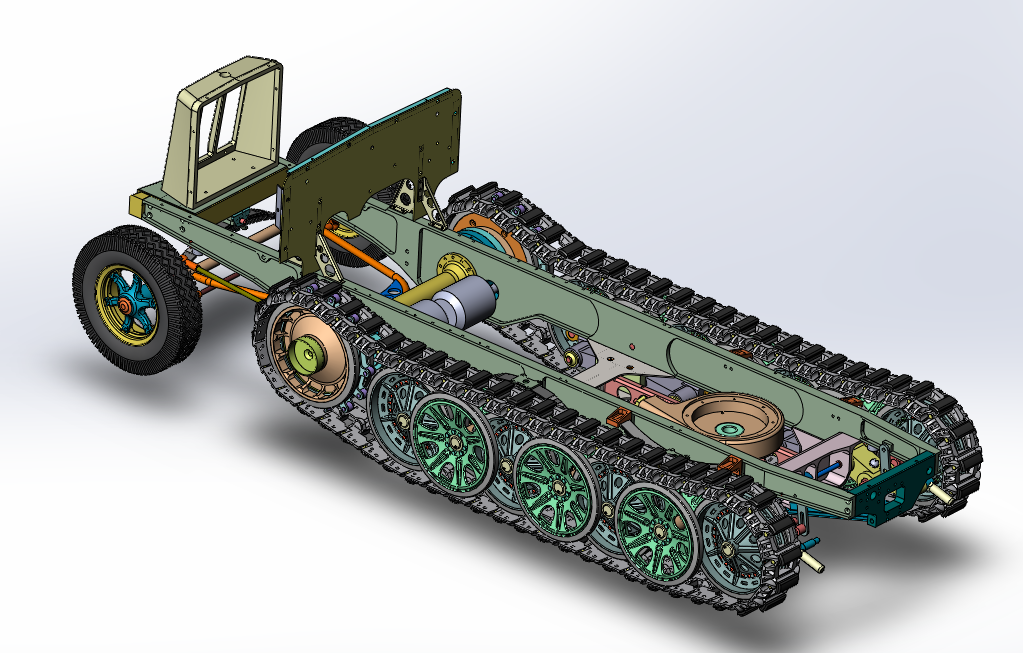

As off today, the CHASSIS is pretty much complete with the redesign - the only outstanding part is the tow bar assembly that will undergo some further work.
The key changes here:
- The front end has been reworked to more accurately represent the bolt pattern and sheet metalwork on the real vehicle
- The front wheel centre and hubs have been slightly modified for realism
- The roadwheels have been heavily modified (see next post) along with the axels
- The idler has also been modified as has the idler shaft to allow more travel
- Roadwheel hub caps all have more detail with simulated grease points.
- The sprocket crossmember will mow be made of steel to move some weight forwards
- TEMPORARY CHANGE TO BE CONFIRMED - Brushless motors have been test fitted. As there is no room for a large gear reduction there are 2 concerns ... (1) will there be enough torque and (2) the model will have a very high top speed. Theory suggests that we should be ok with point 1, and with point 2 ... people could just drive slower and not at top speed
. Backup plan is brushed motors, but not my preferred solution.
- TEMPORARY CHANGE TO BE CONFIRMED - Through holes have been added to all the leaf springs to allow them to be fixed (as per the real vehicle). We need to confirm how well this solution works in practice and what this means to the manufacture of the springs.

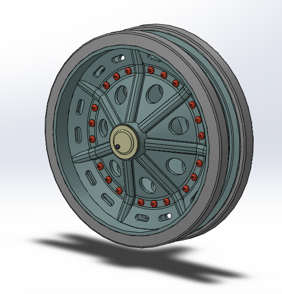

ROADWHEEL A
Roadwheel A was previously a cast aluminium part - we will now make it out of pressed 2mm steel.
In addition, the key changes are:
- The bolt pattern on the face of the wheel, where it attaches to the hub, has changed to reflect the pattern on the original vehicle
- The pattern of the embossed parts has also changed as they are not symmetrical in real life
- Dual bearings have been added into the hubs to support the axel
