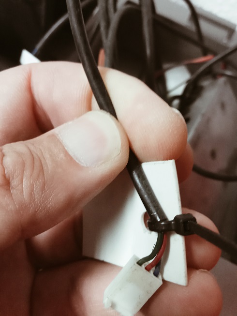

Hi
I am redoing the electronics of my Centurion and I need your support. Can someone help me identify the reference of these cables and plugs or better yet, where to buy them?
Thanks very much

Re: Help identify cable
I'm pretty sure they are Molex KK series connectors, with a 0.1" (2.54mm) spacing.
Post by Helderluiss »
Thanks for the help Adrian.
Any ideas on the electrical wire? It has three 1mm wires, if I´m not mistaken, but I can't find it anywhere.
PRO ELEC - PELB0674 - 16-2-3A
Thank you very much, I was stuck with this situation and managed to actually resolve it.
