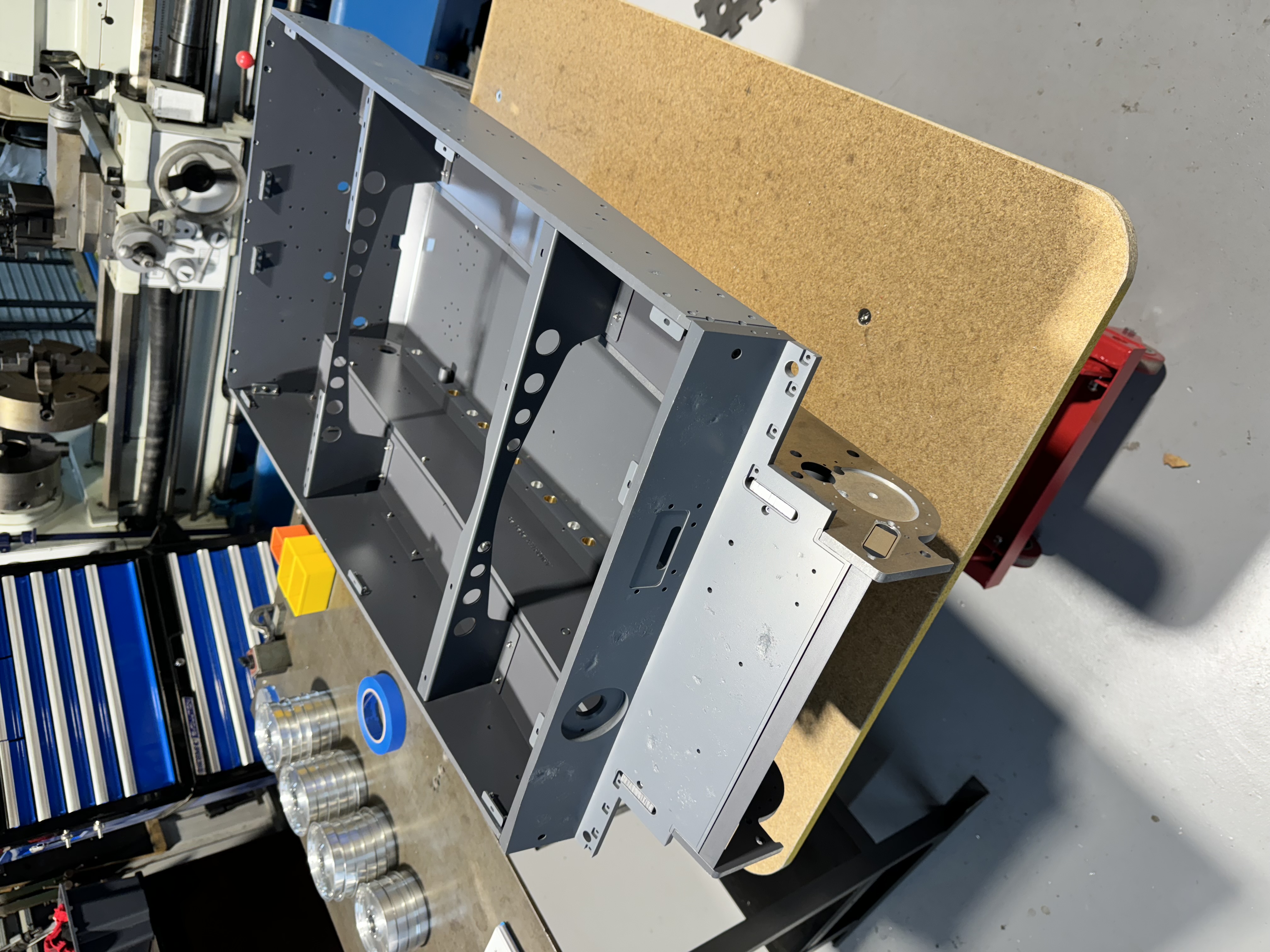

G’day all,
I thought I’d build my Tiger #25 in the form of an old Tamiya kit I built as a youngster in German grey.
I’m no history buff and don’t know if the Tiger depicted on the box art was even a real thing, maybe someone here can enlighten me.
Anyway, here are a few pictures of my progress to date.

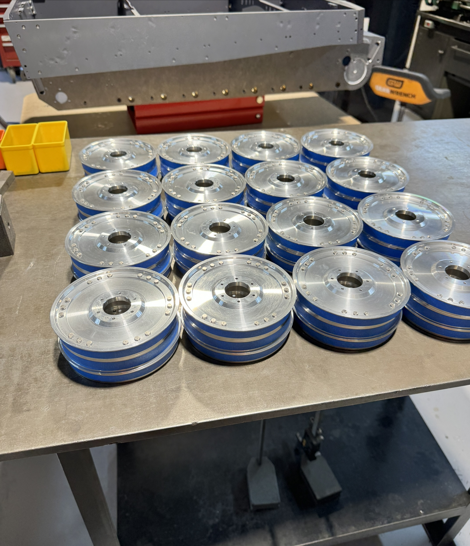

Had fun with wheels today 😃
Dave Goodwin
Posts: 126
Joined: Sat Oct 21, 2023 3:01 pm
Location: Vermont, USA
Has liked: 29 times
Been liked: 123 times
Re: Tiger #25 2023
Post by Dave Goodwin »
Looking good! It was a highlight of my day when I stored away the last wheel stack, painted and with tires mounted. They sit in a storage bin, awaiting mounting once the hull gets finished.

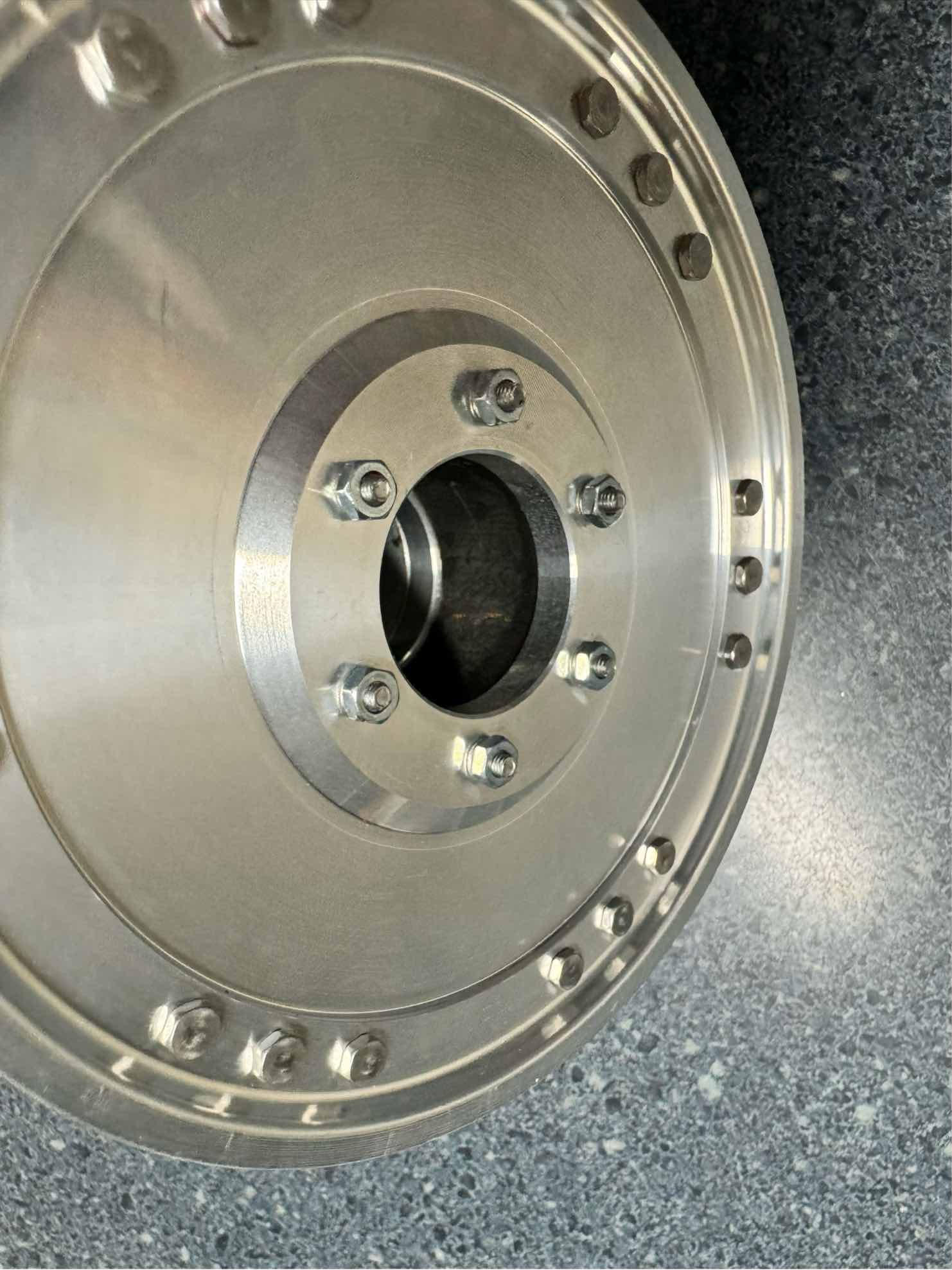

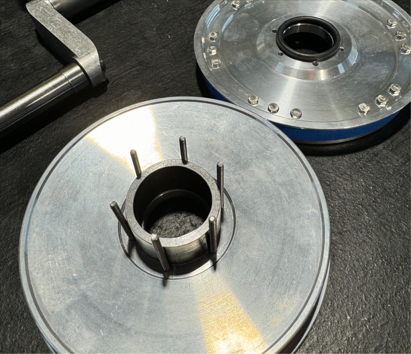

Progress for today, suspension arms done.
I made some spacers to go between the double wheels to help keep everything running true and keep any crap from getting in the large cavity between the inner double wheels.
An “O” ring works great to seal the gap between the outer double wheeels.
Spacer and “O”ring to seal cavity between wheels.
18.2mm wide spacer.
18.2mm wide spacer.

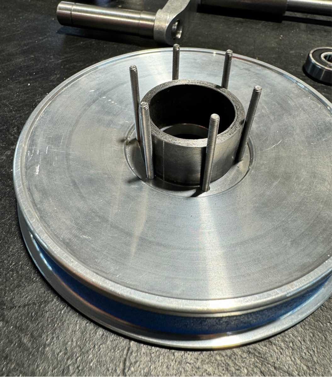

Hi Andrew looks great , do you have a photo of the two wheels together interesting to see how it works . Dale

Hey Dale, the inner double wheels are supported with long M2.5 studs and have an 18mm gap in between them that can get filled up with crap.
The spacer simply clamps between the two wheels and fills the gap.
Section view of the wheel showing gap between the two wheels.
Wheel assembly with spacer installed.
Wheel assembly without the spacer.

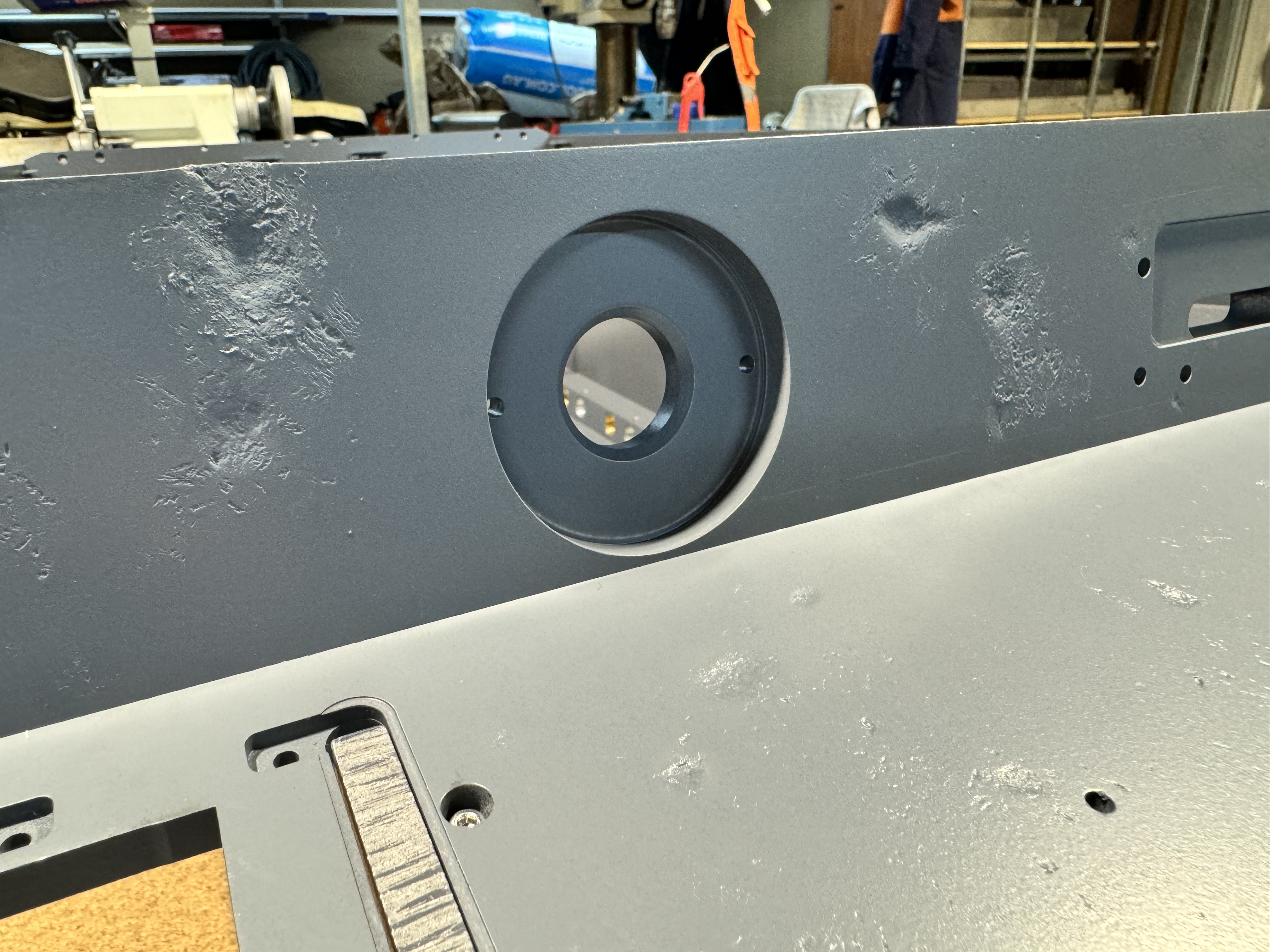

How did you stress/damage the front armour plates?
It looks fantastic!
(I originally posted this in Paul's thread, I didnt realise it was yours, my bad)
Andrew Gaze
Posts: 40
Joined: Tue Aug 22, 2023 2:32 am
Location: Hobart
Has liked: 17 times
Been liked: 83 times
Re: Tiger #25 2023
Post by Andrew Gaze »
neil graham wrote:
Fri May 31, 2024 1:50 pm
It looks fantastic!
Hi Neil and thank you for the positive comments.
It’s simply done with some gravel off the driveway and a 10 ton press 😄

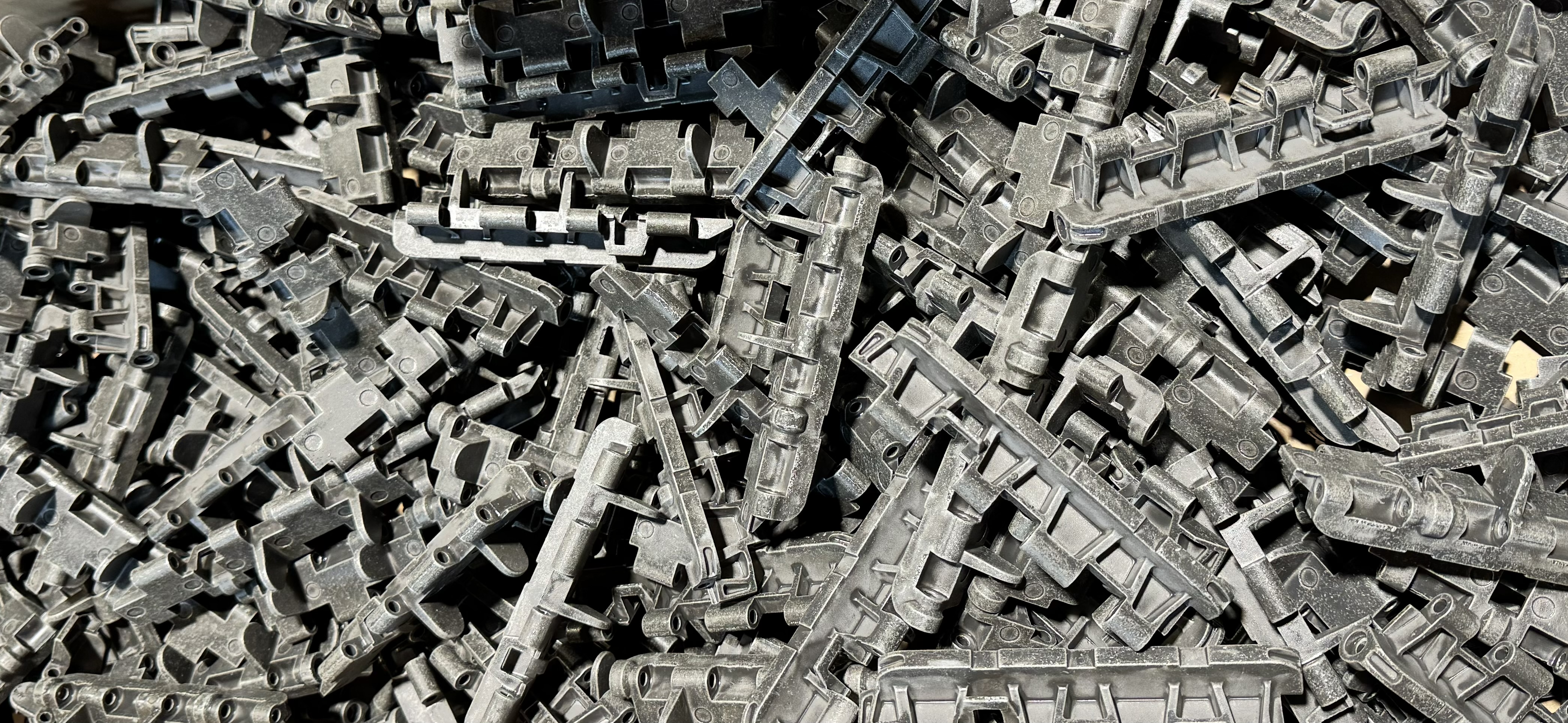

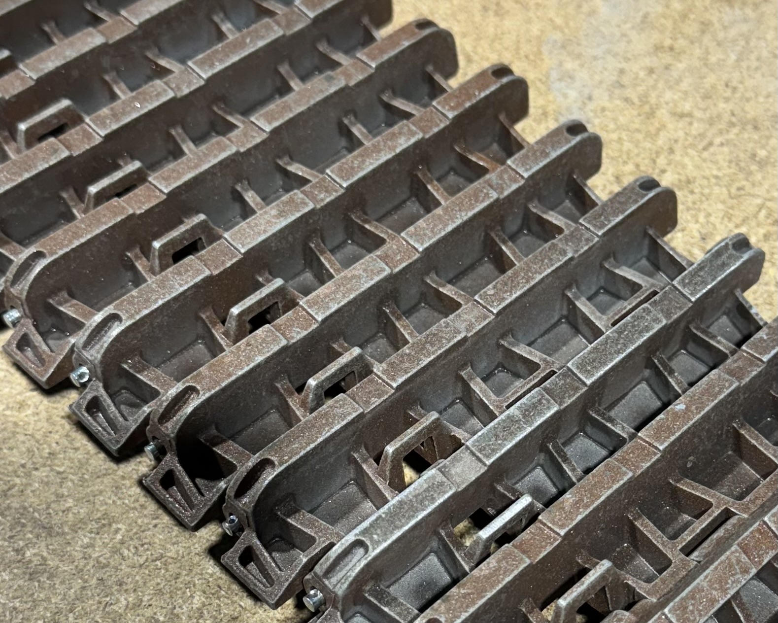

I’ve been busy painting track links.
Happy with the end result
This would make a good jigsaw puzzle
