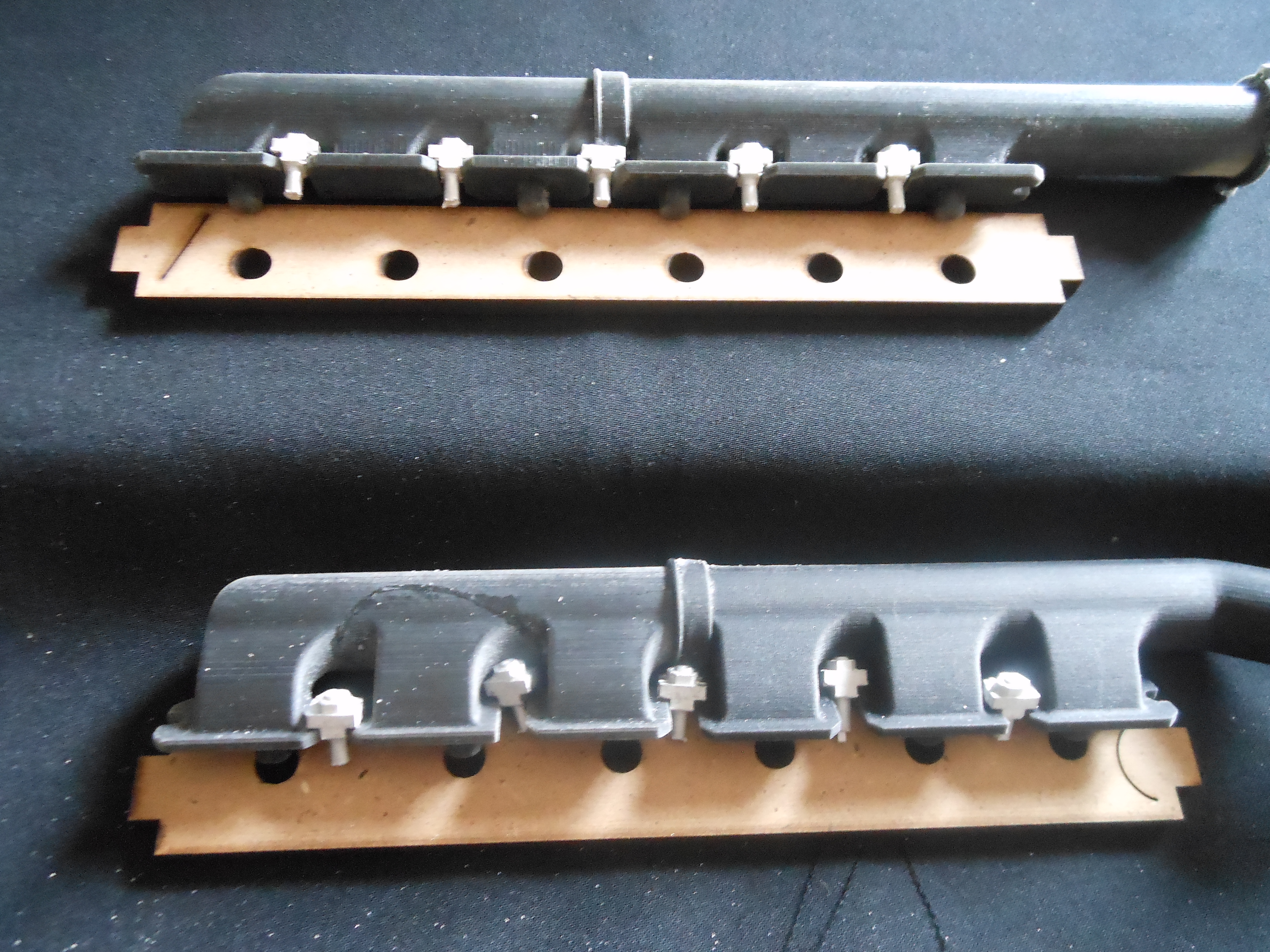

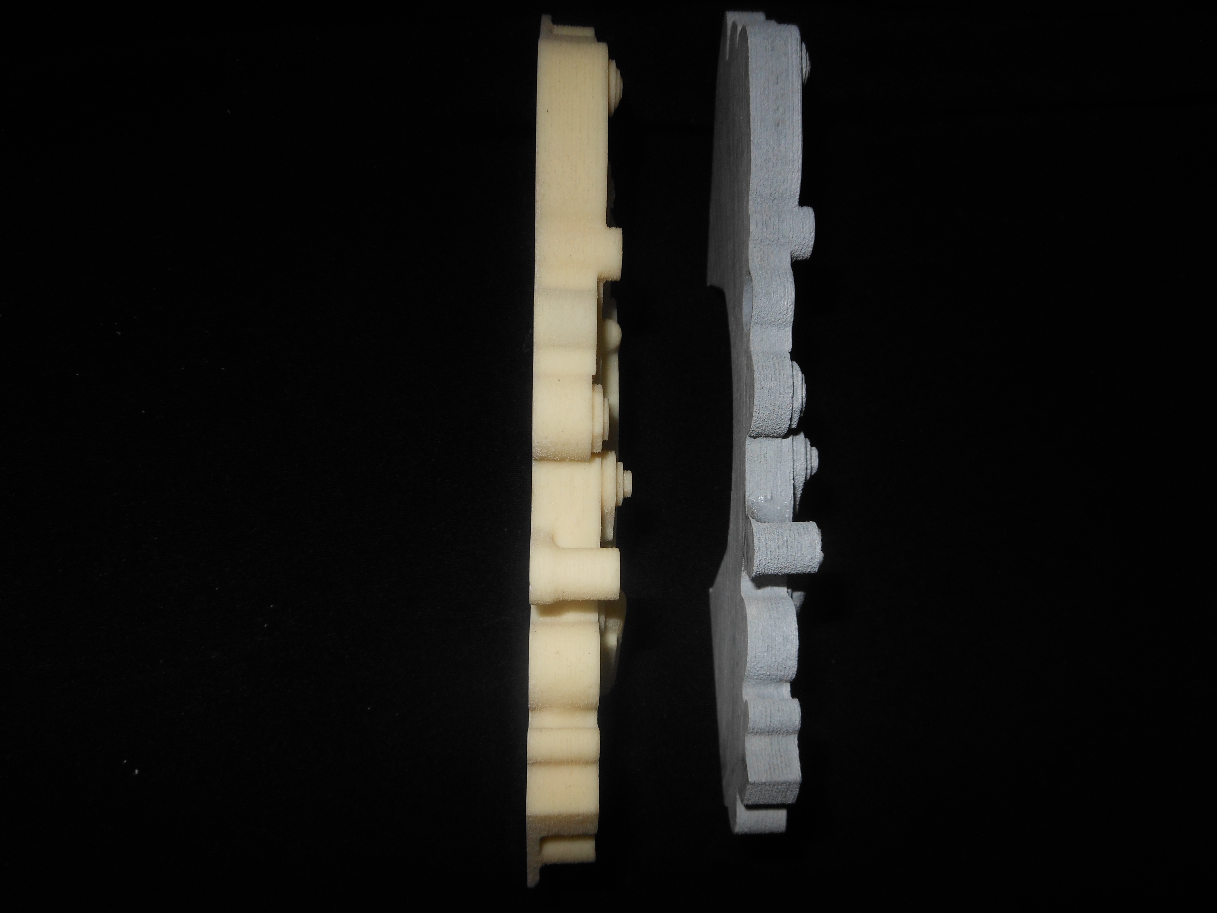

The engines began to arrive at their destination. I hope you are happy with what you have bought. And a handmade product so there is no perfection but nothing that can not be solved with a little 'stunned or sandpaper.

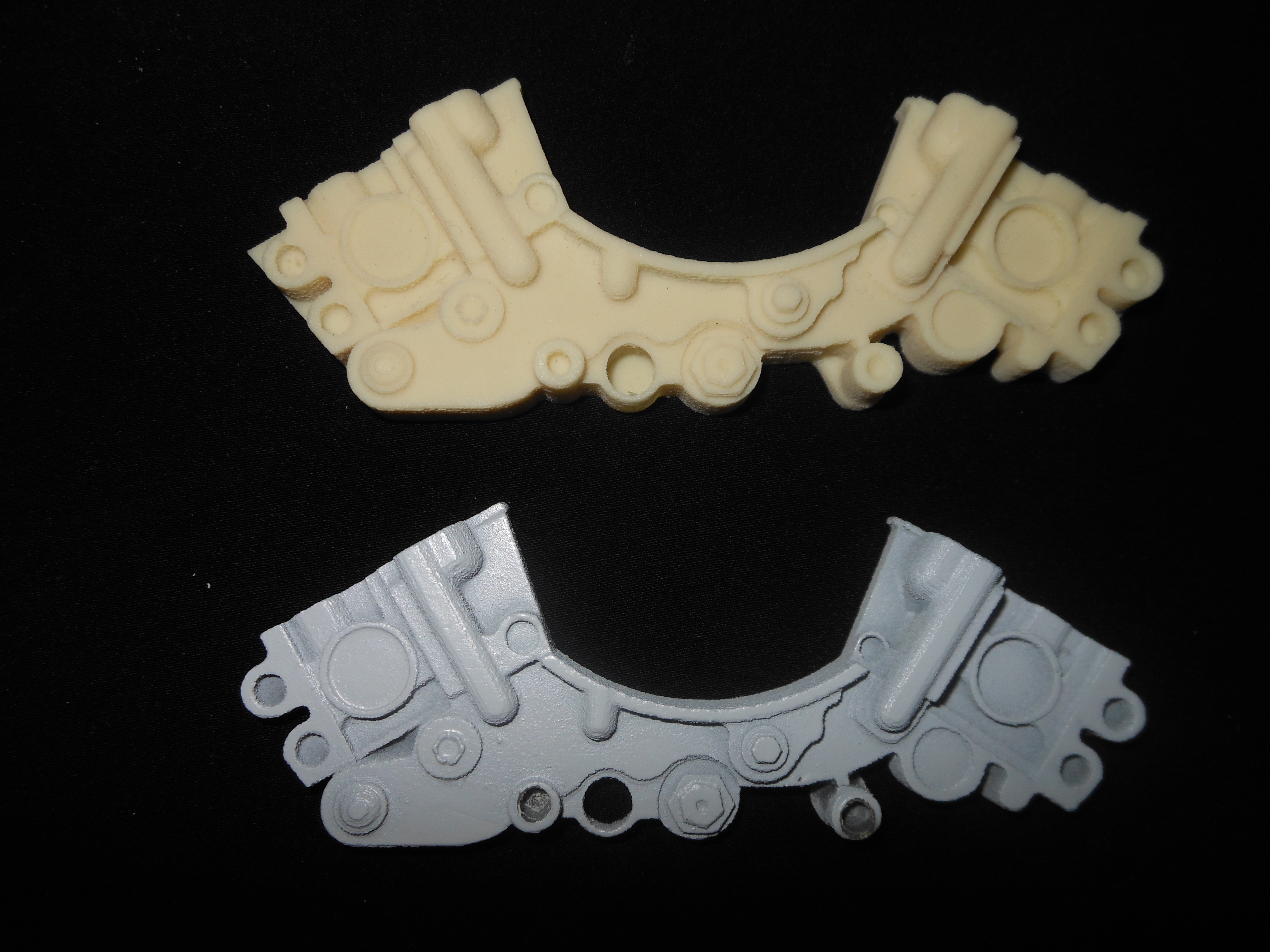

The motor can be further detailed and improved. I stopped at this point to keep costs down. For a model-assembly is simple, the important thing is not to hurry and to be patient. Before starting the construction look at all the photos you can find on the Internet or on specialized books. It will help you understand how to be mounted. The instructions are there and I hope they are clear. Before gluing always check 10,100,1000 times. Always watch what you pasted does not impede the positioning of other pieces. For the skeleton in MDS, I recommend using plenty of wood glue. Before gluing recommend you do the holes for the 10 white metal latches of the exhaust pipe, it will be easier. The drain hose is bent dul side SX. Remember that the resin is deformed at 50 degrees centigrade so careful to use tools which produce too much heat.

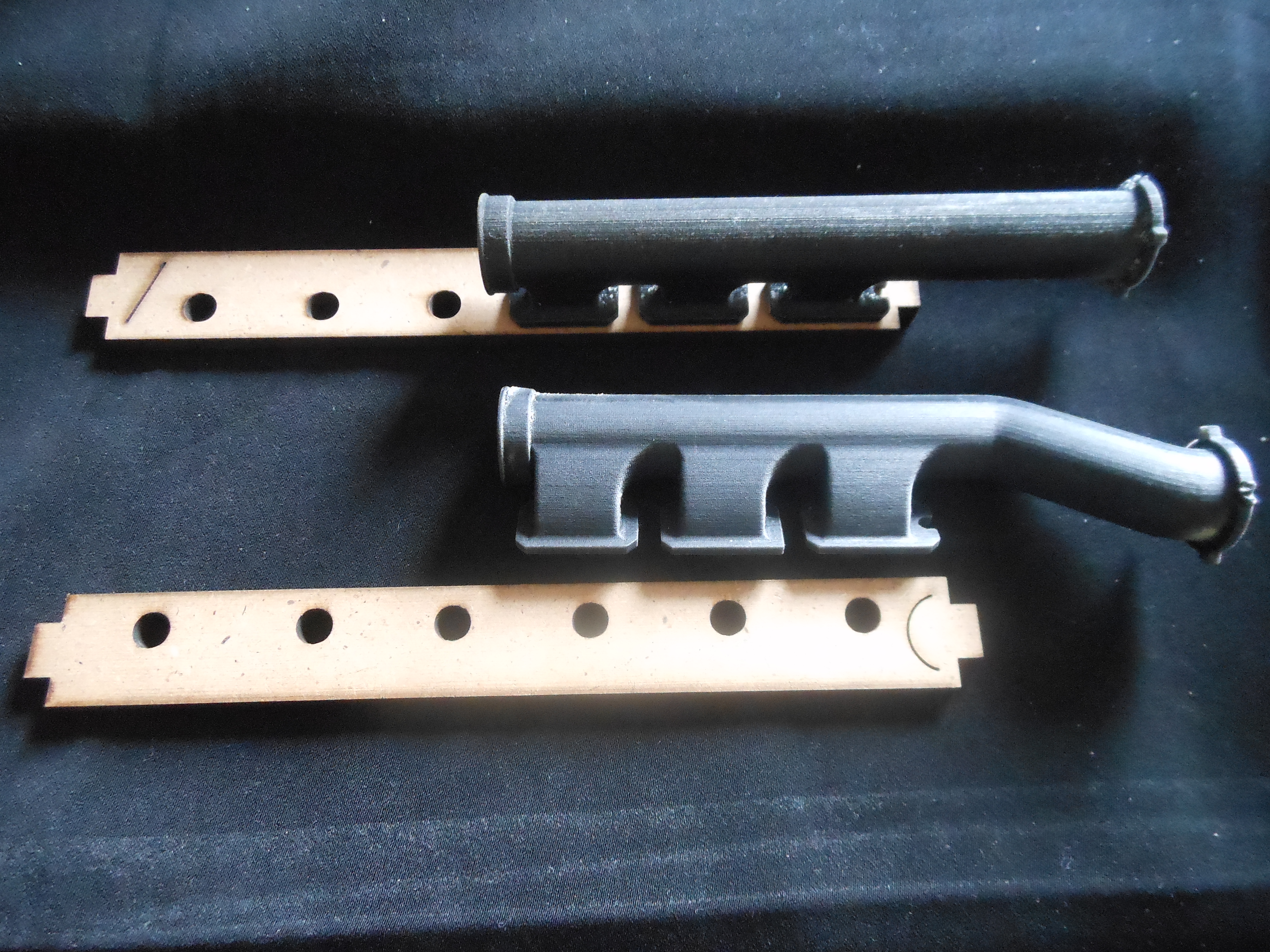

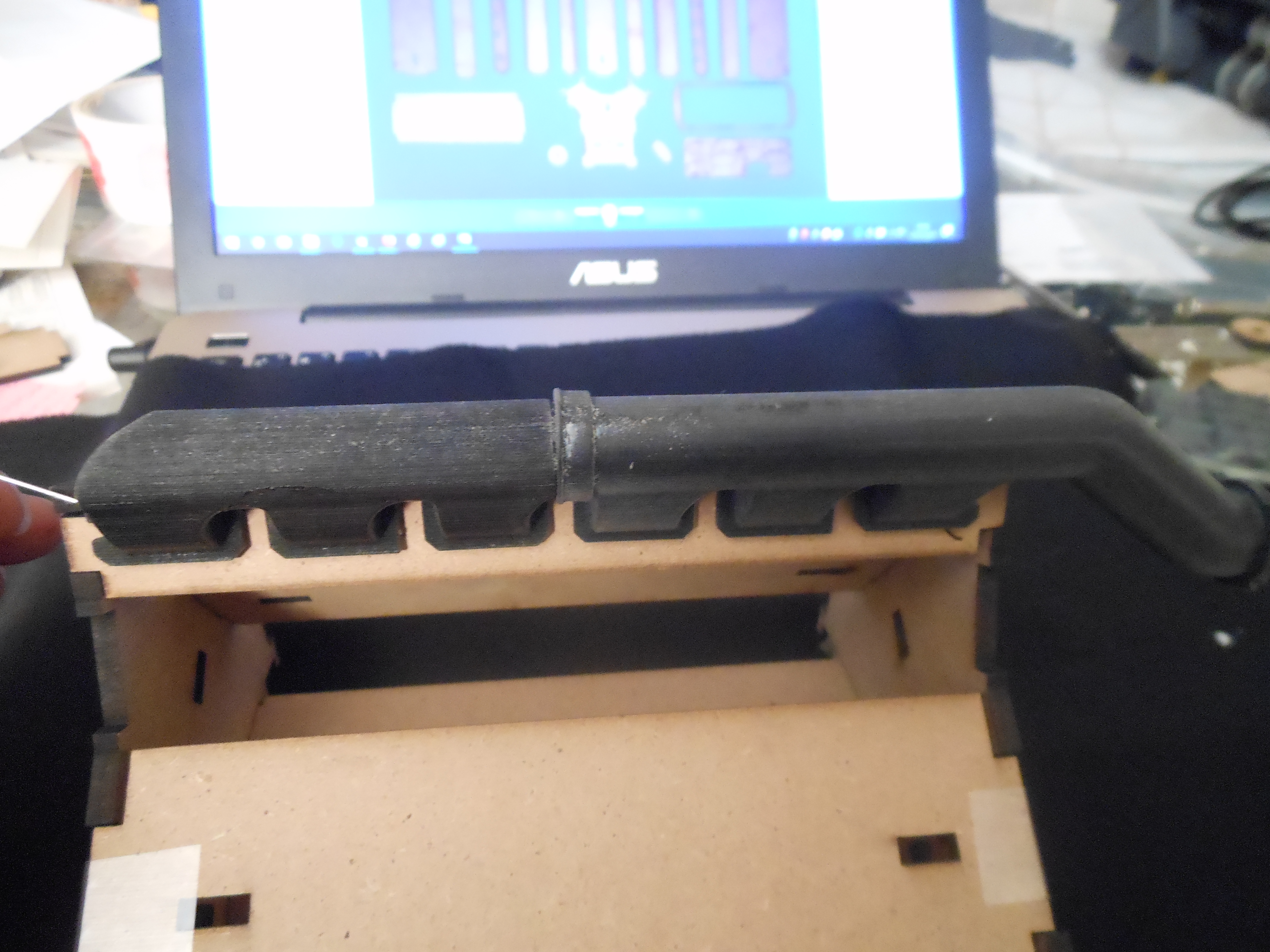

The black parts are not clones but 3D printing, the material is different .The exhaust covers are very thin so fragile, beware. If you need help please contact me and ... HAVE FUN.

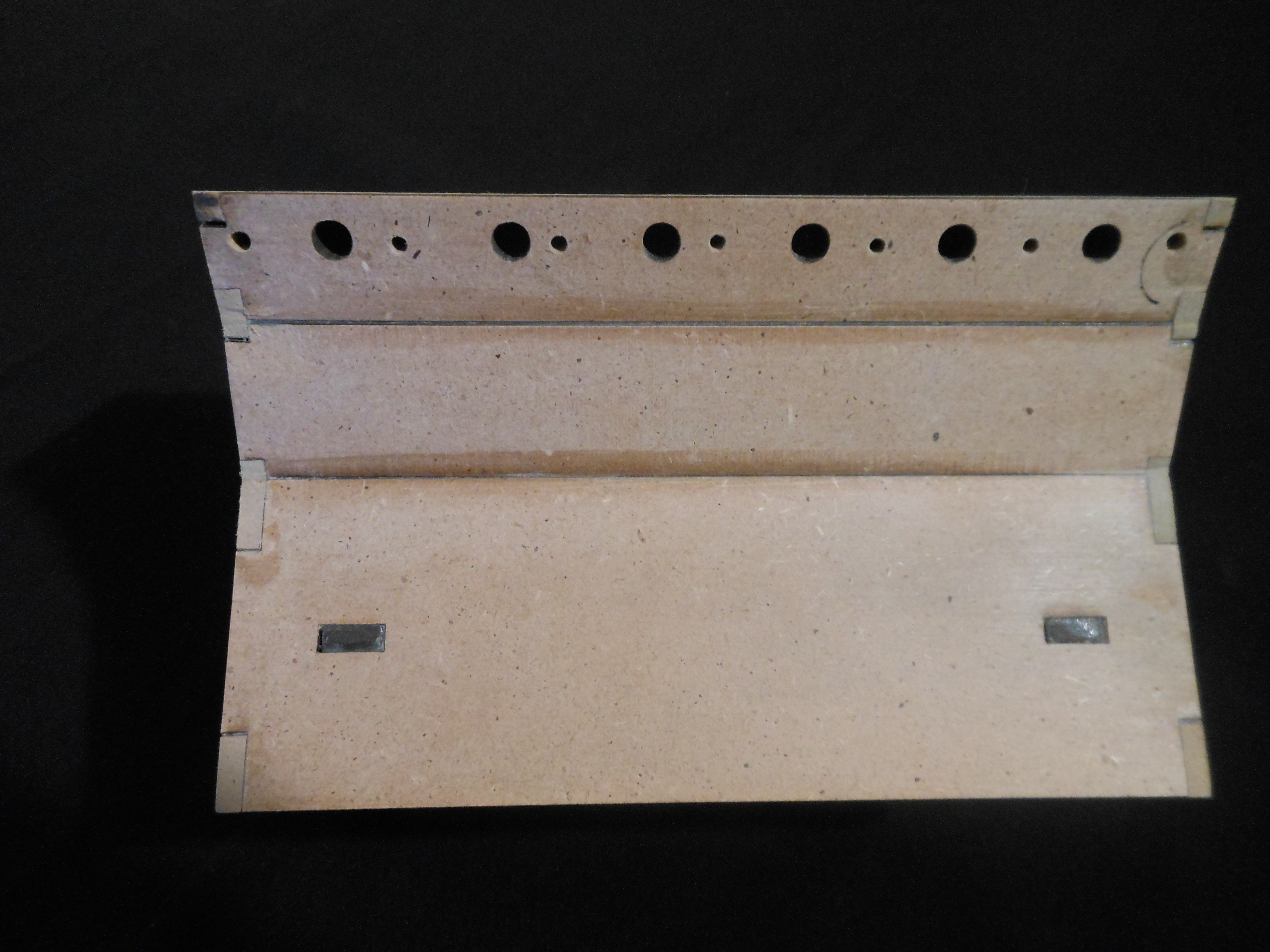

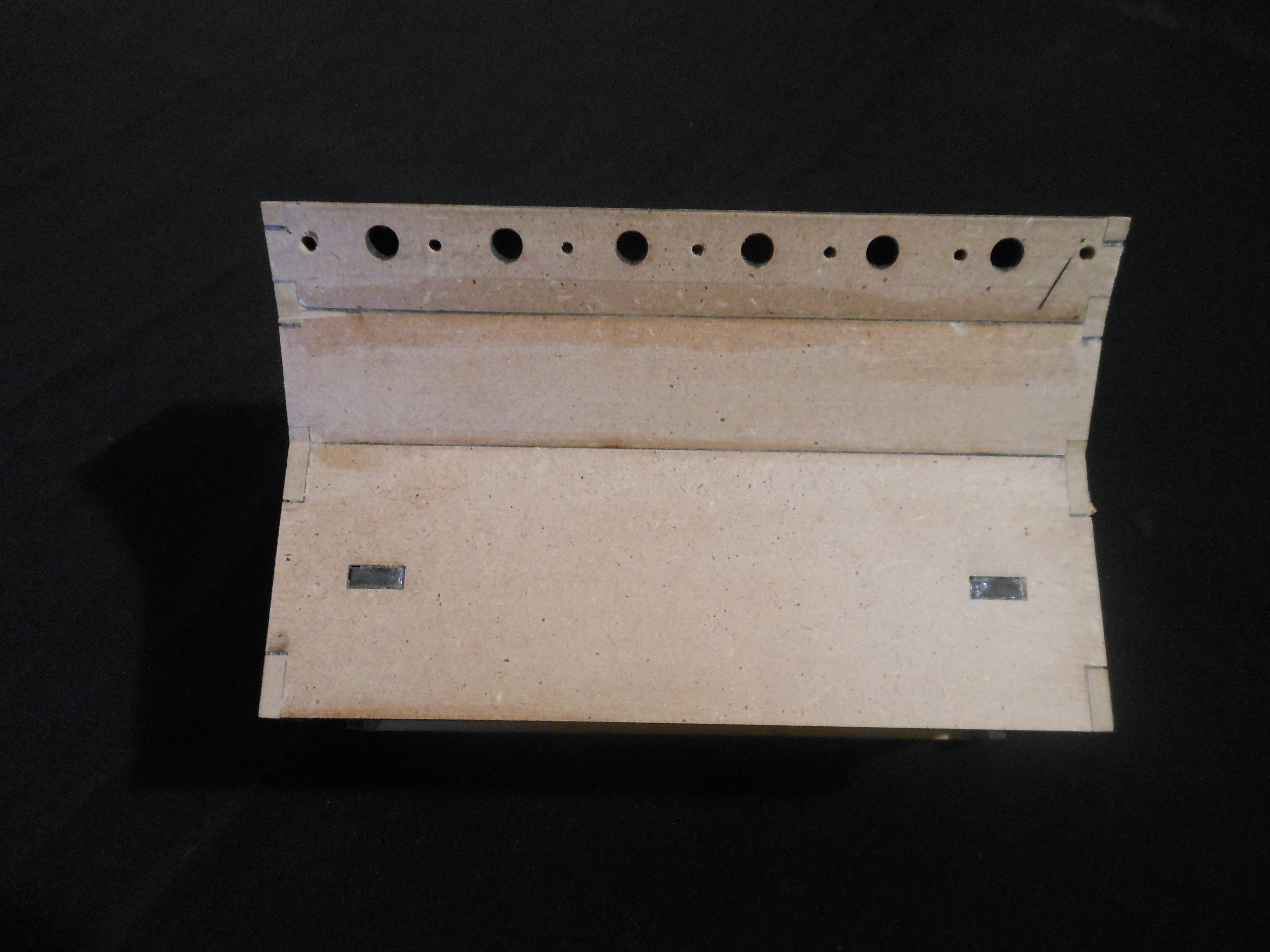

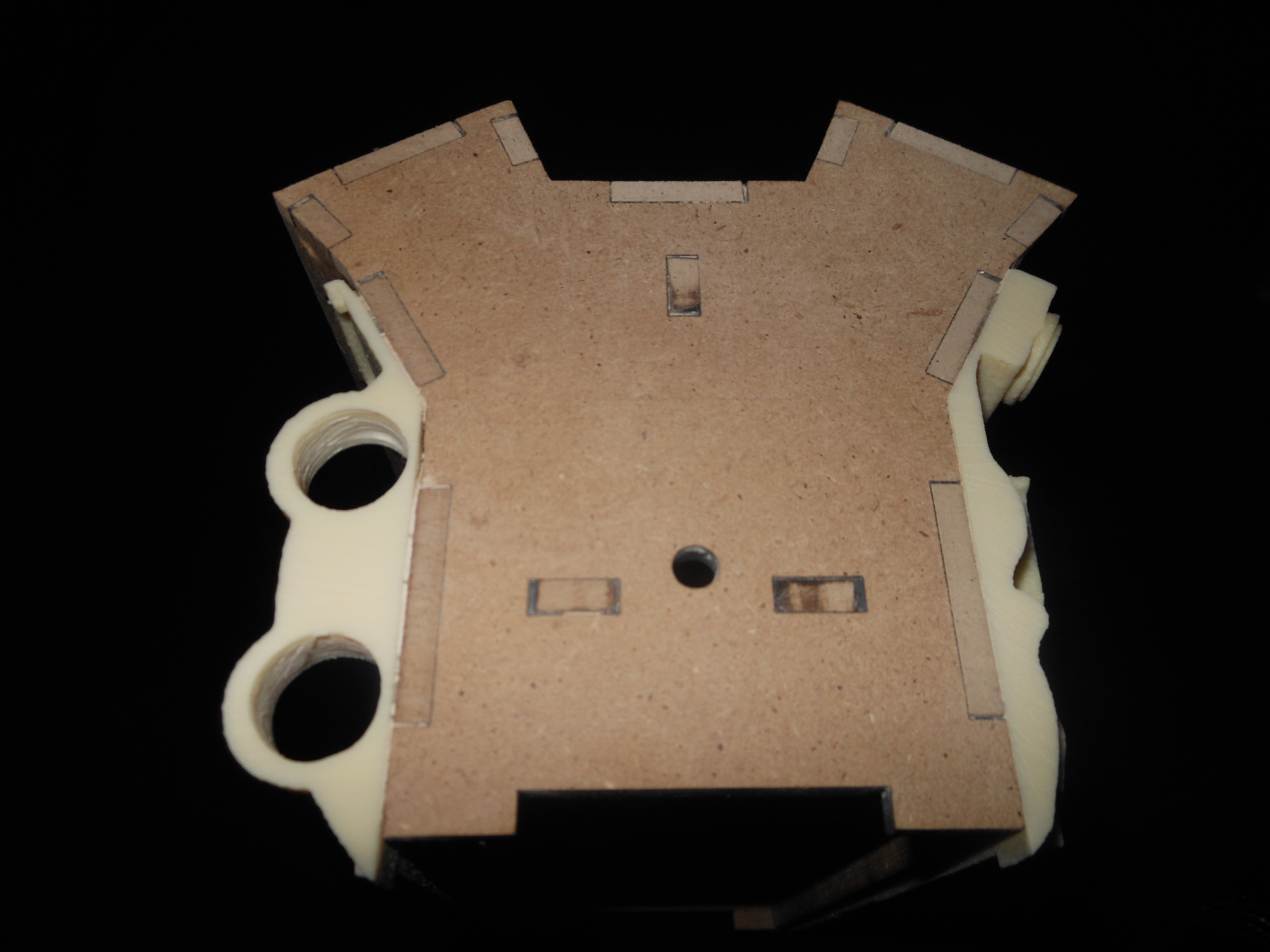

Dear friends modelers, the engines have all been shipped and most have already arrived "safe and sound."

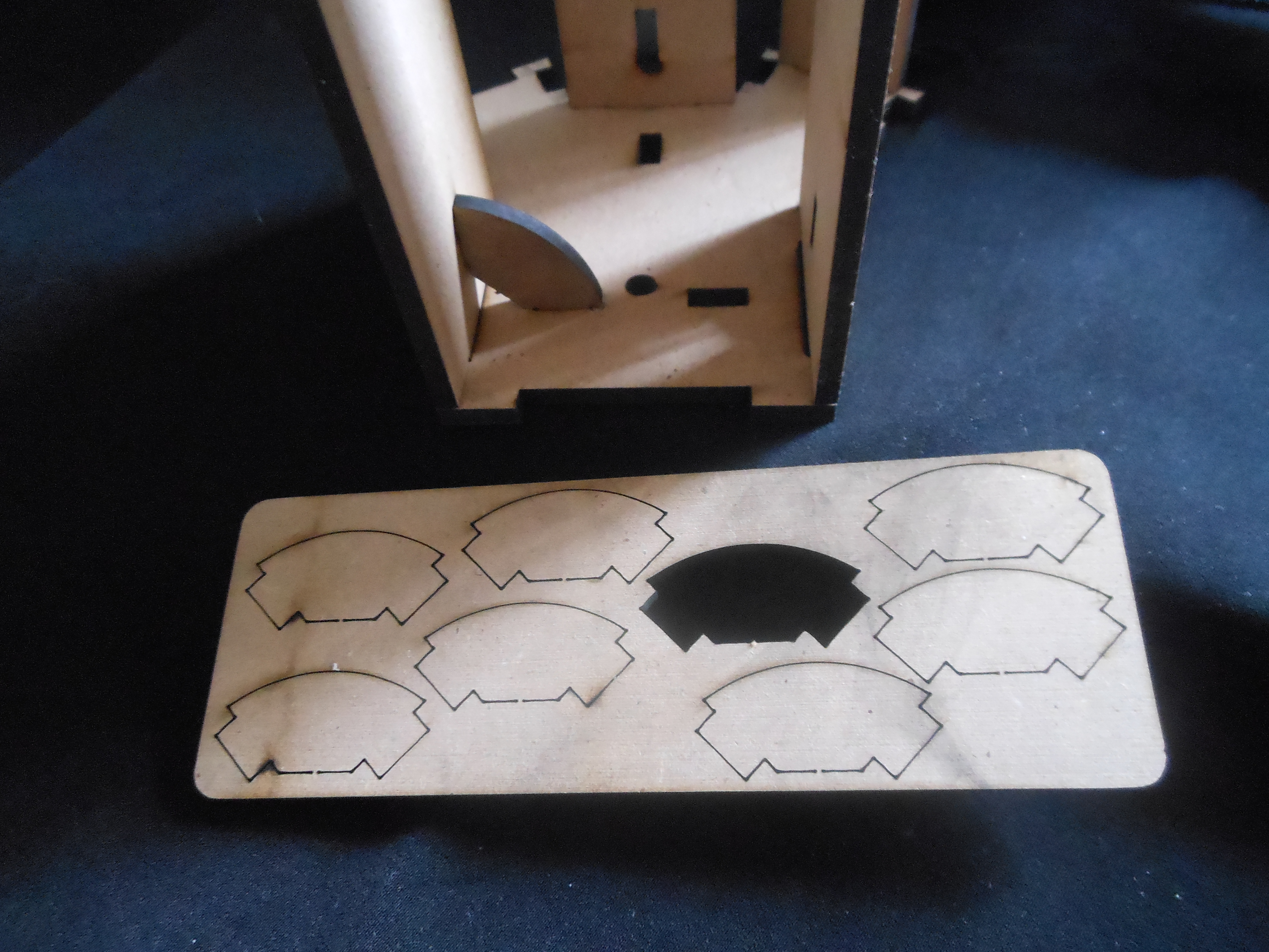

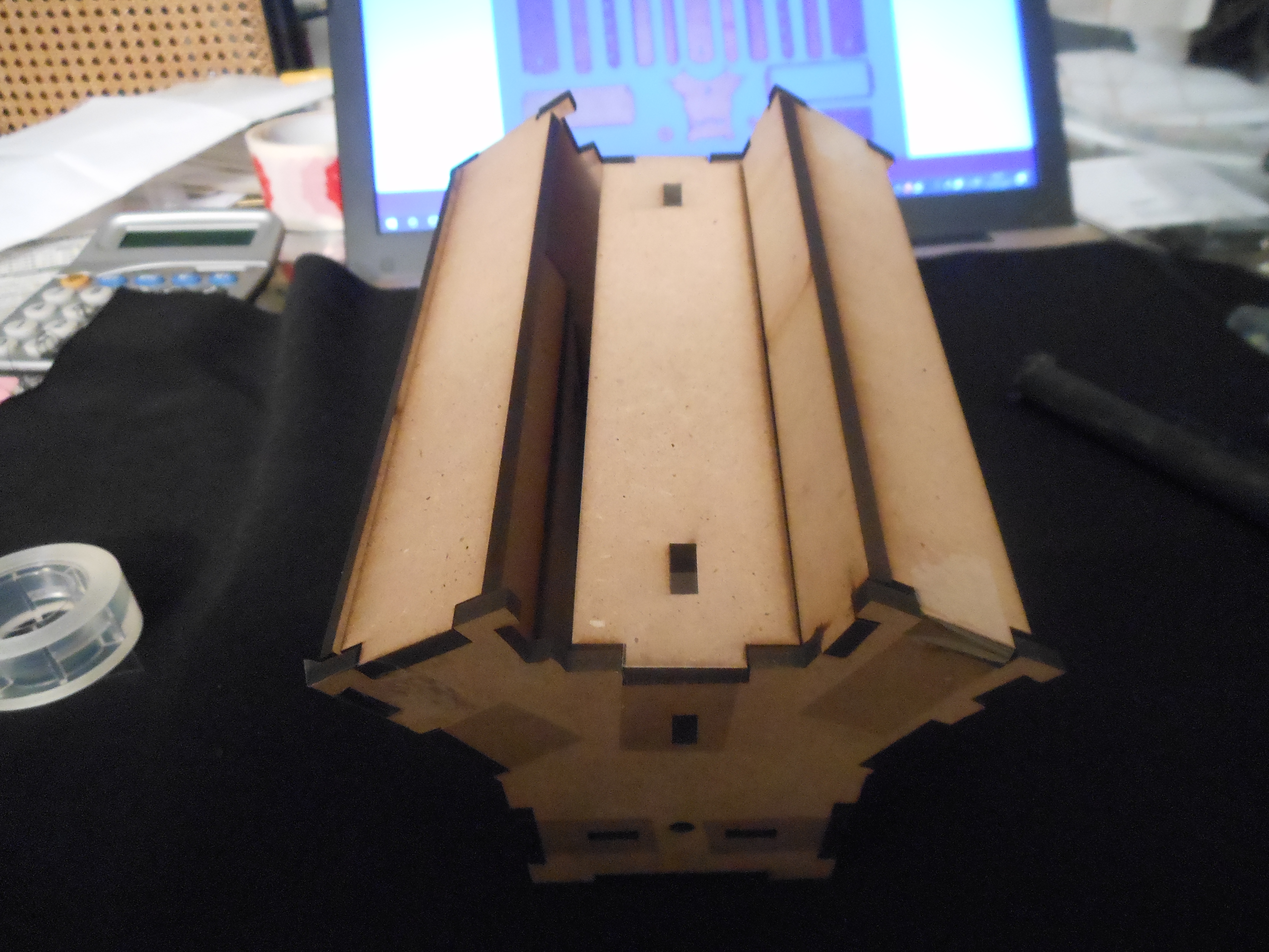

I thought it might be useful to repeat the assembly of parts that maybe in the attached instructions may not be very clear.
We begin by the wooden skeleton.
It should be mounted as a jigsaw puzzle, the hips and heads are mirror images, then you can not go wrong.
The only attention is that the holes should be placed where the exhaust pipes are facing upwards.
For additional security, before pasting, fix it to the test with adhesive tape.
If you want to mount the white metal fasteners you can make holes before gluing the parts will be easier to take measurements.

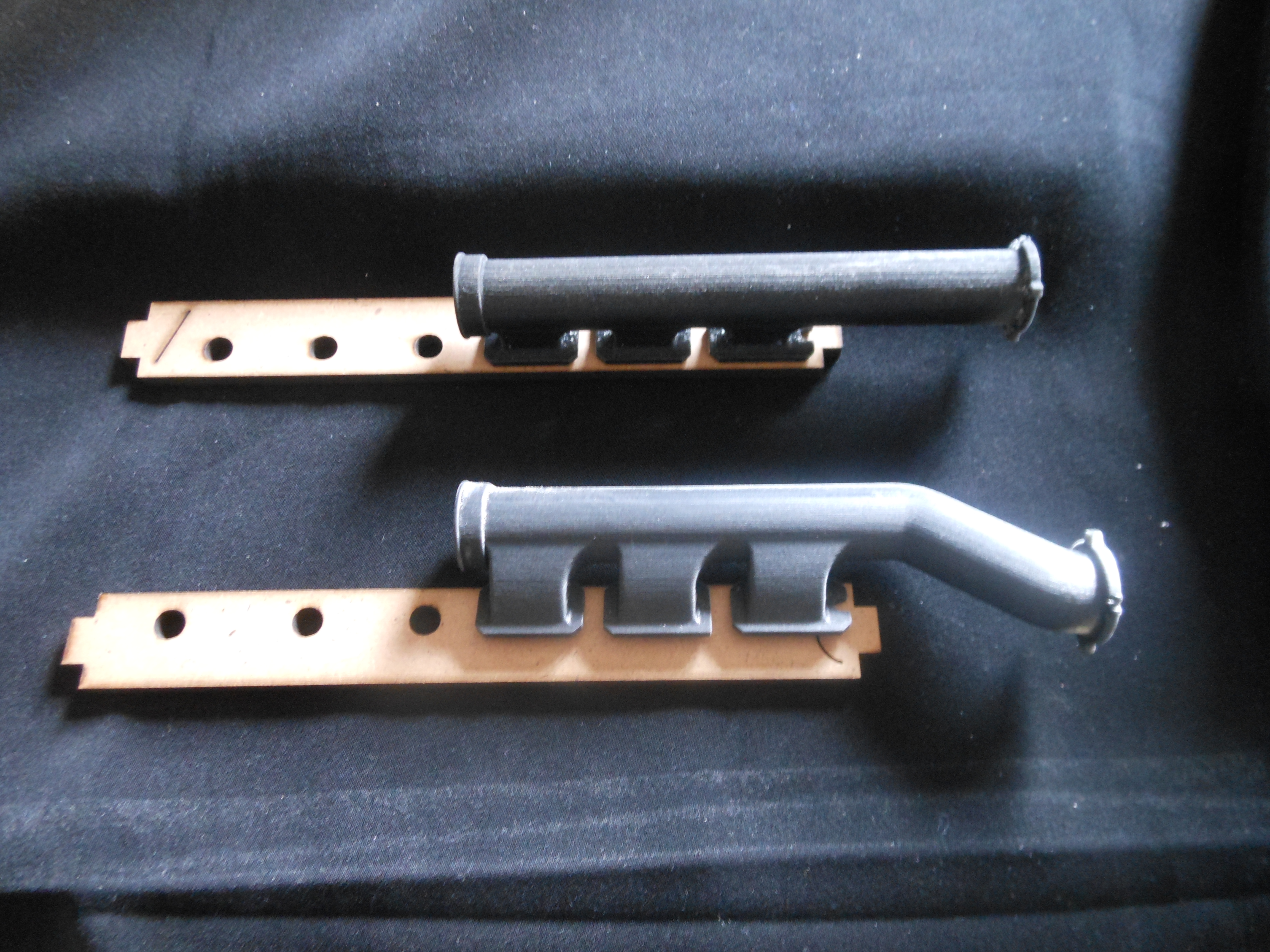

The center detent of the right side is a little lowered. Right side, the exhaust pipe straight.
Left side pipe exhaust wrong. Left and right side looking at the motor rear (where the chain). If you want to intervene, I think it will be interesting for everyone to follow the installation of the engine in all its parts.

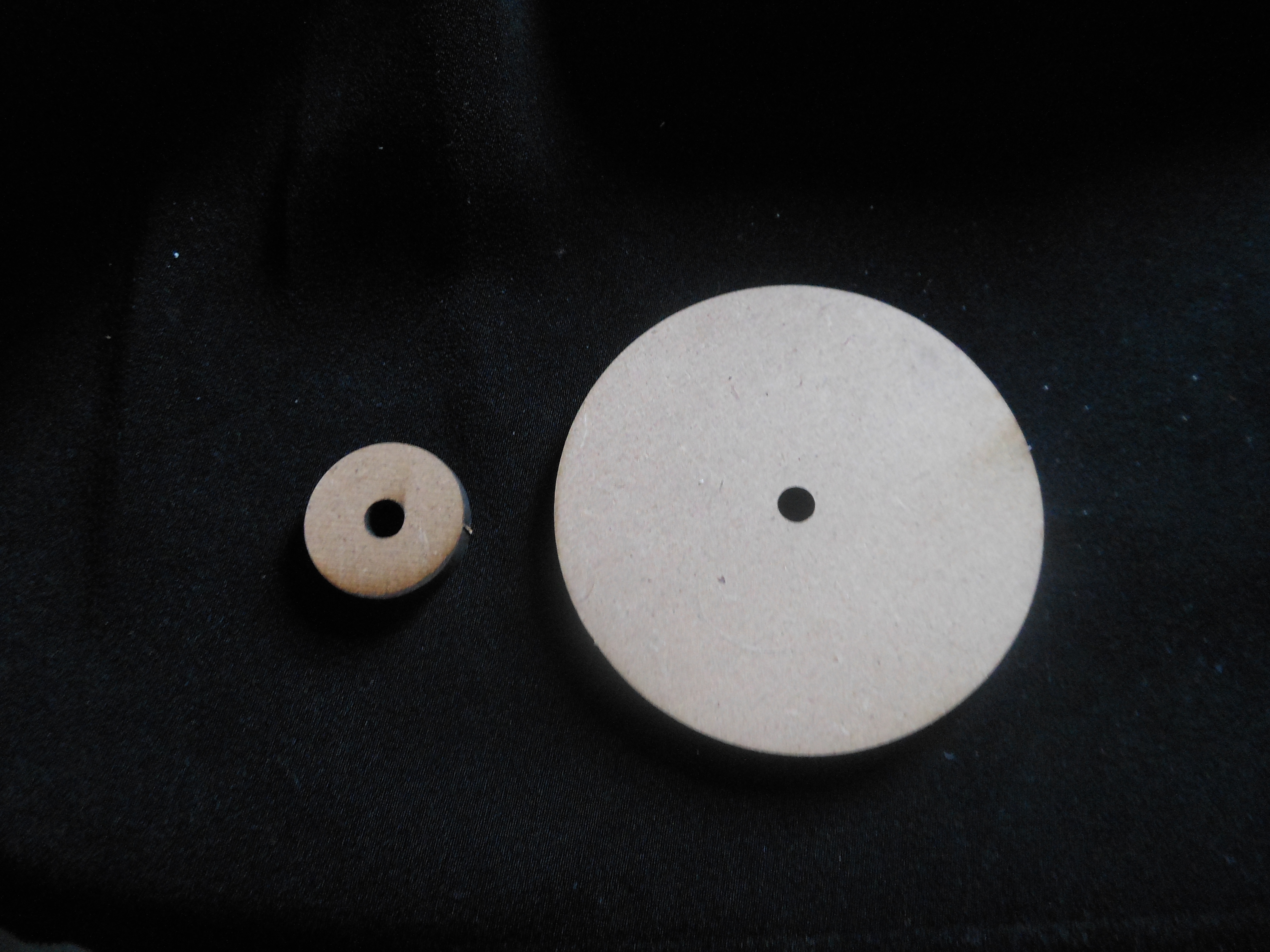

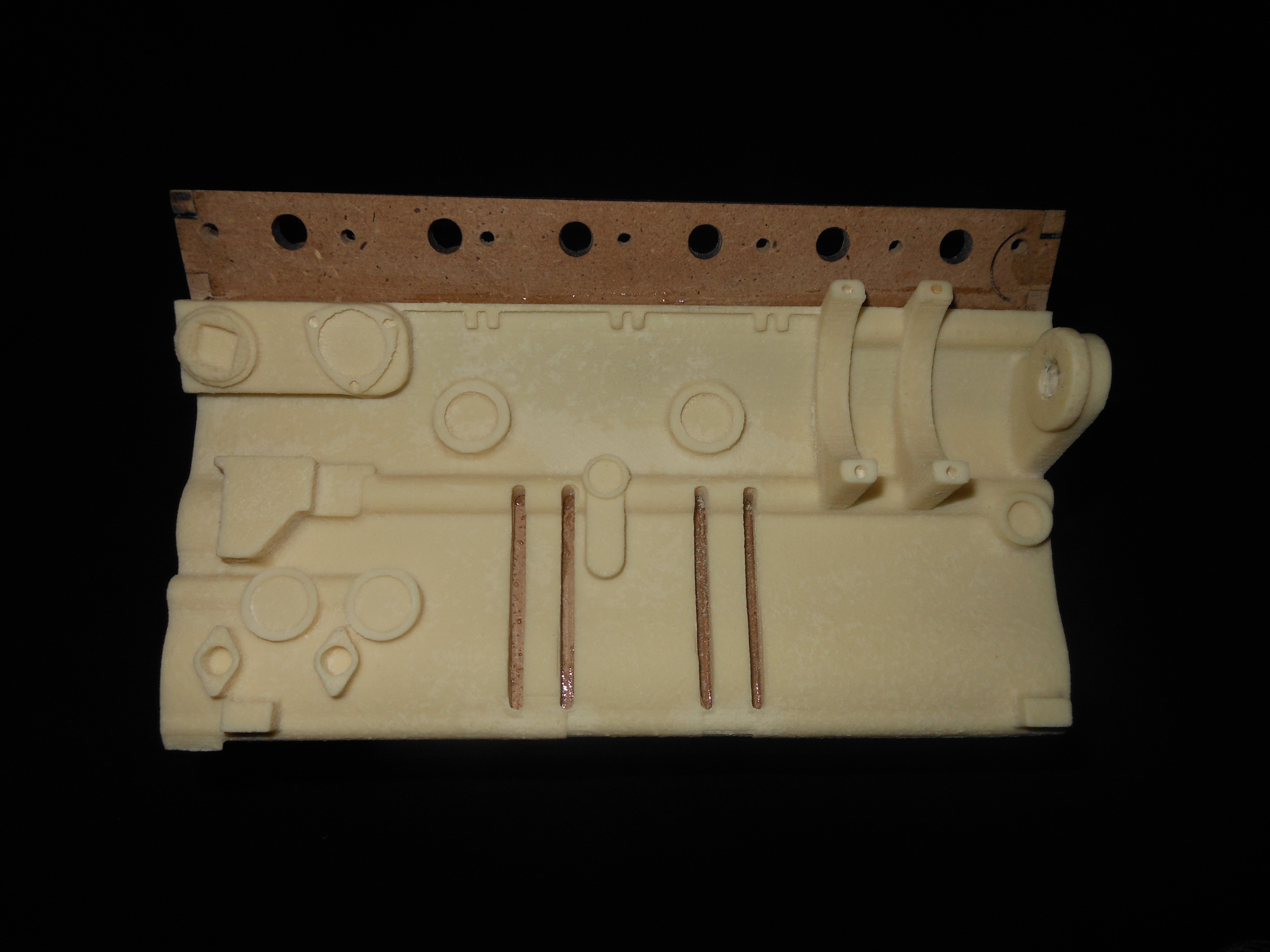

Use wood glue type Pattex or VINAVIL.
In the inner part abound with glue to close and cracks.
When the glue has dried, stuccoed on the outside of the slots and finished with sandpaper. Leveled height differences that are present, in particular where they should be placed the motor heads.
In the wooden parts there are the inserts to facilitate the positioning and bonding of the skeleton.
The circles NOT BE BONDED, only serve to center and facilitate the placement of the other parts. You will understand yourself when the time comes. The engine fund may be closed or left open, you decide, I would still recommend it to decide at the end of the assembly.

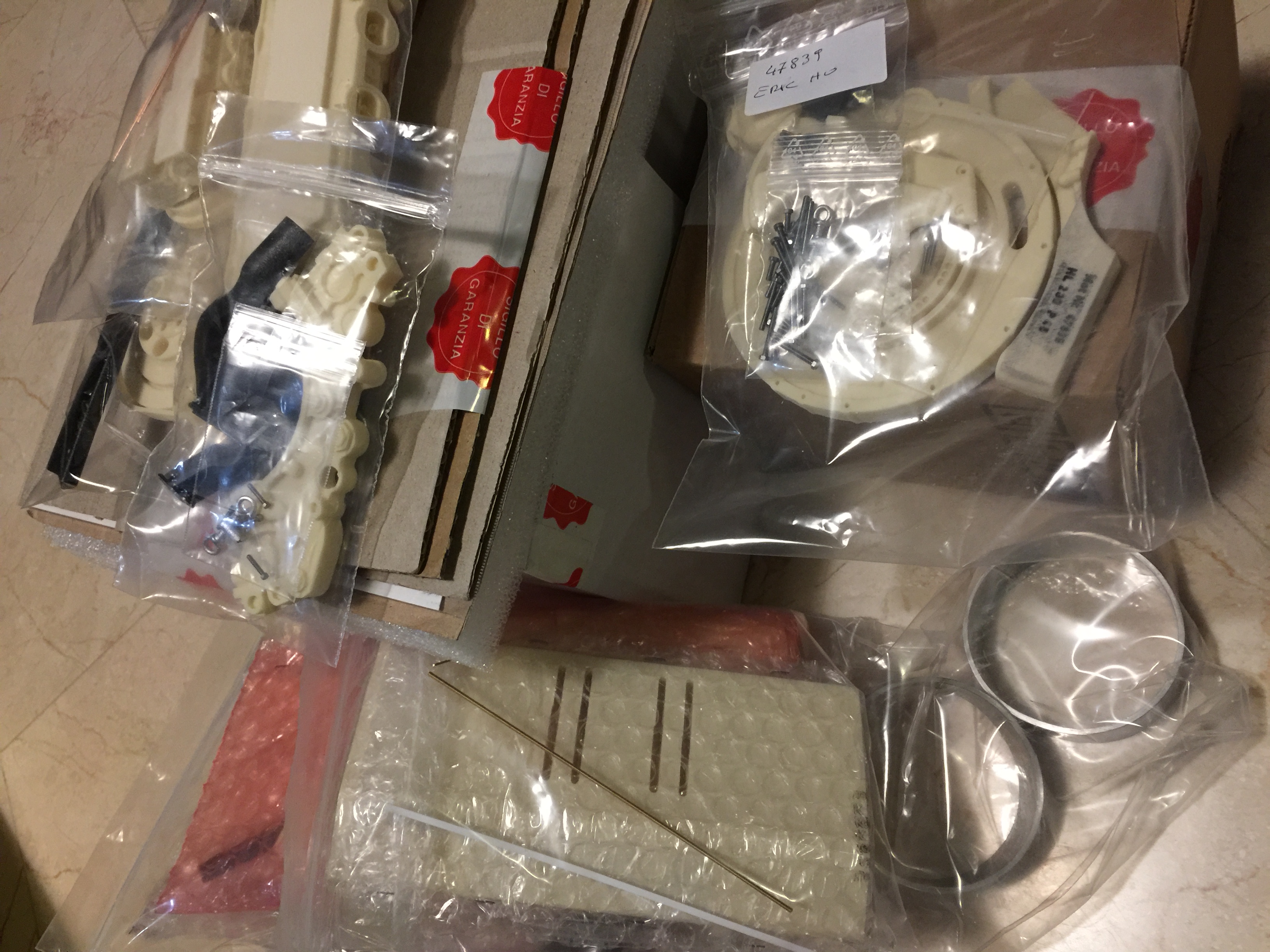

Ivano, please post more pictures. They are a great guide to the assembly!
I got my engine last week, but it has been sitting in the box as I was still too jet lagged to open up and sort.
I only got to open it up this week: Parts are well packed! Looking forward to putting it all together

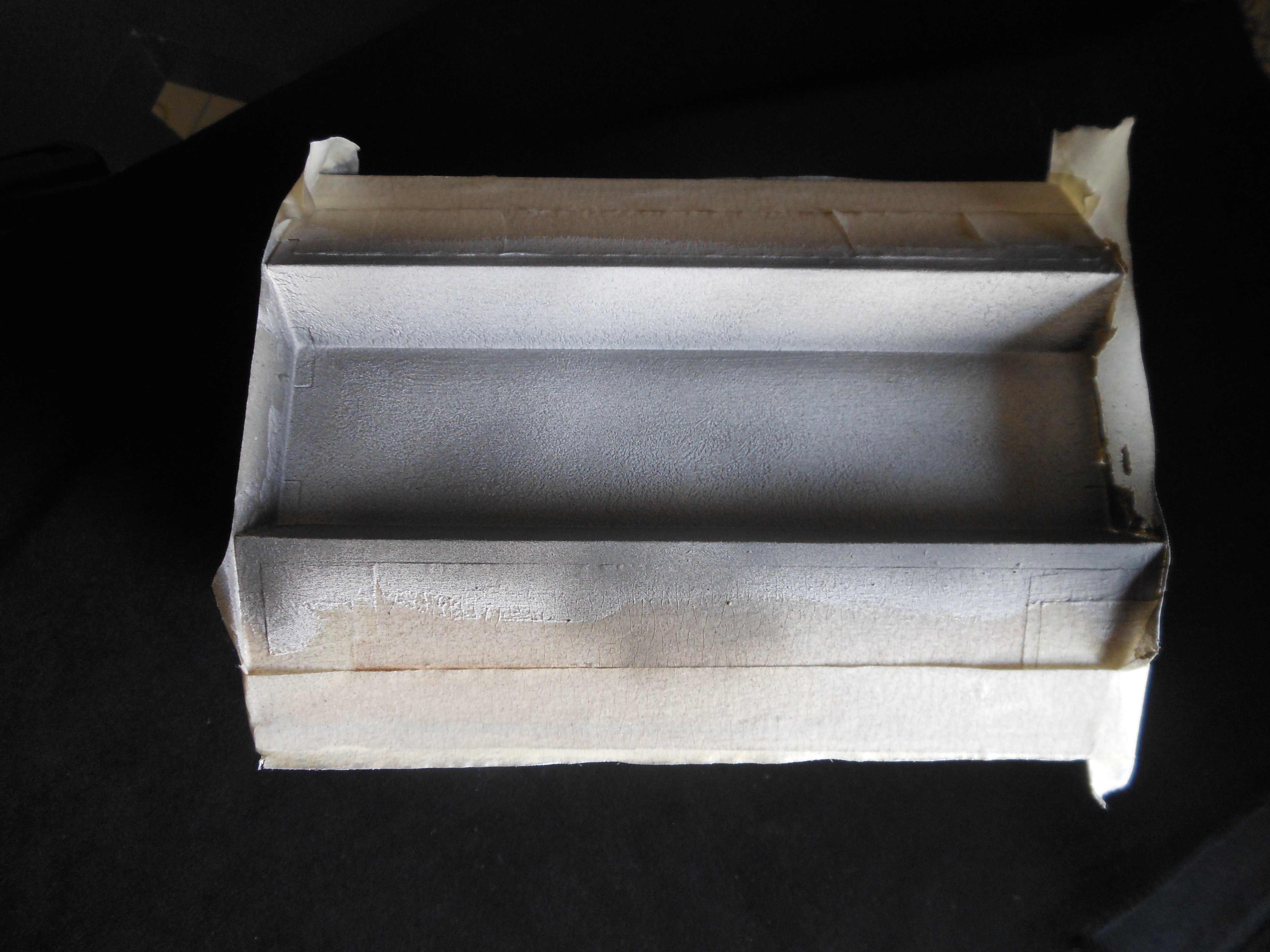

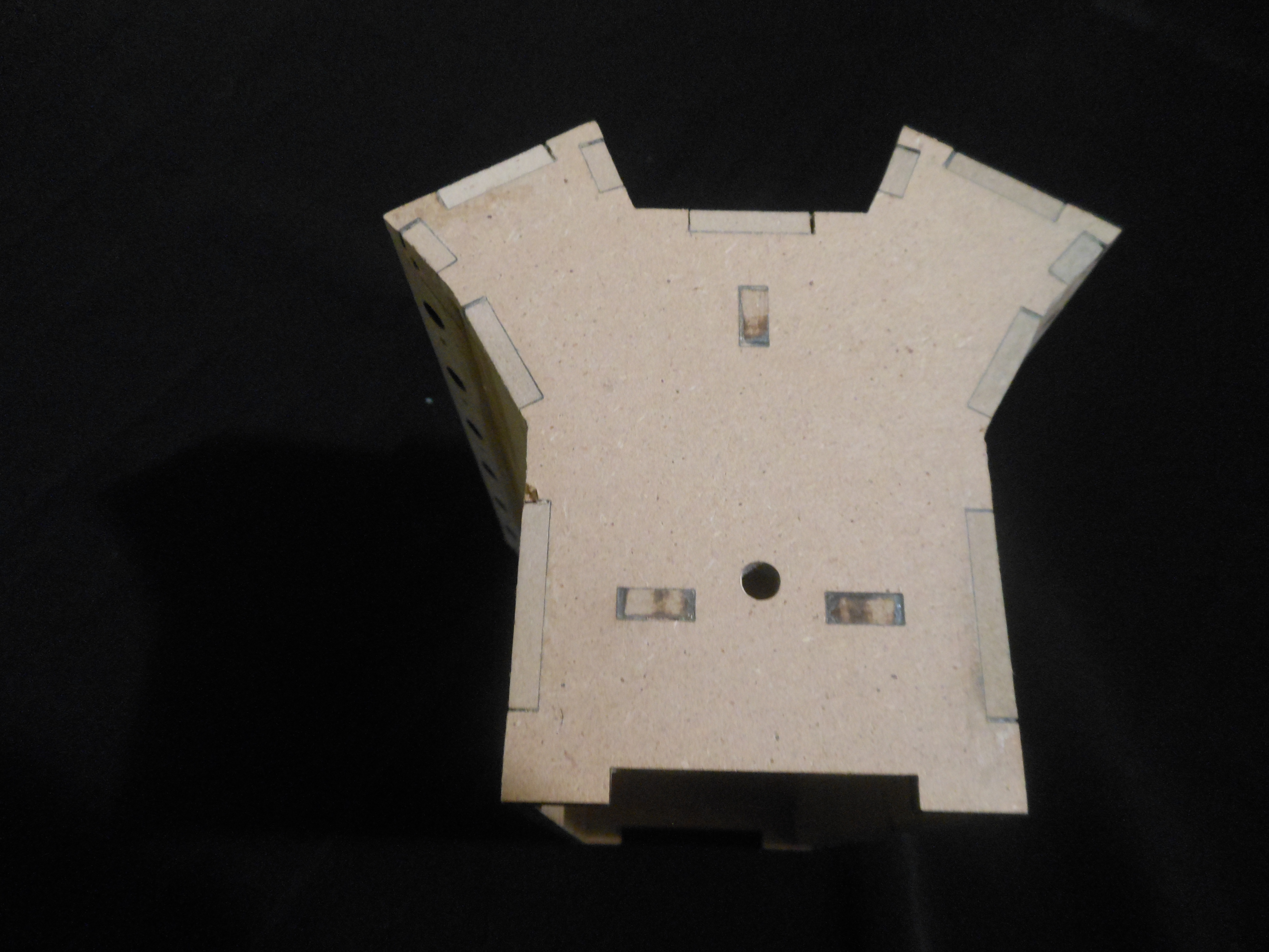

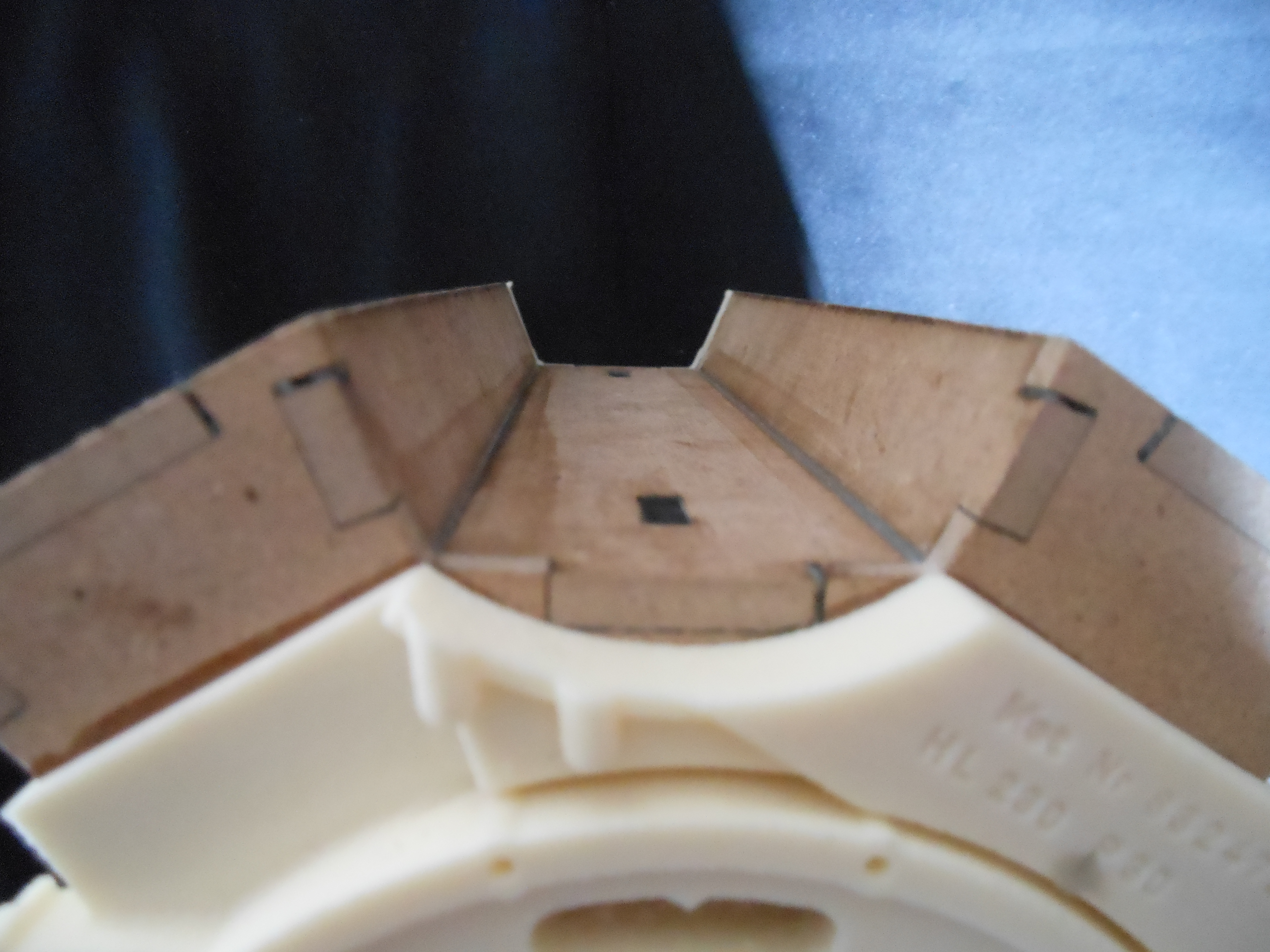

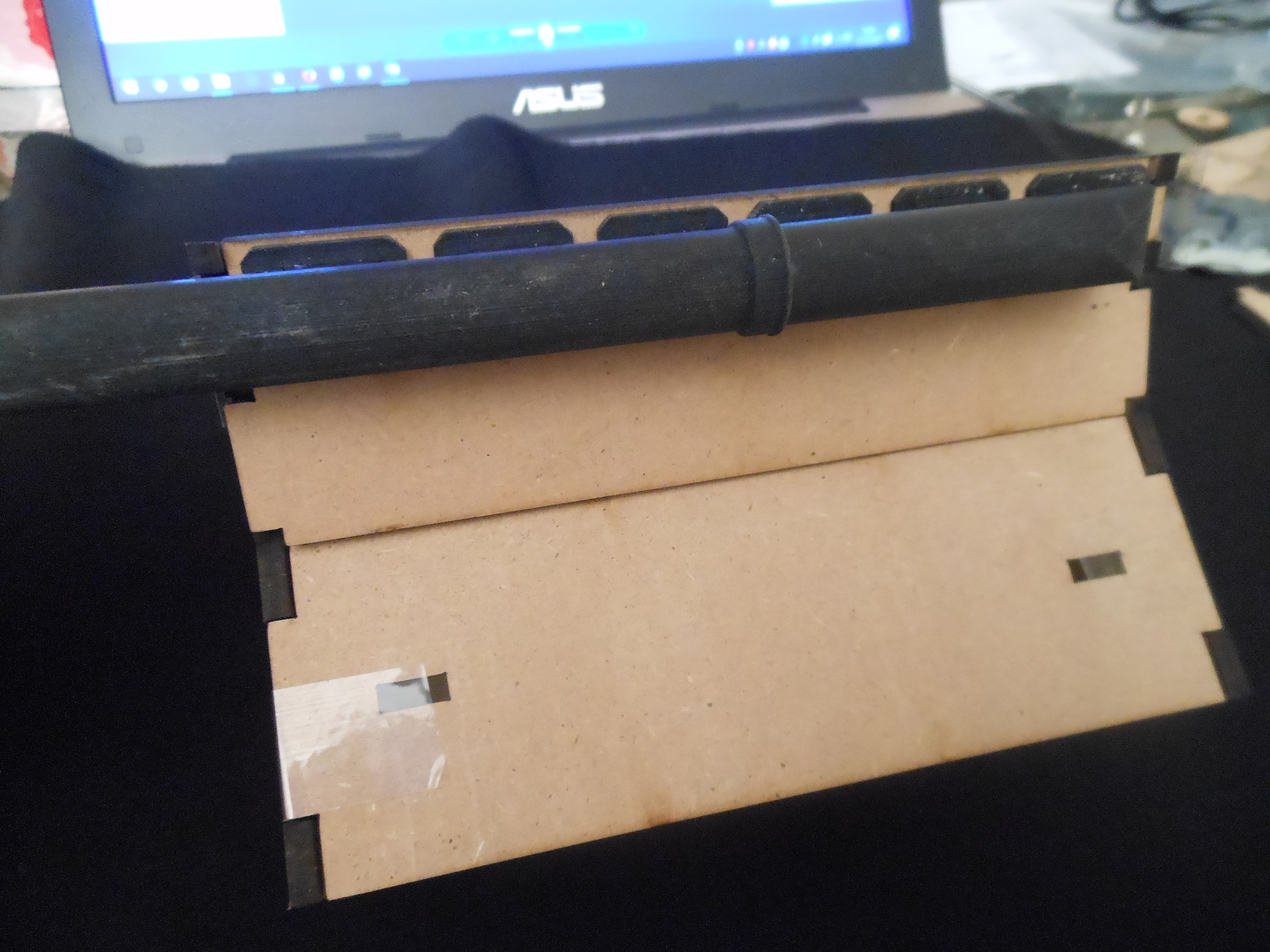

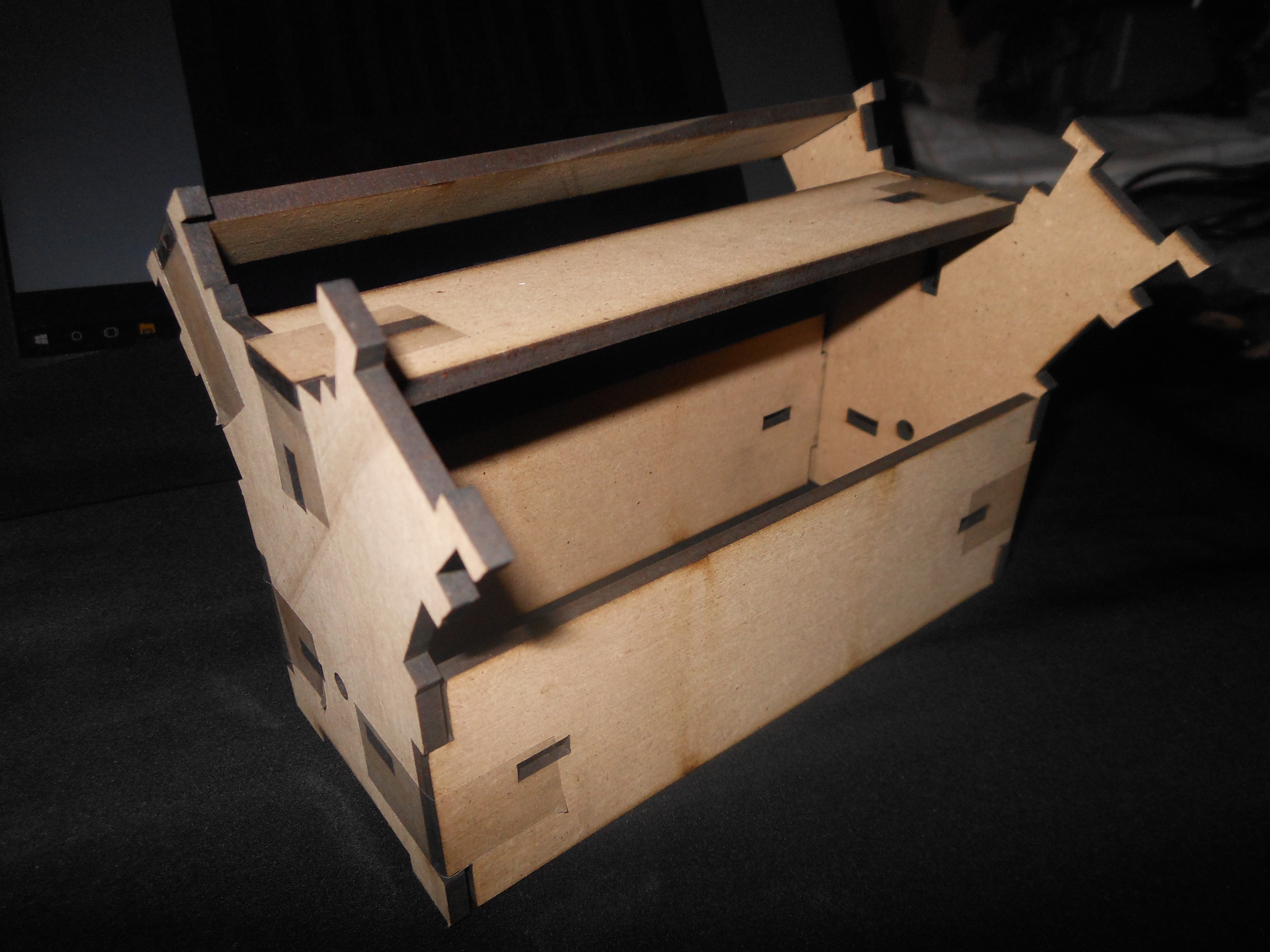

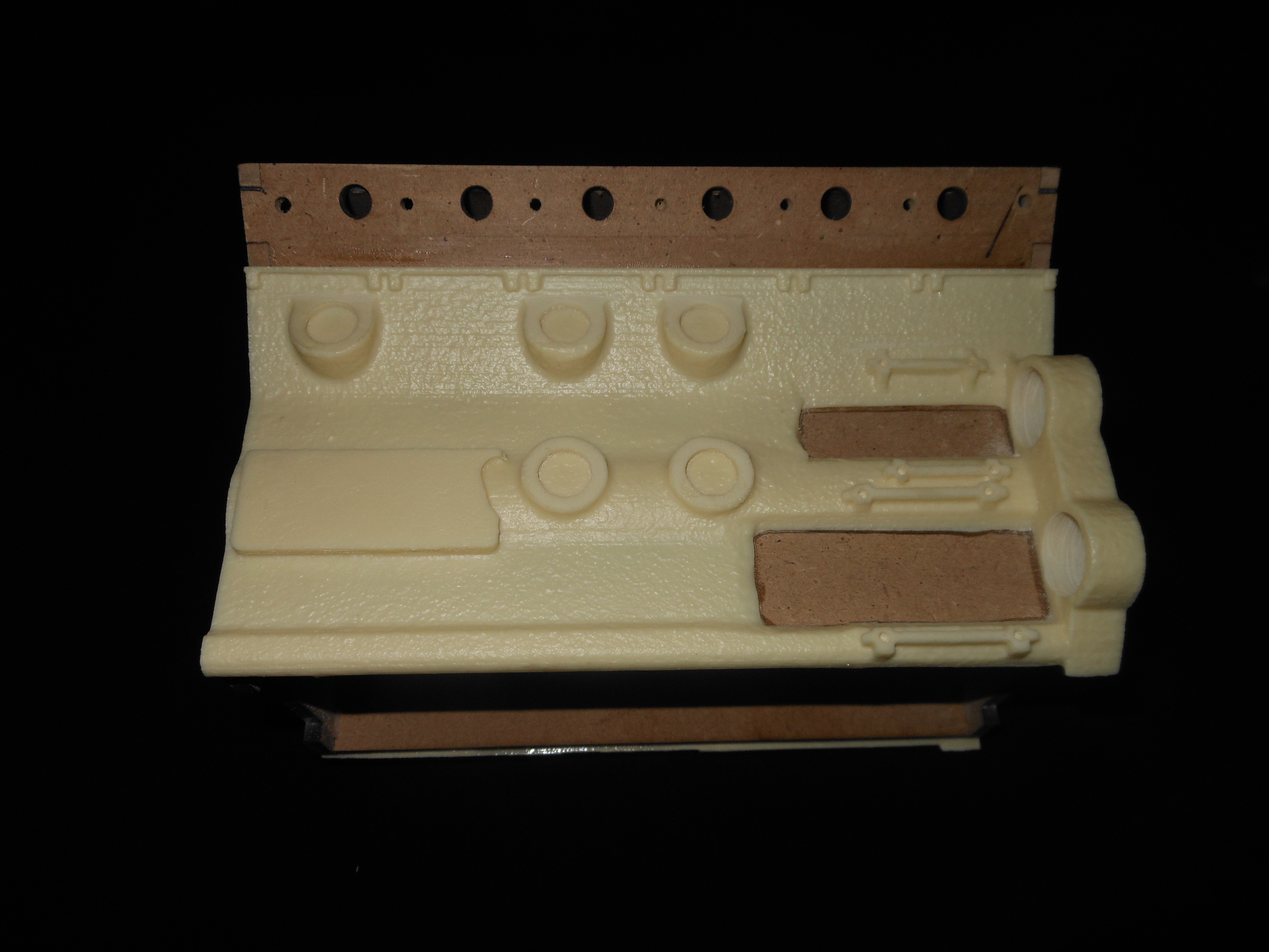

Here assembled take the skeleton MDF.
All very simple and precise, like a puzzle.

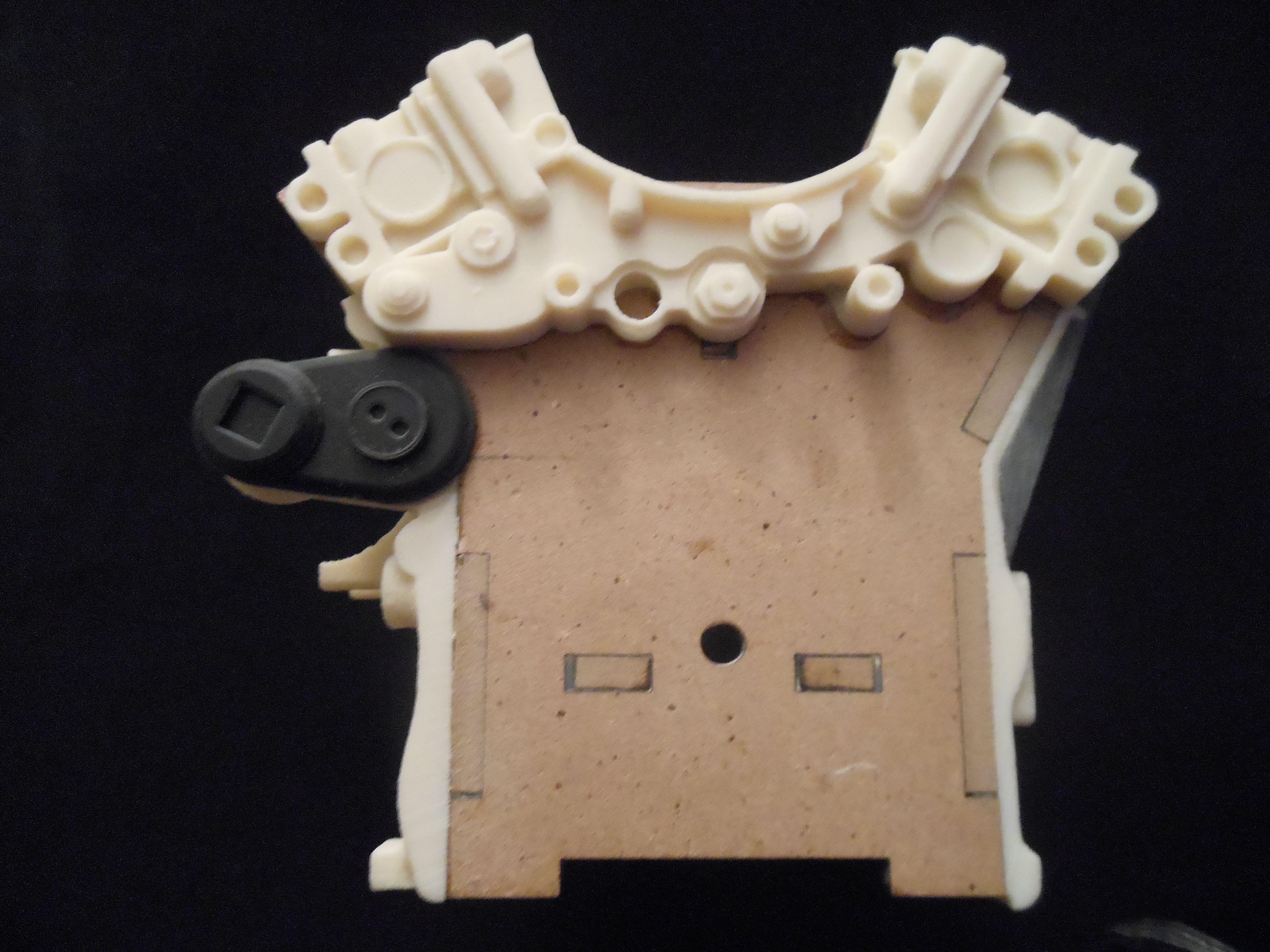

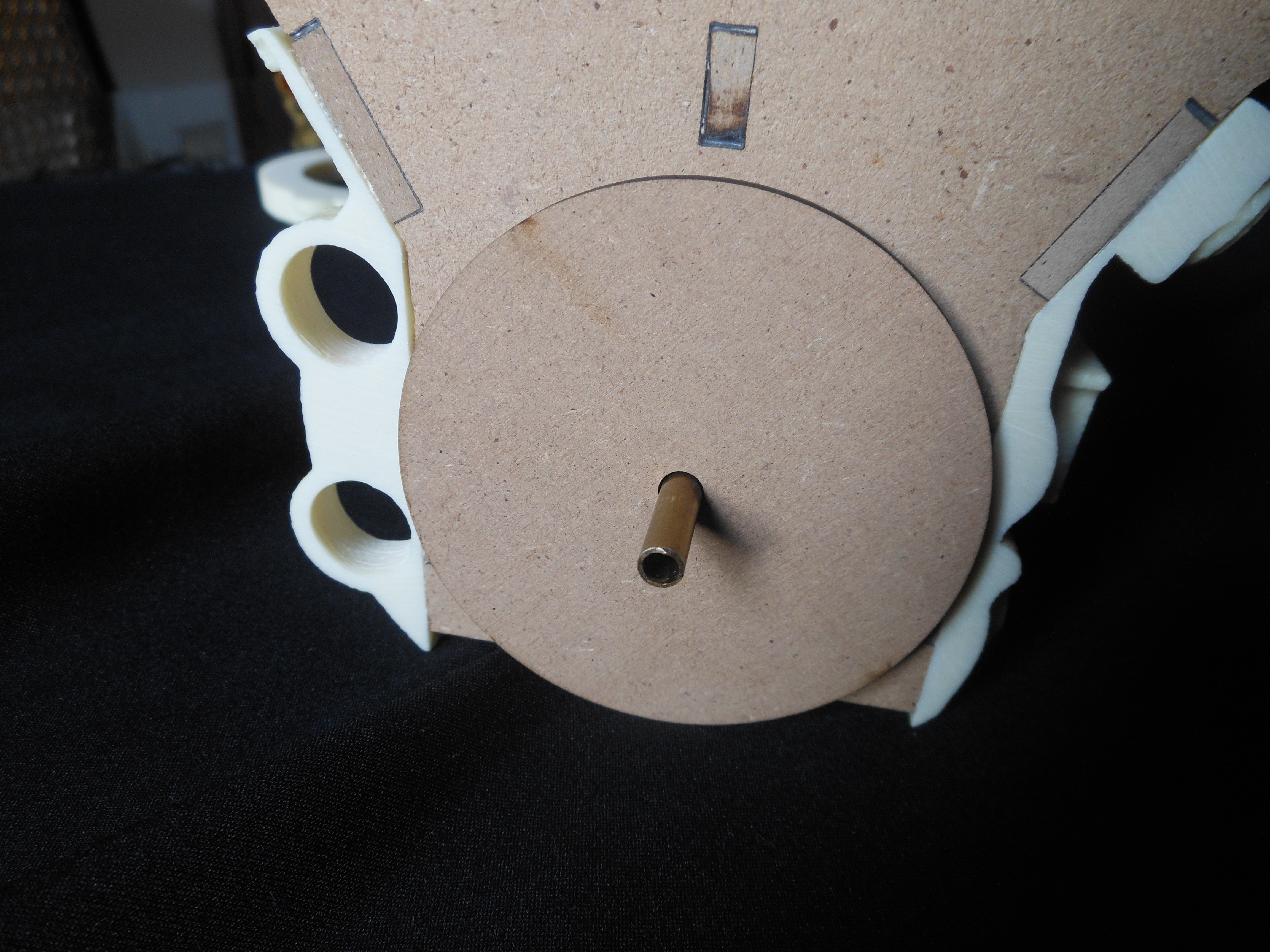

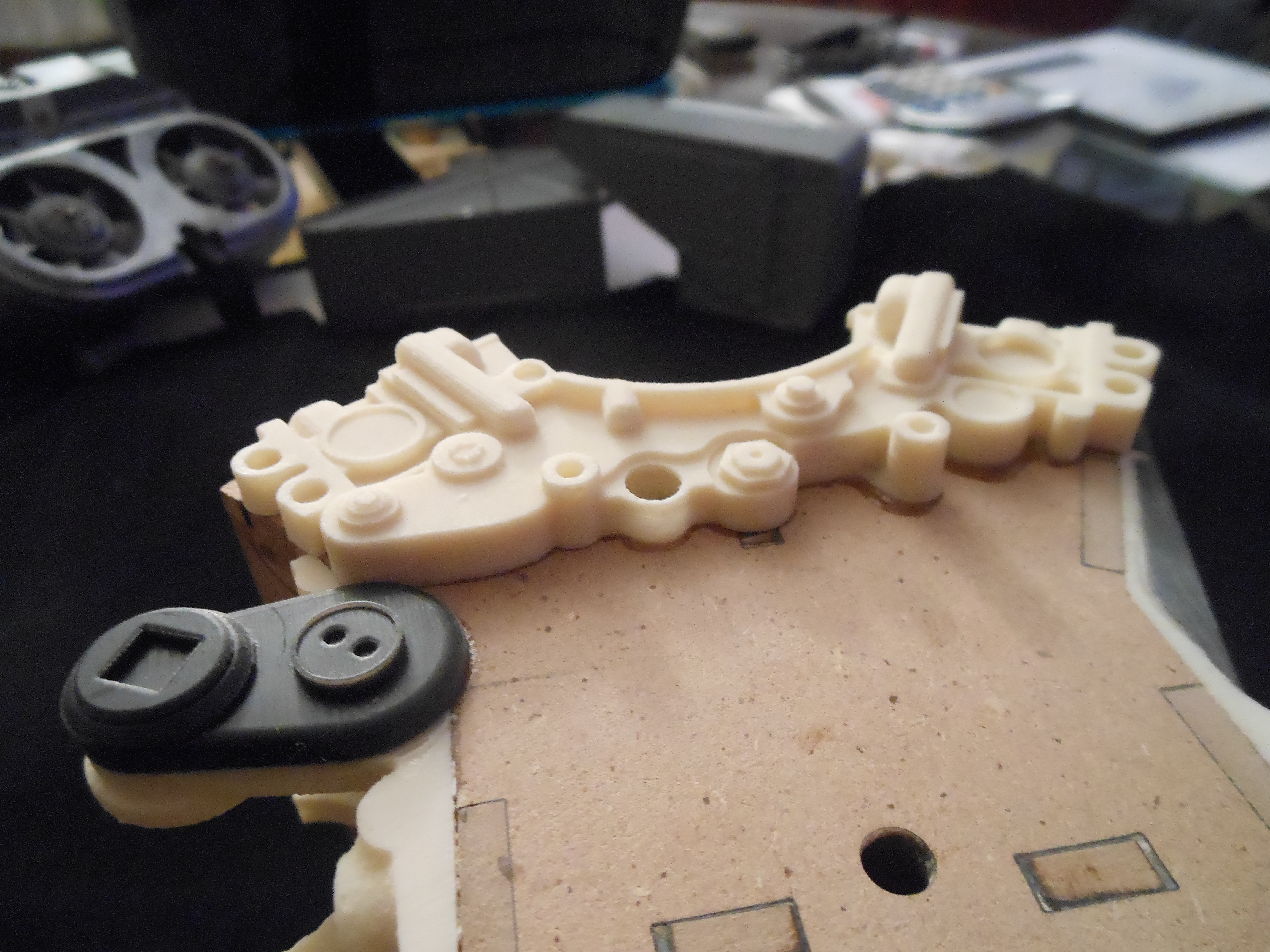

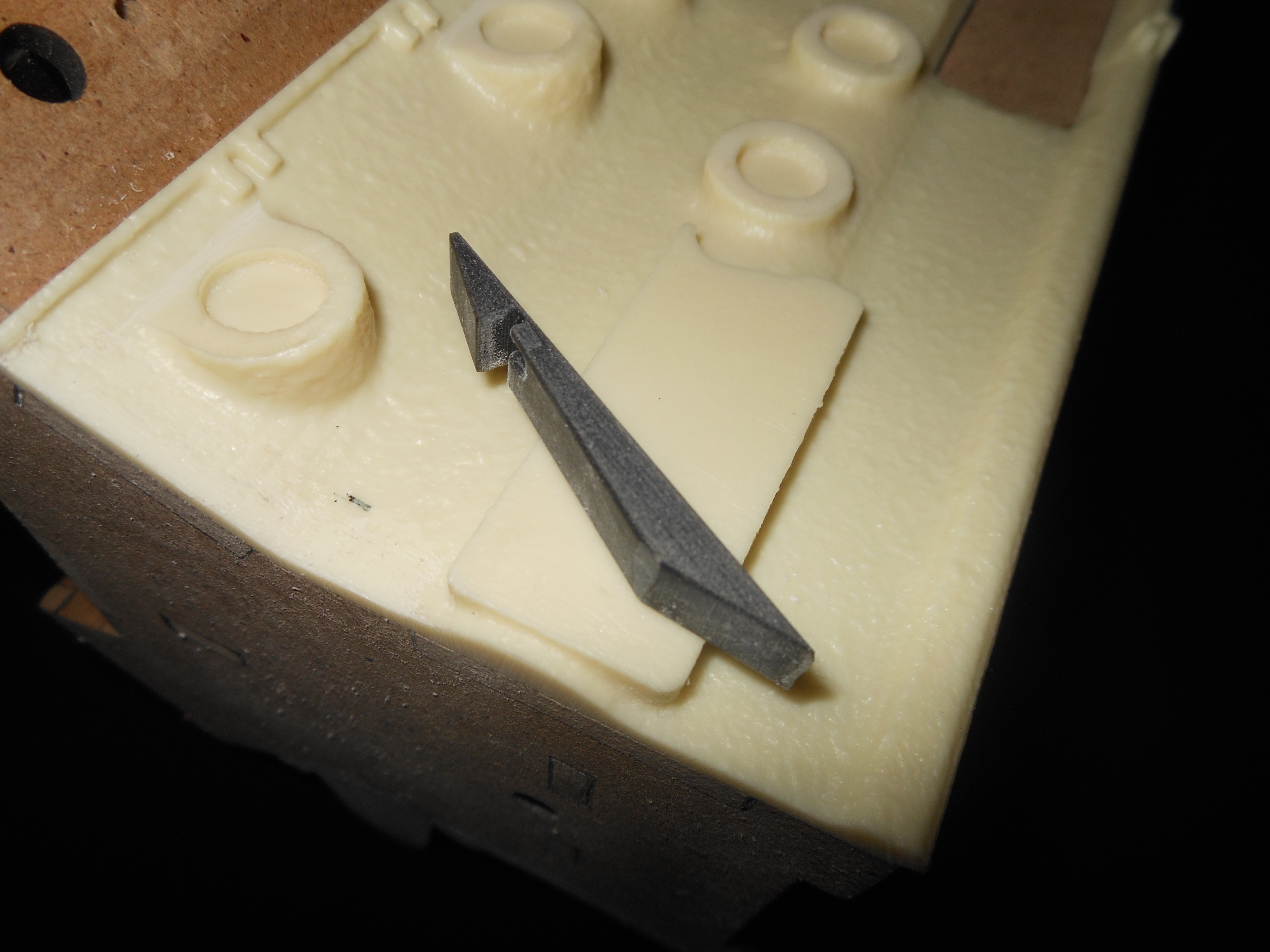

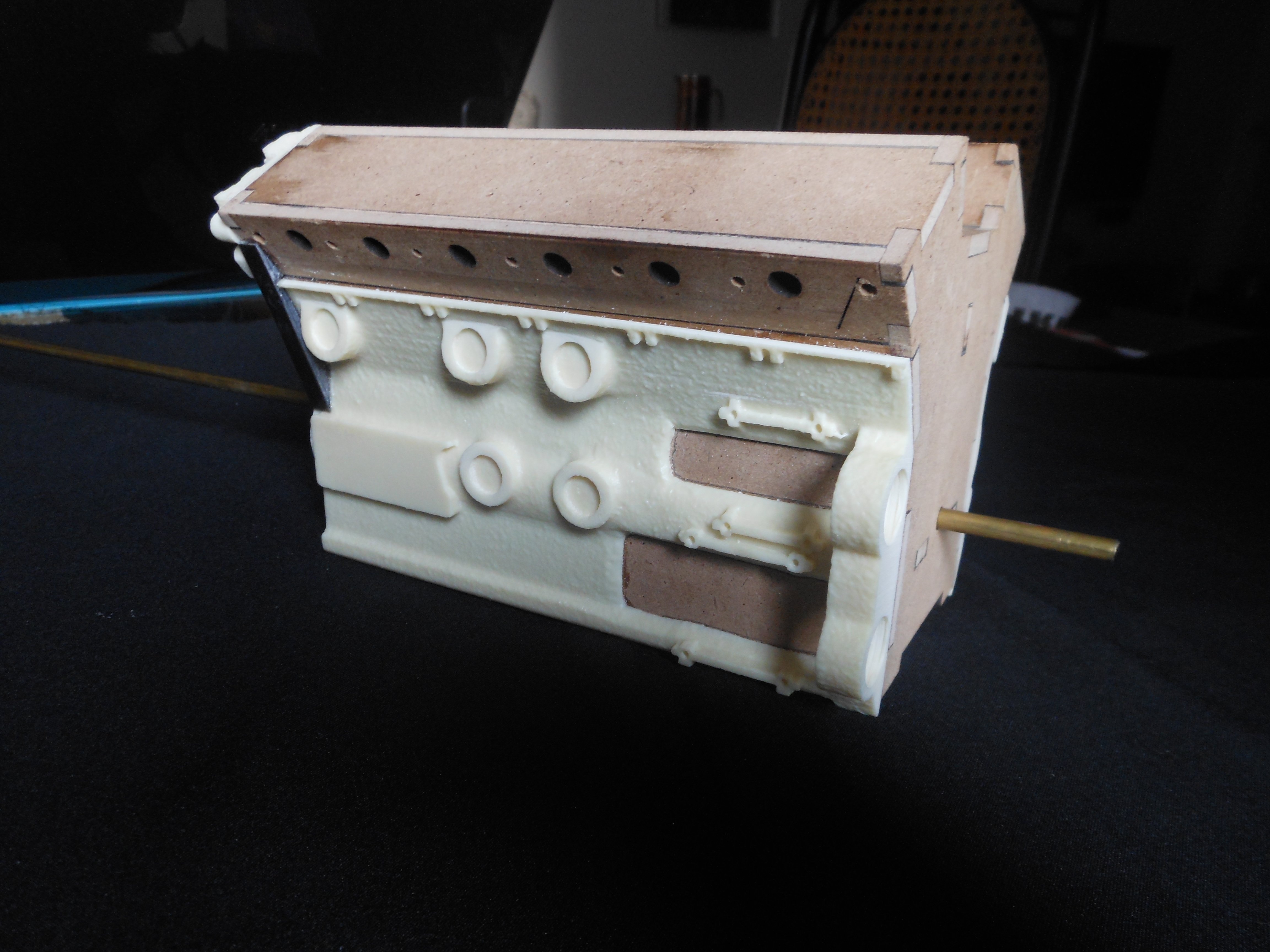

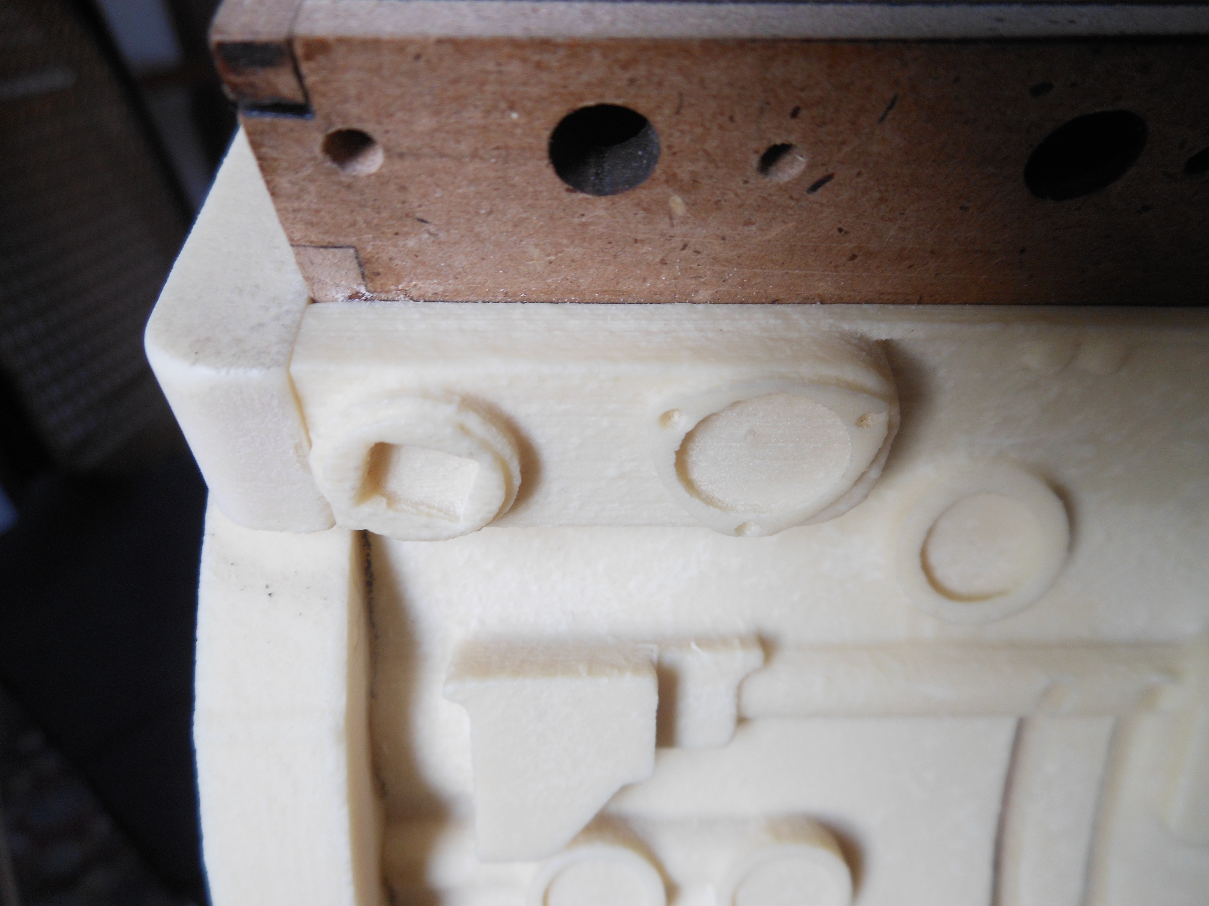

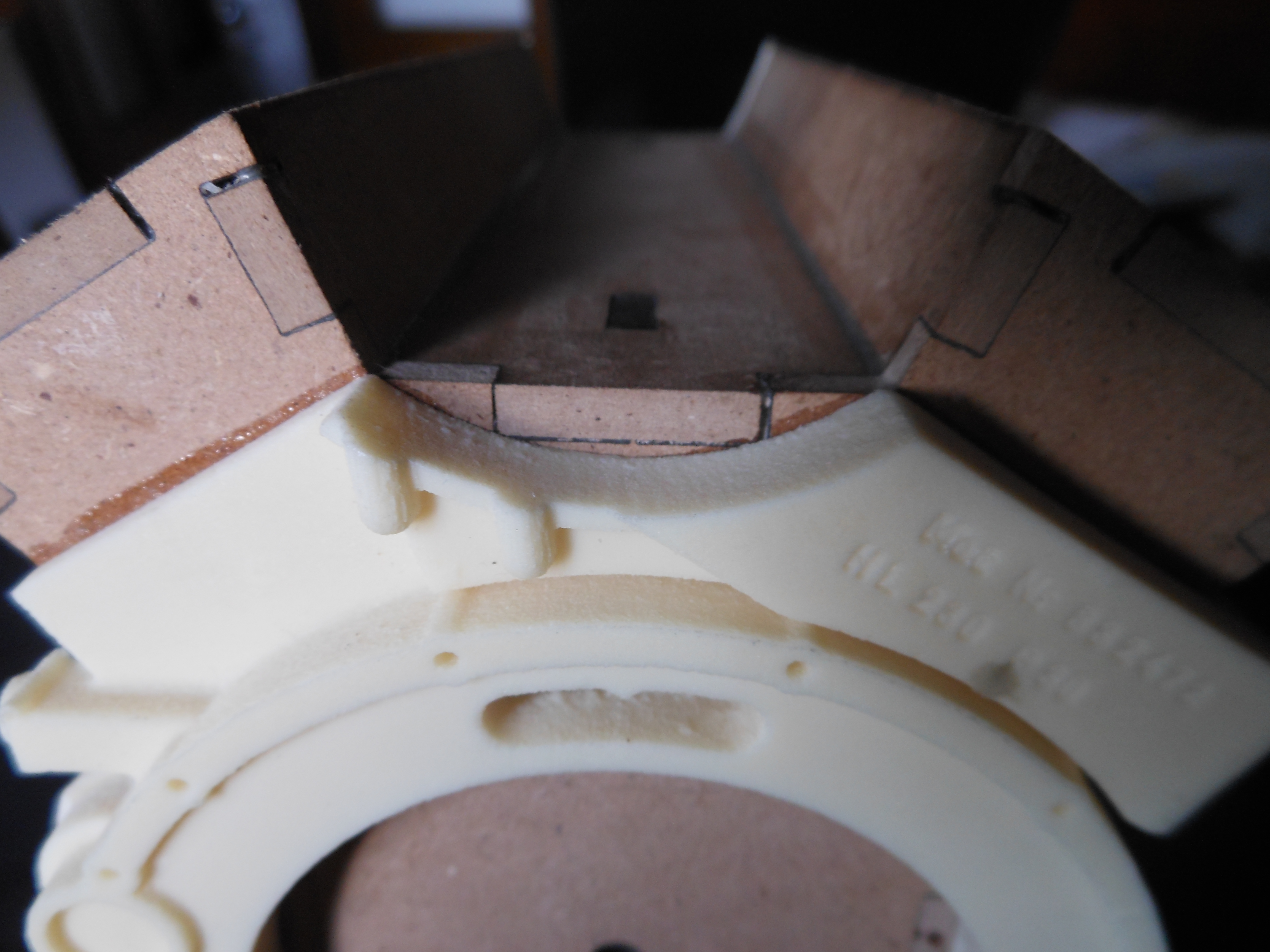

The engine that I'm putting together will be mounted on my Tiger Mid.
I will make changes to the assembly but only for my personal taste.
Photographs available on the internet you can see a lot of variations.
Look at the available material, will help you make a beautiful engine.

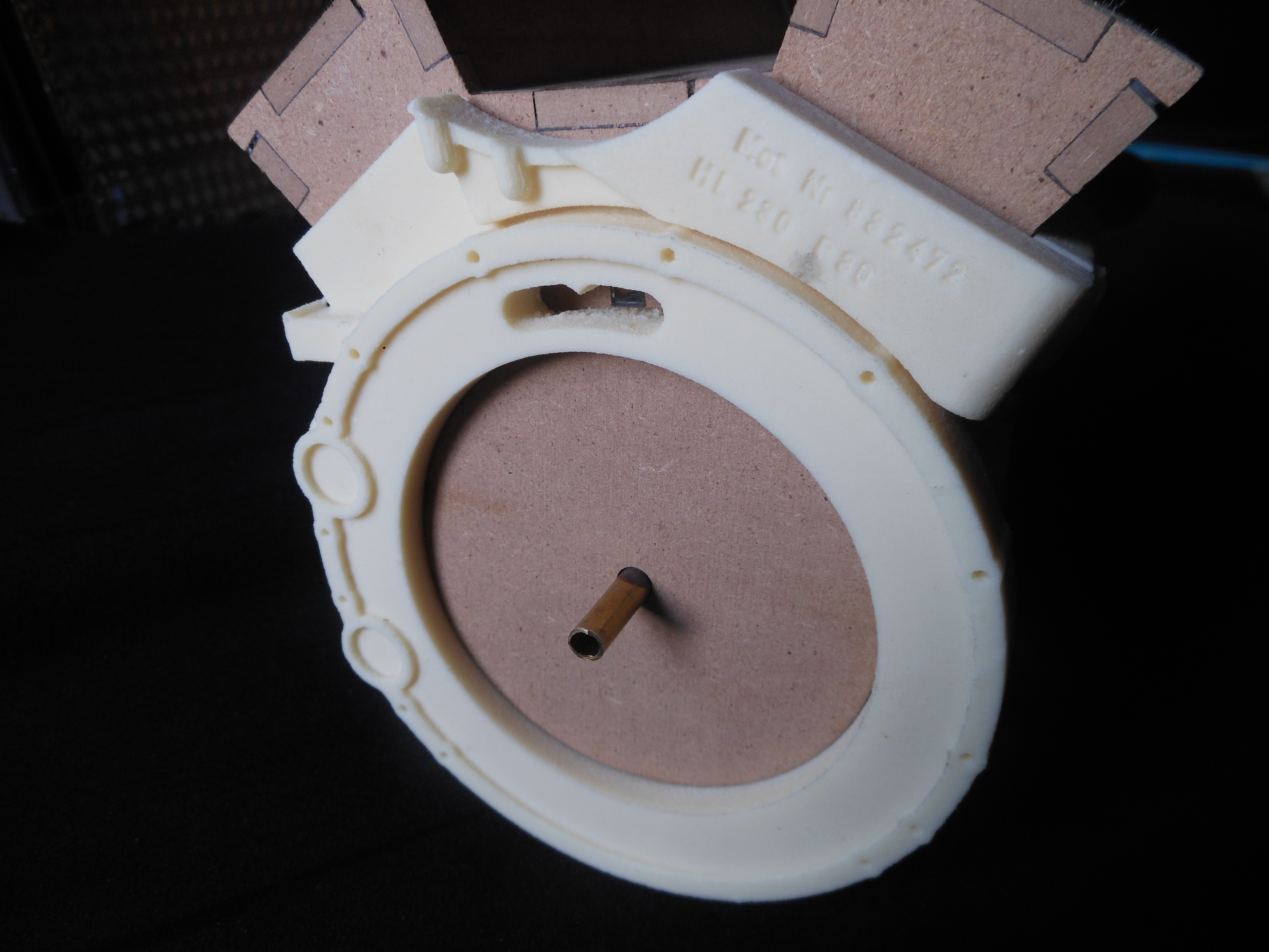

Here are more photos of the installation of the first pieces on the skeleton

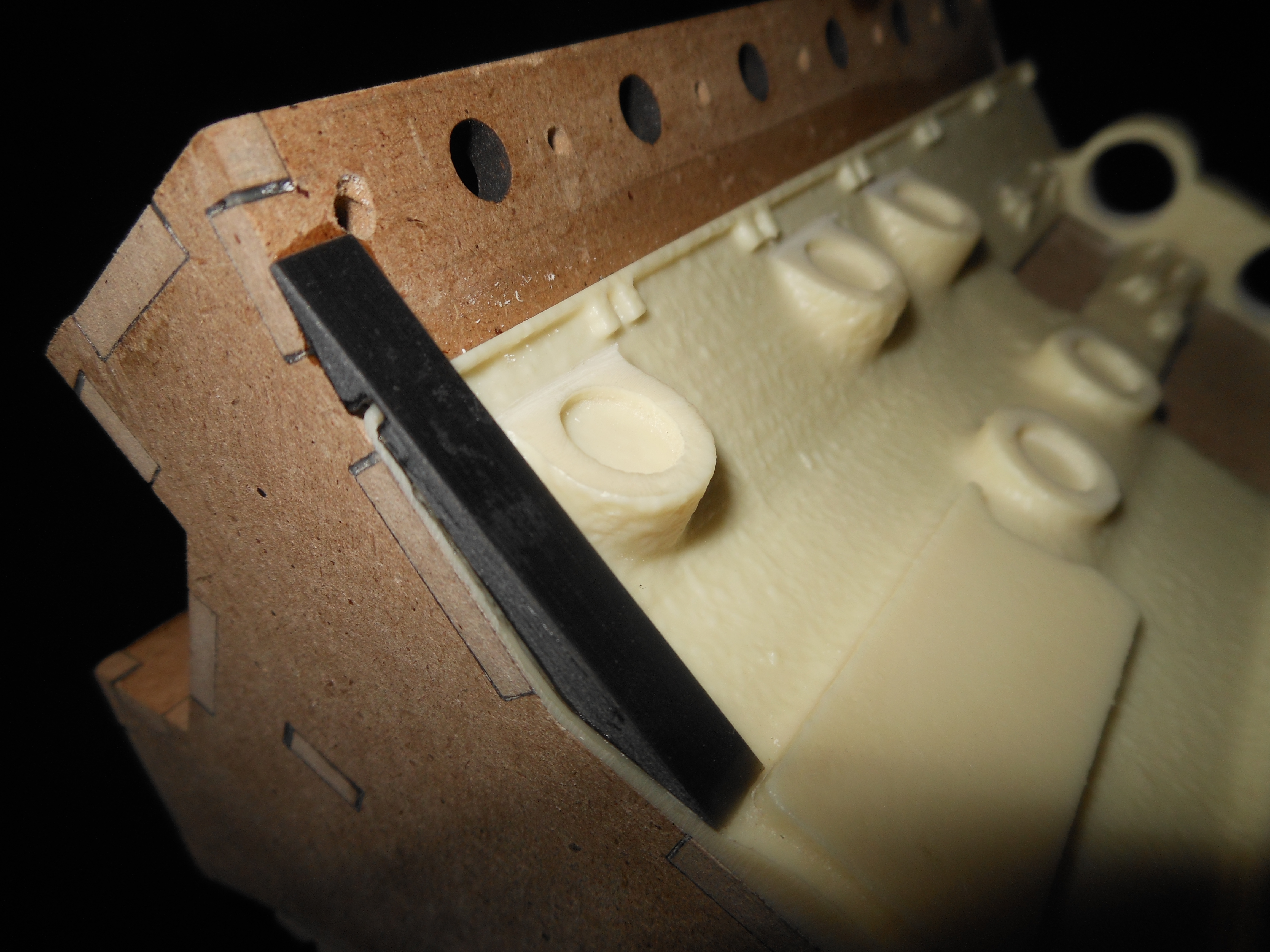

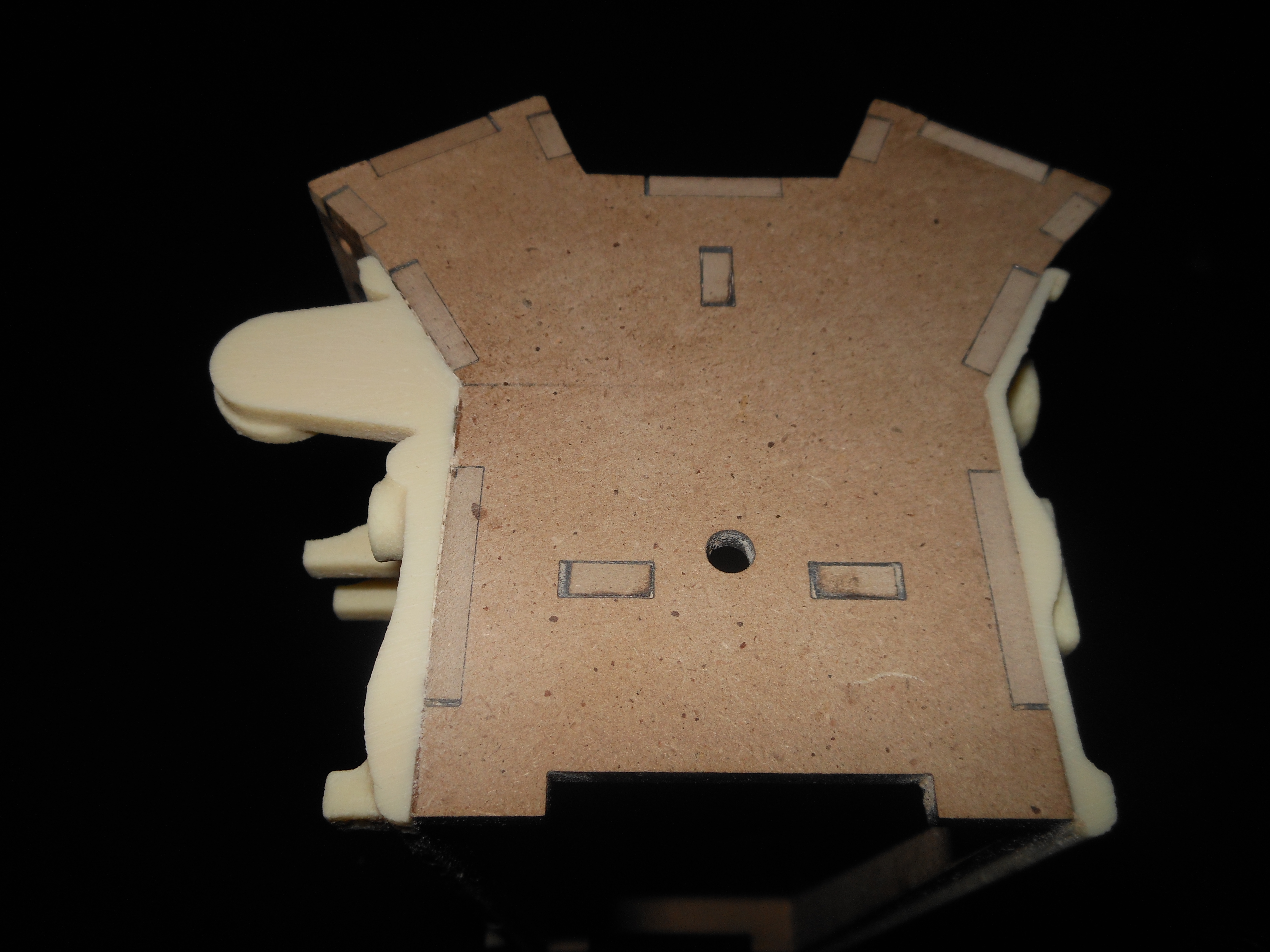

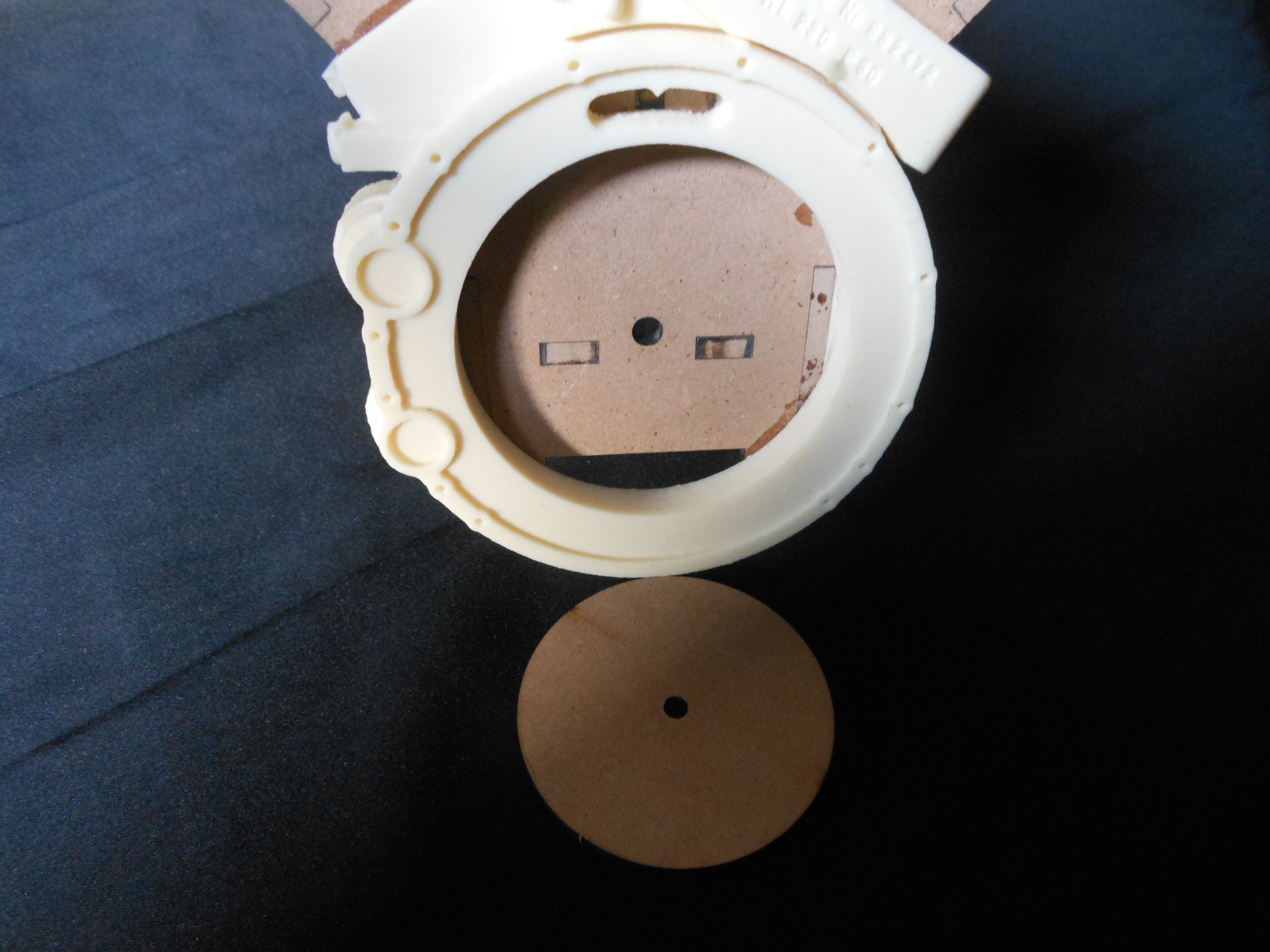

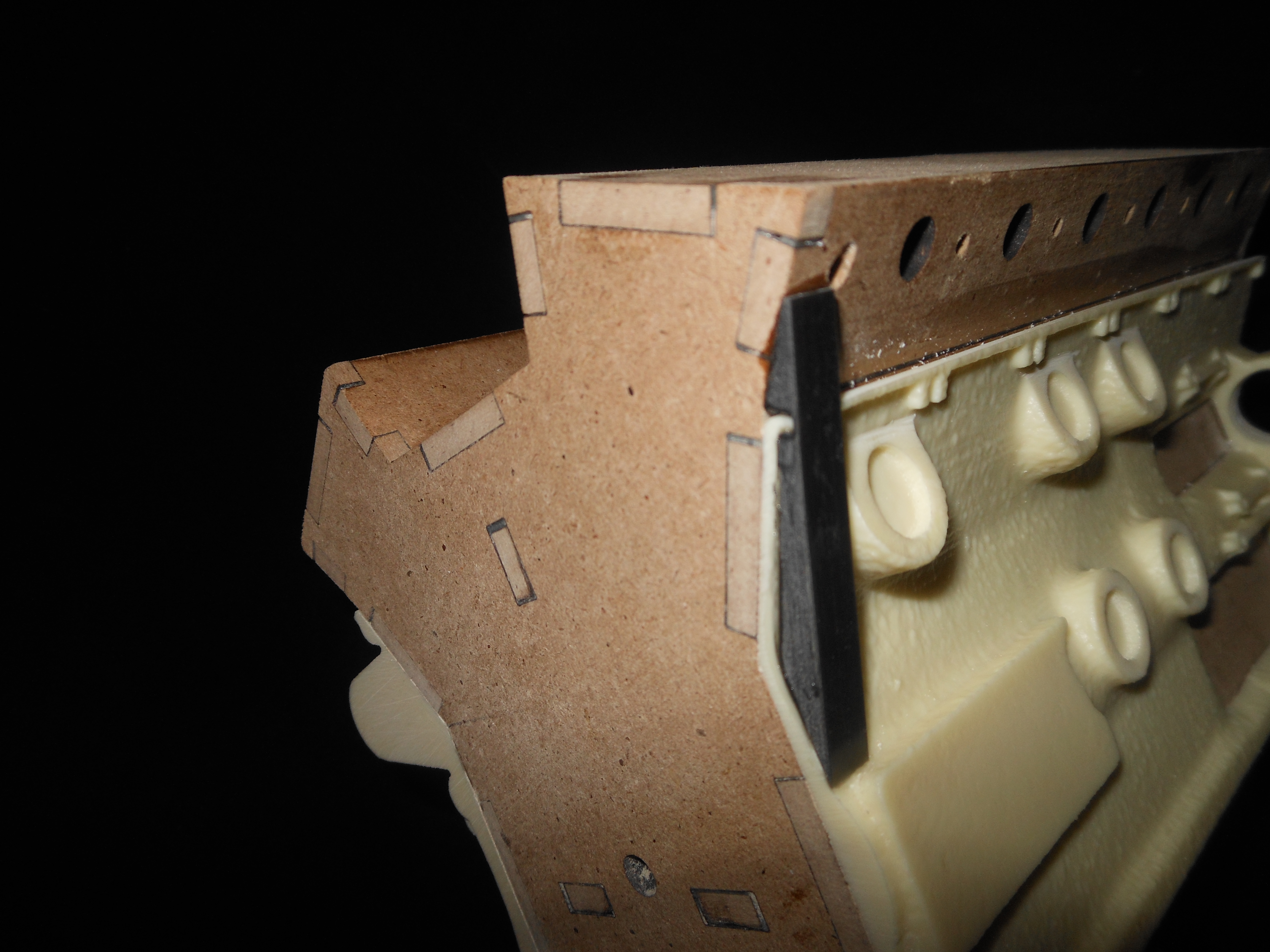

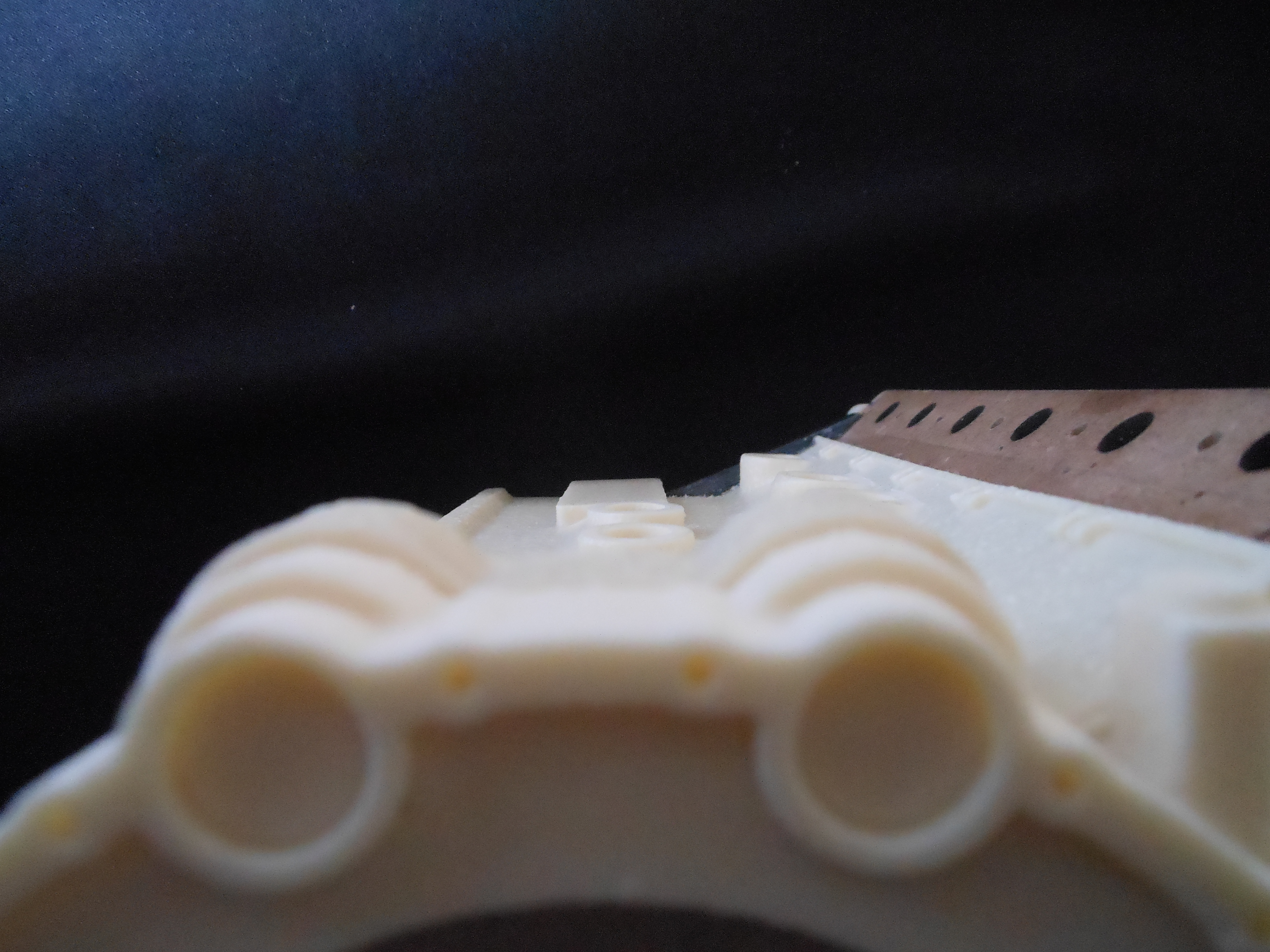

Glued to the skeletonthe rear piece.
I preferred to lower the piece of 2 mm,
however nothing changes

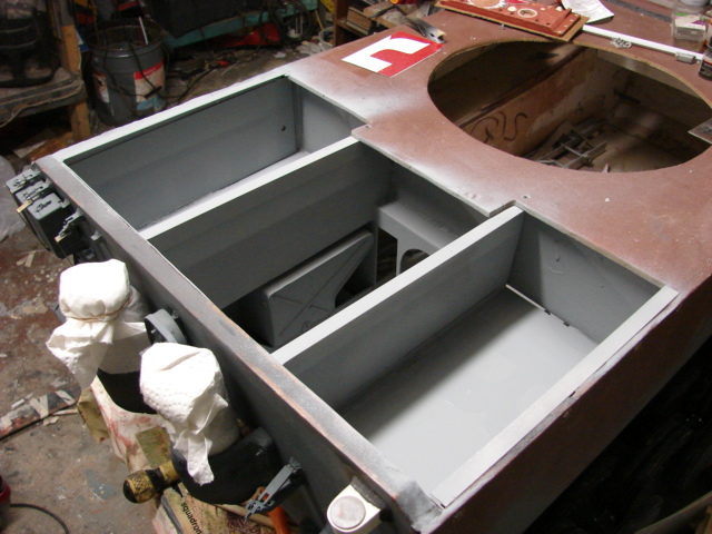

- Posts: 533
- Joined: Wed Jul 29, 2015 10:29 am
- Been liked: 735 times
- Posts: 533
Re: New engine for Tiger1
Hi,
I ask for information:
fuel tanks lower, as were positioned?
With the tips toward the front (as shown Mr.Grima F.O.A.)
I saw the pictures and I think one forward (right side) and back (left side)
You have information?
Thank you Ivano
Thank you Ivano
