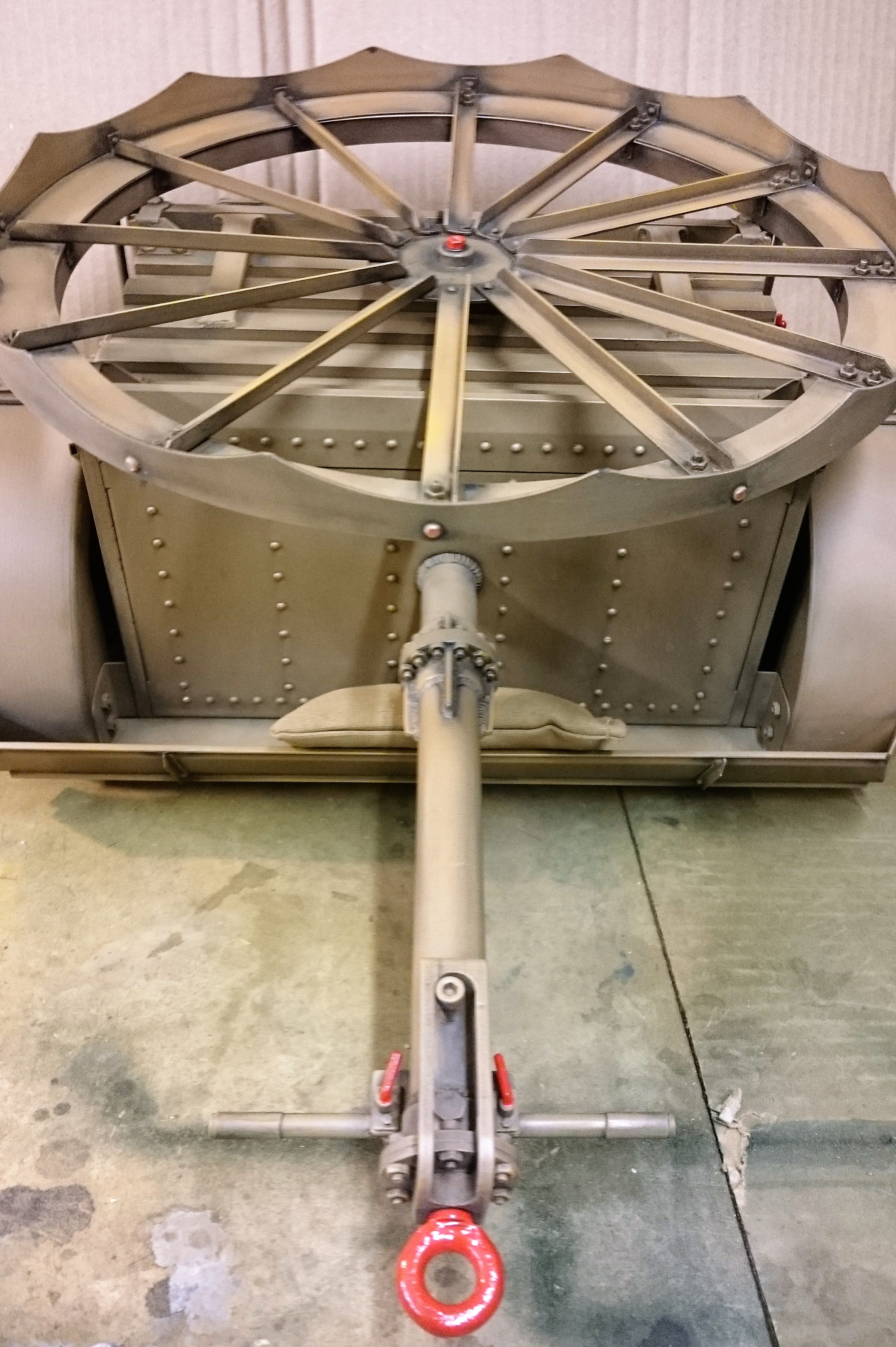

And now to the gun. This kit has the improved tapered axle.
I will let you make your own minds up on the wash technique, It's not as easy as it sounds but with some perseverance it's a very useful method indeed in what ever scale.
It's all still very clean for my liking but chipping and buff dust here and there over a period of time will further enhance the Holy trinity.

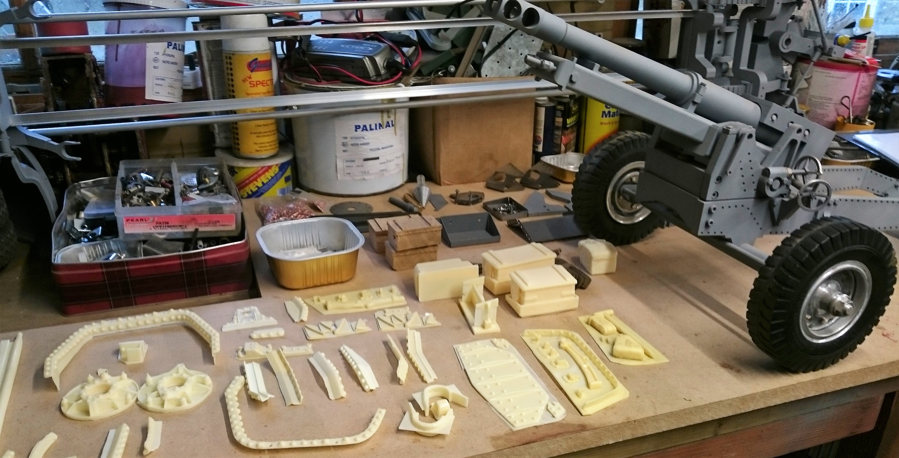

Made a flying start on the 25, lots of Armorpax parts to fit.

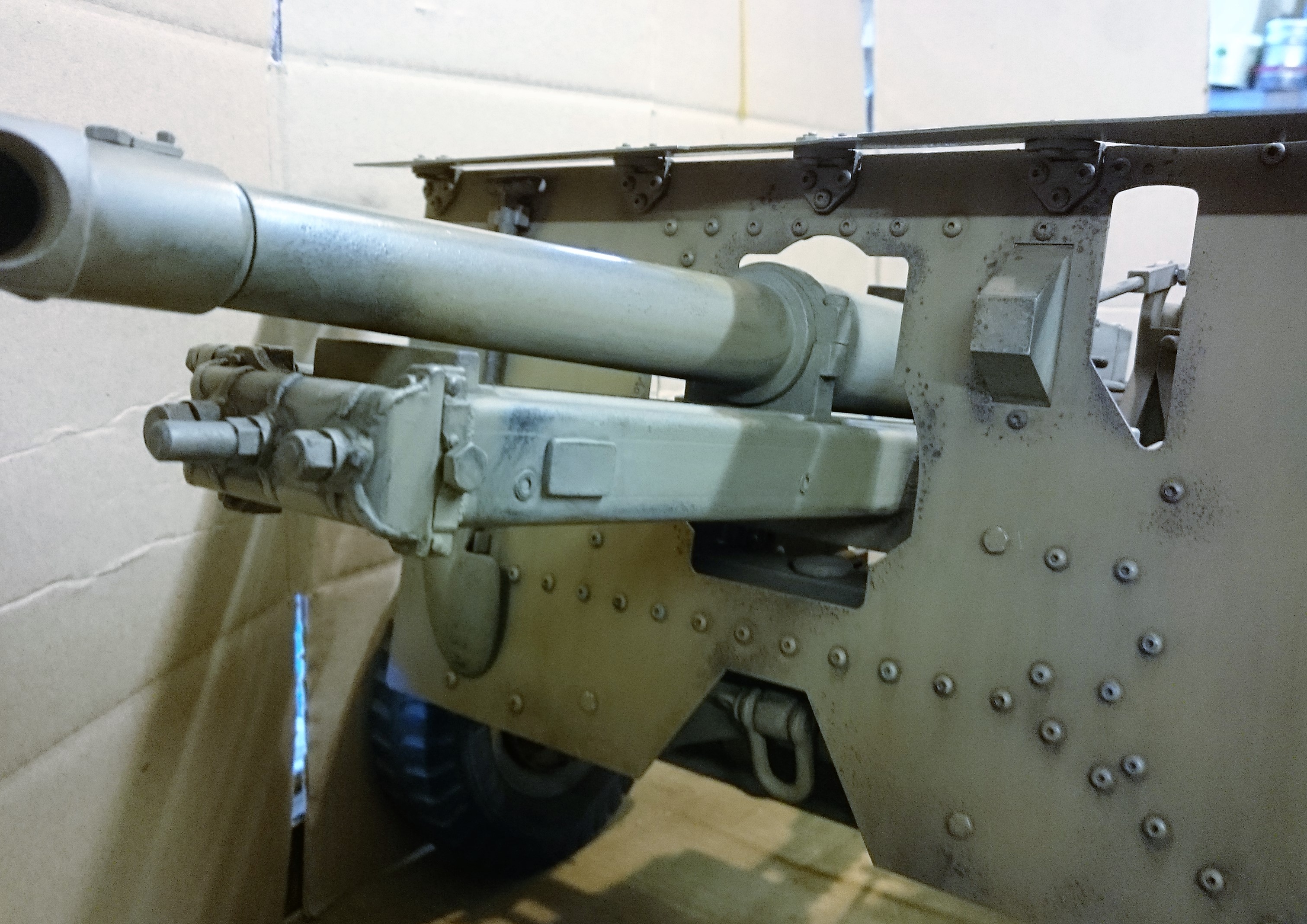

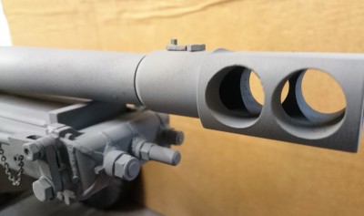

Been sorting the traversing and elevation gears, they need considerable fettling for them to operate smoothly.

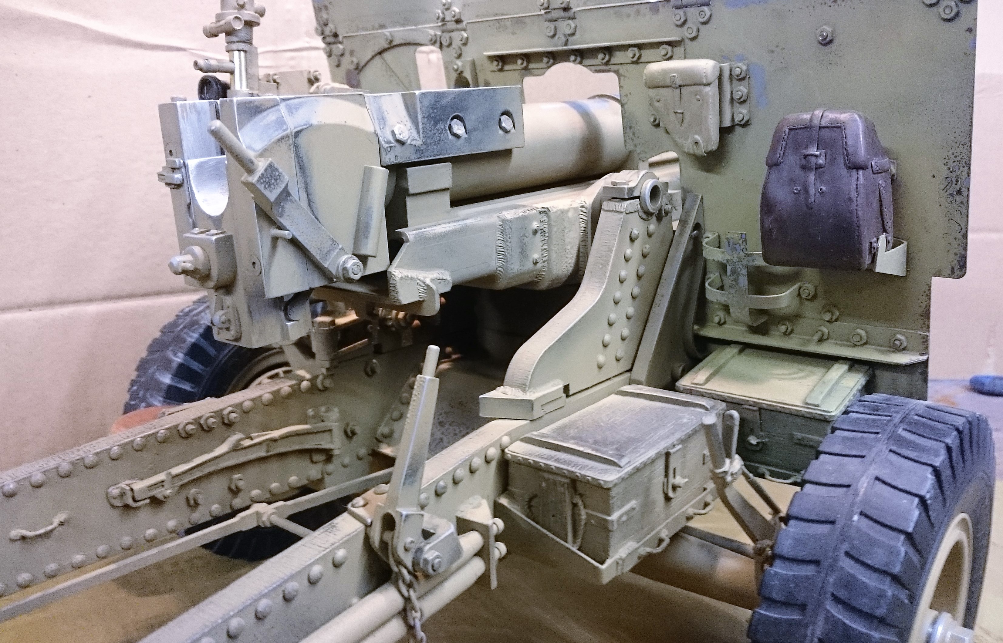

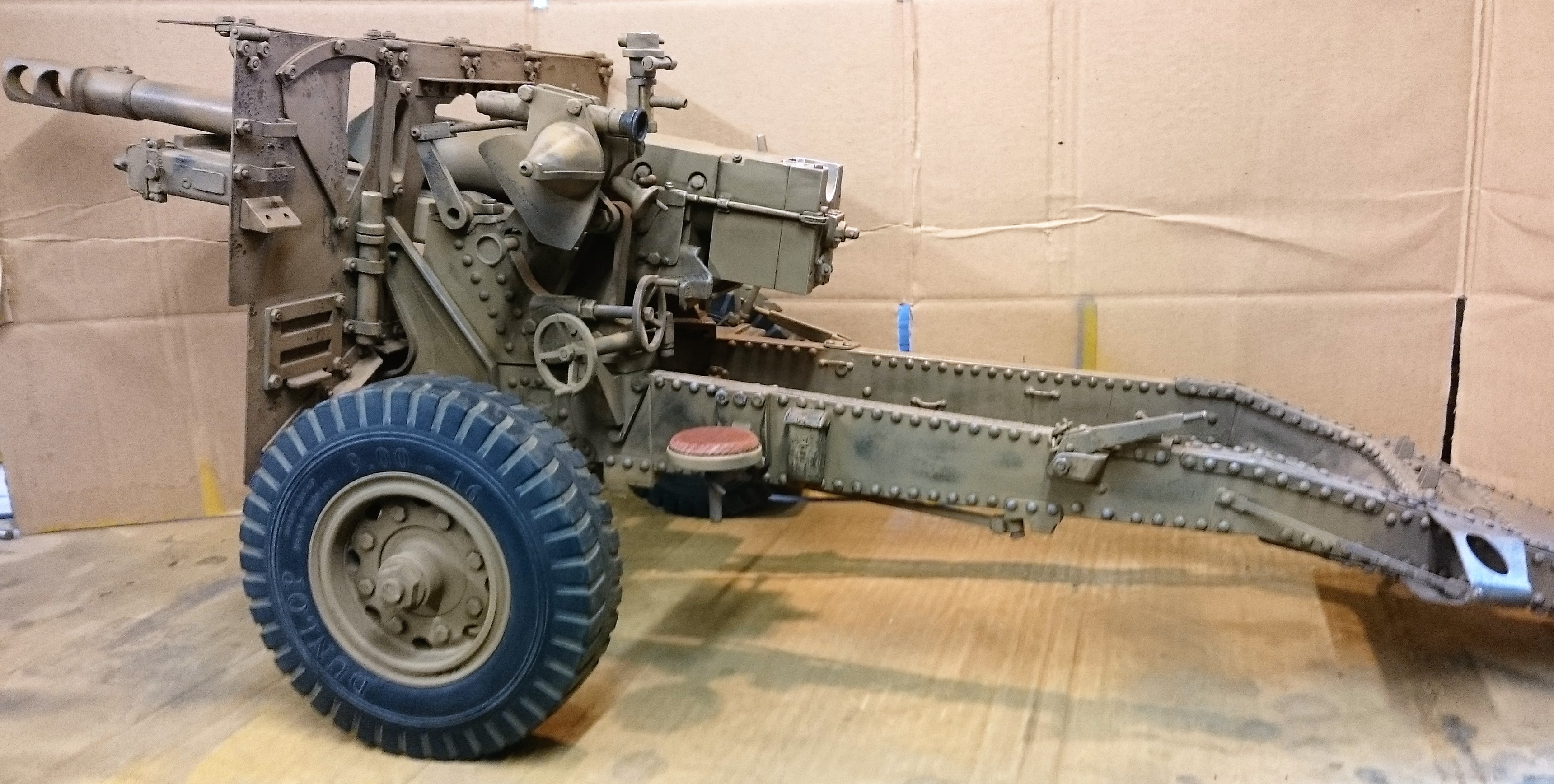

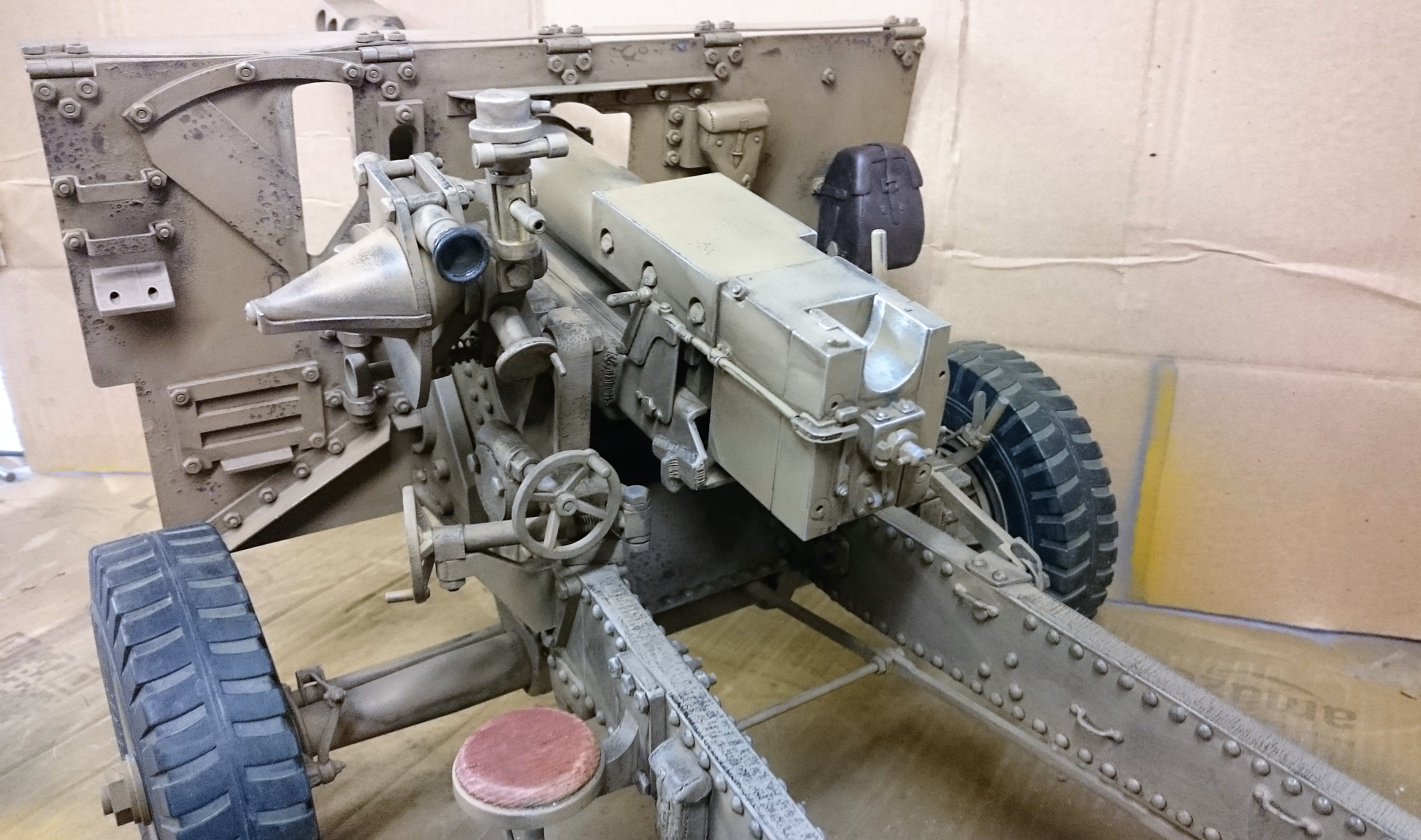

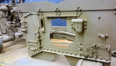

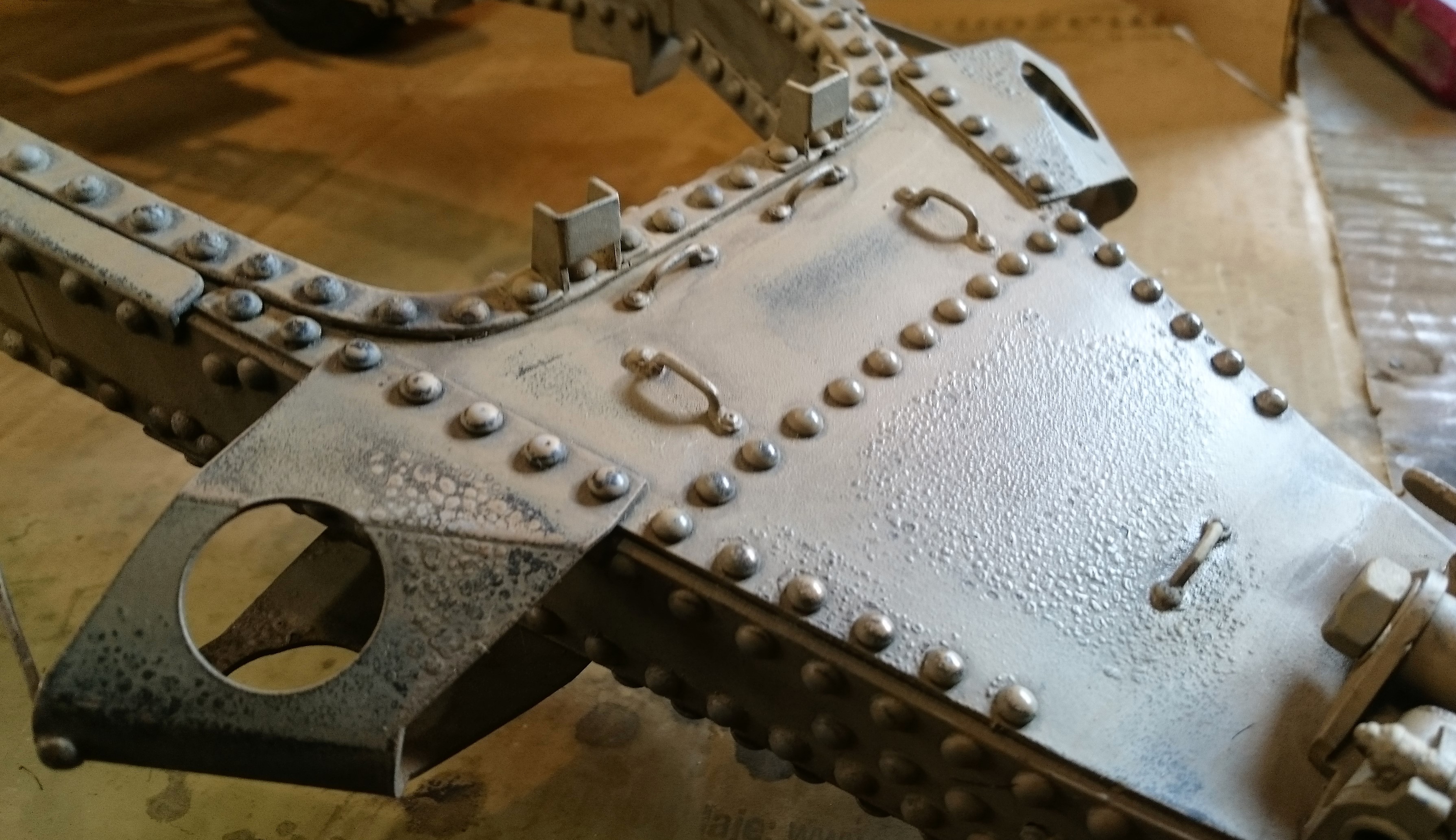

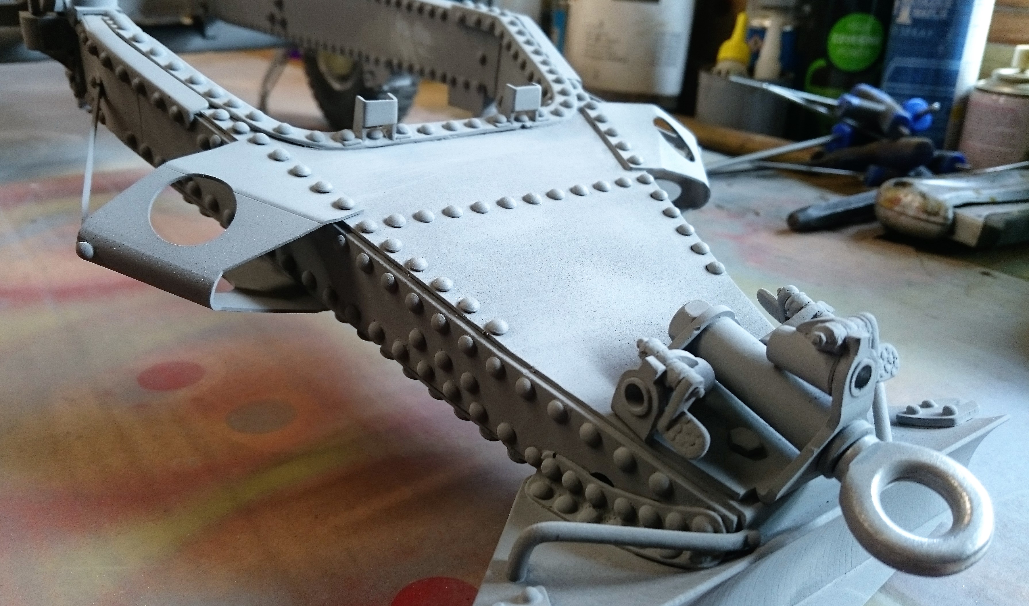

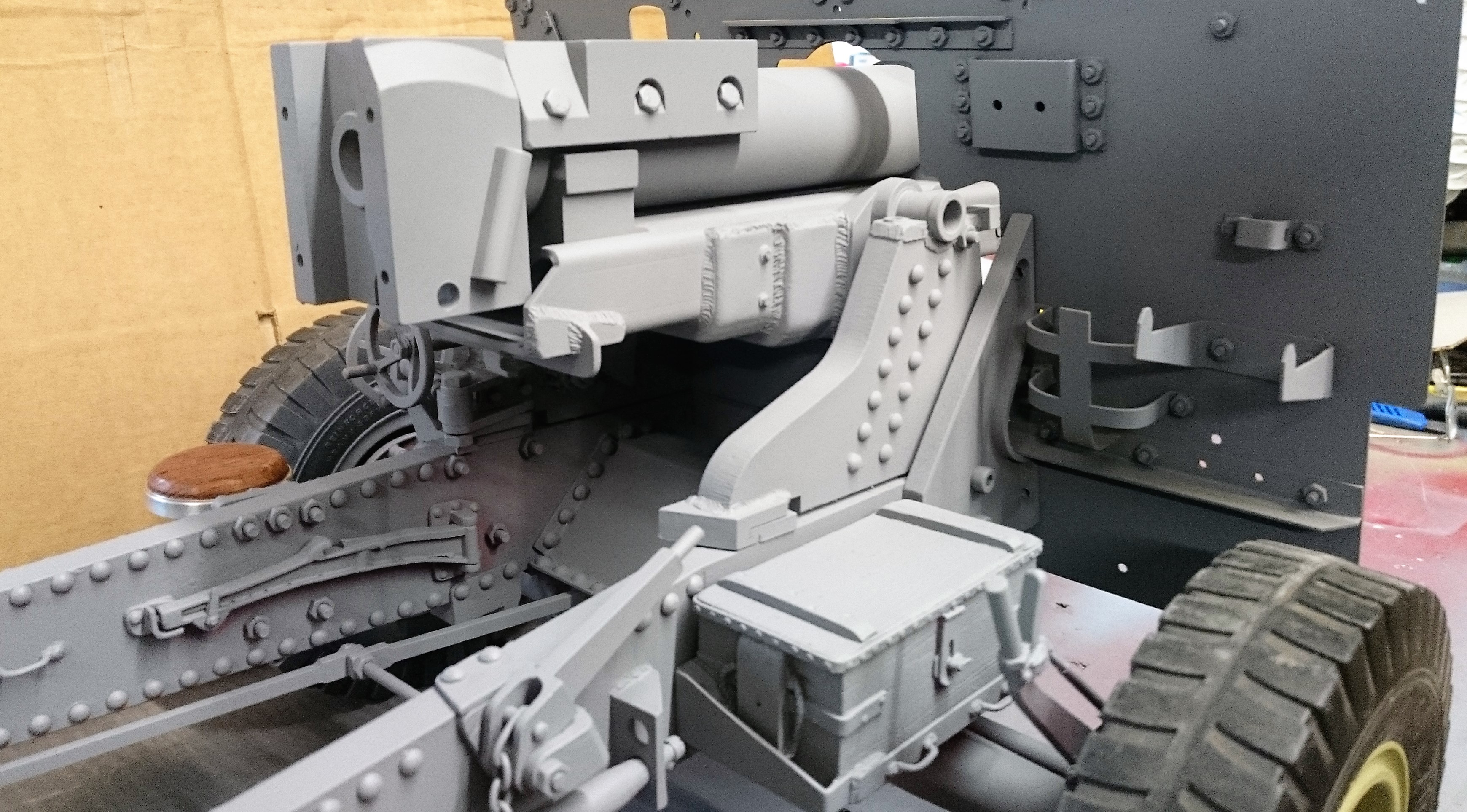

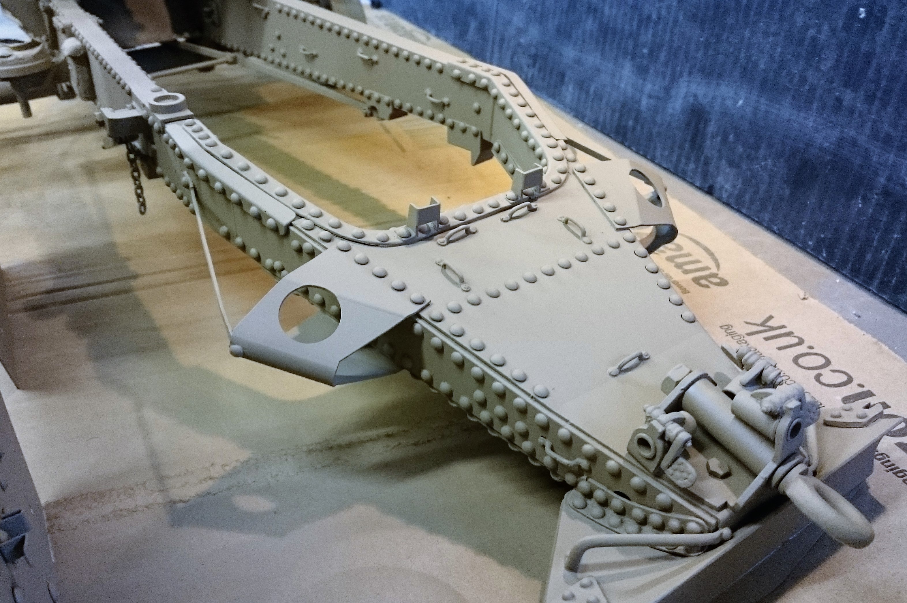

Some progress with the 25 pounder, I've been adding some of Dave's detail parts and checking the finish/build quality with the second primer undercoat.
If you don't like adding rivet detail then it's not for you!
Boy those rivets are the dogs dangly bits.
That's my fume extractor in the background. Which means I can crank the temperature up and spray and glue to my hearts content what ever the weather and time of the year.
It's fiddly work adding the brake assemblies but well worth the effort.

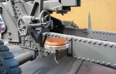

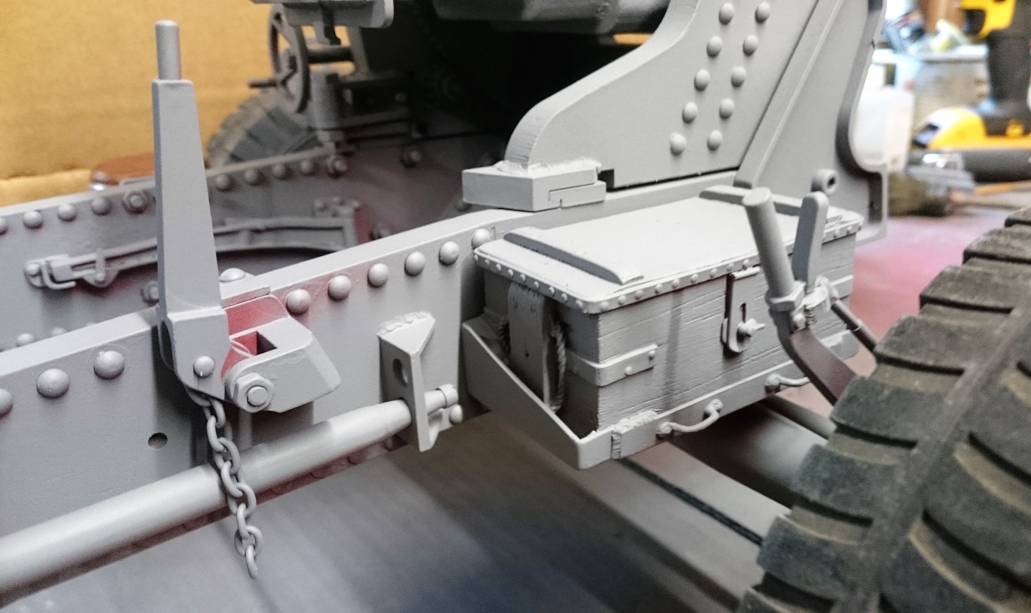

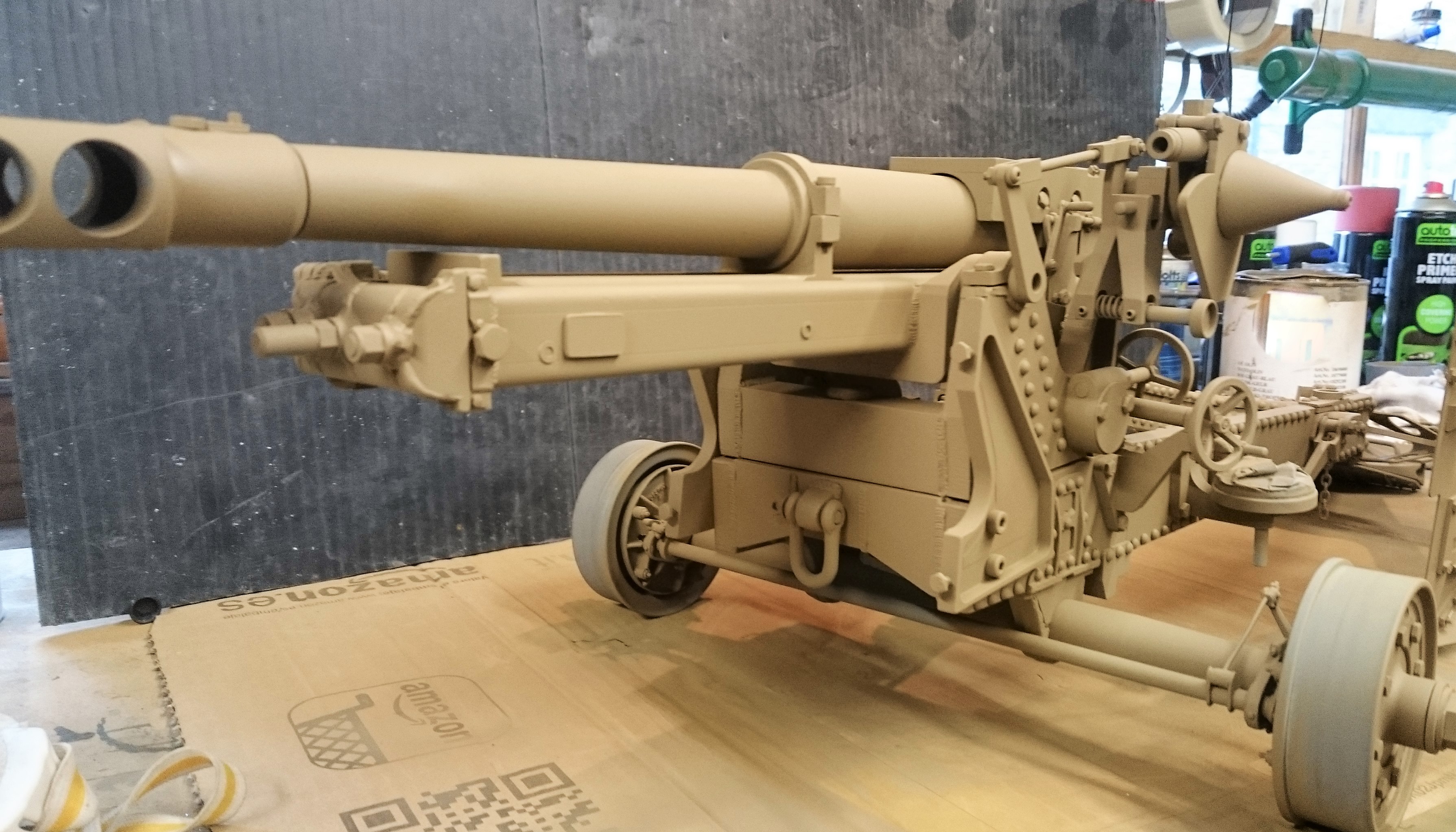

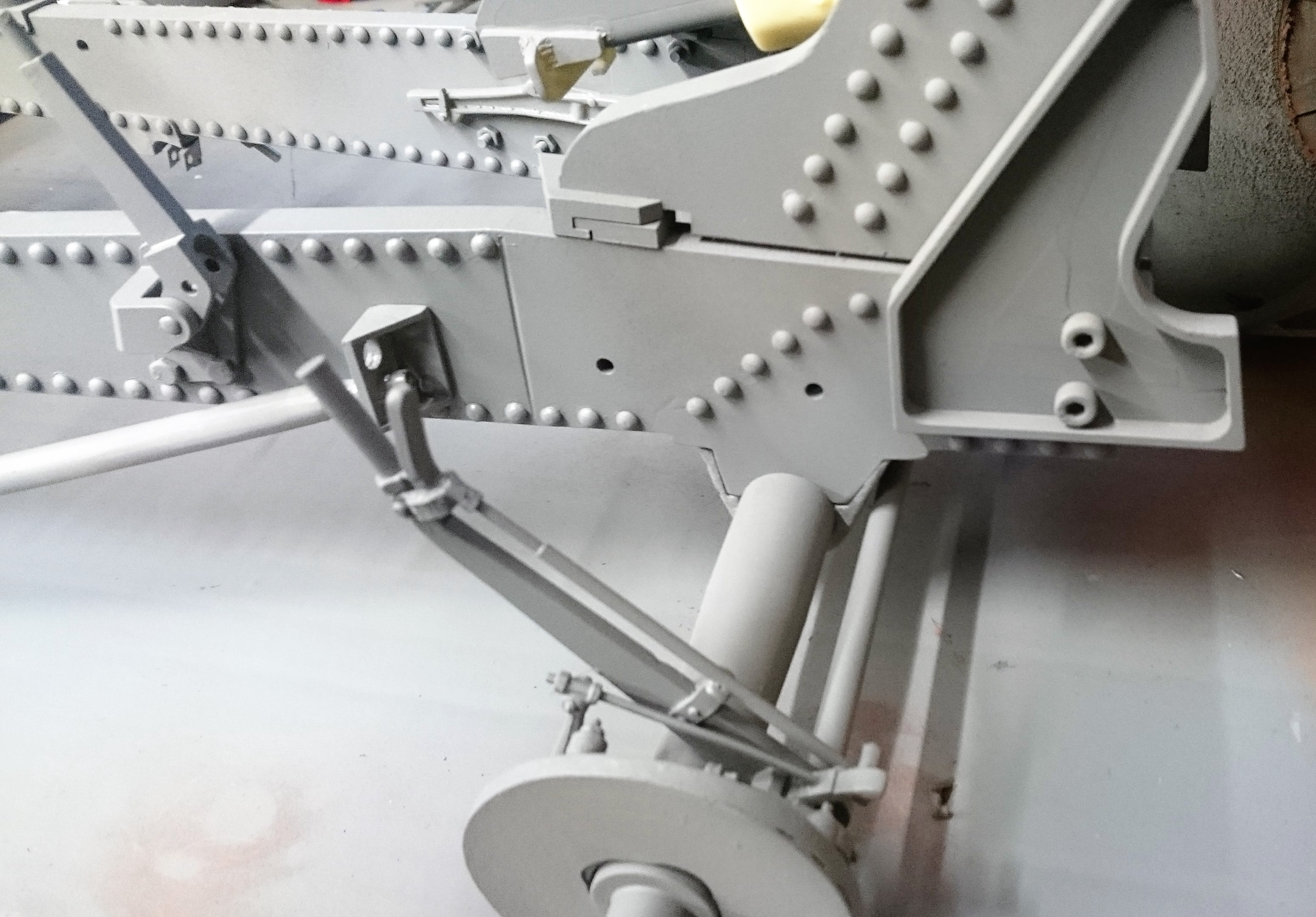

Some more progress with the 25 pounder. I have kept the 25 pounder in the Quad thread for continuity.

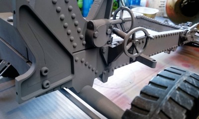

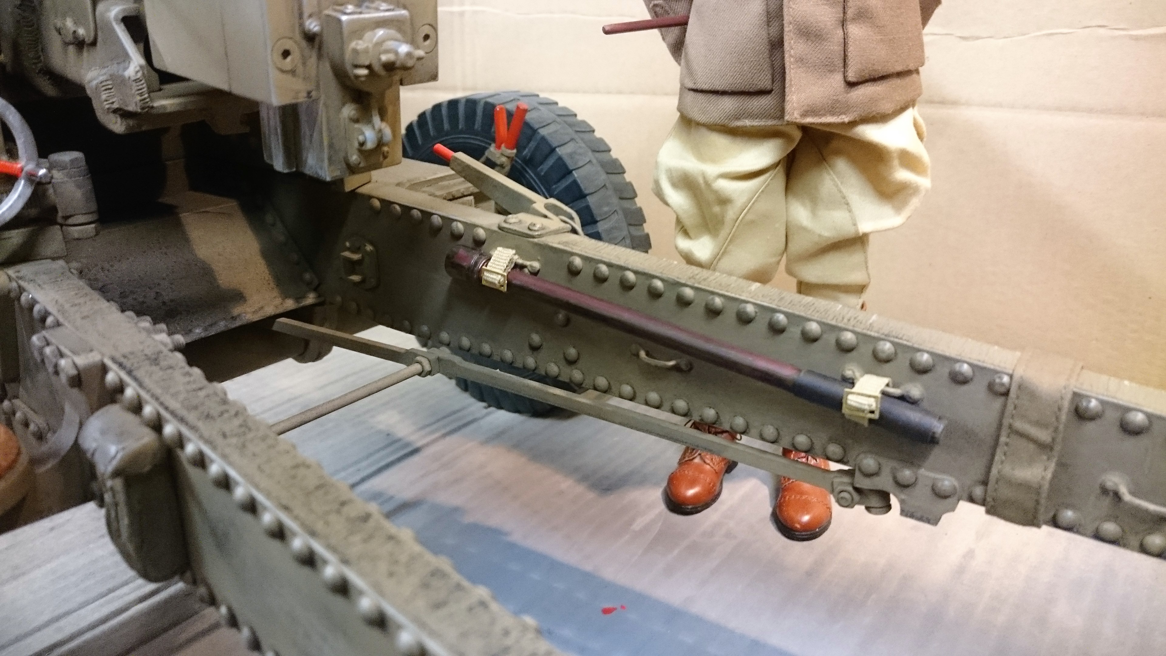

I have turned the traversing ring transit leavers around and made new brackets.
I think I have added all the weld beads
I used the Muckleburgh example as reference for the recoil front assembly.

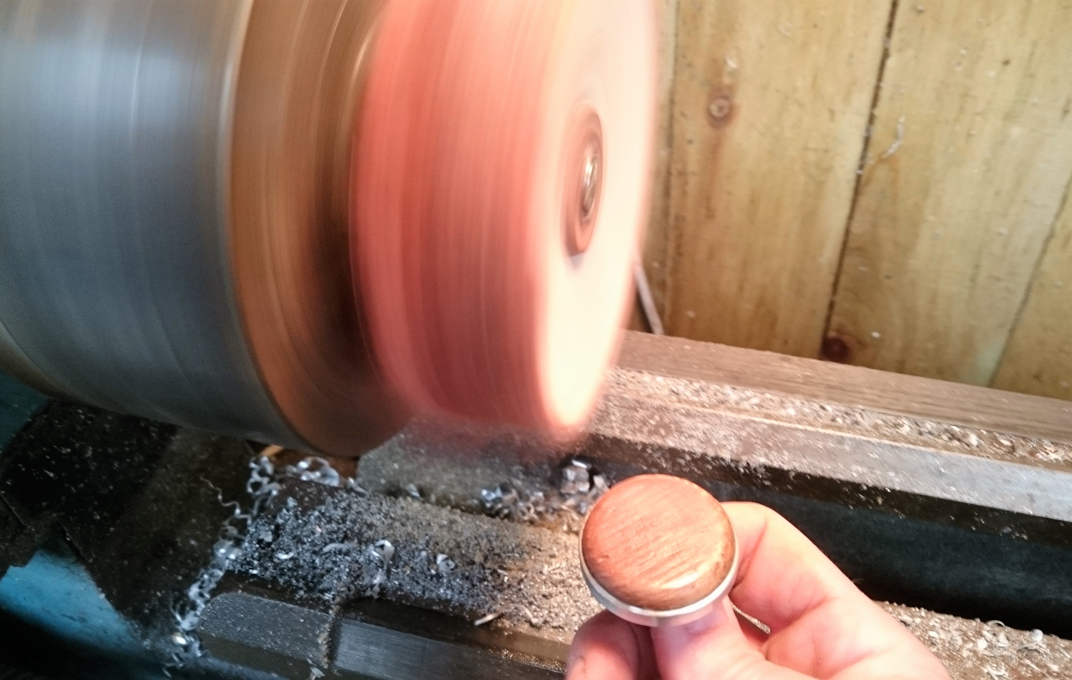

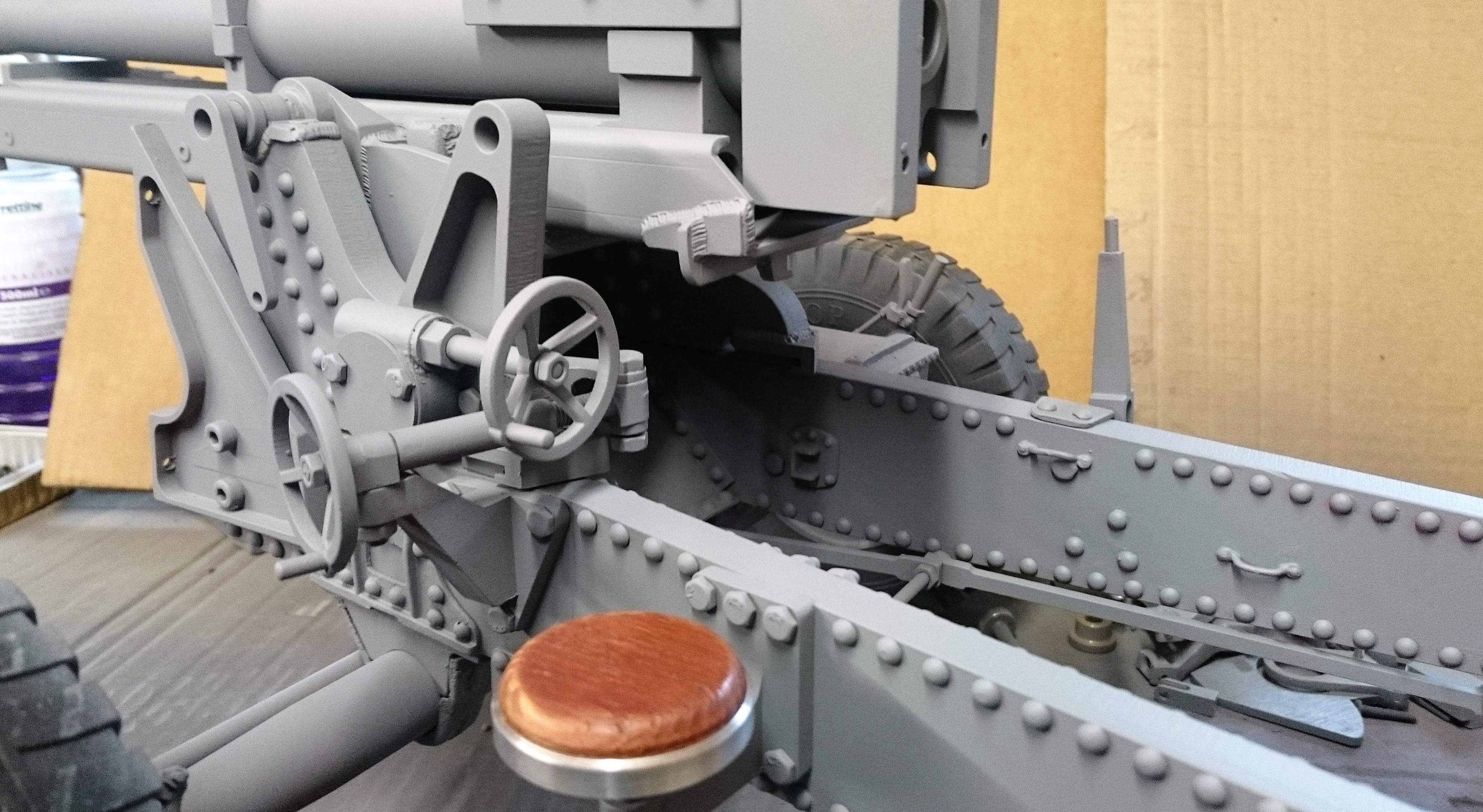

Thought I better make a nice wooden seat for the little guys behind
So a piece of timber glued to the ali seat post and then turned to shape
Some wood dye and a heavy buffing and it's not far off the original.
Oh and it's adjustable. Looking at the base now I think I will turn it down a tad as looks far to thick.

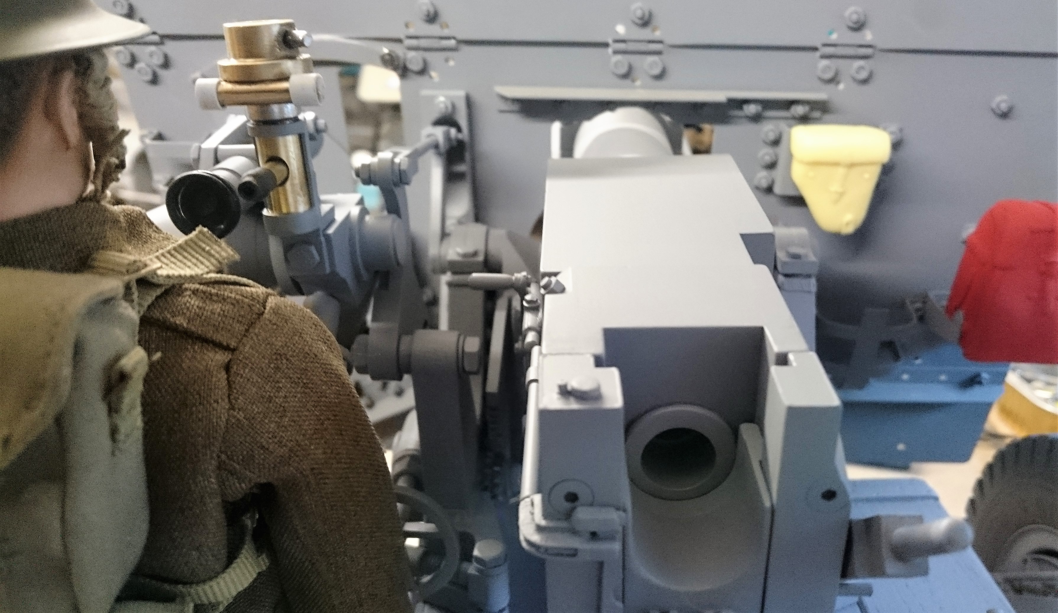

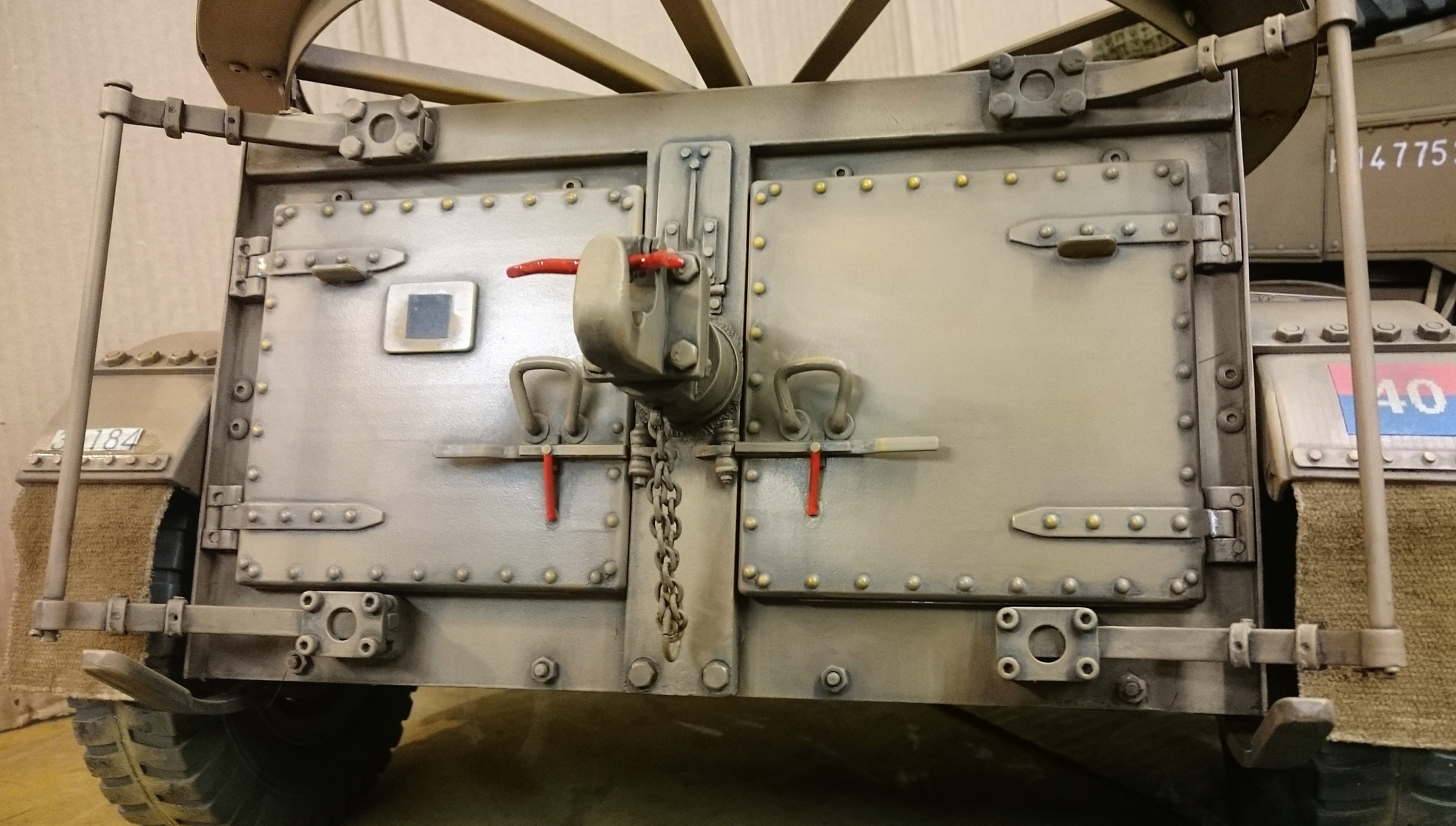

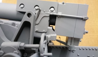

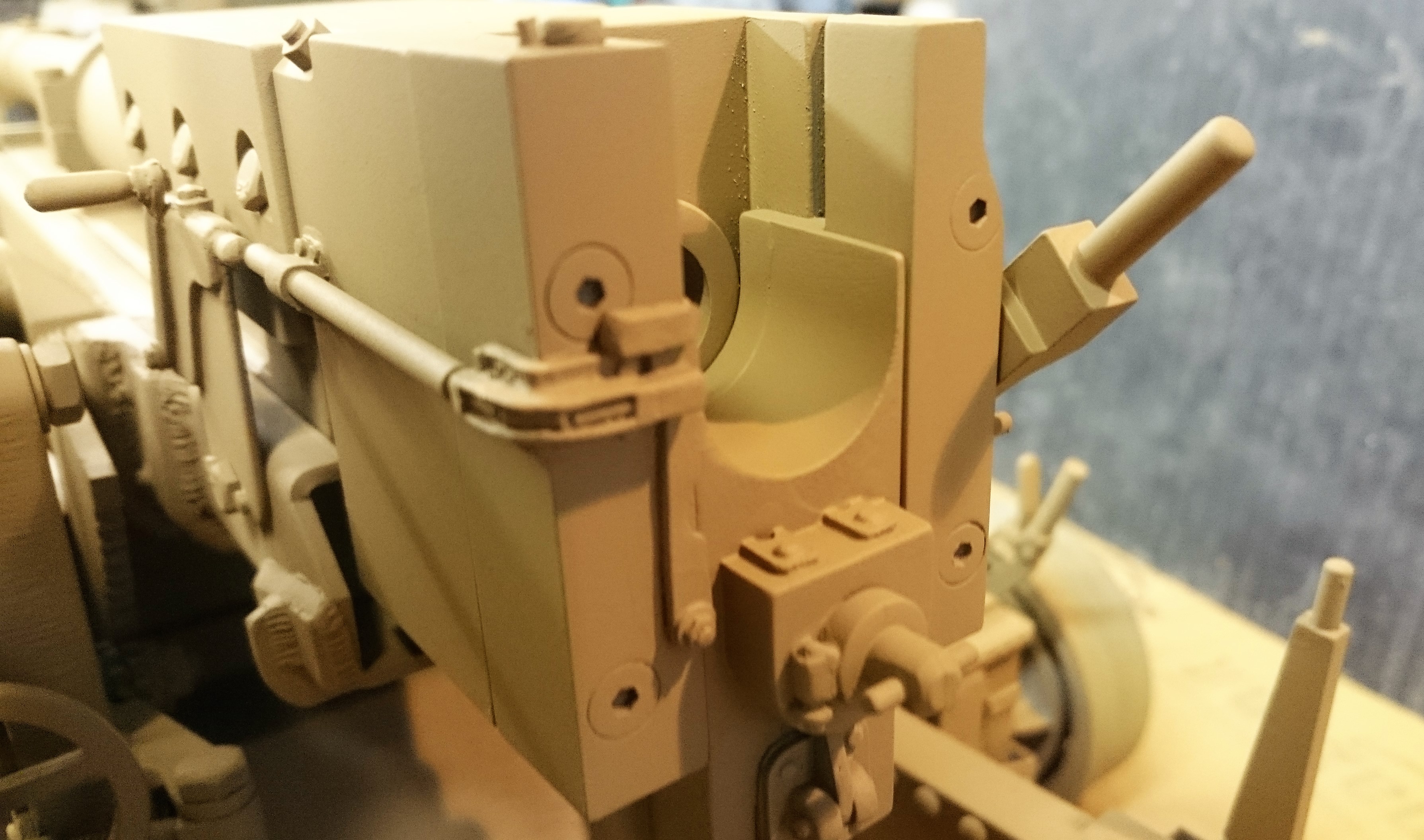

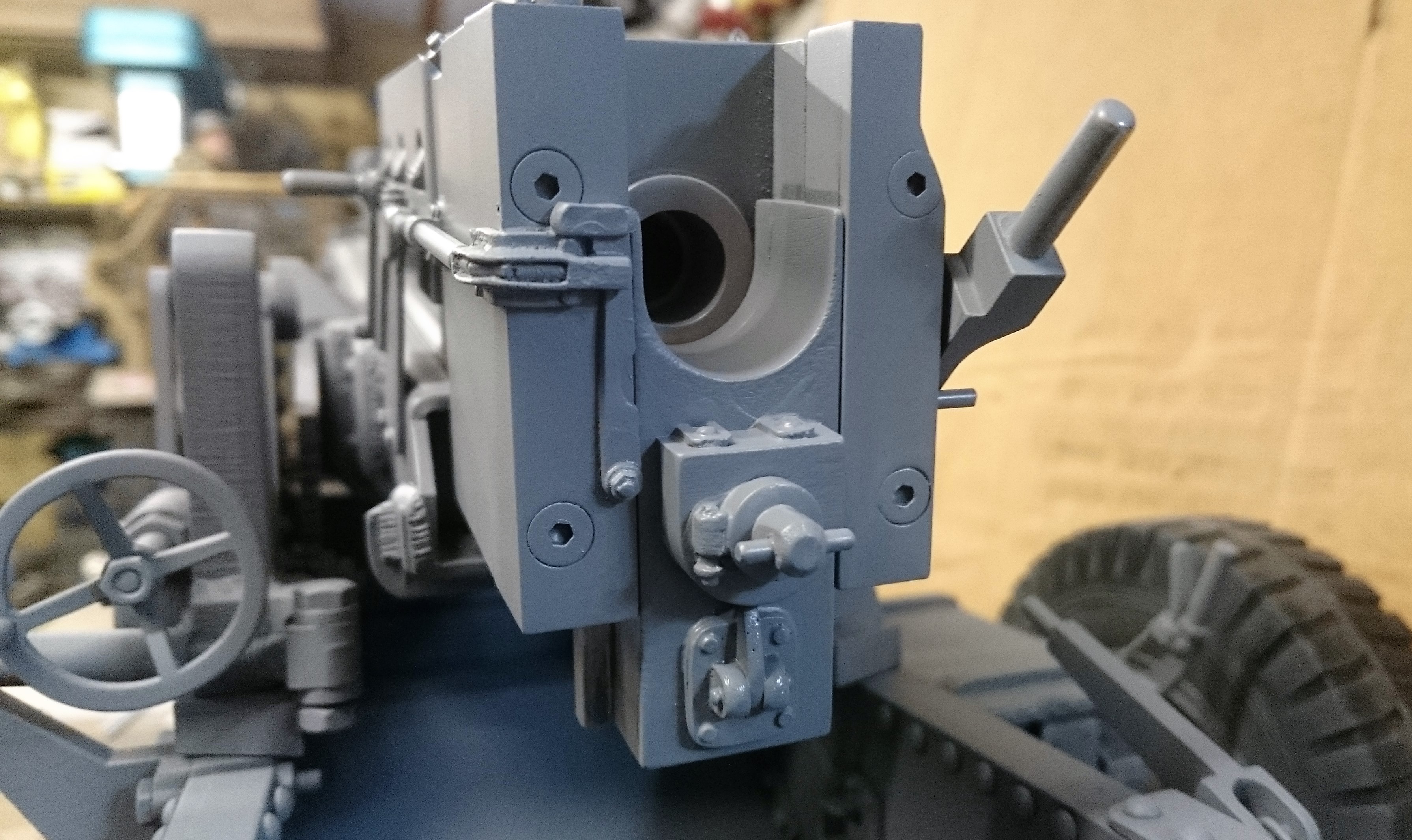

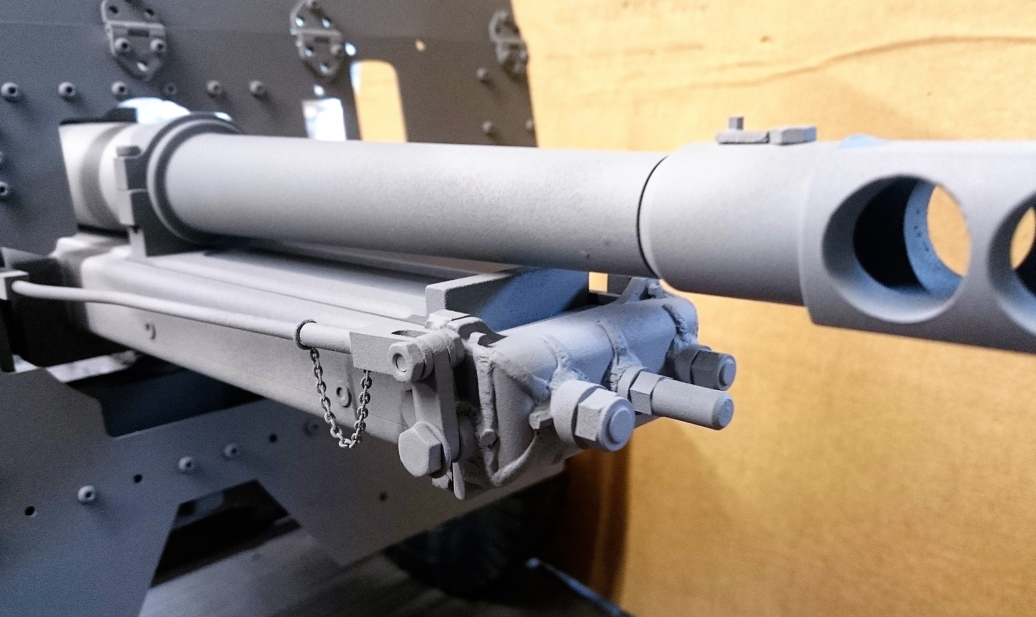

The first of the breech detail.
Dave sent me ID plate for the Limber.
I would like to hide, by filling the m3 countersunk screws in the breech but they may be needed for maintenance.

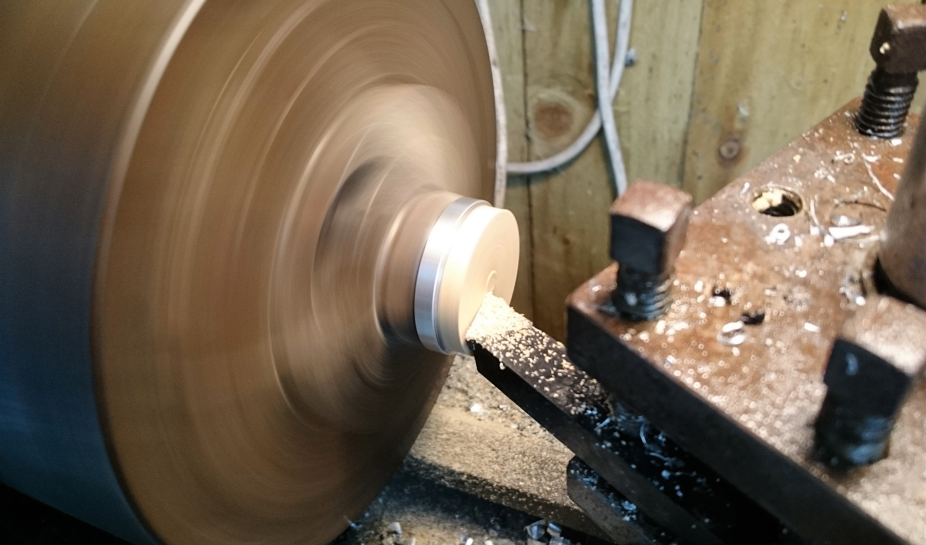

I will be machining the Armortek breech to accept the Armorpax shells of which I have many for the sunny diorama planned for the good weather lol.

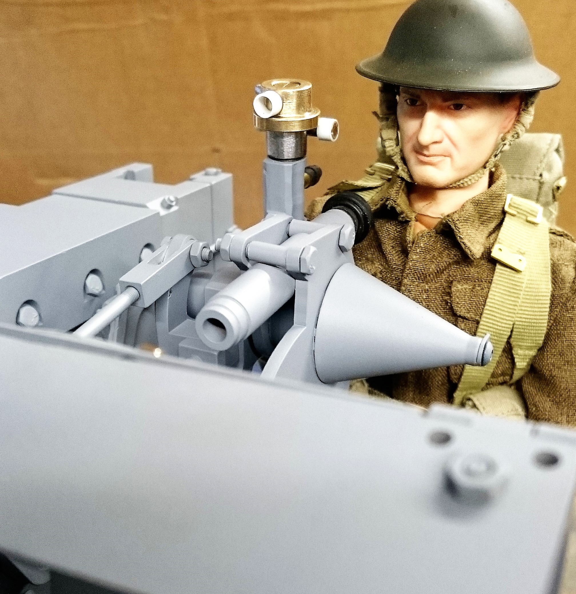

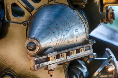

Made a little, I think it's called "Dial sight number 9".

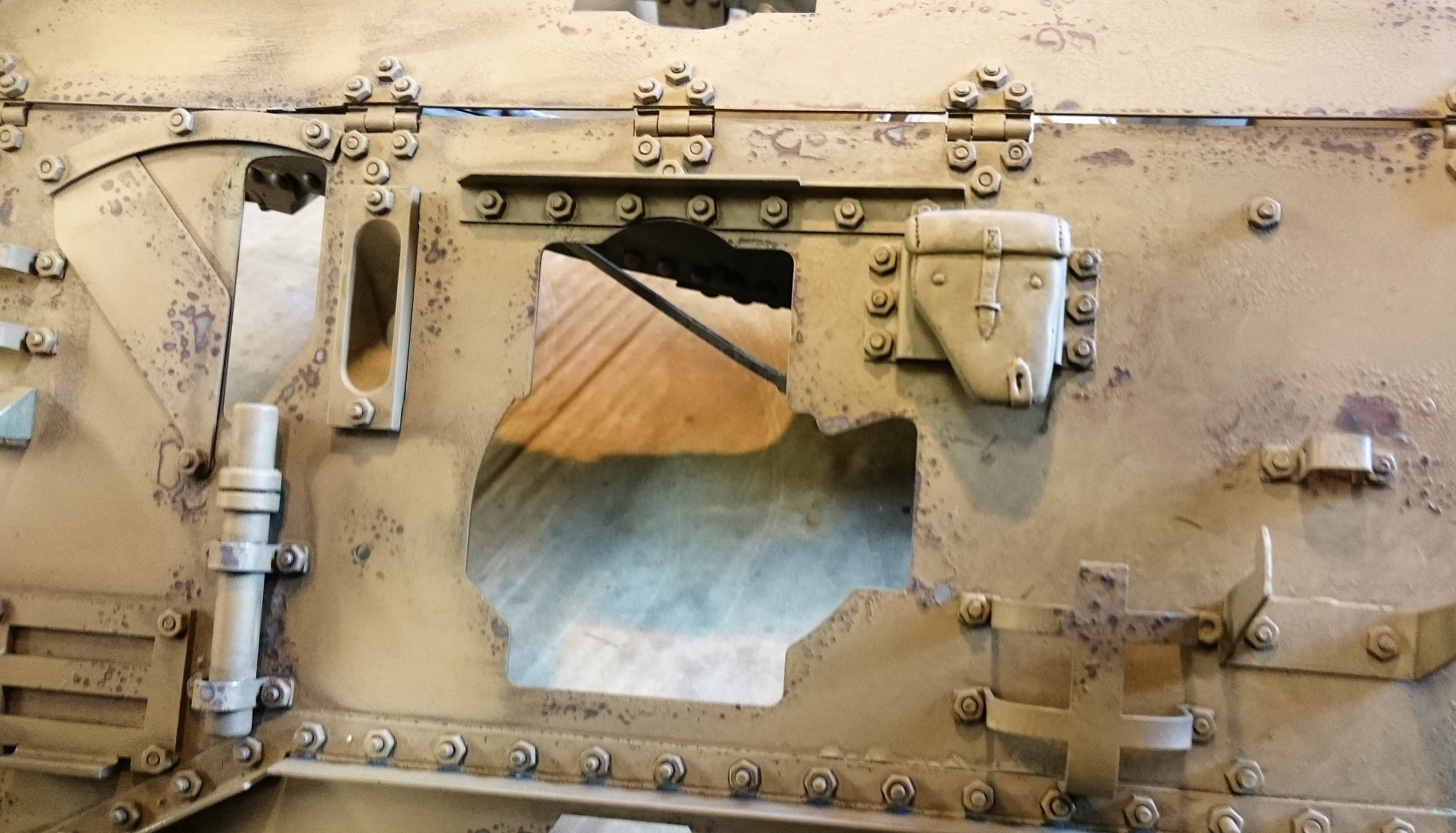

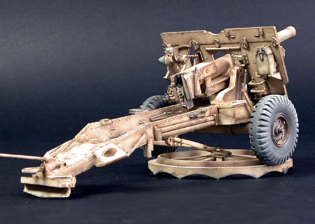

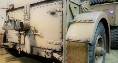

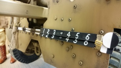

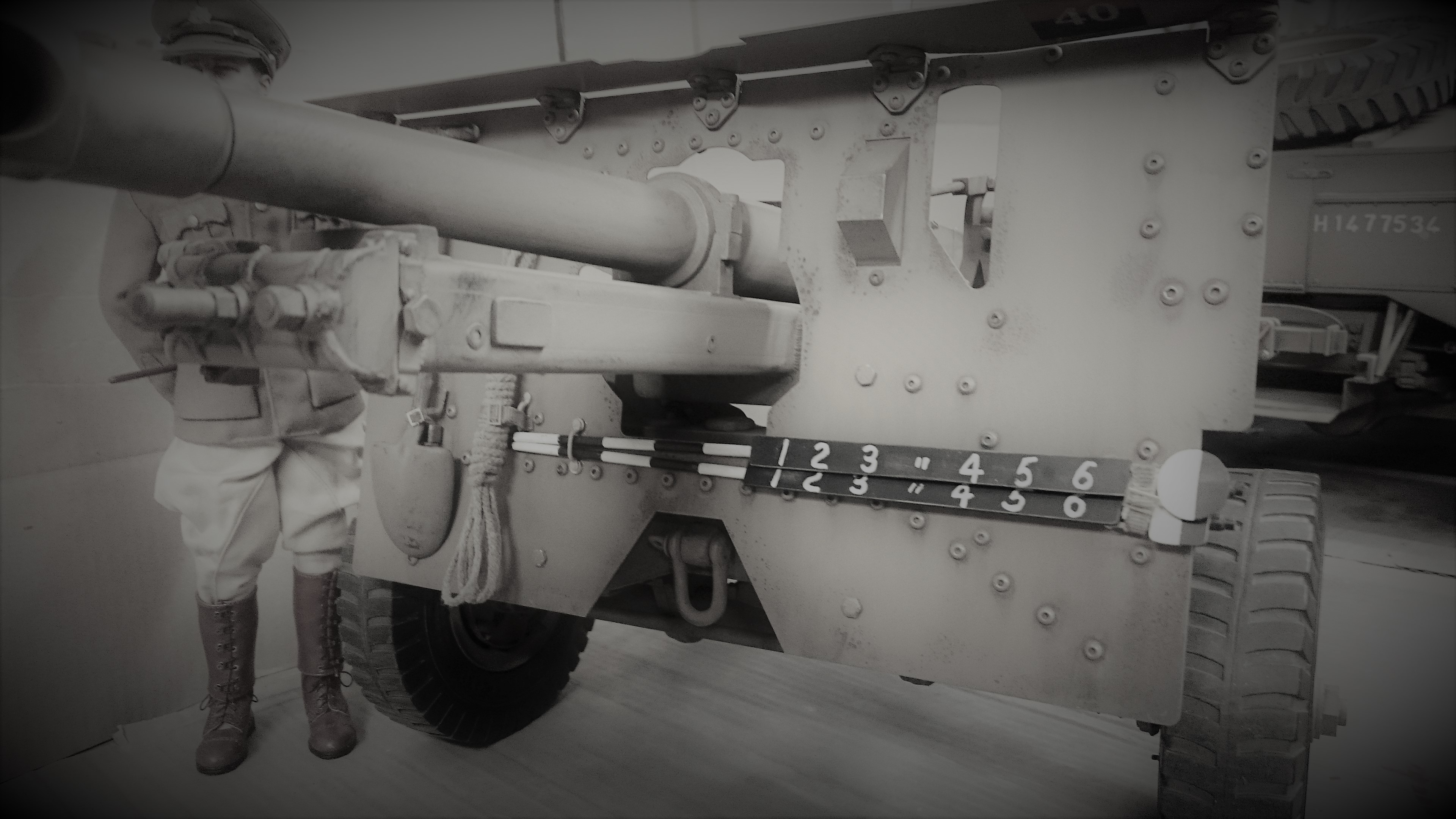

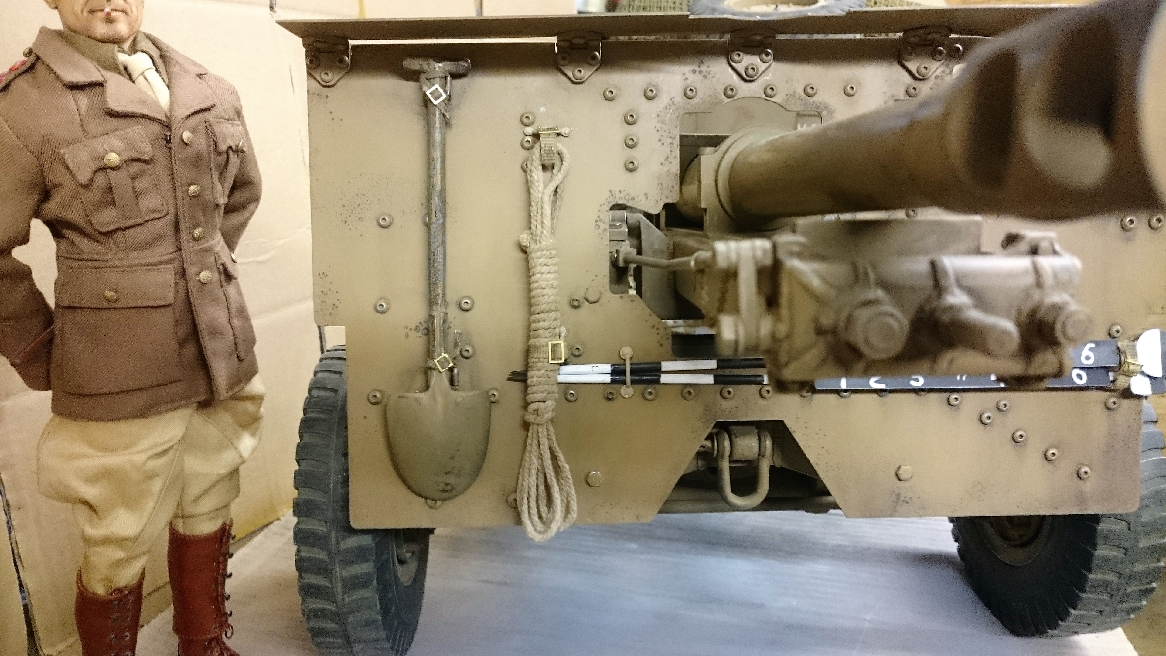

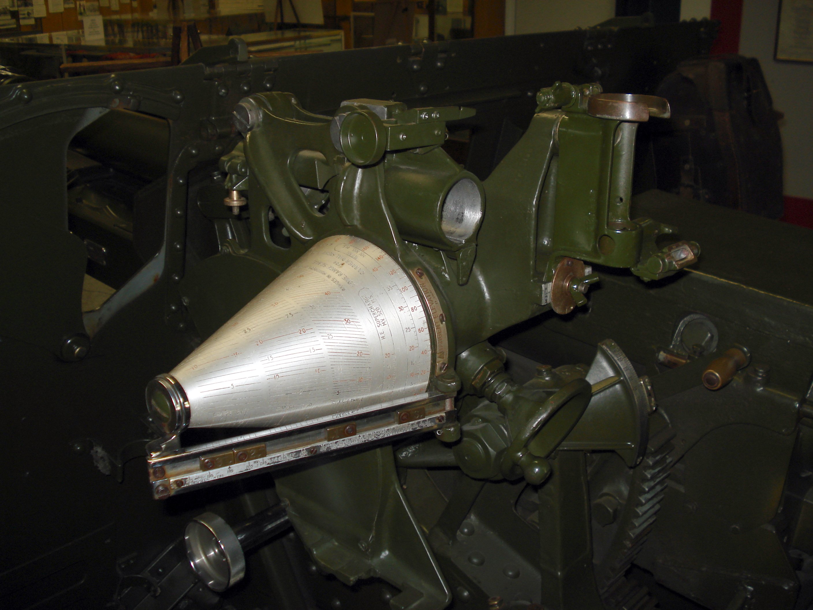

First of the top coats is applied, and some nice 25 pounders examples for reference.
The history of the 25 Pounder is fascinating, it's probably the most successful and the most famous gun ever produced, despite having a 2 part shell and case round, the gun crew would often fire around 300 rnds in a day (that's per gun). The Axis troops coming under fire from a Battery of 25 pounders, really believed that the gun had an automatic loading system.
Note the weathering on the frame, the underlying green is showing through nicely, it's very similar to  Axis weathering, although Allied paint/painting was of good quality it to would wear away in exposed areas.
The ranging cone, I would like to add a lot more detail to this area.
There's a long way to go with this complex piece, it has lots of hard to get to areas.

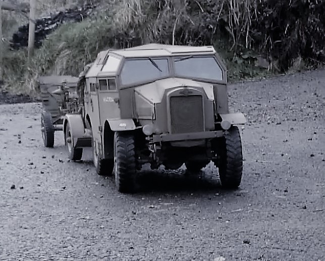

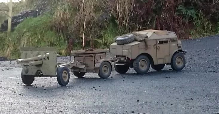

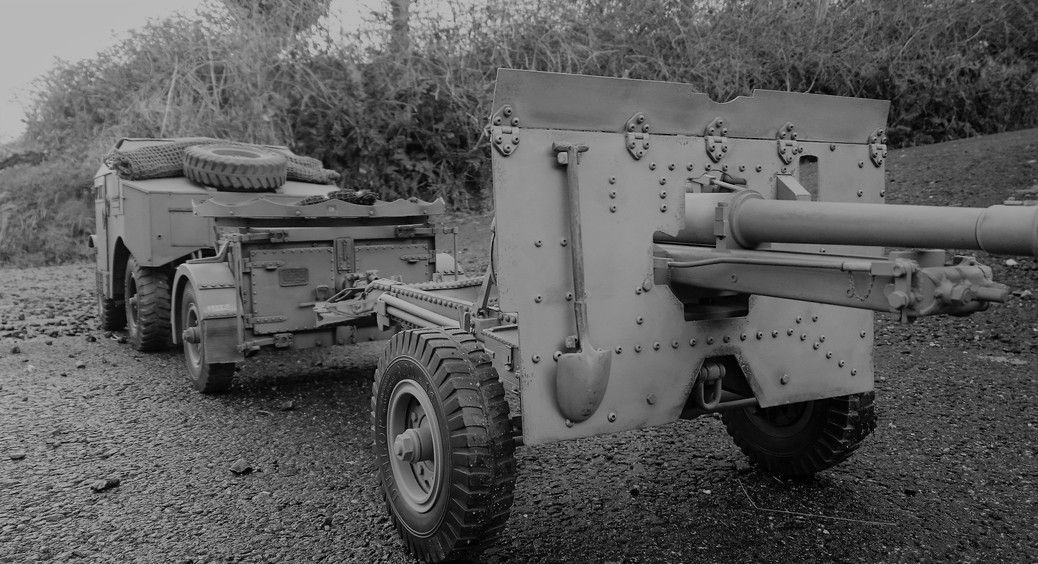

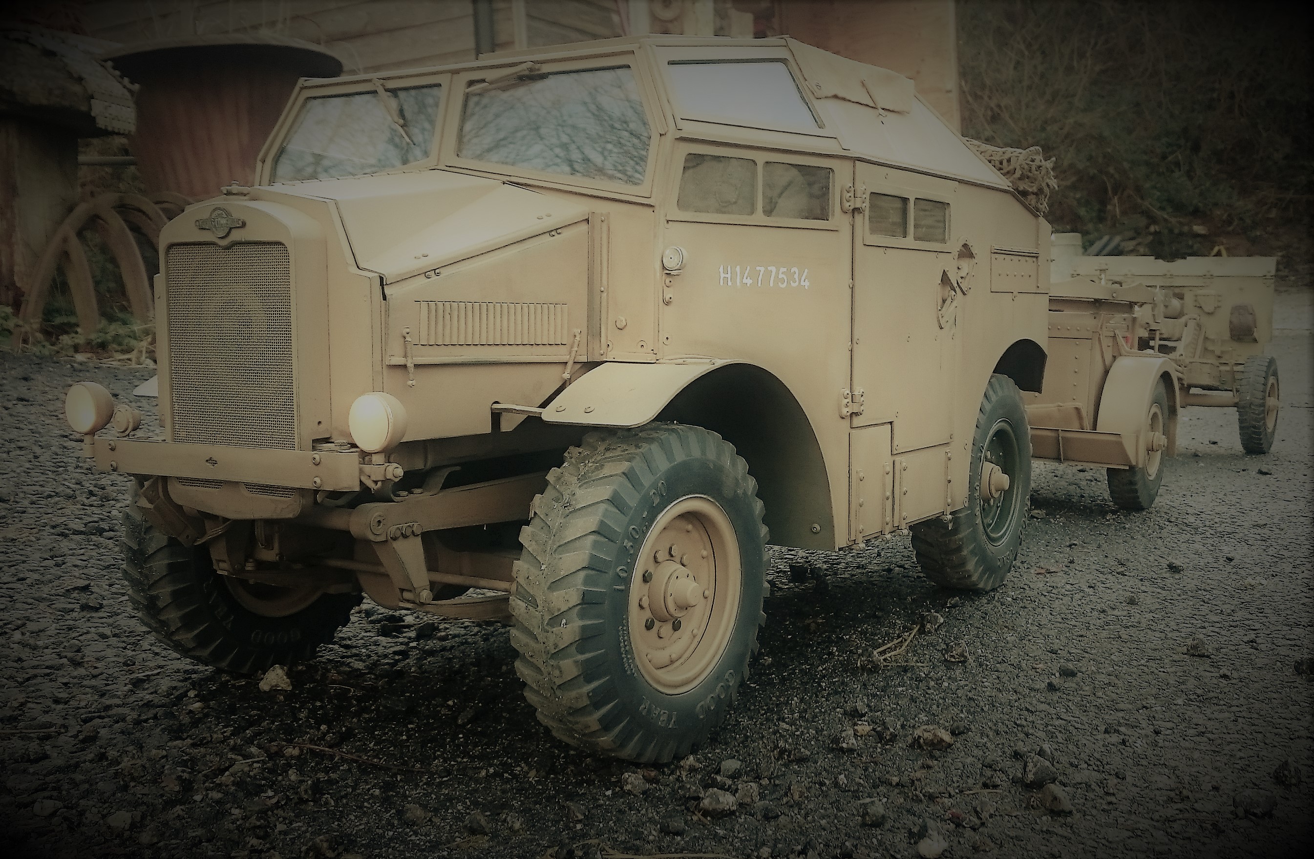

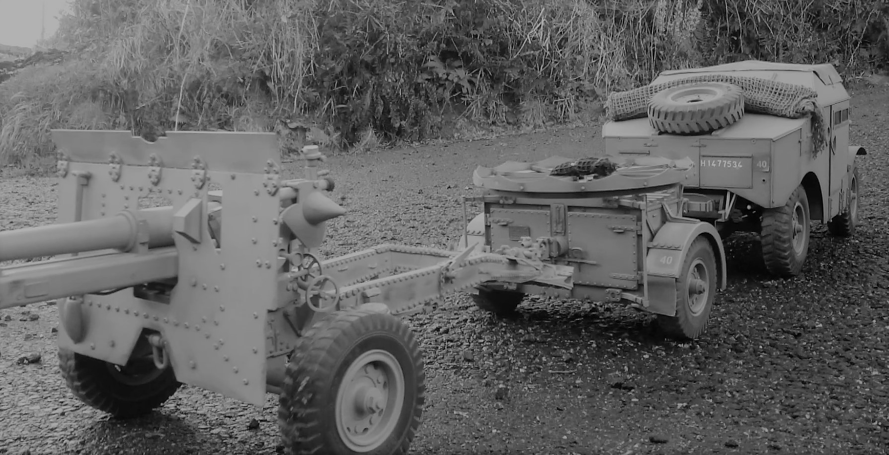

As the sun was out for about 5 mins. The first proving trials to make sure it's all working ok, and the Quad performs faultlessly. I was a bit worried about the power to weight ratio but she's just fine pulling up the steep hill no problem, there's loads of torque and if anything possibly a bit to much available speed. Now back to finishing the gun and tweaking the detail here and there.
Has liked: 1038 times
Re: Me Quad.
Lovely job Phil, well done. The only thing which spoils the illusion of reality is the tyre inflation. Wouldn’t it be great to be able to simulate the weight on wheels deforming the tyres? Easy to do on a static models but not easy for a durable set of running tyres. I suppose you could mould them in a much softer material but that would reduce durability. Any ideas? Thanks for posting your build, not enough on the Forum. Stephen
Re: Me Quad.
Well it's only a look see photo shoot Stephen but a good observation all the same, when I have finished the Holy Trinity (these things are never finished) and I shoot some proper video I planned to use dry sand under the wheels as this looks so much more realistic, also soft mud is good but not Long Grass as this looks pants! The Tarmac in these photos it far to flat and hard.
It's all good wholesome stuff......Phil.

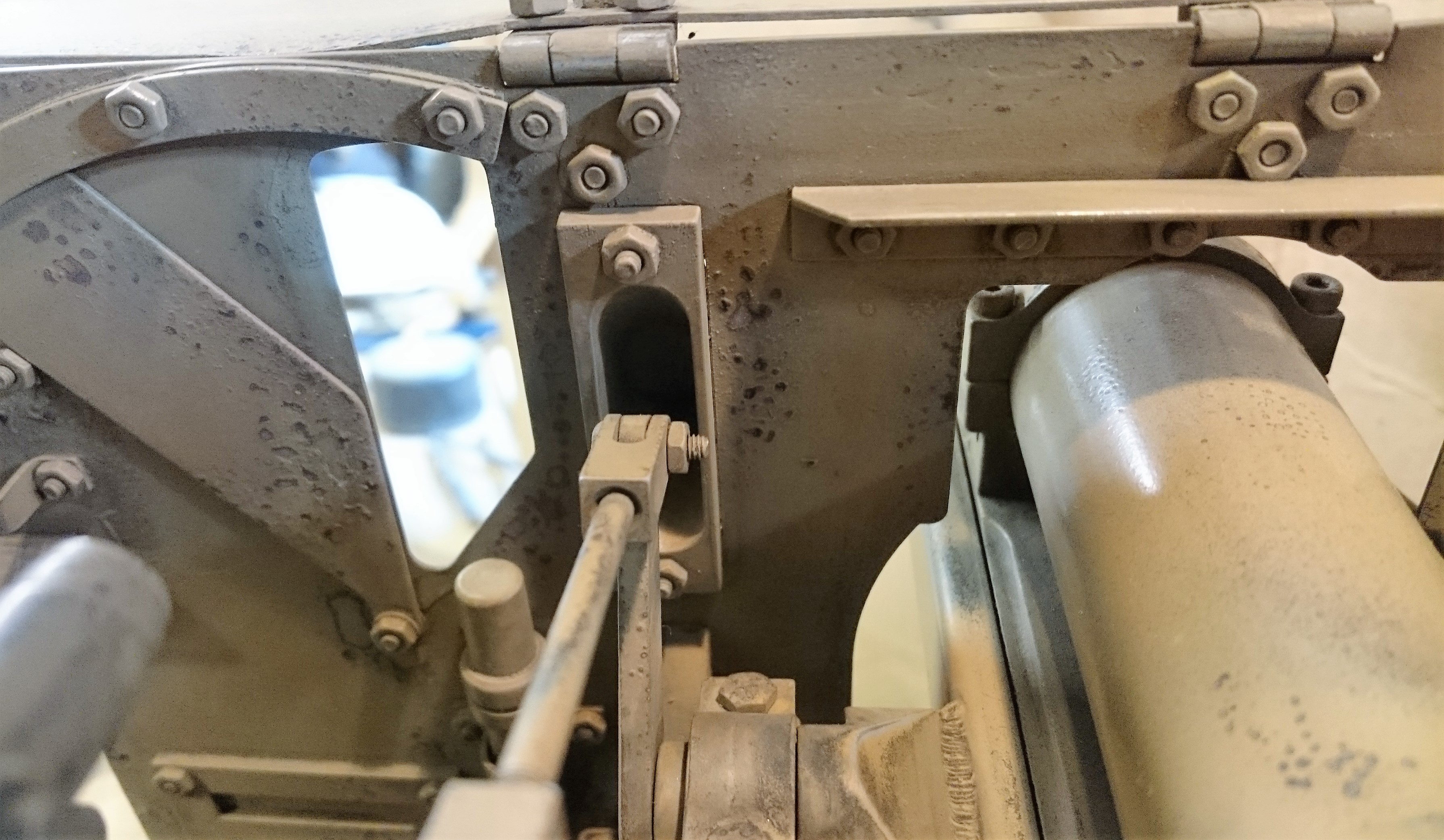

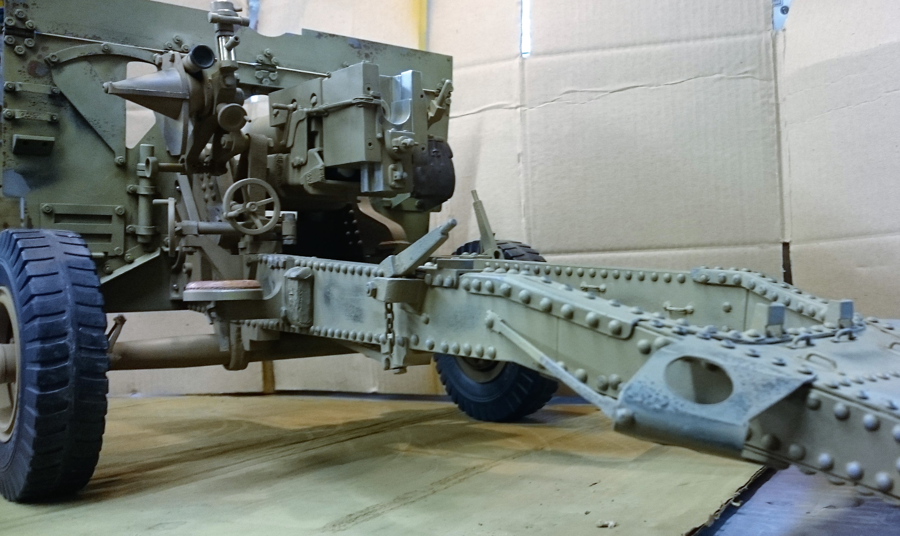

Finishing the gun, weathering technique final stages.
Washes added, it all looks very messy at this stage.
Washes to the inside of the shield showing an area that I have started to rub off until I'm happy with the shading.
The wheels and tyres get a going over with the air brush to.
That's just about the shade that I was after with just a little rain staining from the bolts and rivets and fittings.

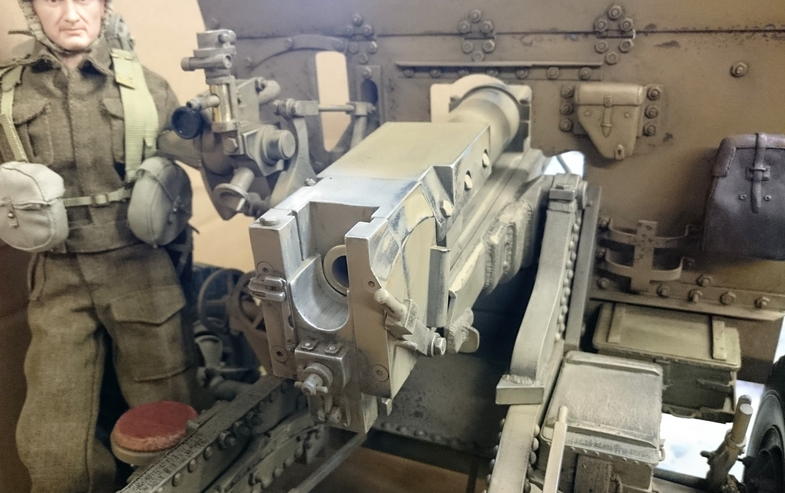

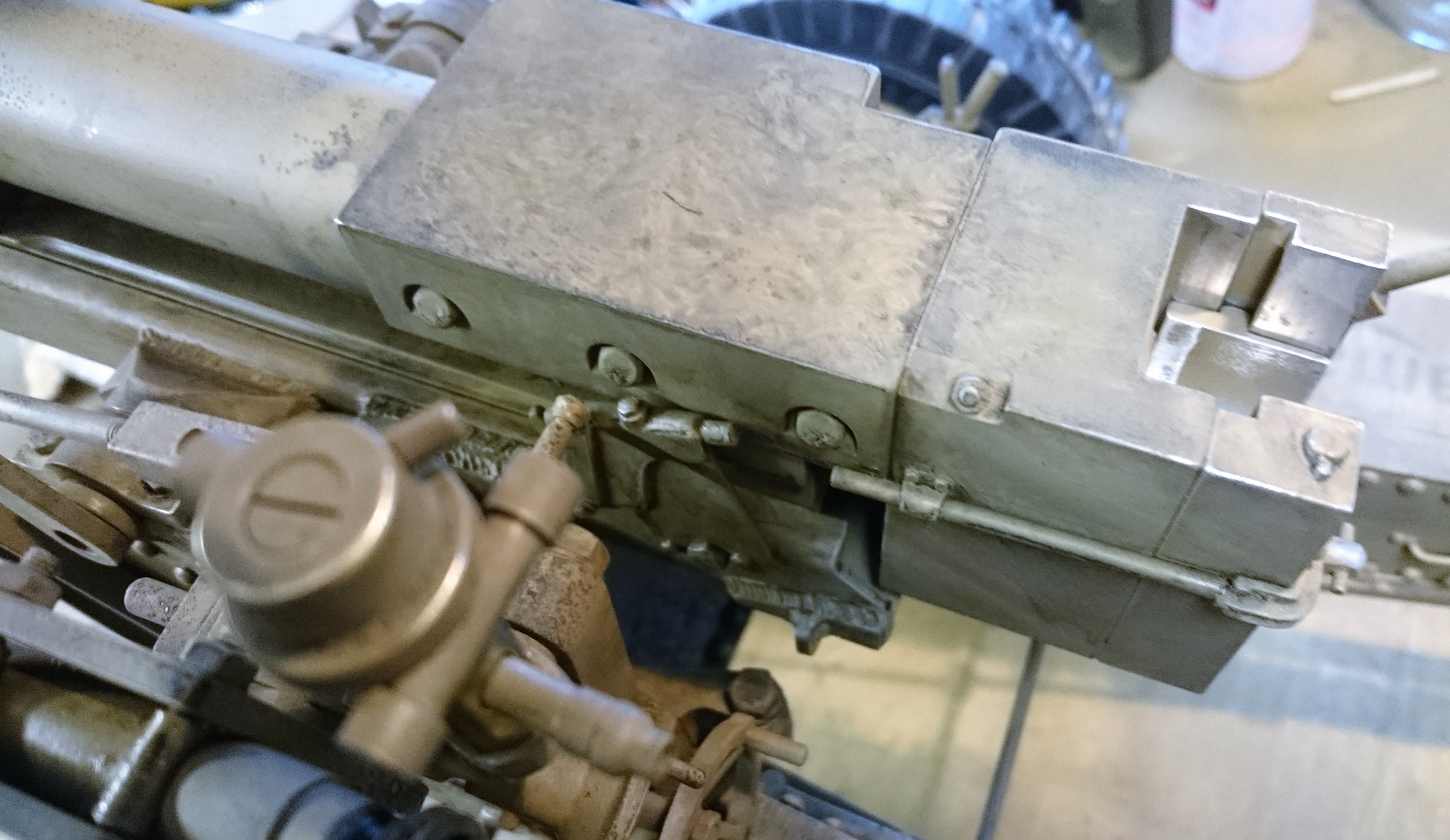

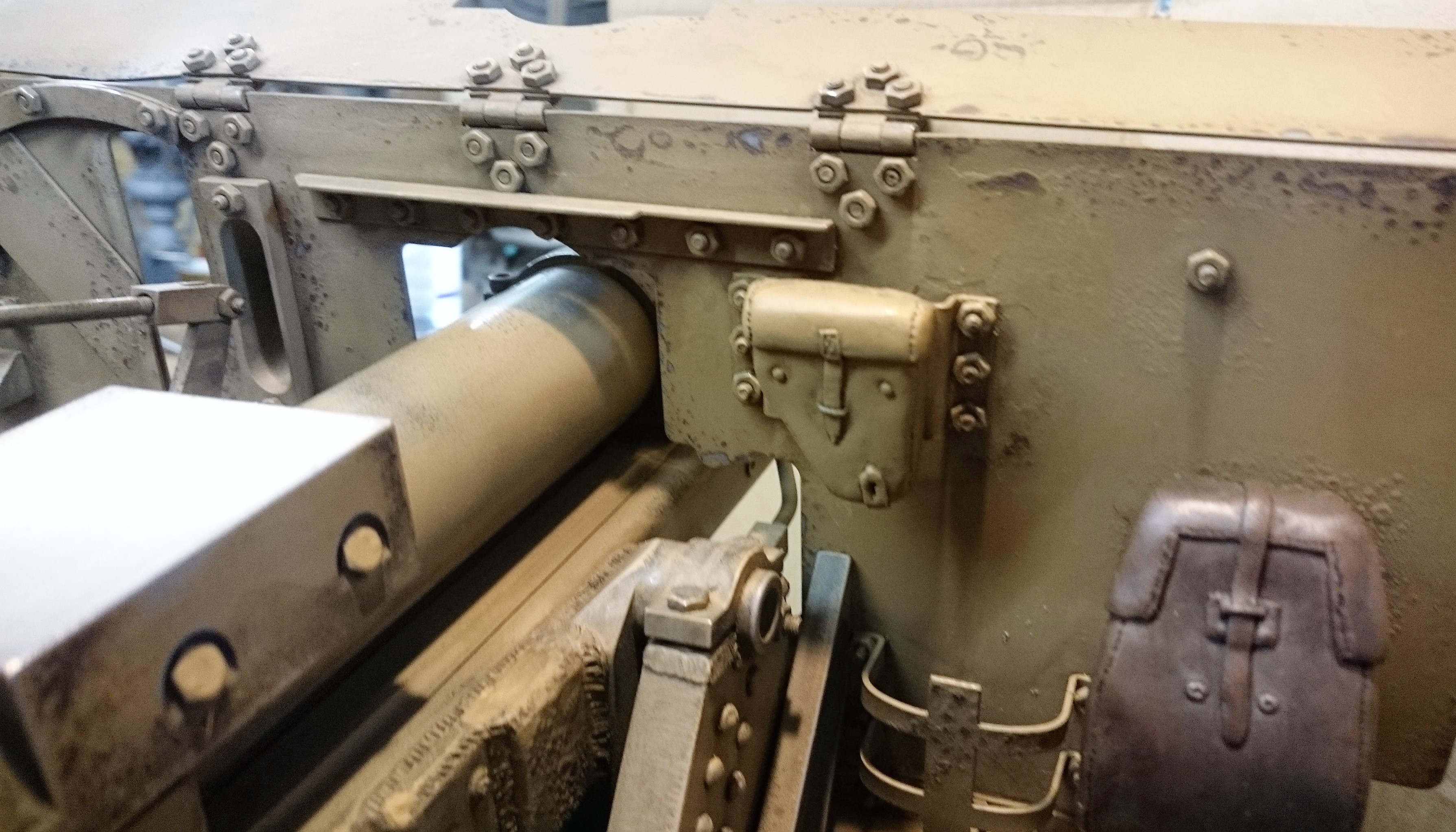

The breech cleaned back.
How ever grubby an artillery piece was in use, the gun tube was always kept clean and would shine just a tad.
The chipping that you can see is a combination of the hair spray technique and quite a lot of my own method.

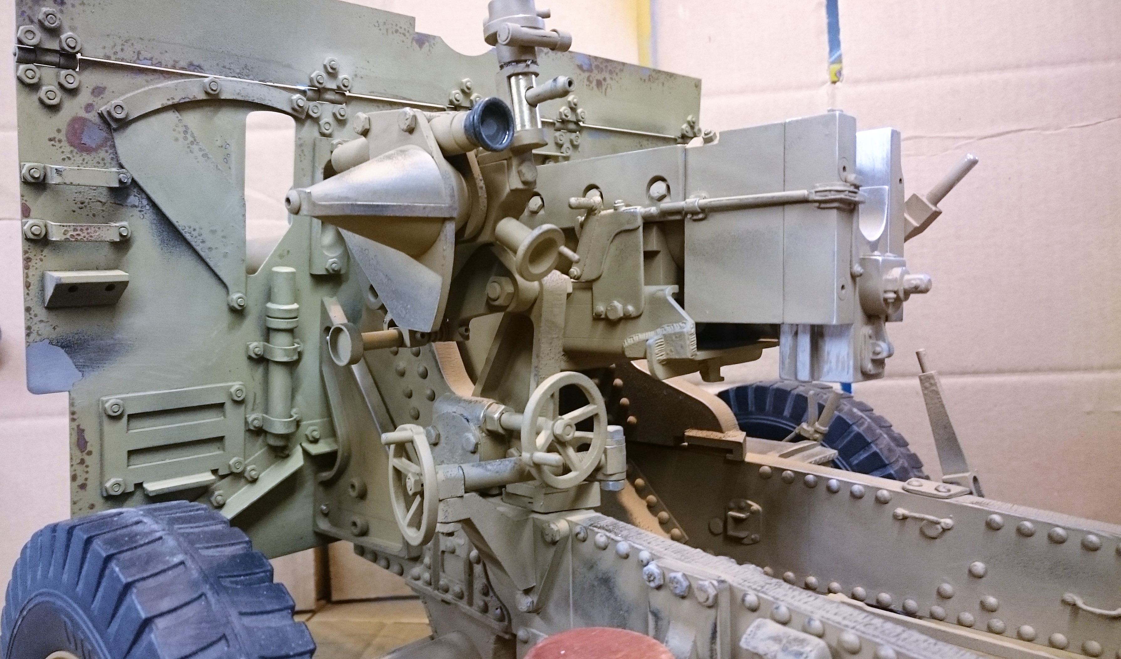

Re: Me Quad.

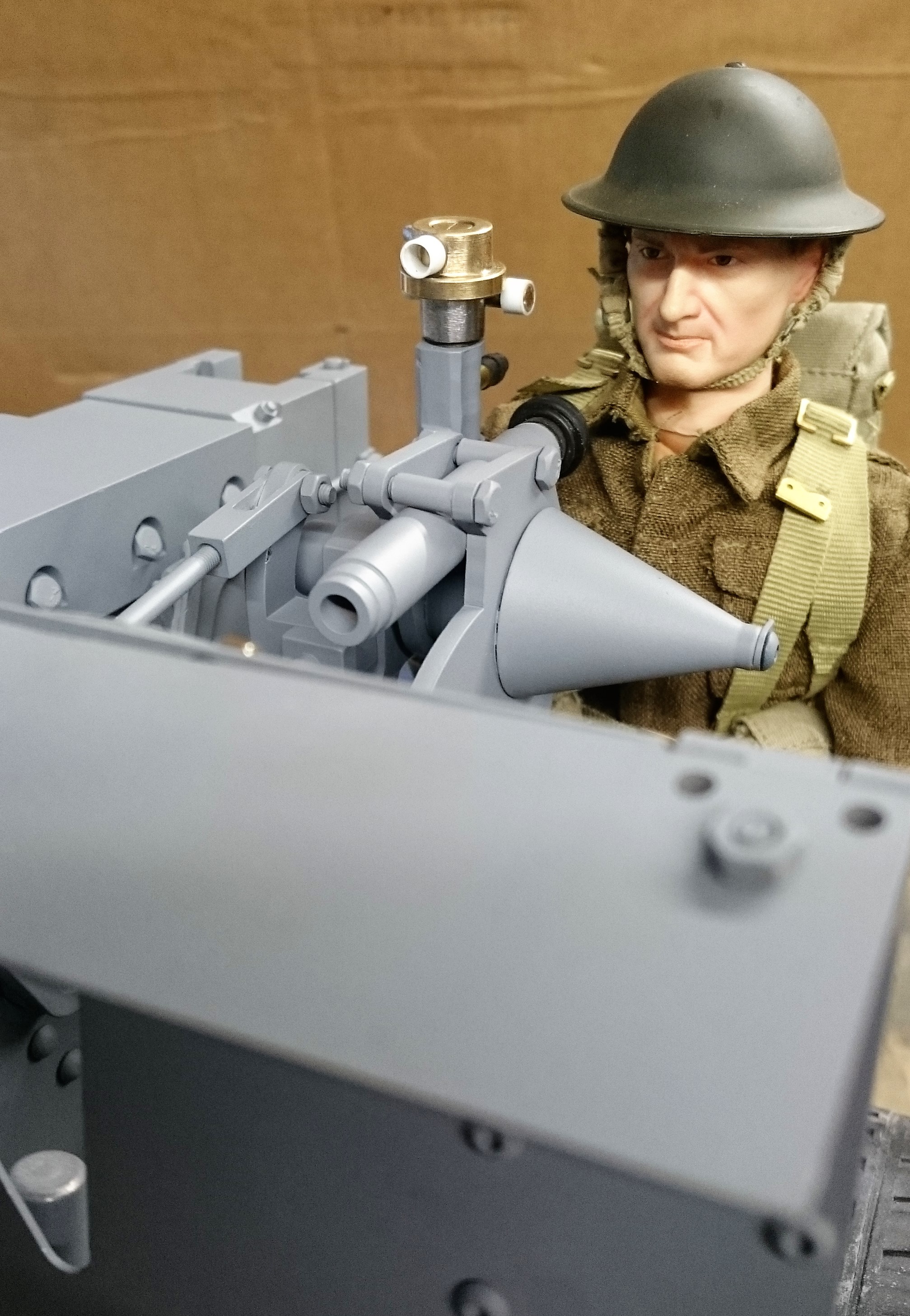

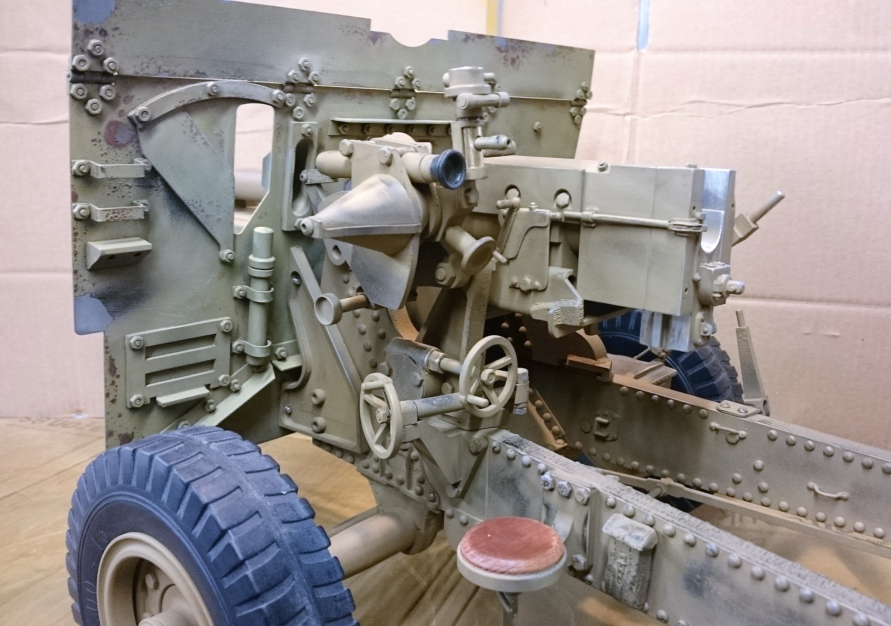

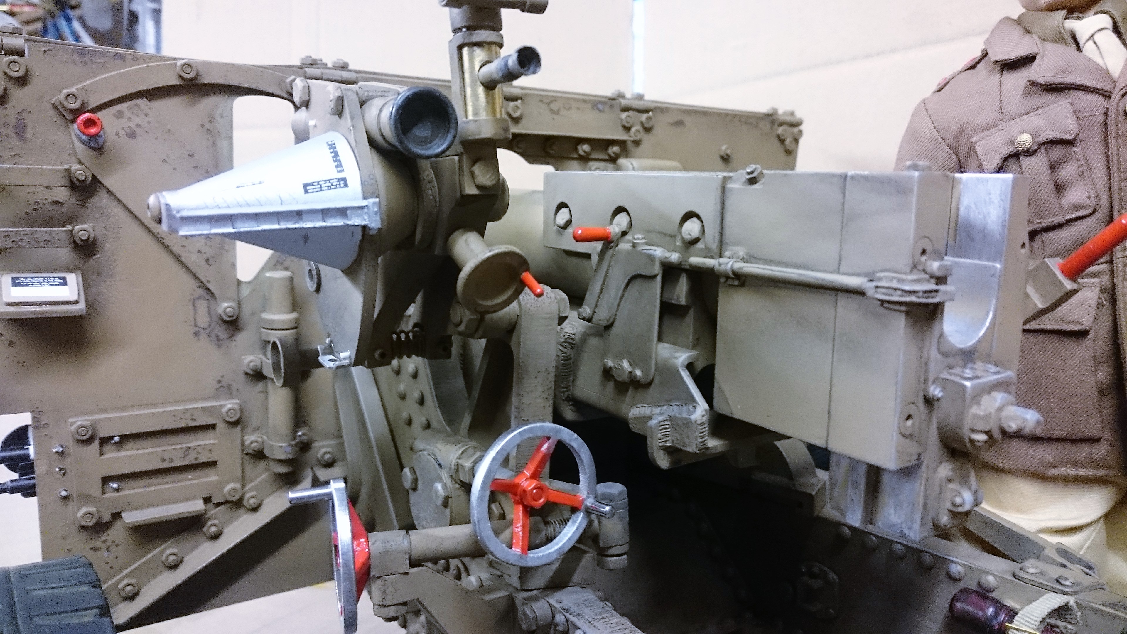

Very close to finishing the gun now, some pics of a wet Saturdays events. Once all is done the trinity will have to wait for some decent weather for a photo shoot, in the mean time it will be back to the KT make over.
Added some detail to the ranging cone, enough I think.
Just had to add some aiming posts, functional to.
Not much more I can add now so that's about it.
