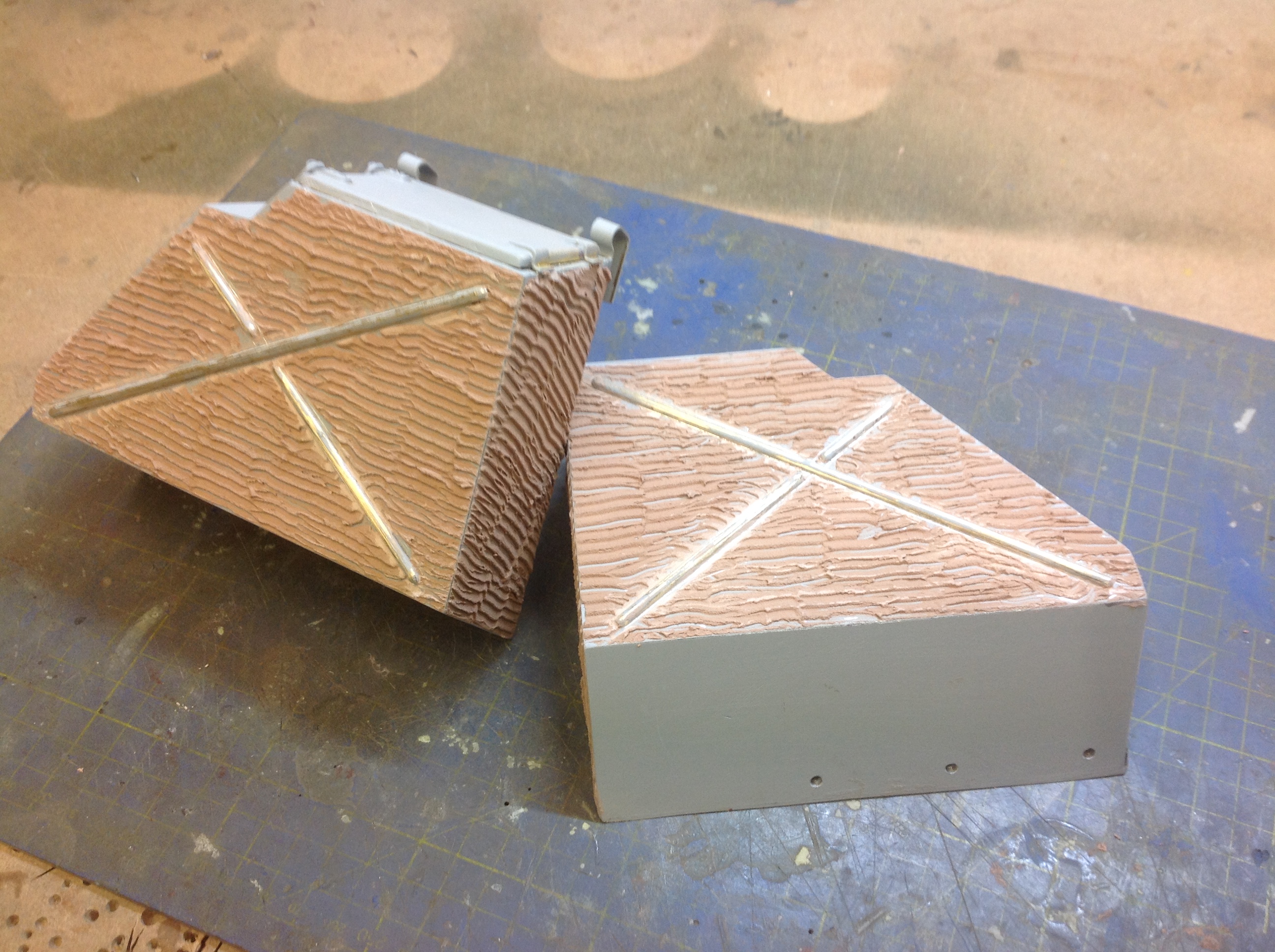

One question, how did you achieve the flame cut overlapped joints?
Paul.
I hope you are well mate, I love tuning in to see your build progress.
Paul.

Re: Steves Panther A
Hi Paul
Hope you are well, it's a long time since we had a North West tank meet.
The flame cut effect was achieved using a small drum shaped grinding bit in my Dremmel and just dragging it across the area you want the flame cut multiple times. Some ares had to be filled before I could do the effect and for this I used Araldite steel adhesive.

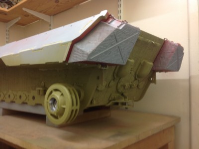

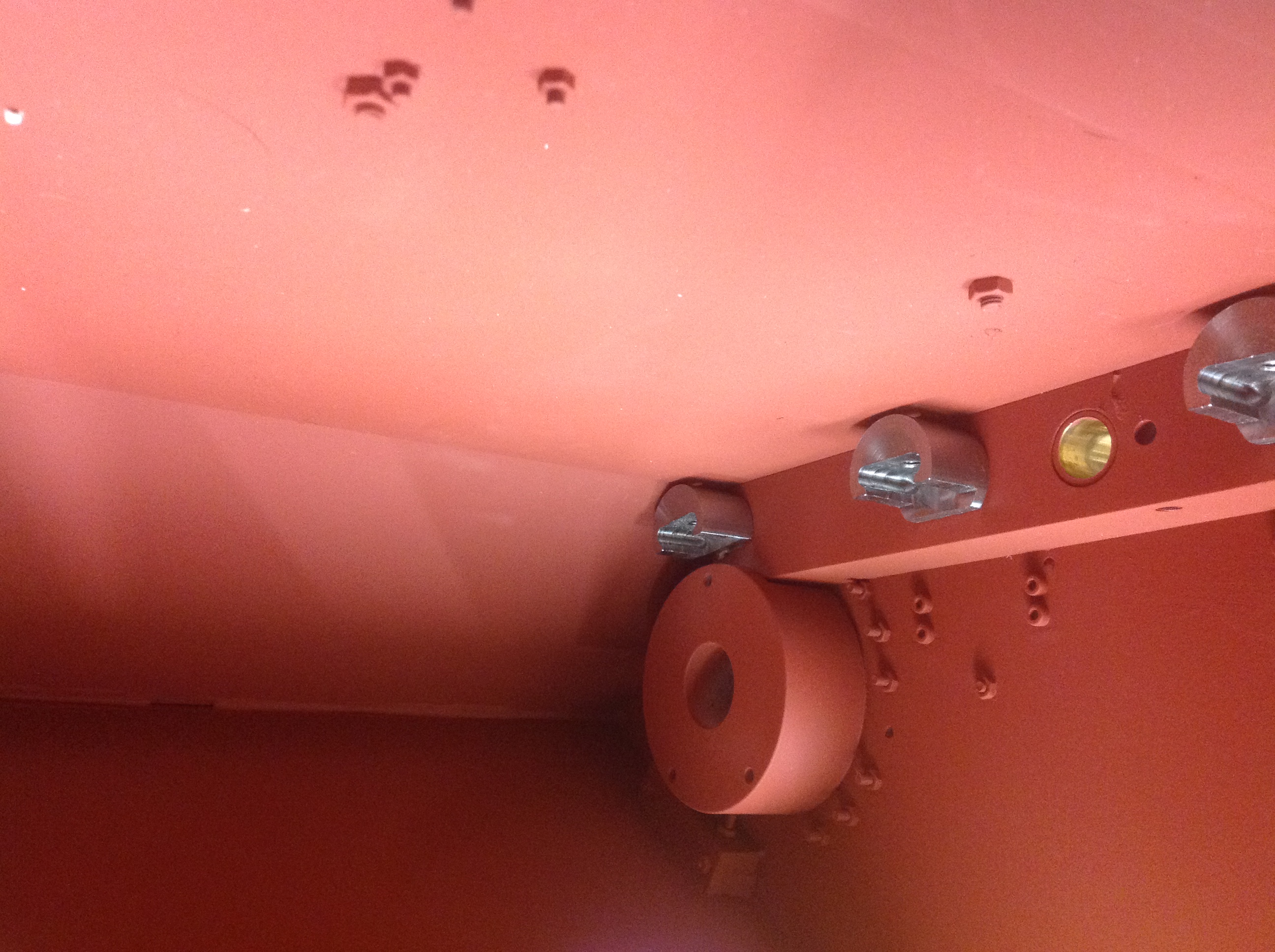

A simple mod for Panther builders that may prevent a suspension jam.
ps. not sure why the second photo is upside down, it's OK if you click on it

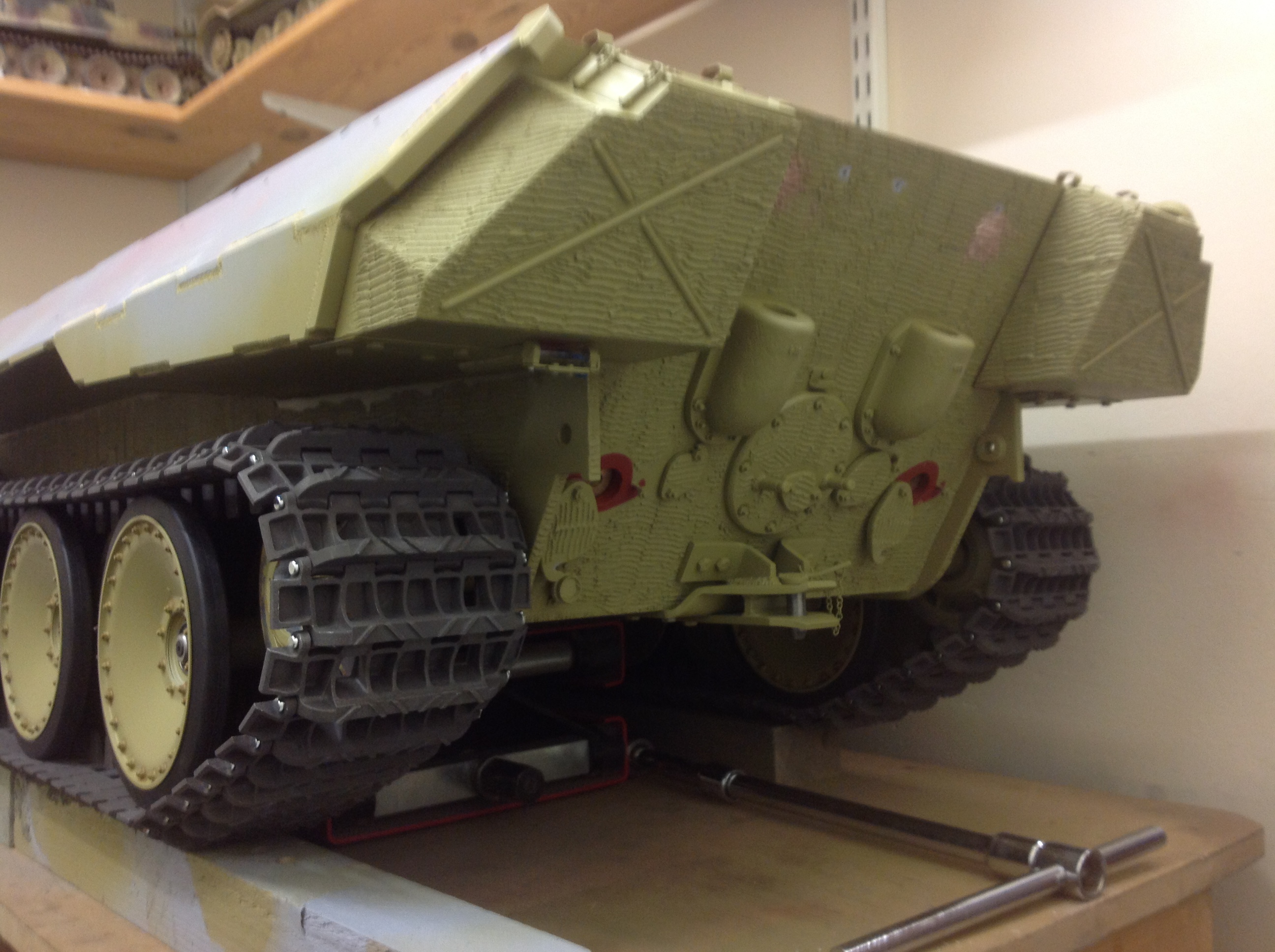

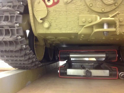

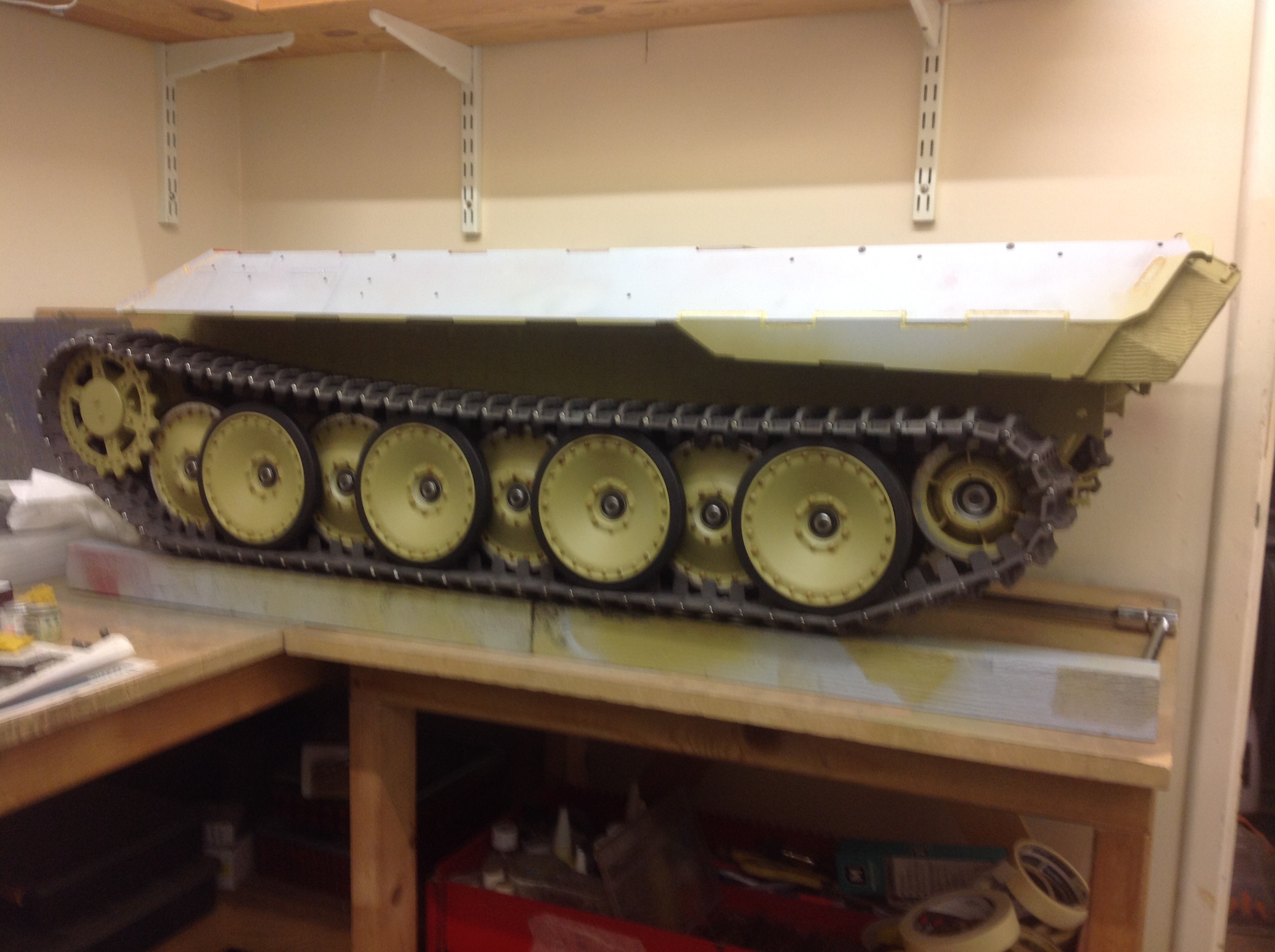

Tracks on for the first time
On thing I did notice when adding the wheels was that they had a wobble on the axle, Yves also noted the same problem. Hopefully an easy fix will be to add a thin shim washer behind each wheel which should take up the unwanted end float on the axles.
More to follow
More to follow
Hello Steve,
Nice work you done on the panther.
Ps: i bolt my inner wheels together, for the outer wheels i try to use a shim like you say.
Best regards Yves
Best regards Yves

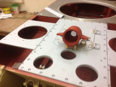

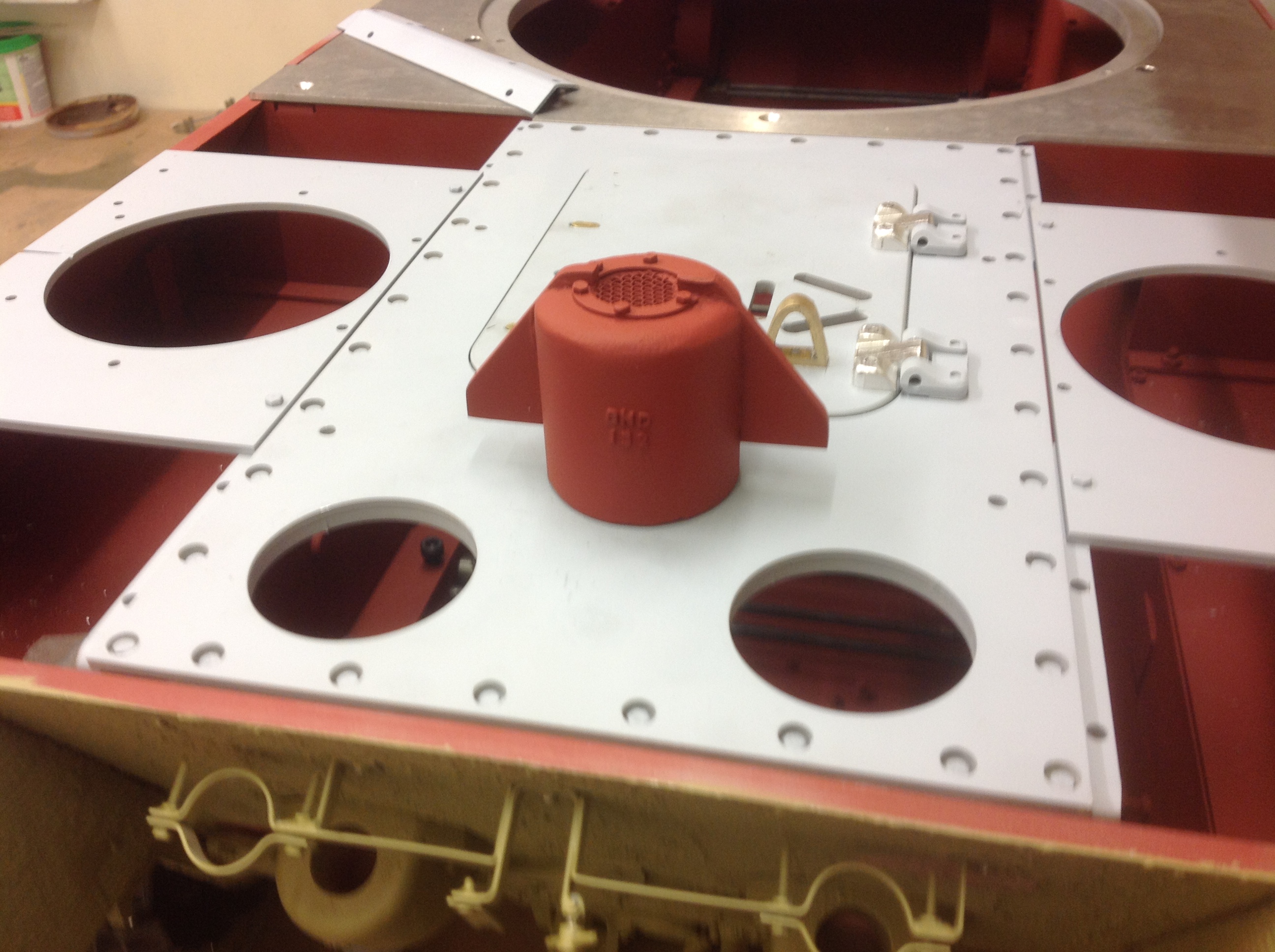

Armoured schnorkel cover next
The intake schnorkel will be added later hopefully

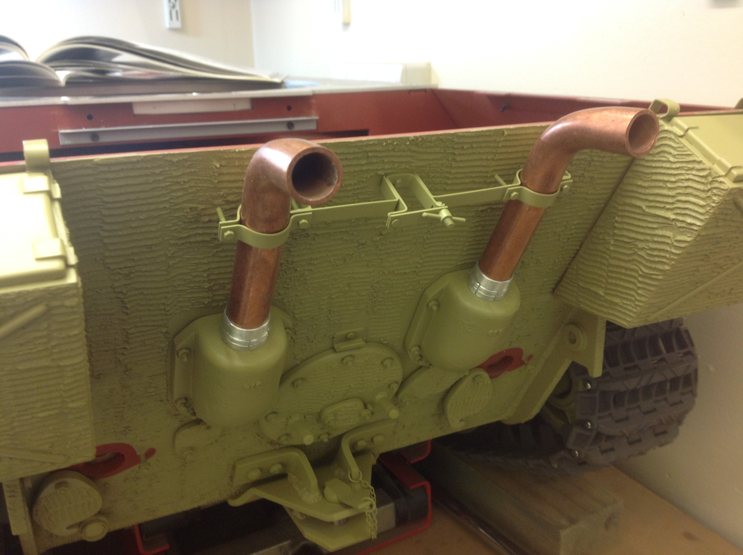

Hi Steve, have I missed something regarding the lovely exhaust brackets? They look the business ...regards Phil.
Looks good Steve, the kit exhausts are a little heavy, I have to make longer ones for the Bergepanther so I will not use them for that build.Regards Phil.
Hi Steve,
Nice progress well done.
You can keep the kit pipes just take the thickness down with a Dremel or make a new ends as I did with
the excellent aftermarket exhaust pipes with cast guards Bob M once made.
Not that hard to make, here is how I did it:
(scroll down to last 1/4 of the page)
http://www.armortek.co.uk/Forum3b/viewt ... &start=120
Kind regards
Kent
