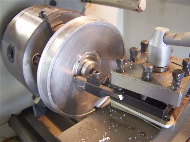

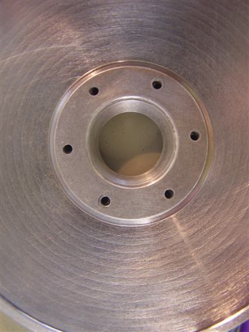

Today I started detailing the road wheels all the outer wheels had a small grove added plus I'm going to add studs to the outer single bearing hub so as to have nuts on the outer wheels and then taping a thread to the double hub to take M3 hex bolts ... Dale

Hi Dale
Make one set for the long and one for the short axle, just dry fit with the rubber rings on. I think you will find that the heads of cap head bolts in the last pic, will be in conflict with the rubber ring . On my build I had to use bolts with hex head of no more than 4m/m across and hight of 1,7m/m. You will have to try it on the tank and try it with some different riding hights of the axels, just as you vere riding over bumps in the terrain.
Ragnar

It might be worth smoothing off the machining marks from the wheels whilst you've got them mounted in the lathe.
- Posts: 1456
- Been liked: 514 times
Re: Dales mid tiger 1
Thanks everyone . Per your comments mean a lot , Ragnar I've ordered M3 X 16 mm button head screws that way they are low profile like wheel studs on a box trailer this way they will clear the following rubber tyre. Adrian good idea about the groves in the road wheels I don't think paint will smooth them out .. Dale

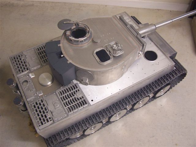

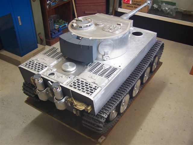

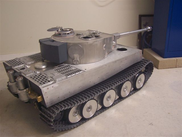

I put the tracks on yesterday morning this is the best stage of the build so far . I've only added two hex head bolts and nuts to the out side road wheels as they will be removed for etch priming later whilst the tiger was on the ground I gave her a test push run . The running gear all ran nice and true ... Dale

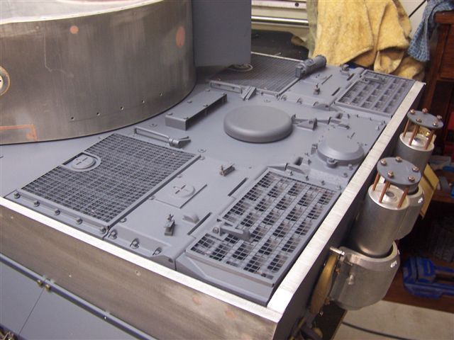

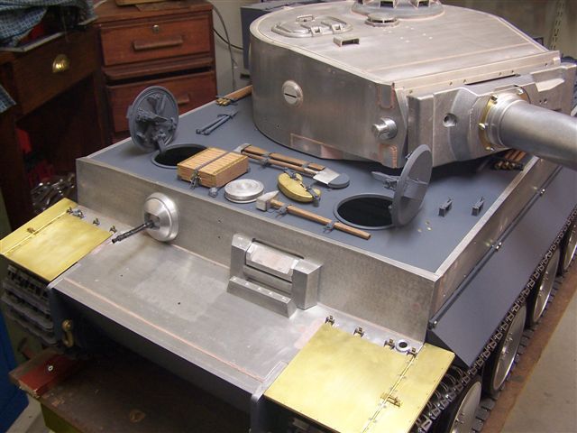

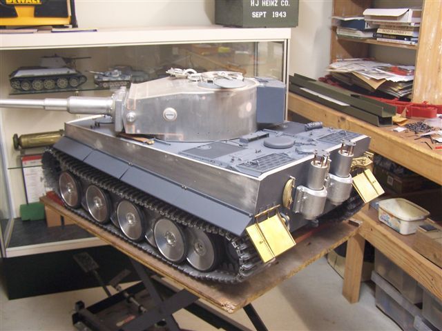

Here are some updated photos on my mid tiger 1 build . Deck work is just about done lots of Mike's parts added just need to add tow ropes then tidy up ready for zim .. . Dale
