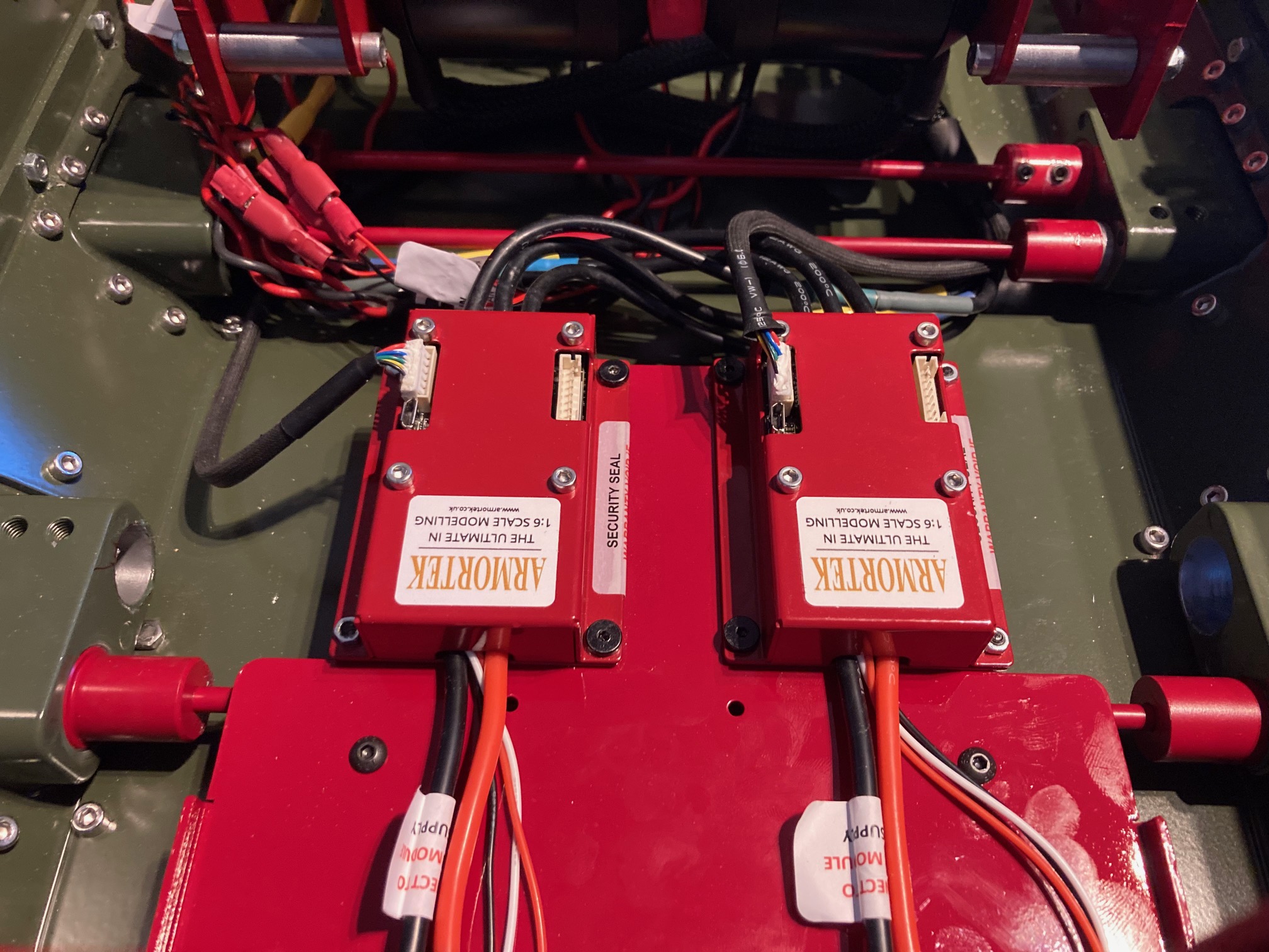

Today, I successfully programmed the TX (Futaba FX-32) and the drives work ... first time in my life to program mixers on the Futaba :D
I will now go on with the installation of the electronics and of course the final assembly of the wheels and tracks!

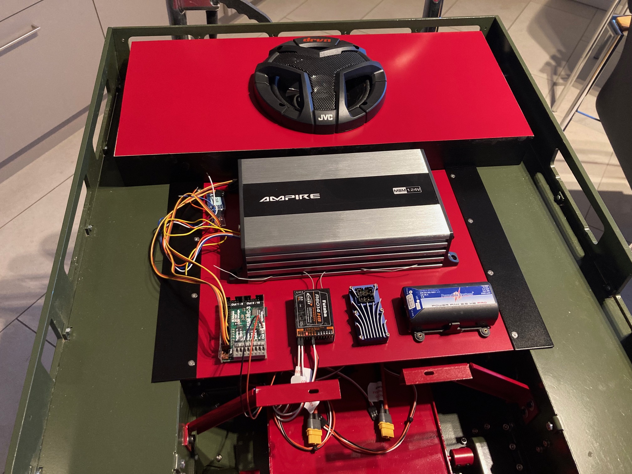

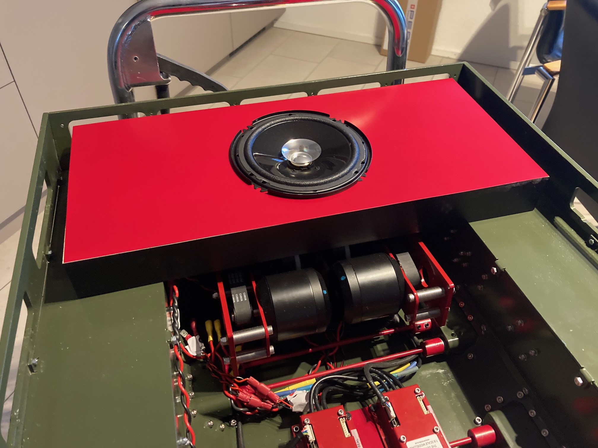

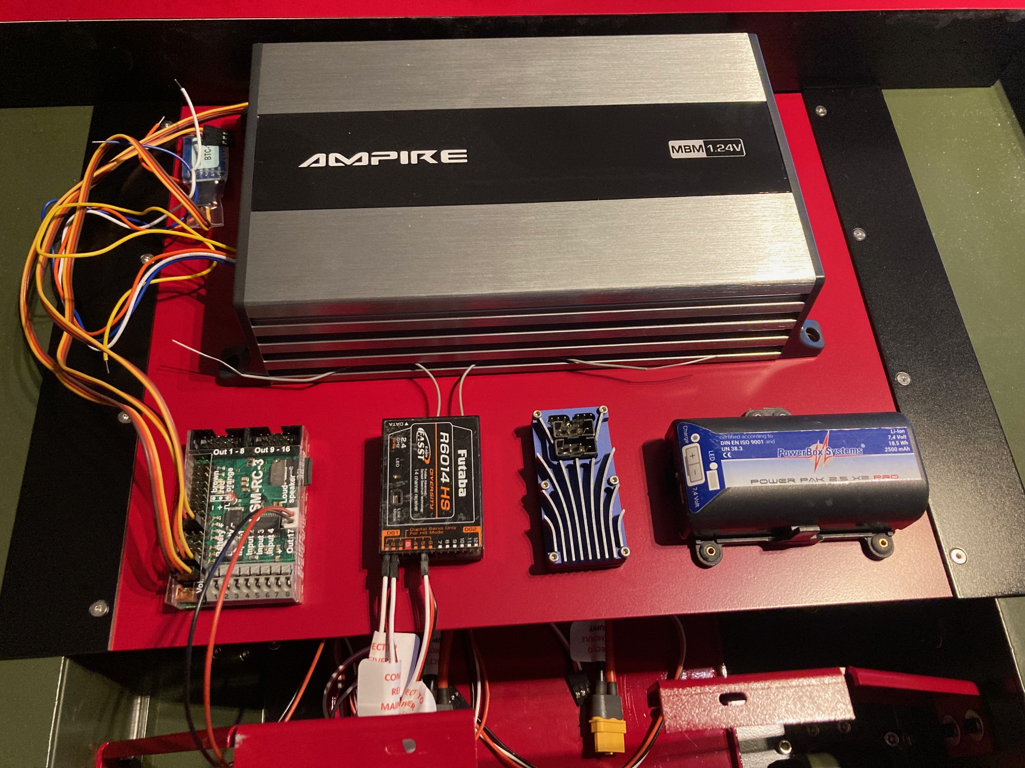

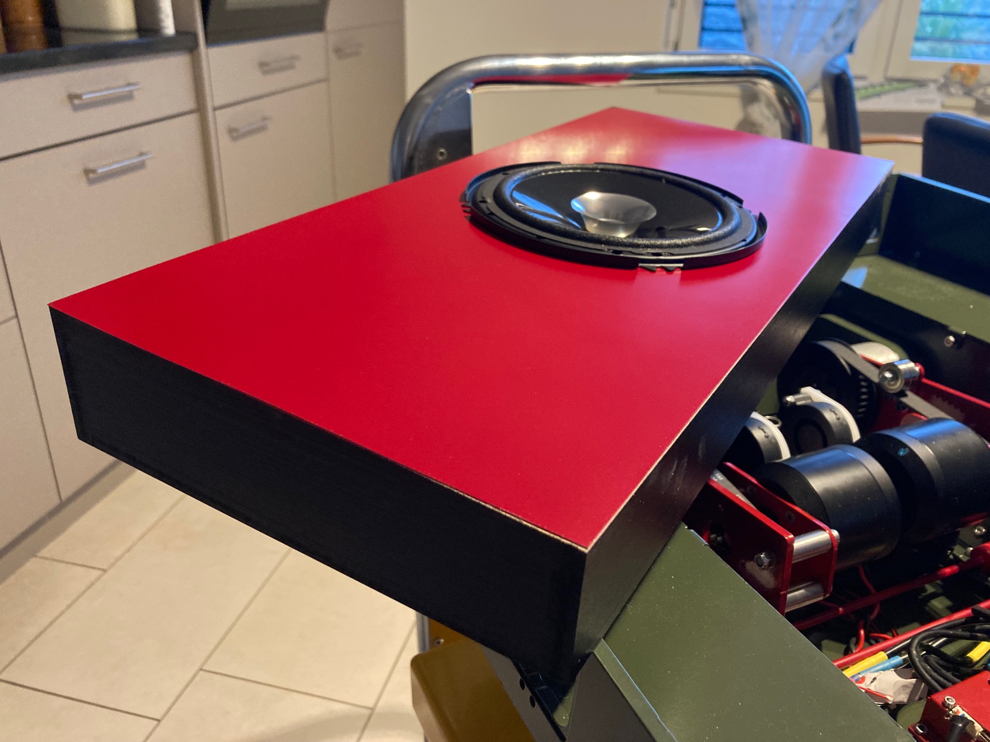

Over the last couple of days, I have been trying to sort out the layout for the sound and RC components. For my loudspeaker (JVC, 230W), I have built a box made out of MDF 10mm, rather flat but 50cm wide. I will use the USM-RC3 by Beier Electronics for the sound and a 500W amplifier (not many at 24 volts available).
The amplifier as well as the RC components will rest on a tray made of 3mm fibre sheet. The black parts are aluminium profiles I had in my hobbyroom since long time. They will be fixed using welcro as well as the sound box.
Cheers Andre
Martin Donnison
Posts: 79
Joined: Sat Jun 17, 2023 12:00 pm
Has liked: 40 times
Been liked: 109 times
Re: Pz 87 Leo of the Swiss Army
Post by Martin Donnison »
Loving the speaker and amp. How have you connected it to the amp. Very interesting. Should have a rich deep boom when the main gun is fired.
Andre Meylan
Posts: 165
Joined: Sat Aug 17, 2024 6:02 pm
Location: Olten / Switzerland
Has liked: 802 times
Been liked: 362 times
Post by Andre Meylan »
Martin Donnison wrote:
Wed Oct 23, 2024 8:24 pm
Hi Martin - only wild cables by now ... I will try to connect it properly as you said and then pray for the first time to fire up !!!
Cheers, Andre

Chang
Posts: 1115
Has liked: 16554 times
Been liked: 487 times
Post by Chang »
Hi Andre,
Like your new layout of large speaker , amplifier and 4 other parts.
Only part I know is the 14 channels receiver (2nd from the left). What are the other three?
Do you still need the Armortek's Motion & Audio Modules?
Regards,
Lerh Chang
Andre Meylan
Posts: 165
Chang wrote:
Thu Oct 24, 2024 6:45 pm
Hi Andre,
Regards,
Lerh Chang
Dear Chang,
Thank you for your question. I will use the motion module as is but skip the audio module for another kit (?) ... the electronic device on the left of the receiver is the sound module, the others (blue type) are a magnetic switch and a lipo battery for the RC components. I will not use the BEC's from the ESC and cut the red wires. I will probably upgrade to 8S Lipo later instead of the 24V power supply now for testing.
The blue components are from PowerBox Systems, the best products that mostly flying modelers use like jet and turbine helicopter pilots around the world. I also use it for my race boats.
By the way, I will also get a 1-channel gyro for the gun stabilization from them, probably the best gyros on the market.
https://www.powerbox-systems.com/en.html
Cheers, Andre

Andre Meylan
Posts: 165
Chang wrote:
Fri Oct 25, 2024 4:32 am
Hi Andre,
Thanks for the explanations (although not fully understand their whole functions :oops: ) and will keep watching your building.
With regards,
Lerh Chang
Sorry for my ignorant writing ... it's very simple, just written complicated :shock: :shock: :shock:
From left: Sound-/light module USM-RC3 from Beier Electronics, will replace AT Audio Module, then receiver, then PowerBox Gemini II, regulated (5.9V) power switch with magnetic impulse for on/off, possibility of connecting two accus (2S Lipo) with MPX, far right is the 2S lipo 2500 mAh (I use only one)
is this better by any chance ??
Best regards, Andre

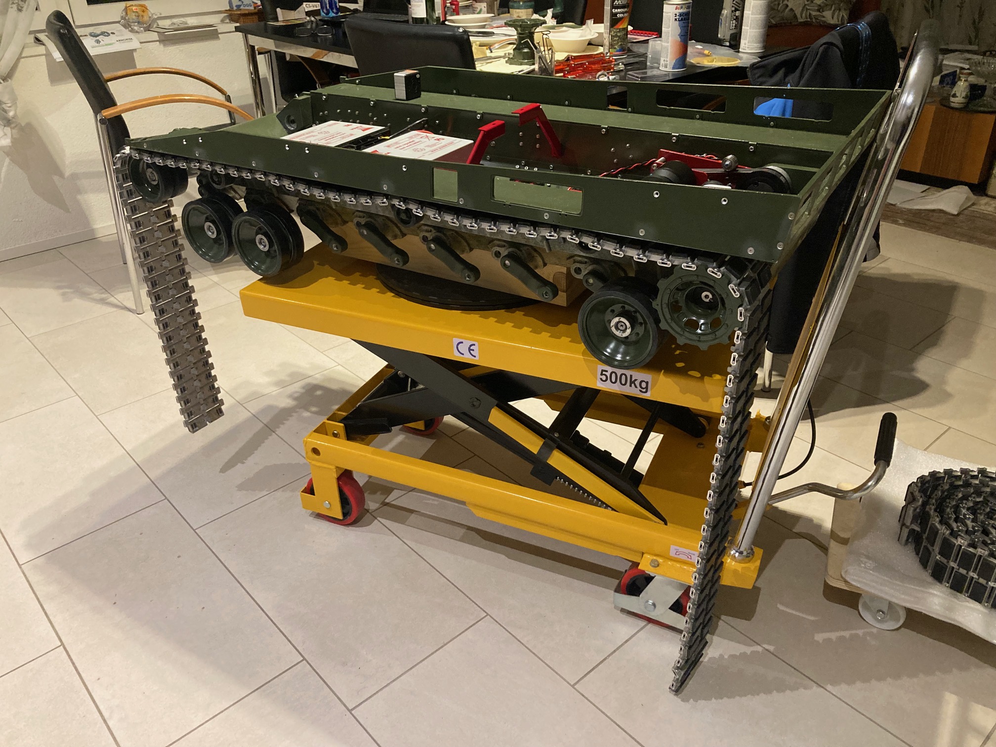

Andre Meylan
Posts: 165

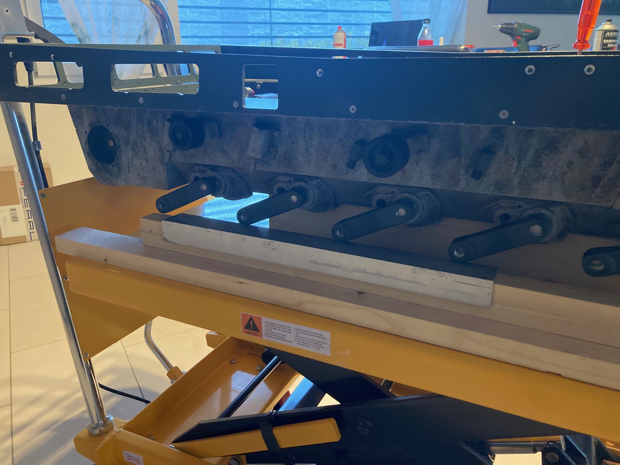

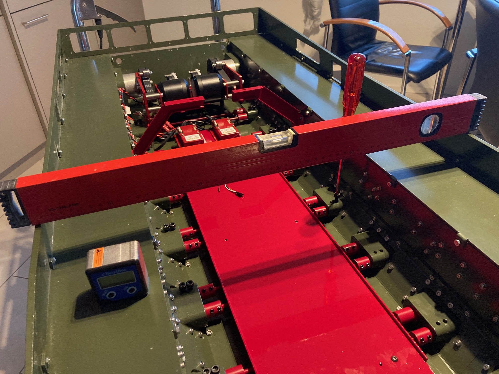

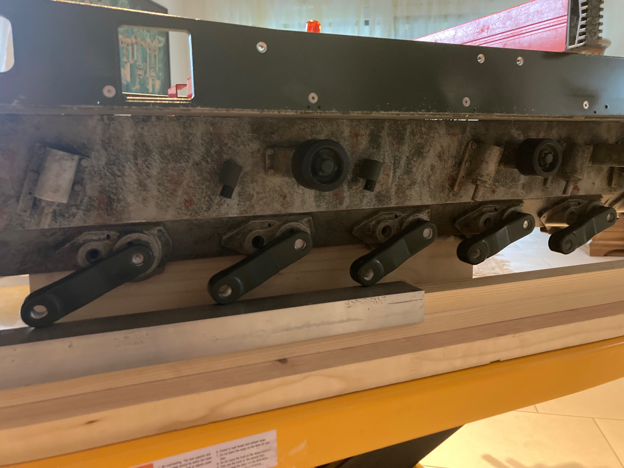

Mounting the suspension, this went almost a bit too easy for me ... maybe I made several mistakes but I cannot see them until the tracks are on ... or you guys tell me :mrgreen:
After making sure the floor is levelled on the bench, I measured the degrees using the bevel box and then just put the supports underneath and fixed it like this ... that's all ???
Cheers, Andre

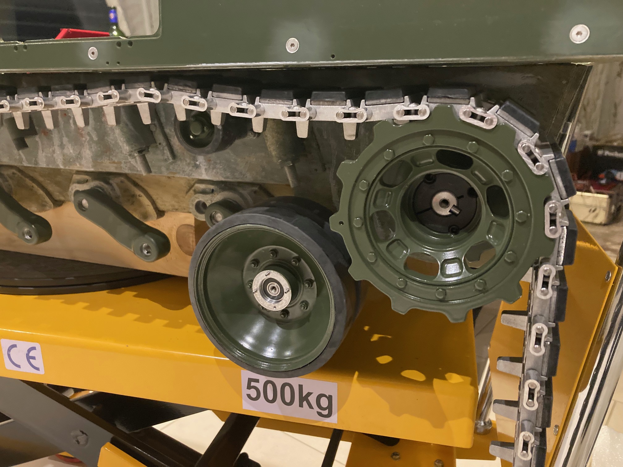

Early Saturday evening, mounting some wheels and adjusting the sprocket on one side ... not that complicated at first sight ???
Cheers, Andre

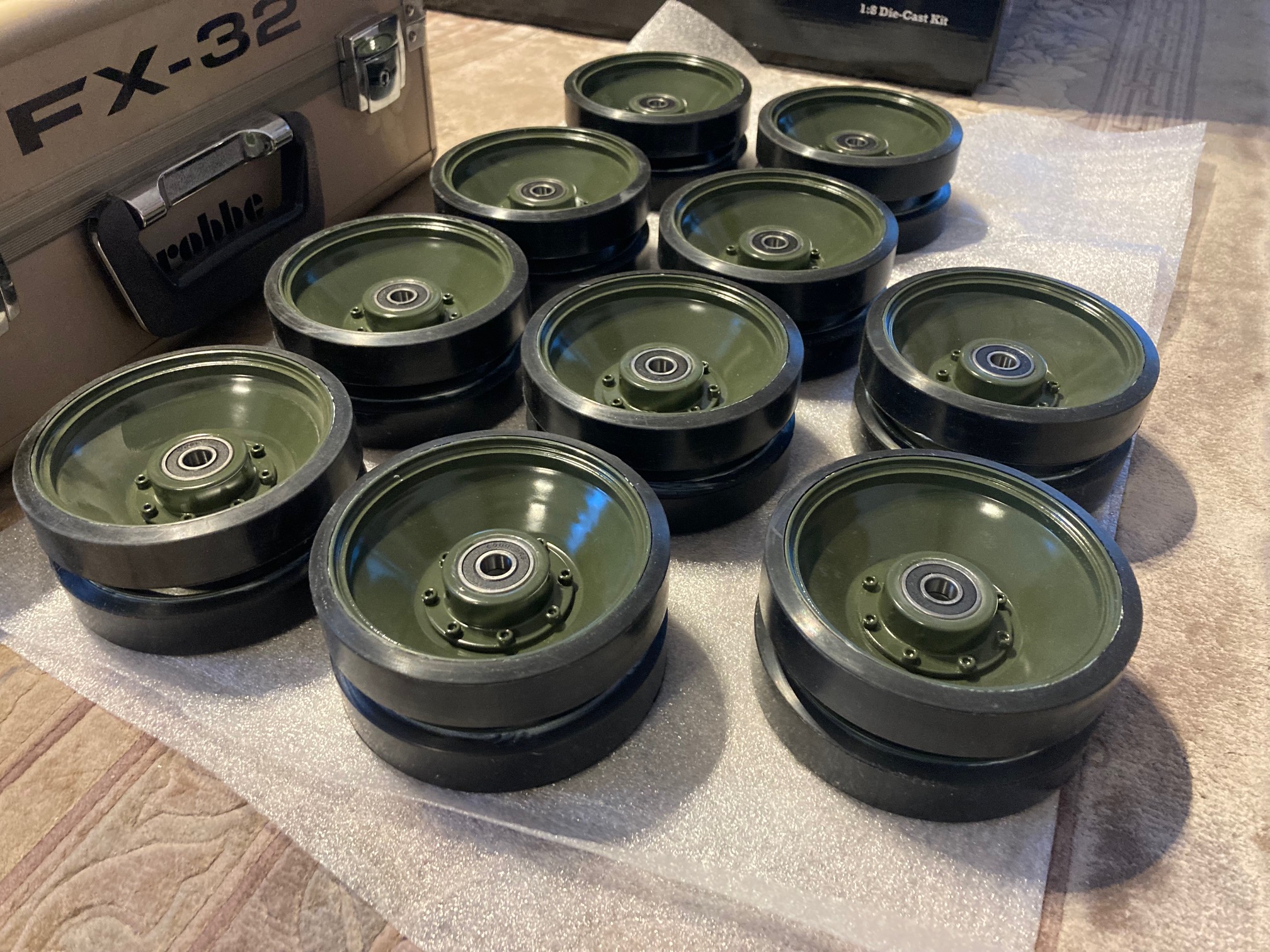

Andre Meylan
Posts: 165

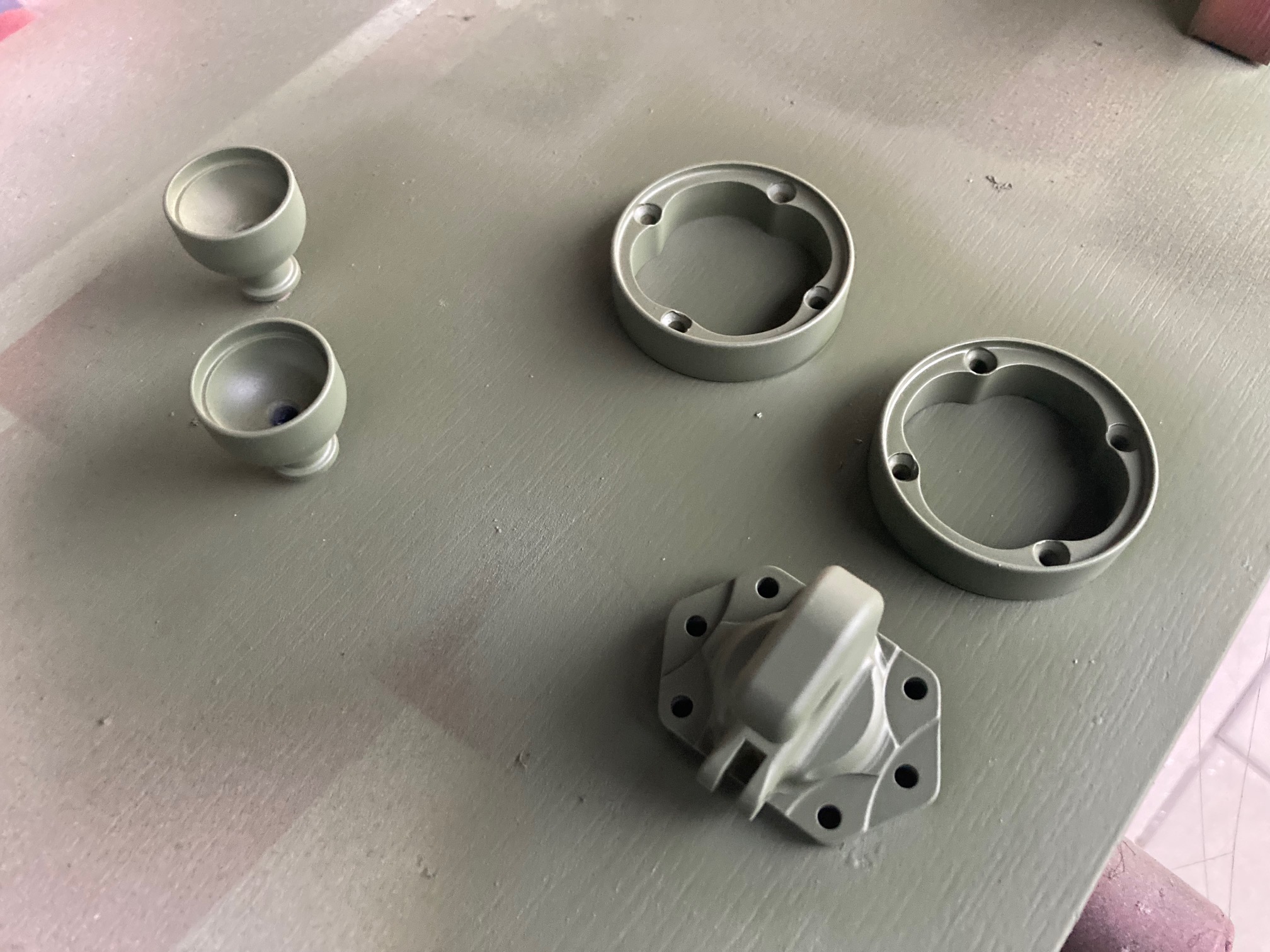

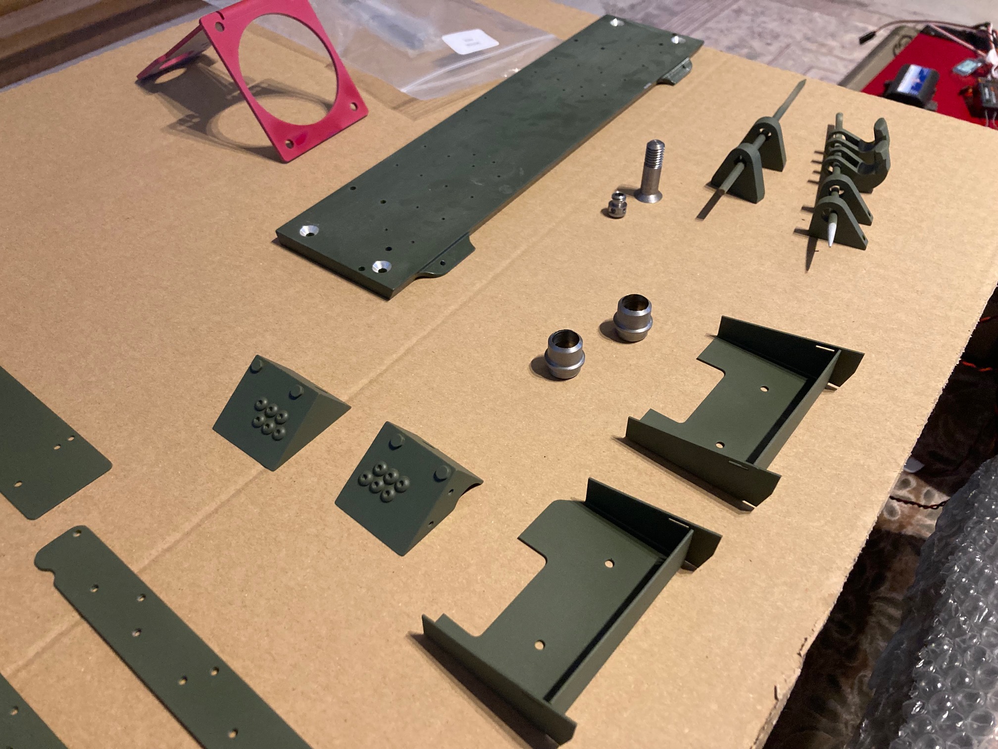

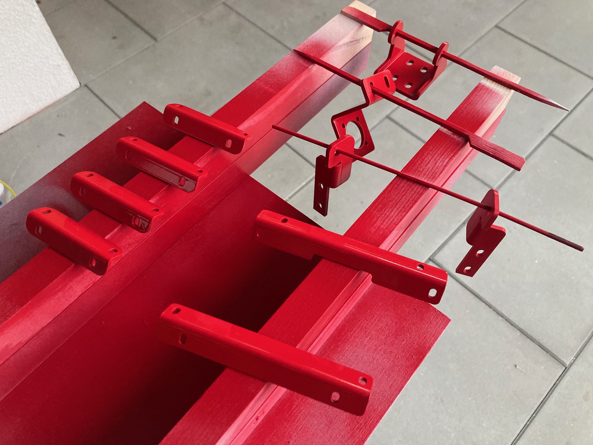

I have done some preparations over the last days ... and I stick to my decision to paint anything interior in the AT red ... including the new recoil bracket just received. So, the wheels are ready for assembly and once done, a first running test can follow ...
... meanwhile, I prepare the mounting brackets for the whole deck assembly and once this is done and the decisions are made where to put the whole electronics and switches, I will continue with this.
