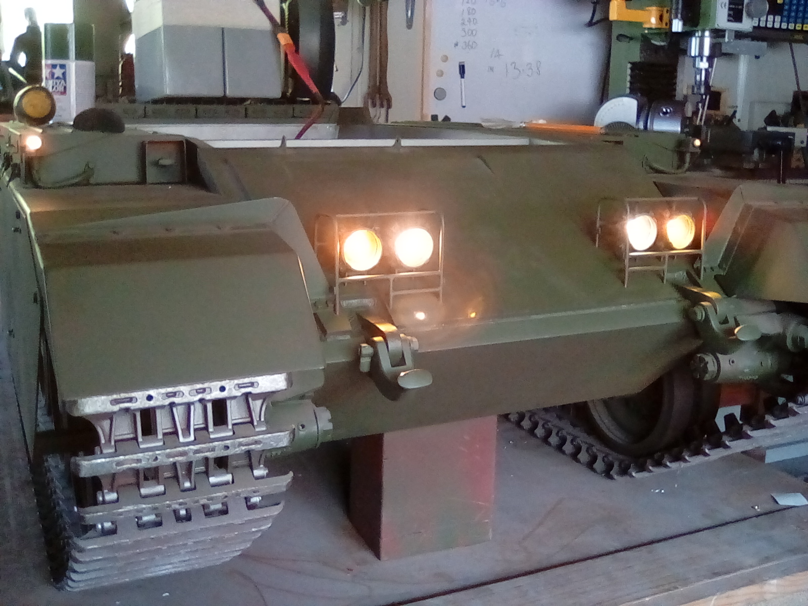

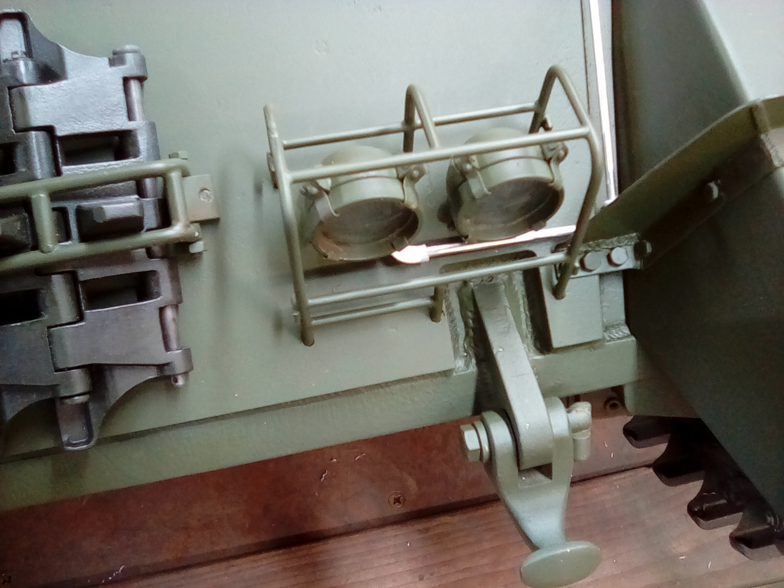

Finishing off the head lamps. Has anyone got details of the headlamp conduit runs perchance , particularly the offside lamp configuration , also the strange conduit covers as the tubes disappear into the panniers ?

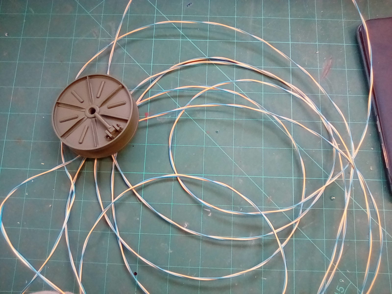

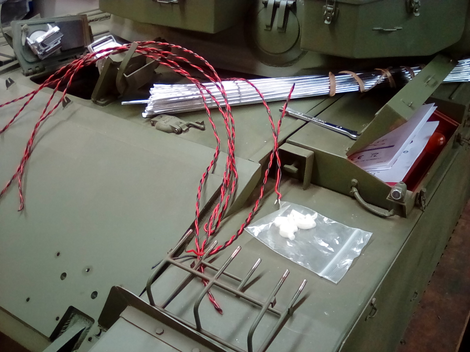

Wiring, there's miles of the stuff in this model

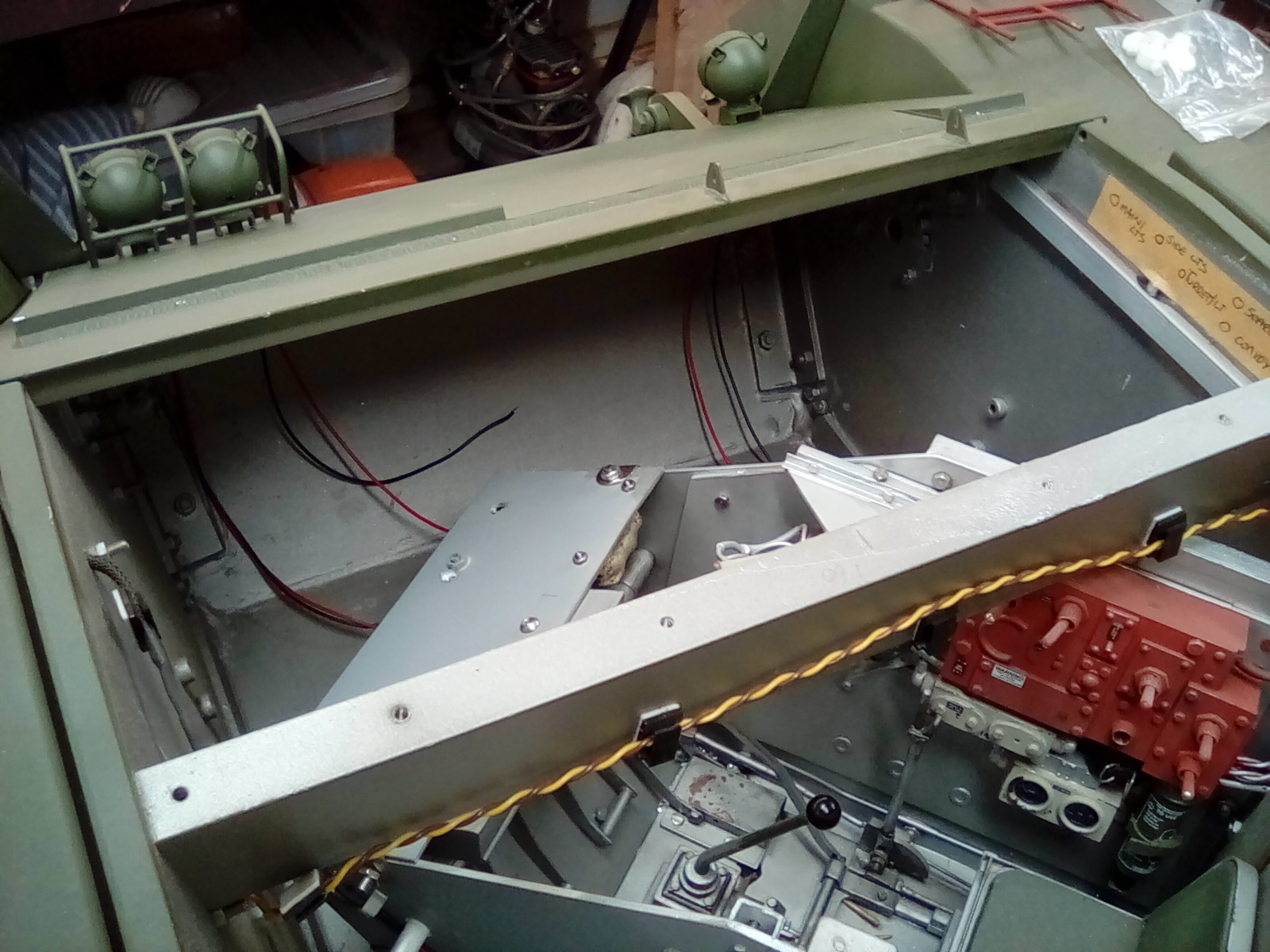

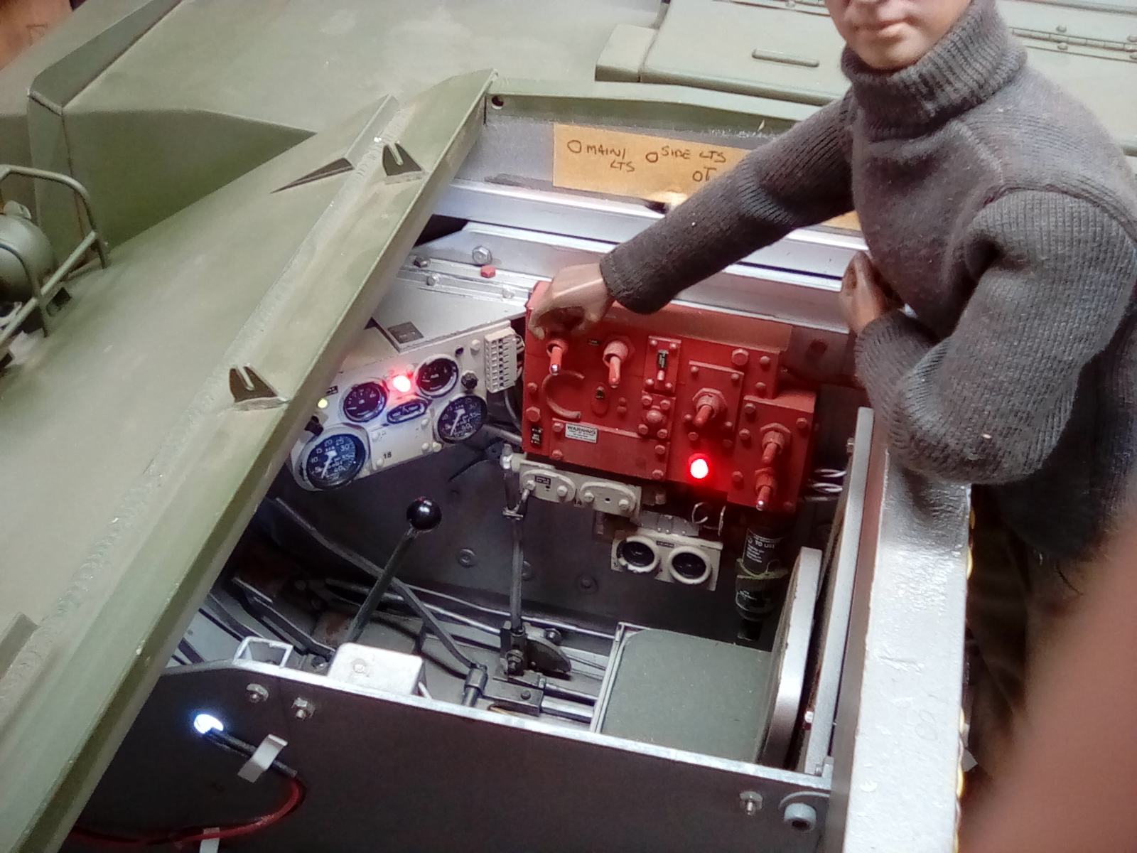

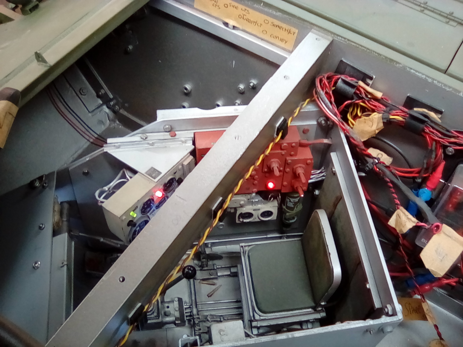

So glad I made the drivers compartment modular

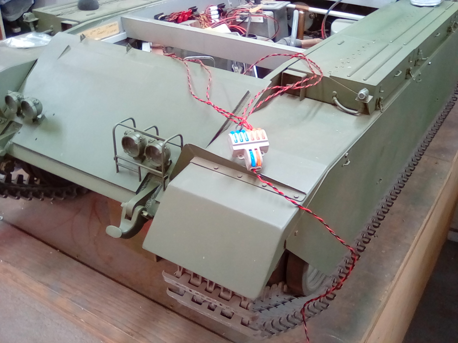

I do like these multi block connectors

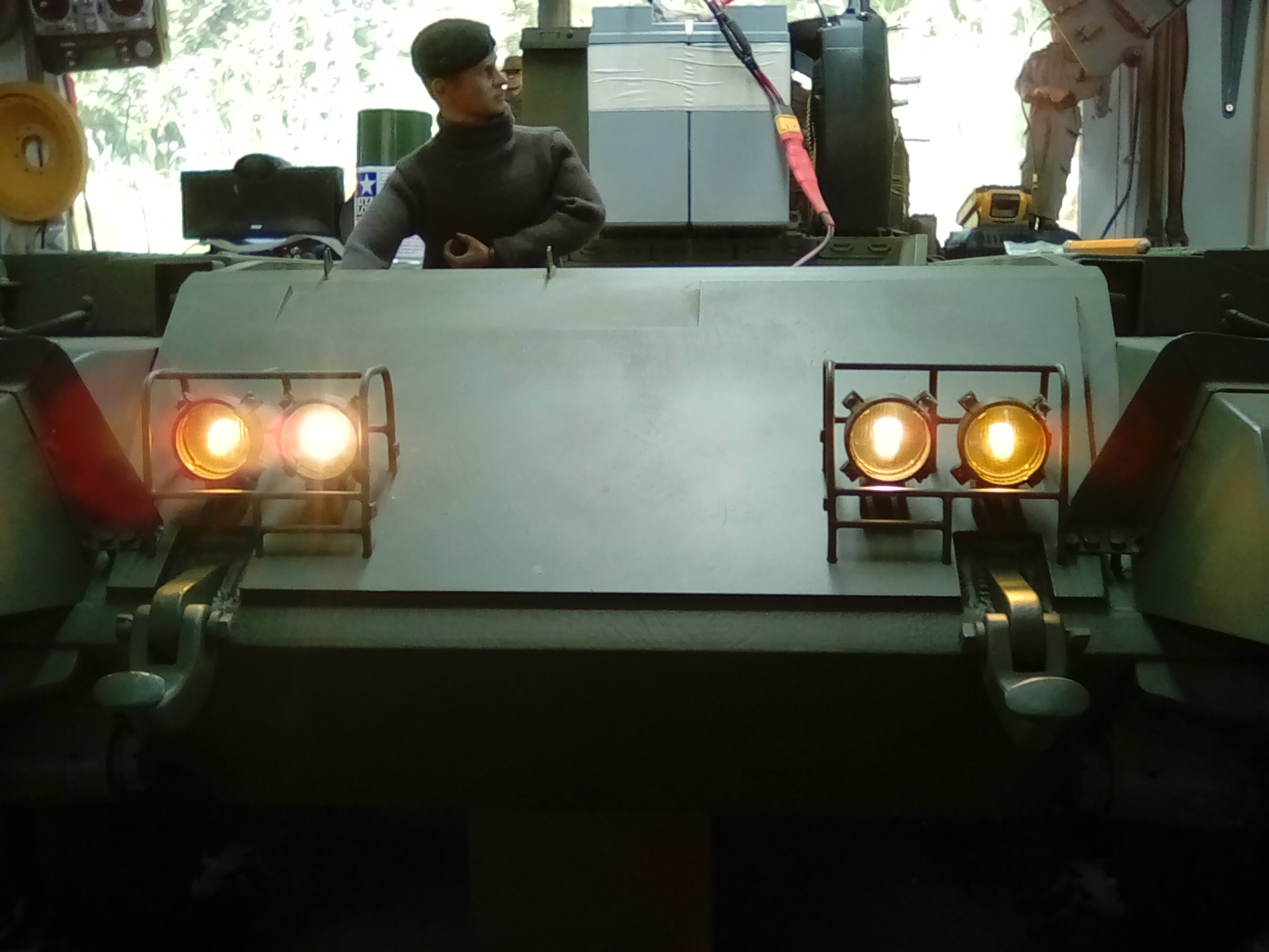

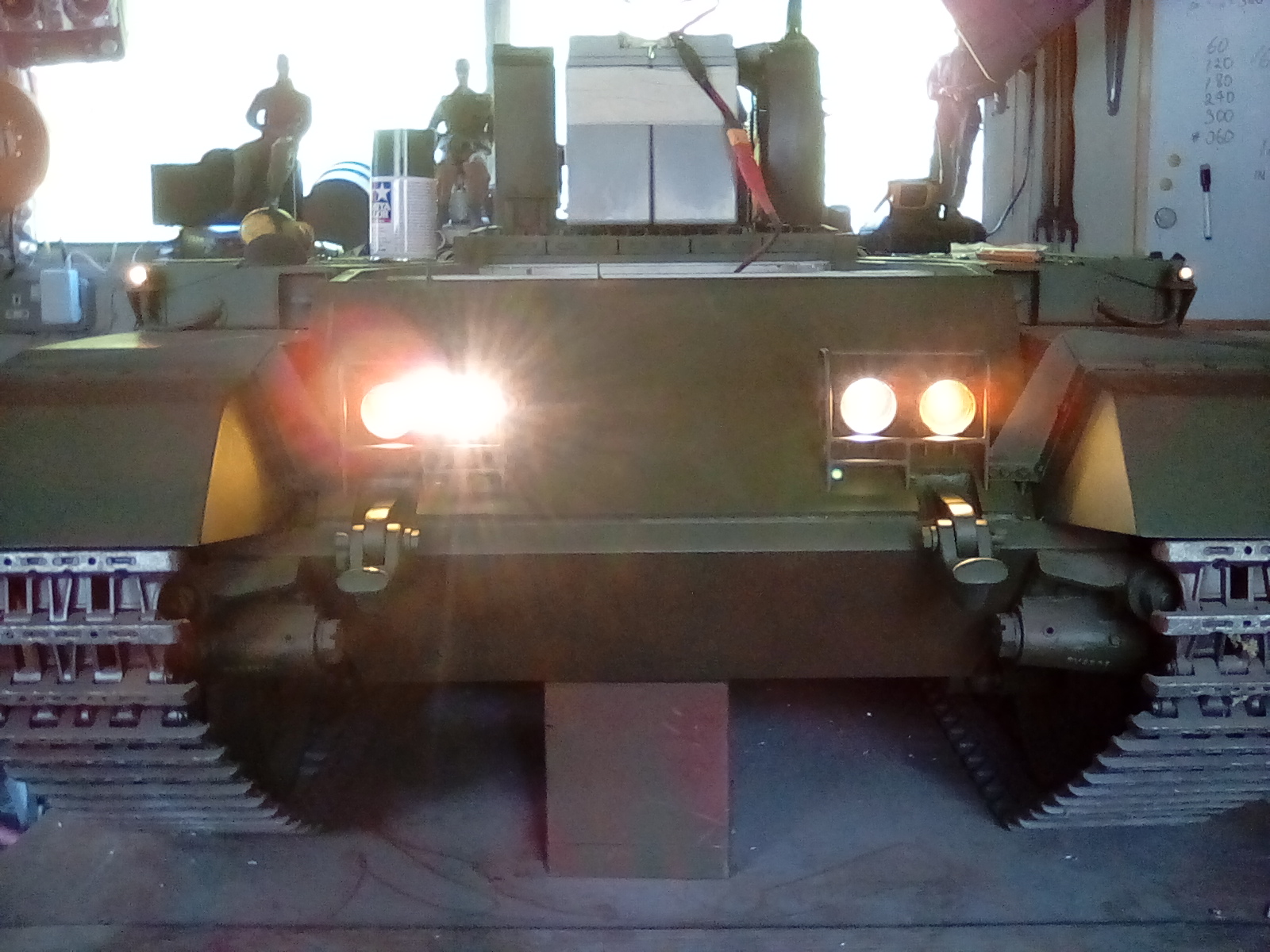

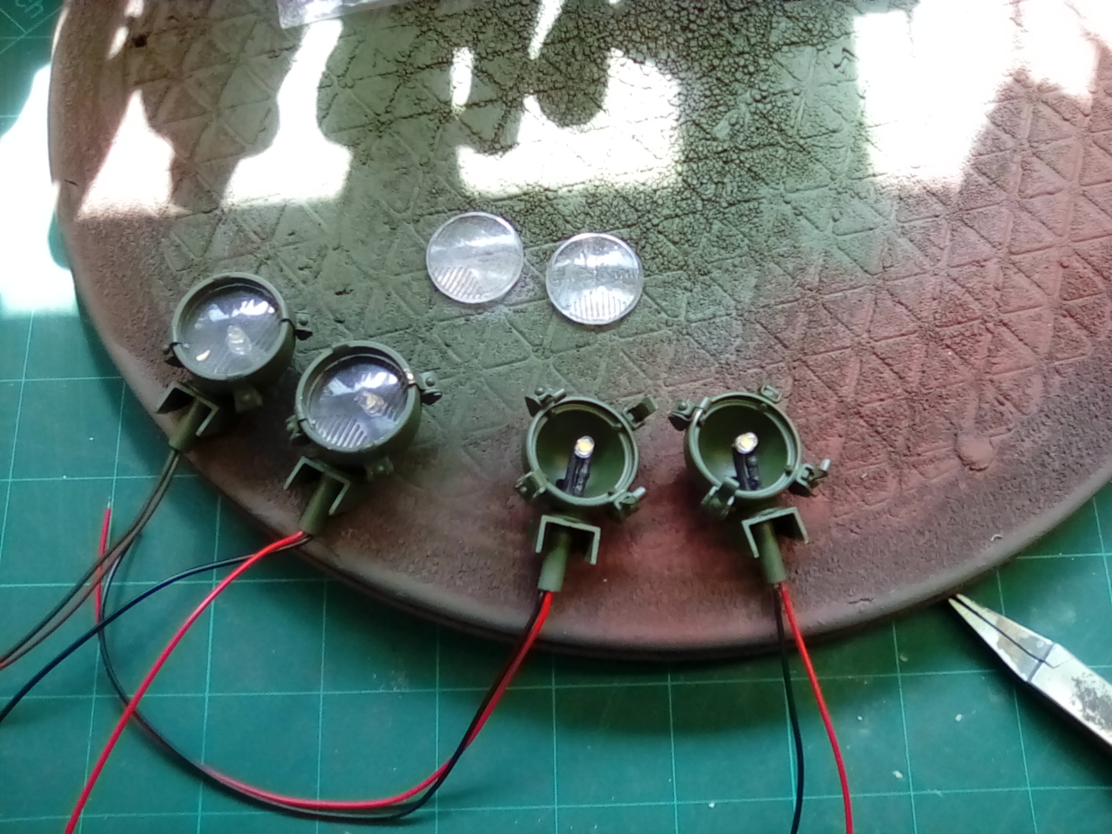

The outer lamps will be tinted very dark to replicate the IR
This switch for the head lamps Mr Dawe

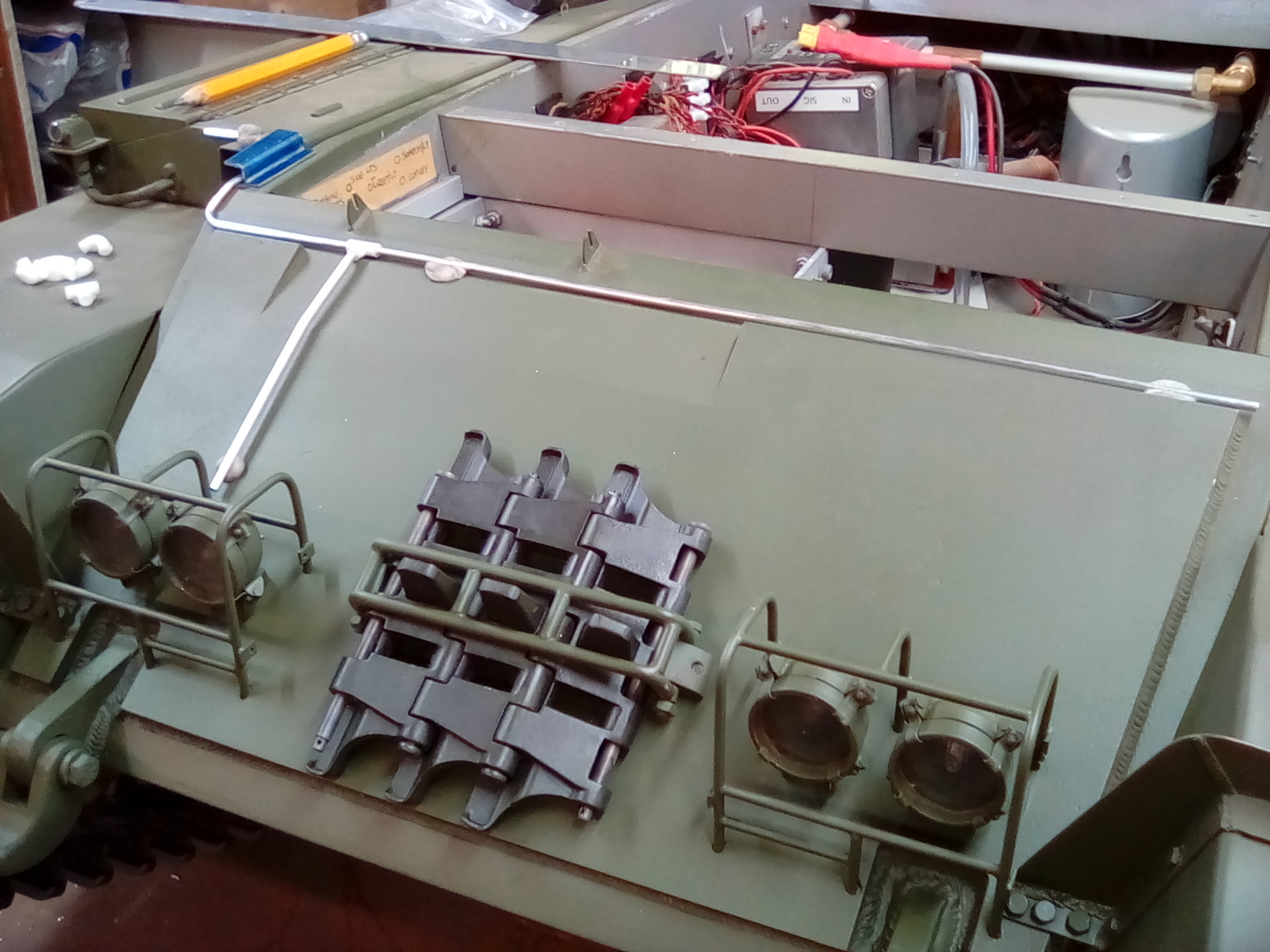

Starting to think about the conduit

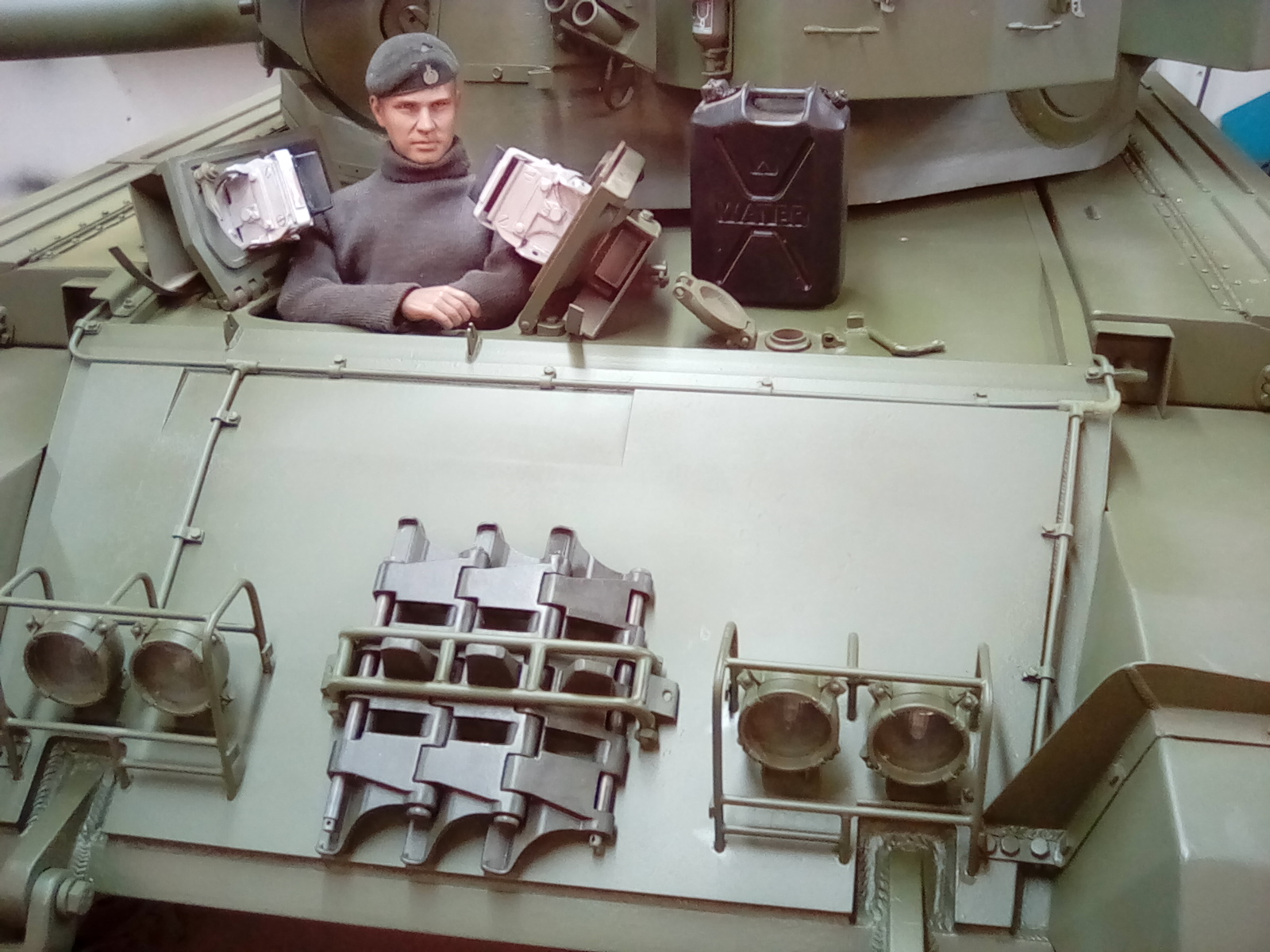

Working in the cool of the morning today rather than the heat of the afternoon.

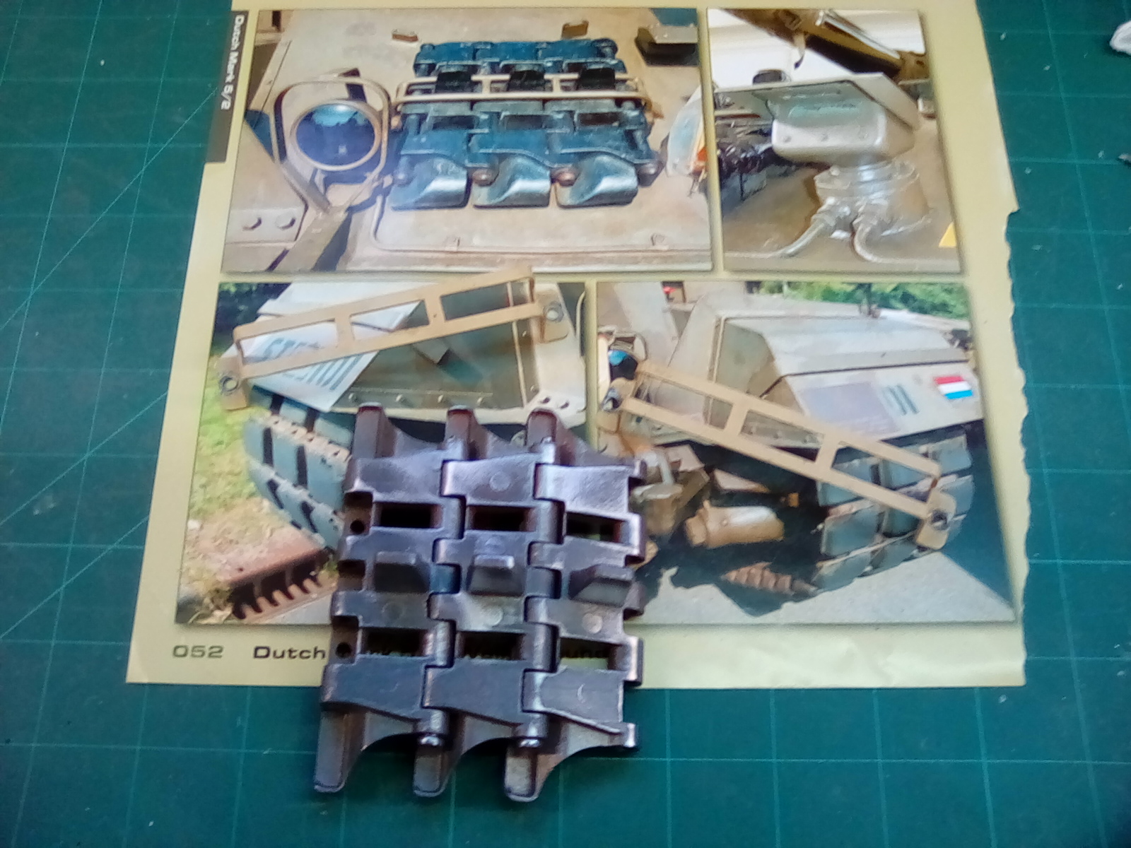

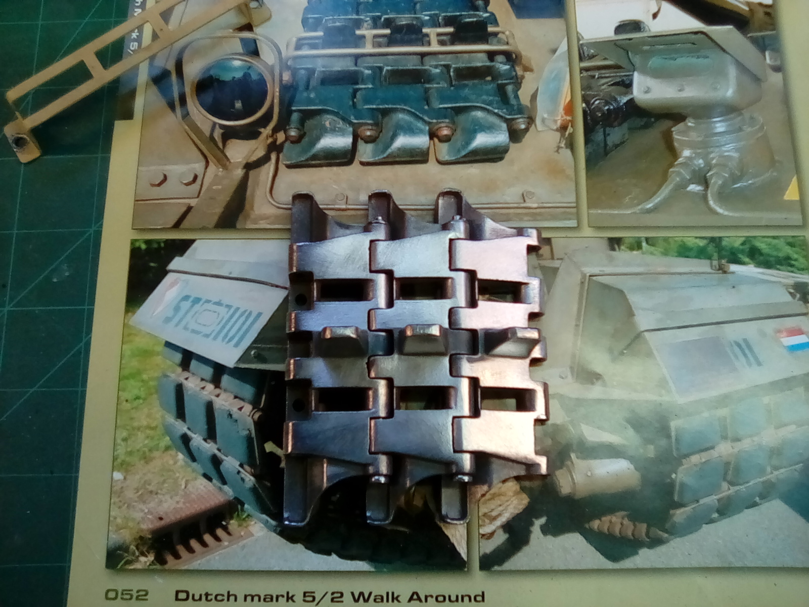

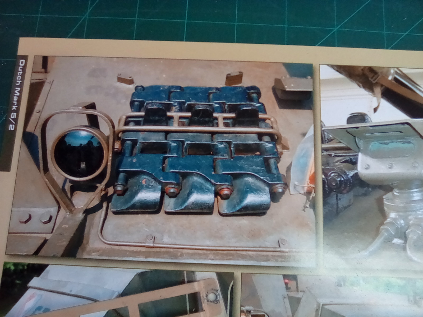

The naked links and the kit track holders
Some dressing of this side of the track links is required as they are on show
I'm going to use the peg method to mount the blocks
Not easy but with some thought it gets done

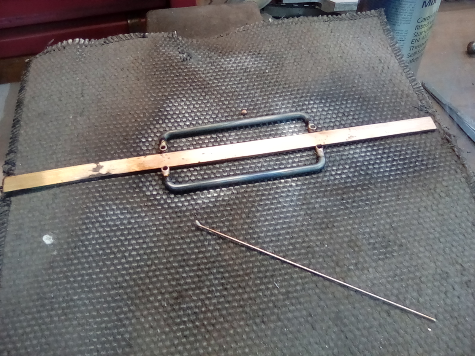

All silver soldered
All silver soldered
Just need to clean it up , fit the mounts, peg the mounts and paint.

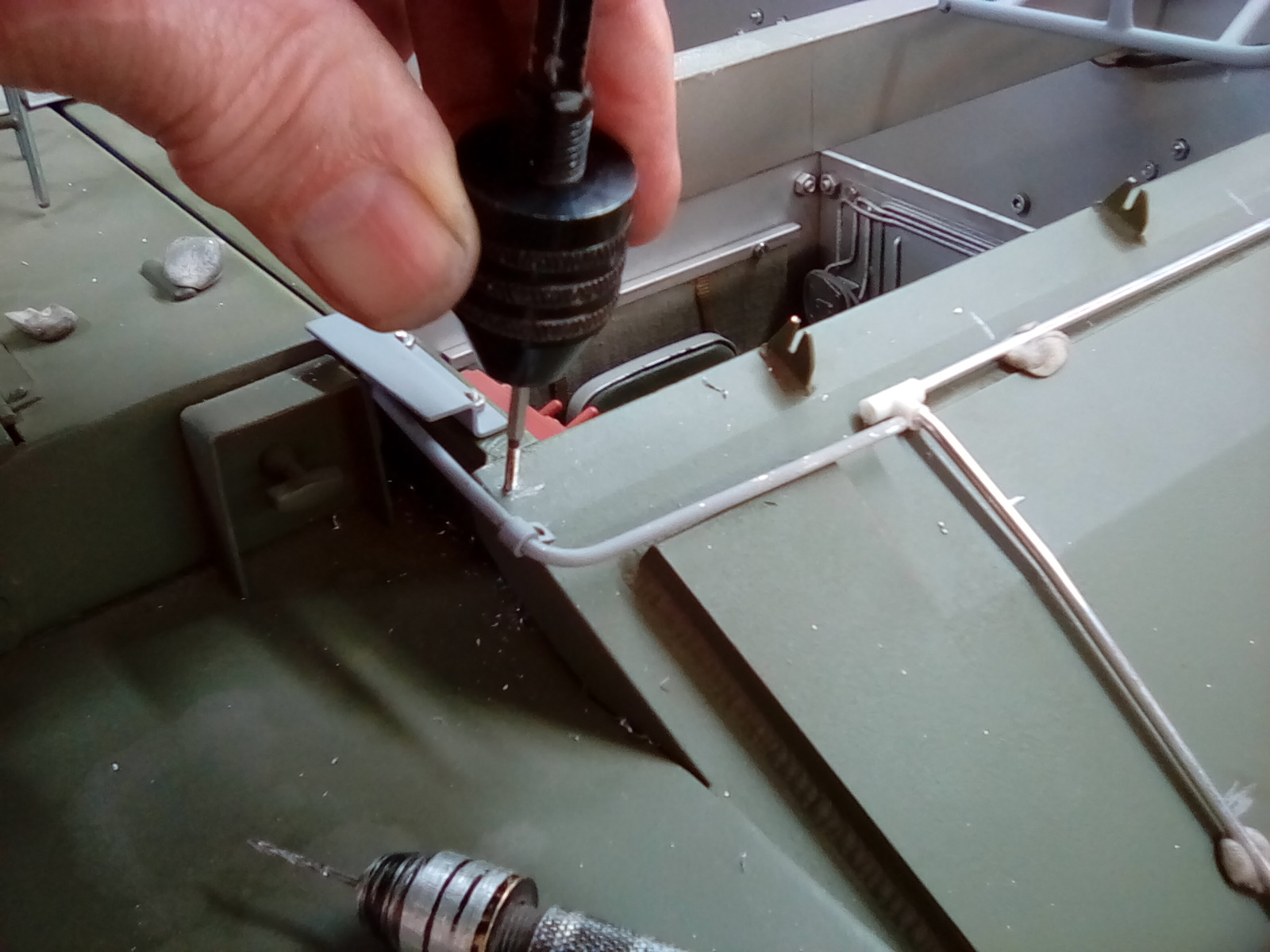

Finished the track holder and made a start on the oh so awkward conduit.

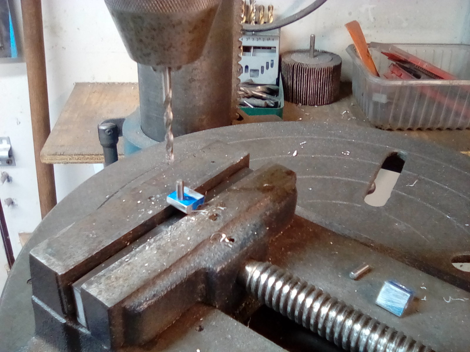

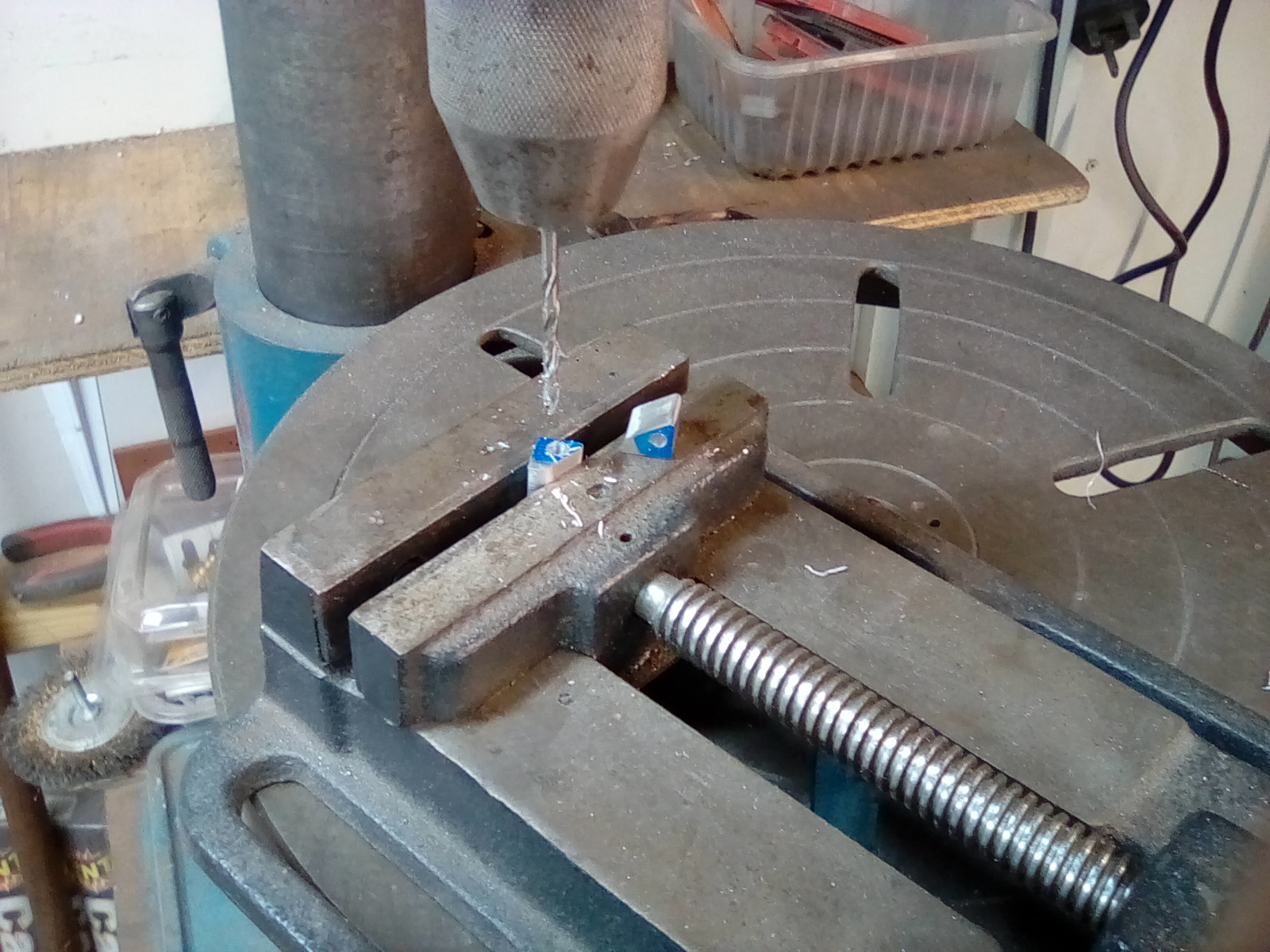

Careful drilling
Careful drilling

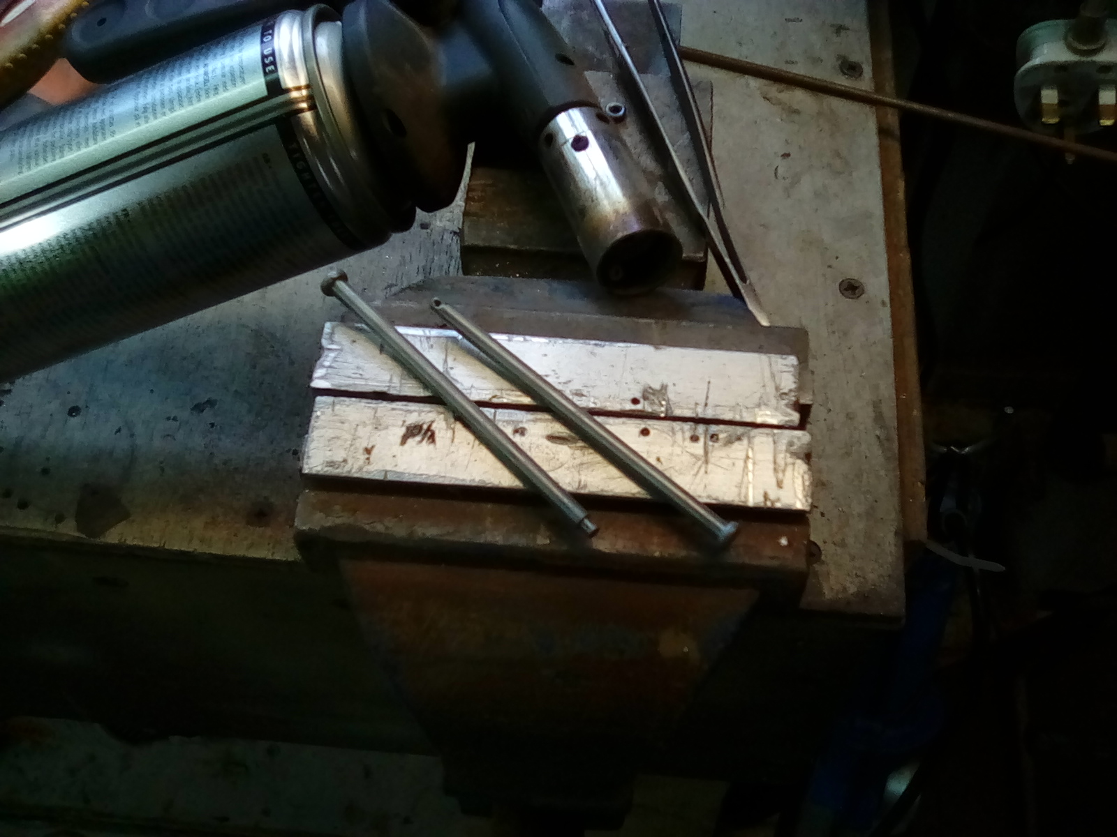

The pegs
The pegs

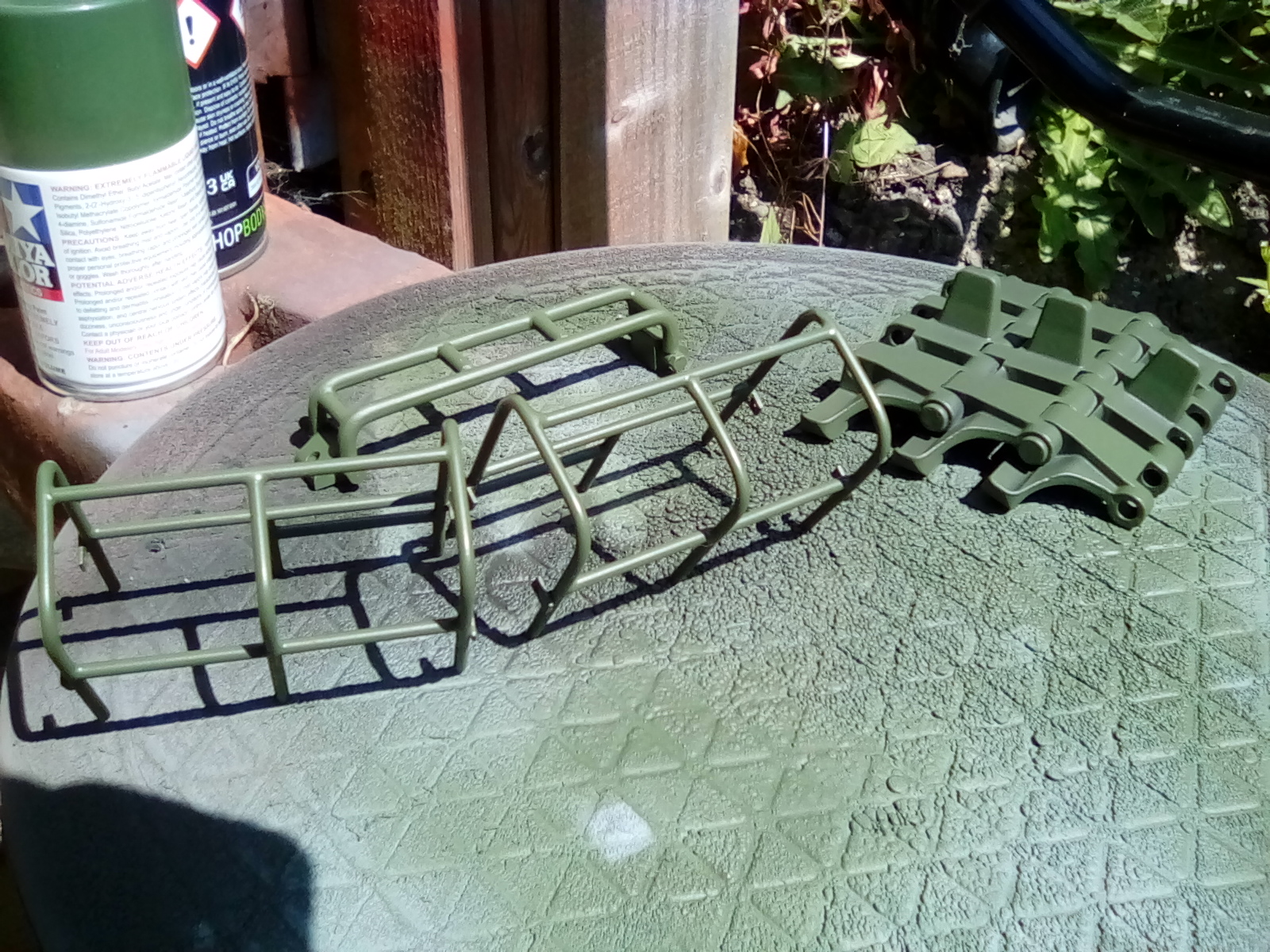

Loads of paint, we will get through maybe 20 cans + of Tamiya ts range and as many large primer cans during the build

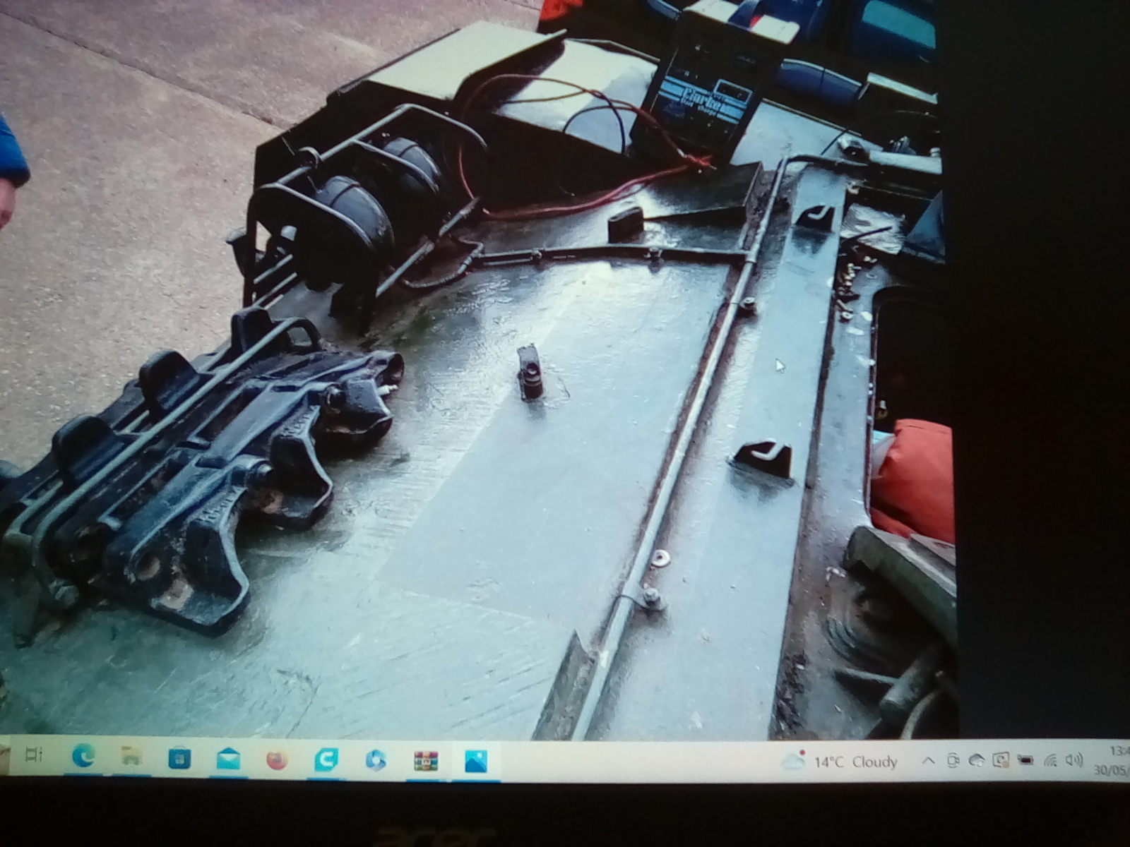

That conduit protection armour piece is proving difficult to find good reference photos of,  there's always something in the way.

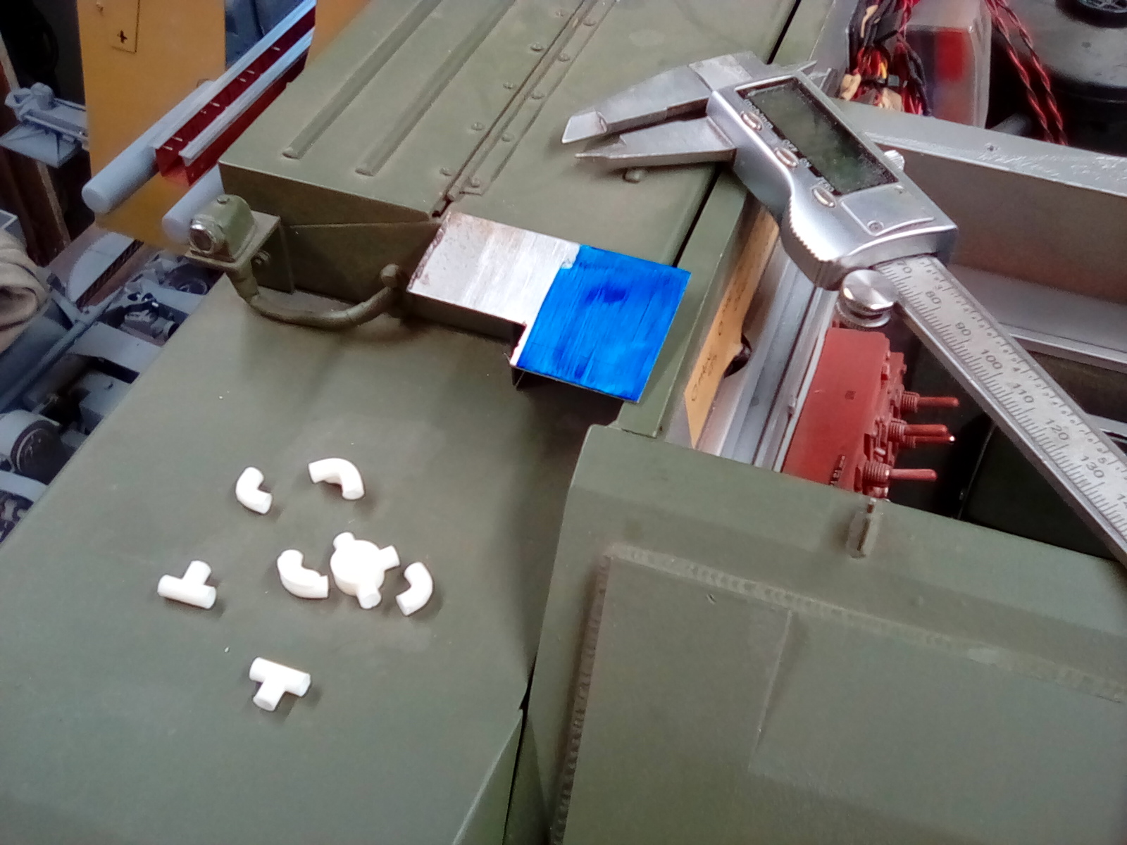

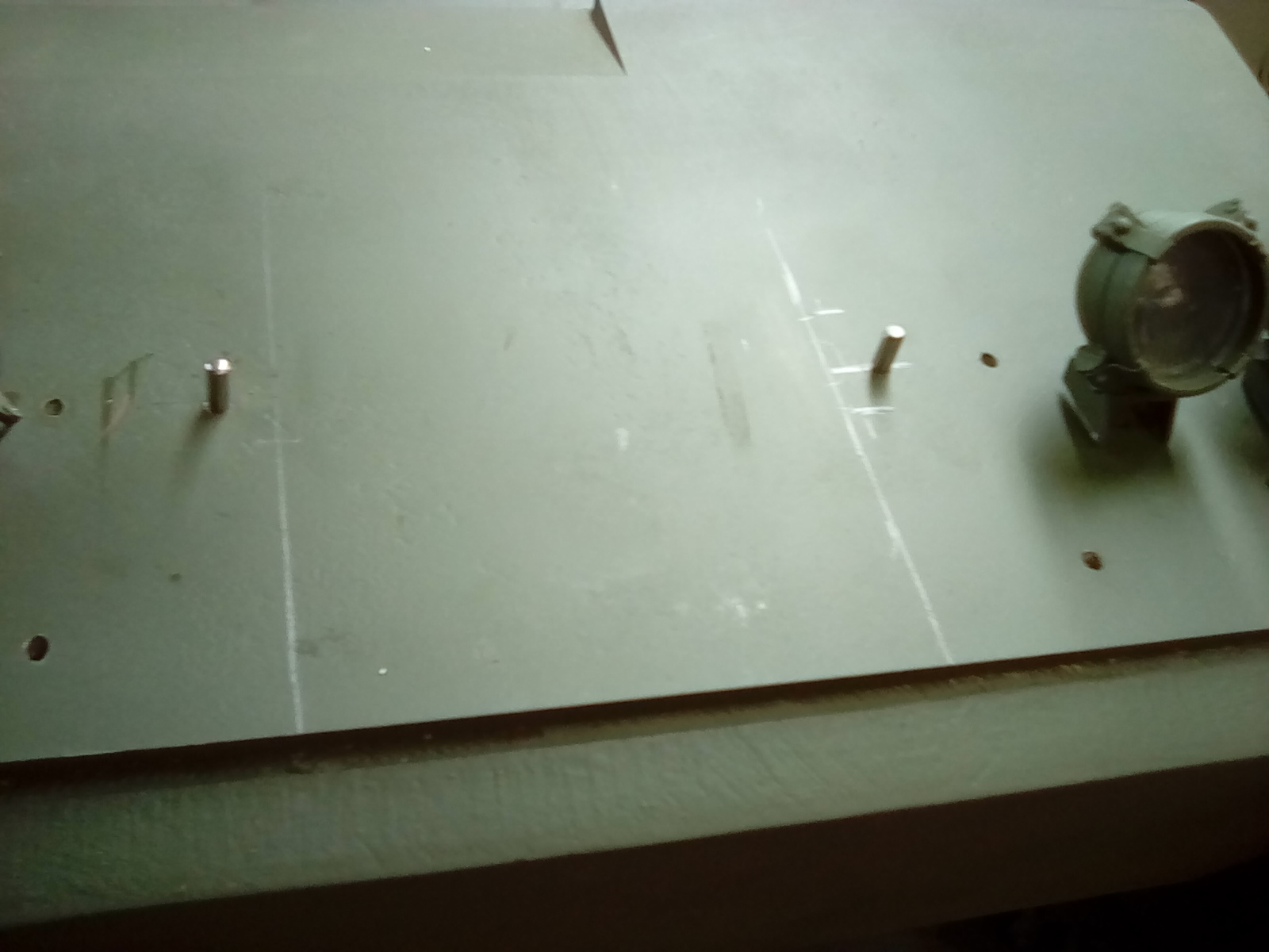

Modelling clay helps with setting this lot out

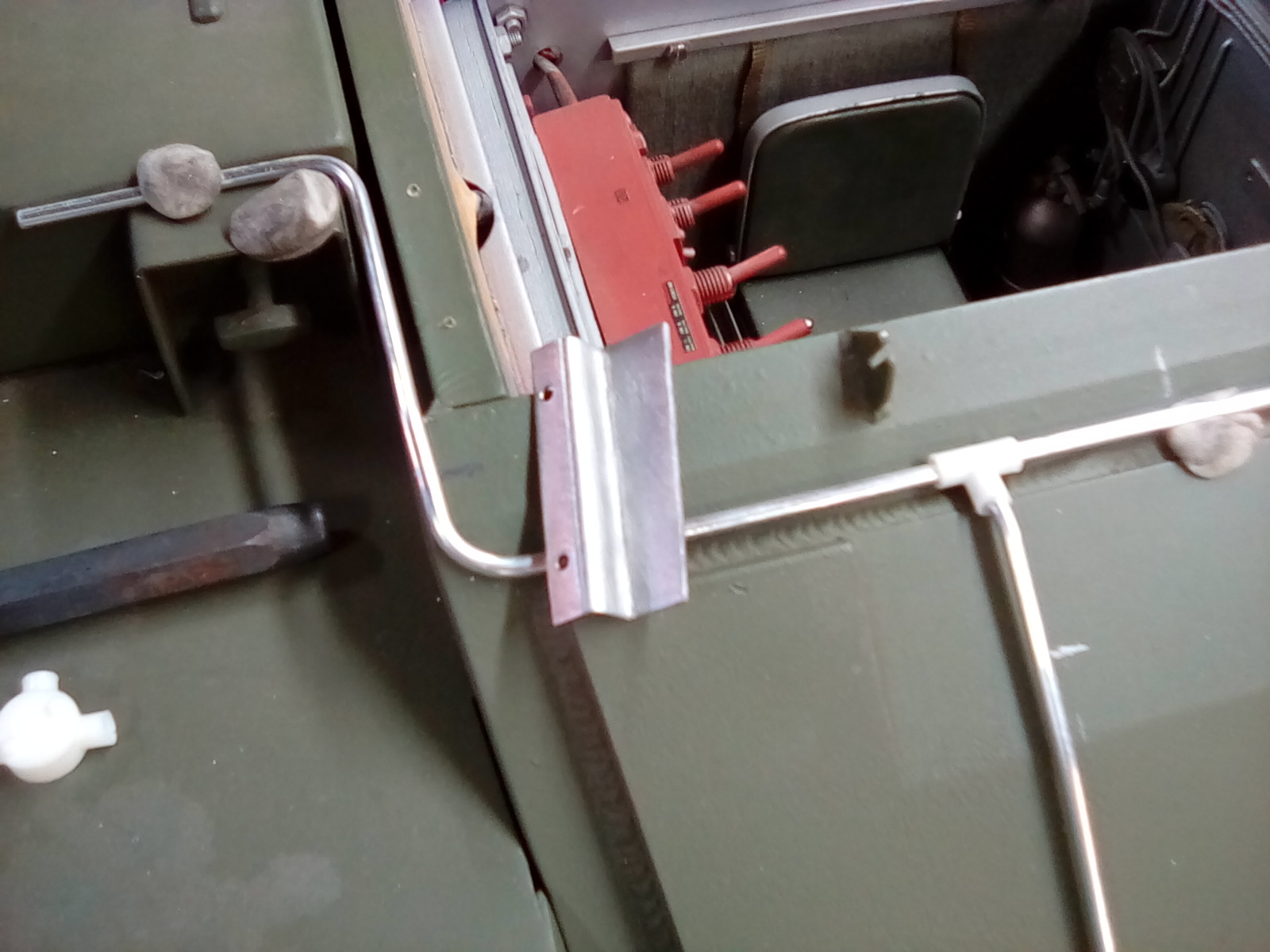

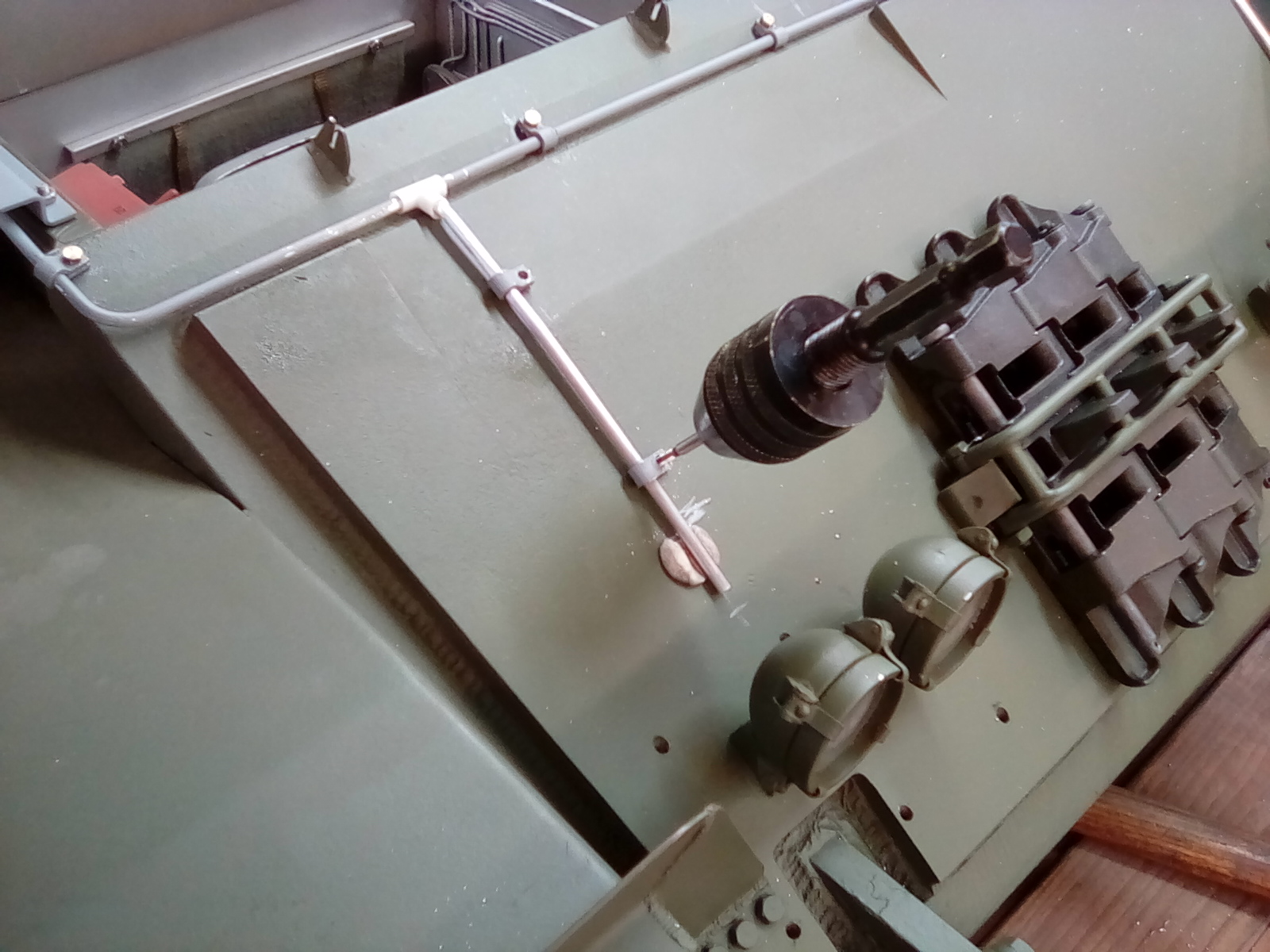

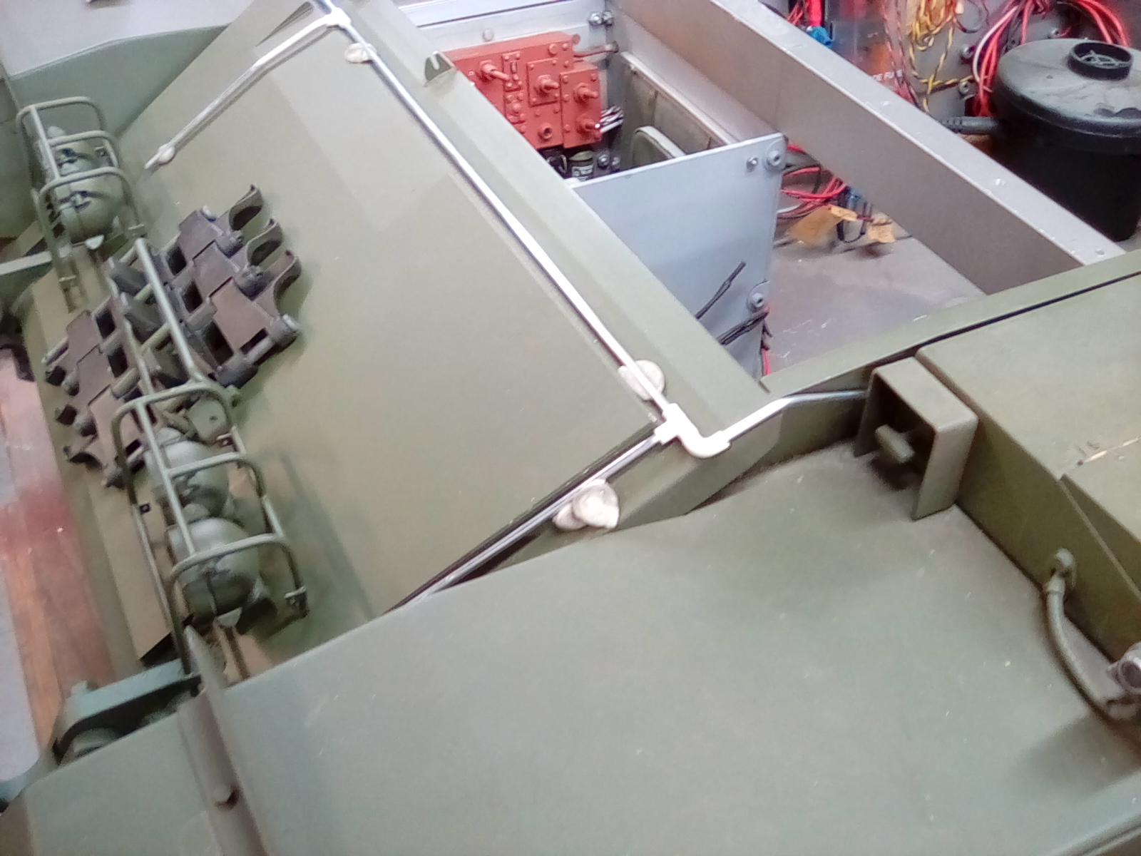

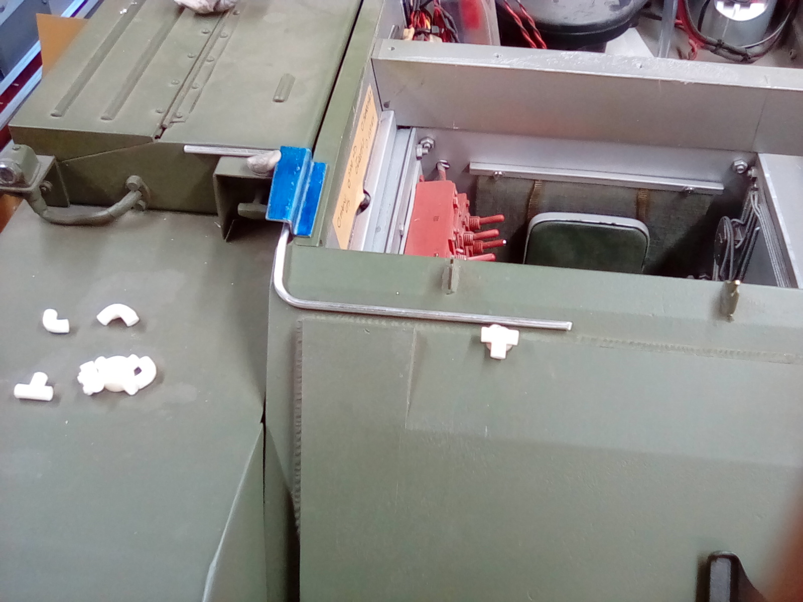

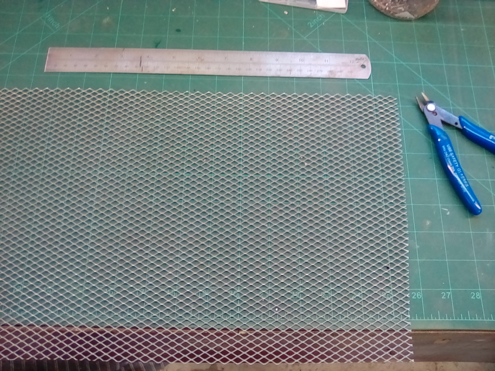

Moving along with the headlamp conduit, the mesh arrived today but I'm a bit concerned that we won't have enough!
If anyone would like a piece of mesh please let us know .

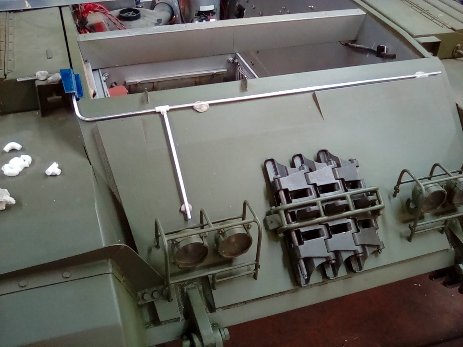

I don't really know where the conduit goes off to on this side but it does go off there
The real conduit wasn't very tidy but ours will be
This side conduit rises from below the headlamps

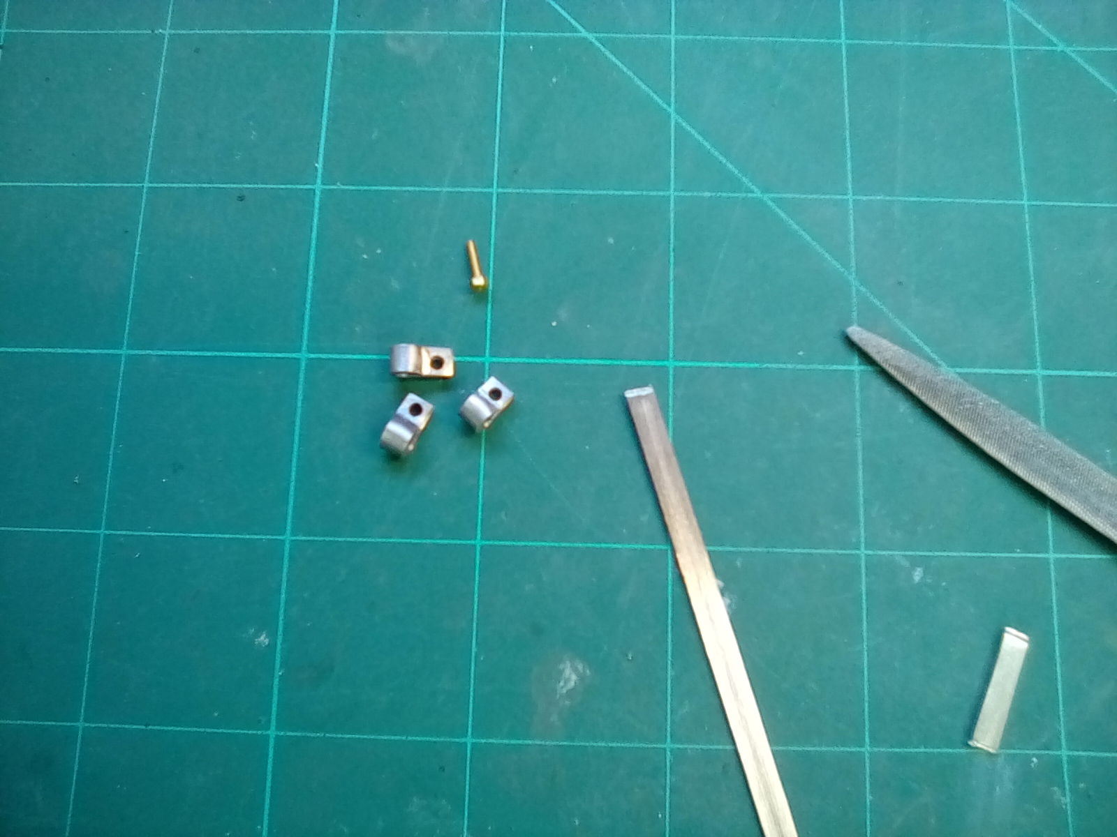

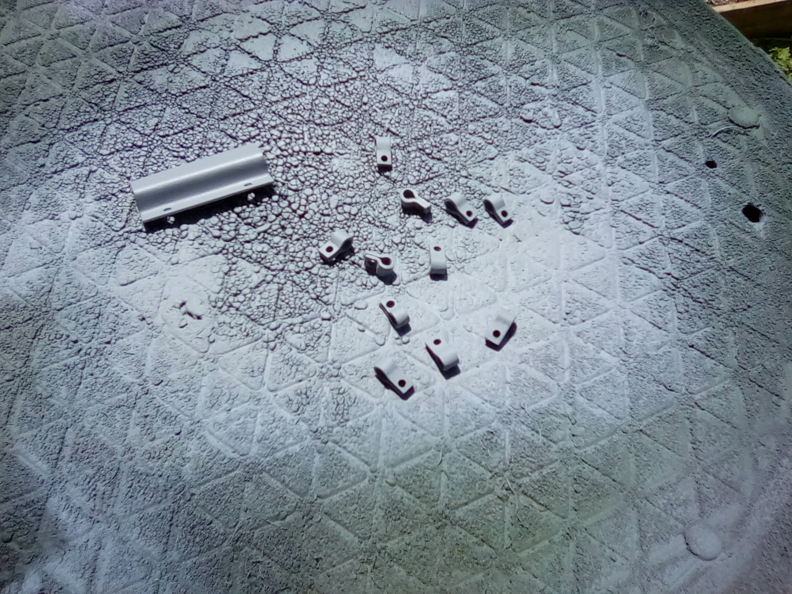

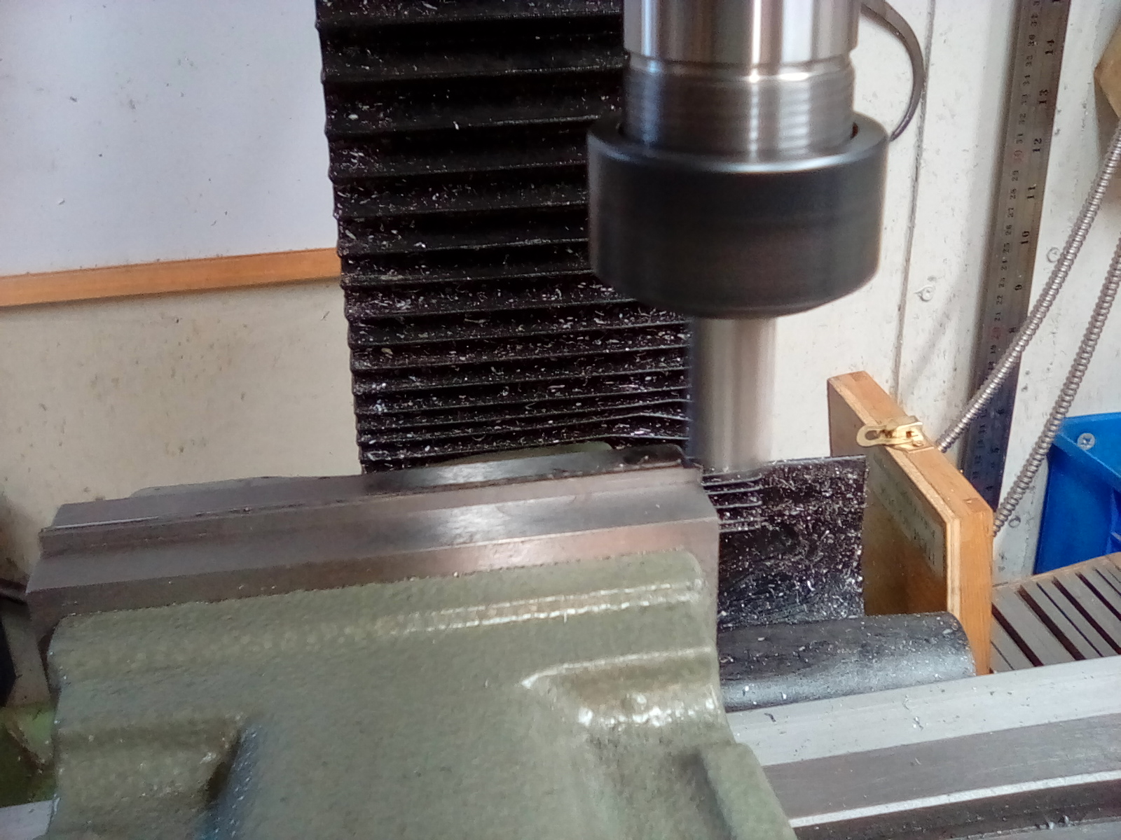

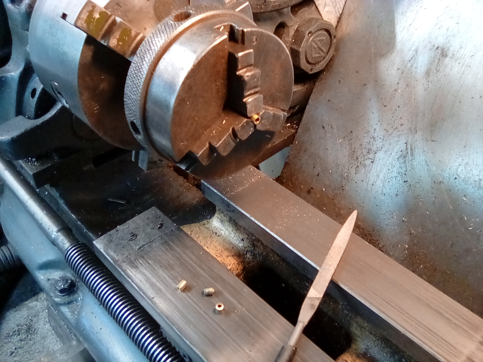

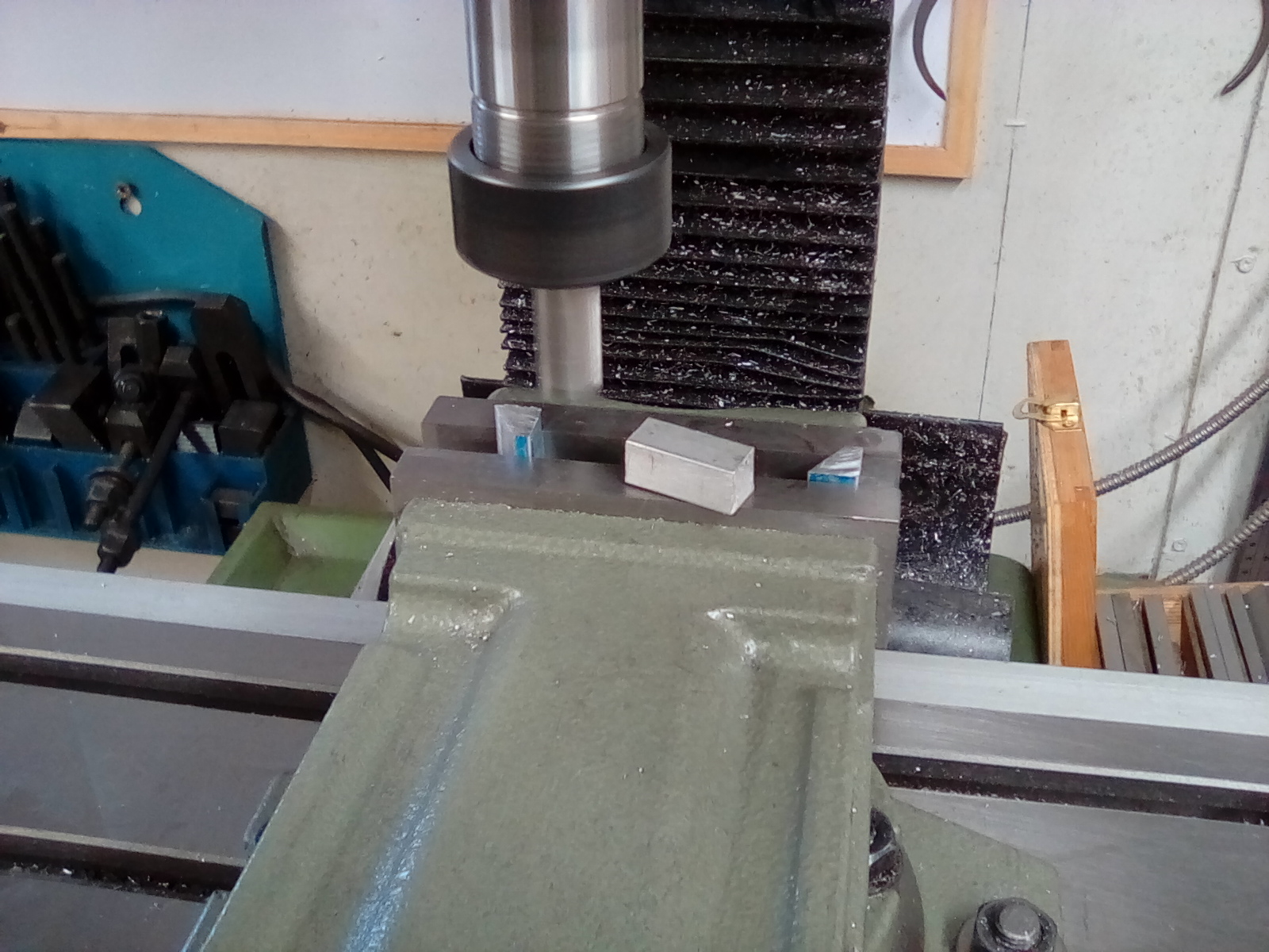

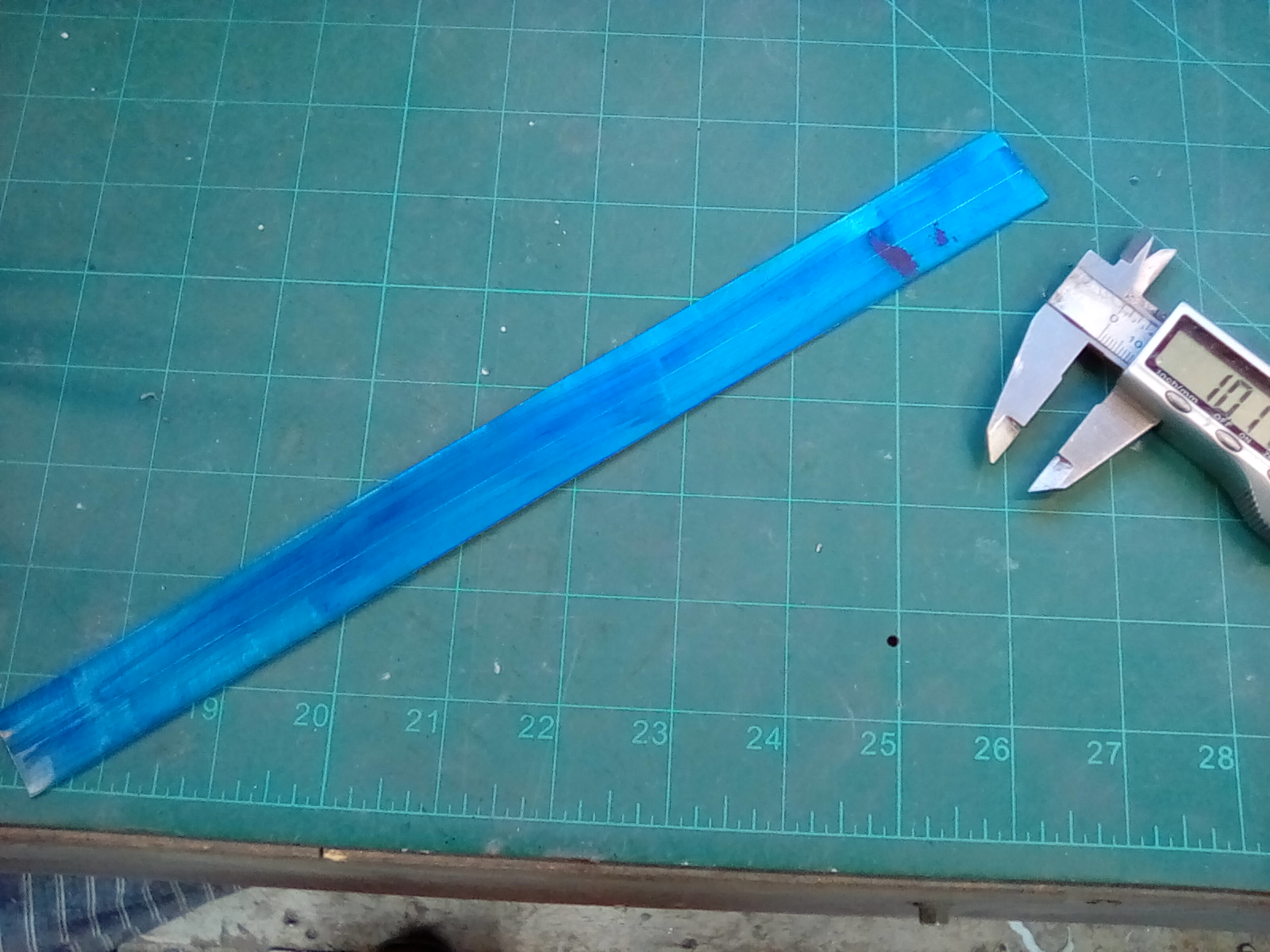

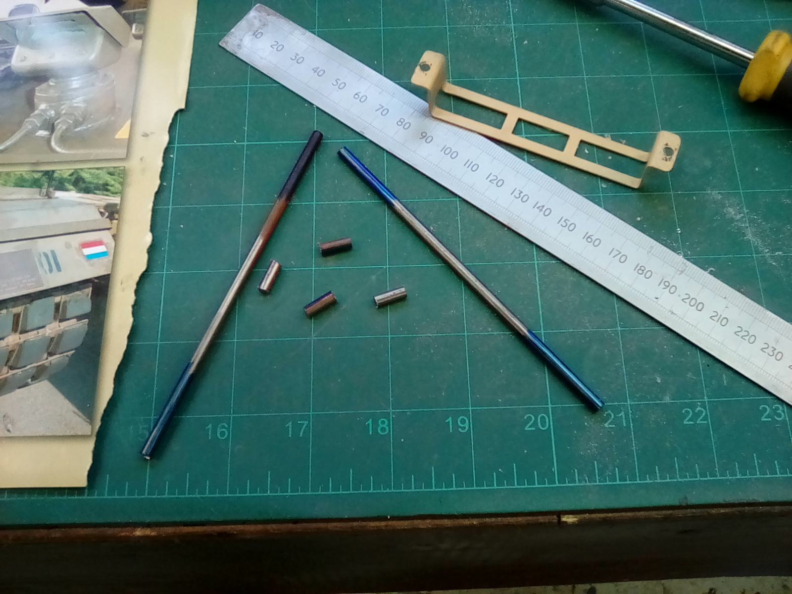

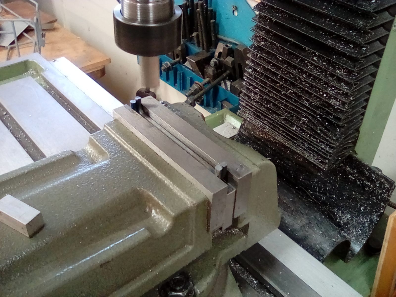

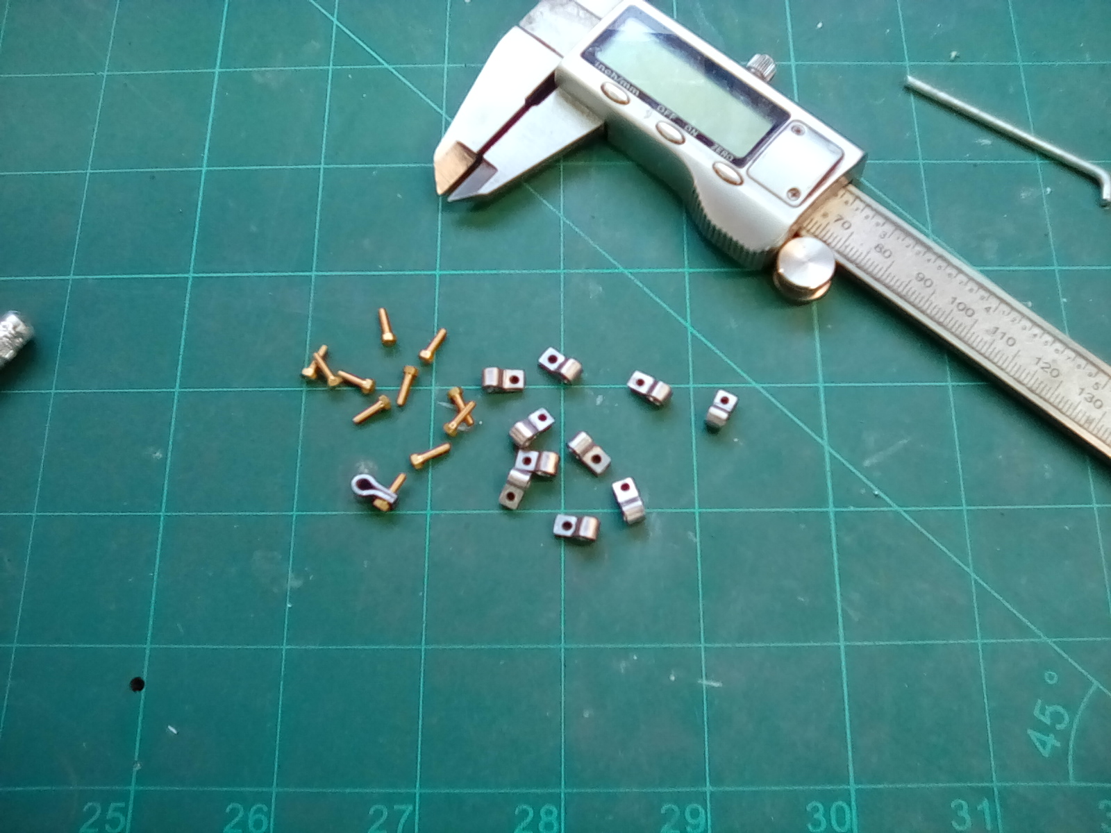

Milling down my stock strip for the p clips
10 to make
10 to make

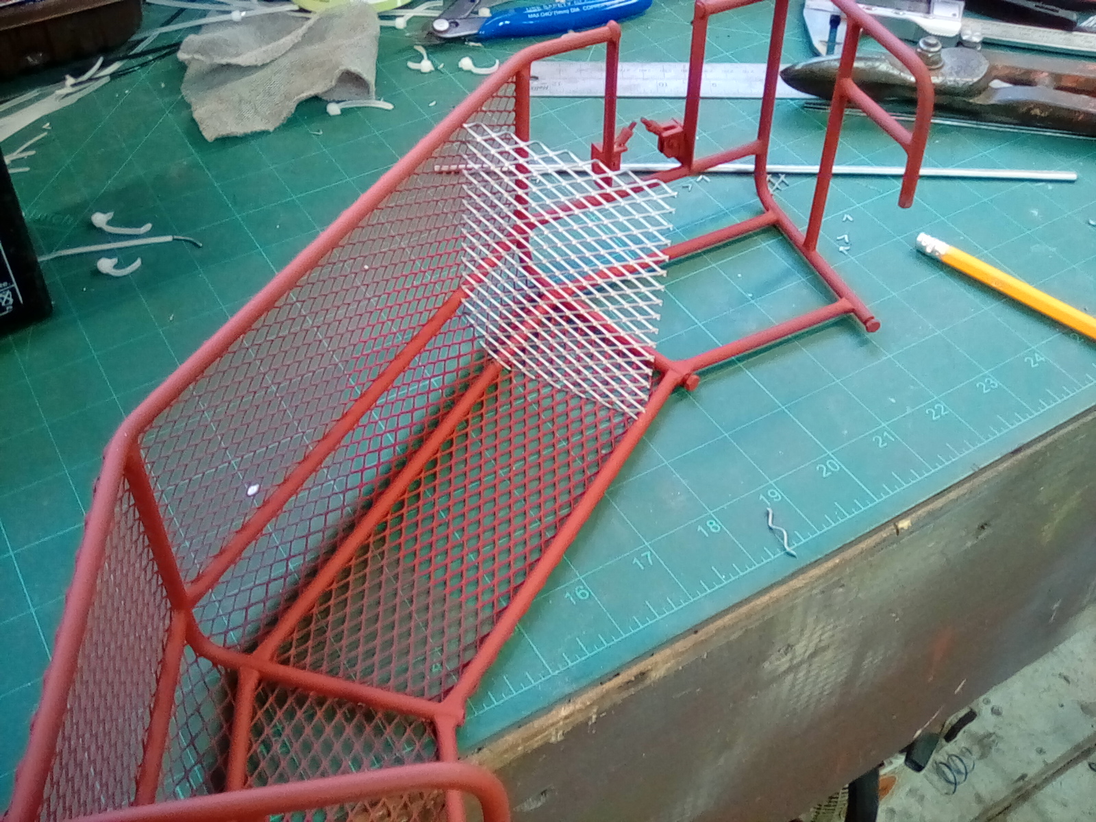

I'm not sure that there's enough mesh here.
Beautiful quality mesh for the turret basket and it's steel so if it shows through the paint some time in the future it won't look like it's made of 22 carat gold!
P clips finished with maybe one spare, I really need to prime all this lot before it's all bolted to the front plate

The mesh has definitely been worth waiting for. Phil W and I have discussed the fact we have more mesh than we need for the Cent and I am quite happy to make the mesh available to other modellers who may need some for their projects. PM Phil W or myself if you are interested.

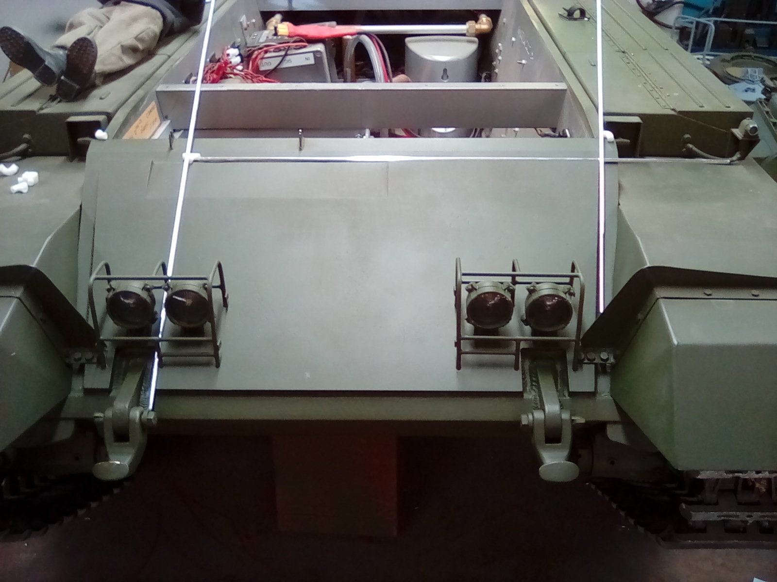

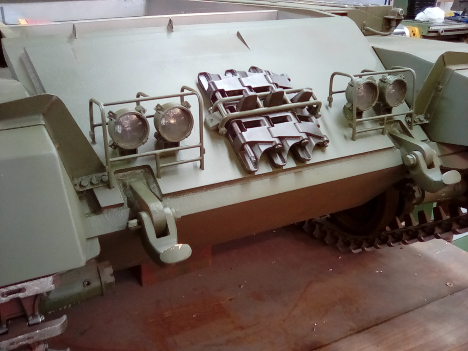

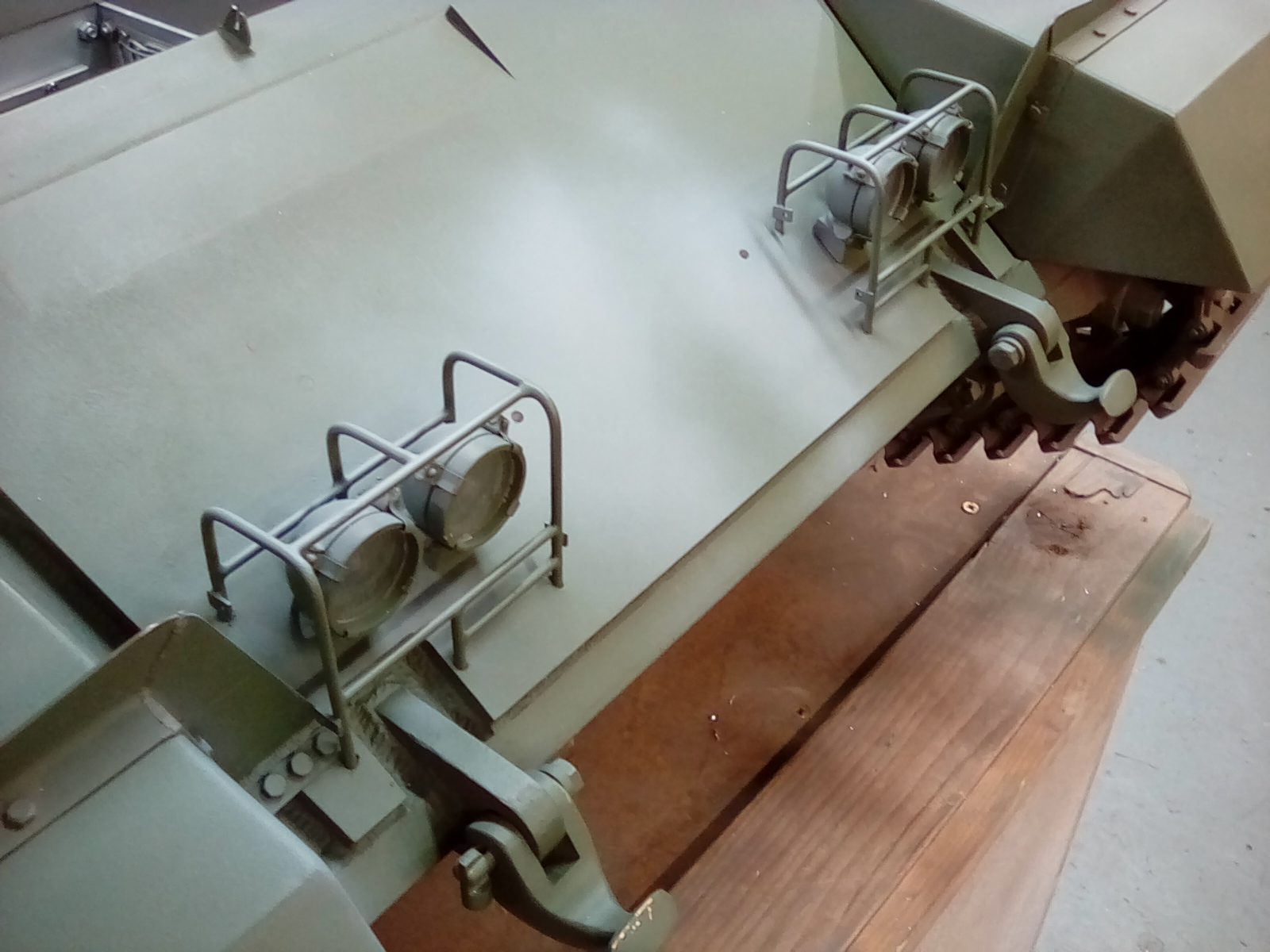

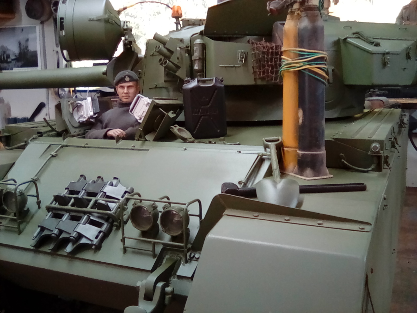

Working on that conduit and there's still away to go with the headlamp ends but nearly there.
I thought it was time for a good "look see" so I've taken a few interim photos.

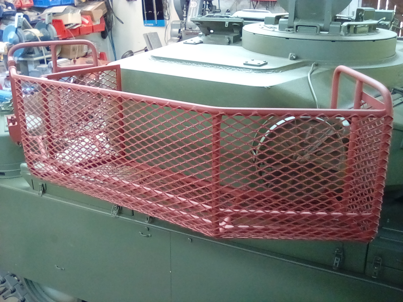

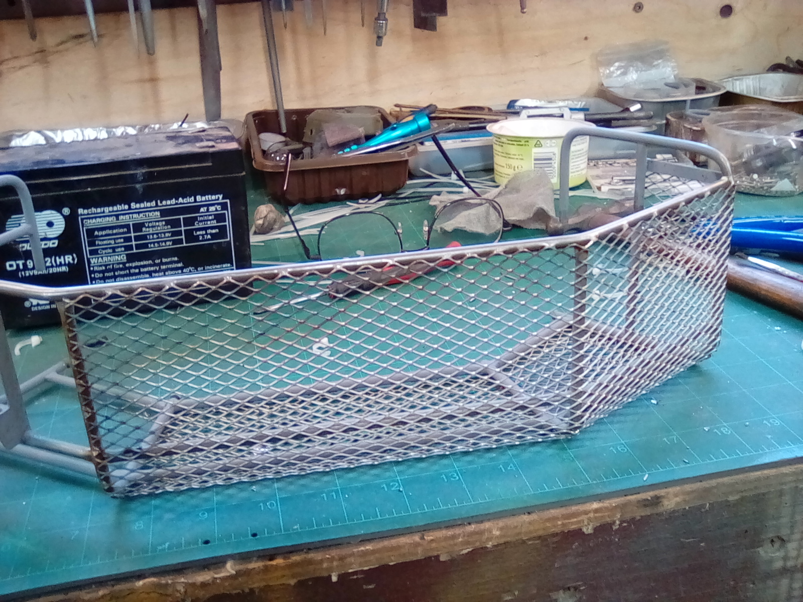

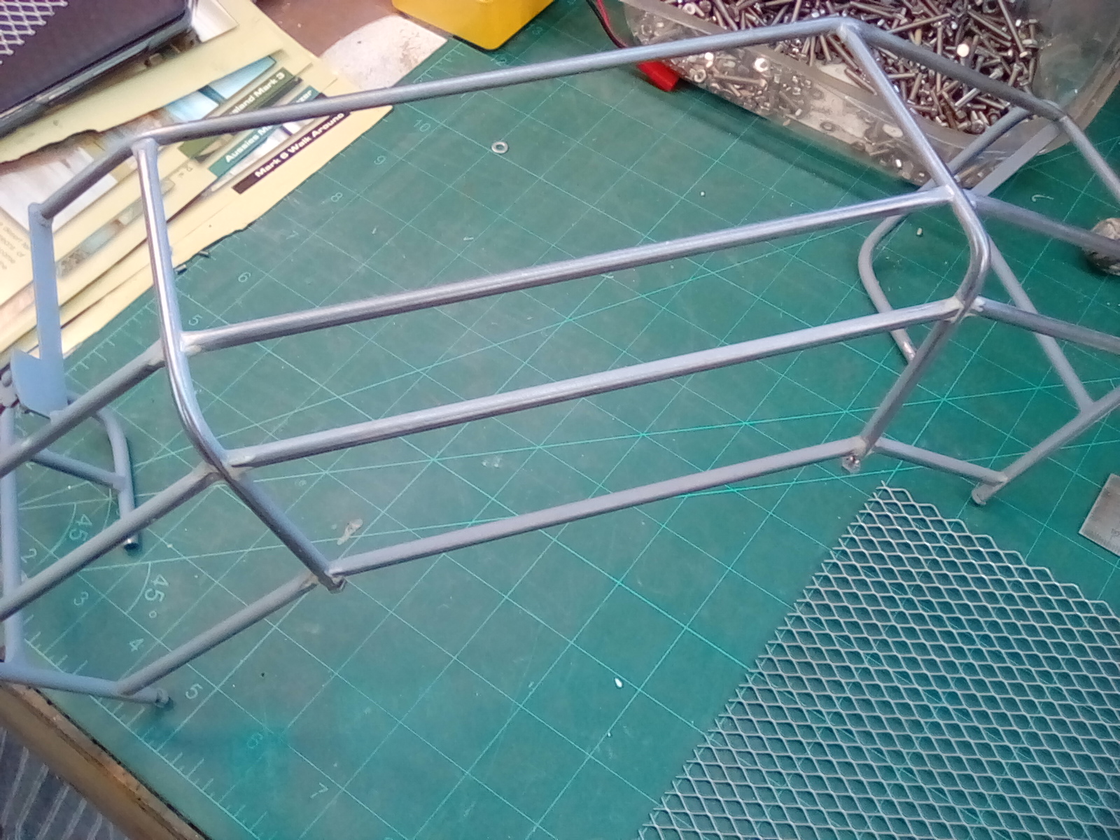

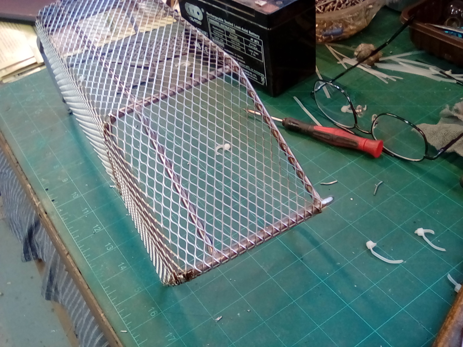

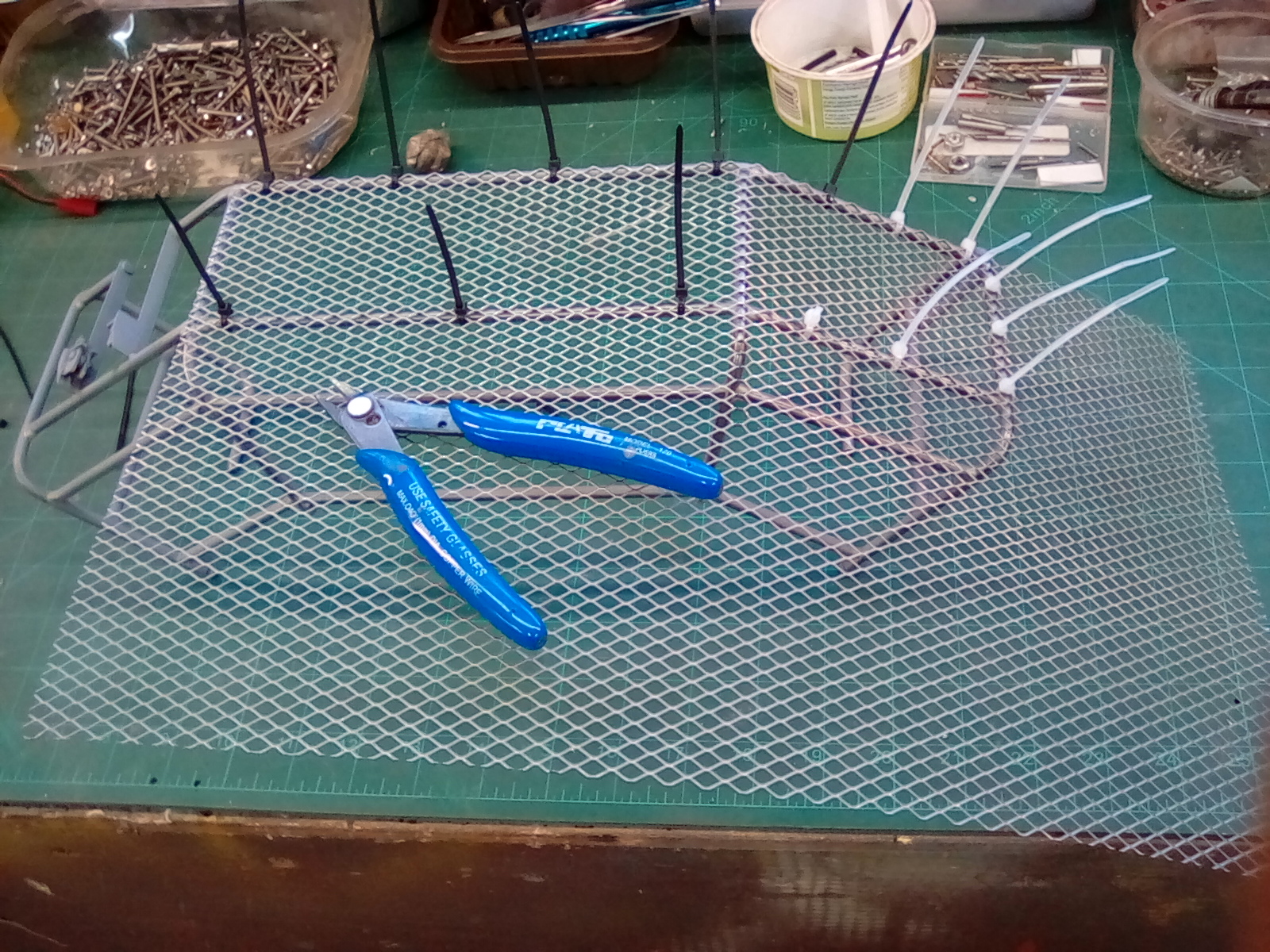

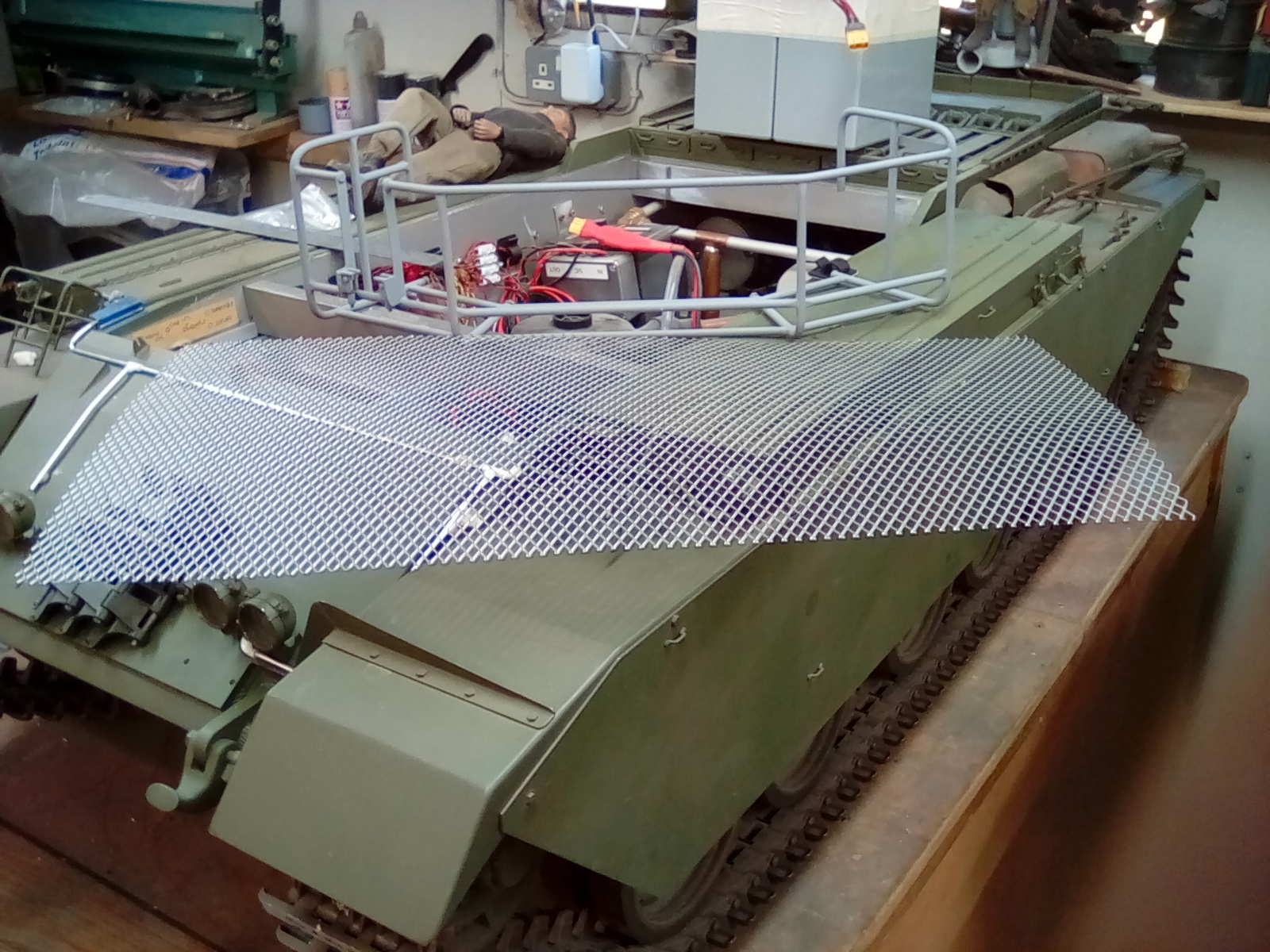

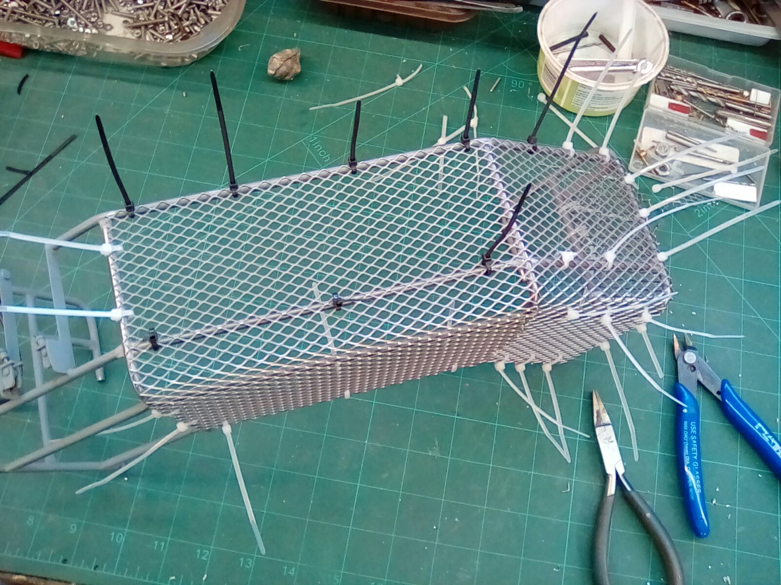

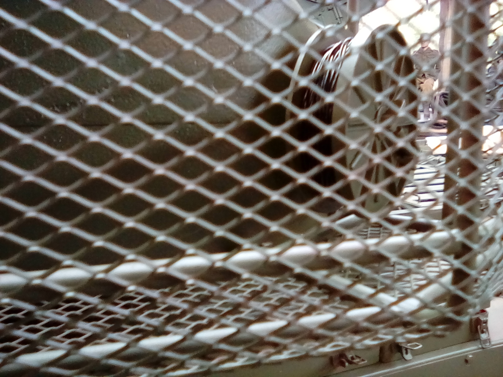

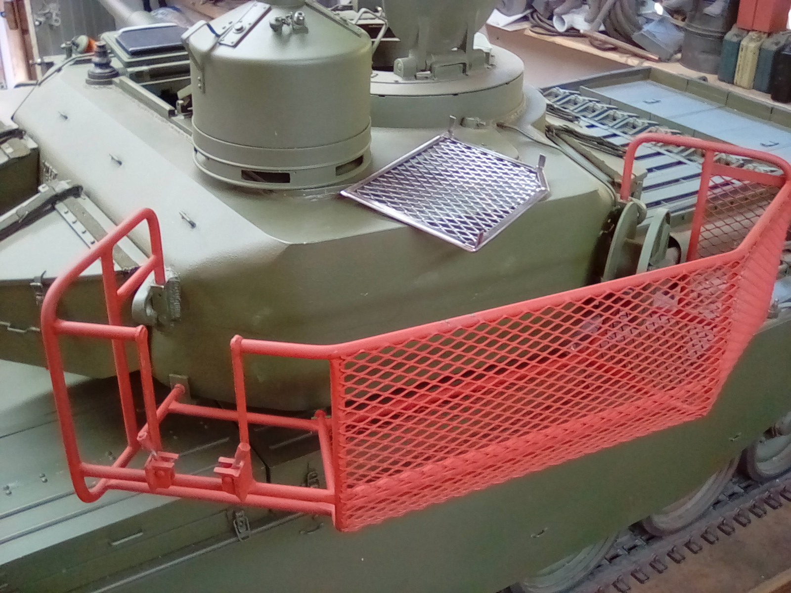

The mesh goes on, not an easy job for sure.
Very good quality mesh

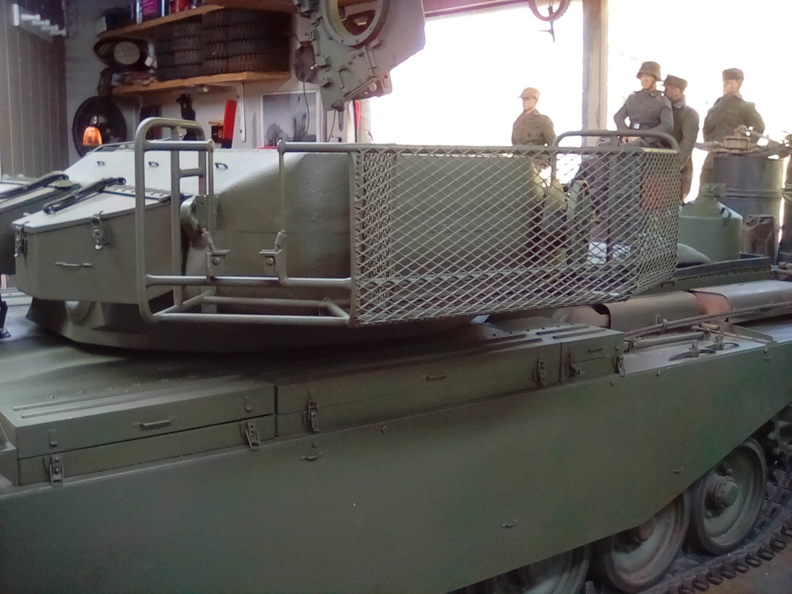

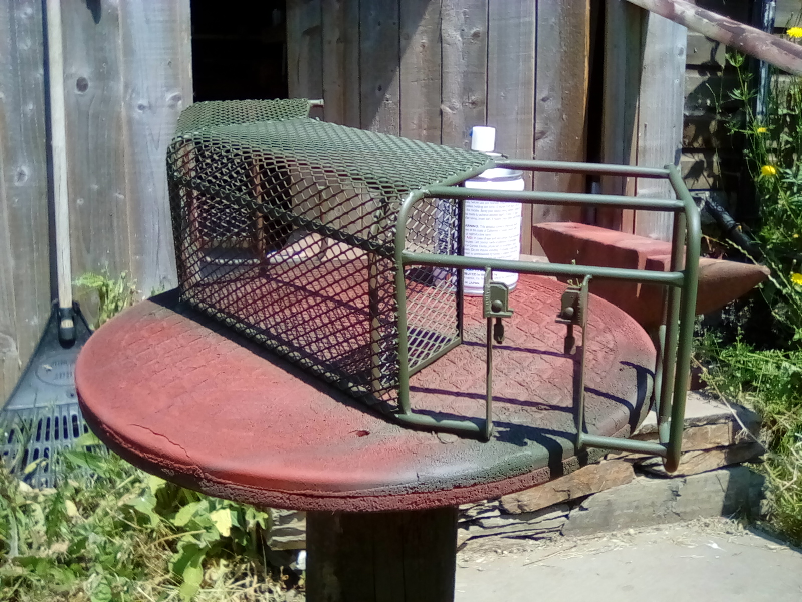

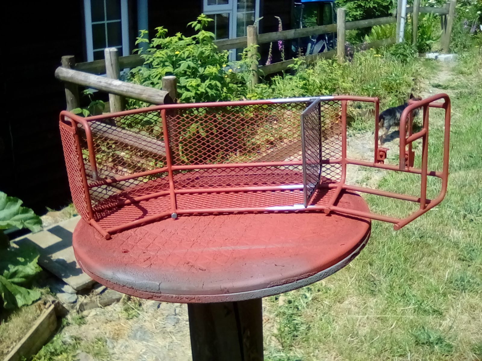

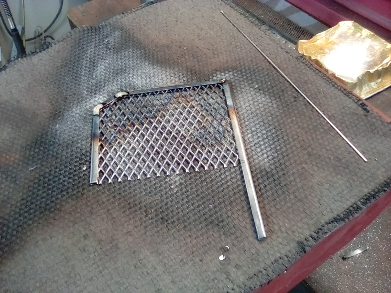

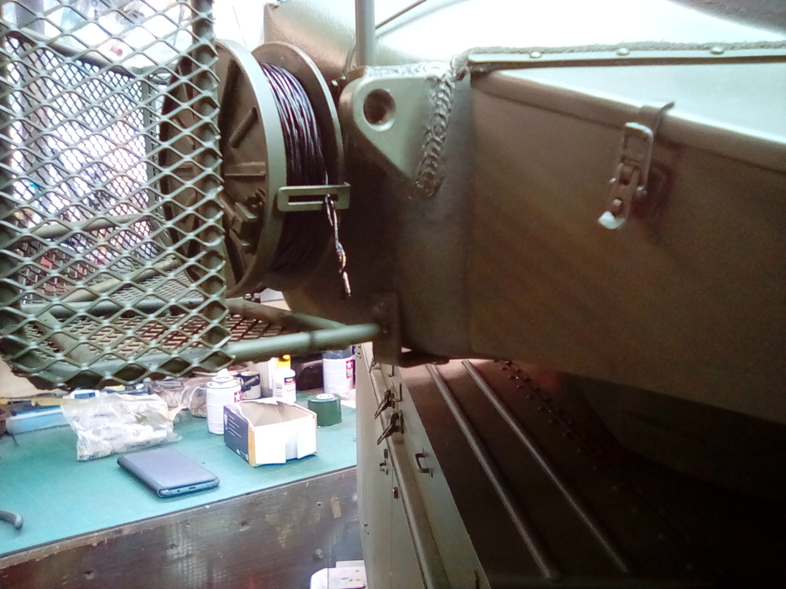

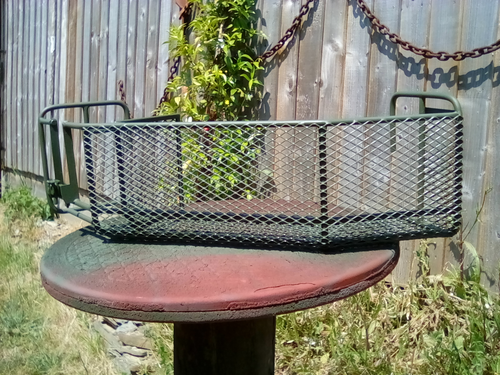

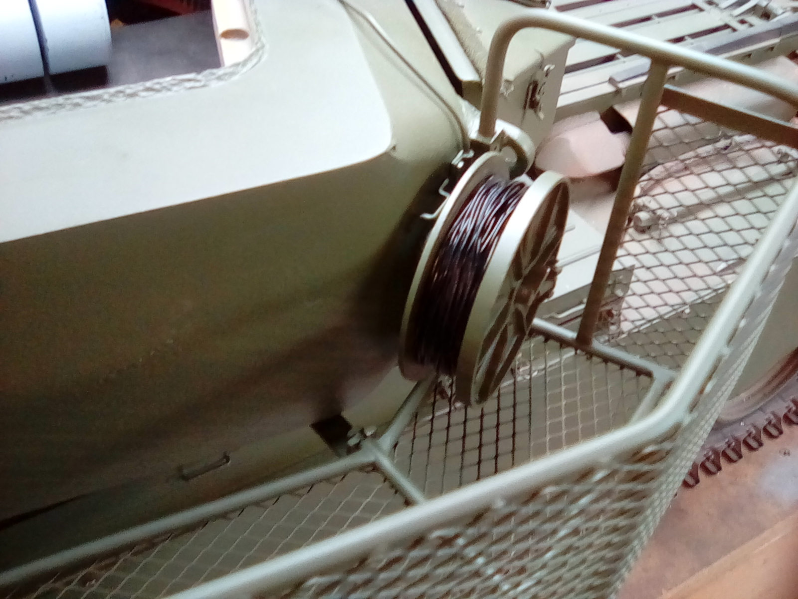

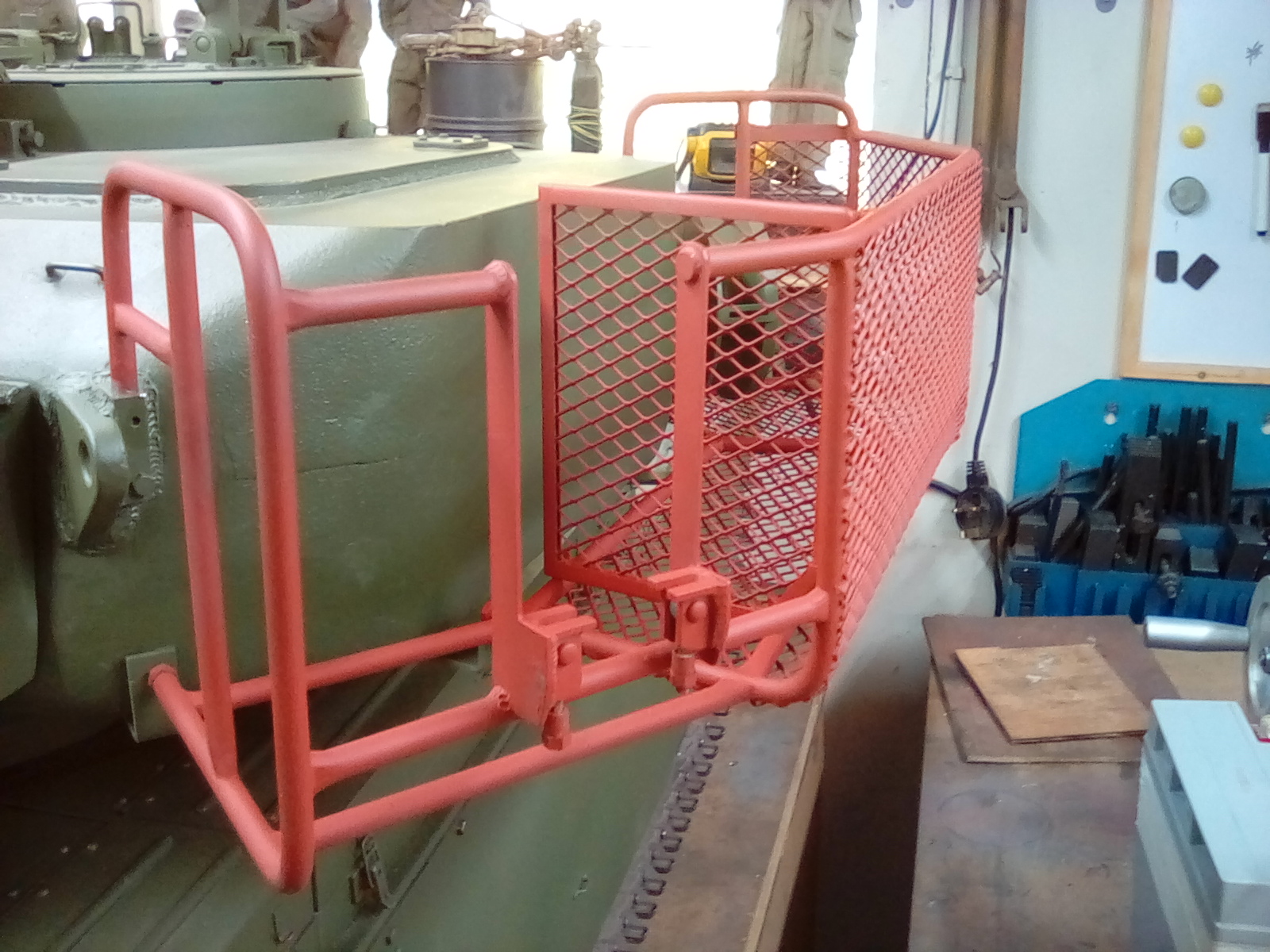

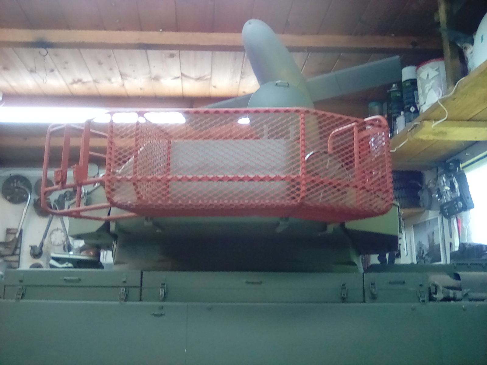

But for the top coat, the Don 10, the searchlight and all the stowage the basket is done!

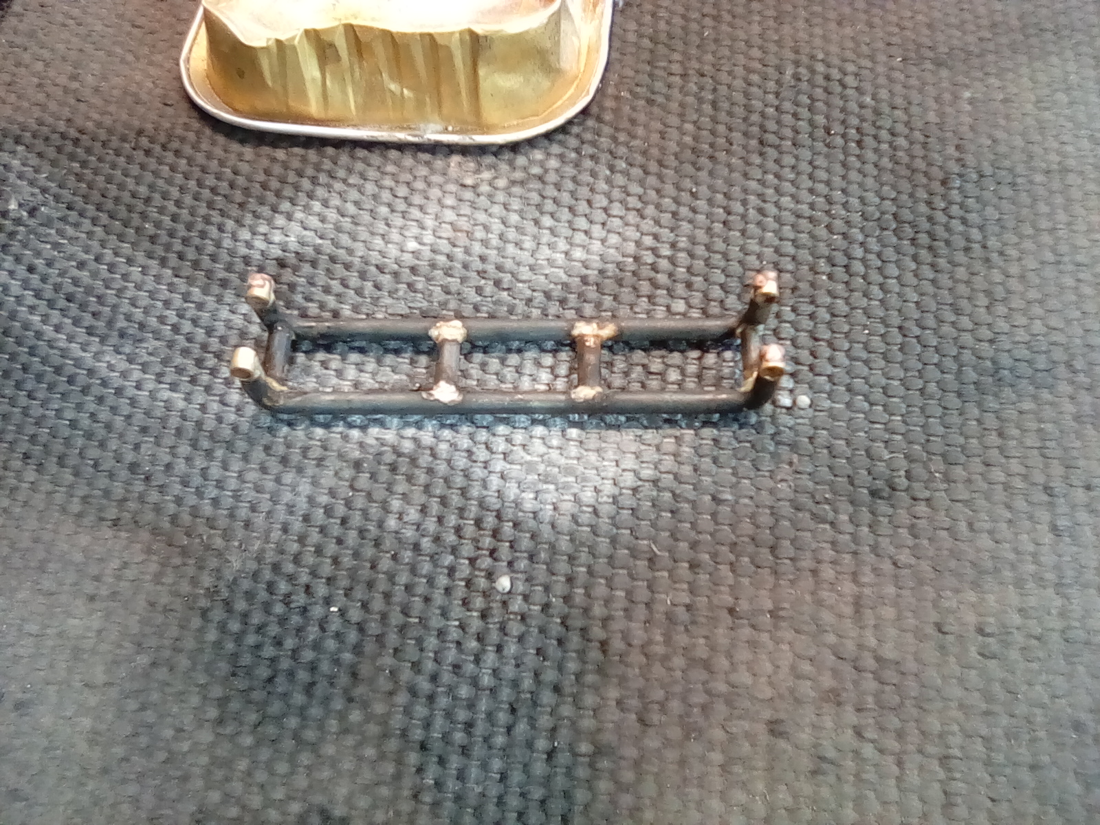

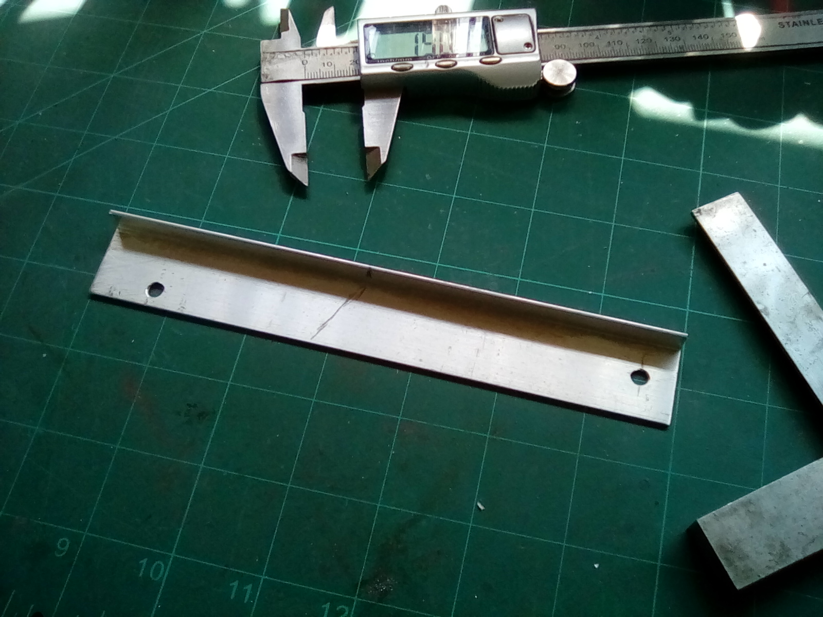

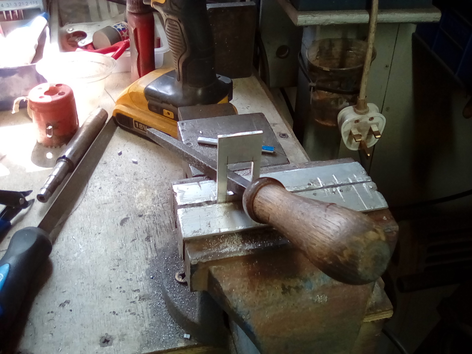

I don't have anything even close to the U channel used for the partition so I have to make it from sheet
The sheet is folded as far as my bending machine will allow, the rest is formed by hand
Silver soldered.......
.....and with fixing tabs
The partition is now soldered permanently in place
It's not fully pushed home just yet as it needs to be removed to wind on the don 10 and apply the top coat

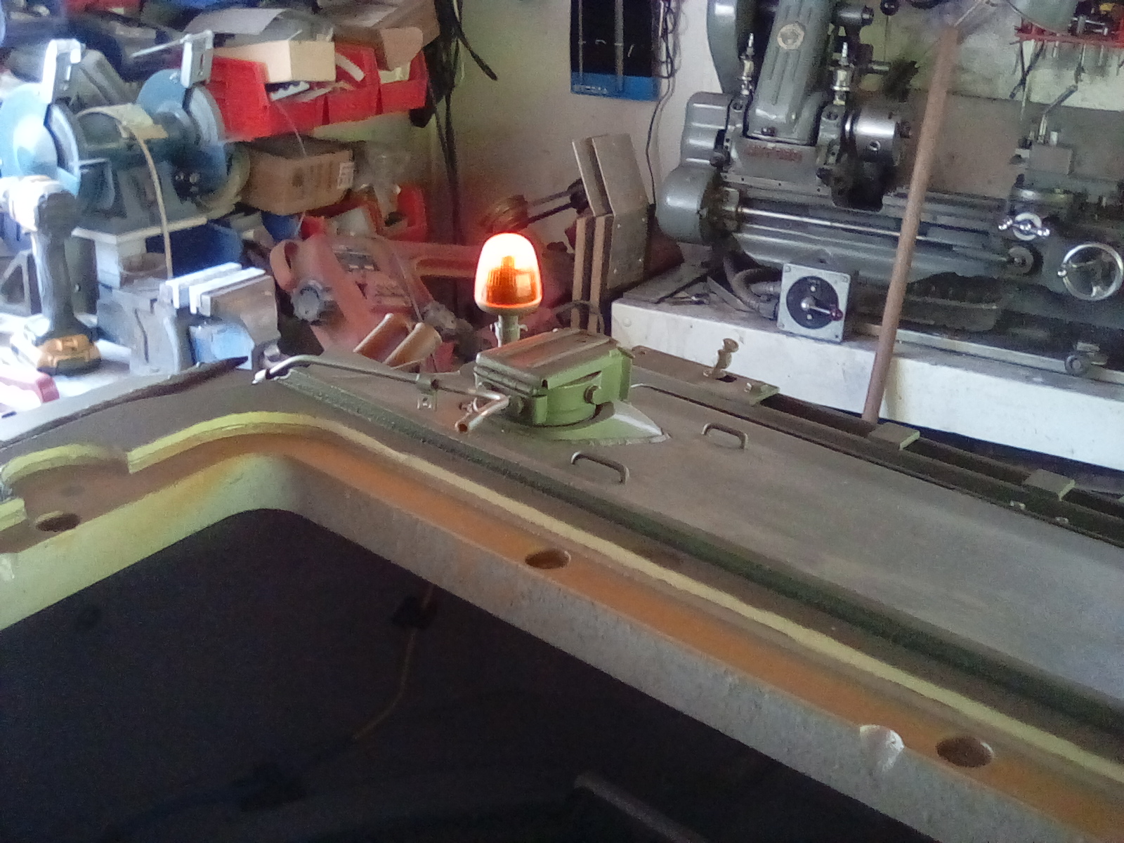

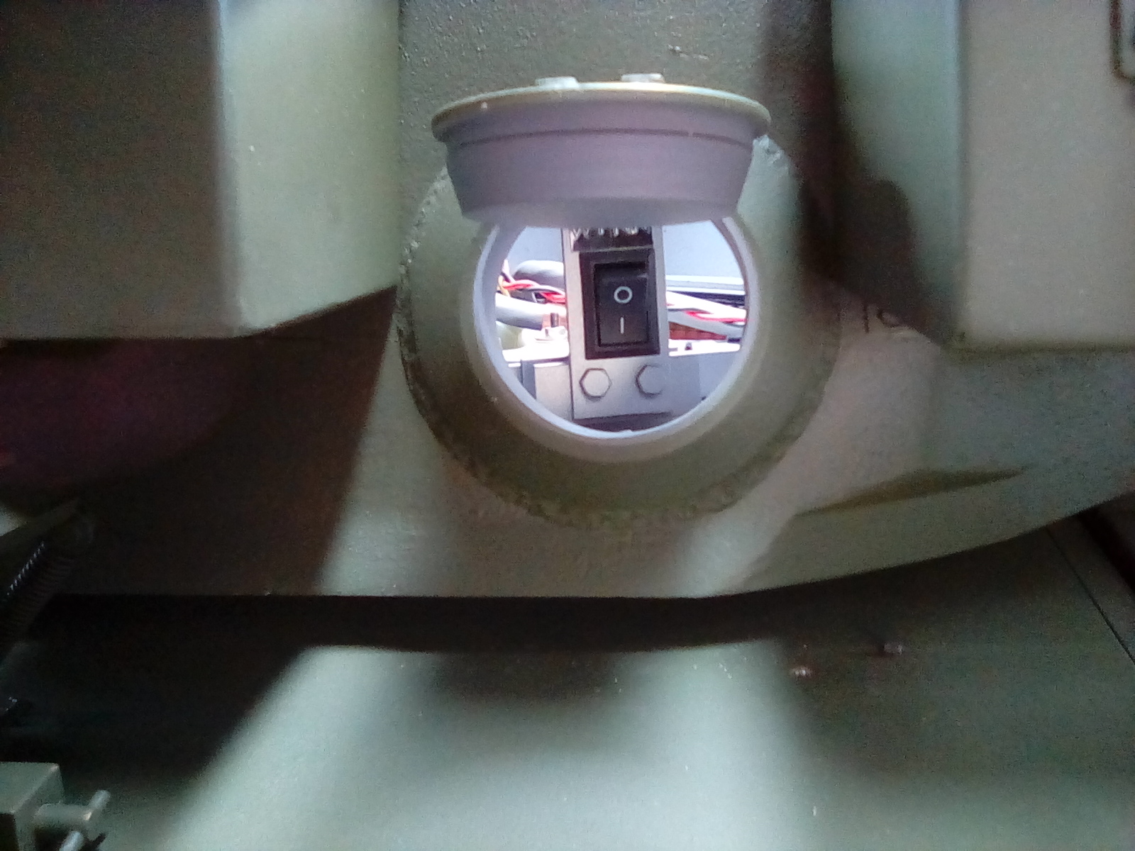

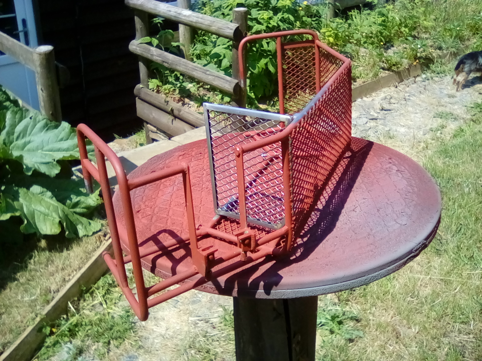

Top coat and winky pot wiring.
Great weather for painting
Switch bracket making, not my favorite job.
Rocker switch bracket all done
Basket now has top coat , that's a whole 100 ml can .

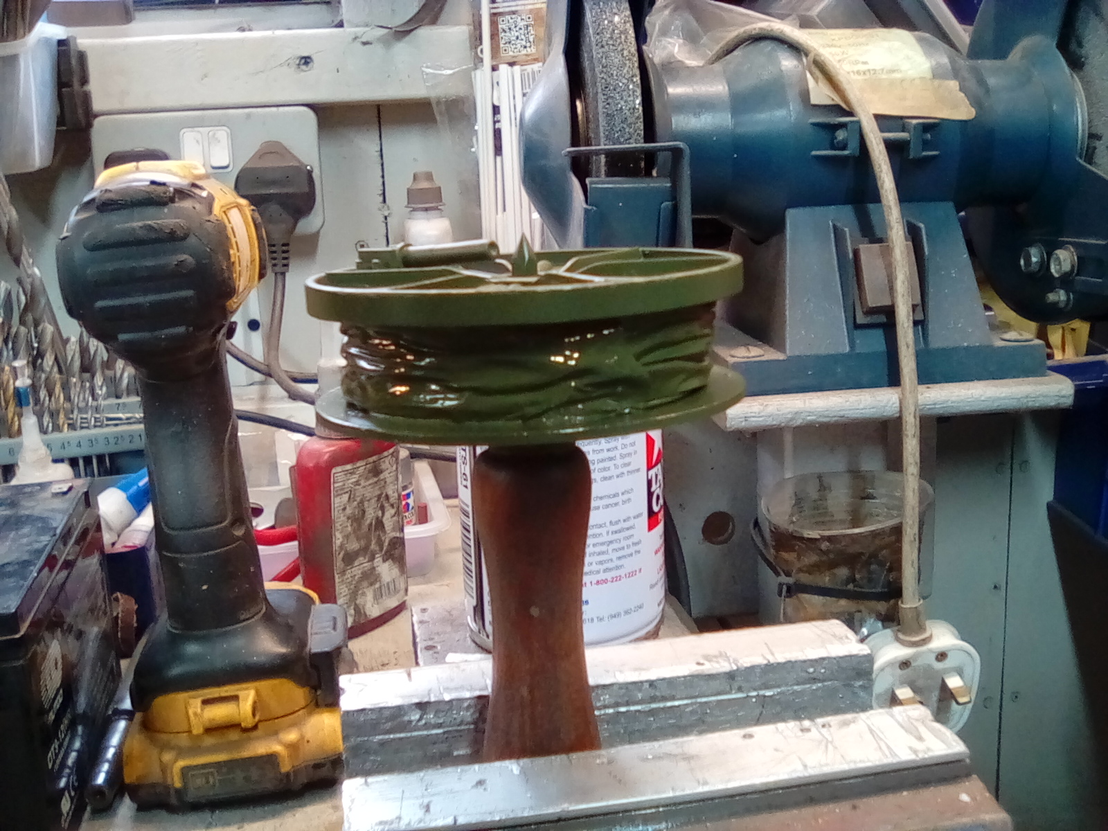

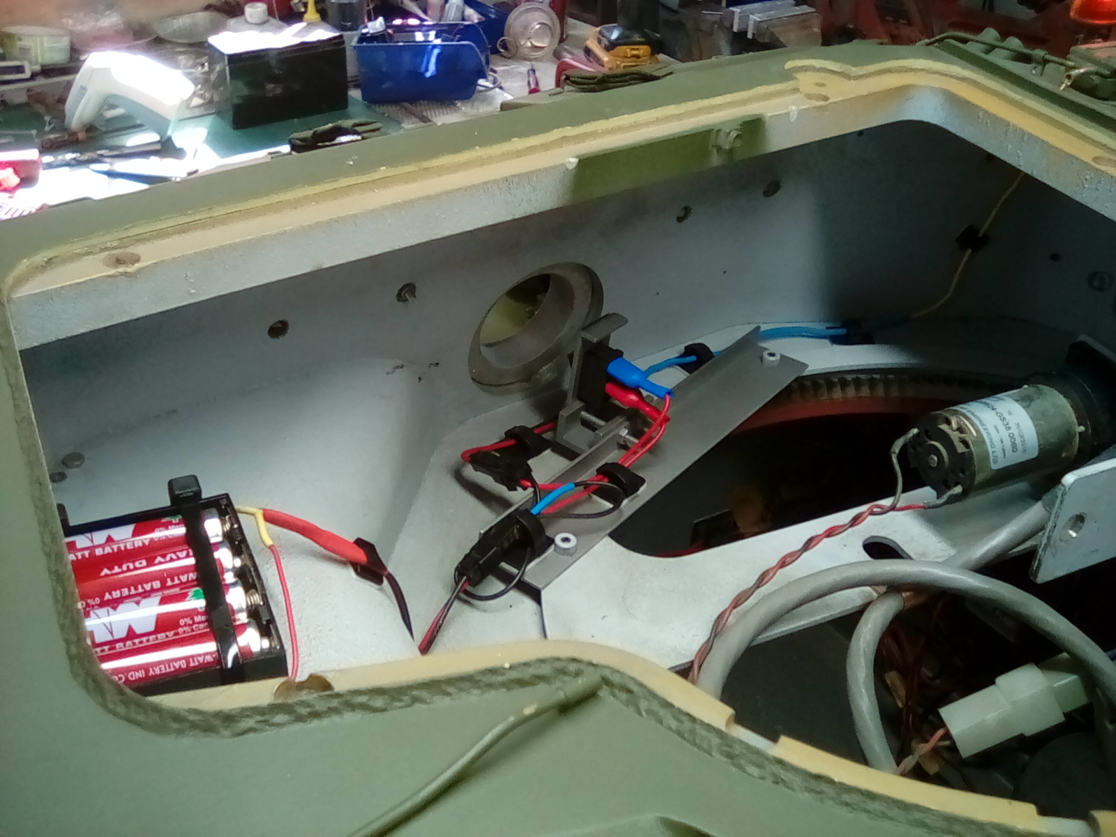

I've decided the winky pot should or rather could have it's own independent power supply, this cuts down on turret to hull wiring and I would think those four AA batteries will last for years.
Discrete rocker switch for the winky pot

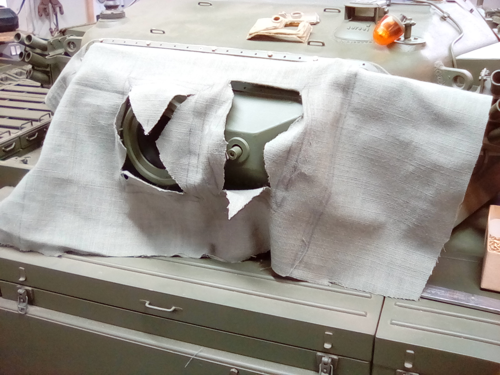

Re: Mr Dawe's Centurion.

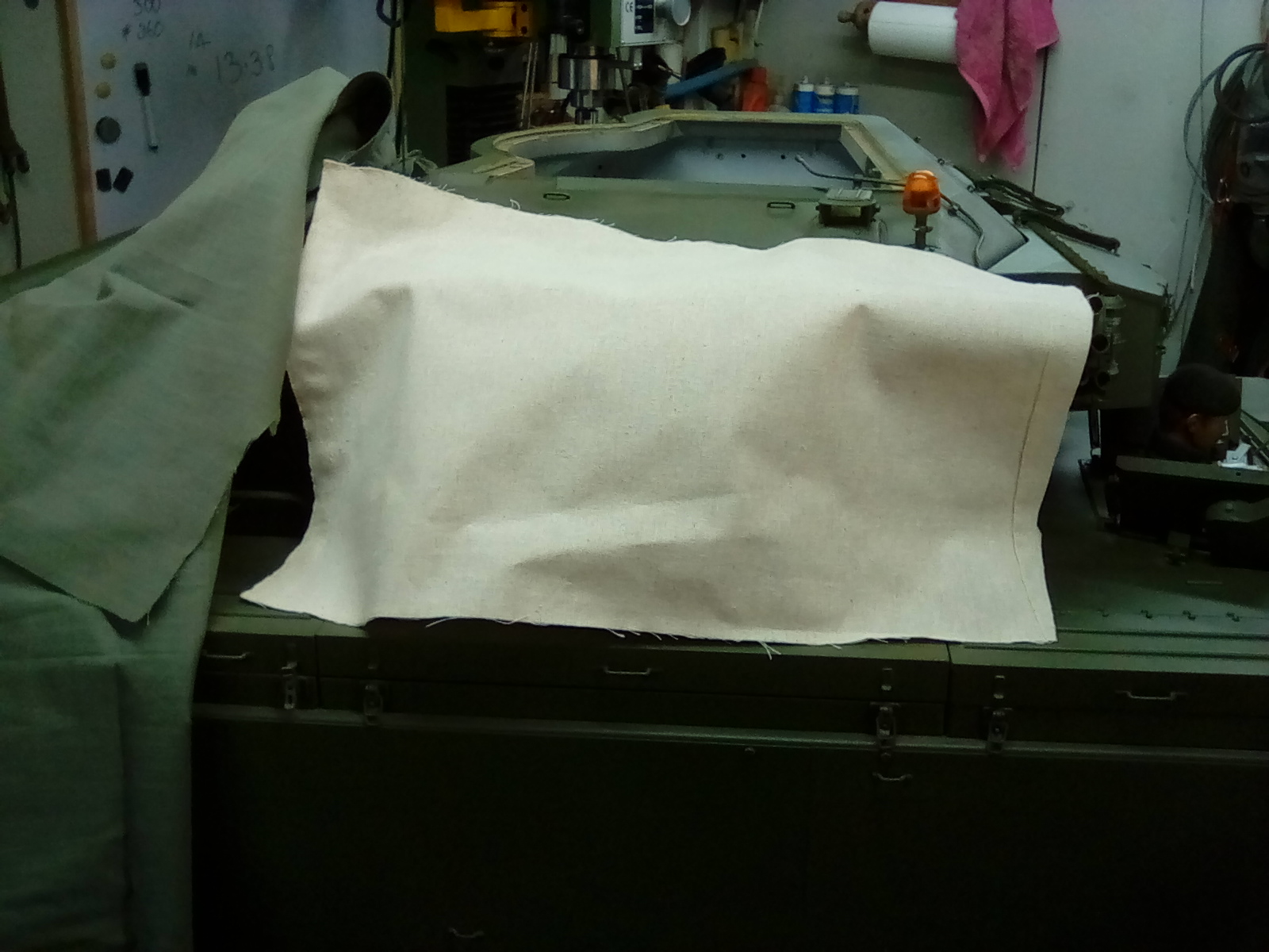

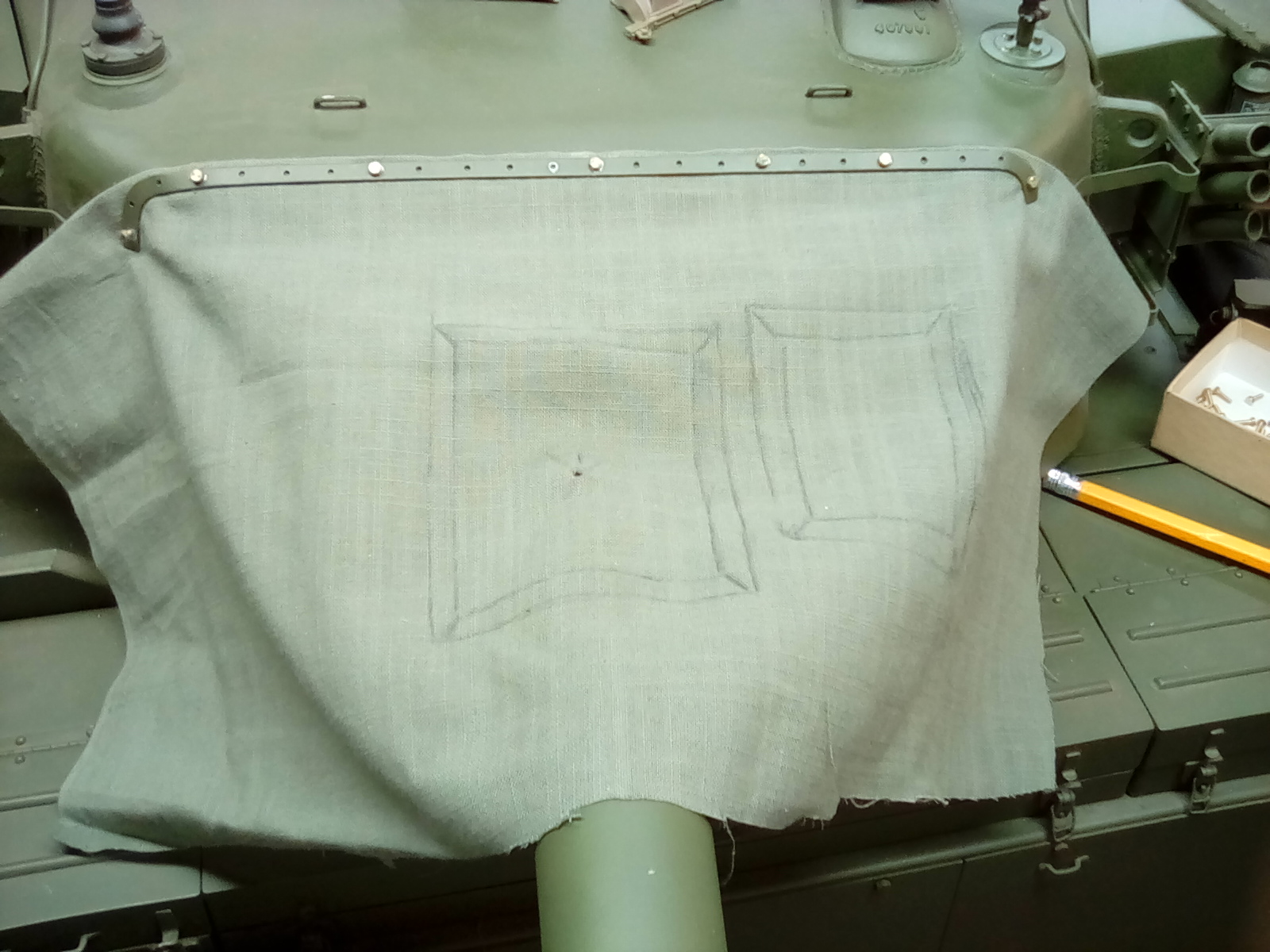

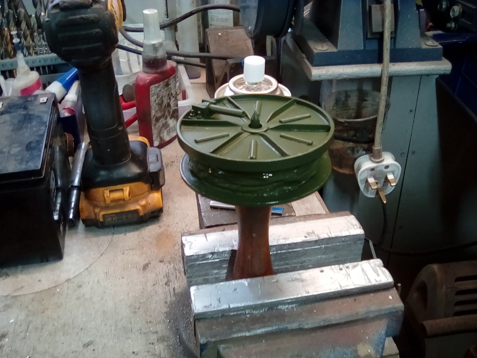

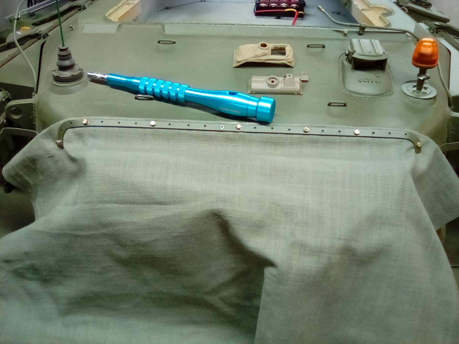

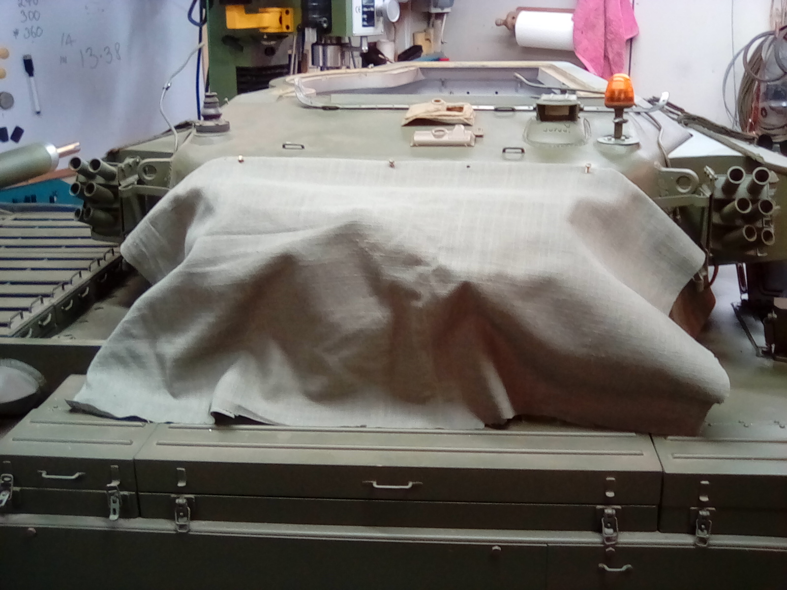

Don 10 this afternoon with a bit of the canvas mantlet cover work, I doubt that this cover will be the finished example.
I think that this will be the test piece
Has liked: 1038 times
Phil (D) - you asked about patterns for the mantlet cover. I didn't make a paper pattern, I used a maquette technique using shirt weight cotton to make a pattern, snipping and cutting until I could pin it to shape. From that pattern, I cut out the final stiffer material. Have a look here:
viewtopic.php?t=3931&start=900
Sorry to say I didn't keep the pattern material. Pete Mallet helped very kindly with the miniature zips and you can also see the shoe cream I used to get the correct colour.

Thanks Stephen, Its a team effort on this one!
Phil, I do remember my wife saying I should pre-shrink the material if I was going to paint it or put shoe cream on it and she was right. I didn't and it shrank. I only just got away with it, mine could be a bit looser.
