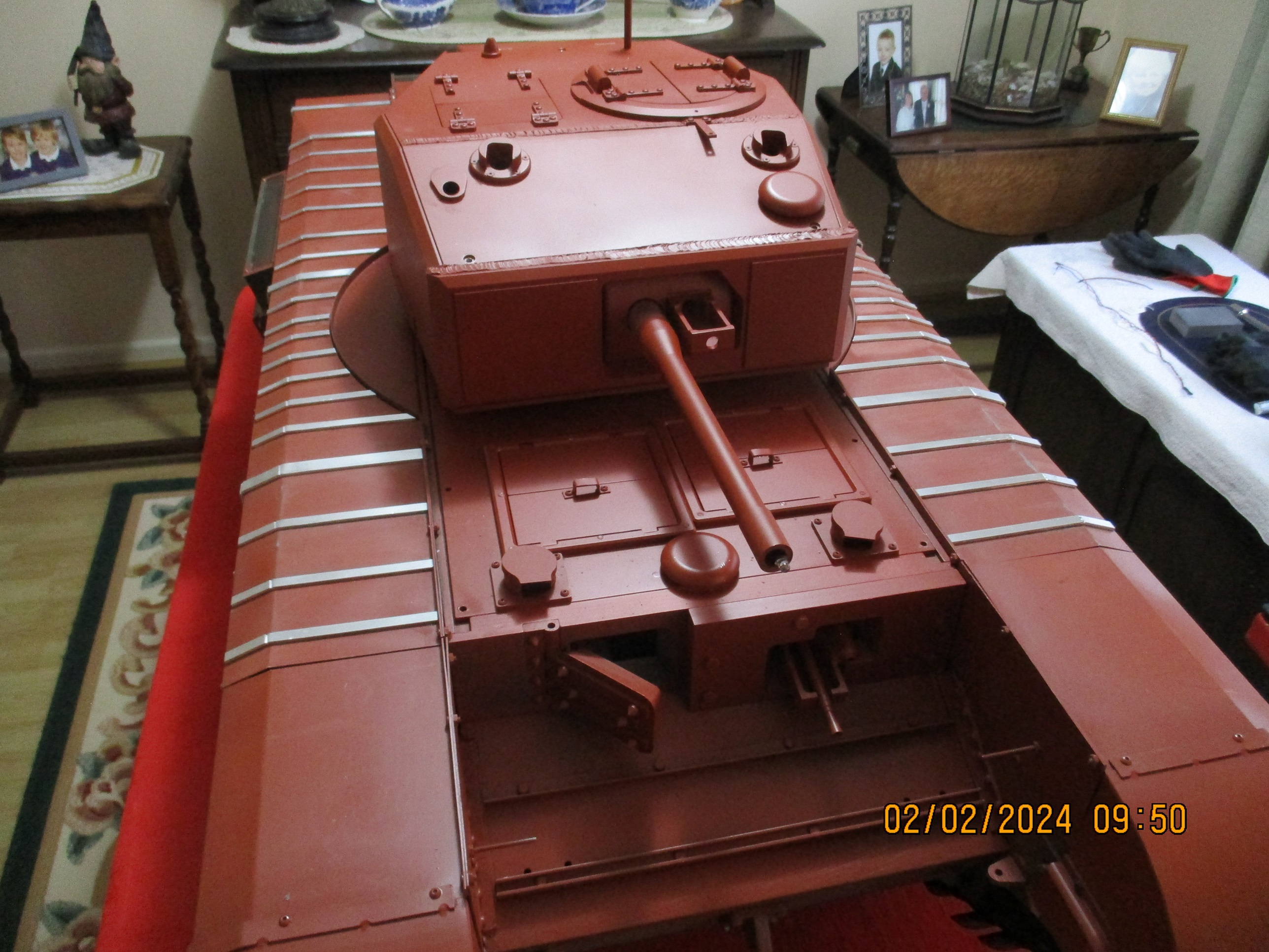

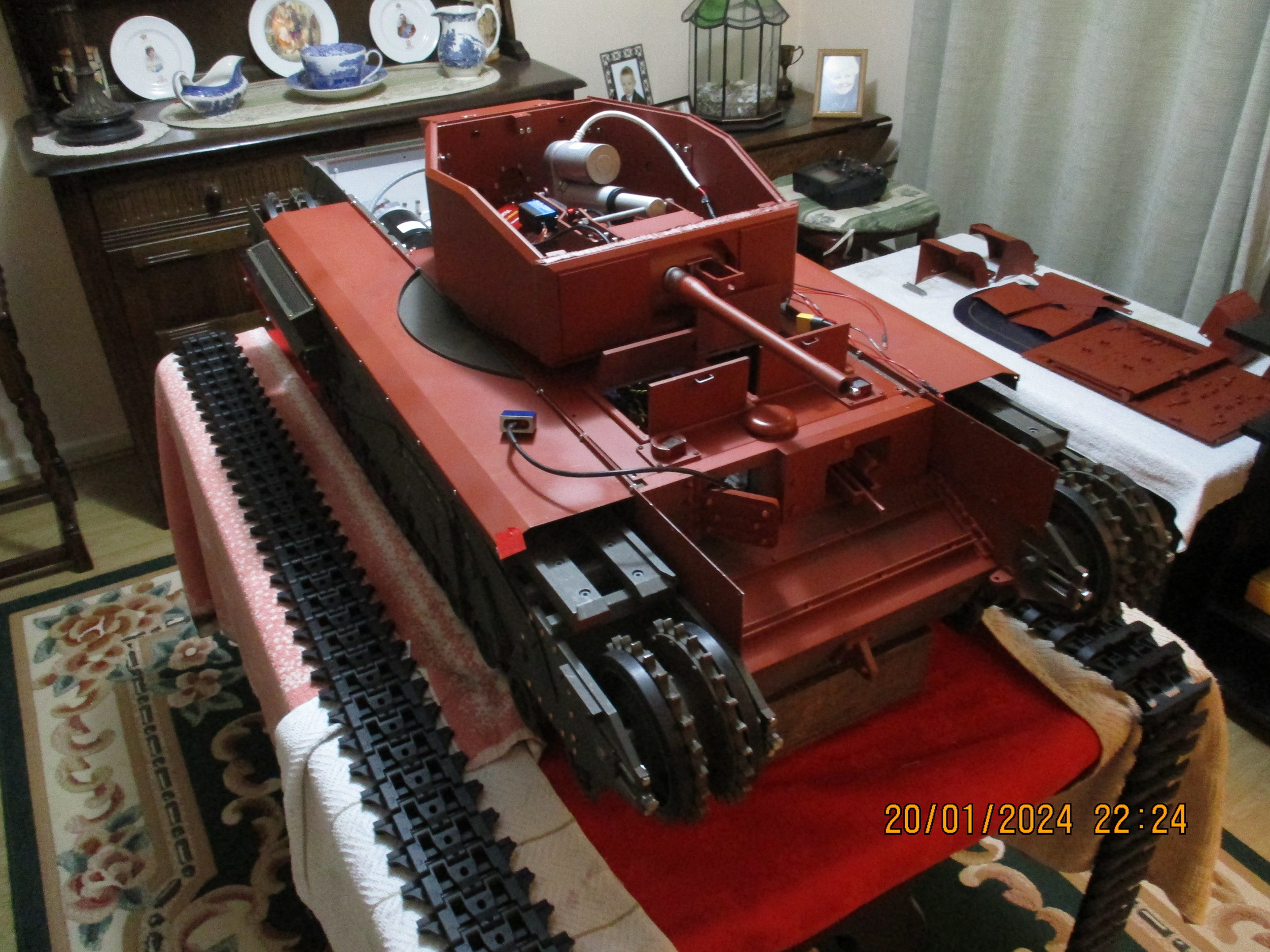

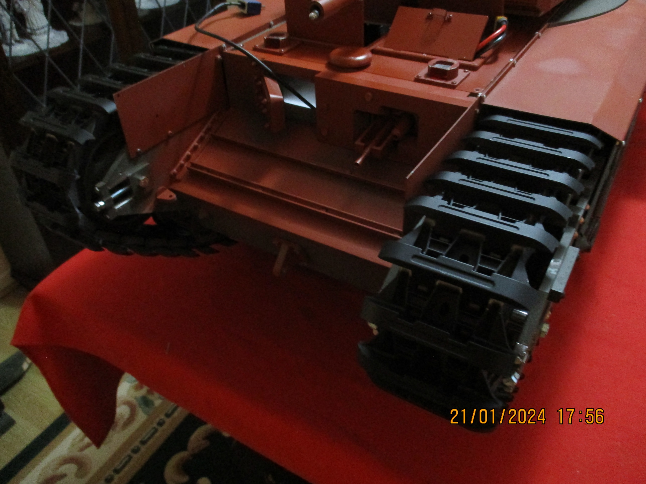

Looking great Mick. Your work area is always so neat and tidy.
Dont REVERSE into the china lol

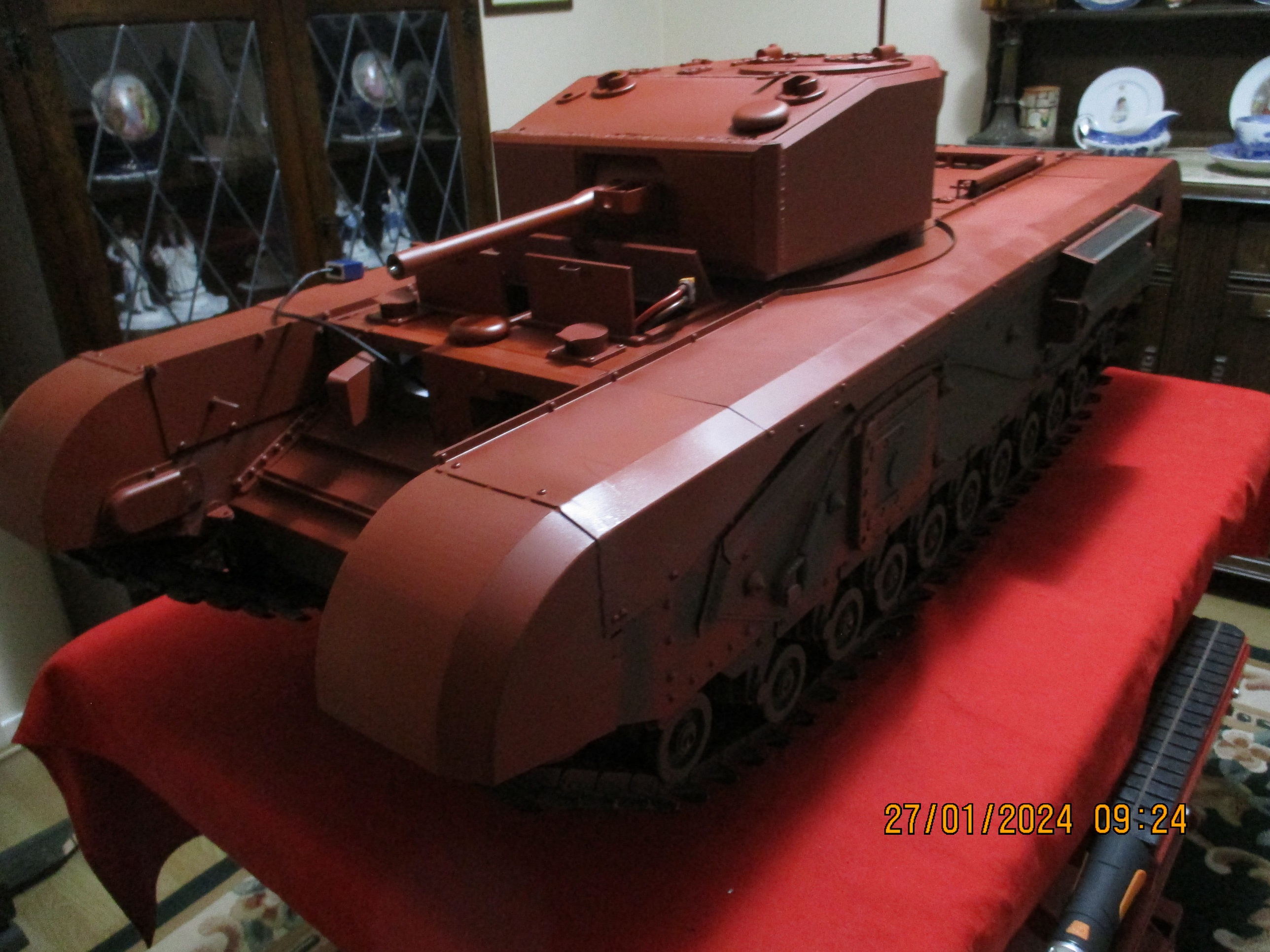

Good morning lads, she really looks ' the business ' the more I see her.....

Stunning mate. Absolutely stunning. I love the moody red photograph although its a shame the deadpool look has gone :wink:

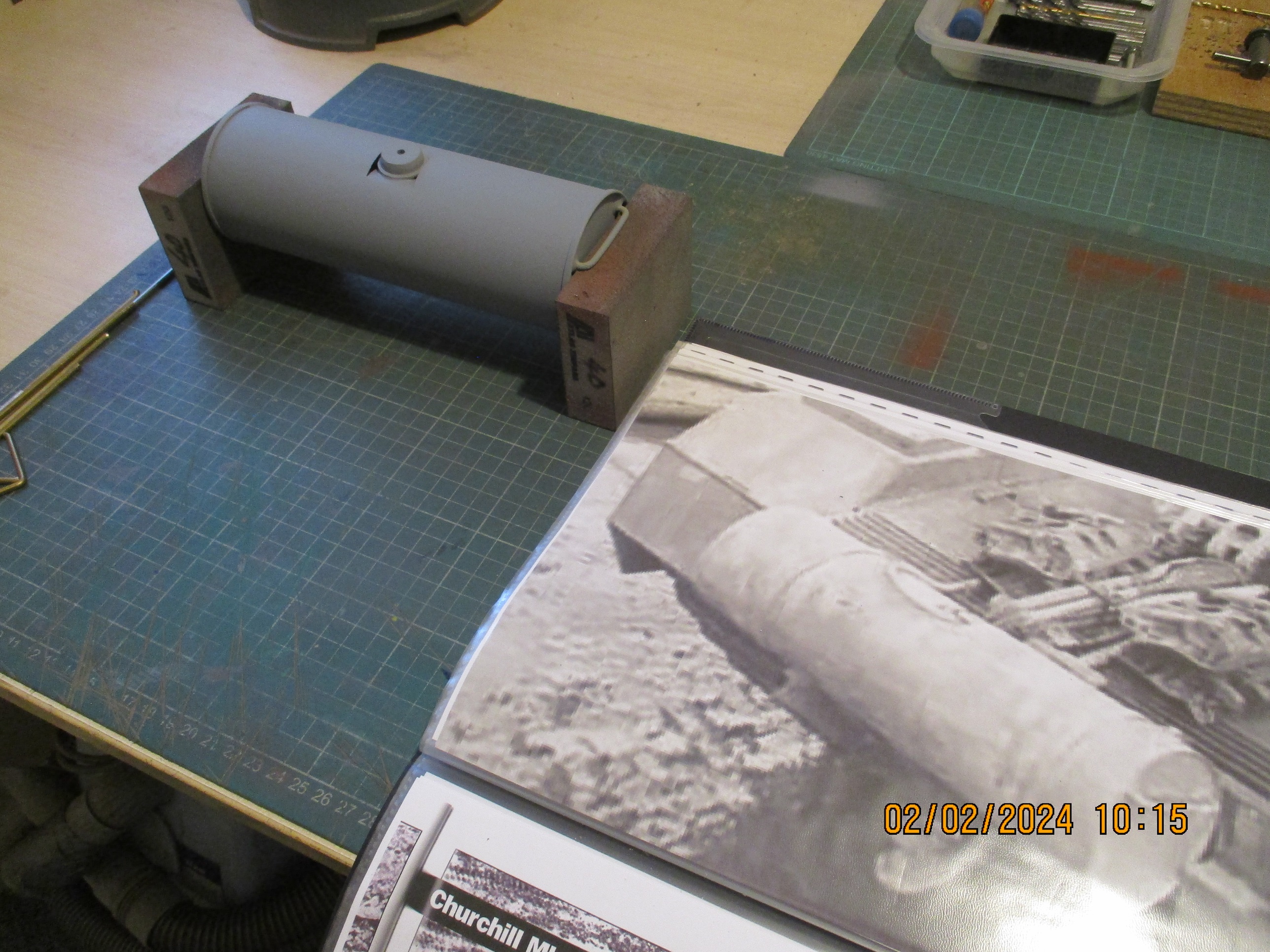

Good morning everyone and thank you Gary, I have enjoyed your attention to detail. I had the same problem with those armor plates, the button heads and nuts are a pig to tighten...I reconfigured a 3mm spanner. I had noticed from original Churchill photo's that the button heads in the kit, appear to be Hex heads, what do you think.

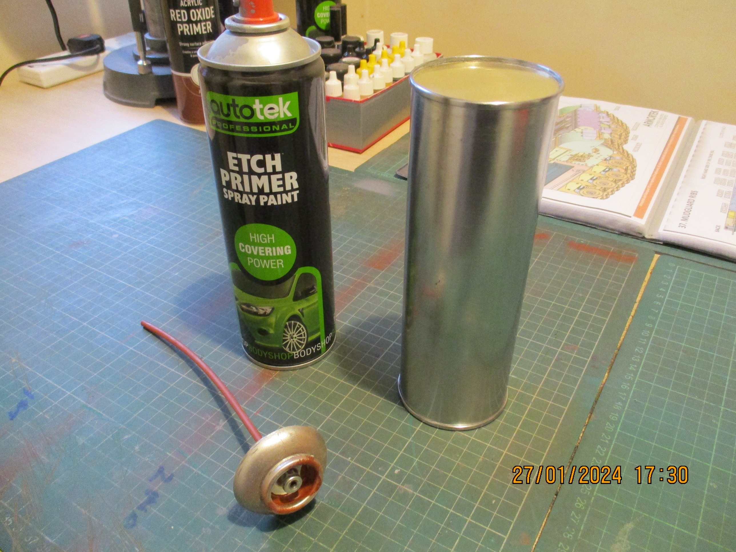

Fitted the mudguard ribs....and made a start on the rear fuel tank fitted on the rear, an add-on I spotted which I would like to feature. This model of the Churchill has a real presence and is a pleasure to build....Mick :D

Nice bit of recycling Mick.
I've been trying to convince a friend in the US that he should use the little tomato paste tins for the drums on the back of his T-34, but he's not convinced.
