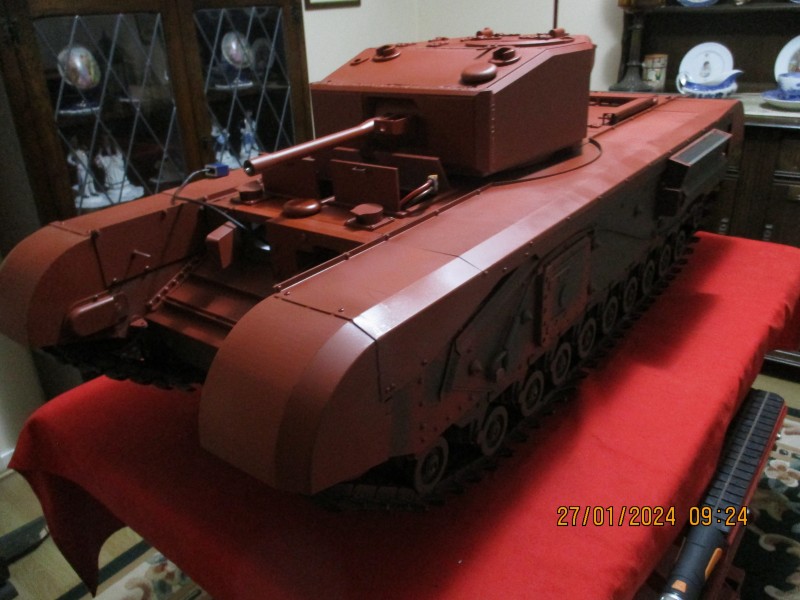

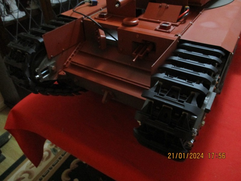

Good morning everyone, just awaiting the predicted storm.....Now, I will set the record straight, I know I said that I had 'single stick' control. That was not strictly (as in the dance) true. I knew something was not quite right....so, I delved into that mine of information, the Knowledge Base, Knowledge Base Topics, and there I found the most informative article, ''Setting up single stick driving'' not only that, it refers to the beloved Spektrum DX8. I will not waffle on....I now have true ''Single Stick'' not the concoction I previously used.
I guess all of Thursday morning was taken up with setting up my Tx and Rx system in the Churchill ....not so easy when your mind in 'old man' mode. Think of what goes where and then promptly forget. Anyway guys, the Sun has suddenly appeared in an otherwise grey sky.....have a nice day,,,,,Mick :)

Looking great Mick. Your work area is always so neat and tidy.
Dont REVERSE into the china lol

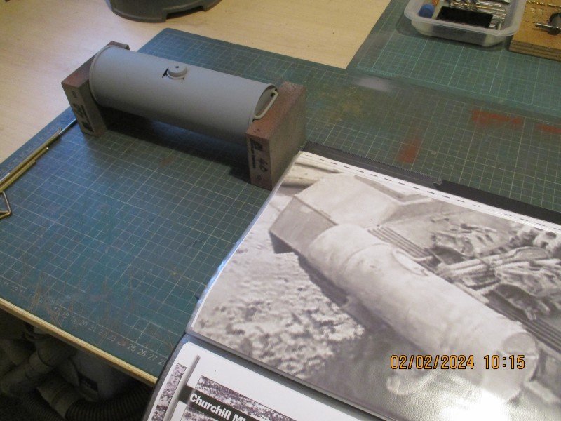

Good morning everyone and thank you Gary, I have enjoyed your attention to detail. I had the same problem with those armor plates, the button heads and nuts are a pig to tighten...I reconfigured a 3mm spanner. I had noticed from original Churchill photo's that the button heads in the kit, appear to be Hex heads, what do you think.
Fitted the mudguard ribs....and made a start on the rear fuel tank fitted on the rear, an add-on I spotted which I would like to feature. This model of the Churchill has a real presence and is a pleasure to build....Mick :D

Nice bit of recycling Mick.
I've been trying to convince a friend in the US that he should use the little tomato paste tins for the drums on the back of his T-34, but he's not convinced.
