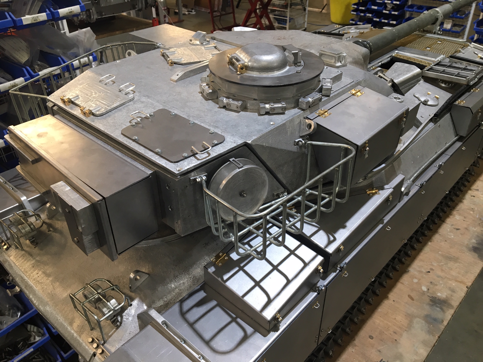

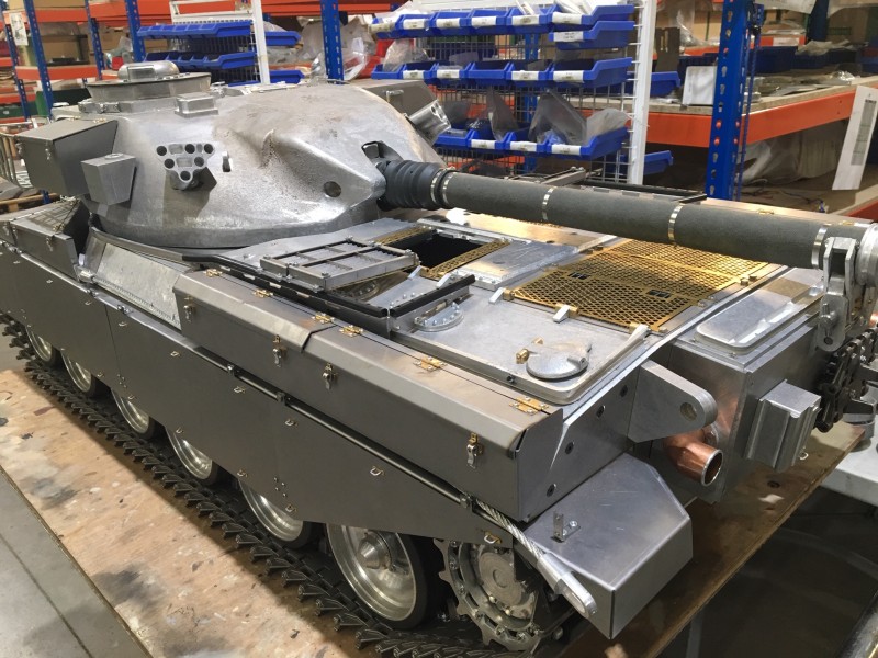

Re: Chieftain Prototype Build
Rubber inserts for the Chieftain tracks getting counted out and packed.
It’s impressive, superb even. Looking forward to seeing it, if not hearing it at the Open Day. Some hull back bins would fill a space or two.
They are on the production version, but not the prototype. Same with the ribbing on the bins.Stephen White wrote: ↑Mon Sep 09, 2019 7:14 am.............. Some hull back bins would fill a space or two.
Phew !!
And the bow wave deflector ?
It looks awesome. Well done to all involved.
