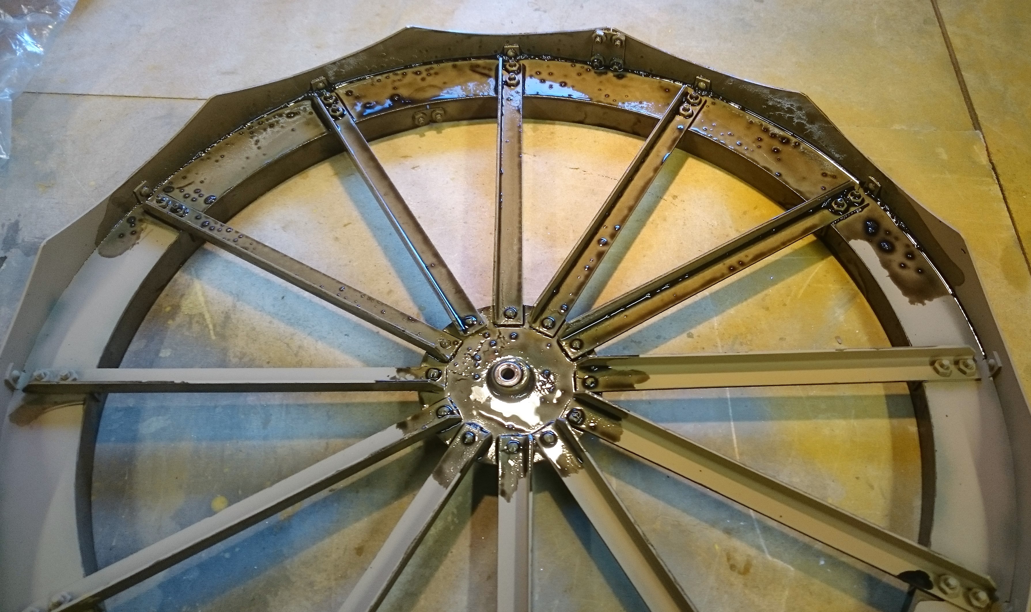

The first of the washes are added along with "wear removal" of the top coat exposing the dark green underneath, this process is quick in some respects but will take many days of adding and removing paint. I sit and look, do a bit, and so it goes on. The larger panels will have different shading added to give interest/contrast to those vast boring areas, paint chipping is not my favourite pass time but must be done but not over done! Crew entrance/exit wear kind of evolves over time and so it will with this Quad.

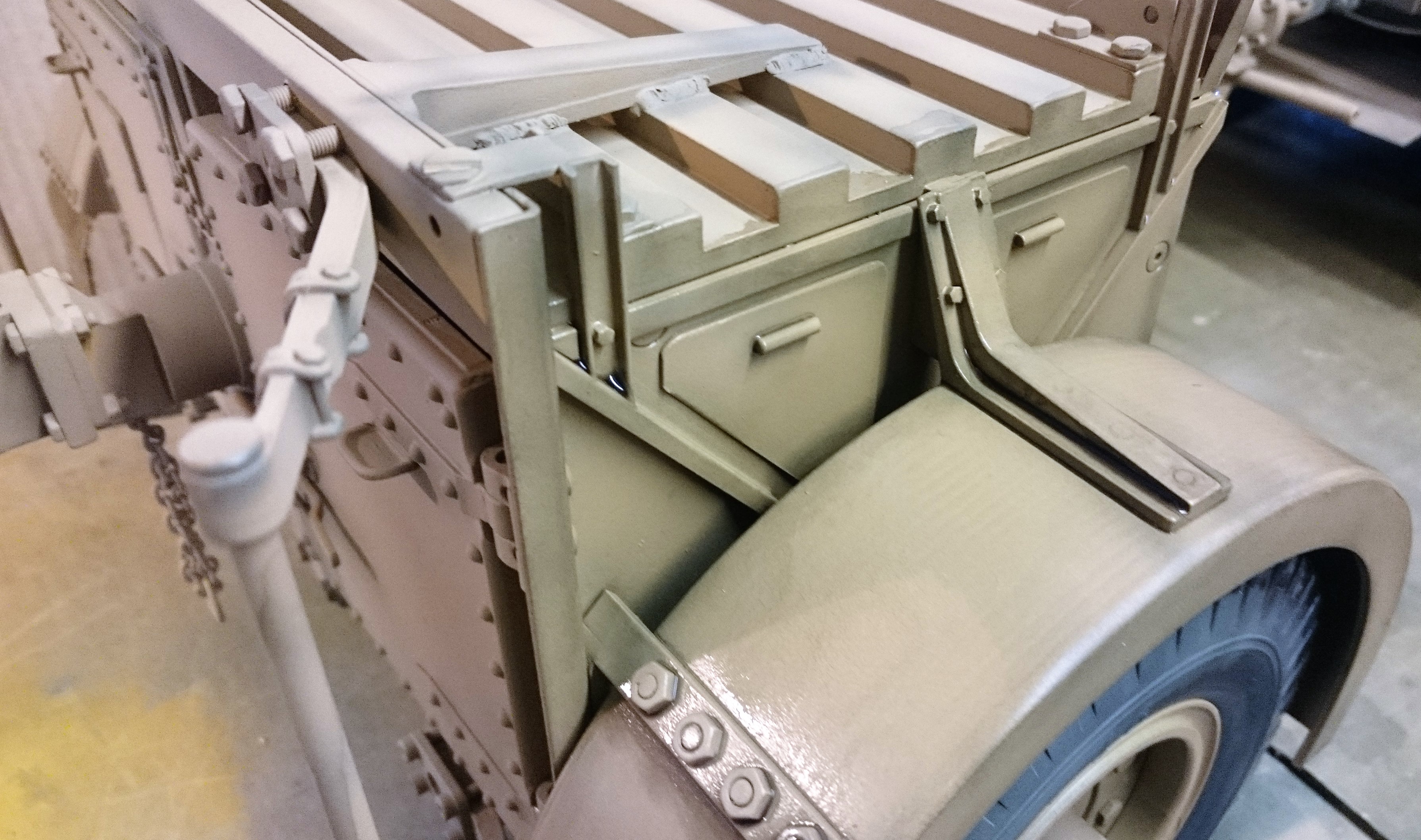

Over spray on the wheel rubber needs removing yet again.

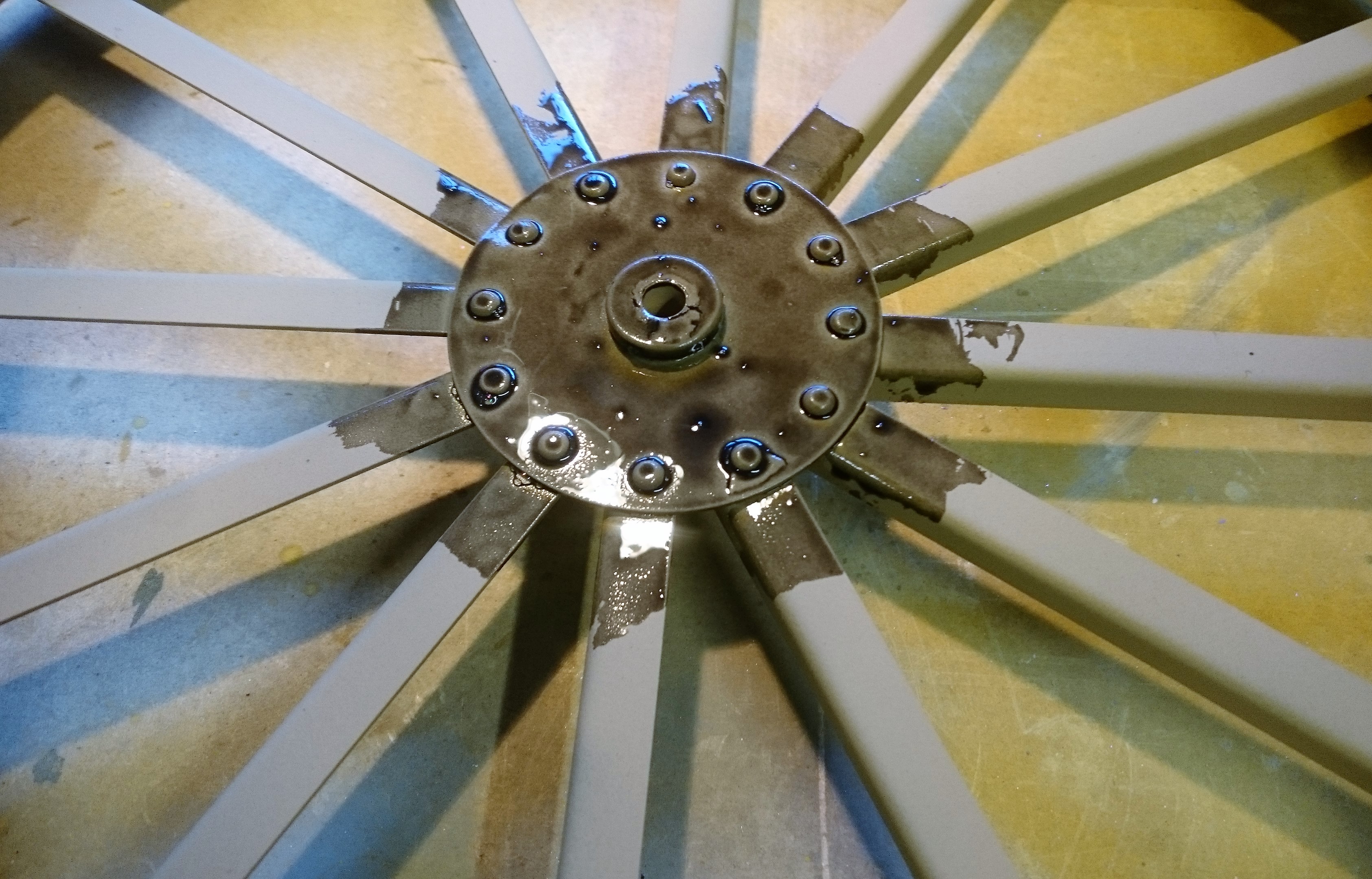

First "dirty wash" chassis coat.
You can see the wet wash drying out, I use a solvent that will bind the pigment to the paint but can be removed as required, the solvent is very carefully selected so the main colour doesn't run.

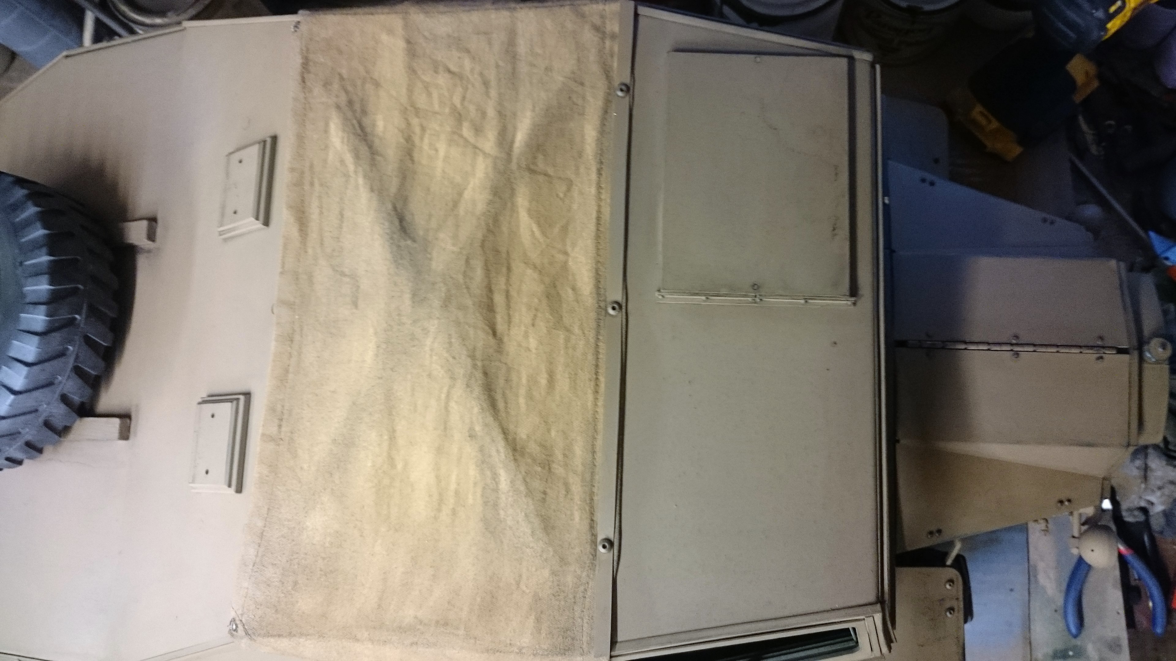

The dreaded "soft top"
After much research I have chosen to fix the front of the tarp, and so its folded from back to front rather than vice versa, to get it to fit soak it in water first.
Four Tiny screws to keep the tarp tight. I have yet to add the spring tie down.

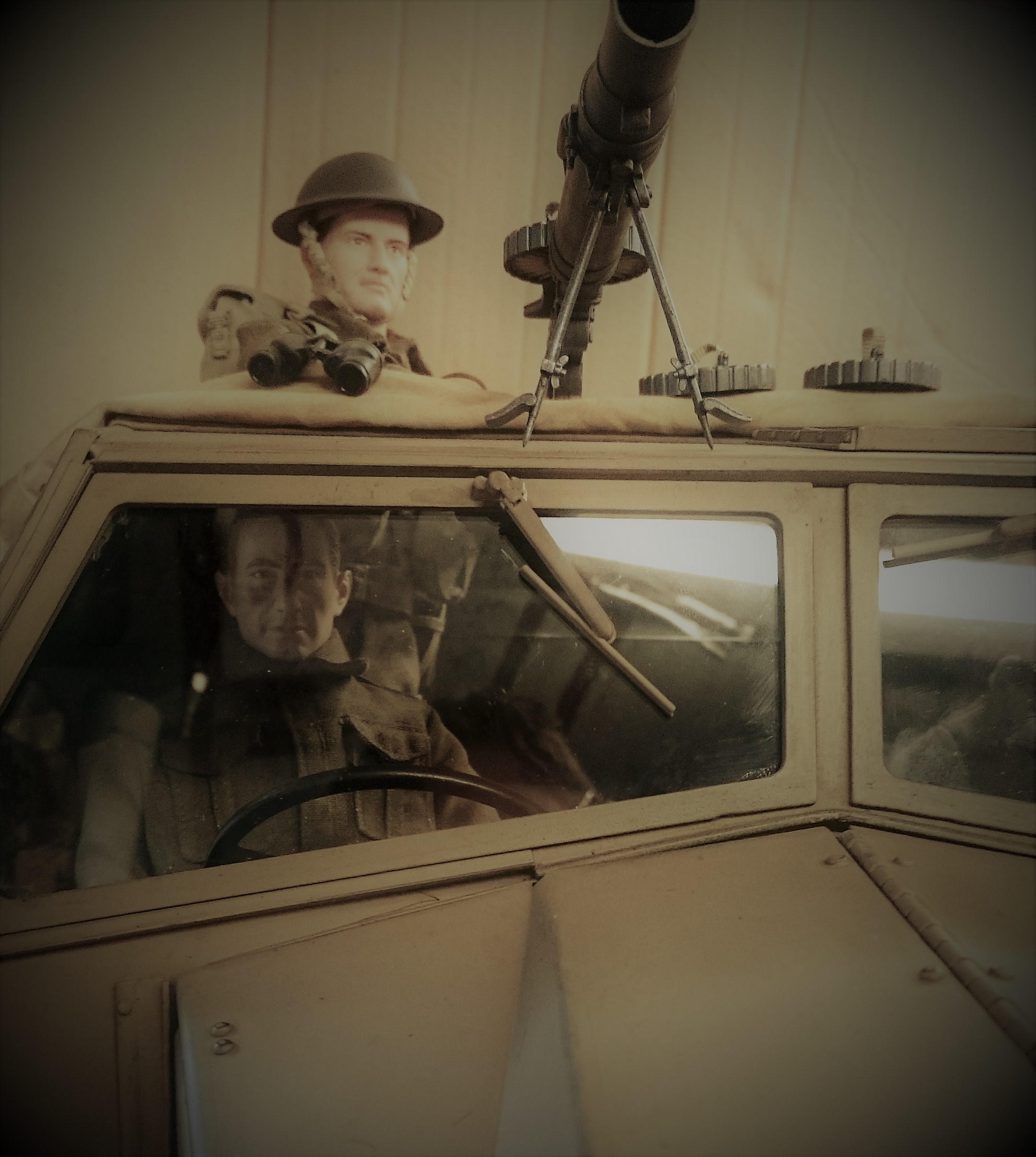

Getting ready with the props for a good ol outside photo shoot, just as soon as the weather lets me.

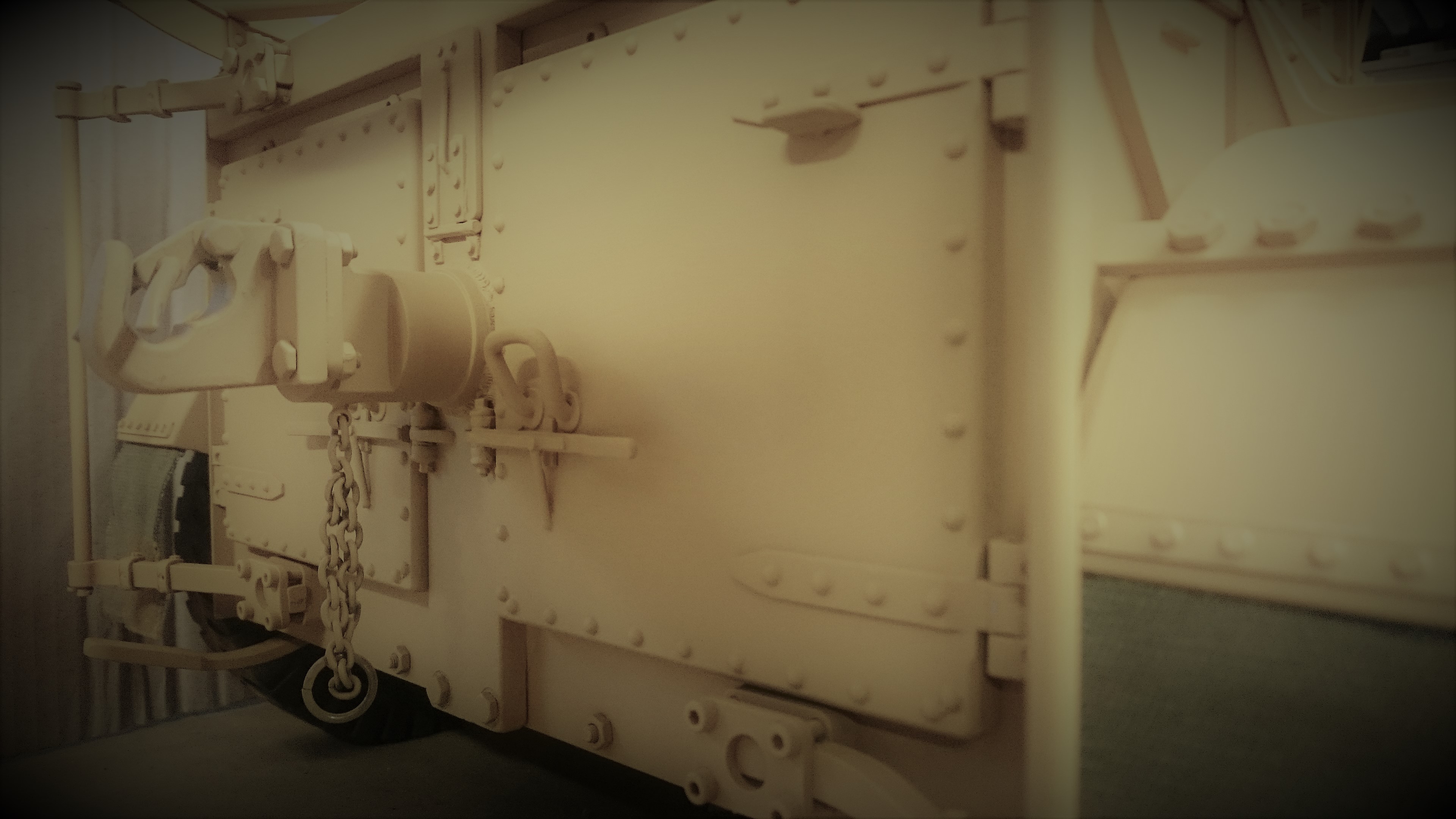

The Quads limber under construction with Armorpax detail parts. As the limber will be a short build and its connected to this Quad I felt its not worth starting a new thread dedicated to the limber, I hope that's ok with Armortek.
I can see why some new to Armortek customers would choose the compact kits, its a great way to familiarise your self with the construction methods and techniques before committing to the big kits.
I can see why some builders like to paint/finish all the components in one hit for continuity, ie the Quad Limber and Gun all painted with the same colour mix almost on the same day, but I prefer the slight contrast that you get from independently finishing each piece, this in my opinion adds interest overall as each will be oh so subtly different.
A nice straight forward build.
With tons of rivet detail.

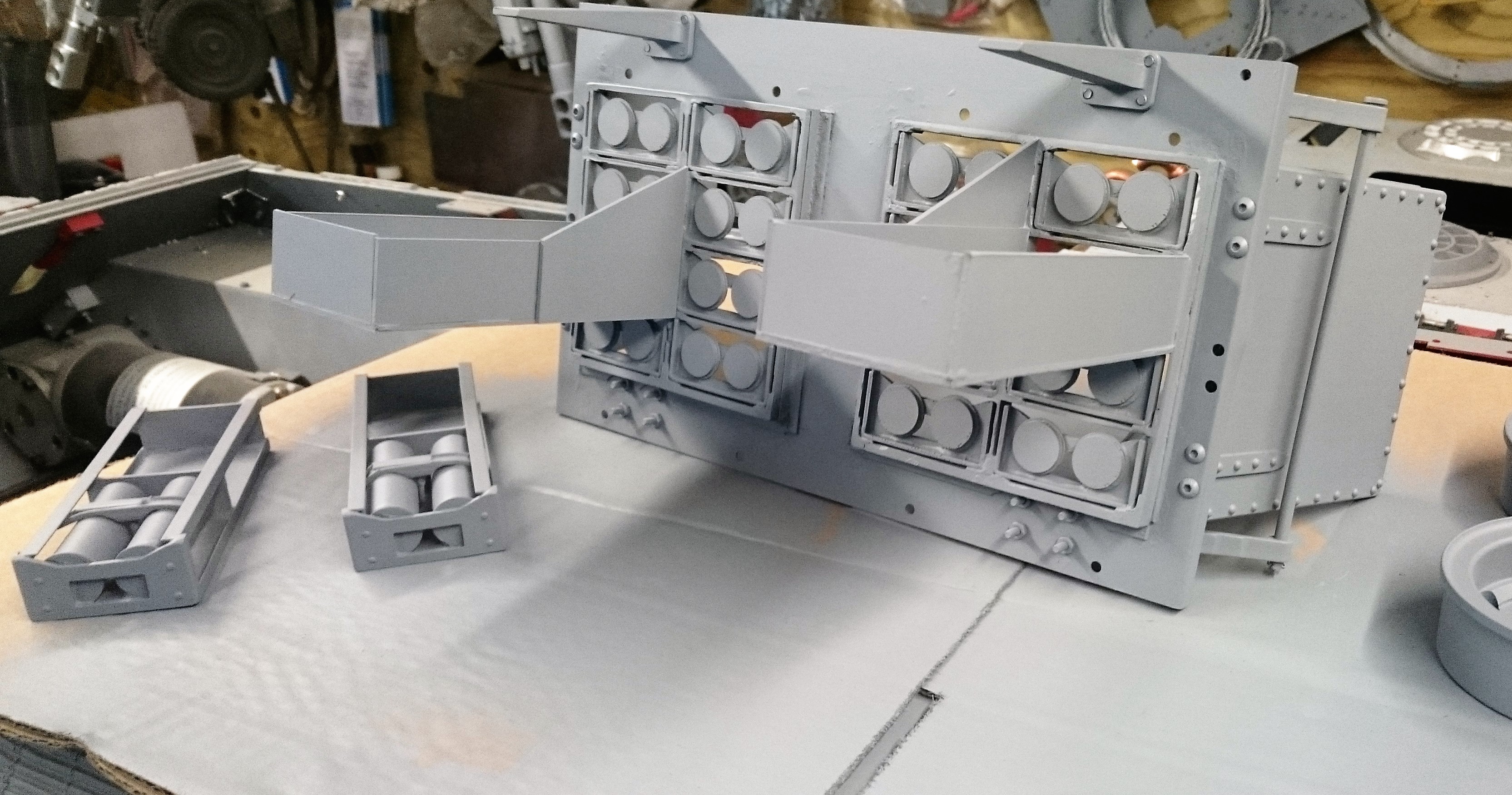

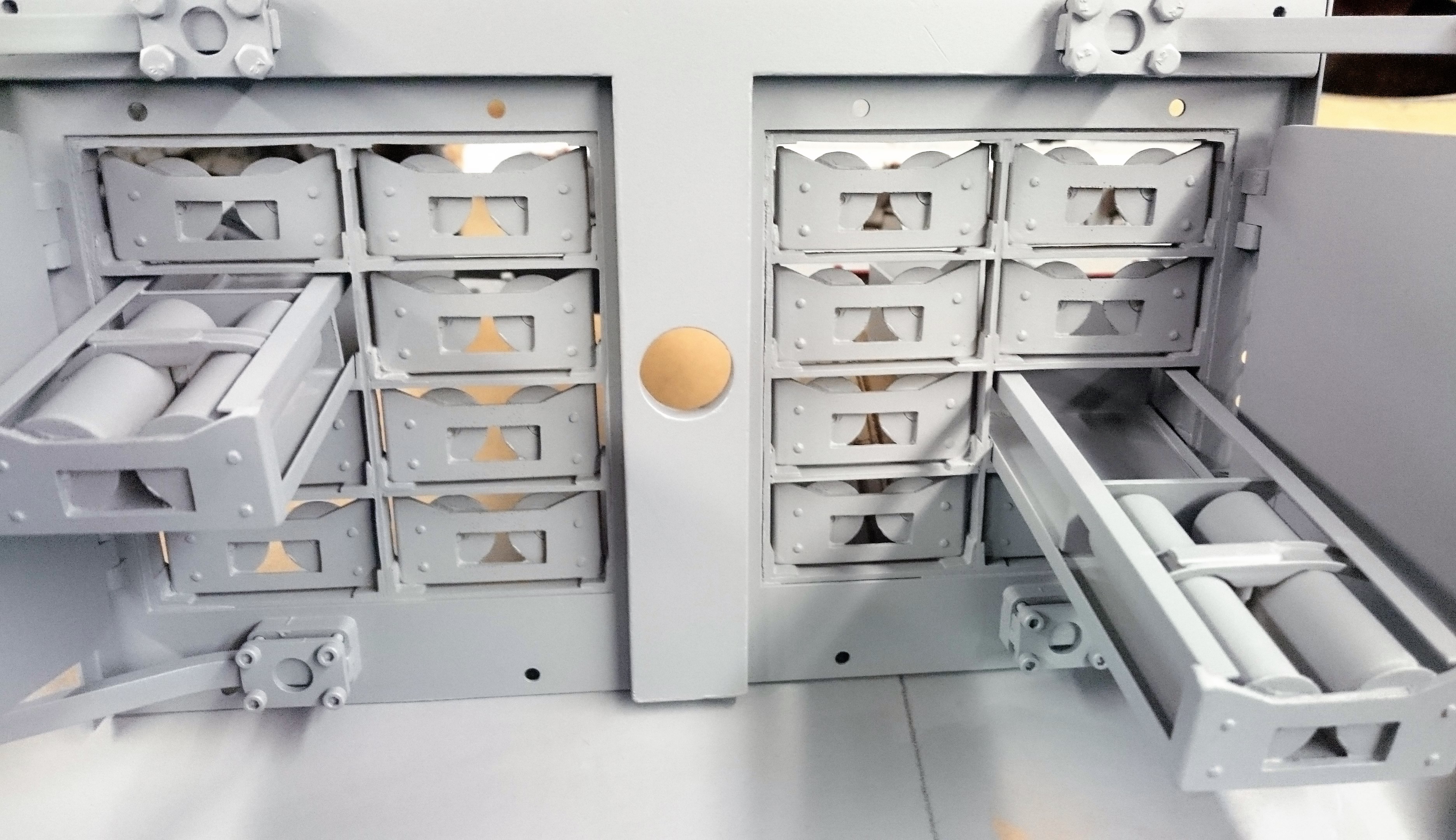

Sixteen draws to clean up and fit.
The draw assembly needs fitting from the back of the door panel.
I have made my own draws and added dummy shell cases to two of them

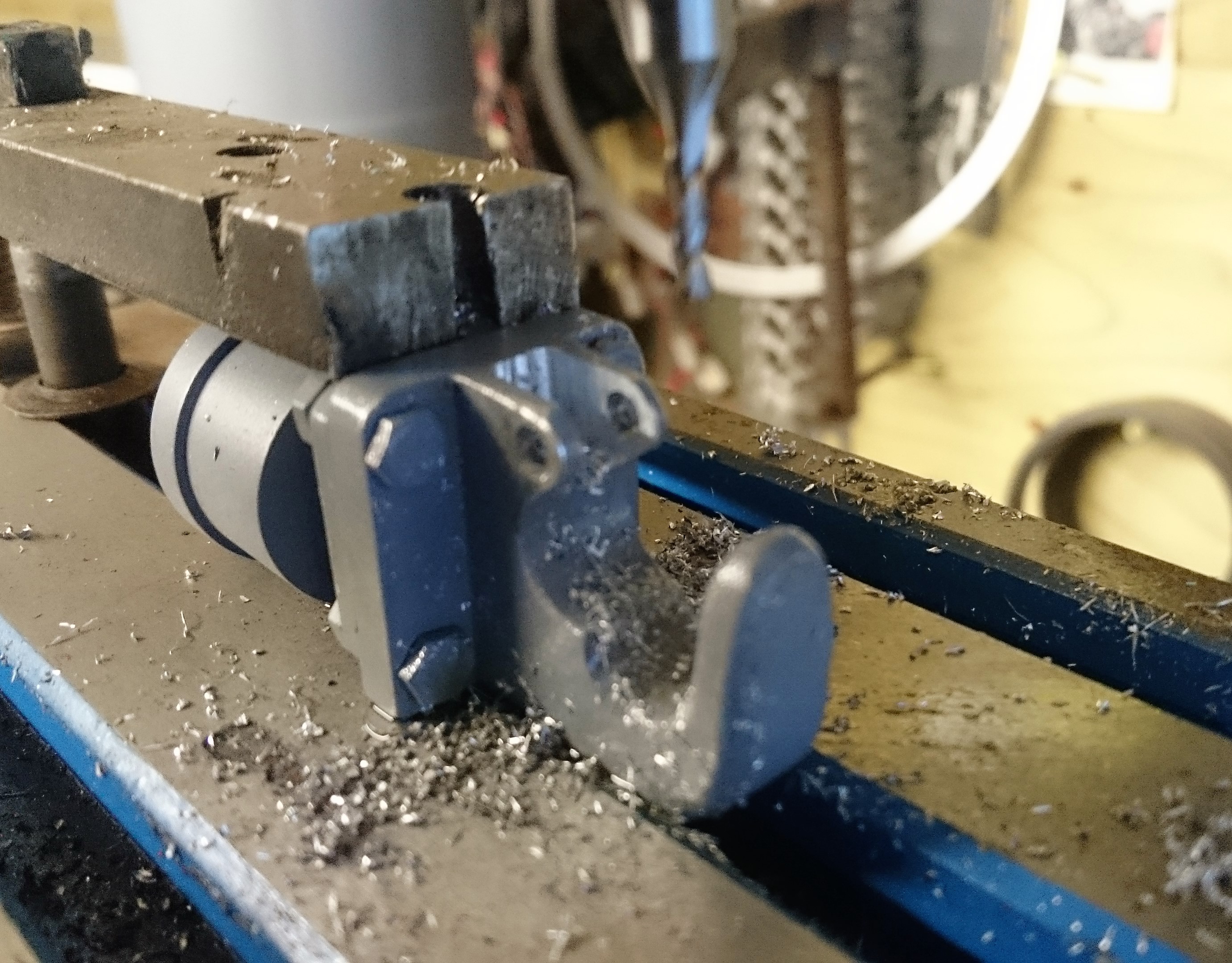

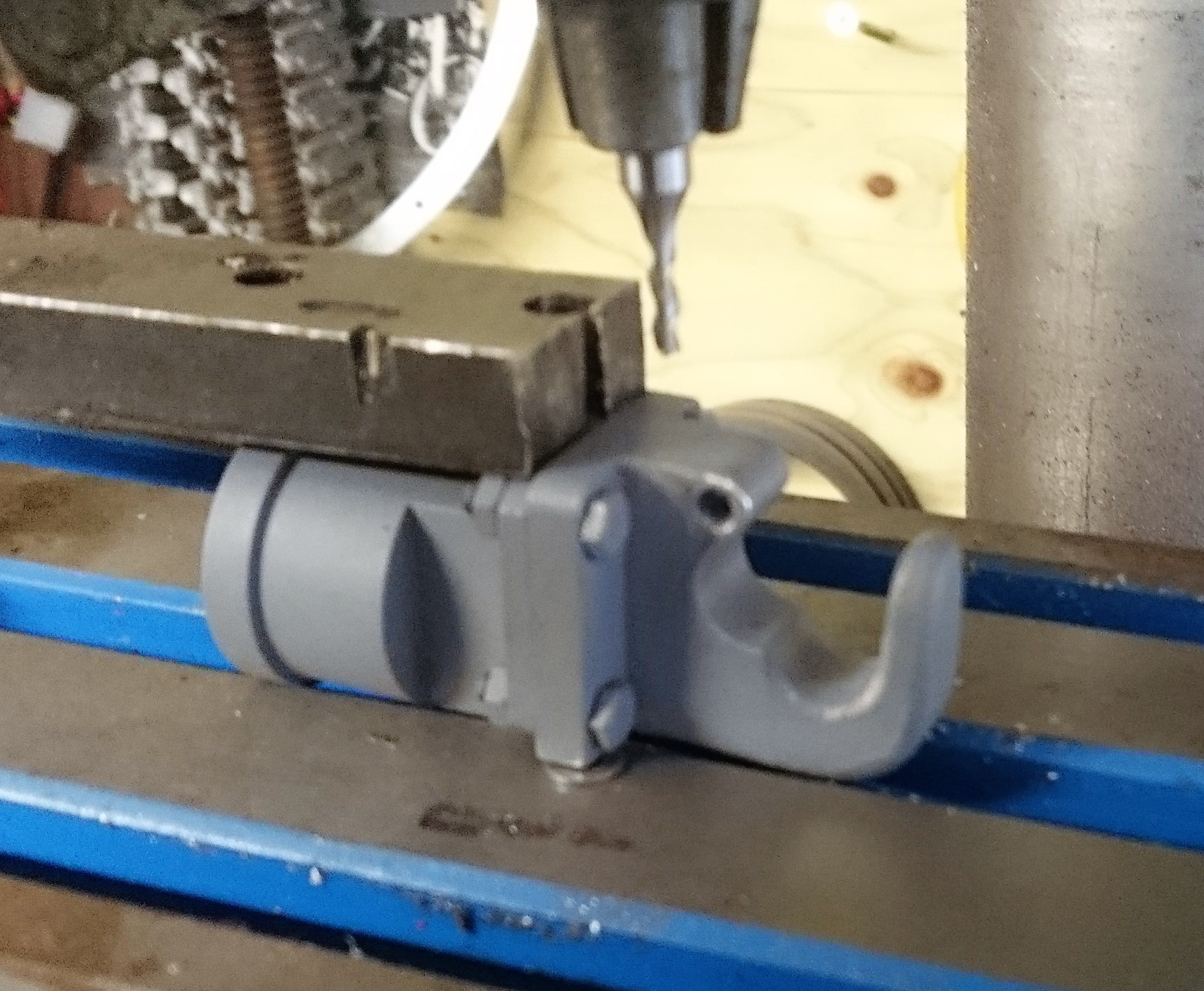

As this Limber will be fully functional ie towed behind the Quad a bit of machining was needed. The Limber tow hitch had no locking mechanism so a simple milling job using my improvised drill press milling machine, and some flat ali stock for the locking lug and some 3mm wire for the handle, instead of an ugly spring to hold the lug in position I have milled the slot to a very close tolerance so the m3 bolt can pinch the lug quite tightly and so hold everything in place, job done.

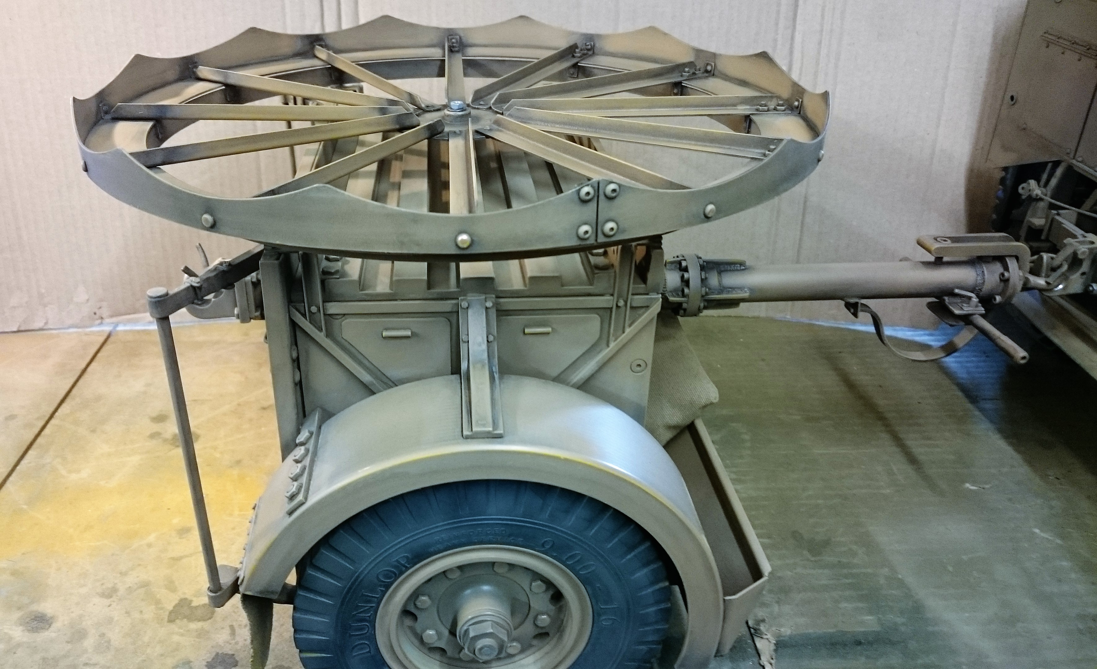

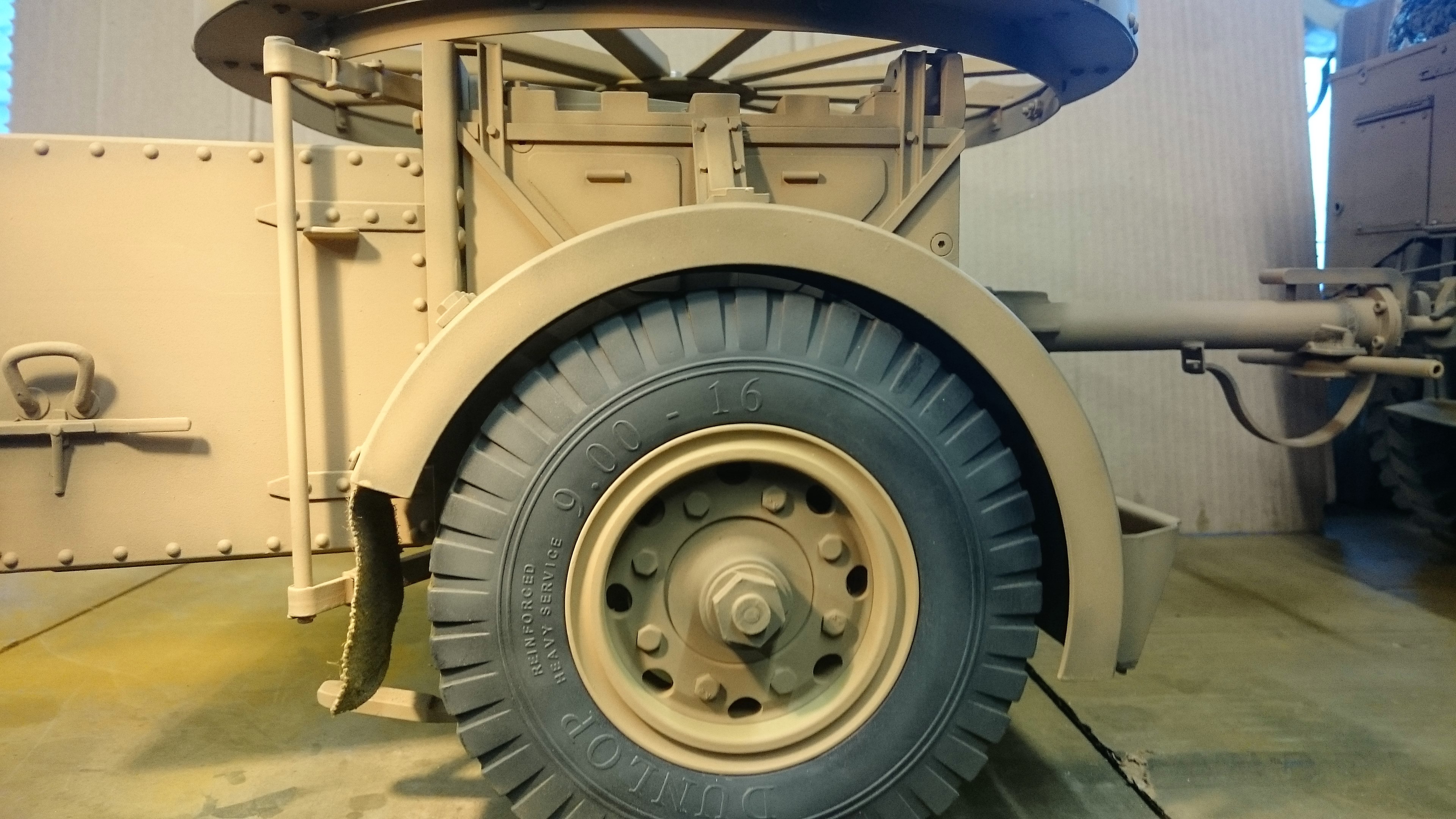

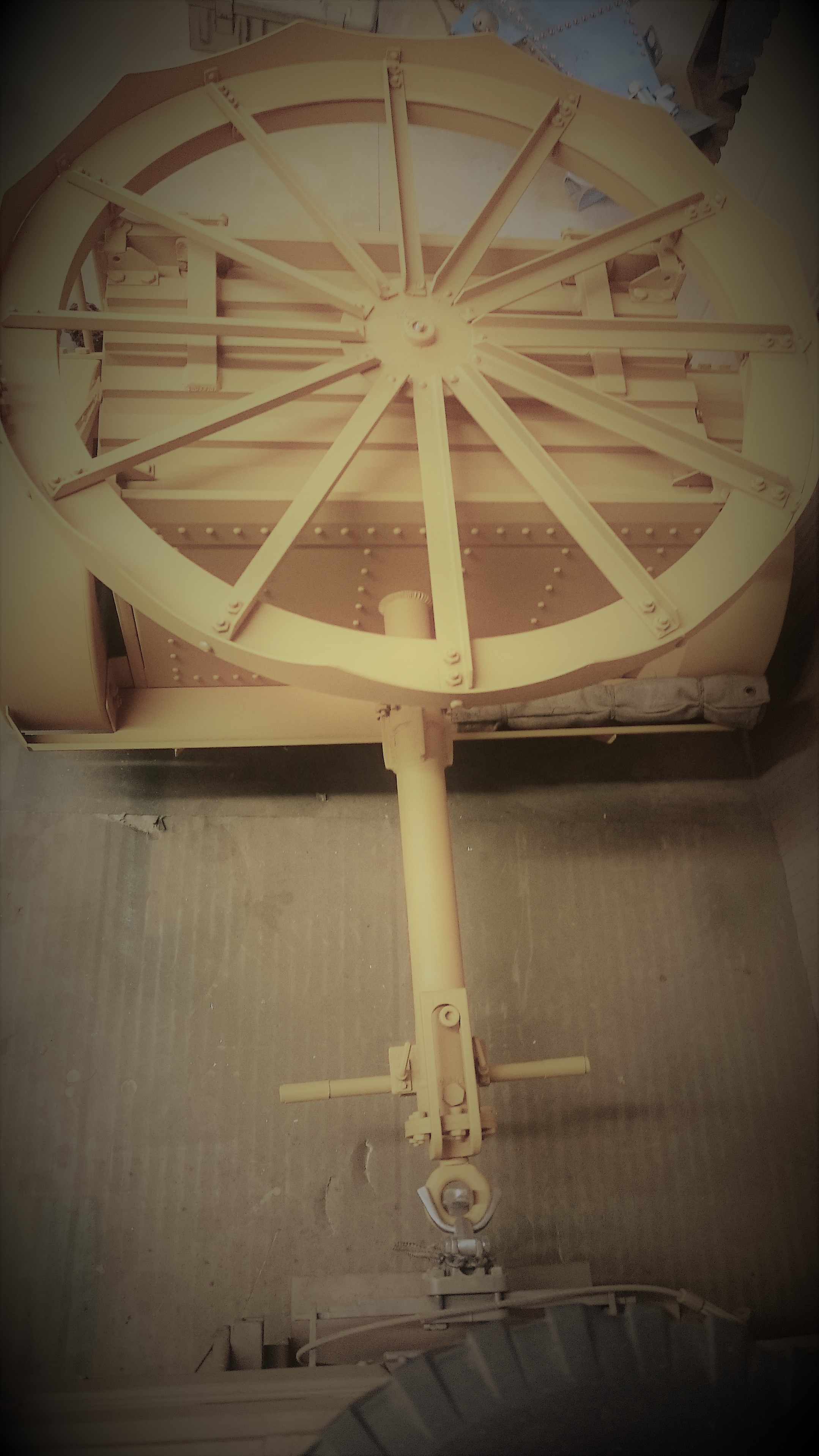

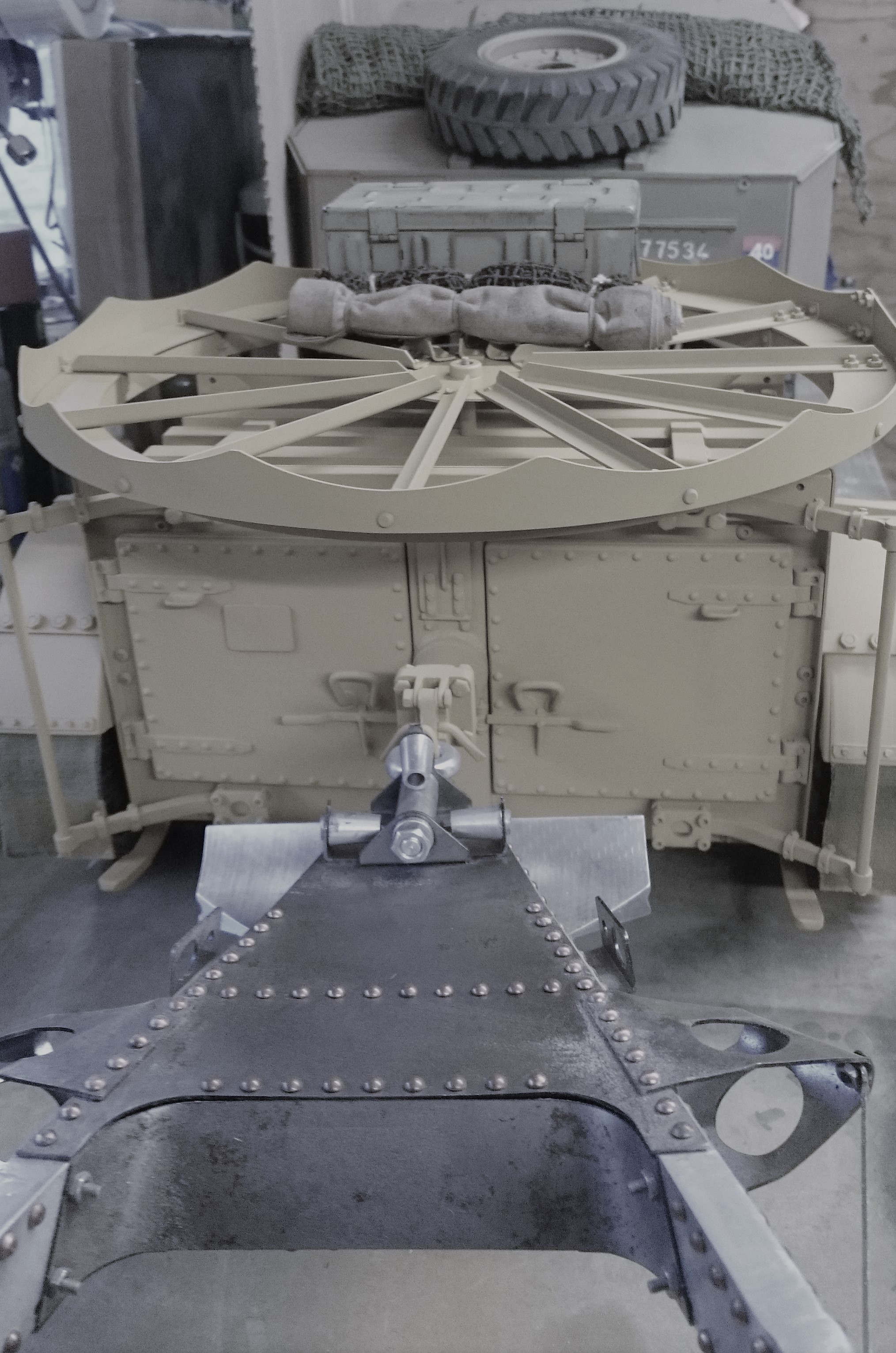

Getting close to enough detail I think, just a little more to the draw bar, I would like to add the tarp to the front or maybe fill that area with kit , that just leaves the mudflaps and those spongy rubbery pads that hold the draws tight, I have found some very nice light rubber pads on the Net but they are the last things to fit as I aint painting round them every five minuets.
I do like the turn table stowed over the limber.
There is enough going on with the 25 pounder so it may lose the table to the limber , I will have to make some brackets to hold it in place.
The colour contrast is only apparent in these photos as I have not started on the top coat just yet.

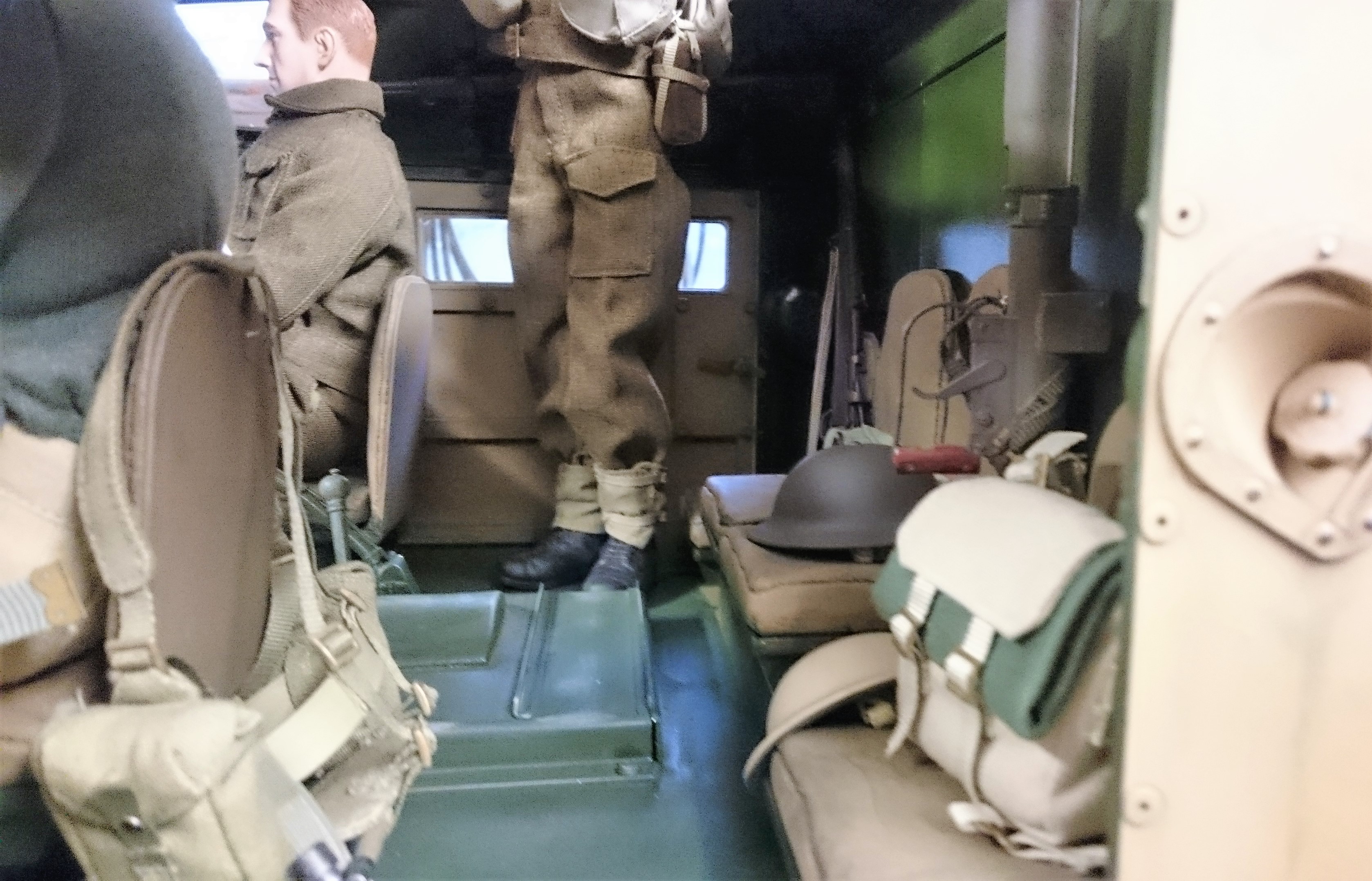

When this Trinity is put up for sale it will include the crew and kit. Im not that fussed about selling though as it will be a long time before I am bored with it. I have much video work planned depicting the unit in action in the field.
Good chap holding his weapon between his legs while he pushes out some ZZZ's (no pun intended lol)

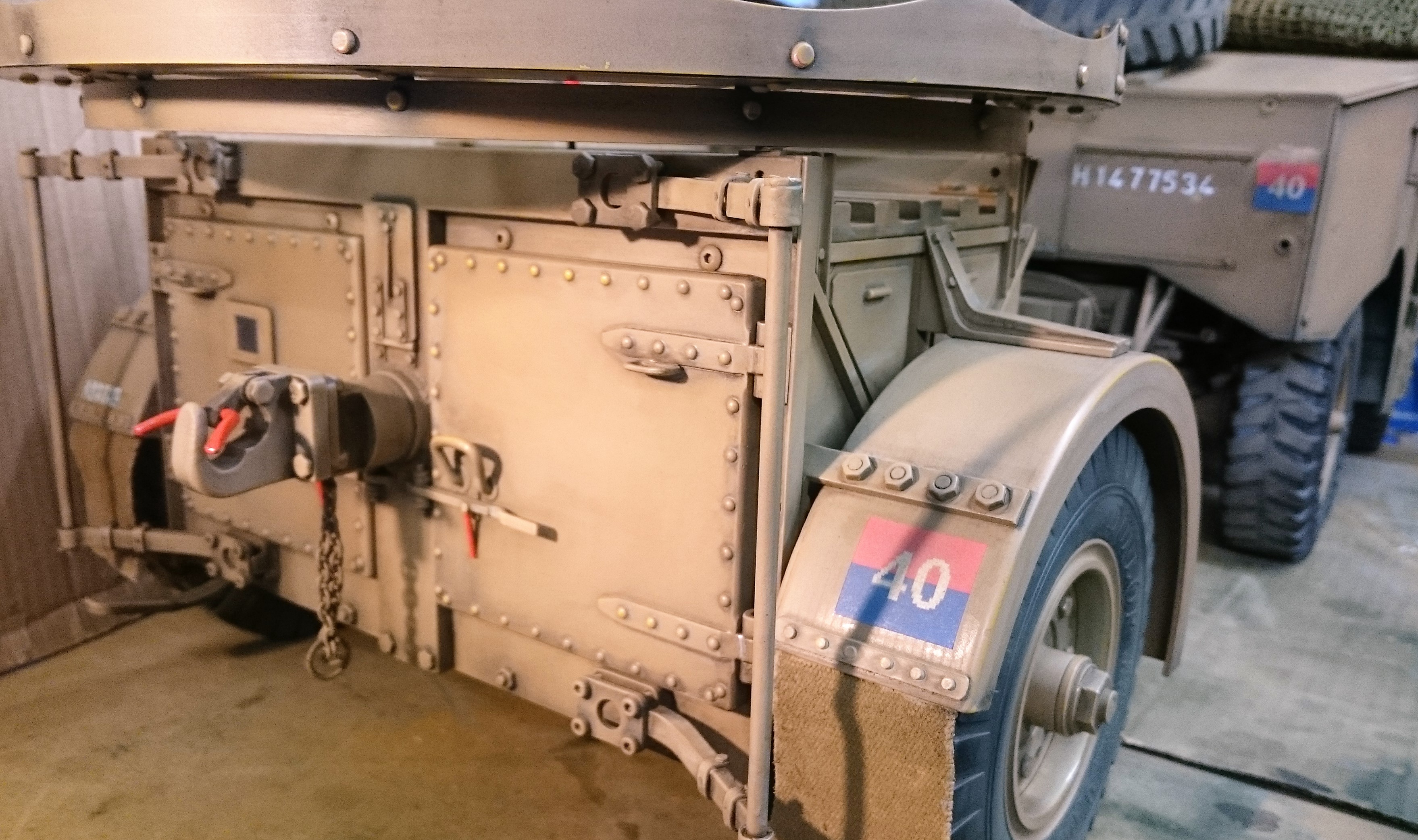

I ended up adding lots more detail but that's it now just top coat, unit and id numbers and weathering then onto the Gun.
Mud flaps in canvas.
That's a spare 25 pounder used for firing I have a new one for this build
I am hoping those rather stiff canvas mud flaps will relax a bit over time.

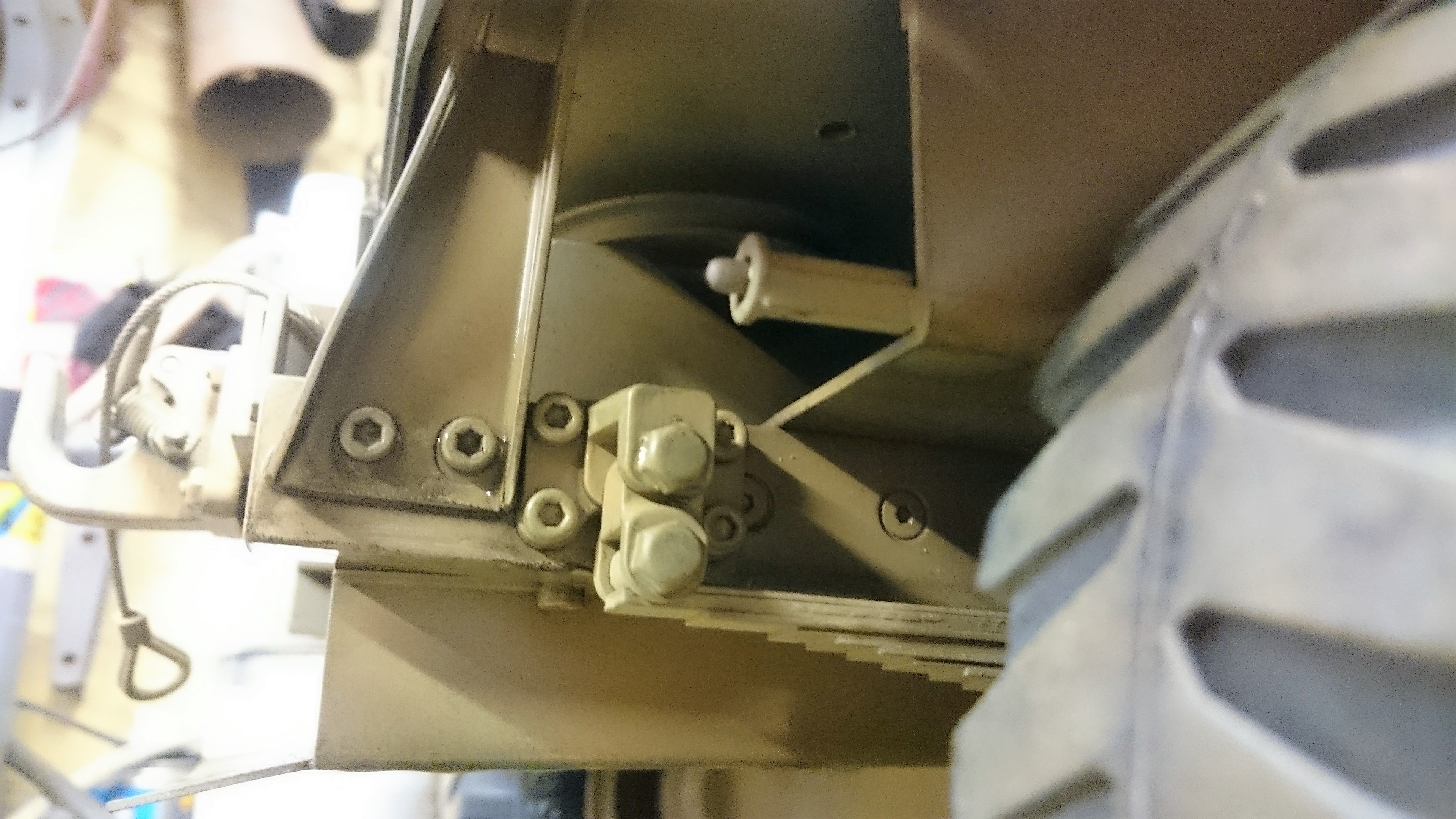

You would be surprised at the amount of work detailing the front area, welds and fiddly gussets and lining up the bl--dy drawbar.

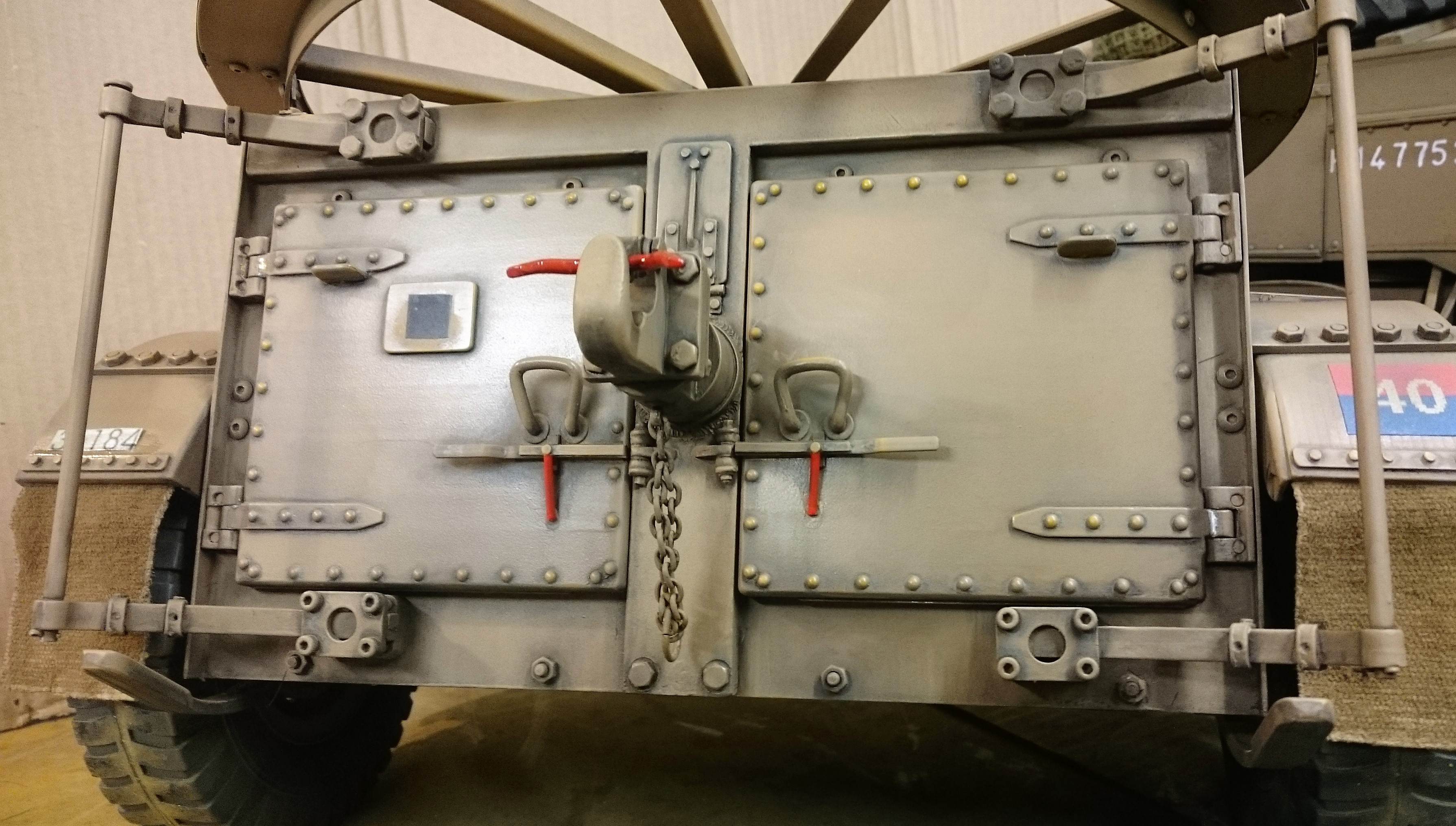

Top coat and first washes and weathering, I will include a few simple/basic techniques for the weathering, now I know we all all have our own techniques but these are easy hints for those who may not have done so much .More to follow for the larger more difficult areas later. I wont go into to much detail at this stage.
Shading the edges and anything that has a border.
Same with this one, a darker colour to bring out the different panels and all the edges.
Prior any washes just different shading to add depth.
The border shading done with a spray pen, follow all the edges inside and out.
The shading in mono tone, this would need to be alot darker for black and white video work. The first wash is applied soaking the entire piece.
Washes, it looks crap at this stage but we will remove 80% when its dry with another technique.
Washes applied with a 6mm soft brush
Dont panic if you have a go as it looks awful at this stage.
The wash finds all the low areas and seams. You must use gravity to pull the wet wash down the piece for it to look like natural weathering, so it needs to be the the correct way up.
This pic shows some reverse weathering, its my way of showing the high lights, you simply rub away the wash until it looks just right, more on the the larger areas when I get a minuet.

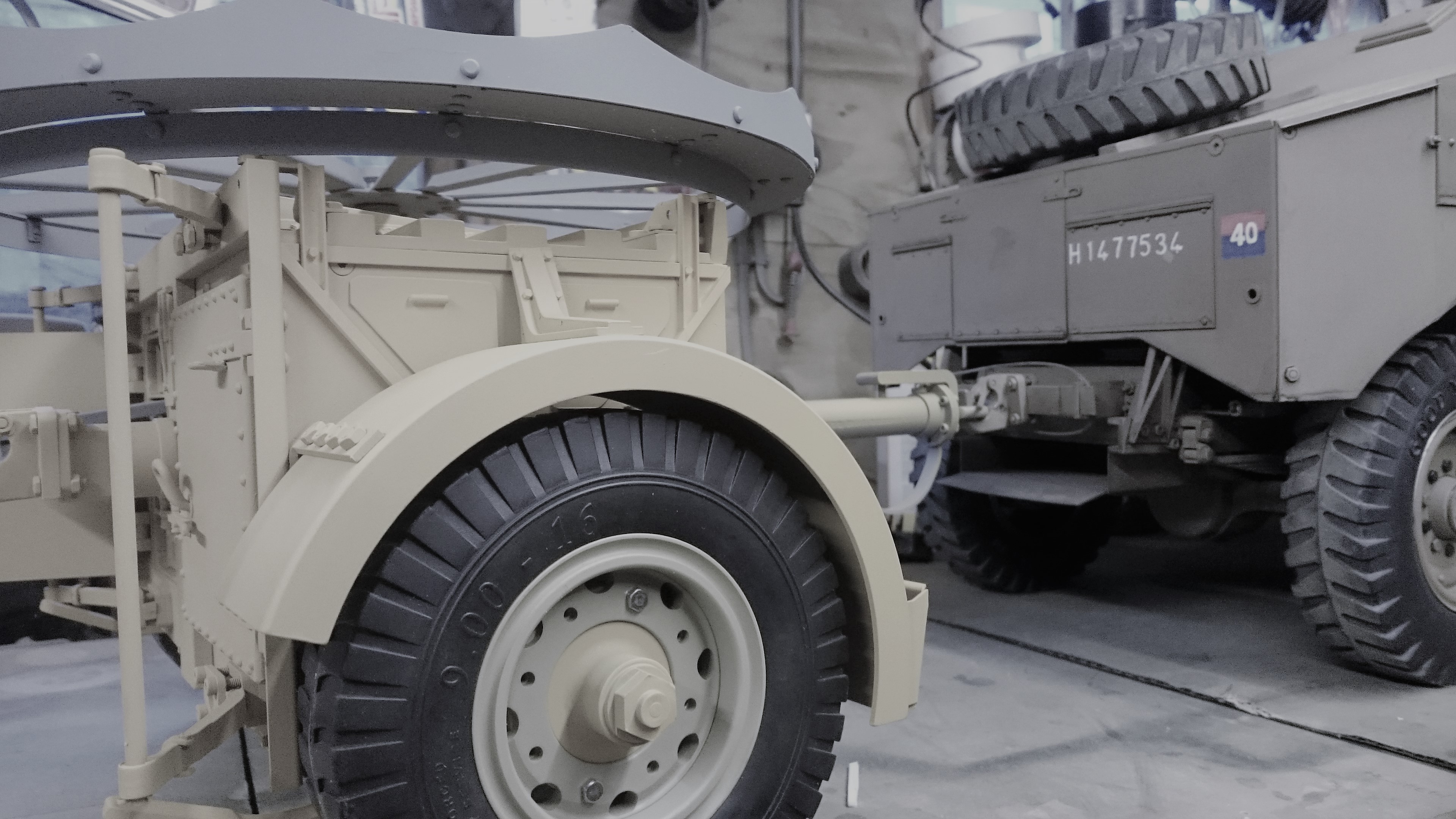

I want to know more about the wife's hair spray technique :shock: it sounds interesting and Simons work is pretty dam good.
I must echo what has been said before that the wheel you have painted is very convincing indeed, I dont have that much patience or time but its good to see the end result......Phil.

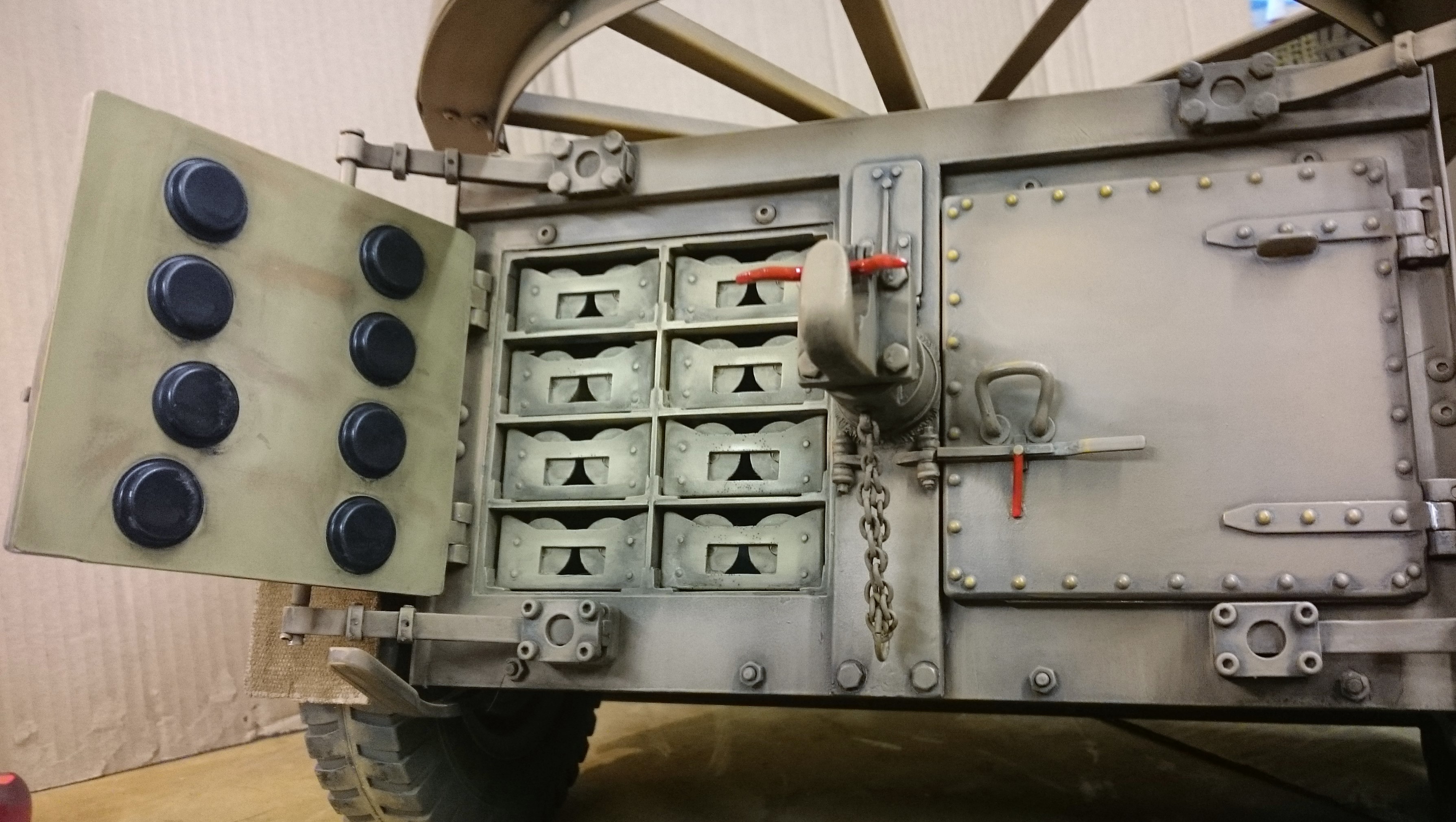

Some more weathering photos and the finished limber, now to the 25 pounder.
Its all dry and looks like this.
Simply rubbing off the unwanted wash.
Use a lint free rag and your chosen thinner, in this case meths. The more you rub the deeper you will go through the underlying paint layers.
Rub away everything thats not wanted but leave hard to get to areas for contrast.
A good 80% removed from the draw bar
Give the rivets and bolt heads a real good going over.
Nearly there.
Nearly there.

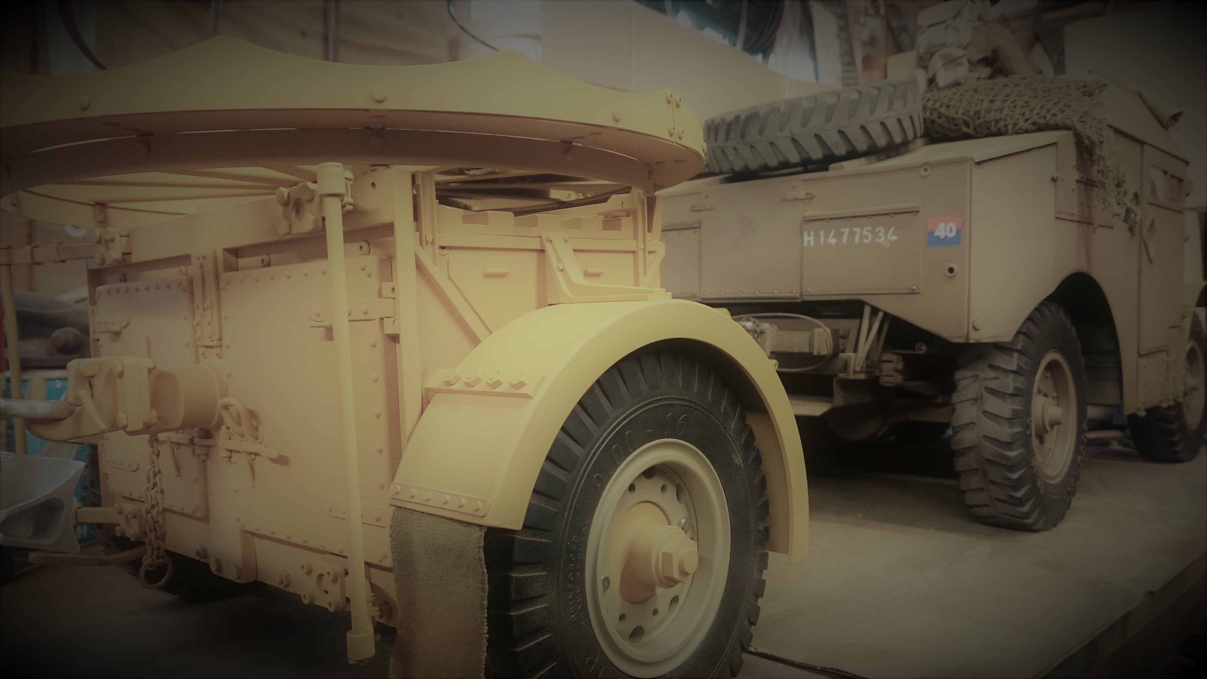

Shes getting that 1940's look.
Dry brushing and adding the chips and scratches can be done anytime.
And all done, quick init? Once the decals are totally dry I will brush the numbers by hand.
