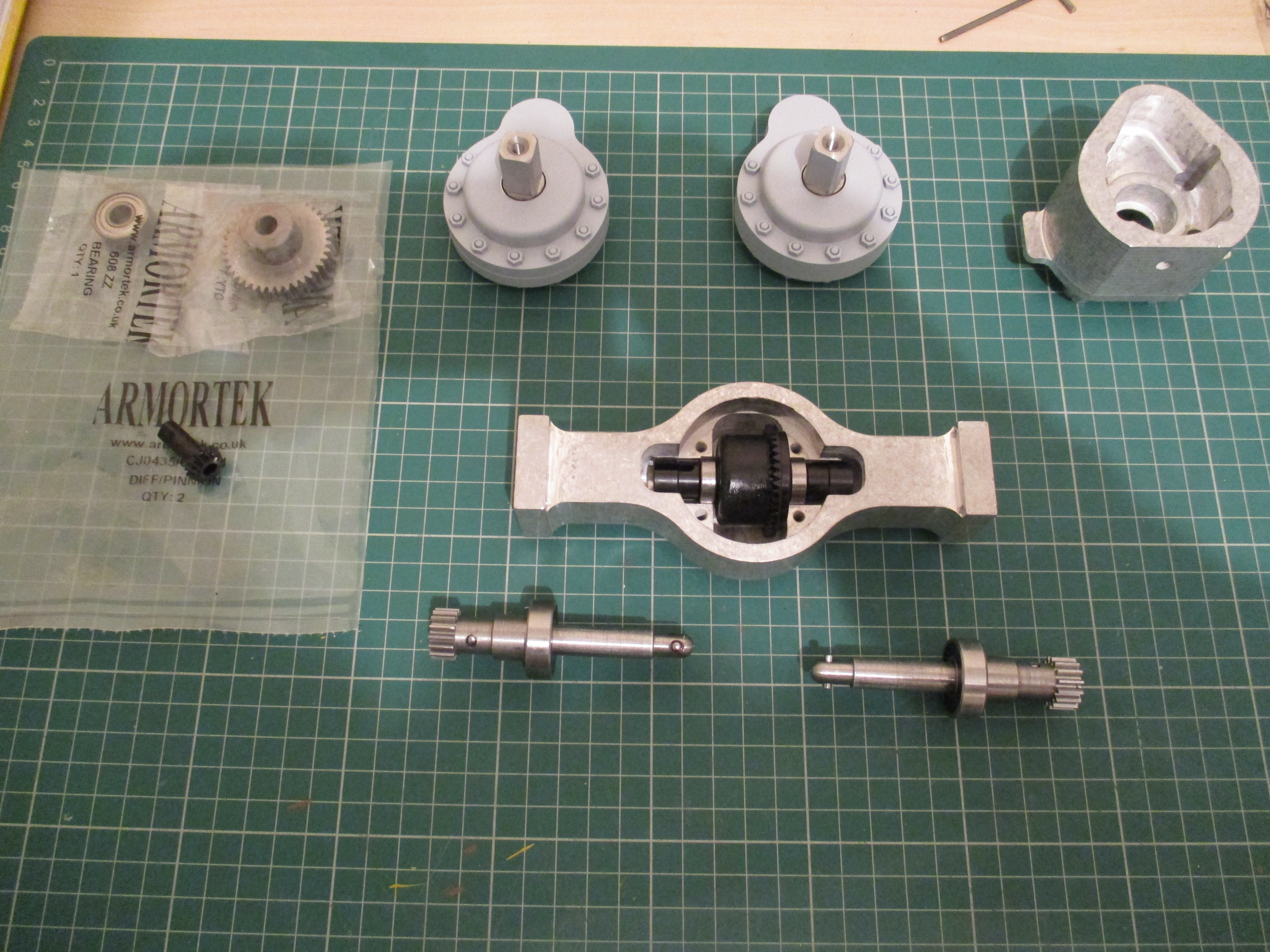

Hello Dennis,I have taken the plunge yet again and started my 251 build. Having followed your construction I need to clear up a small technicality concerning the drive axle, page 2.
I have assembled the drive axles build numbers 3-7.Ok.
Question, are the two 3x12 pins at the differential end, equally centred. For example, the same amount of pin showing either side of the axle, where the axle enters the differential drive.....?
While I am thinking about it, have you added any extra 'grease' to the differential, there is already some on my gear wheel.....?
Regards Mick.
Regards Mick.

Hi Michael,
Glad to see you are back building again. Yes those pins need to be dead central as there is not a lot of meat either side. The way I did mine was to put them in the diff cup to make sure that they were central. In my opinion they could have been a bit longer perhaps but due to limited space in the diff housing probably not possible and I would think Mark has tested it and found to be ok. Look forward to seeing your build. I am just finishing the left hand side and rear door opening and closing and mounting the Flak 38 gun.
Yes I did grease up the gear on the diff.
Dennis.
Dennis.

Hello Dennis, thank you for your reply, that's a relief, as I had used Loctite and set the pins central in the axle. I have to say the differential parts are a nice fit with very little fettling ( already talking like an engineer ).
If Mark says it's ok, then it's ok.
I will add a little grease also....
I will probably go for the Field Ambulance type with my Sdkfz, after 34 years in the Ambulance Service it just seems the right and proper thing to do....
Thanks again Dennis for your quick response to my questions.....Mick

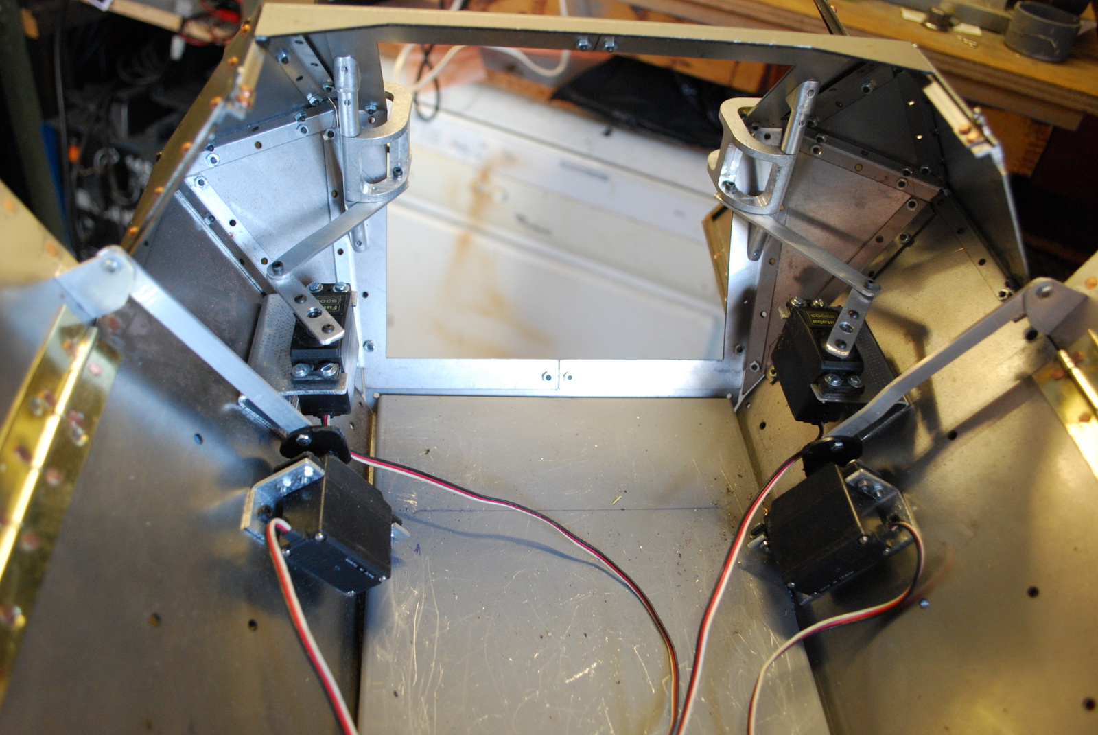

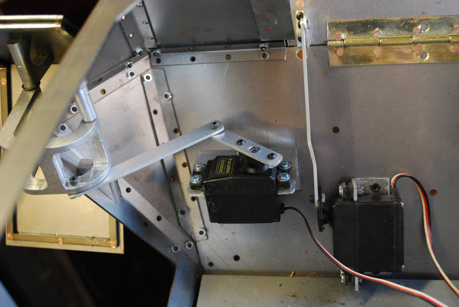

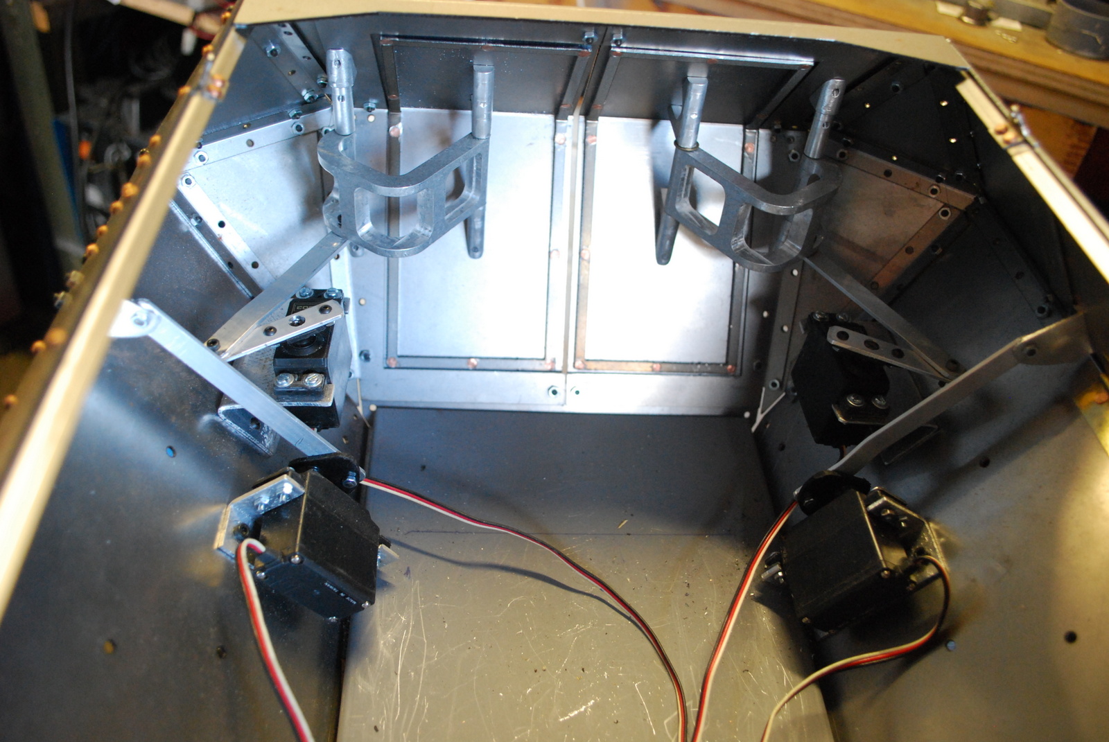

Re: My 251 build.
Hi Mick,
Here are some photos of the door operating mechanism. The servos are on Y leads so they operate together although the left hand side servo is reversed. I use a Spektrum DX8 transmitter and receiver which is an 8 channel system it also has the feature of not only being able to program the travel and direction of the servo but also the speed at which it operates which is why I can get the doors to open and close slowly. I am hoping to get a figure in the rear behind the doors holding a m/c gun with led in the barrel synced with the sound system as the led in the Flak 38 gun will be. The servos will be hidden from view eventually. Also maybe fitting a searchlight. Not completely authentic but hope it will provided a bit of interest.
Dennis.
Dennis.
