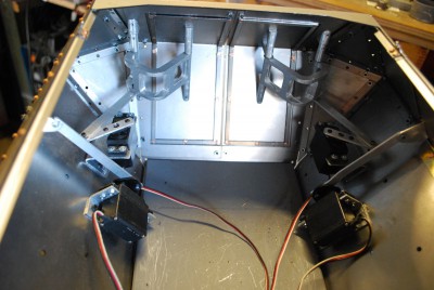

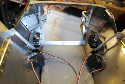

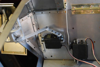

Hi Mick,
Here are some photos of the door operating mechanism. The servos are on Y leads so they operate together although the left hand side servo is reversed. I use a Spektrum DX8 transmitter and receiver which is an 8 channel system it also has the feature of not only being able to program the travel and direction of the servo but also the speed at which it operates which is why I can get the doors to open and close slowly. I am hoping to get a figure in the rear behind the doors holding a m/c gun with led in the barrel synced with the sound system as the led in the Flak 38 gun will be. The servos will be hidden from view eventually. Also maybe fitting a searchlight. Not completely authentic but hope it will provided a bit of interest.
