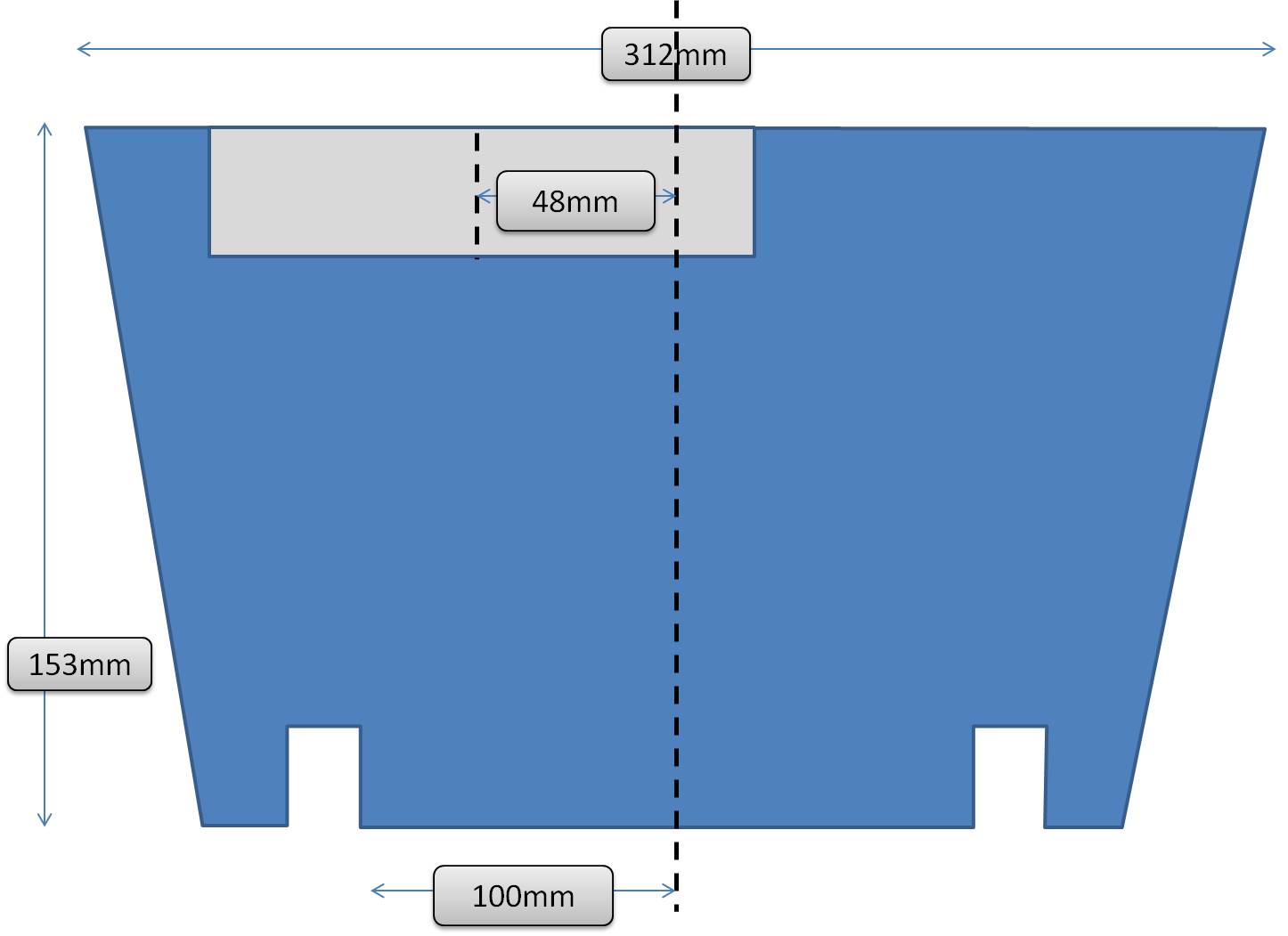

Bollard cut-outs are 23.3mm wide and 29.0 high
Driver's cut out is 145.55mm wide, 35.0 high and the chamfer is 6 degrees.

Hi, Stephen.
Many thanks for the information, i done some measurements from a AFV 1/35 scale model
Centurion glacis applque armour and i was between 1 and 4mm out. Would it be possible to have the overall measurements of the plate and the start position for the cuts outs for bollards and driver position from the outer edge.
As i have never done any milling before i am going to have go at this armour plate first to get some practise, if it is not right i can just try again.

- Has liked: 1038 times
Re: My Beaut Aussie Cent
Like this?

Hi, Stephen
Just one more question the top of the plate is 312mm in length, but what is the total length of the plate where the bollards are. I have it at 280mm, I think it might be a bit shorter than this?

I had a great message from Paul Scott who is restoring ARN 160091 in Australia, with some photos that showed I'd got the sides of the applique too wide. Here's the corrected shape (measurements on the previous page are correct). I've also added the mounting blocks for the roadwheel retainers (which were known as Omega brackets):
