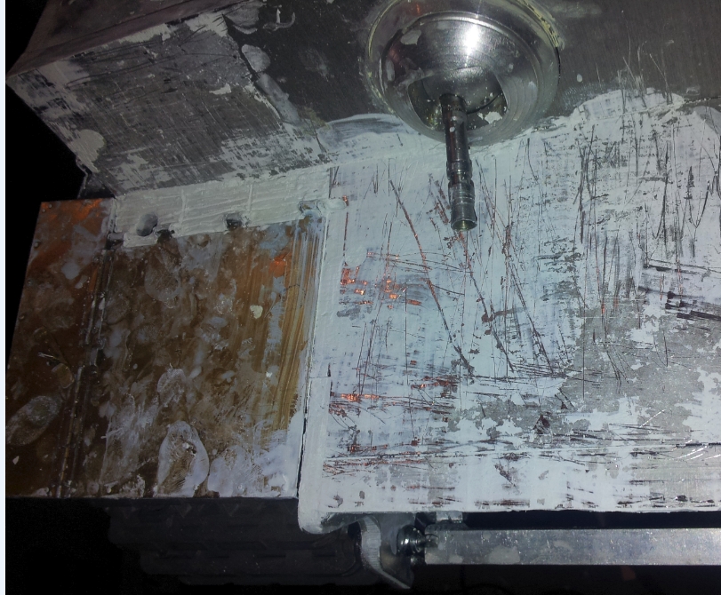

Re: No 012 - Bedroom Build
Hi Bob

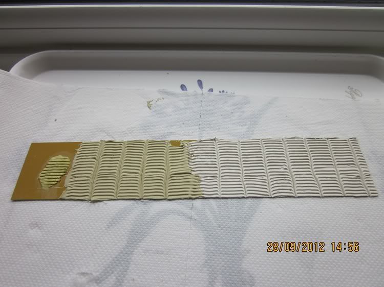

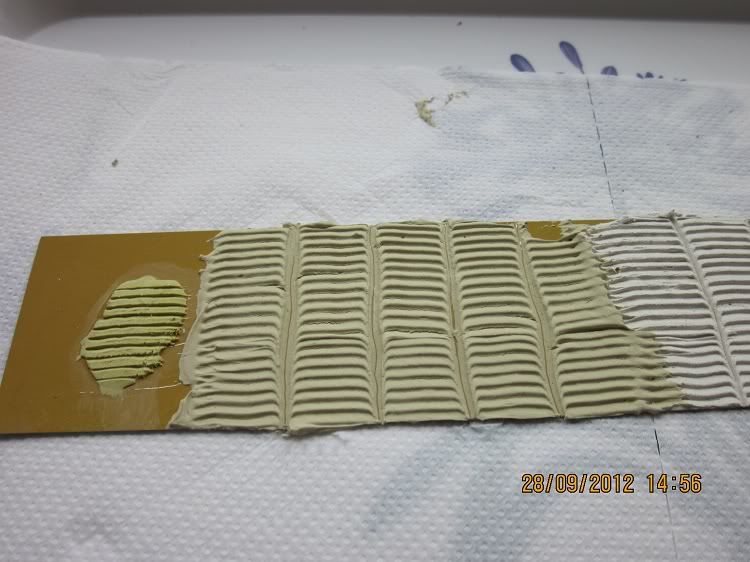

Left my sample Zimmerit for about 24 hours and yes it worked out ok.
The DunkelGelb mixed in is a bit lighter because of the white Tile cement and the
white PVA Glue.
As I mentioned befor it made the mix a bit creamyer so was easy to put on the metal
and the patern went in easy.
More important the pva glue made it a bit harder than the bare tile cement,aswell as
poking my nail into it the little bits that you can get hanging over the plate and pick
off after its dryed,couldnt be picked off like the bare tile cement so a bit of
sanding would fetch them off.
I think the PVA Glue,aswell as making the mix creamyer,made it stick to the metal
when trowling on with no effort at all,made it harder and yet flexible enough still
to bow the peice of metal without the Zimmerit giving way.
The Pics below show the bare whit Tile cement mix I used on my hull,the Dunkelgelb bit
the new mix and the little blob to the left was my Sad little try at Milliput.
It's hard, brilliant. Does it chip, and will it take the paint??? It looks good.
Hi
Looking good with the Milliput Bob.
Your patients is paying off
The tile cement with Pva Glue will take a good knock and your prize
paintwork will have been battle damaged before then
I tried a rolling pin but even with water I managed to get it to stick
to the roll and my fingers.
But with a bit of perceverance I managed to get a few flat bits the same thickness.
Keep going Bob,its lloking great.

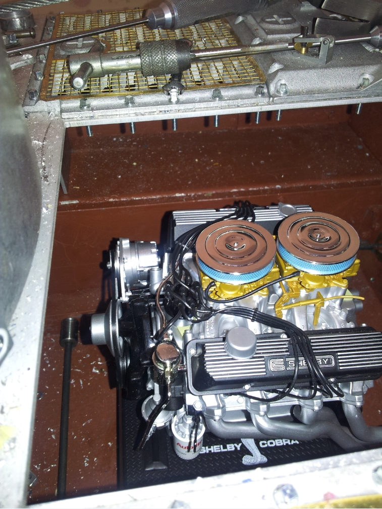

Ok it's not a Maybach, it's not even a V12. But it is a metal 1/6 engine with moving parts.
By the time i have finished with it inc. new down-pipes, air-filter, head extension, moving bits around, aging process, proper compartment and mounting: it'll be a darn sight better than an empty space coz i cant afford the maybach
V8 metal cobra engine - ebay £40

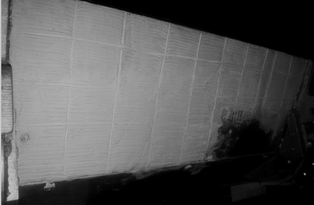

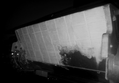

Changed my mind on the zimmerite
Removed old: It's even harder to get off!!
New pattern applied
New pattern applied

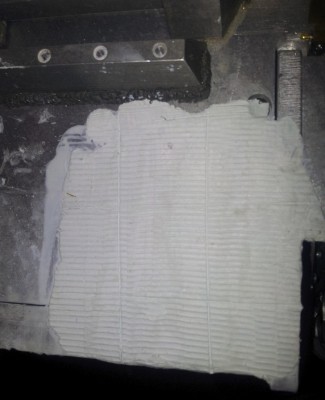

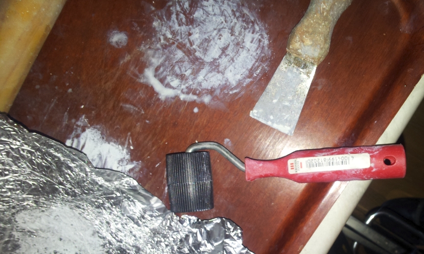

Using miliput mate but have a new system for getting it really thin and even pattern as well as doddle to apply.phil fitzpatrick wrote:Hi Bob
Keep at it Bob![]()
That new patern looks good,are you still using Milliput or is that cement?
Phil
Mix milliput, as i was advised by others, wet both sides plenty, place on tray with silver foil on top, roll with pin, scrape off, put on tank, roll with serrated tool designed for putting tile glue on, insta dry with black/decker heat gun. BINGO
Well done Bob,
Thoght you was going to cook it for a second,when I was
reading your methods.
Great idea with the roller.
Phil
