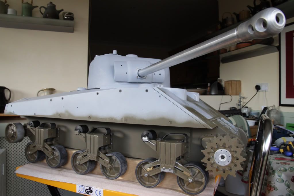

Another photo,
Currently using Vallejo Olive Drab primer on top off the Upol.
We're Shermans repainted by the Brits when they converted them to Firefly standard?
If so what colour did they use
John
John

Re: Firefly 008 build
Olive Drab of course. But not US Olive Drab, British Olive Drab...
It's a whole wriggly can of worms I'm afraid.
A series of books which Stephen White recommended, and which I can heartily second, are the "Warpaint" books by Dick Taylor. These bring together all sorts of information on British colour schemes, camouflage, unit markings etc.

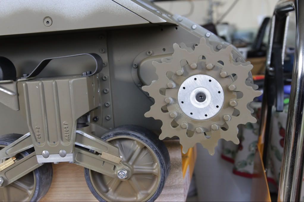

Hi
Not much building this weekend. I did bite the bullet and fit the drive sprockets, which went smoothly!
John
John

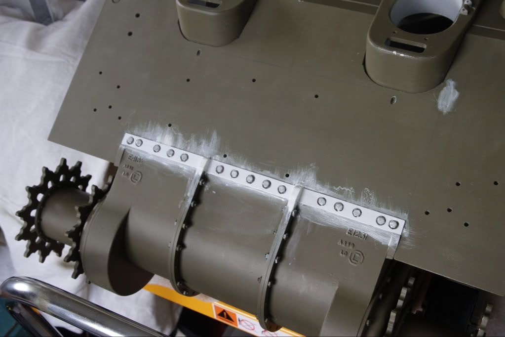

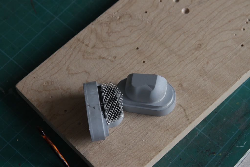

Hi
Whilst waiting for the weather to improve, I want to take the Firefly outside to fill the countersunk bolt holes. I don't think the 'boss' would like me stinking the house out with car filler!
decided to add some detail to the dif case.
Also add a piece of mesh to the louvre. I think the mesh is too small, I used the type that car body repairers use?
John
John
That grill is looking good
Here is a photo from one of the Bovington Shermans - I think it's the Crab
And here is my attempt from a while ago, using a sheet of mesh from, I think, B&Q.
There should also be a bolt running through the middle of the part - you can see the head in the Bovington picture.
Thanks Adrian
You answered my question, the mesh is too small. I will take it off and visit B&Q, to find something larger.
When ever you see Shermans, with louvers, they seem to be fitted in different ways. Some with the mesh facing forward, some with top following the slope of the rear deck, some with the top following the horizontal. The drawings I've got, show it with the mesh facing forward and the top horizontal, is this the correct orientation ?
John
John
The majority of pictures in the Mark Hayward Firefly book show them facing forwards with the to level, but there are still quite a few where they are other ways around.
What I've never understood is that what's underneath the vent is usually referred to as a grouser storage box, so I don't know why they went to the trouble of casting these vents. Other marks of Sherman just have a flat plate instead.
