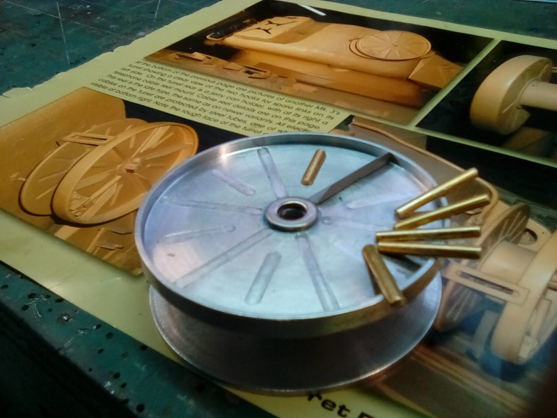

Lots of brass pieces to cut, file and fit
A few look see photos to see how she's coming along

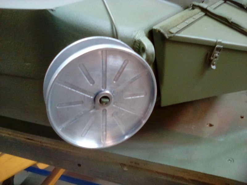

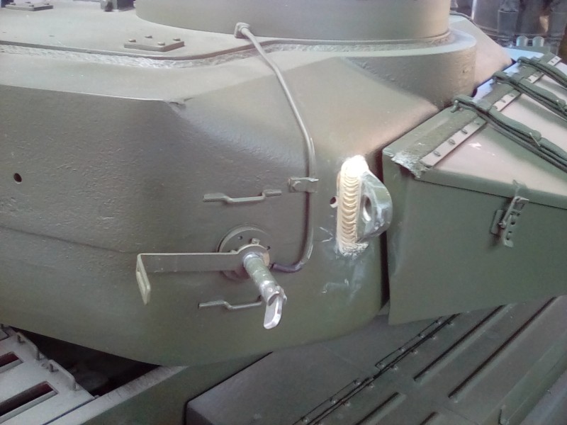

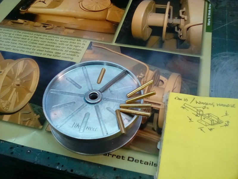

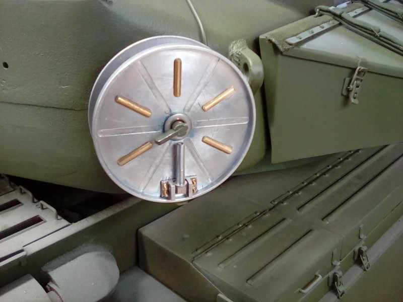

The don 10 reel is all but finished

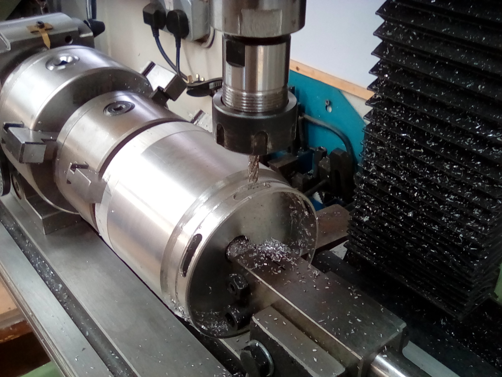

Squaring the bracket stock

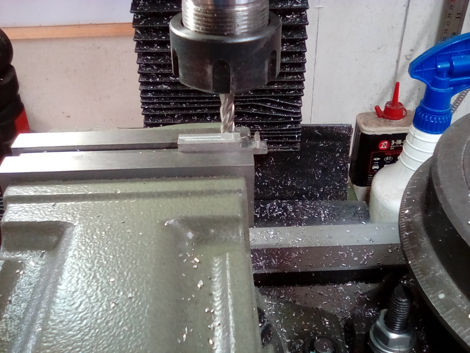

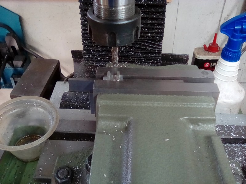

Milling the tricky little handle bracket
Handle blank
Handle blank
2 pairs of glasses are needed for this work
I've milled the square end and drilled the pin hole
Turning the final handle diameter

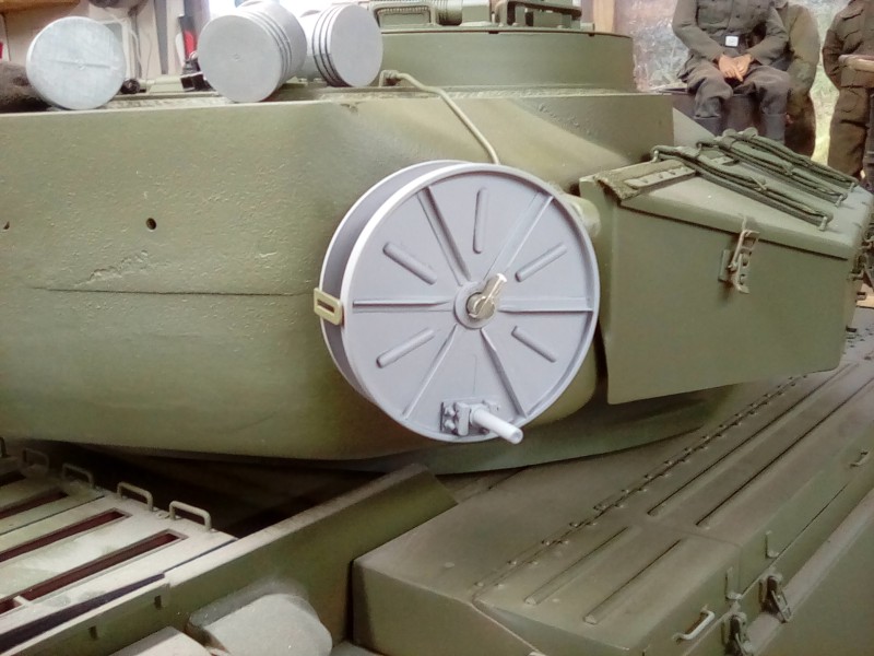

Working handle......
..........folds out and folds back in

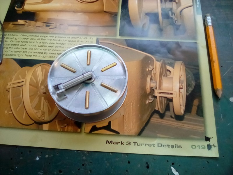

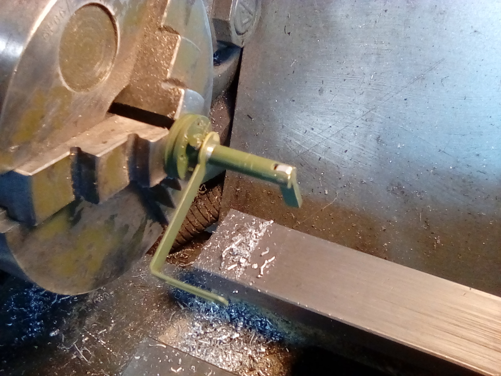

Final adjustment for the cable pay out arm
Thread lock as this could be the last time the spindle is fitted

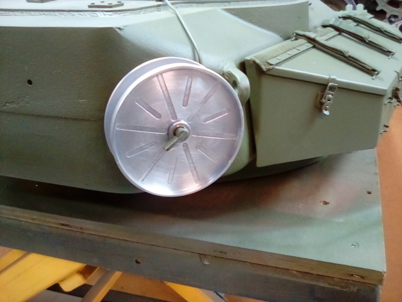

We will be loading the reel with a don 10 cable in 1/6

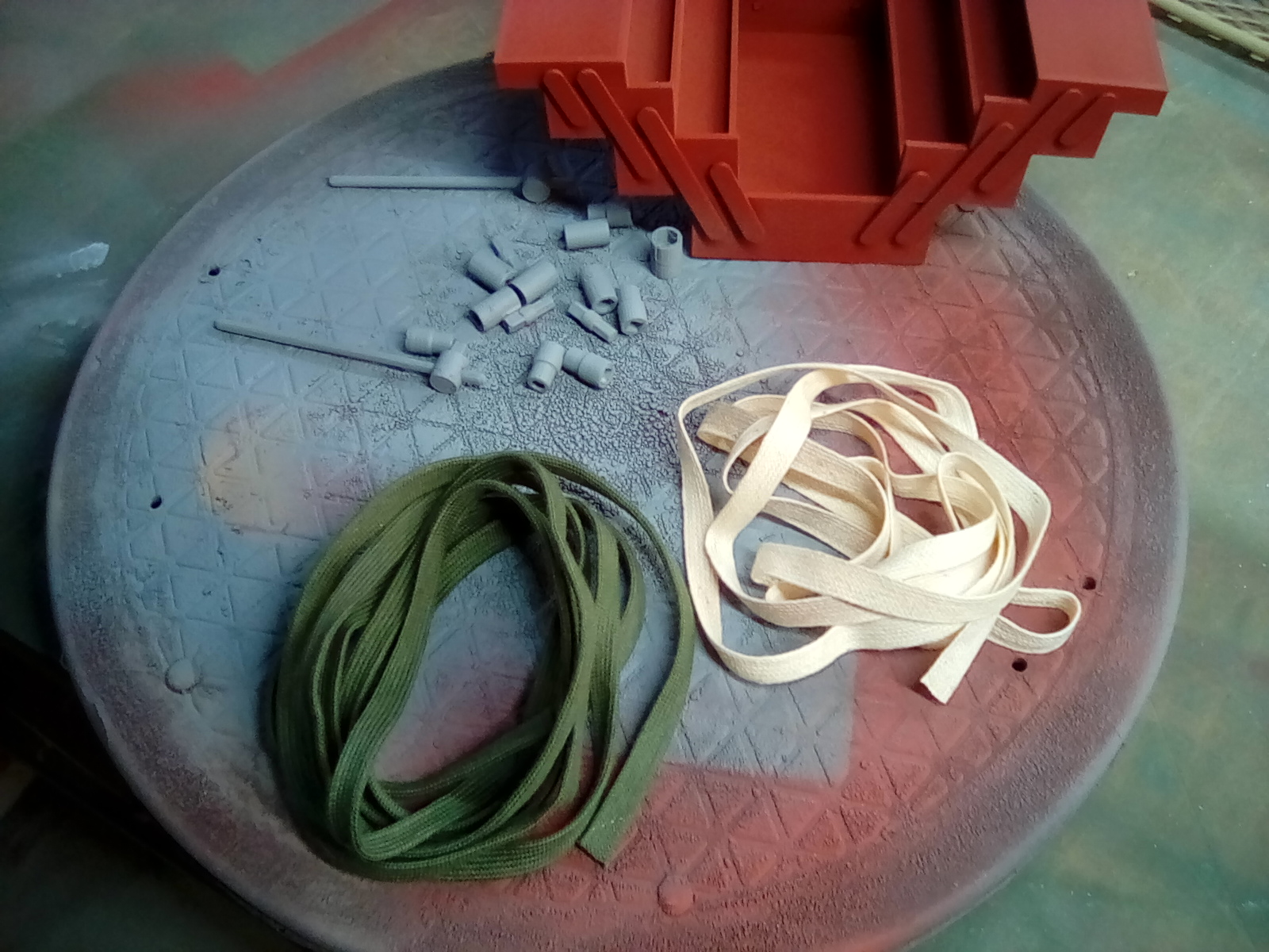

For Muttley, your webbing mate.

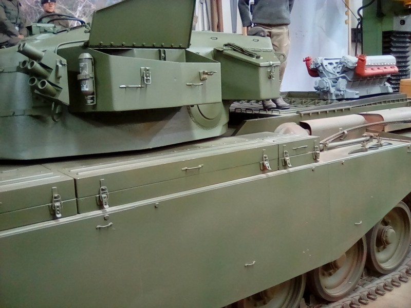

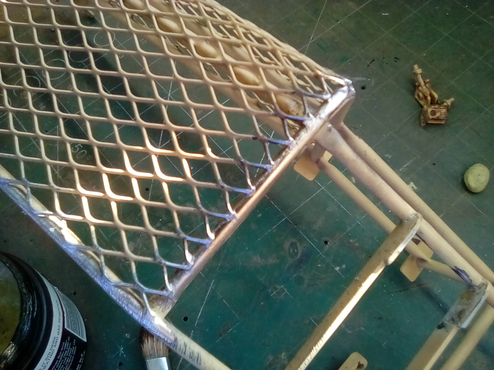

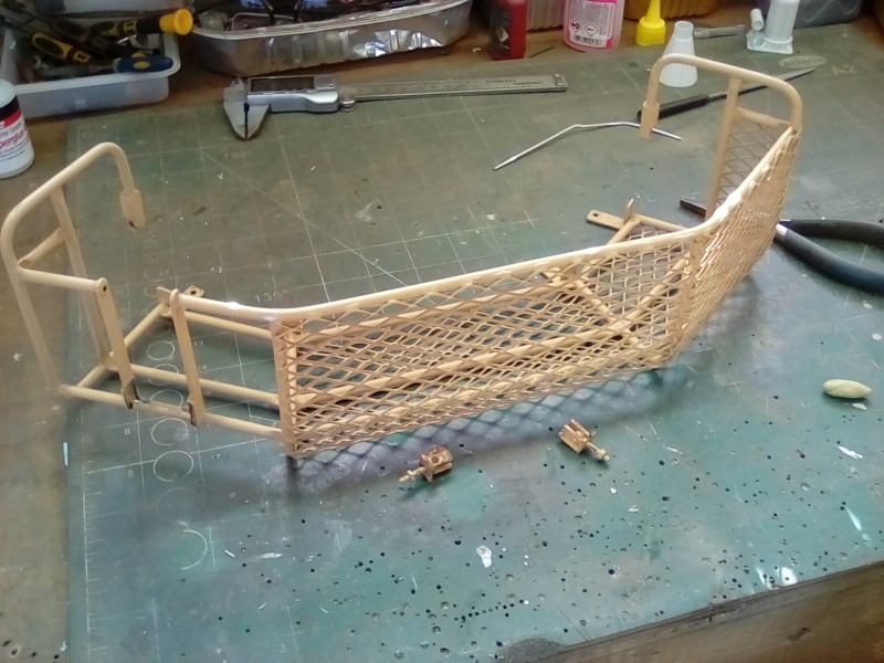

Made a start on the turret basket. The winky pot arrived today thankyou Didier great service my friend, more on that very soon.
Nice sunny day in Cornwall so I can paint outside

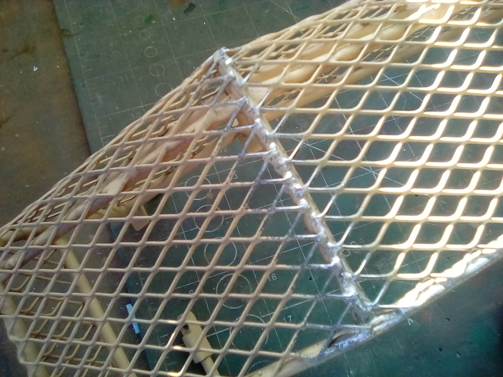

The turret basket is basically very good
The search light mount is to narrow and will need some adjustments
The mesh is the correct size
With a little work this will tidy up nicely

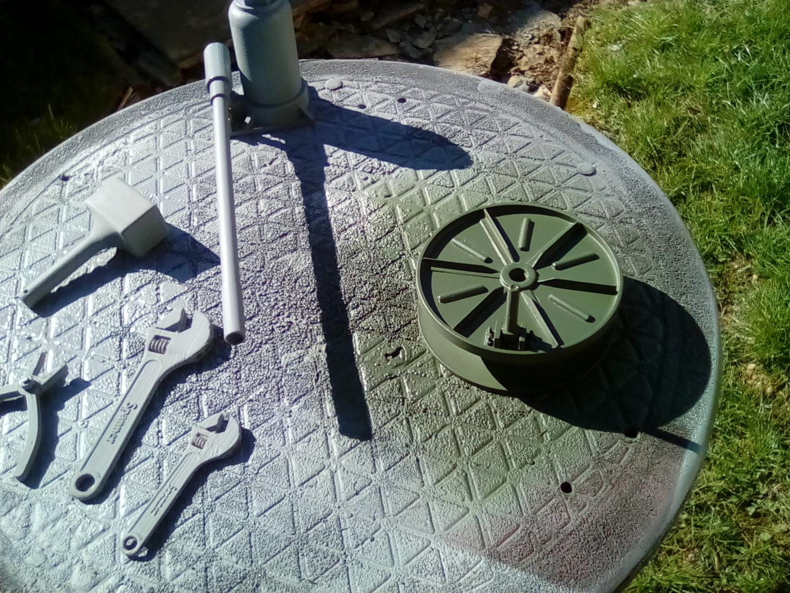

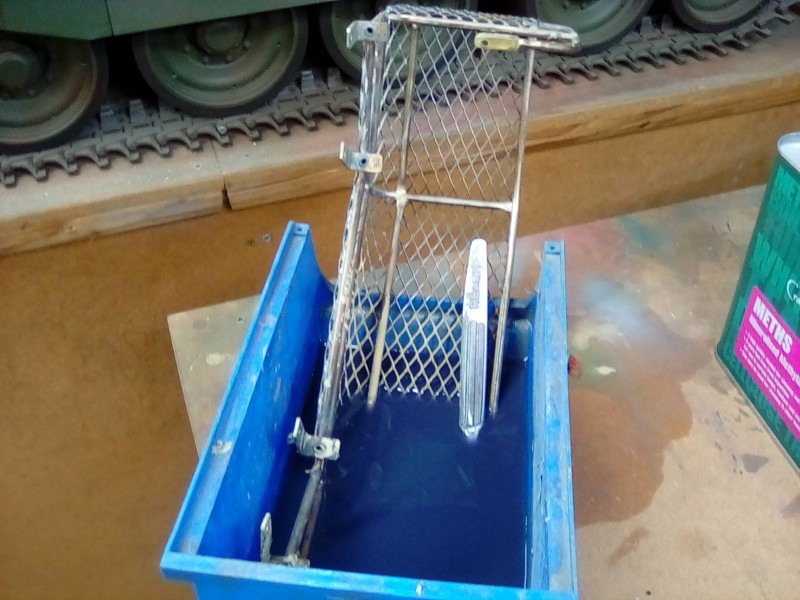

Paint removal
Paint removal
Whilst the paint is soaking in meths I can get on with this
There's a long way to go with the search light
The weld is now up the right way
Nice bit of top coat and it blends in nicely

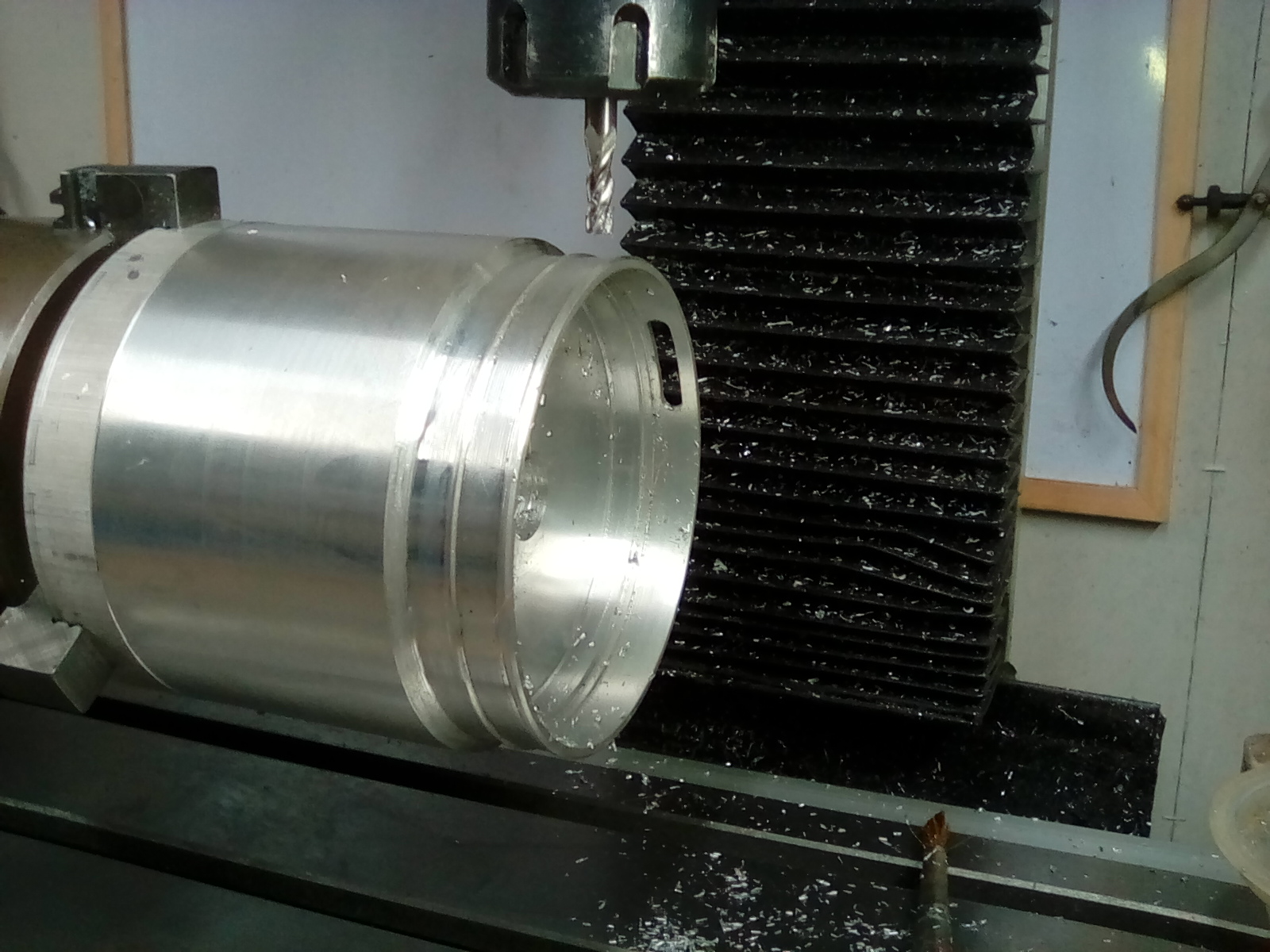

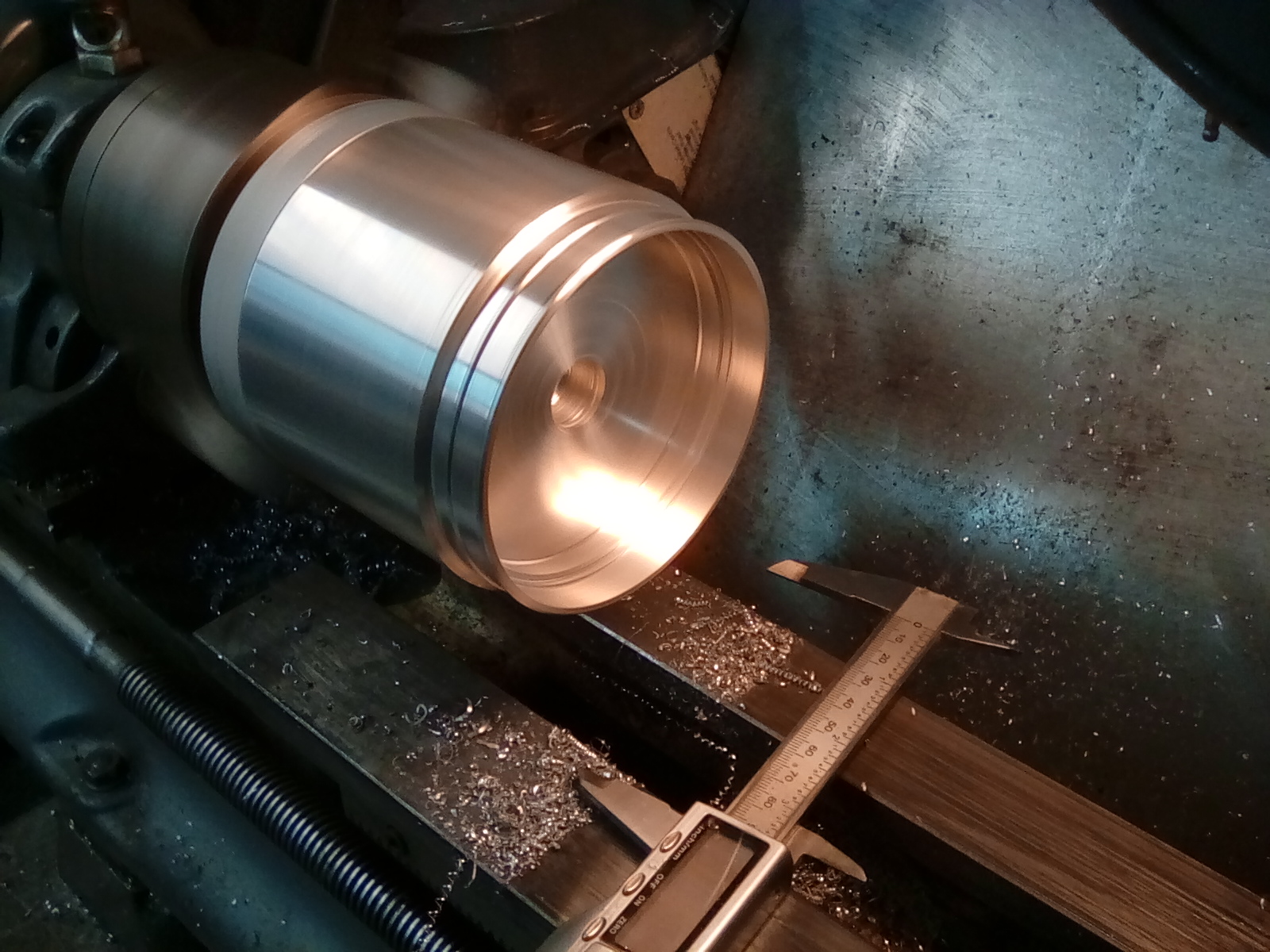

The searchlight is a big piece.
Lots of material removed.

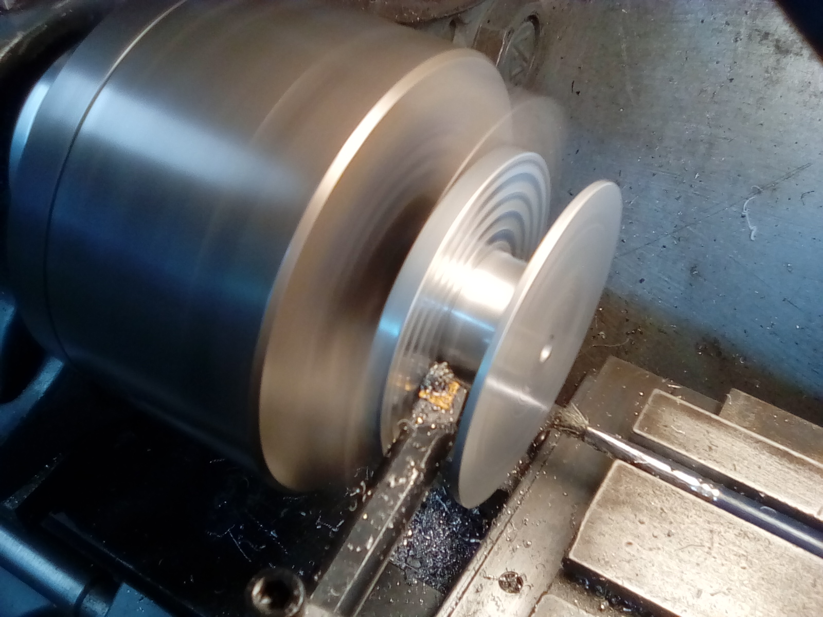

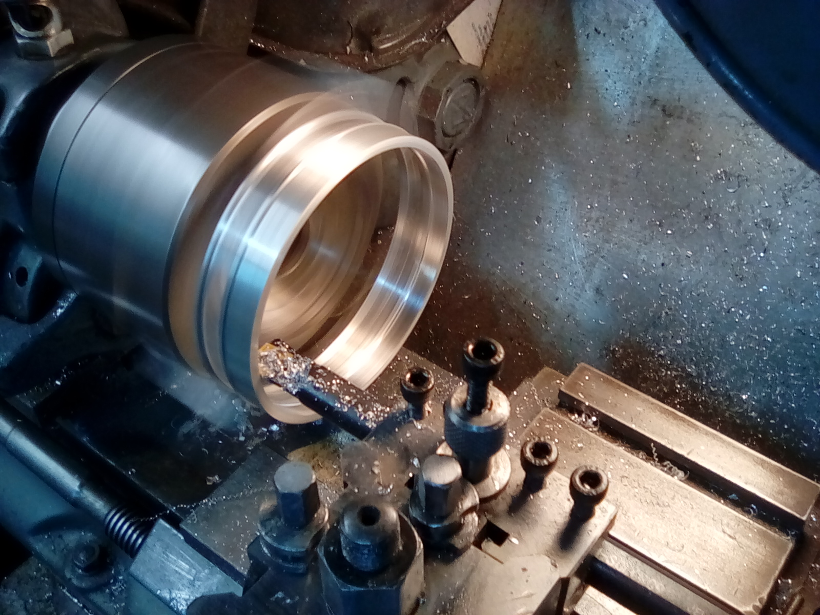

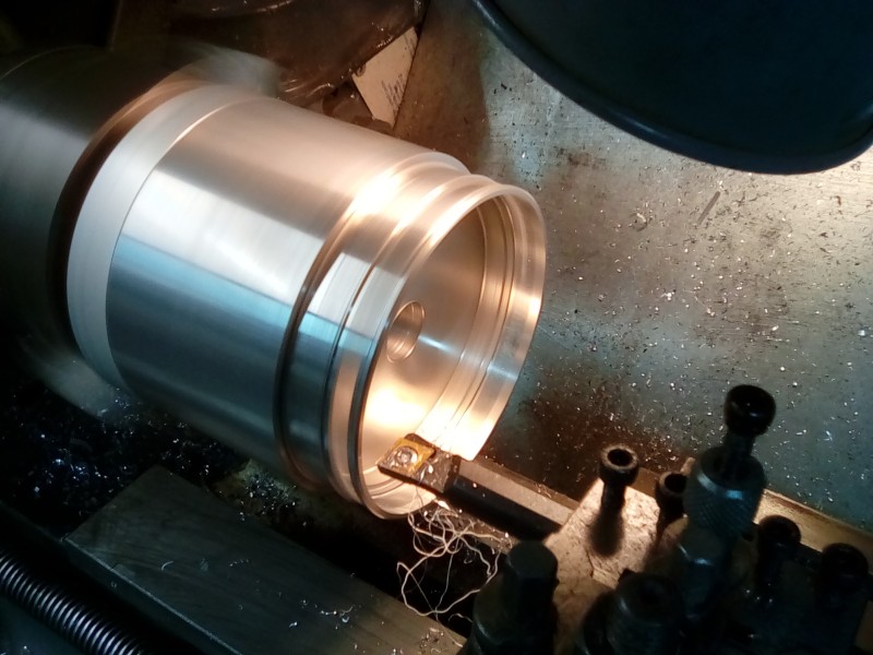

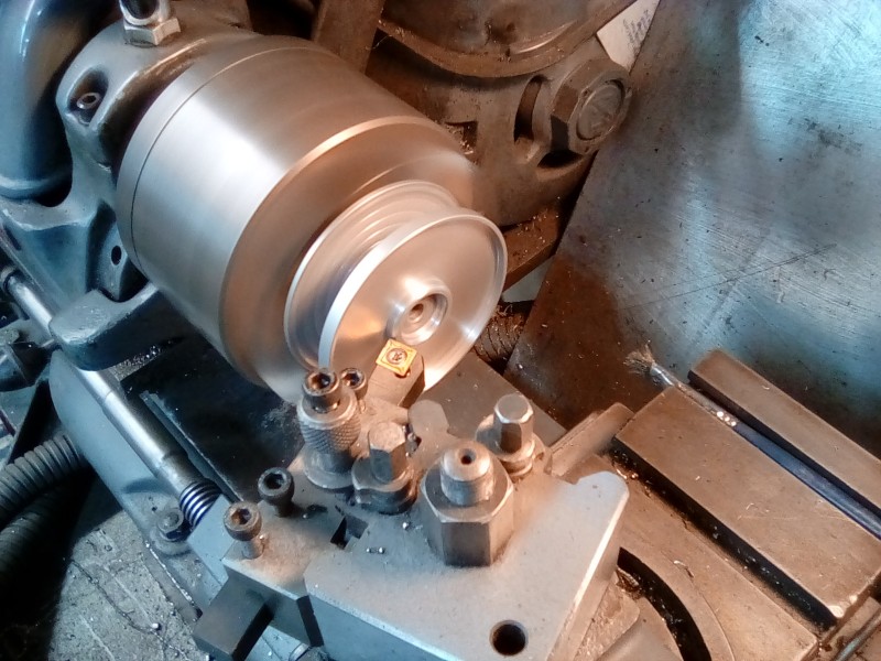

Turing the searchlight lense / filter end piece first
Nearly done with the paint removal

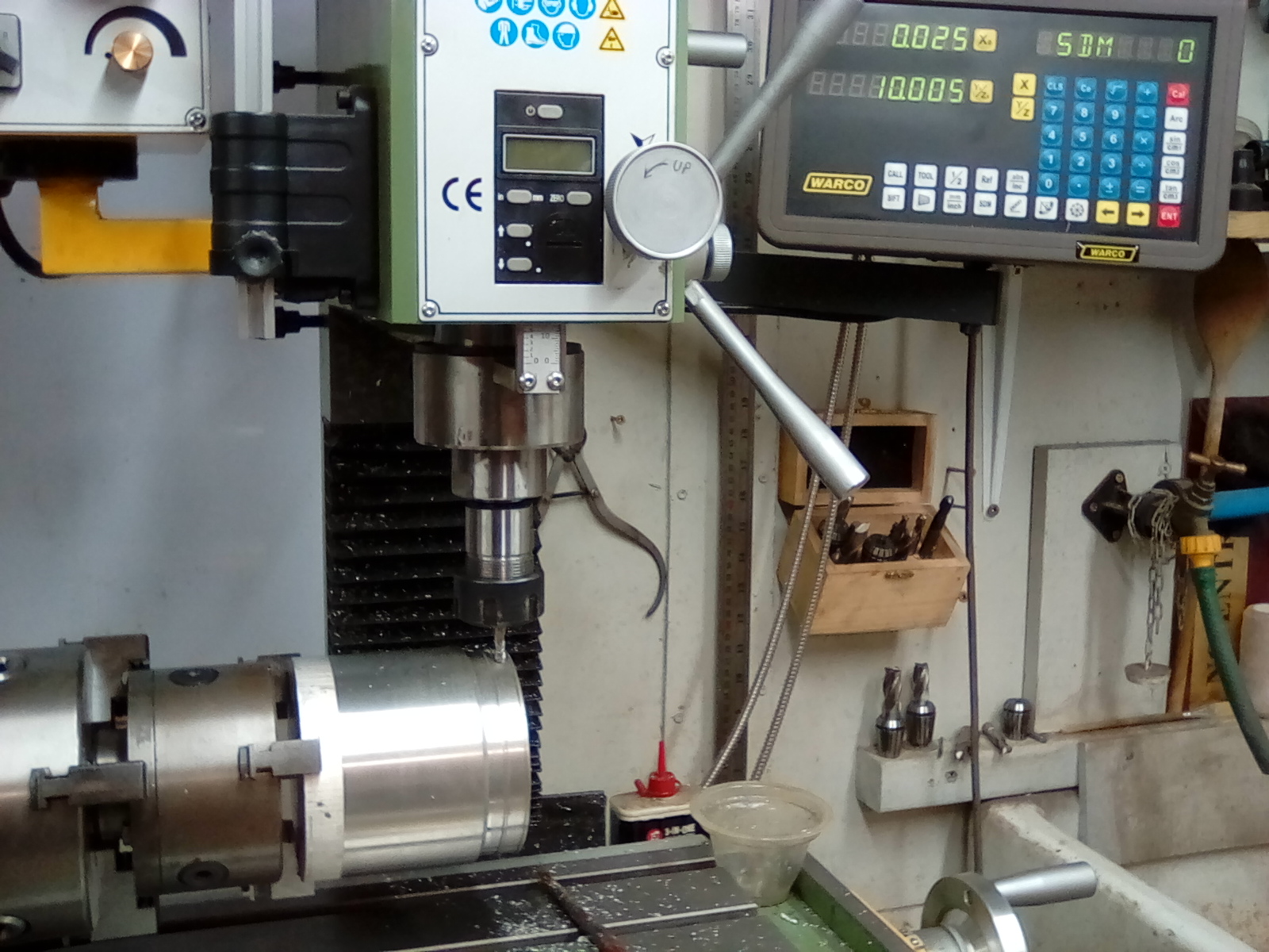

My new toy
My new toy

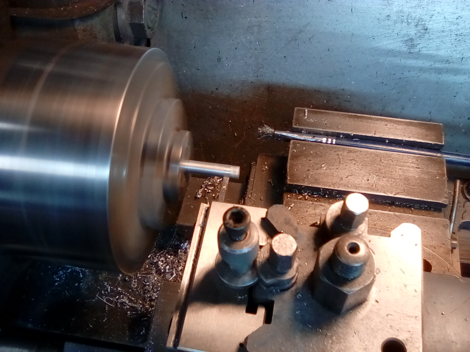

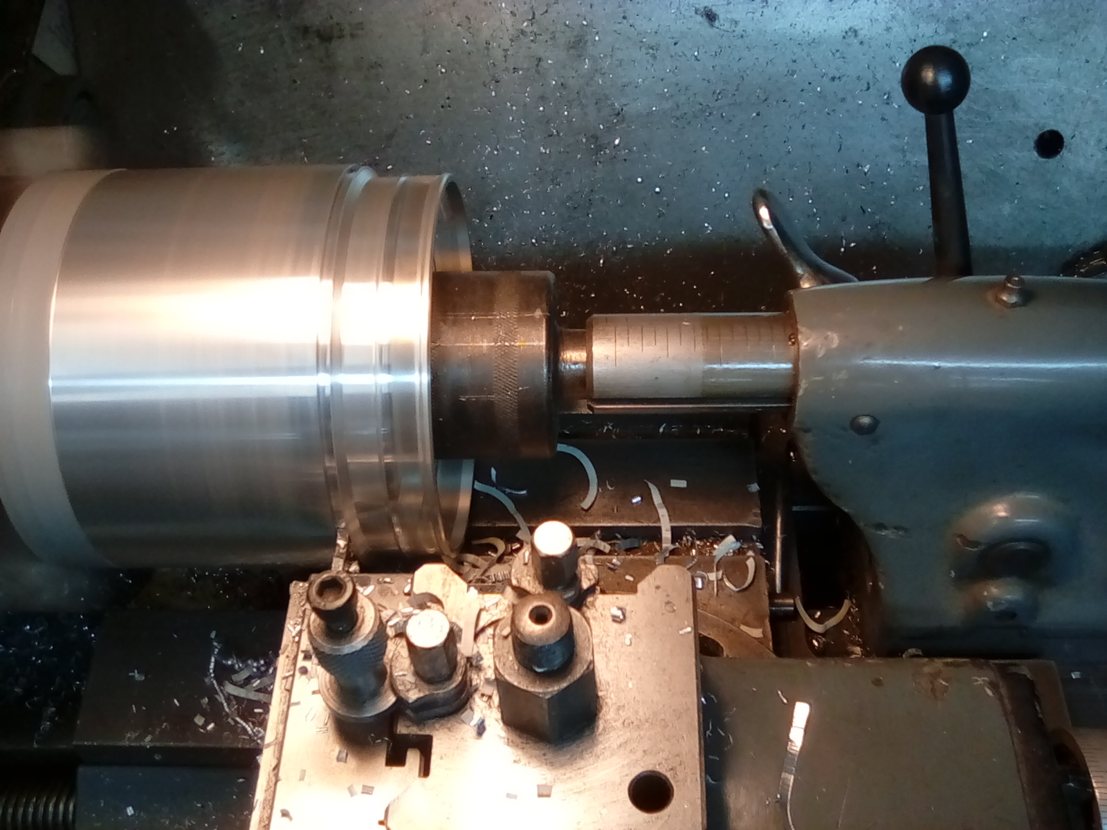

I don't want to take the main searchlight body out the first chuck, it's a bugger being so over sized to true up again.

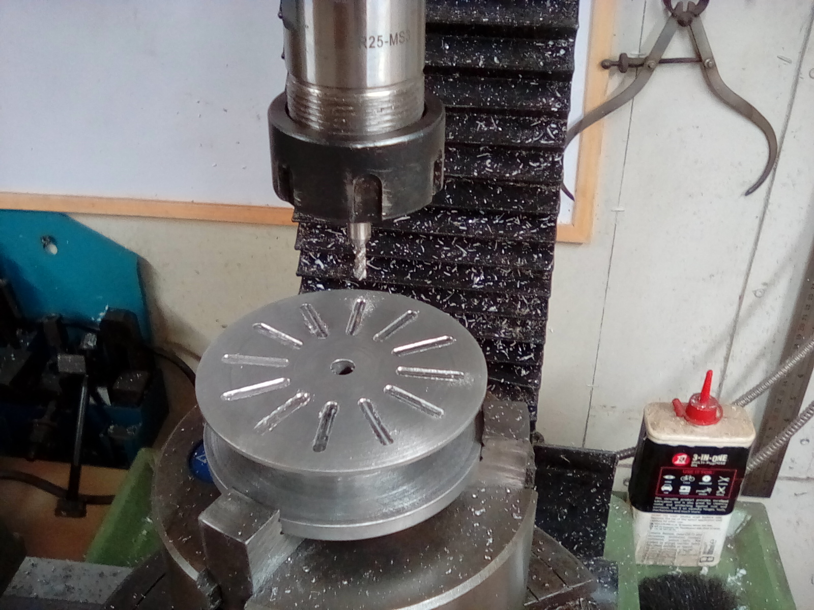

Easy maths
Easy maths

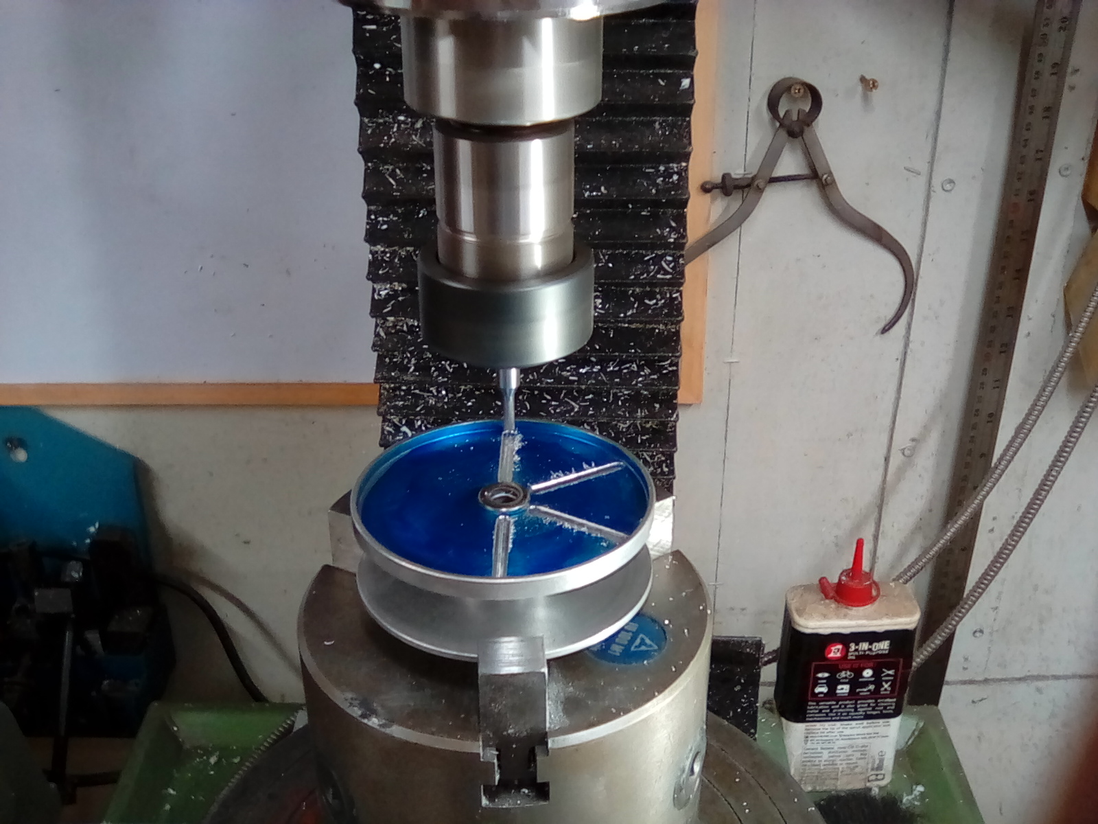

Five more slots to go

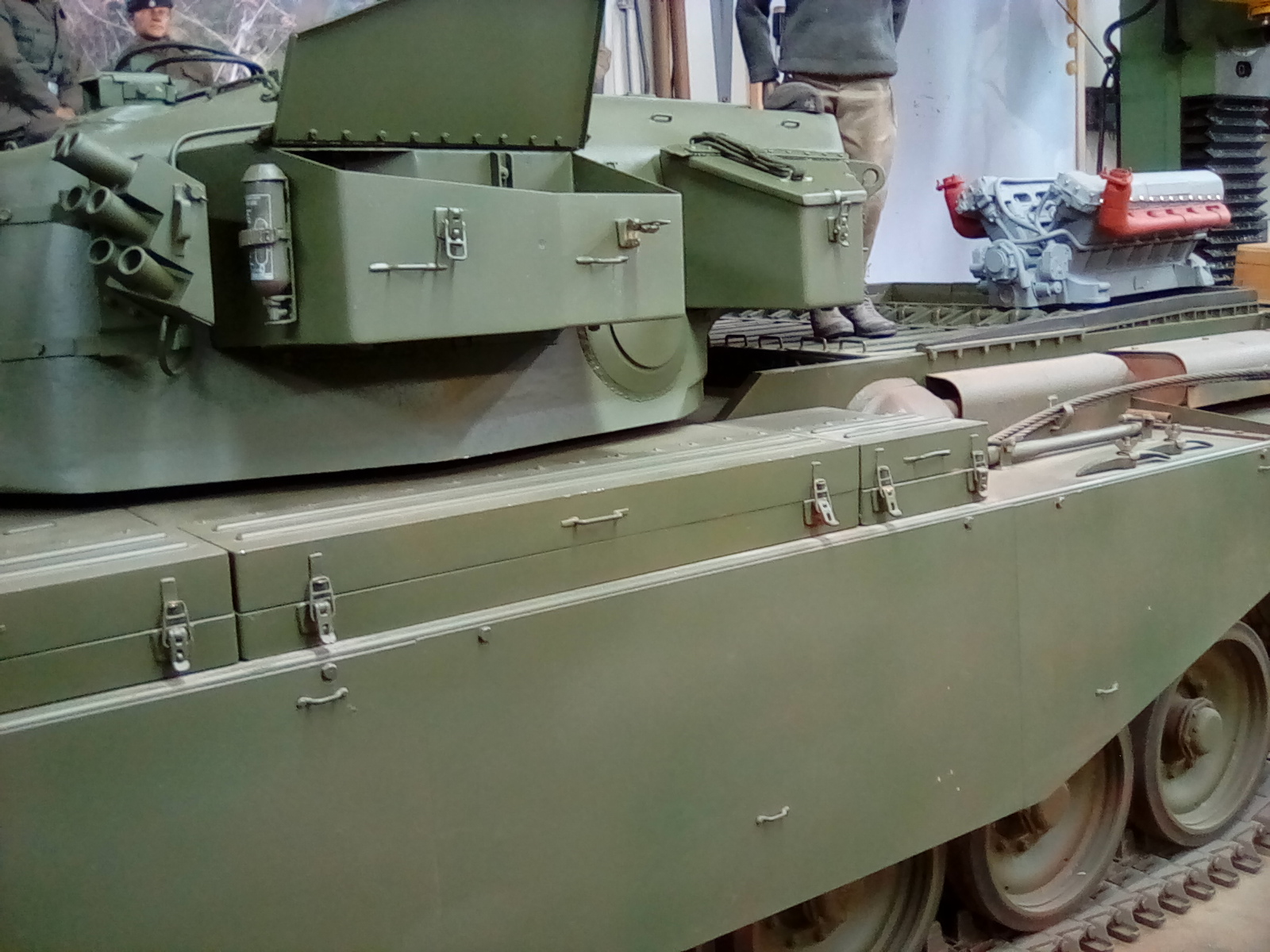

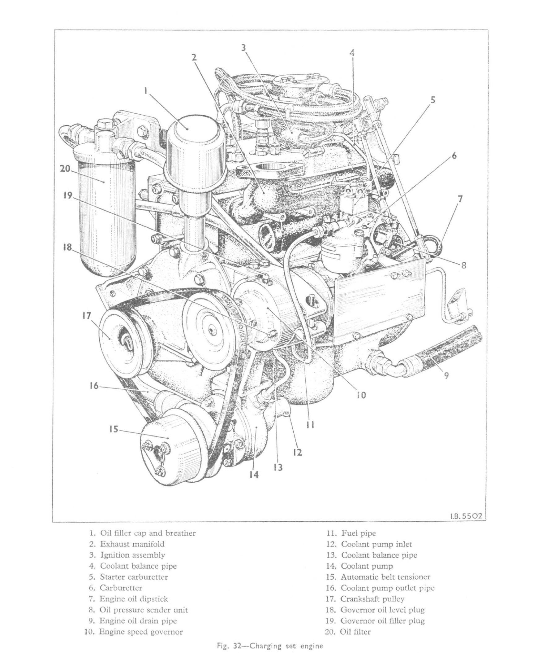

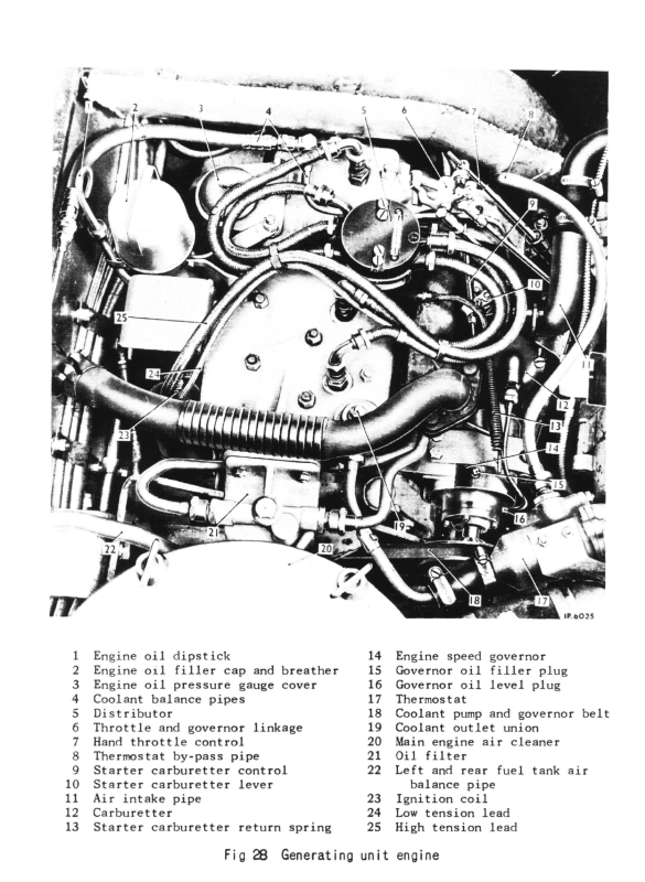

Something else we need to think about is the Morris engine, often referred to as the "donkey engine", stl files would be fantastic! It's a simple straight four overhead valve petrol motor used in the Morris Minor, it drives a generator.
Screen Shot Engine side view-oil filter.jpg (67.13 KiB) Viewed 813 times
R (1).png (247.17 KiB) Viewed 813 times
Has liked: 1040 times
Re: Mr Dawe's Centurion.
Phil, a couple of things which might help.
Flashing light. I wonder whether Centurion gun tanks actually had flashing lights in service, other than the ones which survived into later service with the Gunners and Sappers. I say that because I can remember the flashing lights coming into service on Chieftain as a result of German legislation, probably in the mid seventies. The fitting was a local modification, a simple tubular stalk fitted onto what had been the IR detector stalk to the rear of the cupola. It was nothing more than a piece of tubing with a rubber bung at the top and contained the power leads. It certainly didn't fold or anything fancy like that.
GUE (never heard it referred to as a "donkey engine") - this was a simple Morris USHNM Mk 3 engine. Photos from the handbooks attached. See also my thread (you probably already have) for photos.

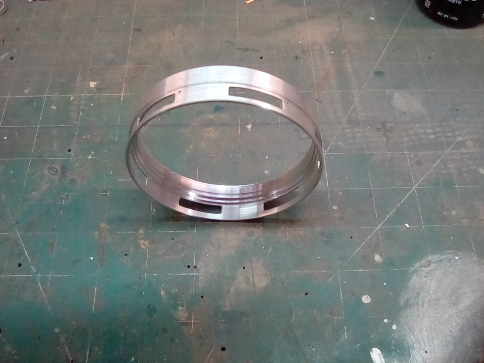

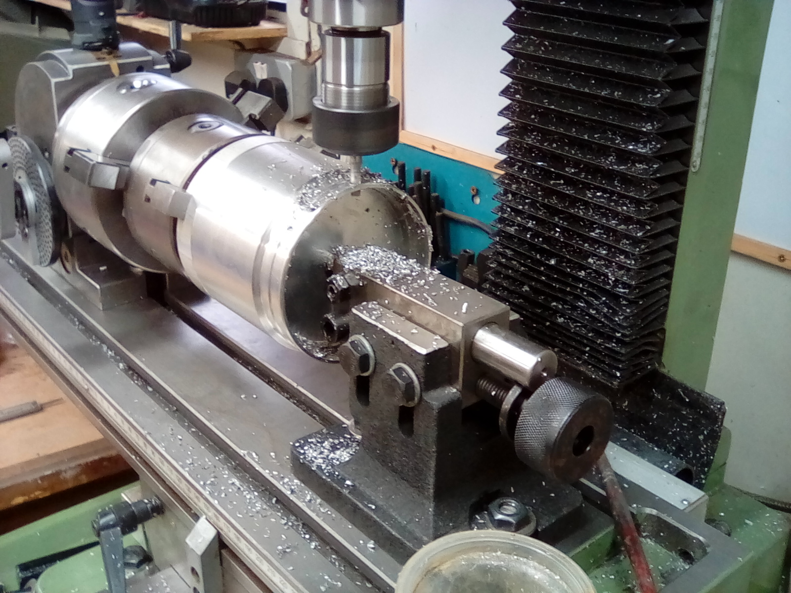

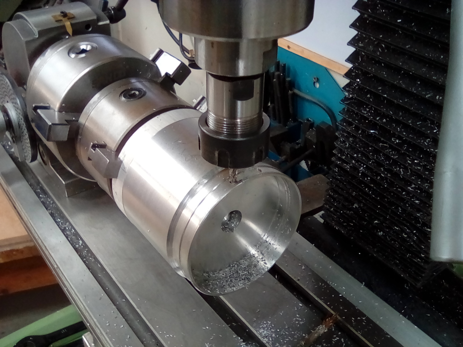

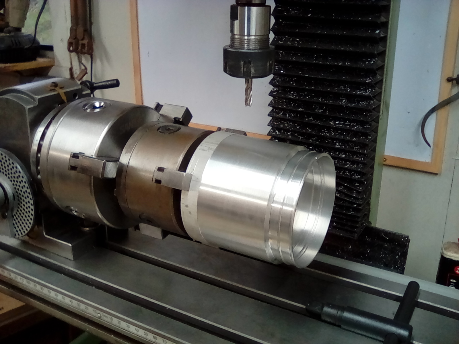

More milling and turning of the searchlight components.
Gently does it
Gently does it
All done but for some filing
Squaring the slots while it's fixed in the chuck is a little easier
Final cuts from this side while it's still fixed

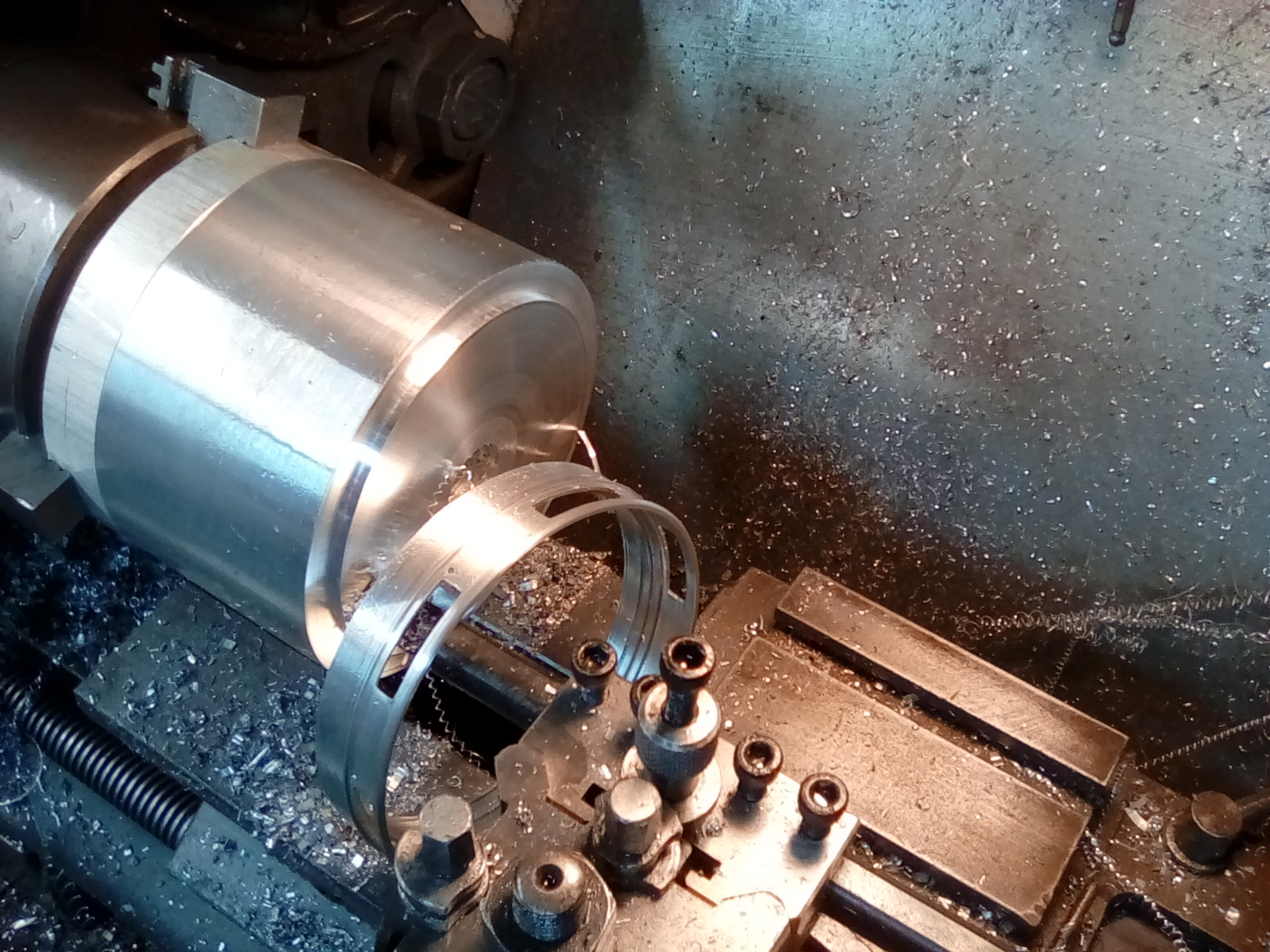

Parting off is my least favorite job
Phew it's off and in one piece
I'm very happy with my ring piece!
All this from that ring piece.
This is sketchy, the front piece of the searchlight is very close to scale thickness, well as close as I dare and so is very springy and compresses when nipped up in the chuck. I have to take very fine and gentle cuts or I could damage the thing irreparably and have to start again.

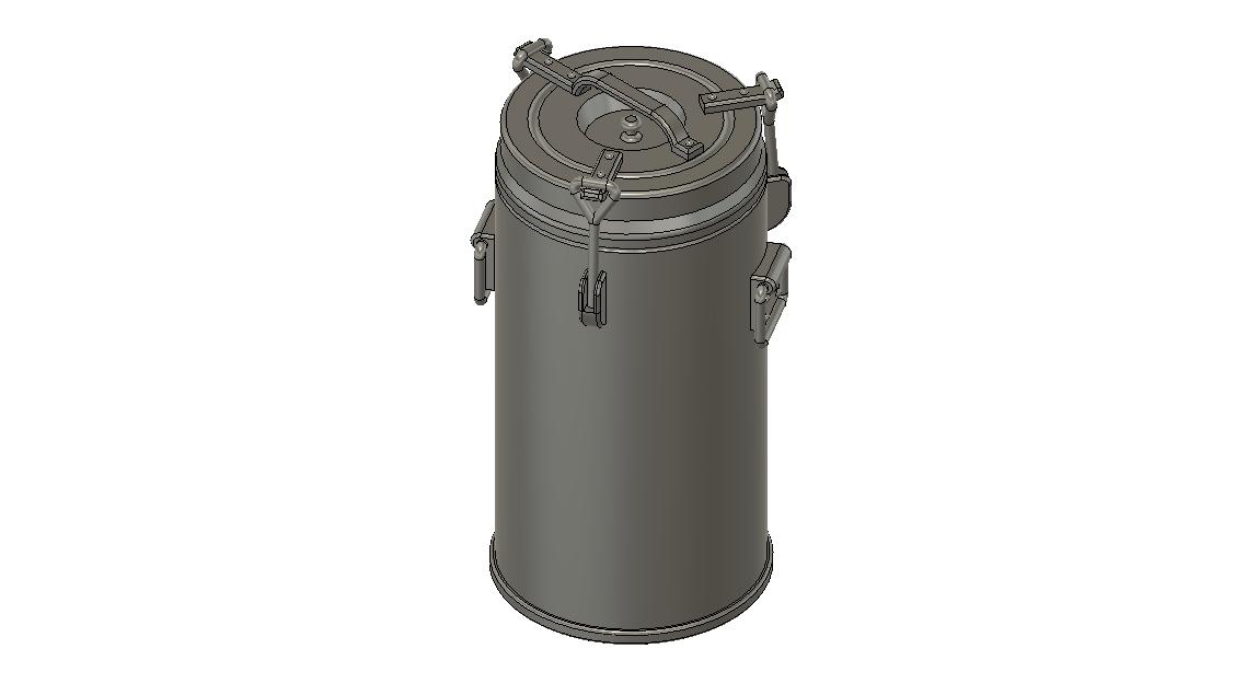

I am nearly 100% sure that this won't work with a filament printer.
Food or Liquid container
Looks lovely, if the clamps and lifting handles are to fine they could be printed separately but it's worth a go first. Alternatively the furniture could be made from wire and strip , or go slightly over scale on the thinner parts.
