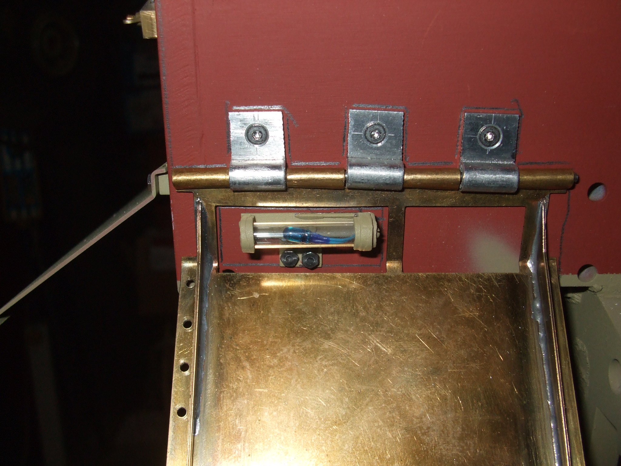

Fitted Steve's convoy light. At the moment using temporary 2mm bolts to fix it to the rear plate but I will be changing them to 2mm bolts with one size smaller hex heads. I am lucky that I am expecting some from Germany.
Convoy light
Convoy light

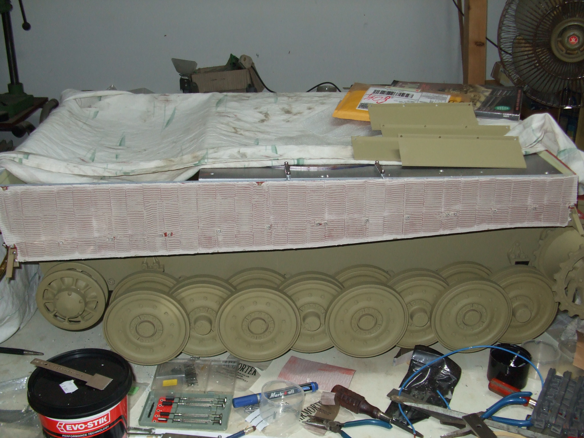

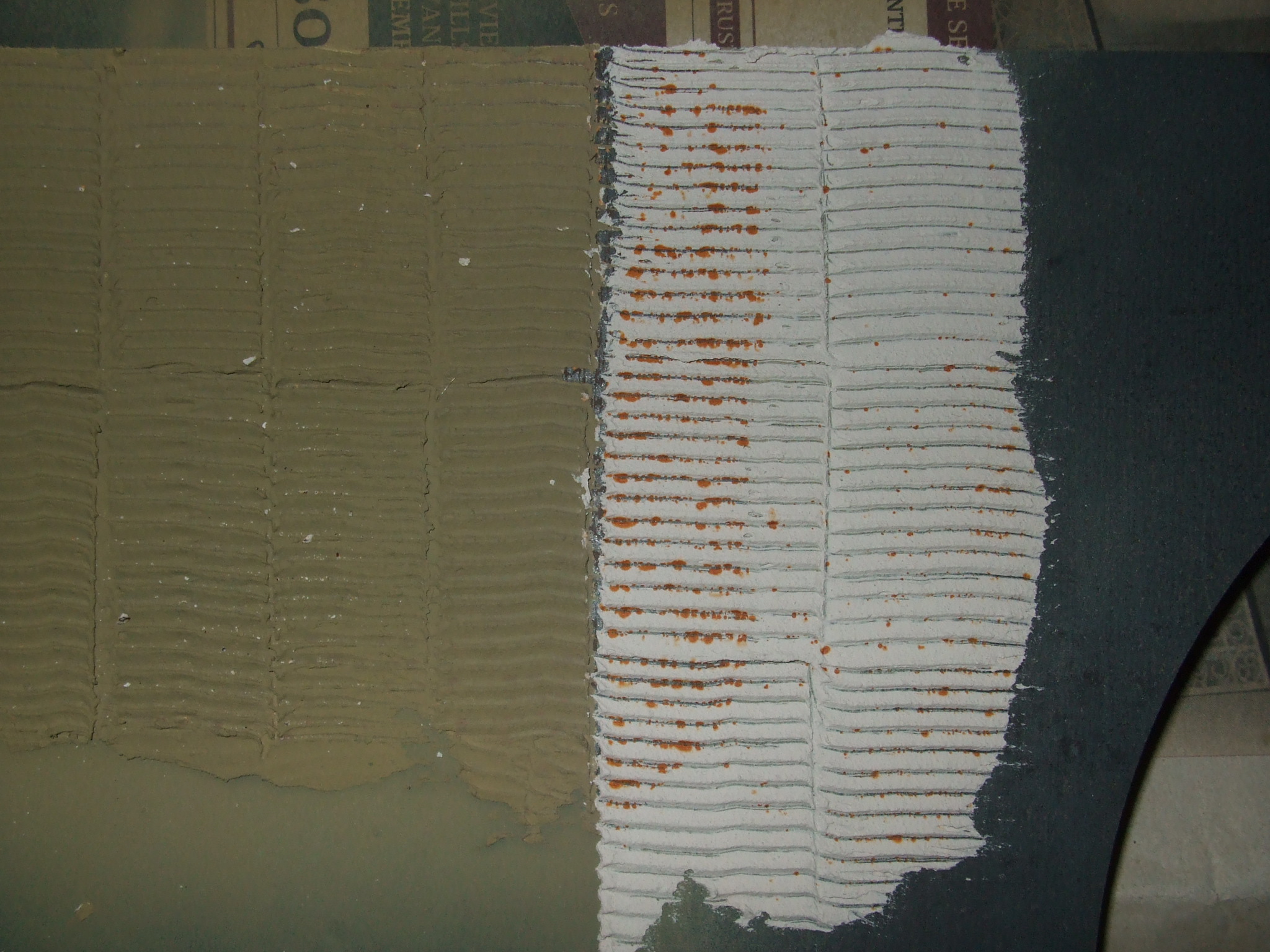

I also played a bit more with the tile adhesive. As Phil said, it is brittle but it is so easy to apply that I will be using it. I had used the No.2 tool previously and today I used the No.3 zim tool.
Unpainted patch is using No.3 tool.
I might actually use the No.3 tool.

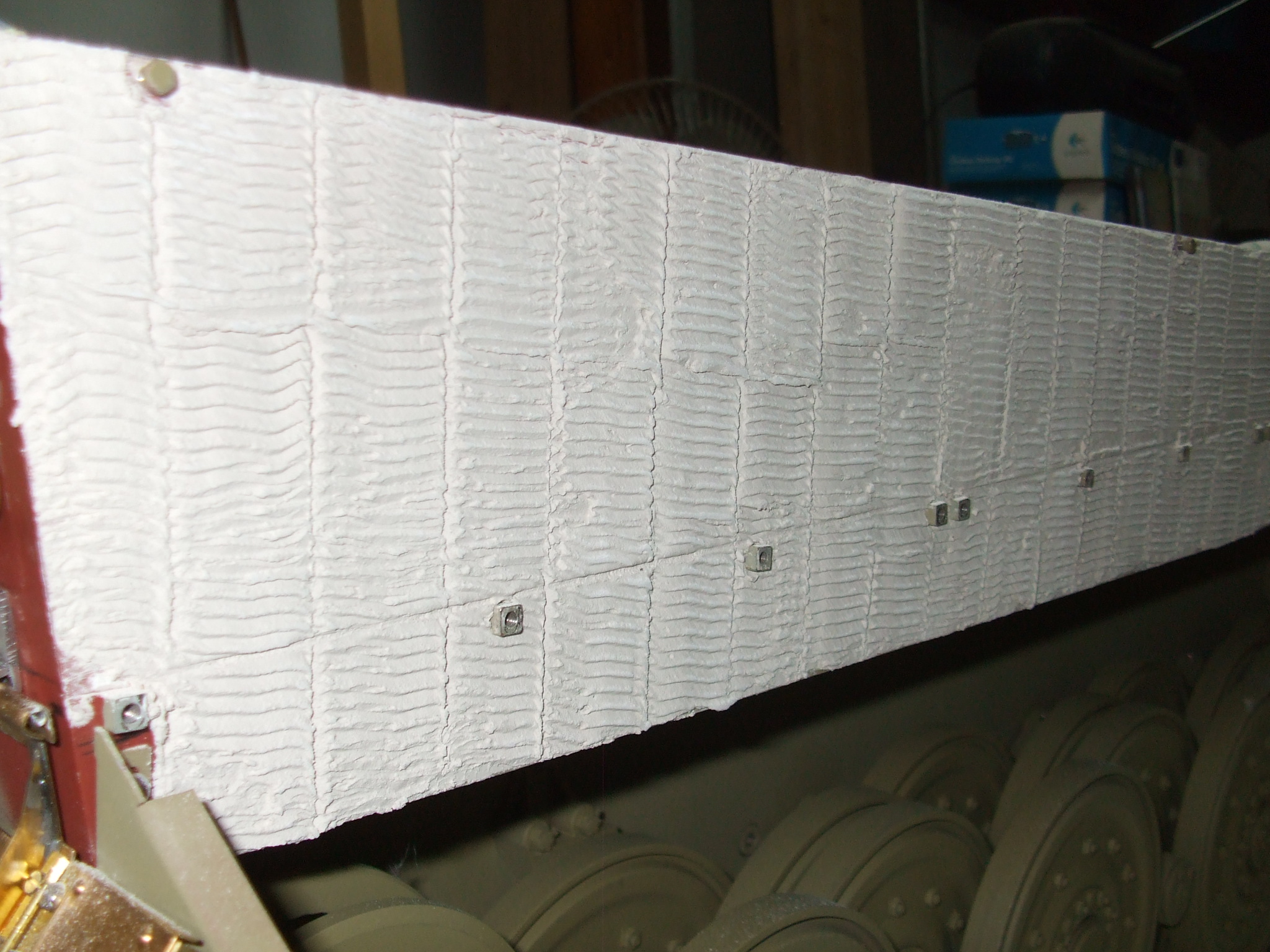

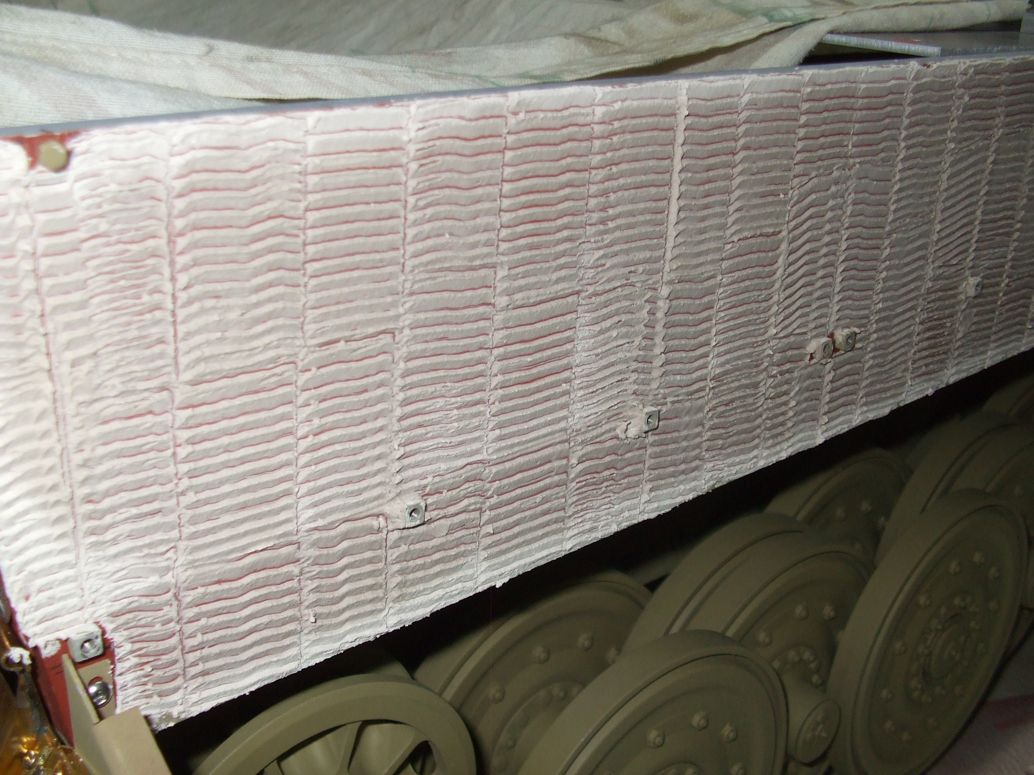

I need an honest opinion.
It's no use thinking about it and practicing on scrap metal so today I finally took the plunge and applied some simulated zimmerit to the tank. This is my first ever attempt. I have been looking at other peoples results and still not sure if I could get the same look.
I will not be offended if you guys think that my effort looks like crap. I need to learn from my mistakes. So before I continue I need your thoughts. It will not be a problem to remove it and start again. If you click on the photos you can really zoom in.
Looks ok for a first attempt mate, it's a bit on the thin side, it's a rough as any real Tiger 1, some make it far to regimented. Try a bit of paint before you take it all off as it may look quite good with some colour!

Was that the #3 tool?
Has liked: 792 times
Yes Adam. It's the No.3 tool.
Thank you very much Phil for your thoughts. Much appreciated. I guess I'll sleep on it and take a decision tomorrow.

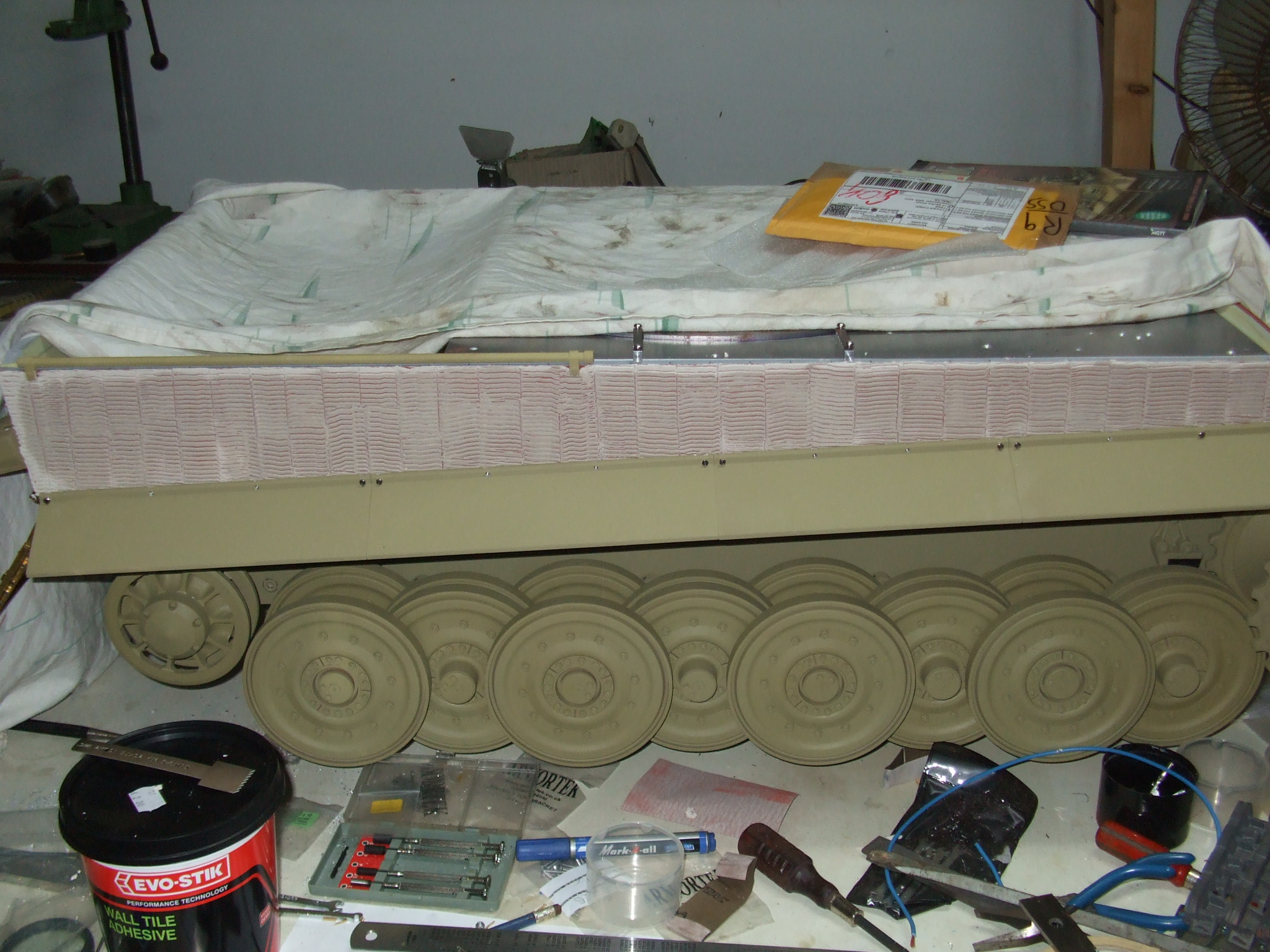

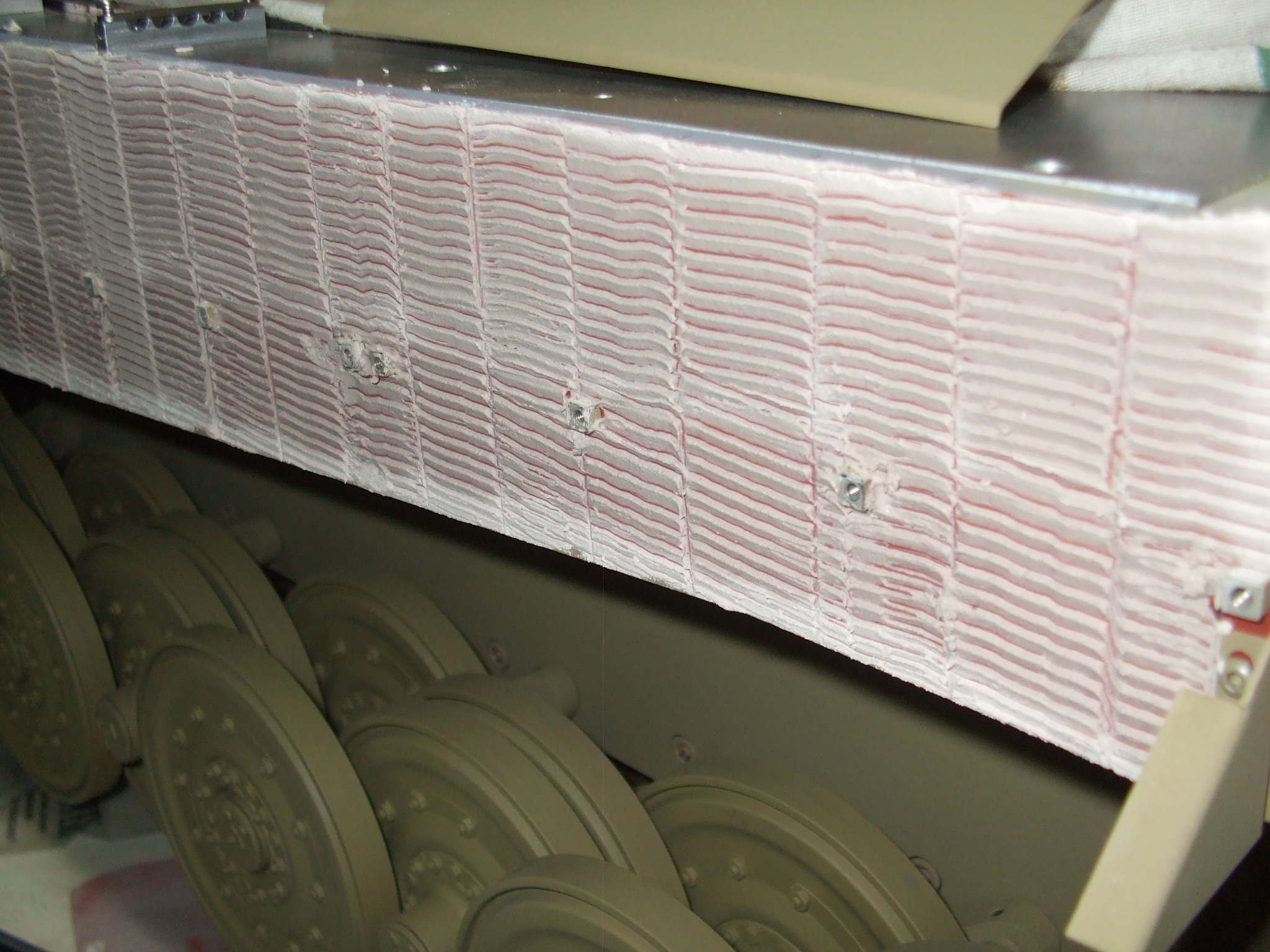

Zimmerit: Take 2
So after sleeping on it, yesterday I removed the zim and re-applied it. I made the layer slightly thicker and also changed the orientation of the zim tool which I think gives a better profile.
I think there is an improvement but now I am worrying that I might have made it look too rough. So Phil (or anybody else) can you be patient with me and have another look and give me an honest opinion. It's no problem to re-do it again.
I hope I am not trying to chase my own tail!

Hi Vince, great posts. I have been having trouble sleeping and was looking at AT forum for hours but somehow missed your updates until right now. Sorry!
I like your precision with the tool. Lining it up carefully the way you have looks authentic. From the pictures I have studied it seems to be the case that most of the Zimmerit jobs on the Late Tiger 1 tanks were nearly perfectly applied. By perfect I mean PERFECT.
Since that was the case. I thought long and hard about how to reproduce it in 1:6 scale on my Armortek kit. Since I have some experience with Zimmerit in 1:35 scale.
Here is the conclusion I have come to.
Don’t try to be perfect. The reason you will never get it perfect is two fold. They did not use a scraper tool and we don’t really have a 1:6 Zimmerit. They spread the Zimmerit on with a spatula and let it semi harden. They then came back later and poked the coating with a another tool or spatula to get the texture. It took them 3 days to do th tank.
Since I decided to use the tile and scraper technique I had to make a decision. Do I try to make it look perfect and fail or do I get artistic and just do it a little funky?
I ended up putting on the tile adhesive sloppily and then making the Zimmerit a little “wonky” just for fun. Don’t forget it’s an effect not an exact reproduction.
I am happy with the effect.
Here’s my last piece of advice. If you do something for the first time like Zimmerit or camo. Start on the back of the tank. This will be the least pronounced area so if you make mistakes they are less obvious. Then you will build confidence and master the next side more quickly.
Just take it slow and have fun. Your energy will show up in the finish. If you are stressed while you are applying the Zimmerit you will be less happy with the finish.
I hope my experience will be helpful to you. Good luck.
Brian
As Brian says " don't worry about getting it to perfect", I would't bother with zim under the skirts so much and if you present your Tiger with a piece of skirt missing it probably would't have had zim applied there any way. Just about anything goes with this stuff but to get it to look like a twelve inch high guy mixed it, applied it,run out of it, lent on it, sat on it, left it to long after lunch then cut the vertices with a knife like tool and so on...
Be a little random and don't rush it, take a small hammer to an area and crack some off to expose the red oxide base coat, now there's a photo I have somewhere of a Panther (all be it knocked out) that has just the pattern left after the zim has fallen off maybe when the vehicle burned out, now that would take some doing to replicate!............Phil.

I was told, many years ago, not to stress about decorating a house, because "you paint from 6 inches away but live from 6 feet away".
Once the tank is finished, you'll probably never get as close to it as you are when you're building it, so things which stand out now will blend in with time, especially once it's painted.
Having said that, I think it looks perfect :D :D
I'd be more than happy if that had been my tank.
Thanks Brian, Phil and Adrian for your comments. I will heed your advice leave it like that. As it is, today I received the fasteners I had ordered so now I can finish the other rear mudguard.

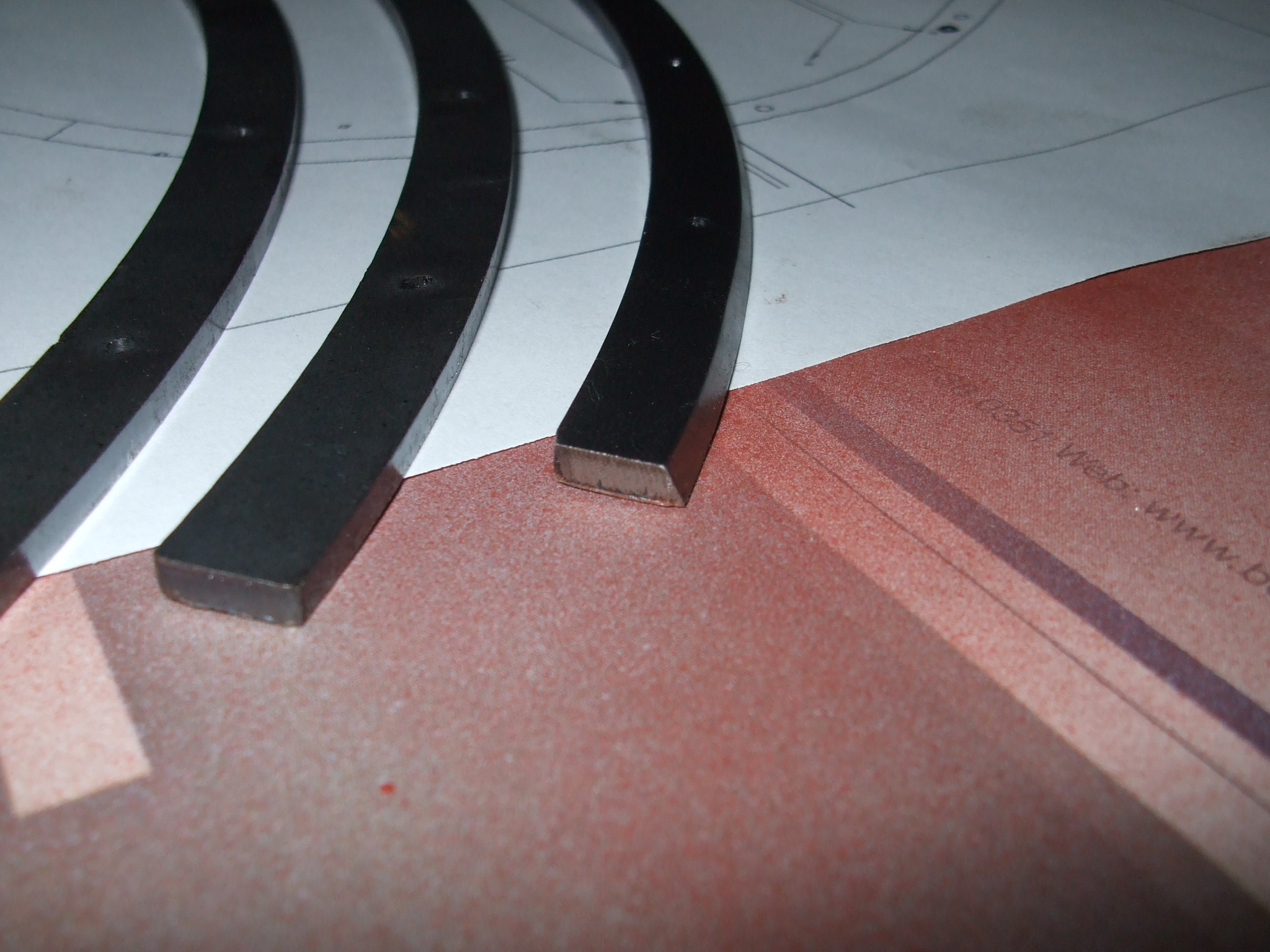

Some time ago I decided to change the kit turret joint protector (bullet ring) and make one more similar to the real thing which is basically divided into three sections. So using the information from the tiger1.info website I drew one of those sections in CAD. Took this drawing and a .dxf file to the laser cutters and the three sections where cut.
Turret joint protector sections
I used the same width and thickness for these sections as the kit part. If I had to do it exactly in 1/6 scale it should be a little wider and thicker. As I did not know if it would interfere with other components I thought I would play it safe. Another thing I wanted to add was to add the bevel on the outside of each section. I have been thinking about how to achieve this for some time. Grinding with a Dremel was always the obvious solution but doing it free hand was going to be "iffy" at best. Then a couple of days ago I had one of those moments. Why not use my T & C grinder instead. It has a decent table and I can fix it at the desired angle. So today I ground the bevel on one of the sections and happy to say it turned out good.
Ground bevel
Ground bevel
