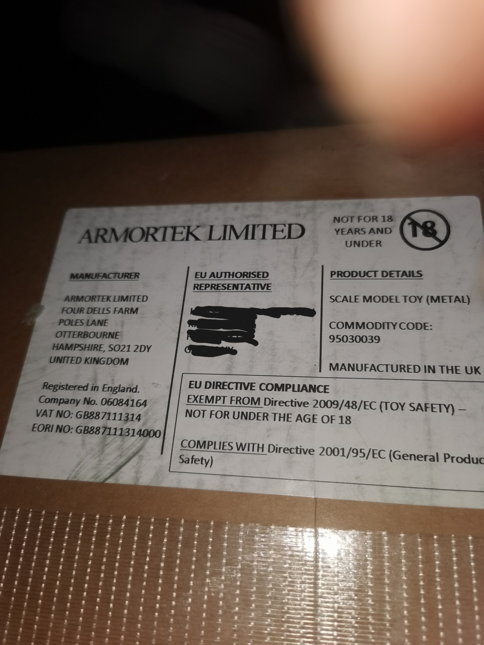

Hey Hey, Xmas came early
Me and Tsar had a roadside rendezvous with a nice brown delivery van today
Sound and motion packs arrived. Recoil will be my own design, and if my plan works out, a quite a spectacular one both in sound and motion
It will also be the most difficult and time consuming aspect of this project , but is also one of my main reason for the entire build.
Smoke is something I will consider down the road, as I don't care mutch for the effects i have seen so far. (to mutch "steam" without pressure)
