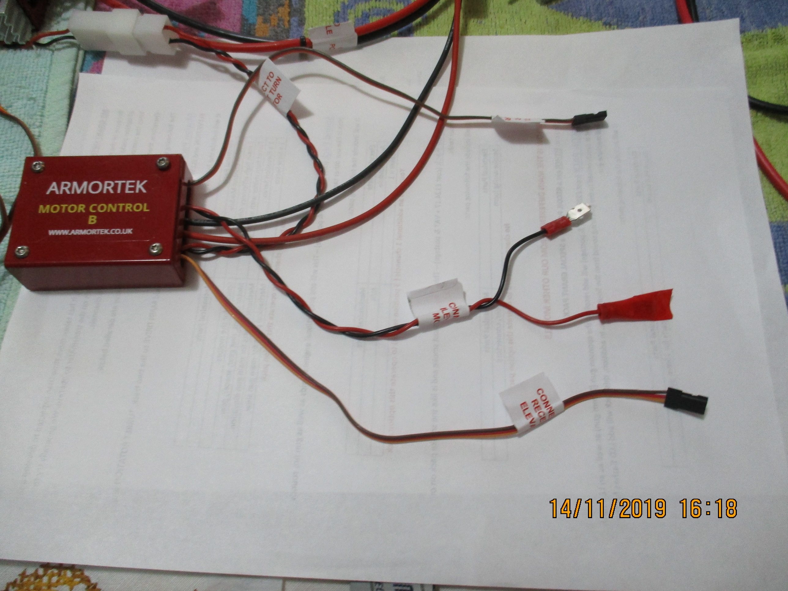

Good afternoon ladies and gentlemen, update with my radio control 'bench setup' for the M3 Grant. I have the new 'Recoil Pack, not the new Special Grant Pack.
Kian kindly checked the Tx, Rx and Motion Control A.
This is my progress; I am using my Spektrum DX6 and a 6 channel Spektrum AR620 Sport receiver. I have also tried my 6 channel Spektrum AR610 receiver. I have two new 12v 22Ah YUASA batteries and a Ctek charger. The batteries are fully charged.
Step 1, Testing the main drive. All connections made as per the instructions, Motors respond on the right hand stick, forward/reverse single stick control.
Step 2, Adding the Audio Option Pack. Audio Module connected, speakers connected, RC 1 and 2 to the respective Y cable connectors. RC 3 to the receiver on a three position switch B on the transmitter. Programmed the sounds, using the 'teach' button. All sounds are triggered and respond as expected.
Step 3, motion control B to the power module, turret motor turns/works on left hand stick, left/right. Slew servo working. The main gun servo also works and the LED flashes when selecting the appropriate sound number 2.
Couple of issues I require help with.
The Hull machine guns work on the MG sound number 4, the LEDs do not flash.... I have tested the LEDs alone, they flash ok.
Also, I am unable to set up the elevation servo on the receiver. I have two channels, the Slew is on one of these. I have tried swopping the leads.
Connecting the Elevation RC lead on the Motion Pack B to the receiver, causes a two lead cable from the Motor Control B to become 'live' so I guess this is for a Special Pack motor.
I have some photo's not sure these will help though. Fingers crossed....Mick
PS, when I connect the Motion Control Module B turret turn, to the receiver, rudder, I have no motor movement????My brain hurts...
If anyone has installed the options, have you found the main 75mm gun and the 37mm sound much the same.. more like a polite cough.

Morning all, reference the 'bench setup', I have decided on a new beginning, a fresh start, a new dawn, a new day, hope springs eternal....
Now, I'm not the brightest button in the box, however can someone explain this...when I connect the RC lead attached to Motor Control B... which has a label saying 'connect to receiver elevation' the exposed twin black/red lead, along side the RC lead... is 'live', gave me quite a shock, not literally.
I taped the live lead safe as I do not have a motor or anything to connect this live feed to.... Mick
