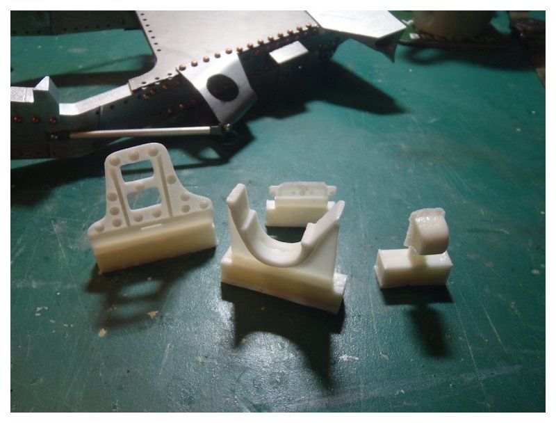

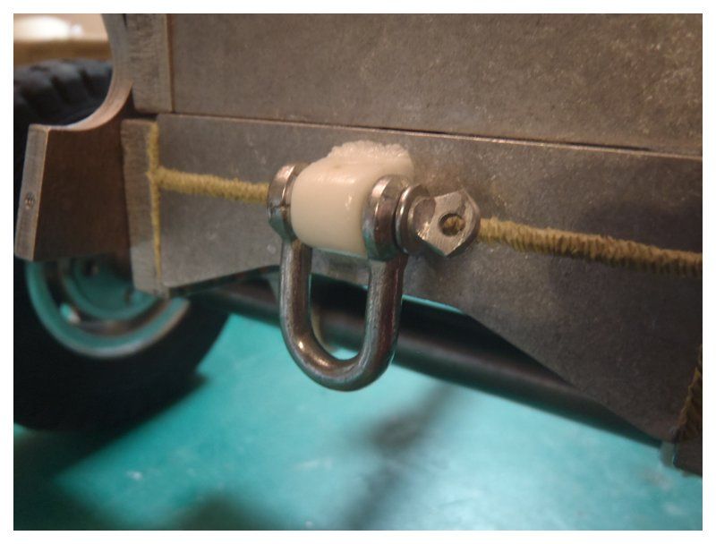

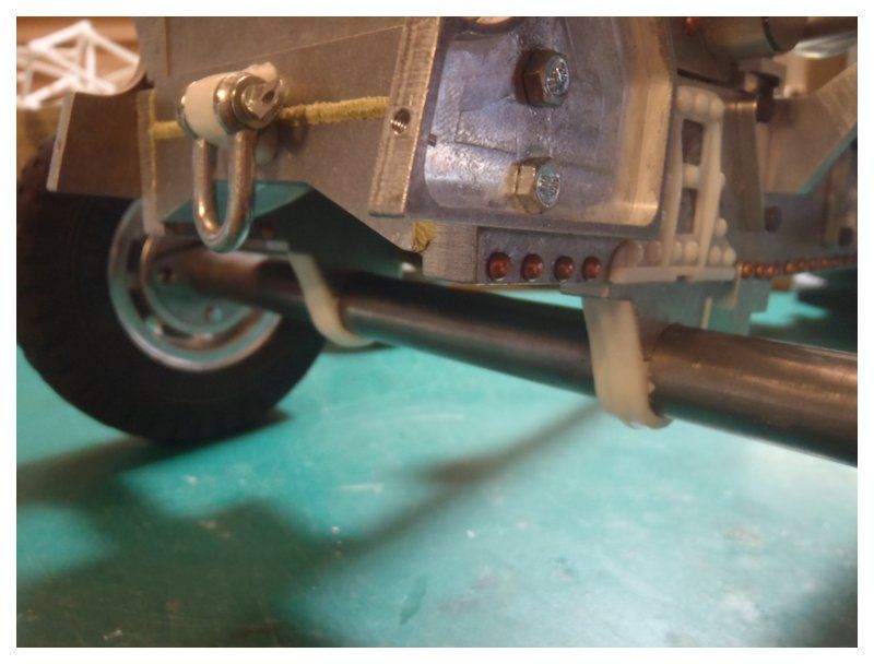

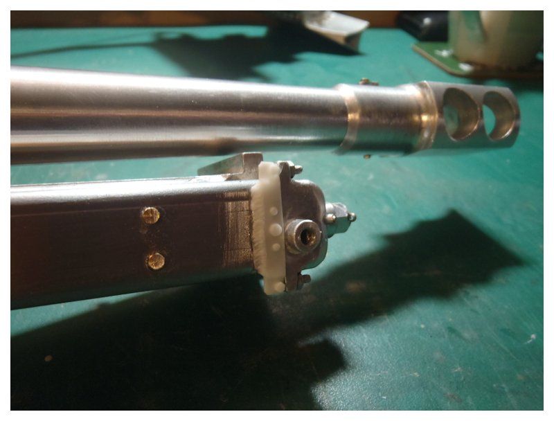

Hi All,
New moulds made and parts fitted. The axle castings may need a little adjustment dependent on how the kit goes together as mine were ever so slighlty different on each side. As I've only made the master from one side there is not much I can do about this but I only had to trim the rear step on the new casting about 1mm on the opposite side.
Also used K&S tubing to add a little more detail to the elevation rod.
Dave

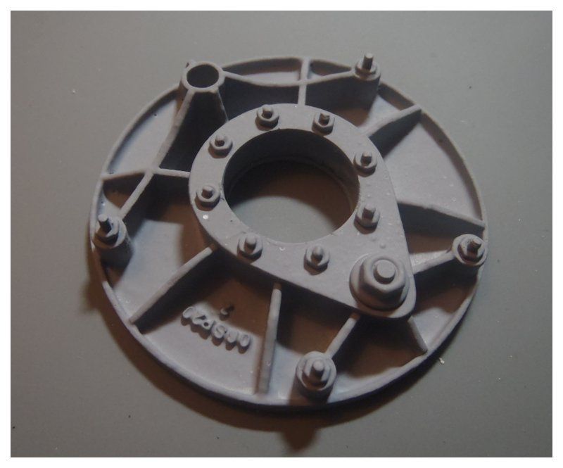

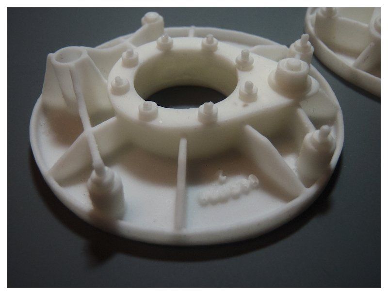

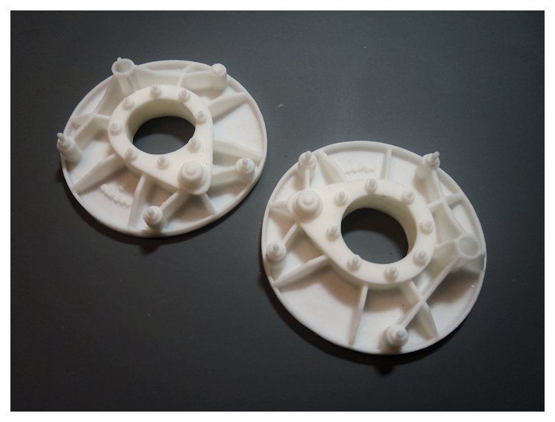

Hi All,
A parcel arrived from Marcus today and inside was the extra brake drum he had made. A little Mr.Surfacer and it was ready to mould.
Its a lovely little piece and will finish the wheels off nicely.
Many thanks Marcus!
Dave

Marcus Kwa wrote:Glad you like it Dave! I see I forgot to sand the edges of the stiffener ribs smooth on that third one....... :oops:
What kind of photo equipment do you use? I am still struggeling to get the detail shots wholy in focus.
Marcus

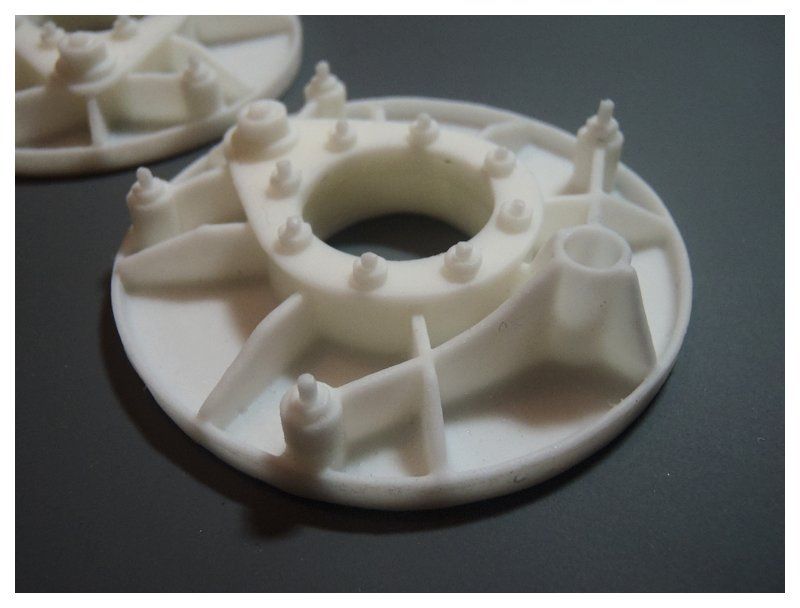

Hi Marcus,
They were smooth but I've added a fair bit of Mr Surfacer which has blended in the ribs but also then been stippled to look a little more like a casting. It means the edges vary slightly.
I use macro or super macro without a flash. I prefer daylight but if not I shoot the pics under a desk striplight with 2 LED spots on the front to reduce shadow.
I have the second casting curing at the moment but will post pics of the pair later.
Dave
www.armorpax.net

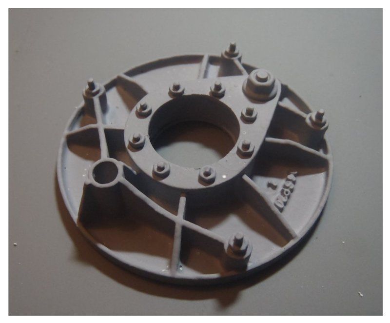

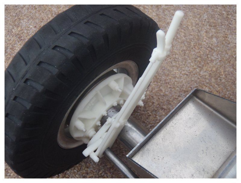

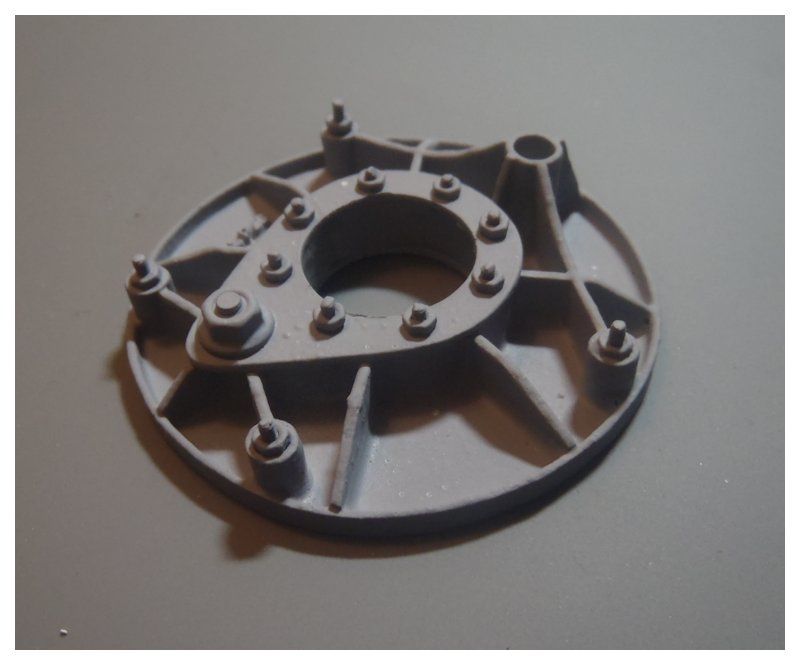

Hi All,
First pair of brake drums cast.
Dave
www.armorpax.net

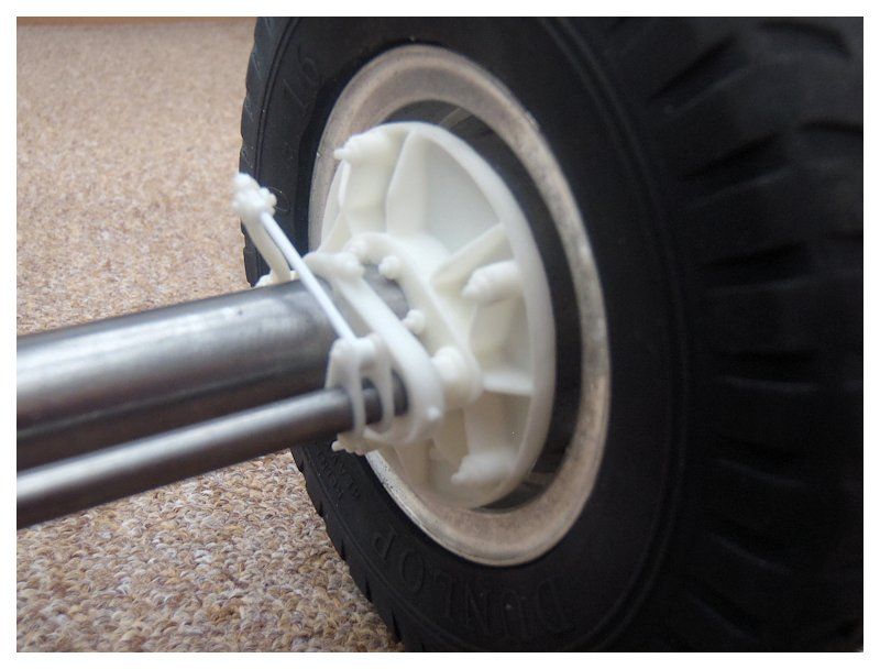

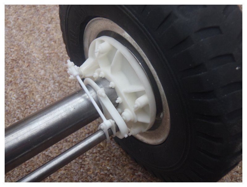

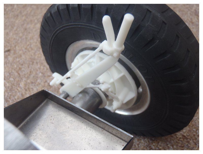

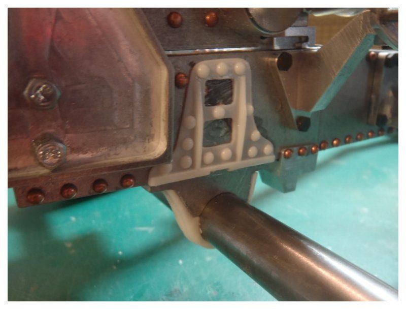

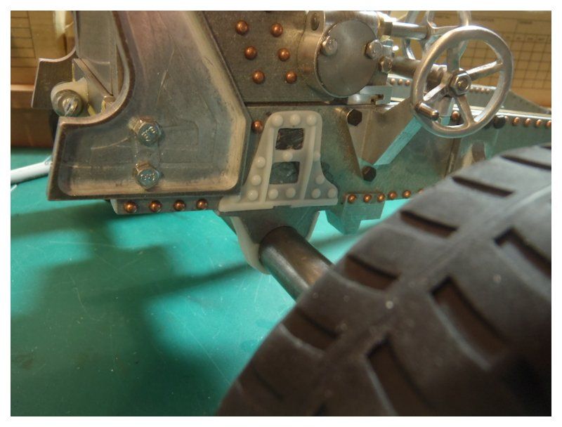

Hi All,
Rest of the axle and brake parts cast and fitted. I'v made a slightly simplified version of the brake assembly to keep it strong enough in resin and make it a little easier to cast. There is also a little artistic licence in my original brake handle but I decided to mould it and add to the set.
I've also made and cast the first of the lower rear trail angles.
Dave
www.armorpax.net

Simplified? Actually there is nothing more to add....... :lol: Looking very good!!!

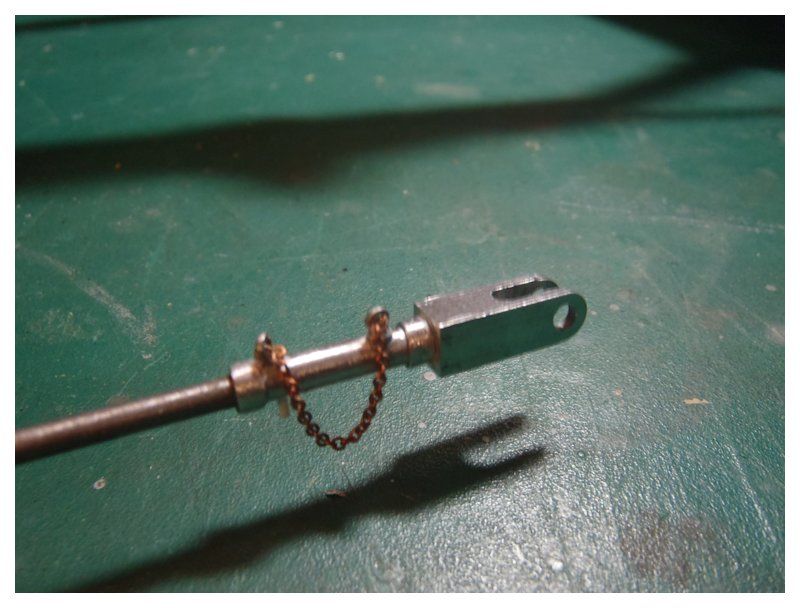

Sourcing the spring for the brake actuator rods.
I replaced the 4 hex bolts on the back of the wheel with some CSK bolts (taper head) to position the drums slightly more towards the wheels.
Working on the rivets here, 200 to go......
