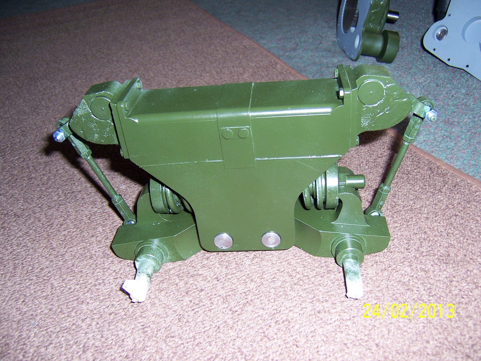

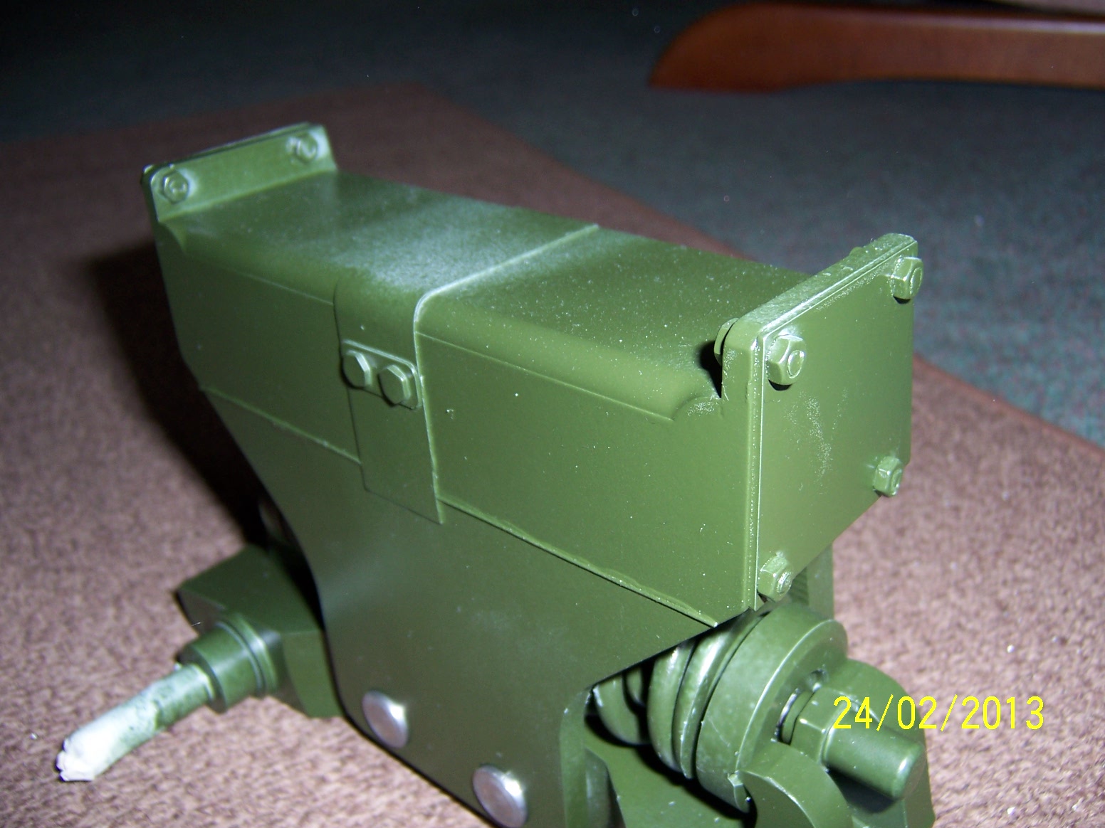

We built up the bogies: They just need a paint touch up. I added some plates to the sides of the middle bogies with bolts through the holes that are already there. That kilopoise is sticky stuff and always finds it's way onto your fingers
I'm now going to concentrate on the hull to get it ready to paint and receive the electrics.

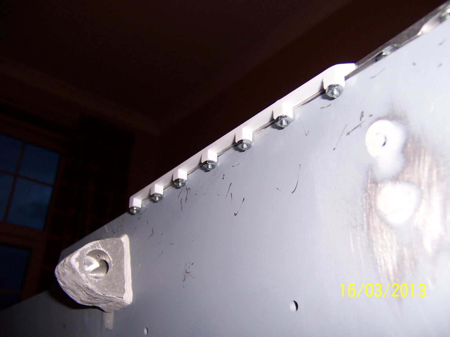

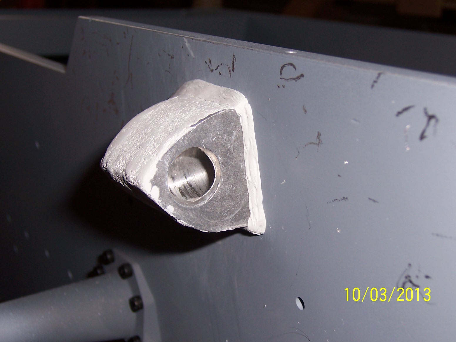

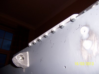

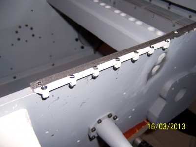

I finished off the welds on the hull and found a couple more parts I want to add before the final paint coat - the exhaust elbows and side rails that hold the rubber bumpers.
Robin

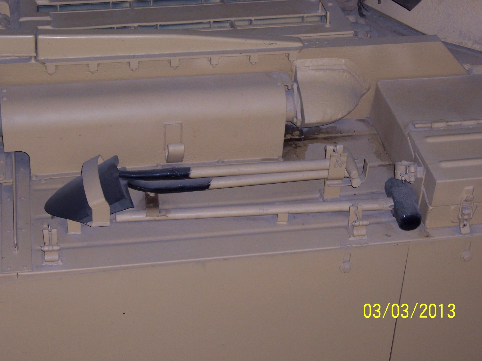

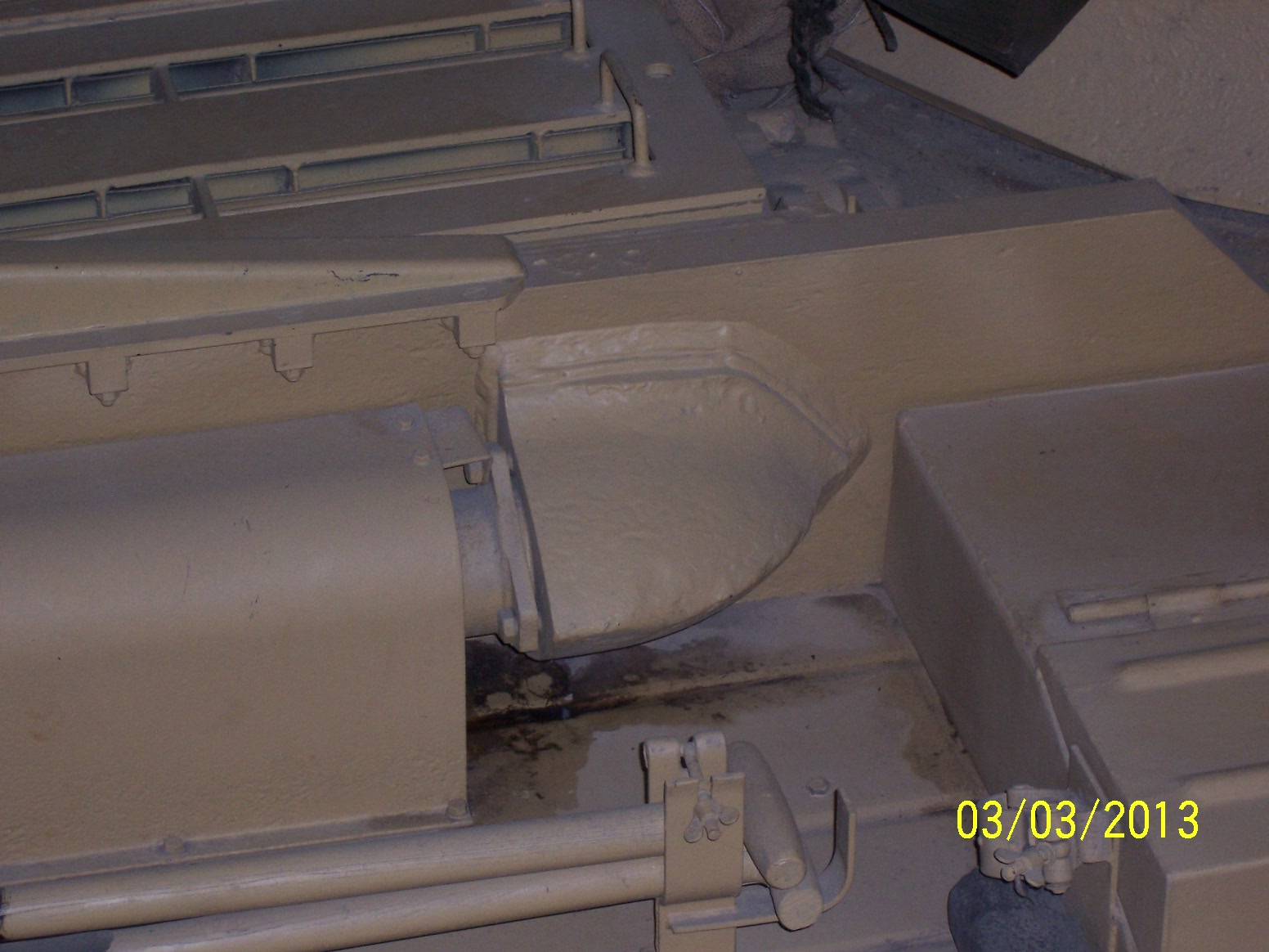

We spent some time pondering over the Cent 1:1 last Sunday at Duxford, here are a couple of shots of the areas I'm working on at the moment:
We're still on track to paint the hull over Easter.
Robin

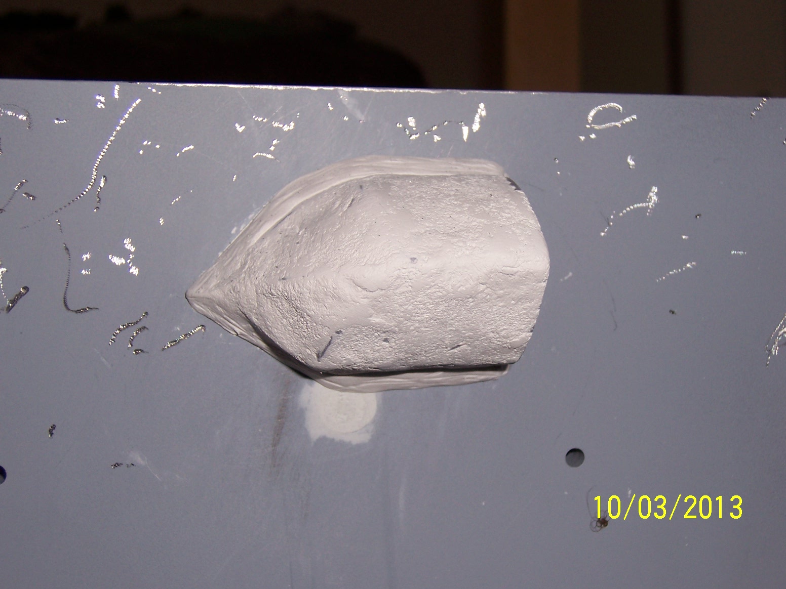

I tried to change the shape a bit with milliput, a little more pointed at the front.We're still on track to paint the hull over Easter.

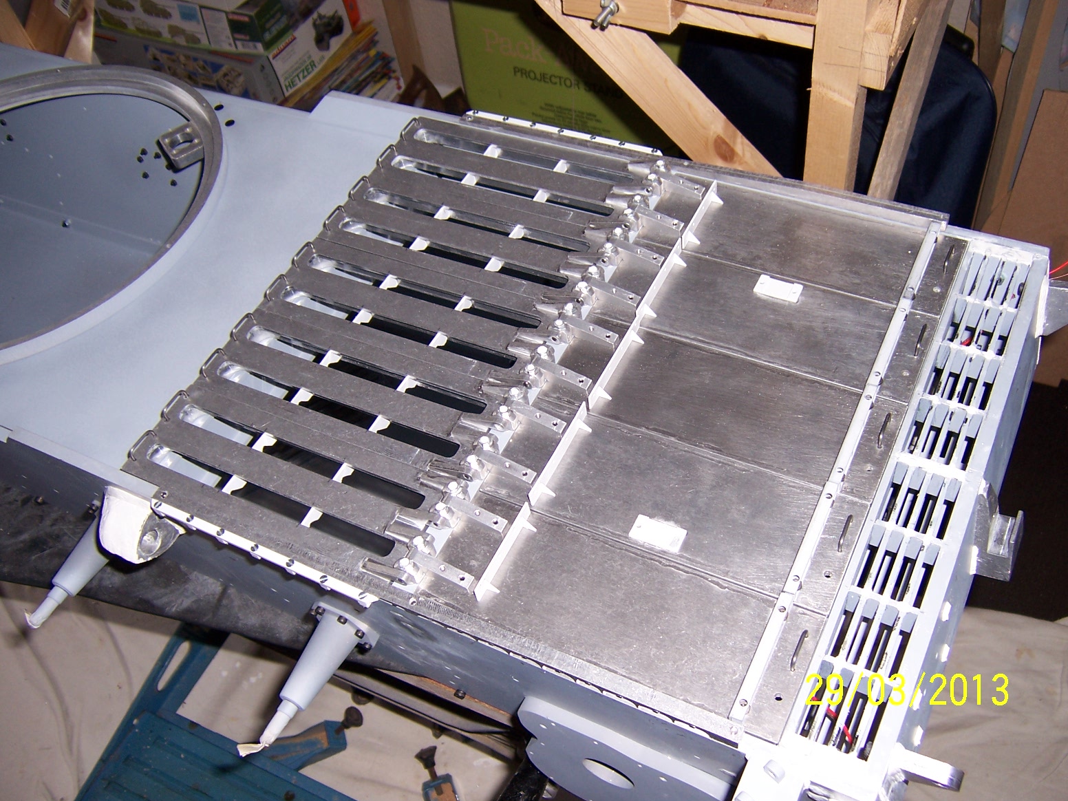

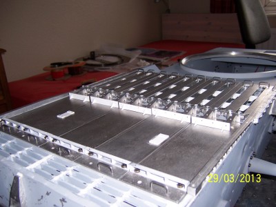

Re: Paul & Robin's Centurion
Hello,
Had some time off this week hoping to paint the hull - a significant step forward. I expected spring to be here by now

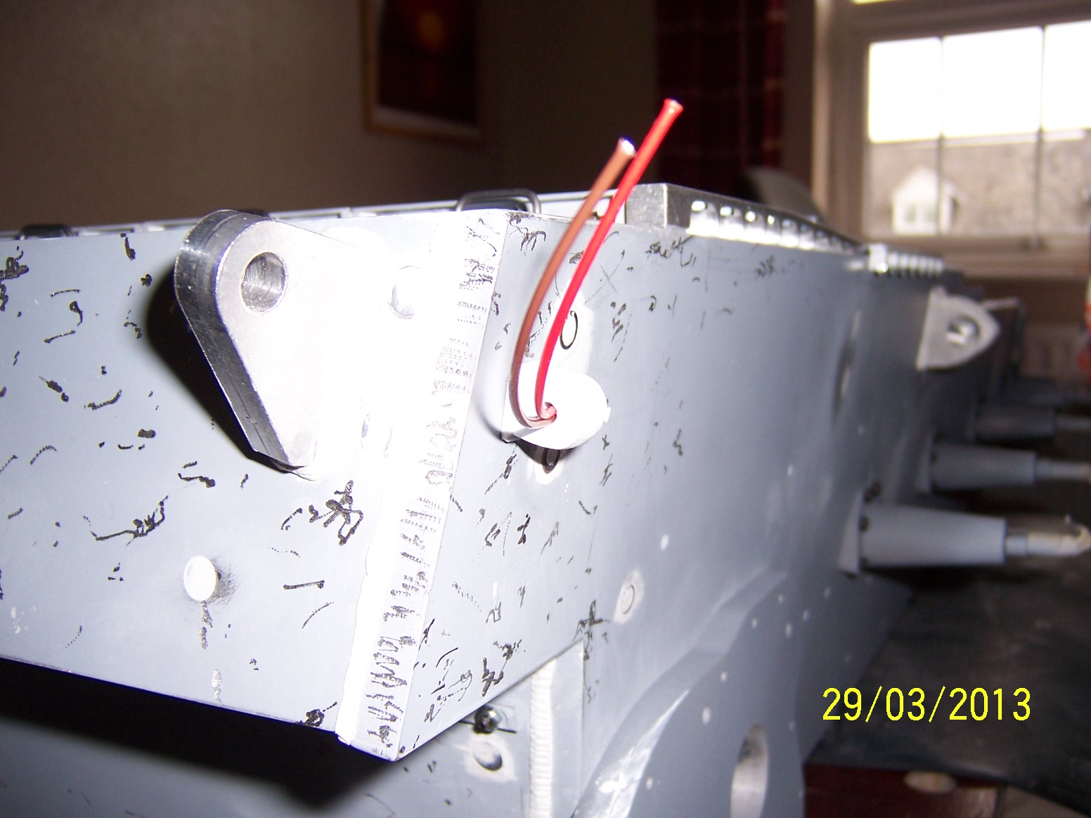

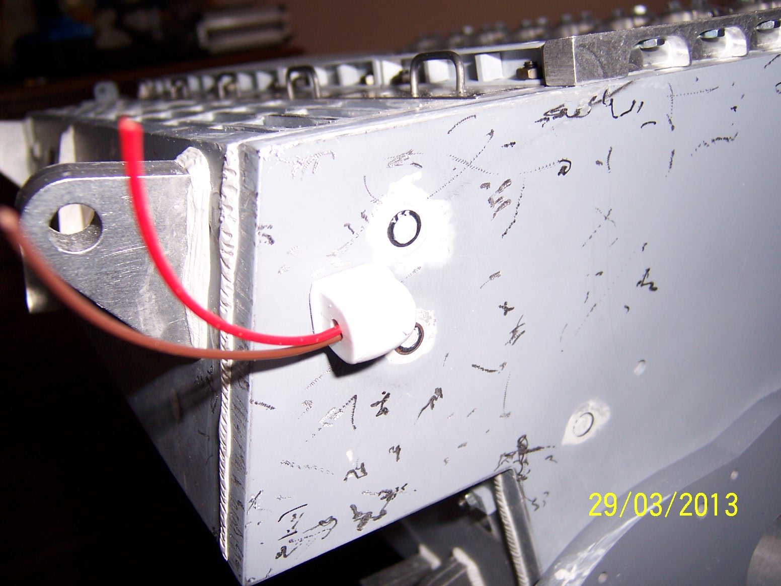

Instead I've been doing the engine deck hatches. We found the rear stretcher needed some filing to clear the hinge screws: Rear side lights (and headlights) are fitted, carved from plastic, holes drilled for the led. I'm not sure I quite captured the shape though: Robin

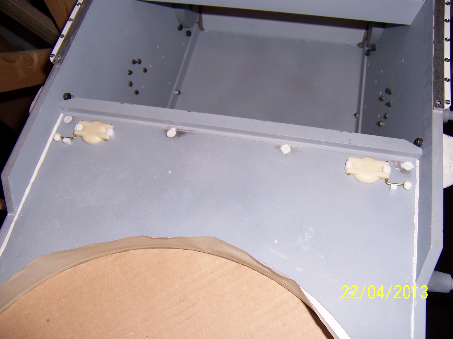

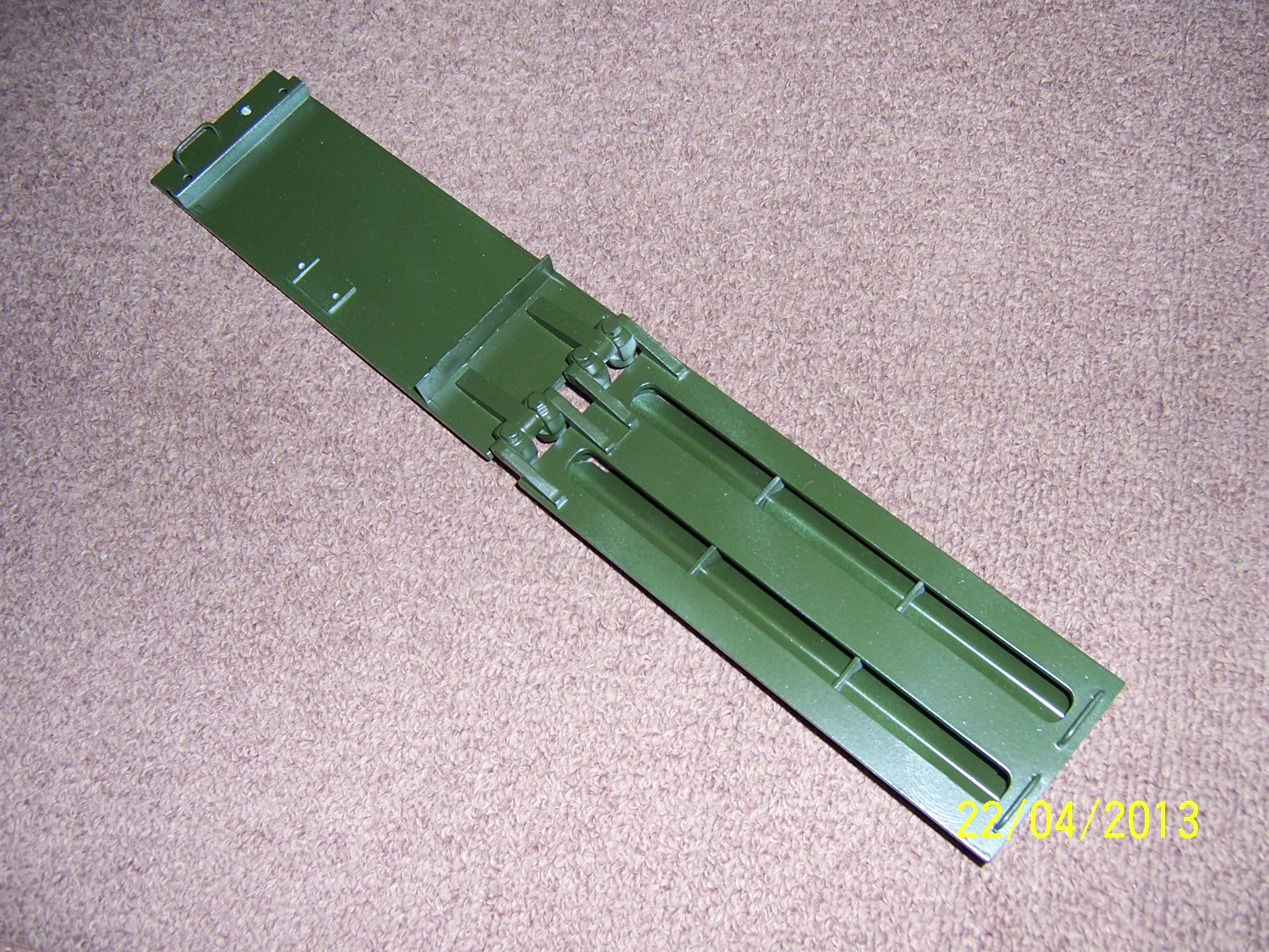

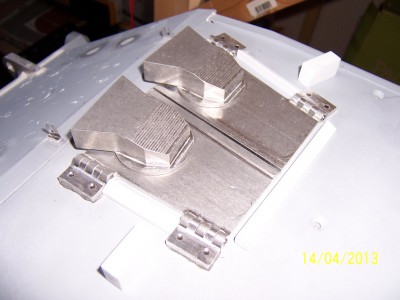

Did some painting this weekend, perfect weather. I've hinged the front and rear engine deck hatches together in pairs for painting, just line up the hinge centres and glue when ready.
We got the mudguards out of the box and filled the gaps where they are folded with liquid metal, it retains it's flexibility which will hopefully stop it cracking if we drive into something
We found the rear mounting hole was missing on both of them - easily drilled.
Paul has been remaking the tool handles out of pine dowel, the pick handles (Armorpax or home-made) don't really fit in the tool clamps though. We eventually found the five small pins to pivot the tool bracket eye-bolts, no mention in the instructions.
We've decided to fix the deck plate/turret ring permanently, there's plenty of room to get the electrics, etc. in/out and it means I can hide the fixings.

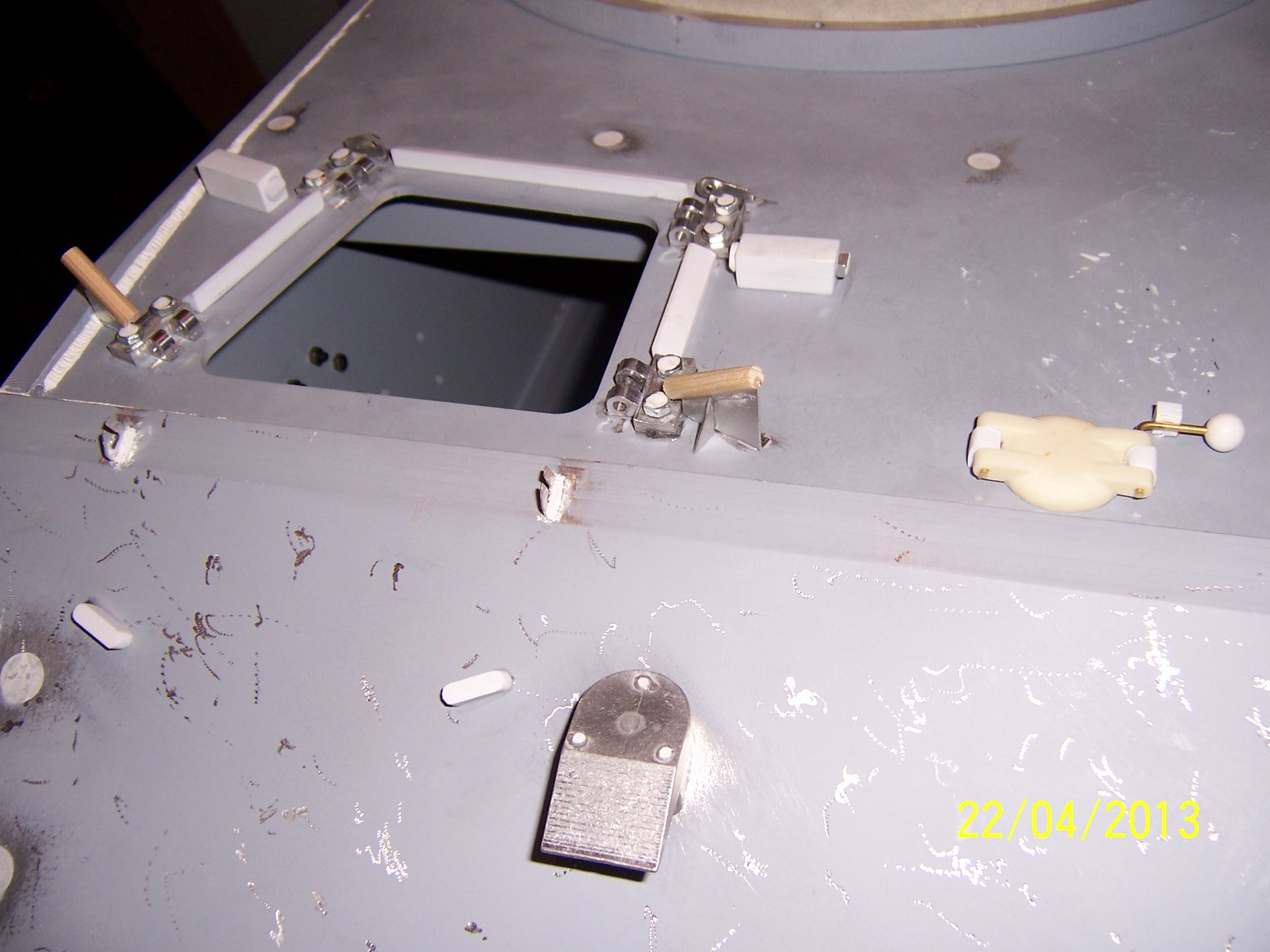

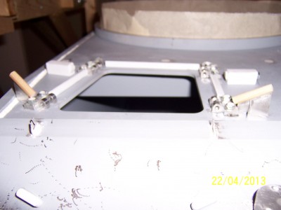

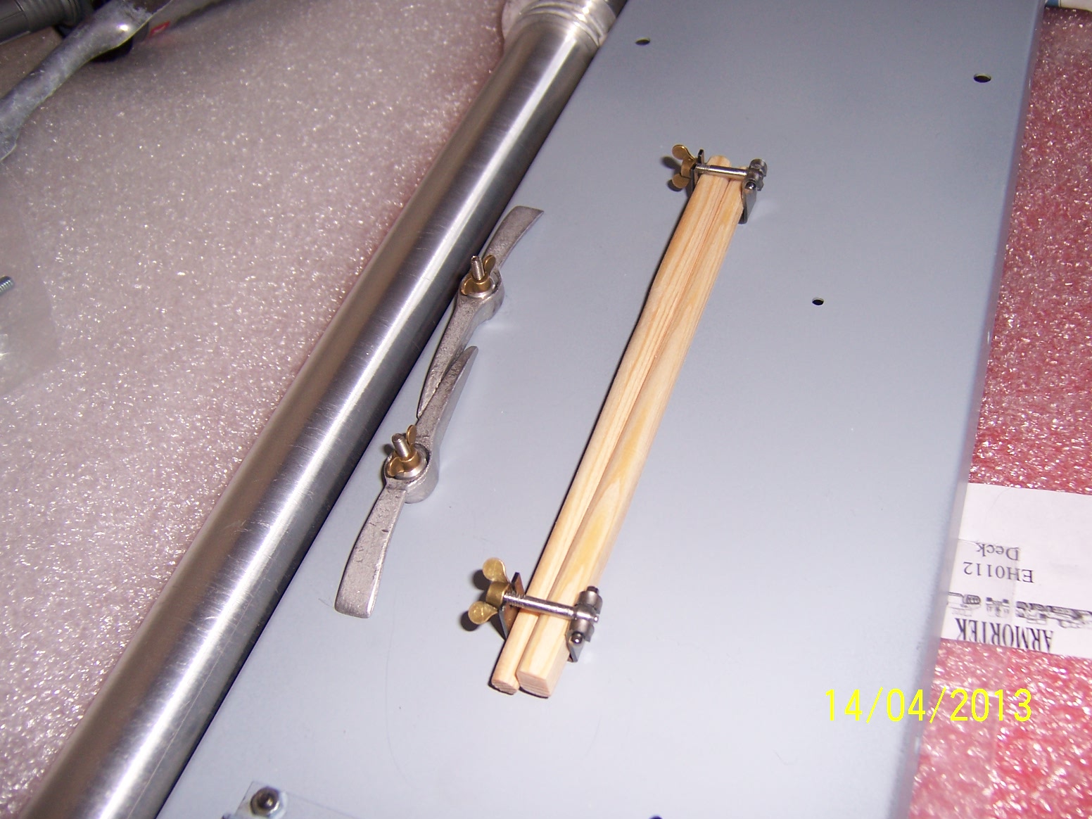

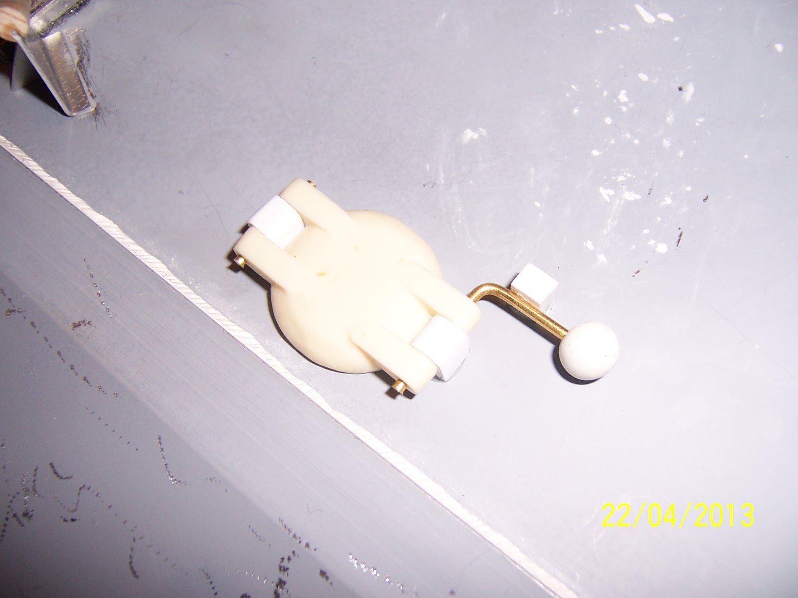

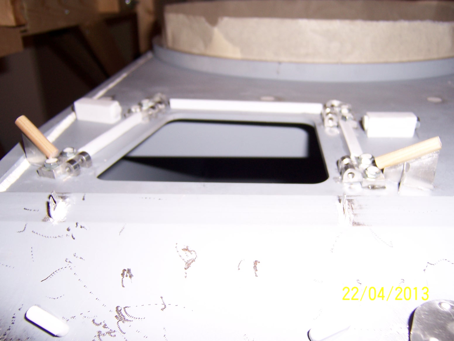

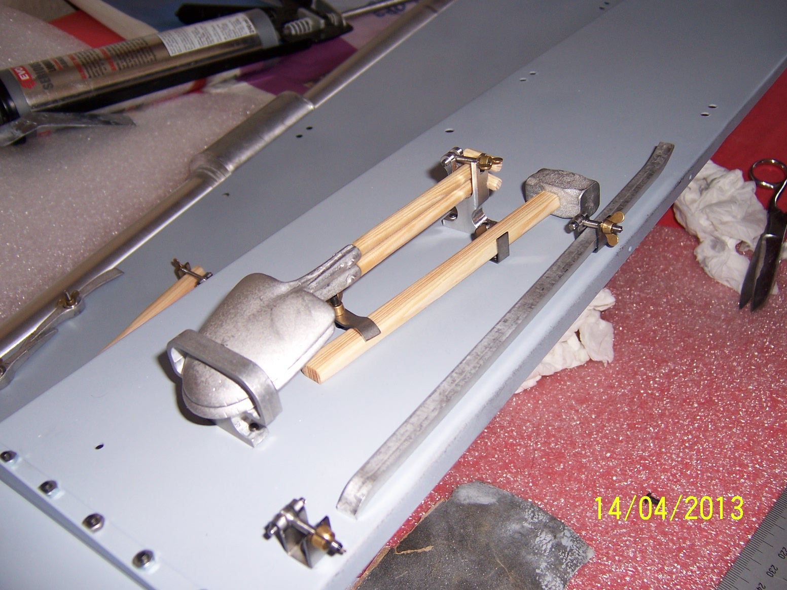

We managed to squeeze the pick handles into the brackets:
Paul's new shovel/hammer handles: I have since turned the pry bar brackets 180 after studying photos. We found the wing nuts could only screw on a couple of turns.

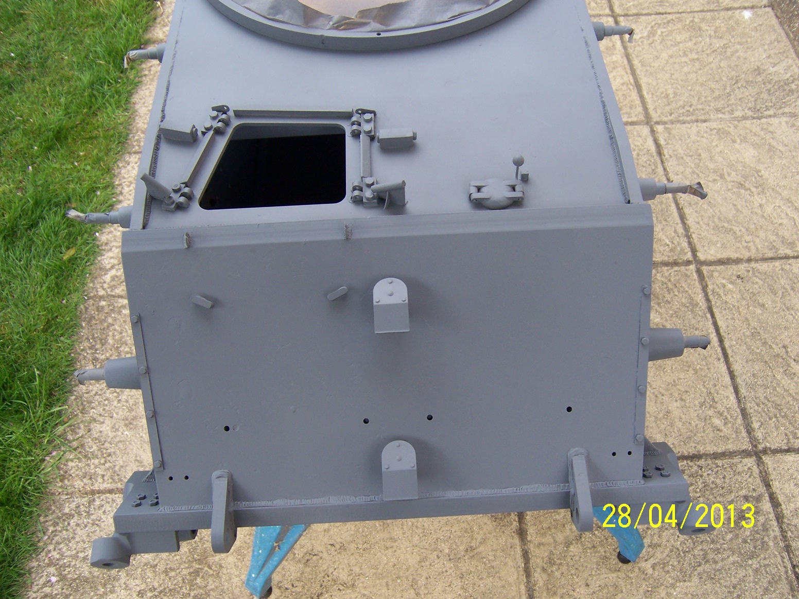

I've been concentrating on the driver hatch surroundings: You may be able to see the small hooks on the edge of the front plate, I assume they are to do with the windscreen/foul weather hood?
Robin
The pick heads are very loose, I'll add some guides to stop them swinging about (we also shortened the lugs). Likewise the other tools need stops to stop them sliding out.Paul's new shovel/hammer handles: I have since turned the pry bar brackets 180 after studying photos. We found the wing nuts could only screw on a couple of turns.
Robin

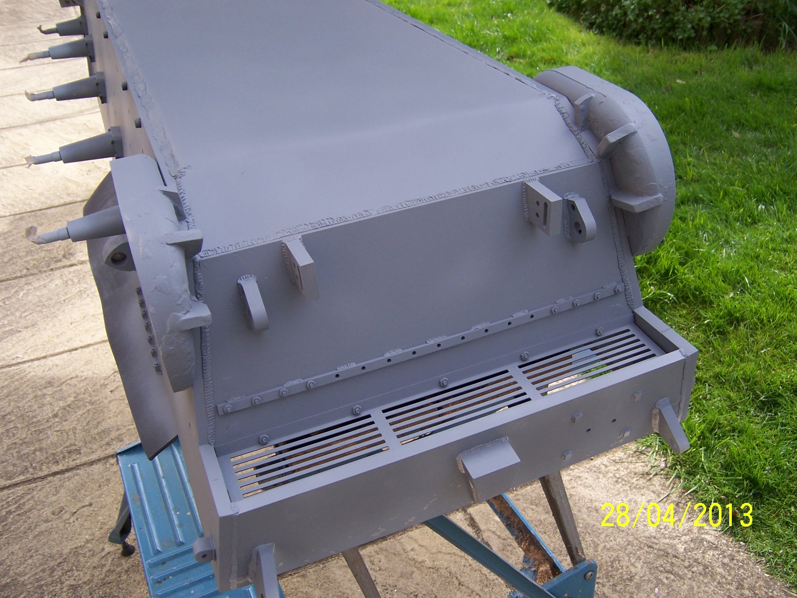

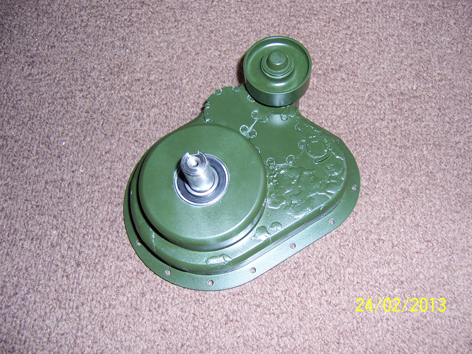

Finally completed the hull ready to paint
I'm pleased with my filler caps, made from resin, plastic, brass rod and Milliput:
We got the hatch pairs painted:
Here are some more detail shots:

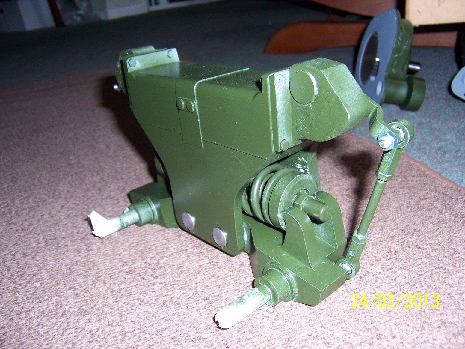

Took a proper look at the turret parts today, most of the basic bits need filing and adjusting, it's like starting another kit
Robin

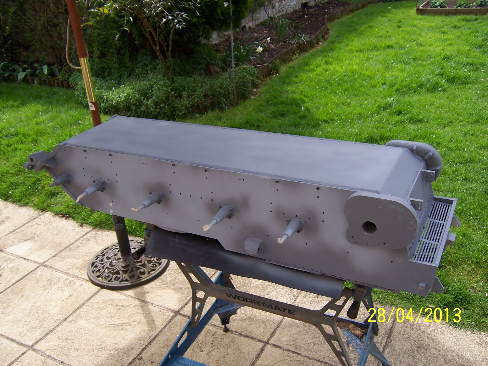

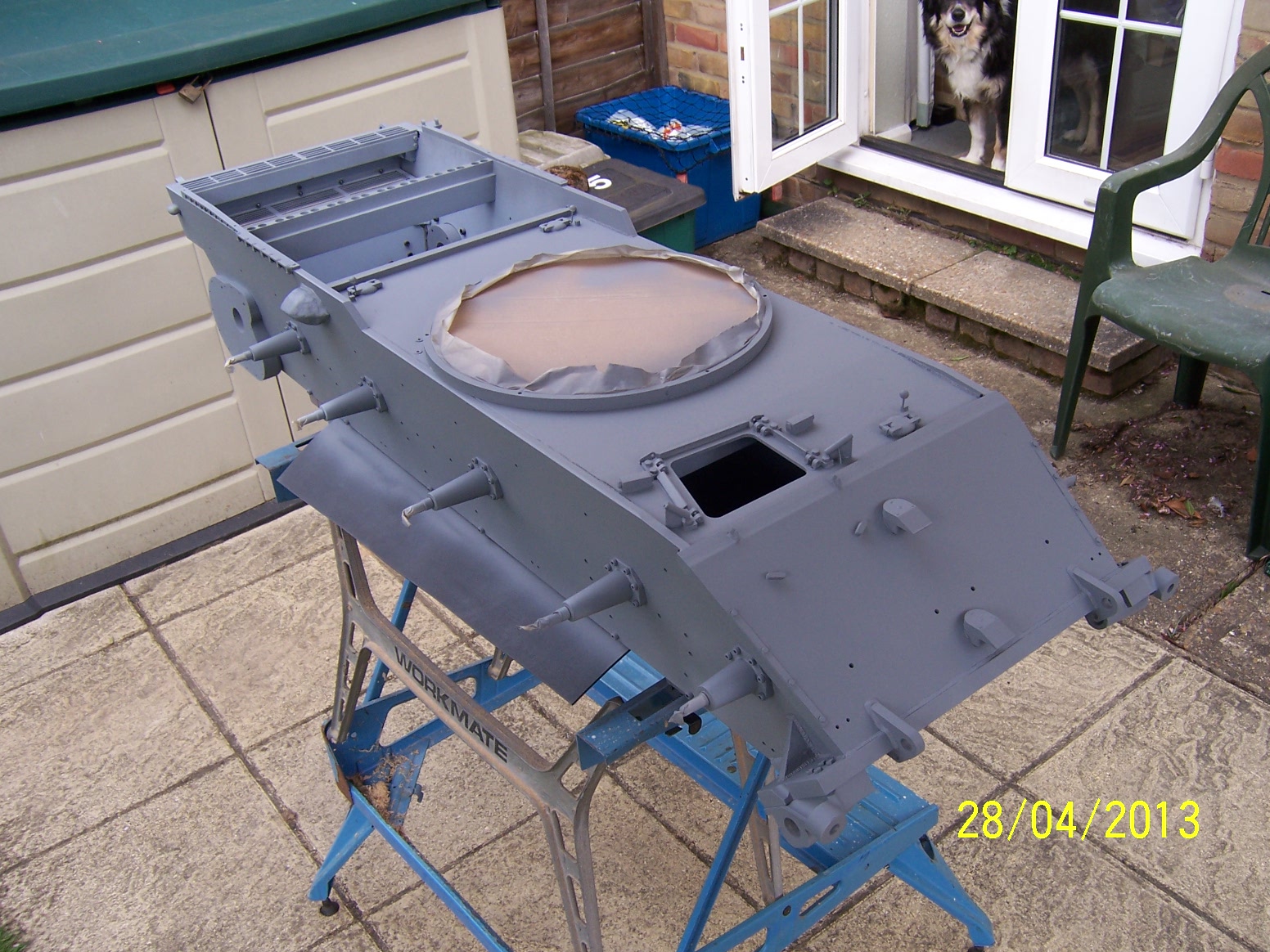

At last (in between gusts of wind
) we are able to paint the big bits.
It's only now that I can see if some of my improvised techniques have worked.
Hopefully tomorrow the green will go on
We also sorted out the main turret parts and etched them.
Robin
