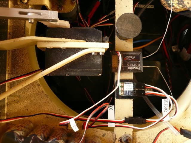

Here is what I am using:
FUTABA S3306 24Kg/cm TORQUE SERVO
TURNIGY THREE CHANNEL SERVO SPEED/DIRECTION REGULATOR
SEPARATE 2.4GHZ RECEIVER AND 6 VOLT BATTERY + SWITCH
With this system you can slow the recoil speed down as much as you like.
The Turnigy was about £7, and the servo £45

What is the function or need for the extra receiver and how is it
connected up and controled.
Phil

I am using a separate receiver because I have run out of channels on my transmitter.Also, I use the long two way momentary switch top right of the tranny for the recoil action,and as this switch is on channel 7, I had to have another receiver! Also I had to use a 'Y' lead to enable me to plug in the 6 volt battery and the servo into channel 7. I hope this makes sense!

Thanks Robin
I thought it might be the shortage of channels,but I didnt know that you
could operate 2 receivers from your one transmmiter,and also that the
momentary switch is connected to channel 7.
Thanks again you learn something new all the time when its shared on
the forum.
I can feel some more experiments coming on now :lol:
Phil

Phil, just to make things clear.I had to use another receiver not only because I had run out of channels, but because on the main receiver in the tank, 7/B was used as the battery connection. I do not have a BEC.

One more thing I forgot to mention, is that you cannot run Thomas's sound card on 6 volts, only up to 5 volts. Hence the separate 6 volt supply. This servo needs to run on 6volts!
