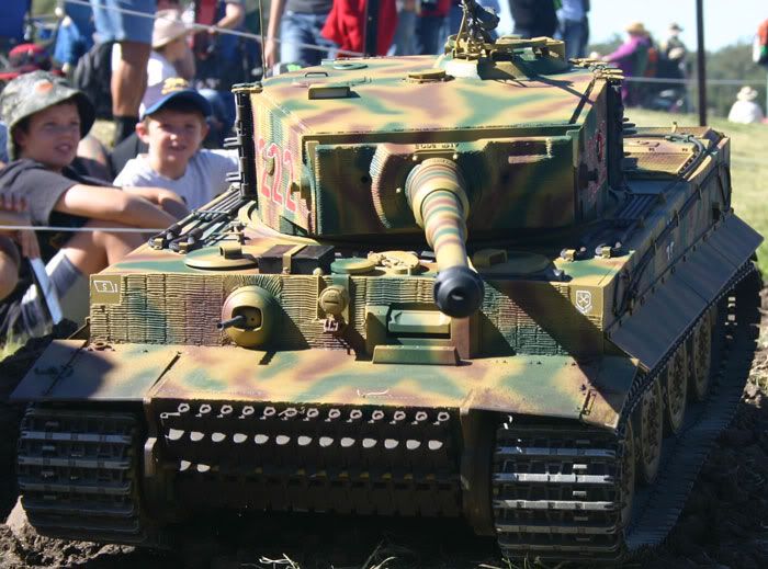

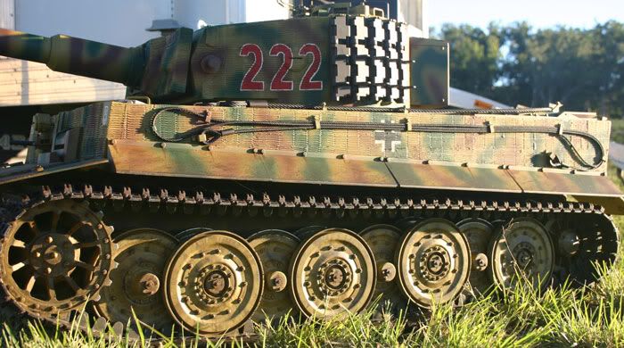

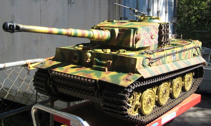

John the turret numbers are painted on, we scaled up the numbers once we found a suitable font we printed them out. Then it was a simple matter of cutting out the stencil.
222 was a very easy stencil thankfully.
Once positioned on the turret we stippled the paint on with a bush and once dried the white outline was added by hand.
Strangely it was easier to do the numbers on the zimmerit than the bin as the zimmerit was more forgiving and minor imperfection are much harder to spot.
My only tips are to not have too much paint on your brush and always brush away from the paper not to it. That will stop the colour bleeding out under your stencil.
The Brown XF- 64 and green XF-26 are just Tamiya acrylic applied with and air brush. Didn’t take much just a single pot of each which surprised me then a dry spray to blend the colours together was applied The finial step was a couple of coats of Testors dull coat, to ensure a matt finish and protect the paint just a bit more.

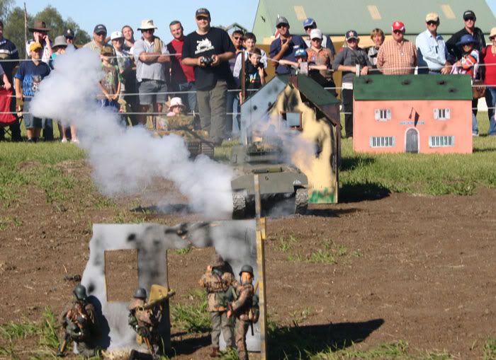

Basically the US has the village, they send out the Stuart to probe the German lines, it is lucky enough to hit the 88 after the 88 missed her to which the German reply with a tiger assault.
The crowd loved it with the Tiger, Stuart, Sherman and the 88 firing their blanks, explosions going off, items getting run over, bodies flying thru the air, what’s not to like.
