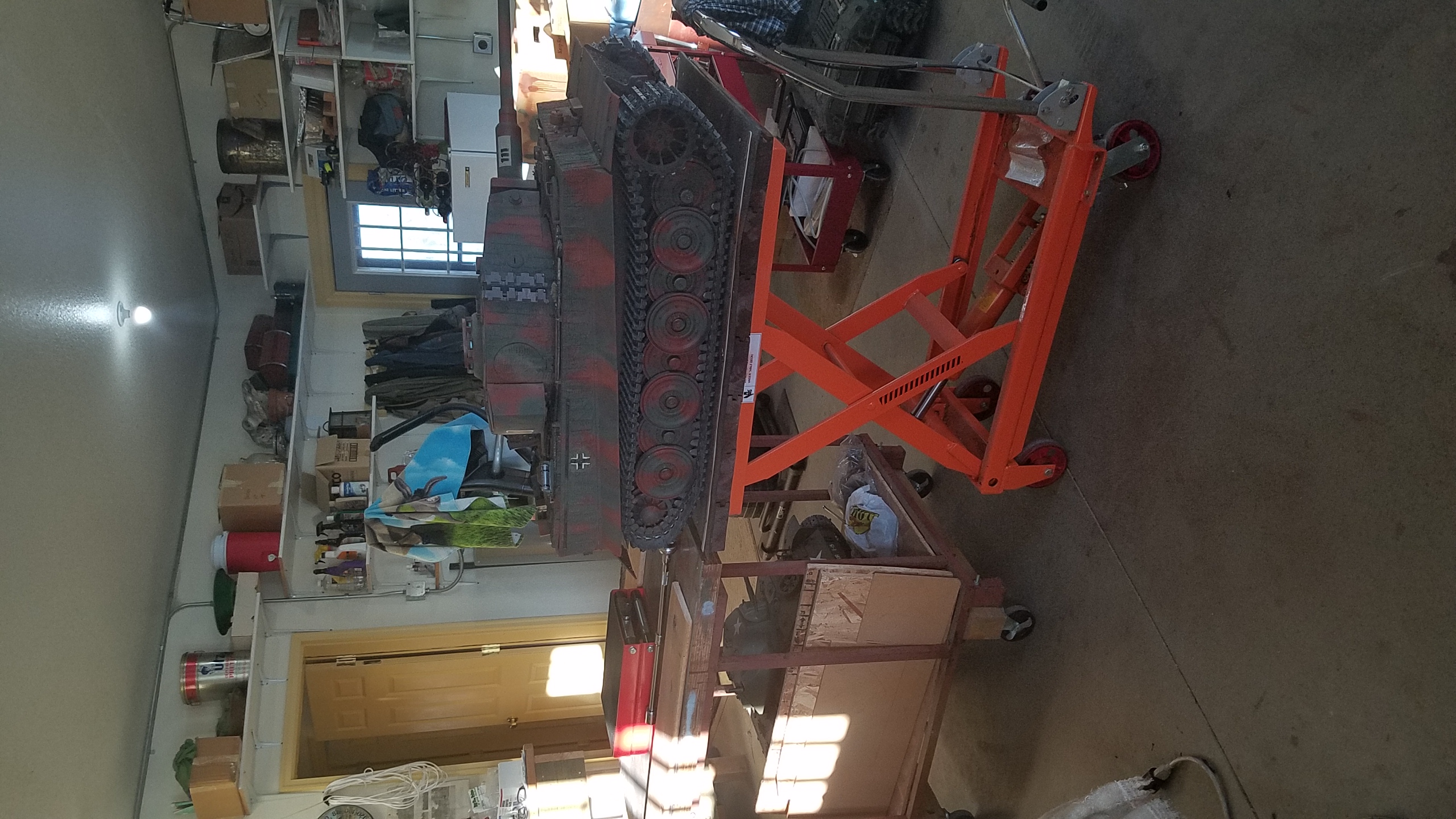

Re: Brian's 2017 NO. 10 LATE TIGER 1 BUILD
pics test.
Looking at the review, it might come out sideways...
