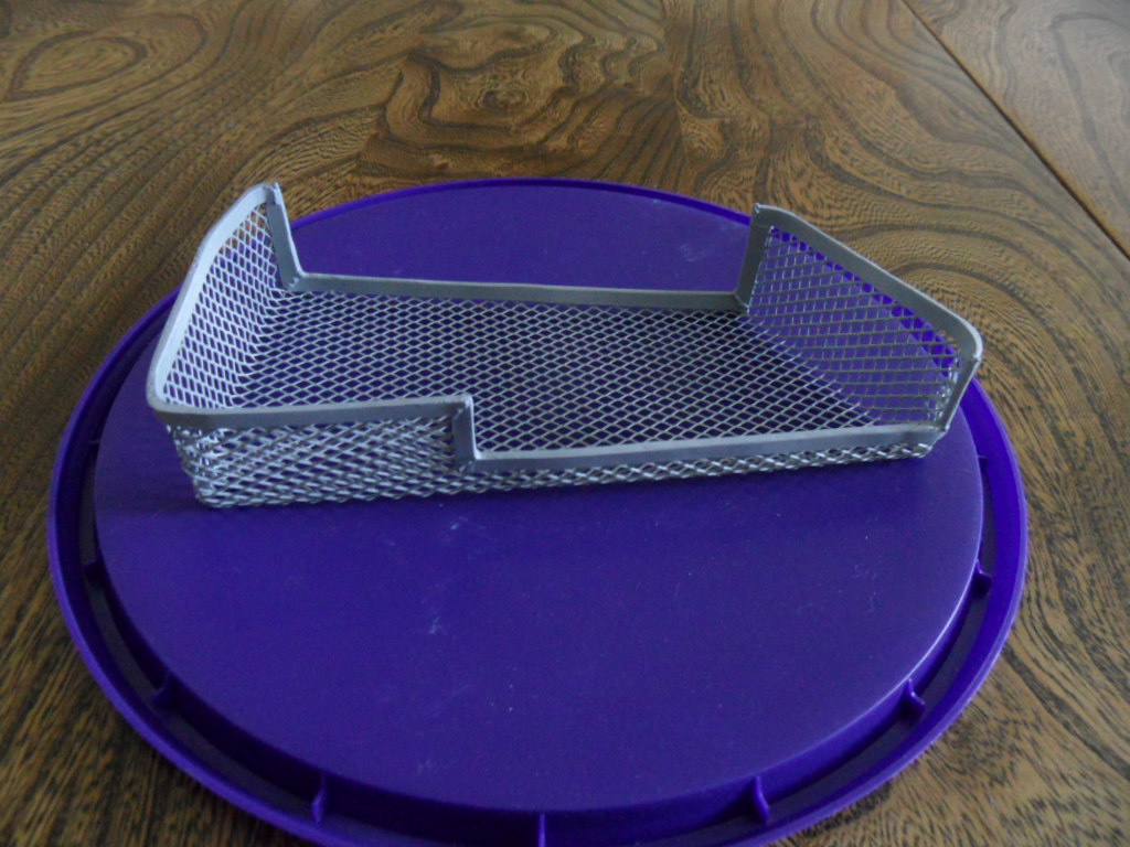

Charles I think your righty on the extra basket detail so far. Something that might catch on?

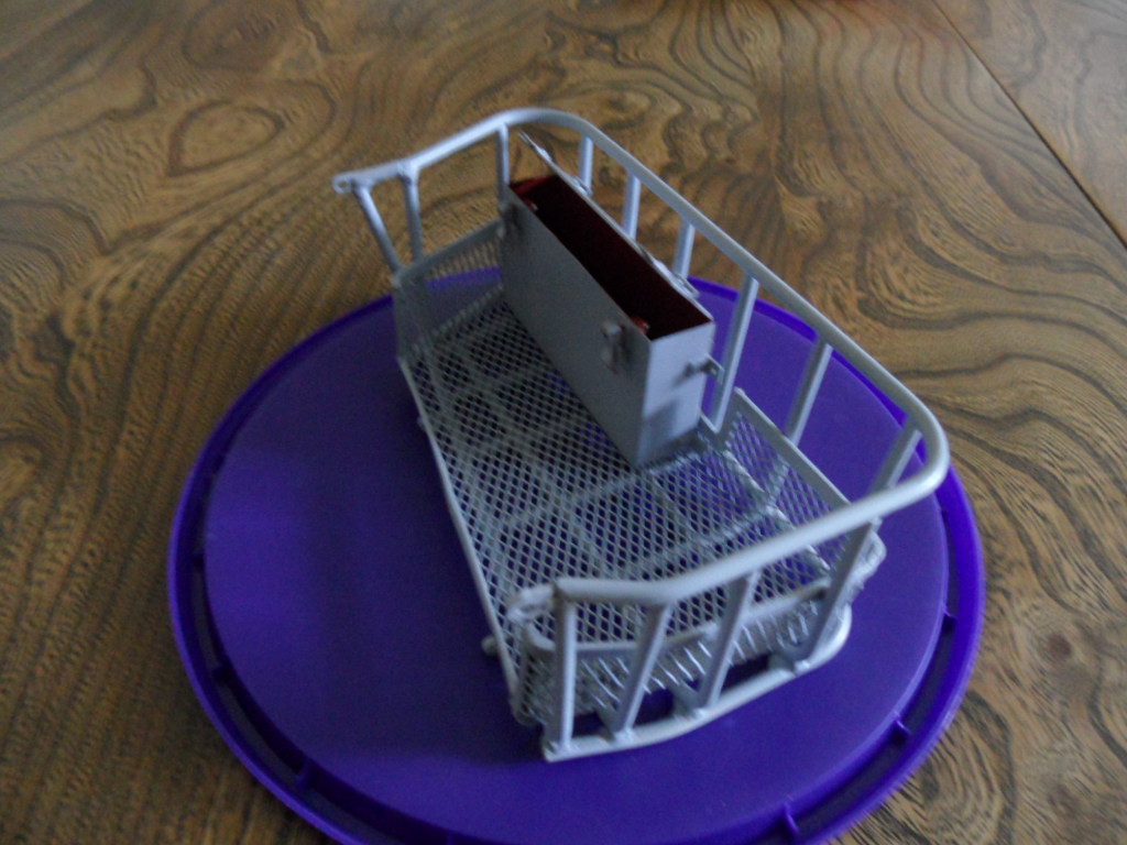

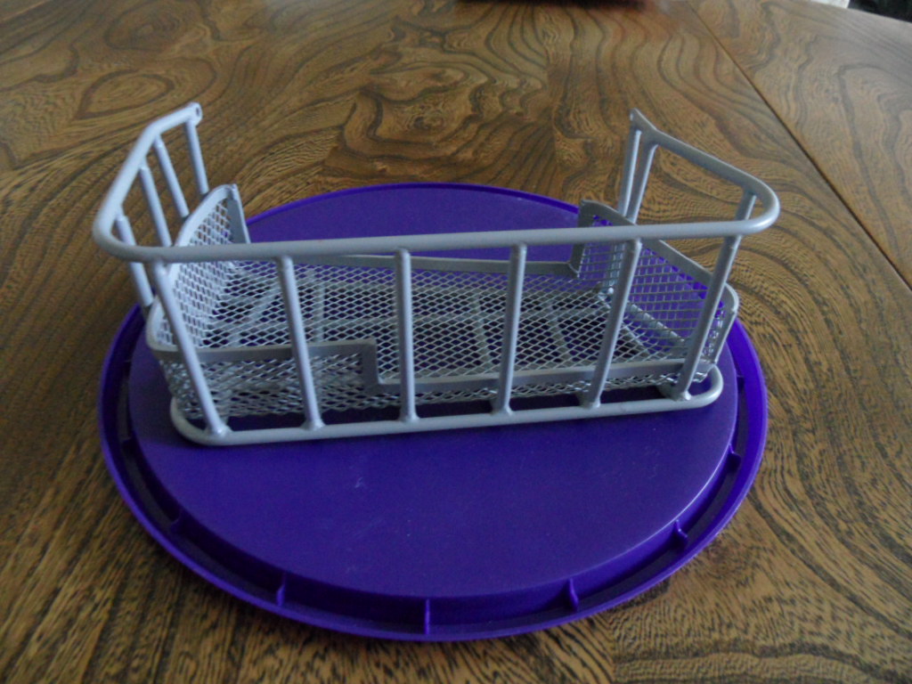

Moving on with basket liner. I don't think the basket liner was an original factory fit, but it was found on many Chieftains, British and Export according to photographs. Measurements don't seem to be common to all, some being high wall, some being low wall, so anything seems to go. Probably made in local workshops for the troops. who may have wanted to improve the storage area. Even the diamond shaped netting goes in different directions on different tanks.
After trimming the basket I couldn't get the fold on the thin aluminum trim I wanted with the basket edging, so I decided to glue a thin strip to both sides of the basket liner upper edge and fill in the gap with JB weld. It makes it strong and ridged around the folded corners, so although it took a bit of time it was worth it. JB weld seems to take about 24 hours to go hard in the cold weather.

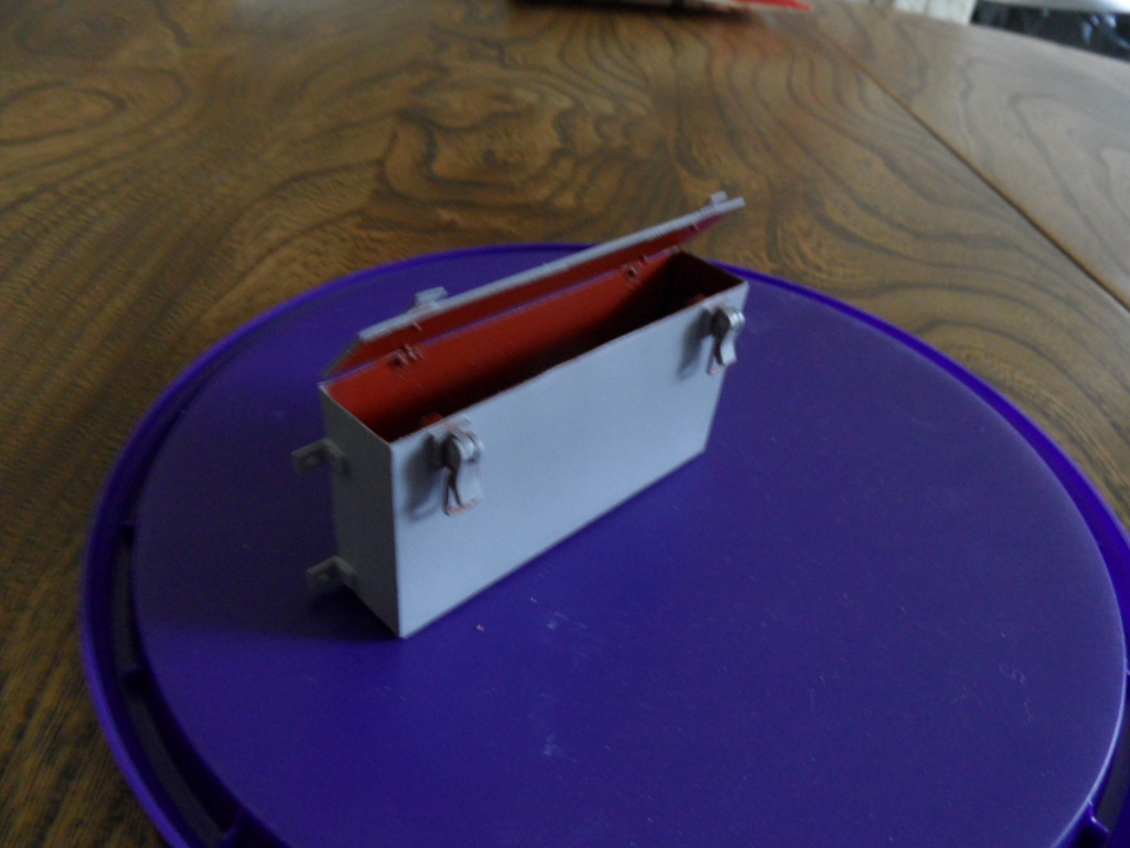

The "extra projectile" box that will be mounted on the Commanders basket was supplied by Mr C Stewart as he had couple of spares, I just fitted the hinges, latches (Modified Chieftain model supplied) and brackets. The original

Hi John,
Basket liner looks very good. As you say possibly not a standard factory fit, I can't find any contemporary photos of them on an early MK3 so that's one less detail for me.
Clever idea for making the basket trim - I've had problems with JB weld not staying put and flowing out of the joint before it sets, so maybe the cold was on your side after all.
Cheers David
Cheers David

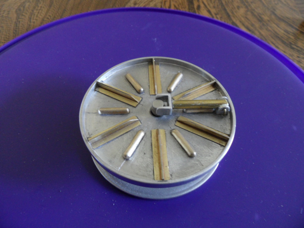

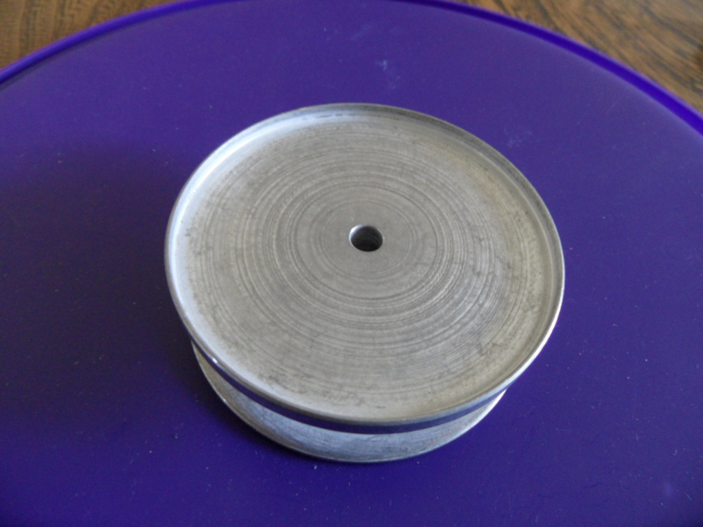

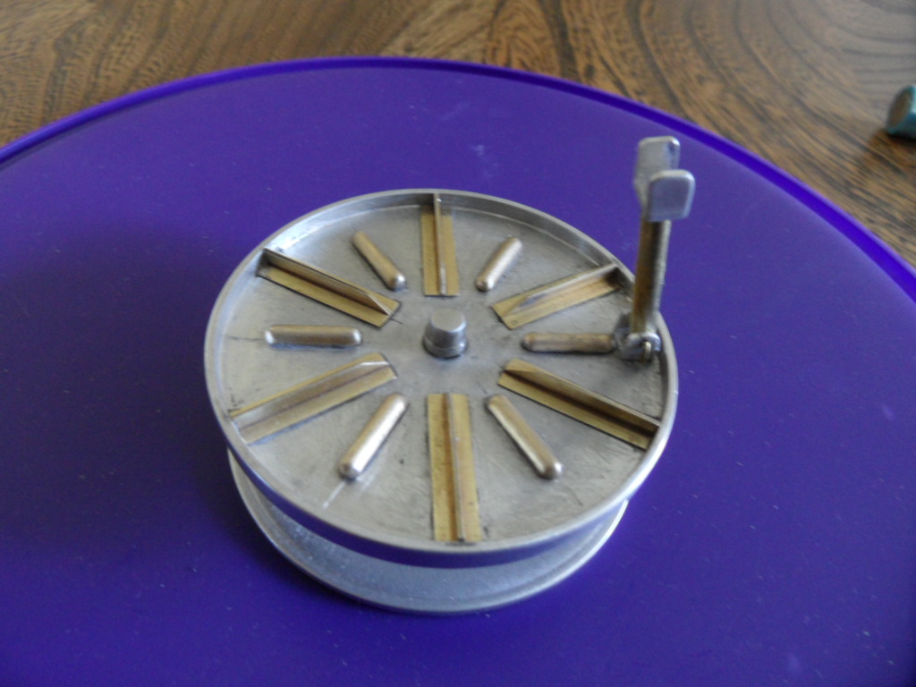

. The land line telephone reel thingamy, Original supplied has few details I've added a few more as others have. Lots of filing, not as accurate as I'd like but better than a blank. Not many good pictures of it on the Chieftain, so I used the Centurion for reference which uses a similar reel. ( I think
) This picture is borrowed from Phils excellent Chieftain build. A lot of Chieftains pictured have this thing missing, stolen? probably make good hose reels.
Your right David, JB Weld can be a bit gooey, stringy too. I use masking tape around some joints to reduce the excess, peeling the tape off before it goes hard. Some times it can take up to 12 hours in cold weather before it begins to cure hard enough to remove the tape.

Nicely done John, I do like that working handle.

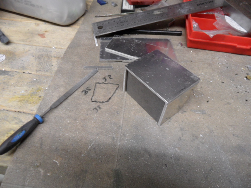

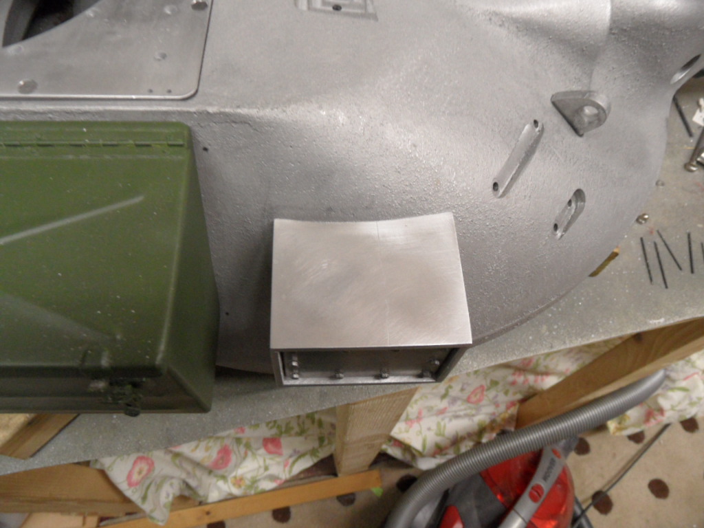

Time for the TUAM or the box on the commanders side of the turret with an ariel on it. I've not seen inside of it and its usually blown off on the down range pictures. The supplied "box" is just large piece of solid aluminum which is small and does not follow the contours of the turret.
A lot of modelers have clad the supplied box to give it the scale size of the original, this allows the extra detail and the fitting of Armorpax's very nice fire extinguisher cylinder and bracket without overhang.
I decided I'd make mine from scratch, cutting and gluing plates together with JB weld. The dimensions kindly given to me by R Goodwin, bolts 10ba. It won't be exact but after several hours of filing it's not a bad fit and now looks the part. It will be screwed and glued into position after painting when the weather warms up a bit. The original.

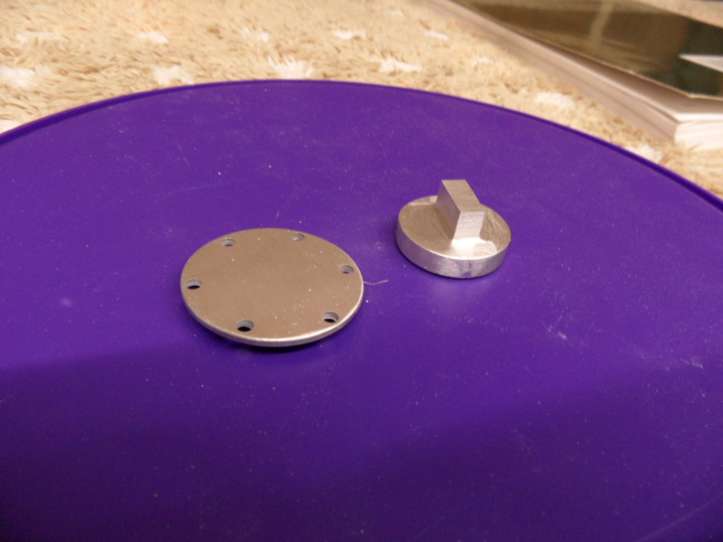

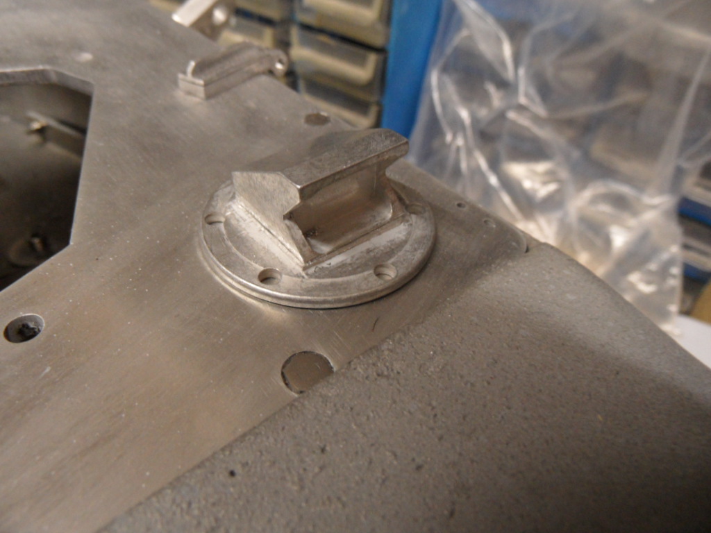

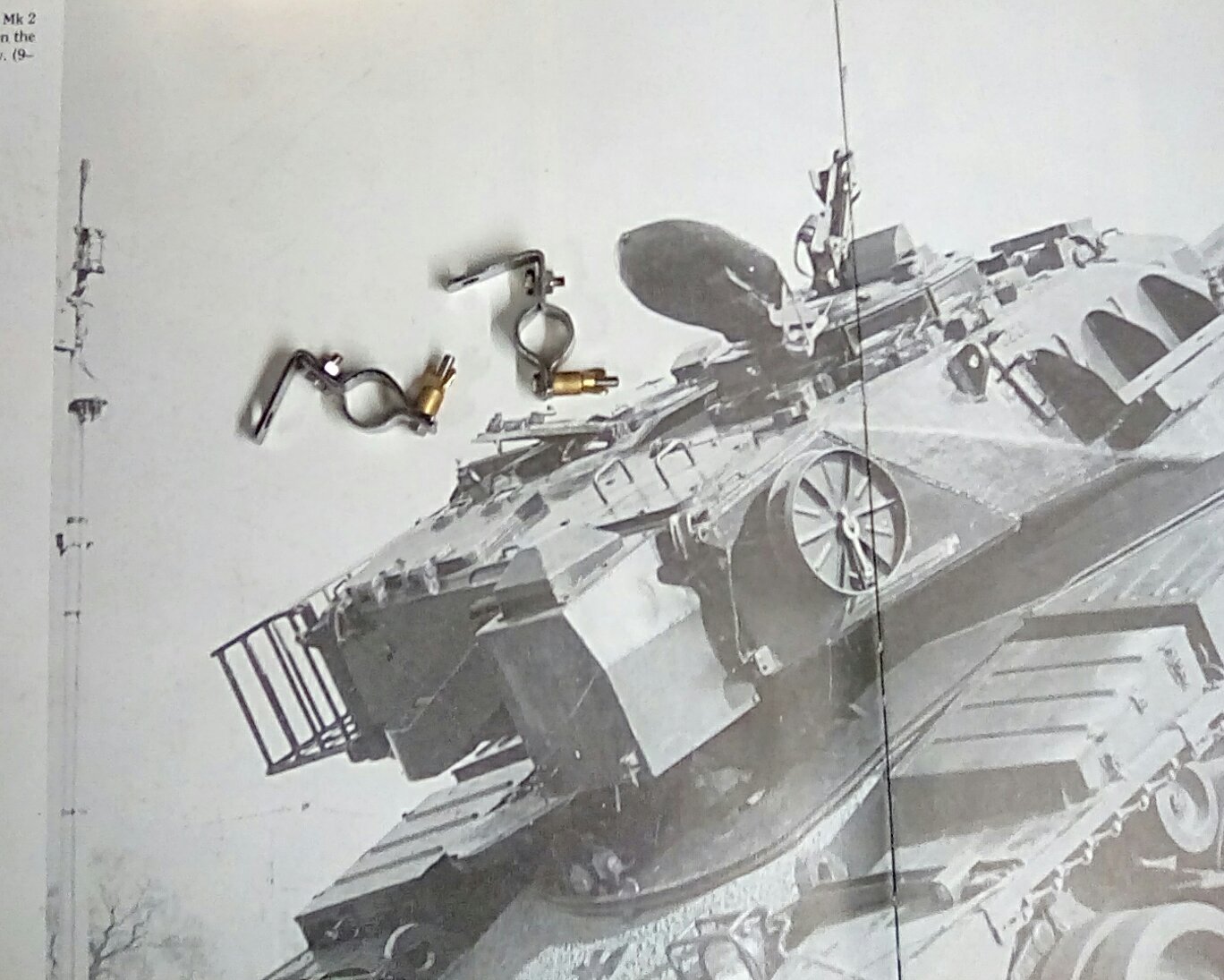

Armortek machined some nice pieces for the Chieftain, the loaders periscope is designed to be stuck in position as a fixture at 60 degrees off the forward line if you want the mounting holes in the correct place.
Although it has a good look, I felt the fitting was a little small compared to the original. So I rummaged around the scraps bin, got the files out and started looking at Chieftains in the picture library.

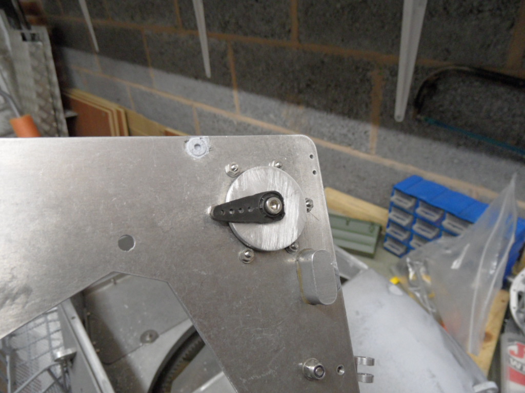

Making the new parts and adding them to the supplied mount, the modification allows the periscope to turn freely and can now be turned by radio controlled. The original

Nice touch John, I fitted a shroud to mine too, certainly improves the look
- Posts: 194
- Has liked: 124 times
- Been liked: 258 times
A clever bit of detailing there John. I hadn't thought of making it servo controlled - but now I can't un-think it....another one for the list.

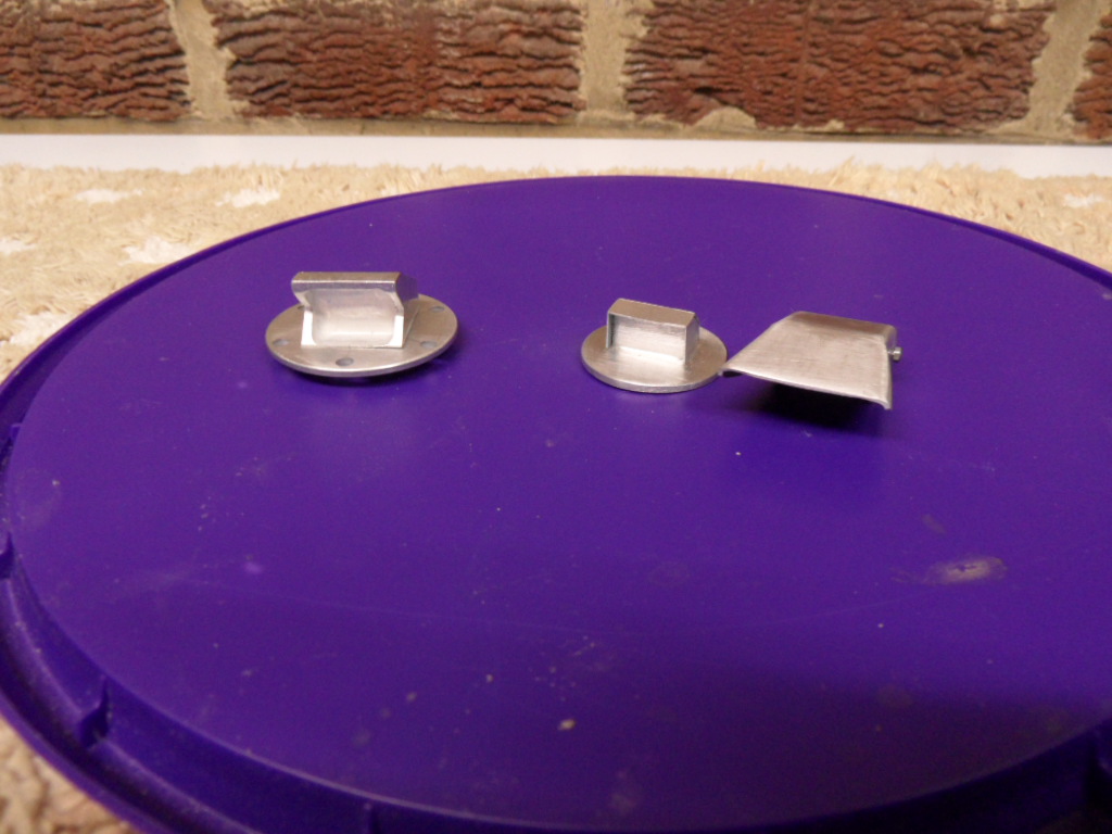

A few more super detailing bits and pieces. The splash board cut from an sheet steel from an old electric heater unit. The brackets too and the strange wedges on the front casting cut from some thick aluminum plate. I still don't know how they work or what their for sitting just in front of the splash board.
I've made another dozer tin plate cable guard, solid this time with more detail, It's now in a reasonable place together with the casting numbers on the add on side armor plate just above it. Lining these things up with the bazooka plates brackets is approximate. I must check if there's casting number is on the other side too. I've seen two distinctive types of numbering, this is the vertical type following the weld line.
