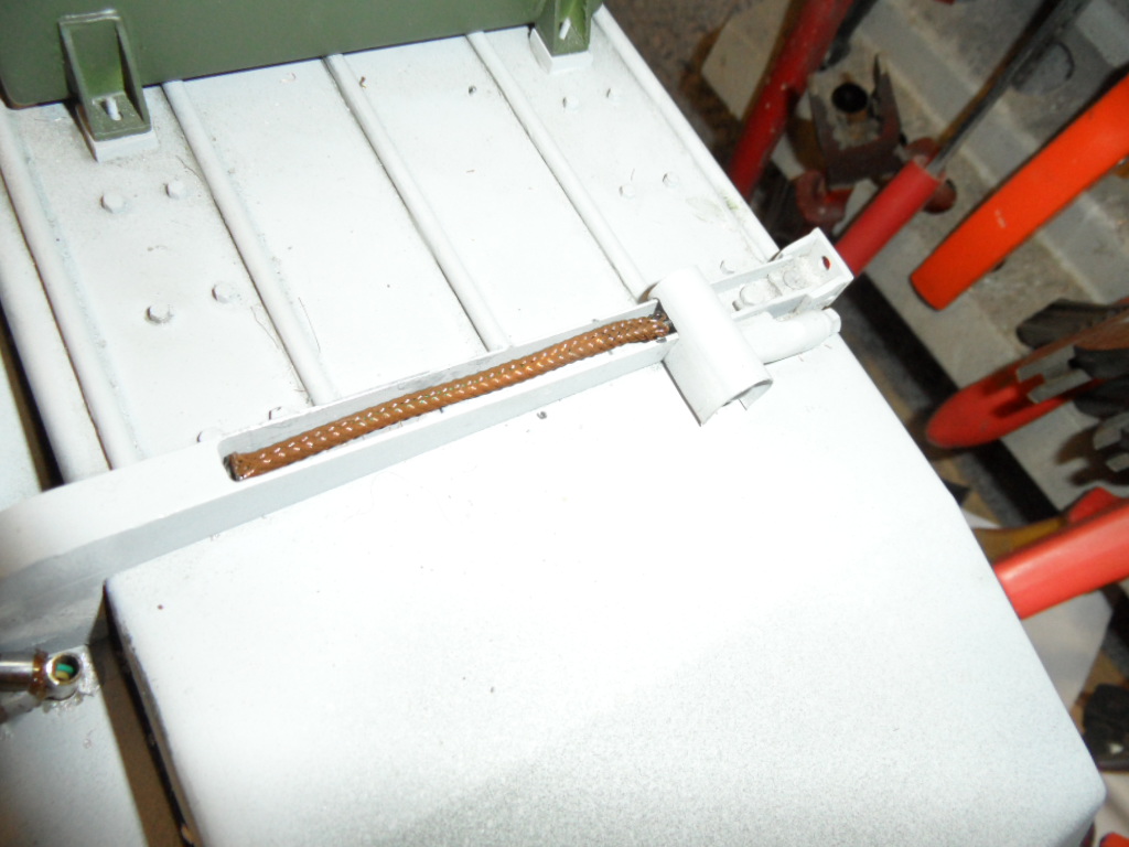

I've been working on the front head lamps and guards recently, the copper braiding I had used seemed difficult to paint and it would loose it's form too easily.
I had made the decision to run all the wiring through the braiding like the original and it became a messy difficult fit.
After using and getting reasonable results from the plastic 2mm braid I have used on the rear end, I went for the make over on the front end.
It's a fiddly job and not one for my sausage fingers. But we're getting there.
Also in the mix were the alterations of the kit lamp guard, After altering the shape where it became a bit smaller and more compact to the rear. I found that the mod exaggerated the lamp bar being not far enough forward. So with the aid of the real tank pictures and artistic license I think I've got the best of both worlds.
With the rear of the lamp housing poking into the rear of the light guard and the front a few mm from the front of the guard.

Thank you Richard, I've made around 2000 changes so far if you include sized screws, super detailing parts and of course modified original parts. It's slowly coming along.
Steve,
The 2mm braiding came from Ebay, although it looks like nylon type material and it does allow paint to stick to it. 2mm was the smallest I could use if I was poking wiring for the LEDs through it. The 2mm is a little too big scale wise, but it allows the four wires to pass through without expanding too much.
If you wanted dummy braid I think they do go down to 1.5mm, maybe smaller, very cheap by the meter too. After cutting, if you gently melt the ends you'll stop it from fraying, unlike the copper shown in the picture which just likes to fray willy nilly especially on short lengths.
I wouldn't advise using copper braid unless as a dummy braid unless you have lots of patience. I did try a stiffer silver coated braid but had no luck with that either.
The ferrules are cut from old radio telescopic ariels, their usually chrome plated brass and ideal for thin walled tubing of various diameters. Cutting them with a Dremel tool mini disk cutter.
The easiest solution is to hide the wiring, probably under braid on the side lights using dummy braid else where, drill directly down below the lamp housings going straight through the armor into the hull. it will save you a lot of time and frustration.
Steve,

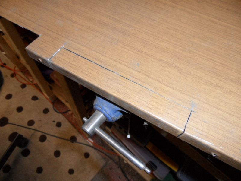

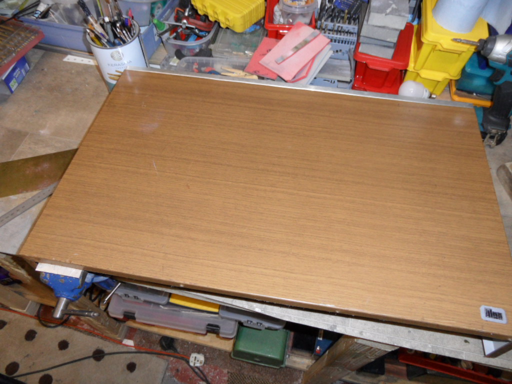

A few more super detailing bits and pieces. The splash board cut from an sheet steel from an old electric heater unit. The brackets too and the strange wedges on the front casting cut from some thick aluminum plate. I still don't know how they work or what their for sitting just in front of the splash board.
