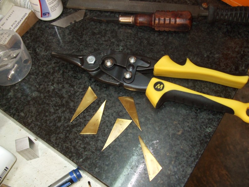

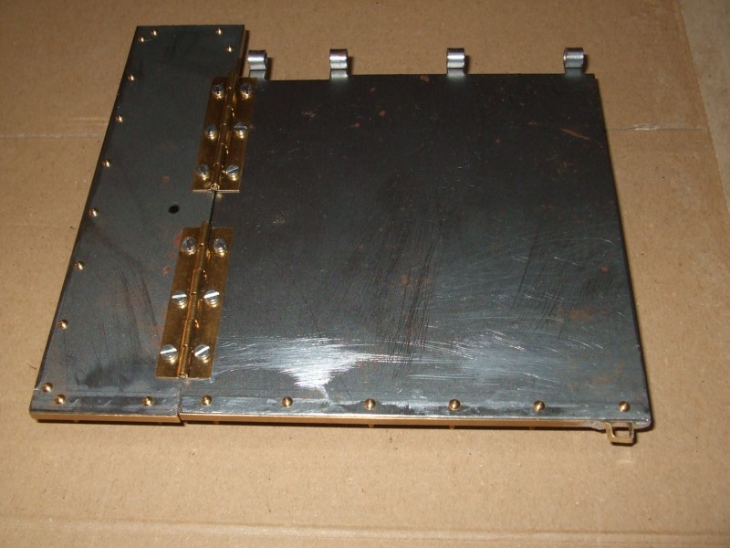

After that rant, I did something new today. I started on the side skirts reinforcing webs. I used 0.8mm brass sheet and cut them old school with a tin snips.

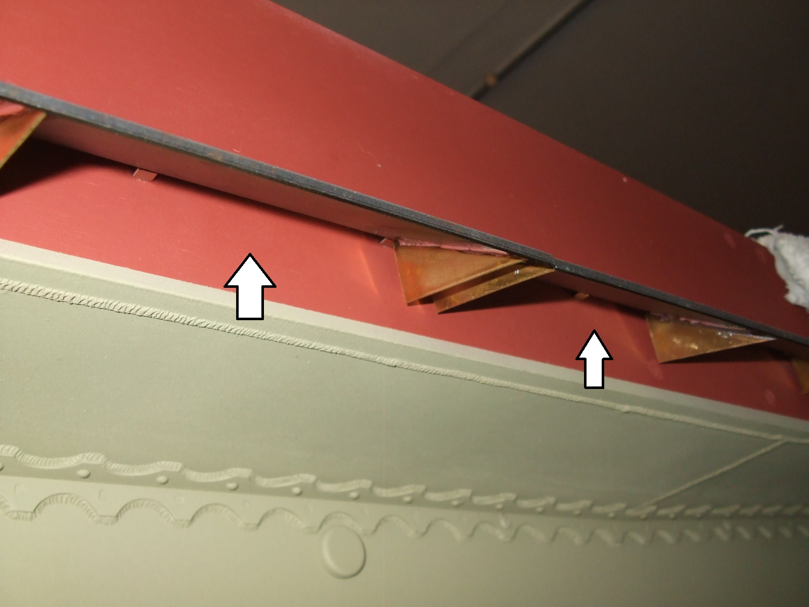

These were then soft soldered to the side skirt with an even older school method. Do you remember soldering irons one heated on a flame?
And the result is not that bad.
I have a question if you don't mind. In the last photo, the area under the side skirt shown with the arrows, does one cover it in zimm also? I have seen models with zimm and without zimm in this area.

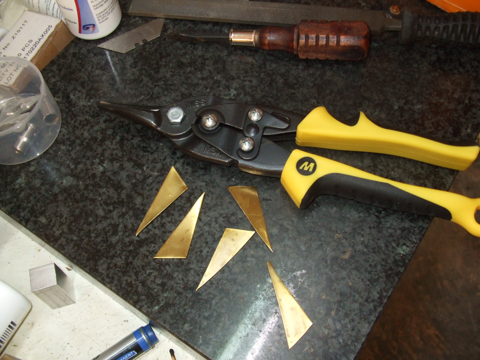

Vince,
Those side skirts look awesome. I will do something similar to add the triangle pieces. I may use steel.
I believe the entire sides were zimmerited, even under the skirts.

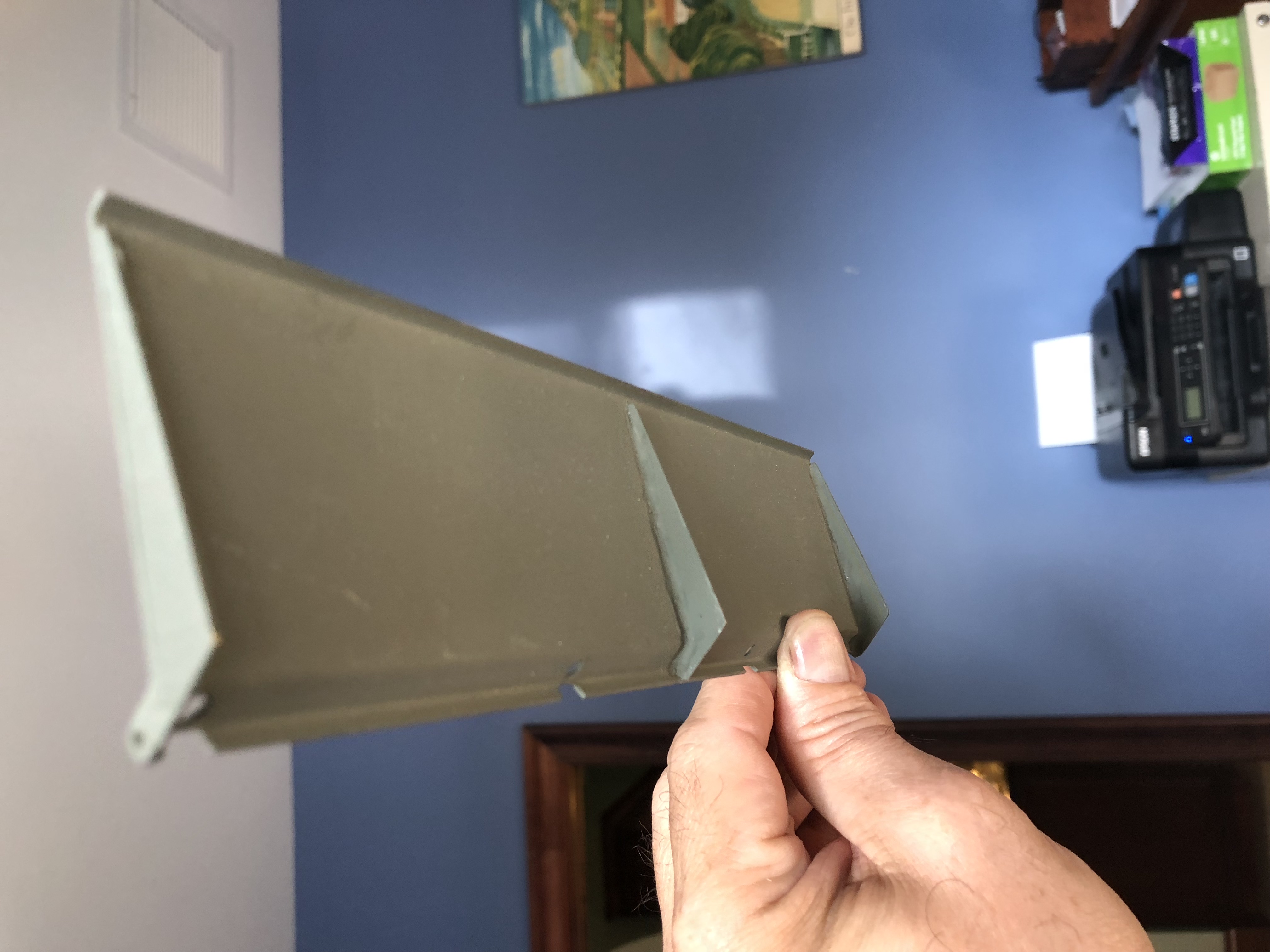

Those turned out really well Vince. I roughly copied John Grima's technique. I made a pattern from cardboard and traced them out onto brass sheet stock. Then I cut the pieces rough and slightly oversized. I flattened the bottom of all the pieces and clamped them together in a vise and gang filed them. I then shuffled them and filed them again very lightly.
I used my resistance soldering system to attach them. If I were better with it I could probably replicate welds fairly well. I was very pleased with them. One or two were not soldiered perfectly square due to my primitive work piece holding techniques, but probably won't be noticed.

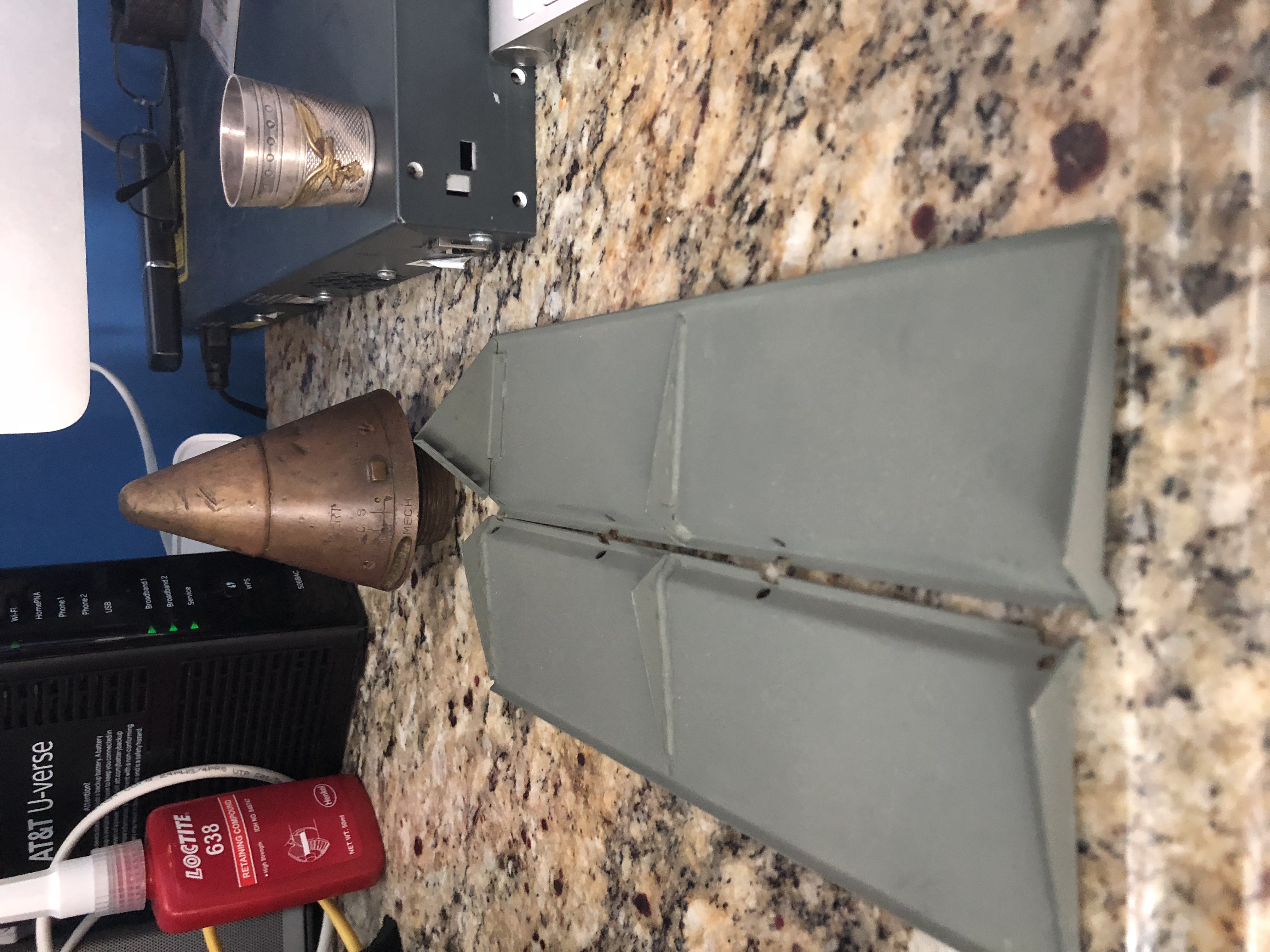

This might help:

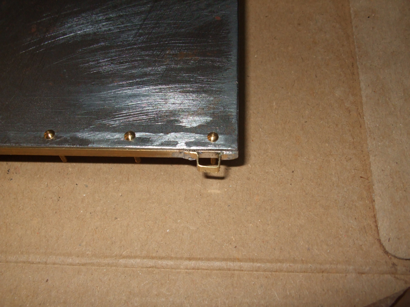

Finished soldering on the sideskirts of one side. Now to clean them up and remove any surface rust in preparation to be etch primed. I also did some work on the front and rear plug of the sideskirts (CE0365). I elongated (not opened up) the fixing holes by 2mm so that the plug could be moved up and fit better with the sideskirt.
I did this with a 3mm slot drill in the milling machine but could very easily be done with a small round file. Now to do the same thing to the sideskirts of the other side.
