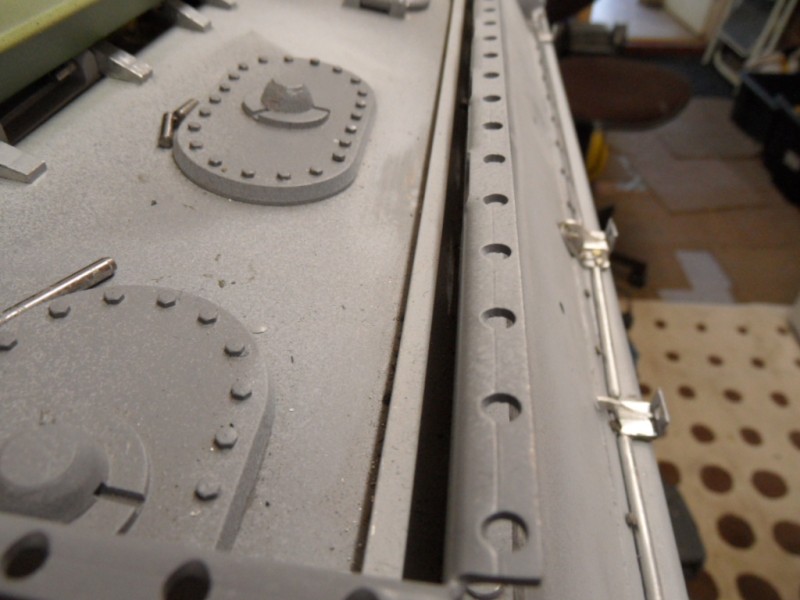

Re: Chieftain No. 34
Posted: Tue Aug 22, 2023 10:51 pm
by Charles A Stewart
Hi Folks.
Hopefully fixed the first Gun bump rail in place.
I have managed to fix it with 3x screws directly into the hull:-
Note the Allen keys to aid fixing
I have moved the long part of the gun bump backwards by about a 1/4" overall. At the forward(fwd) end I drilled another hole in the bump guard (allen key is the clue) put an insert into the hull, tapped and used a M2.5 button to secure that end.
M3 button used on the other two and the now separated cross piece.
I hope this makes sense. Just need to look at some weld and perhaps a bit of filler.
Till next time.
Charles

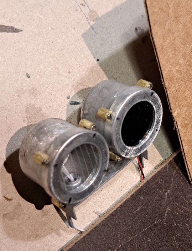

Posted: Sun Dec 03, 2023 8:11 pm
Evening all.
Managed to get my head round this small, arsemungeringly fiddly project. True others have mastered it before I, well done, my respect.
1x set done & card template ready for the other set.
A little profiling with filler next
I have made new brackets too, pinched that from Phil's build, hope you don't mind. The wires are going to go into the hull through the mounting holes and false braided cable fitted to the back of the light units once mounted, well that's the plan :D
Take care.
Charles
Posted: Sun Dec 03, 2023 11:46 pm
by John Clarke
It's a better plan than I had Charles. Looking good
Posted: Mon Dec 04, 2023 10:17 pm
by David Battson
Hi Charles,
Nice work on the headlights the bezel fixings really improve the look, I've just being doing the same detailing on mine and agree with your assessment - very fiddly.
Like you I've also gone for dummy cables coming out of the back which I recon is about 1/2" or 2mm in scale terms - have you or any other builders been able to find a suitably looking 2mm dia. braided cable to use here ?
Posted: Mon Dec 04, 2023 11:00 pm
Good evening David.
I think it will be a couple of days before I finish them. I have just put some JB Weld on the brass bits to help blend in, so we will see how that looks.
Braided cable:-www.prime-miniatures.co.uk has lengths of a braided cable that might suit. I'll say the 2mm looks enormous but might be suited to the smoke thingy's on the turret. Therefore I opted for the 1.2mm for my light fittings.
Hope that's a help
Charles
Posted: Tue Dec 05, 2023 7:38 pm
by David Battson
Hi Charles,
Many thanks for the link, help indeed that's just what I wanted - order is in.
They list their sleeve by the internal diameter, so I've gone for the 1.0mm which has an outside diameter of 1.8mm - close enough to 2.0mm I hope.
