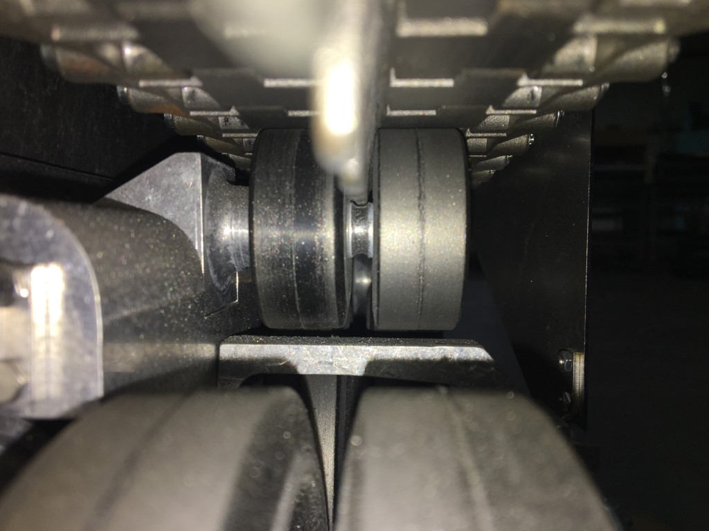

We have checked back to the models that we have here. The horns do not foul on the return rollers.
As zou can see in the pictures, the tracks sit on the rubber.

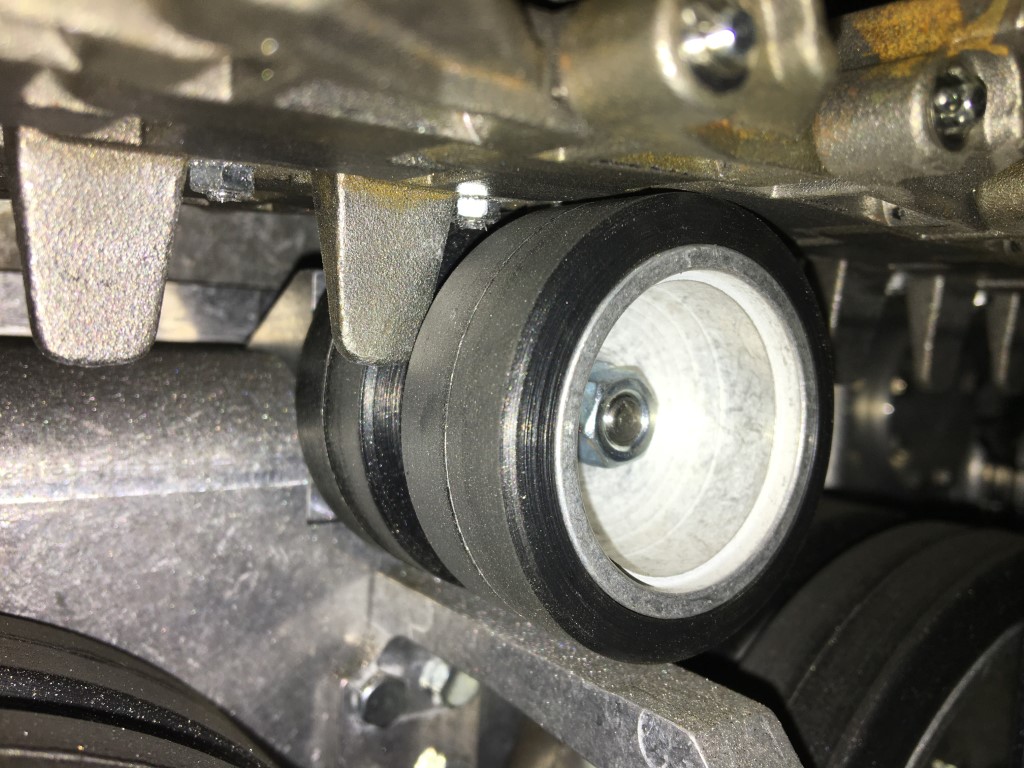

Hello Kian
Your photo does show the track horn running clear of the rollers but there is definatley an issue, which is clearly demonstrated by the gap between the tyre and track link in the attached photo.
Greg

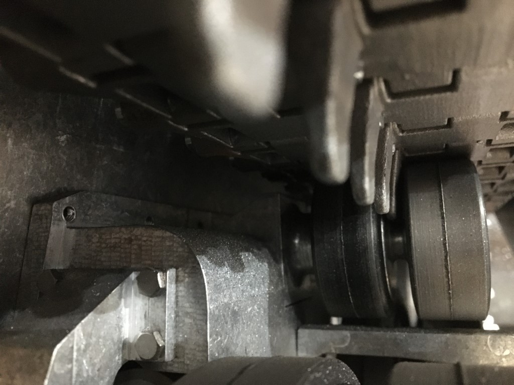

Hi Kian,
I can confirm that mine is he same as Greg's and John's in that the horns are impacting on the roller wheels.

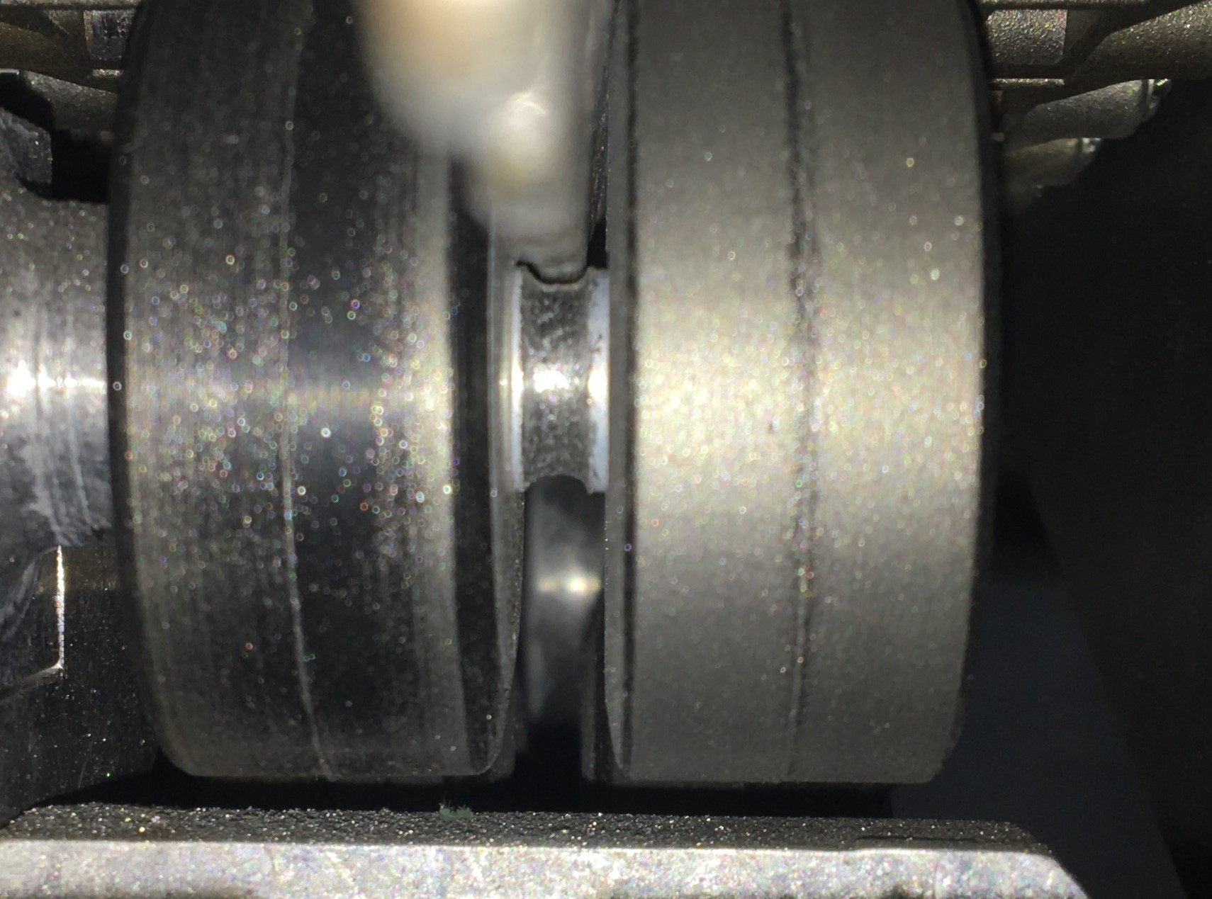

Here is a photograph of our Chieftain in the factory.
As you can see, the tracks quickly cut a channel of about 0.5mm to 1mm. This is not an issue as there is still sufficient material left on the return rollers.
I would advise against cutting the track horns and instead let the running gear naturally bed in.
Worth pointing out that it is always good practice after assembly to run the tank and then get it back on the bench to check the running gear (taper locks, sprockets, idlers, roadwheels, etc) for wear and make any adjustments as needed. As you run the tank, this should be done on a periodic basis.
CHANNEL CUT INTO THE RETURN ROLLERS
CLOSE UP VIEW OF THE SAME THING
