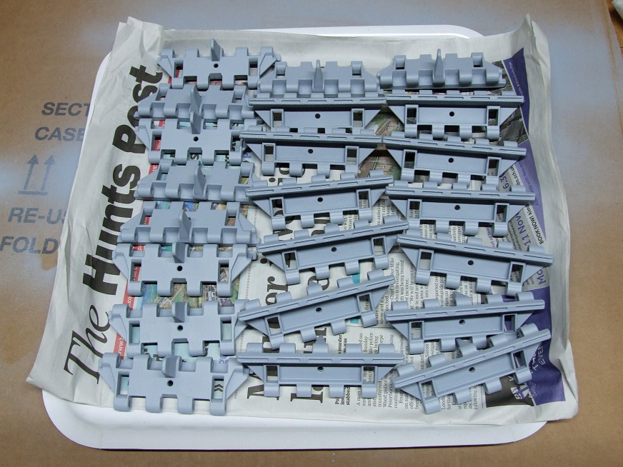

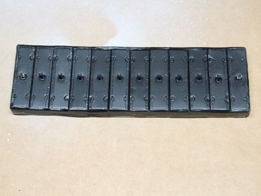

Gents, I think the original questions I asked above have been lost in the noise so grateful for some guidance please.Richard Goodwin wrote: ↑Sun Nov 03, 2019 1:34 pmNow thinking ahead to track assembly, I have a few newbie questions which i hope the more experienced of the community would be kind enough to provide some guidance. I apologise now if these have been discussed elsewhere and I've missed it! Questions are as follows:
1. Is it worth giving the track pin, washer and cotter pin, a thin dusting of etch primer?
2. Should the track pin be lubricated and if so, with what?
3. Should the cotter pins with the exception of one on each track be on the inside of the track?
4. Should the pad securing nut be secured with Loctite blue and should it have a washer under the nut?
Many thanks in anticipation

Stephen, many thanks for your reply. I had read the articles beforehand and as I said earlier, I'm playing catchup with the blog. Taking each point in turn:Stephen White wrote: ↑Mon Nov 04, 2019 1:45 pmRichard
1. Yes - suggest you read the KB Topic I recommended.
2. No - ditto. Lubrication is a magnet for contamination which will increase wear.
3. Yes.
4. Yes and no, the pad isn't going to rotate so not necessary. The real ones had a split washer if you wish for total realism.
1. I had sprayed etch primer on both the washer and track pin but found the track pin very difficult to insert and when I removed it, most of the etch had disappeared. The etch added extra thickness to the washer also and made it more difficult to insert the cotter/split pin in the track pin. I had tried this on several links with the same result. Now the only way this will work is if you put a thin dusting on then it all fits, hence the question.
2. I understand that using grease on the track pin will cause increased wear due to it retaining for the lack of a better word, rubbish, but surprised that a dry lubricant isn't used instead. Surely metal on metal isn't good and will cause significant wear as well?
4. Thank you for the info about the split washer. i didn't know that and will get some on order now.

Richard, etch primer works best with the thinest of applications, so a light dusting is all you need. Yes, some will rub off but usually, the pin won't rotate in relation to the link on one side and so you end up with some protection remaining.
You can use a molybdenum dry lubricant but it's pretty expensive and really not necessary. I do use moly inside the gearbox and on the axle spindles but avoid wet lubricants like the plague. This has been longstanding advice from Armortek although I don't believe it's been re-validated recently. On a real tank, the track pin wear is very significant and pins do get that "crankshaft" effect but I've not experienced any significant wear on the track pins. I'd suggest that with a wet lubricant, the risk of erosion is greatly increased, if you're intending to run on anything other than a hard surface. There are some very "high mileage" models that are run on sandy conditions and they may experience increased wear but for most conditions, it really isn't a problem.

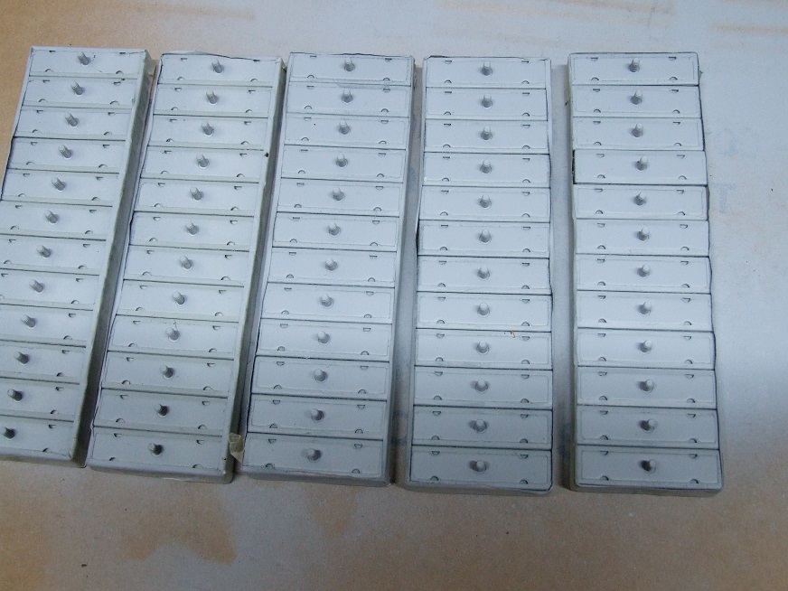

Try 10 litres of white vinegar, 6 rotary wire brushes, 6 hand wire brushes and 3 cans of etch for the track links although in my defence, I did spray in batches of 10 and it sure is difficult to reach every nook and cranny!John Clarke wrote: ↑Mon Nov 04, 2019 6:23 pmThis model is going to cost fortune
