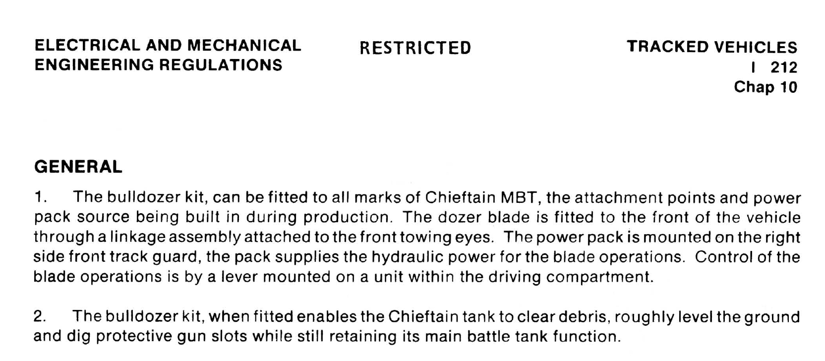

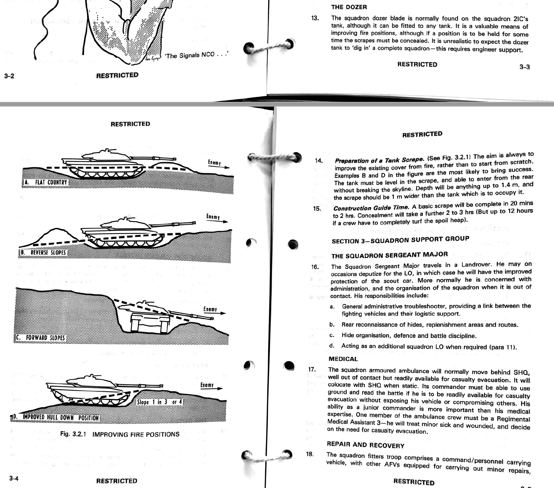

I stand by to be corrected by those who know better but I understood the tanks got the dozer blade attachment for obstacle clearance. Makes sense for one of the SHQ tanks to have it rather than one of the troop tanks out in front that could have got knocked out.
Obstacles could be ground laid mines or booby trapped obstacles so not surprising you would not want to carry the dozer blade.
The Chieftain ARVs and ARRVs had the dozer blade.
Primary purpose, ground anchor during recovery taskings.
Secondary purpose, obstacle clearance.
A good recovery mechanic in the drivers seat could also use it to excavate firing positions for the tanks or defensive positions for the other vehicles and flatten areas for volley-ball courts.
During my time attached to the QRIH, if they needed one of the ARRVs because of the dozer blade but it was not a recovery tasking, they would come on the radio and ask for a callsign with a big spoon.

It's a wet afternoon and the rugby bombed, so a warm fire, glass of wine and a thumping good read - not. Army Electrical and Mechanical Engineerings Regulations EMERs for Chieftain and Royal Armoured Corps Training Volume 1 - Tactics, Pt 1, The Armoured Regiment could never win the Booker but unlike any Booker winner, they do tell you what the dozer was officially supposed to do:
Mine clearance was better left to the Sappers, as was serious preparation of defensive positions but in extremis the dozer could do a bit to help. The real problem is that no self-respecting tank commander wanted to risk the health of his power pack and transmission with pushing hods of earth around and anyway, the squadron 2IC was far too busy to be distracted by such stuff. The only time I ever used it was to push a hole in a bund to clear a route for the squadron, when the Sappers were held up elsewhere. I was given a bollocking by the Brigade Commander for doing the Sappers' job for them. He would have made a great shop steward.

Many thanks Mark and Stephen for you contributions.
It certainly seems as if the drawing has been amended and more than likely, due to the dozer mod. Wrt the attachment plate as I'll now refer to it as, I spoke to my contact at CMSM who drove for 2 RTR and his belief was that it was for the dozer also. He believes it was fitted to all his tanks and from the Tankograd book where i can see, it is fitted to most of those also. It would be logical then that if any Chieftain could be fitted with a blade then this attachment plate would be fitted to most if not all of the active fleet whether they were normally fitted with a blade or not.
