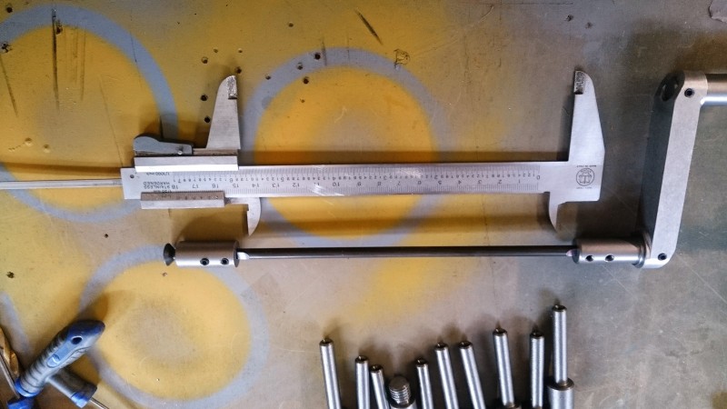

A question for Armortek, do we need to grind a flat on the fixed end for the angle setting grub screw to sit in or will it just need nipping up tight as is?

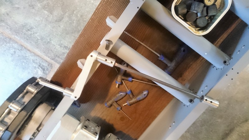

I was a bit worried about this measurement between the torsion bar bearings as theres nothing in the Bible about it. Once you you have tapped the bearings on and locktighted the grubs and slid it in the torque tube you are stuffed.......
So all I did was assemble the torsion bar, just nipped the grubs and slid it all in and as the m6 counter sink pulled it all together the grubs held it at the correct distance......
Then just measured that distance, factor in a little clearance and set all the rest the same. Maybe a bit fussy, and no doubt the big m6 would have pulled it all in even with the locktight set but I want it just right

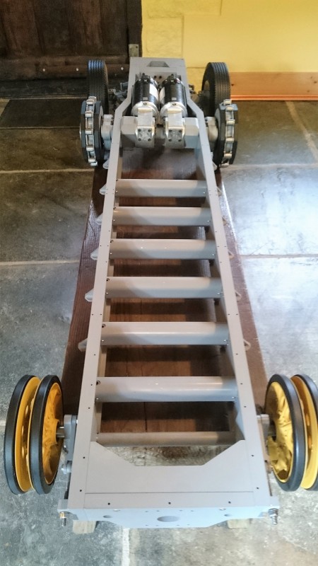

I have assembled the front end with all the expected fetling of the bushes.
It's all very nicely thought out ( I keep saying that)
Chunky brute
Chunky brute

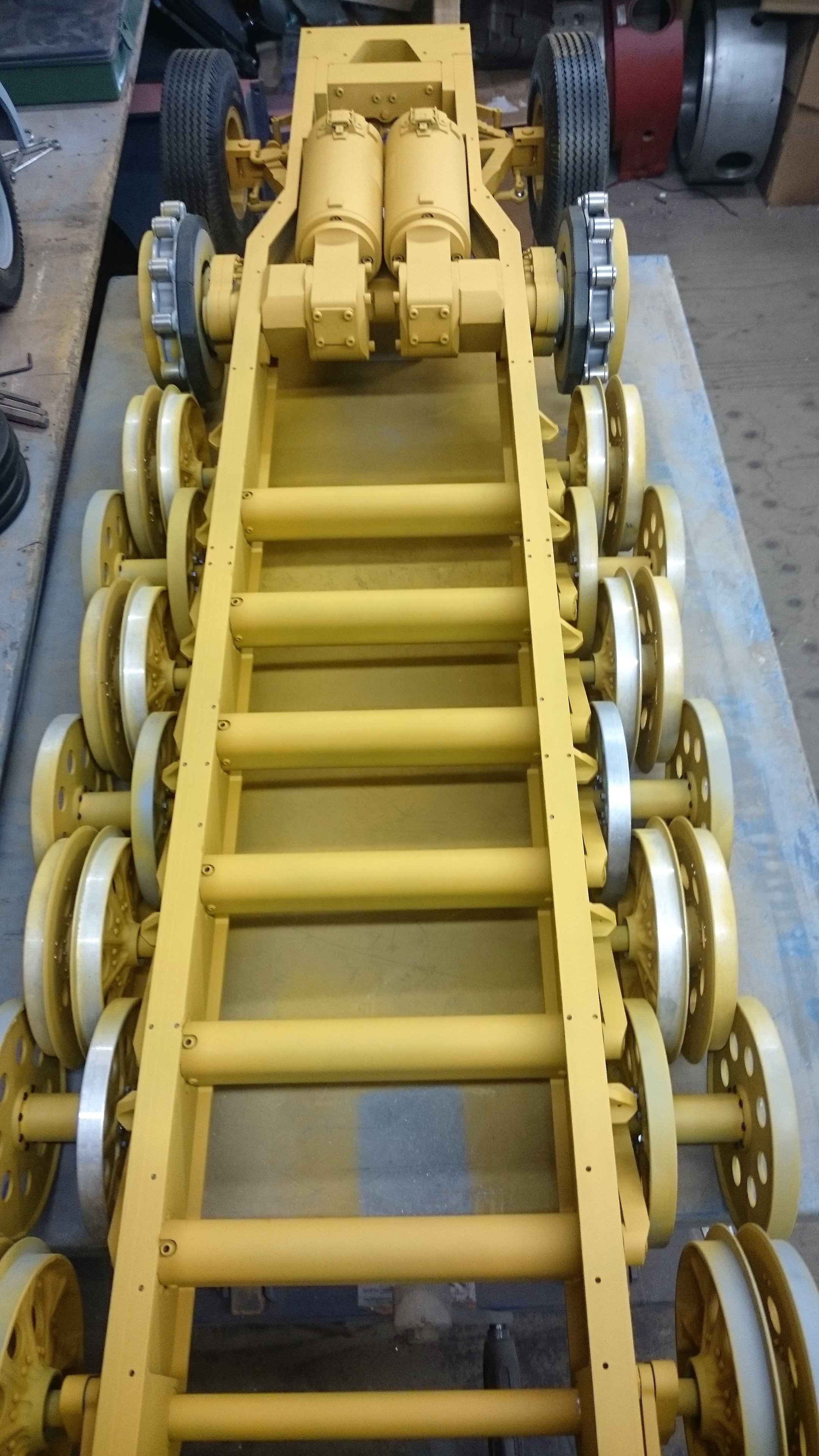

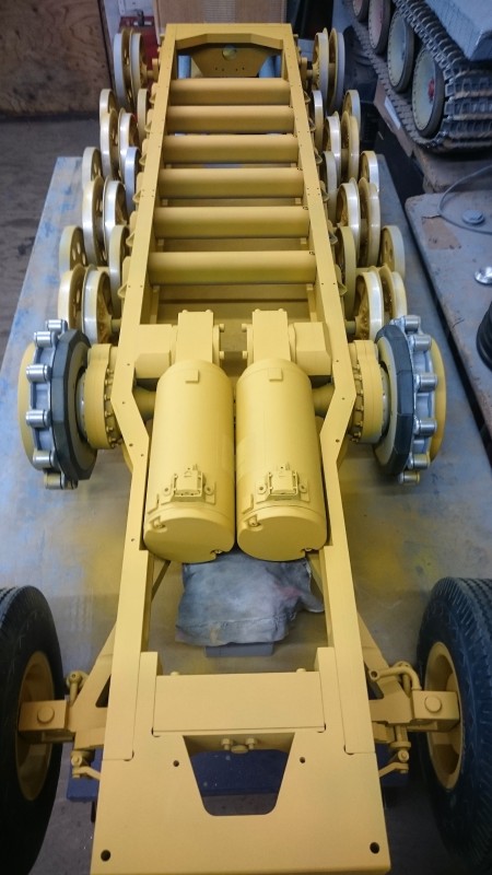

Finished the chassis!
Re: Phils Famo build
All the wheels have rivets and are primed, the axles and torsion bars are complete and etched primed, I shall install this lot tomorrow.
Every thing cleaned with meths
Etch primed
Etch primed
A Tip, warm everything to be painted just like it's summer time
Locktight all the grubs and threads
The assemblies marked with white are for the left side
An example of 4mm head  and standard m3 head

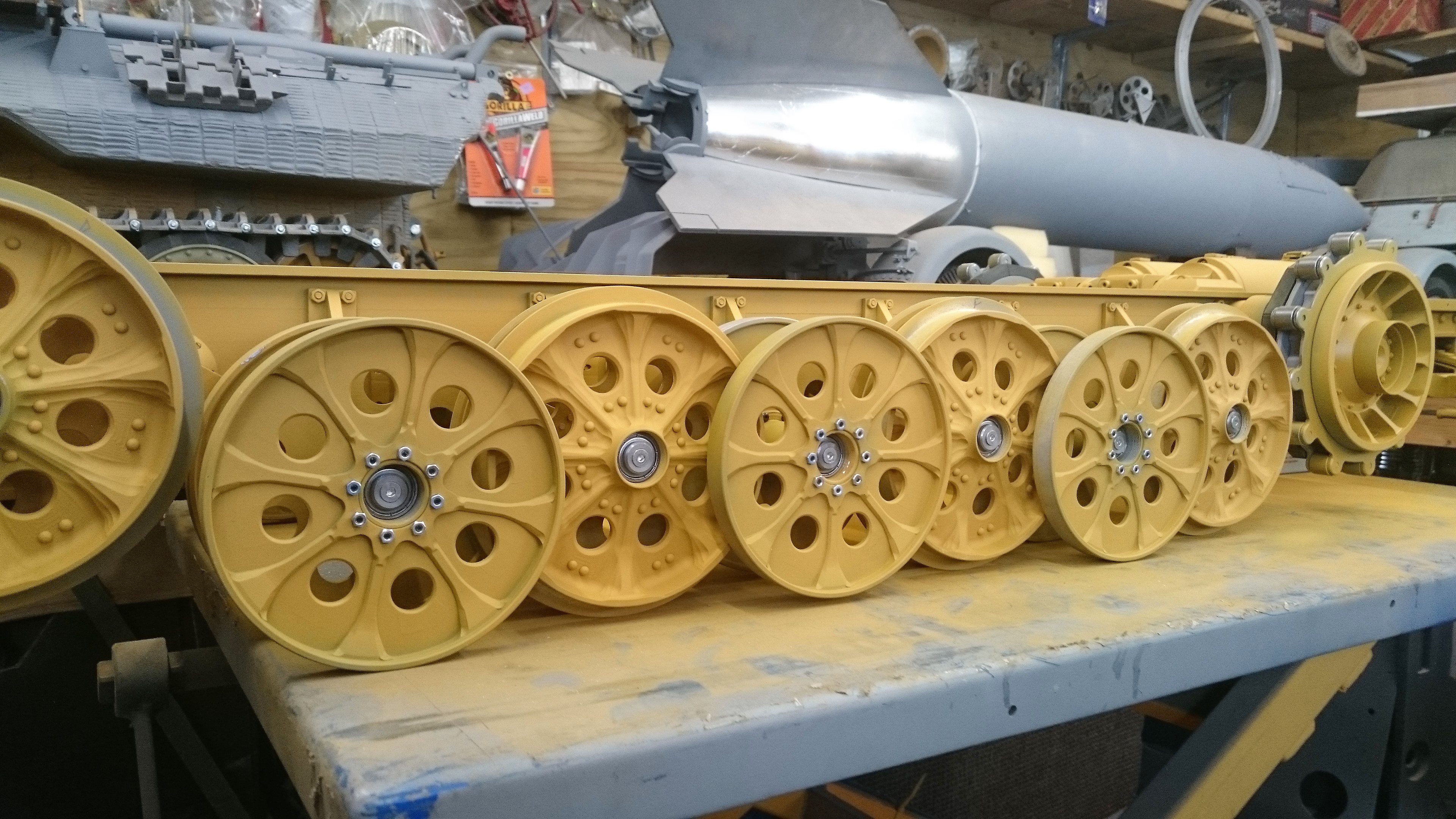

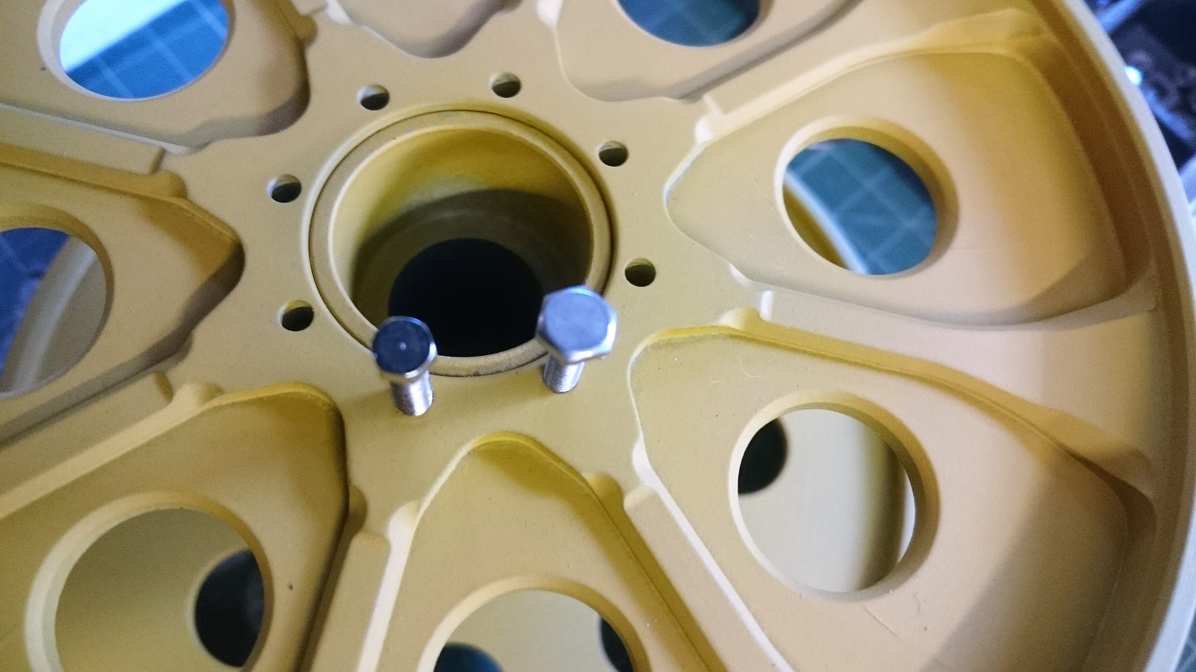

As with all German vehicles with overlapping road wheels it's a bugger to work on, once you have worked out a system/technique of wiggling all the wheel assemblies onto the axles at the same time then your away! If you need to remove any even one then it's not going to be easy but I have a plan.
I am considering removing the 2.5mm buttons on the tandem wheel assemblies and drilling and tapping with m3 (clearance drilled for the outer wheel) I will then use m3 small head bolts fitted from the front so it stays in scale, you can then at least remove the outer wheels, and then the next layer, without the hassle of de tracking and then wiggling all the assemblies off or on at the same time. I suppose if you never intend to remove the wheels you could leave as is. You could also bond the 2.5 button from the back so you can remove just the nuts. All good fun regards Phil.

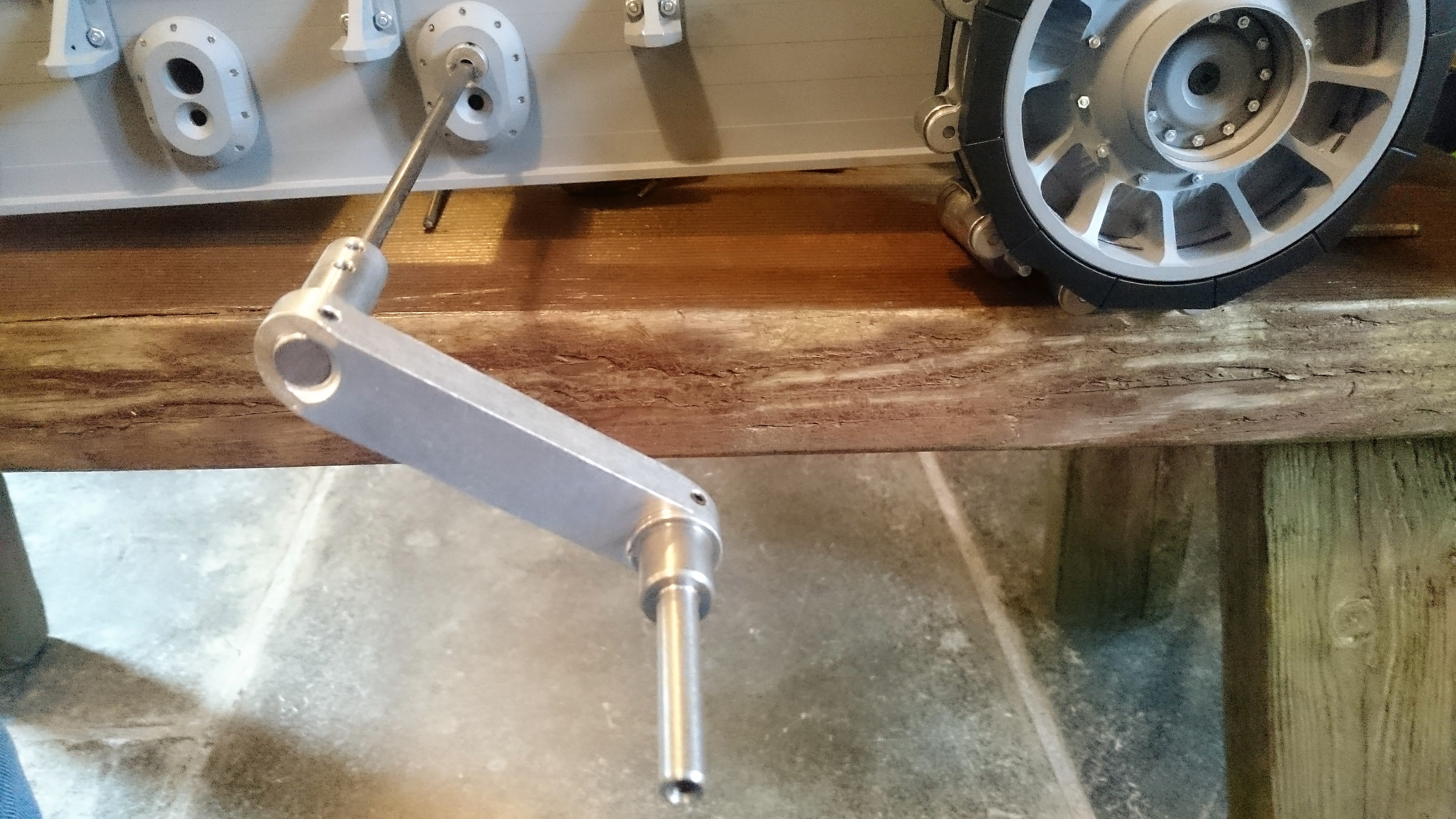

I must confess that I have put flats on the torsion bar fixed ends, over a period of time they may become loose if not done this way, this is my own mod and maybe not necessary.
Setting the angles, left and right are different i have drawn both 25 and 35 deg for reference.
It's longer than my table lift which can happily accommodate a KT
Lovely looking road wheels, they all clear each other and turn effortlessly, you may need to "chock" as it will escape off the lift if it can!
