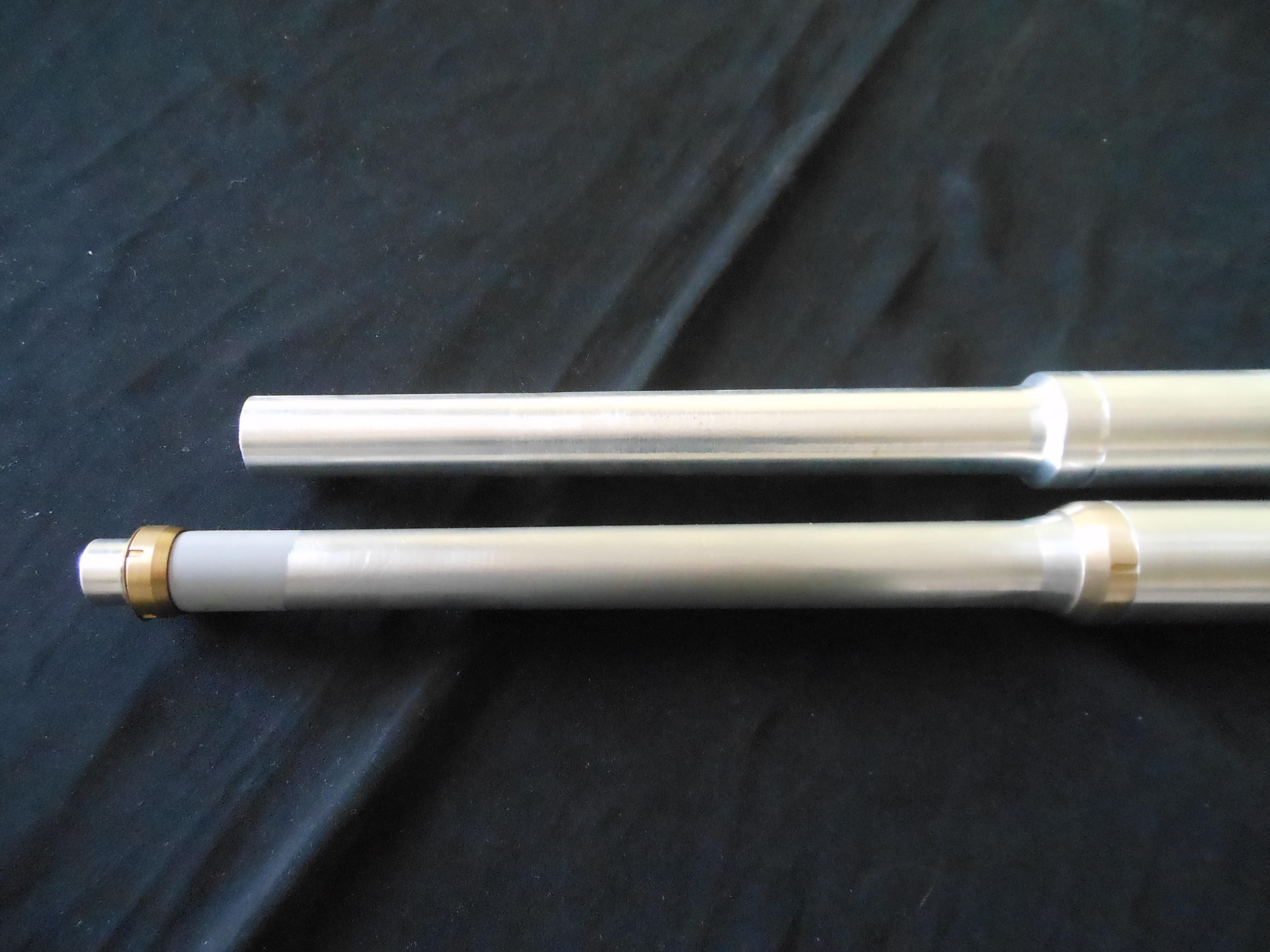

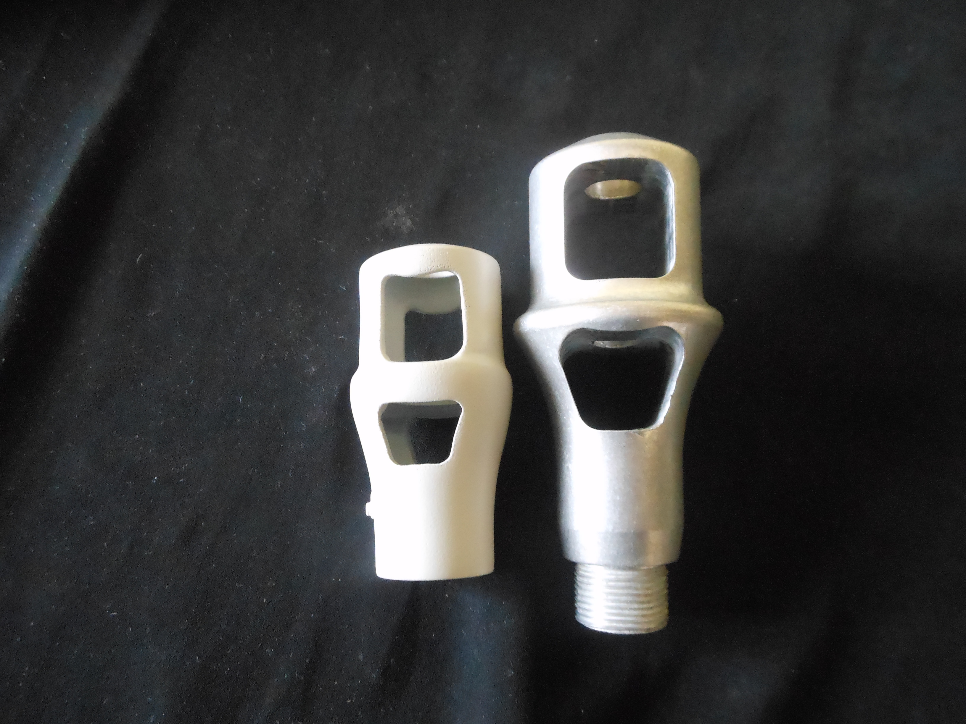

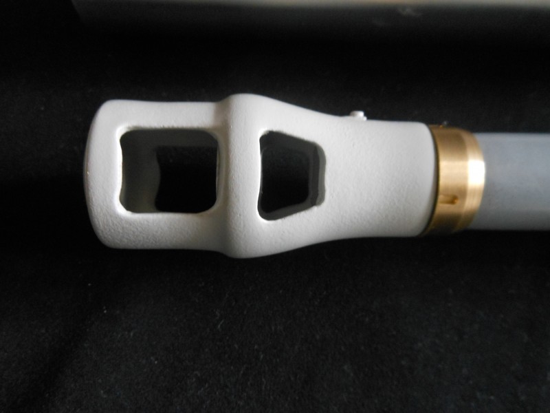

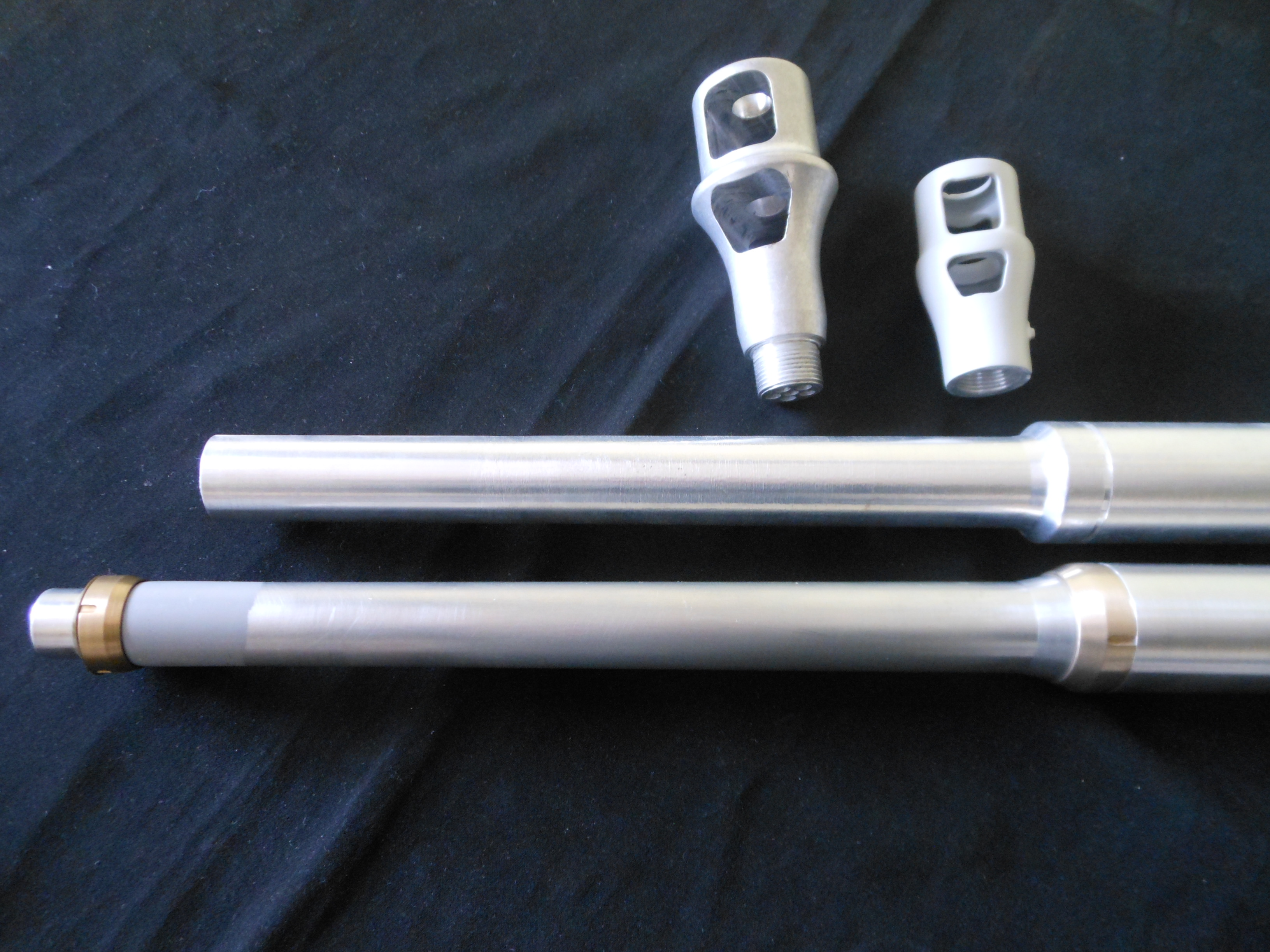

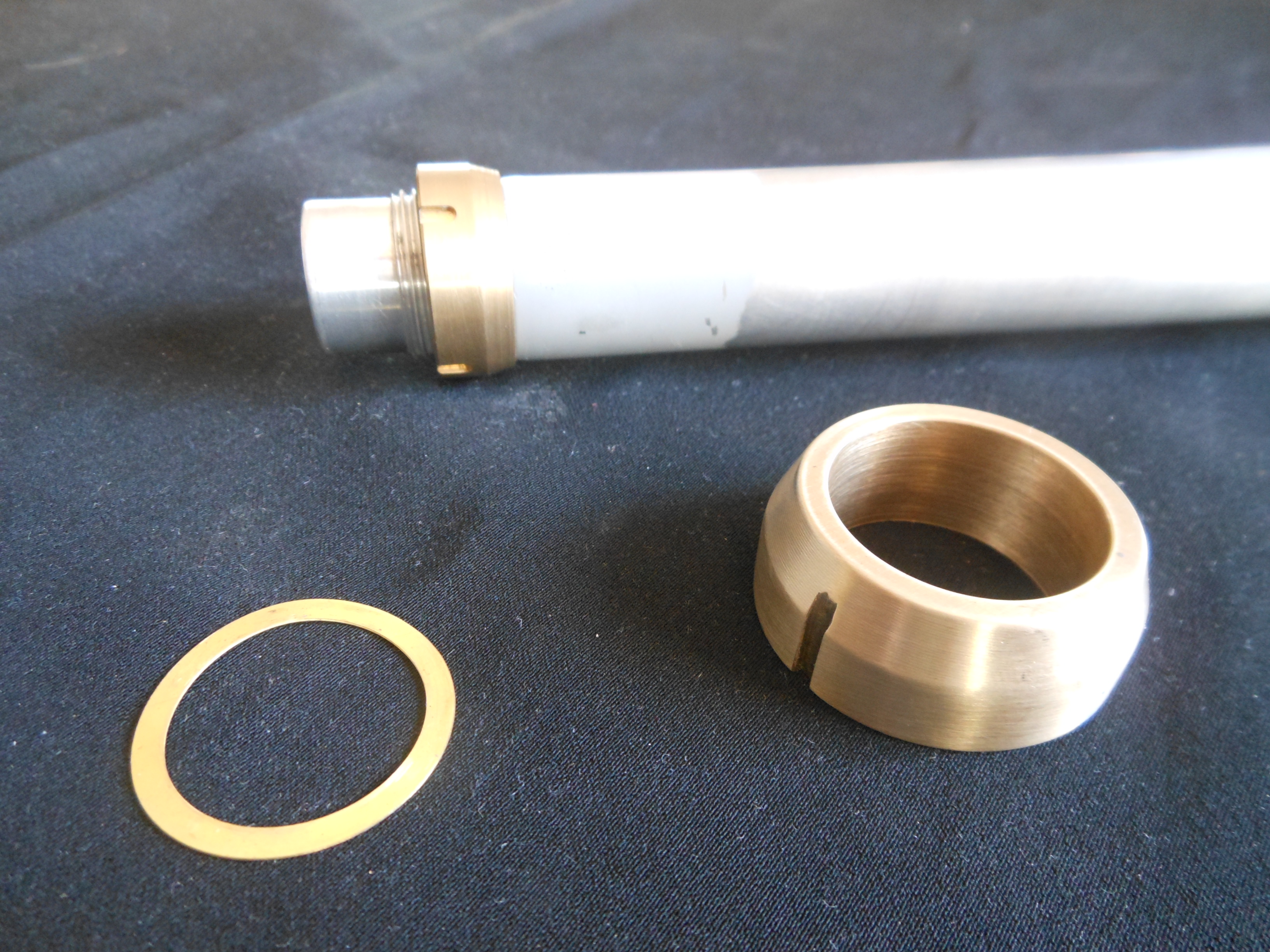

A change that I have not yet seen done by anyone.
My model (2010) has incorrect dimensions of the barrel and sleeve. I modified
the sleeve to lengthen it and bring it to the correct size. I also wanted to redo the most similar rod to the real one. I bought the FOA muzzle brake and this is the comparison with Armortek's. Neither of them corresponds to the measurements "Tiger1 info1". I think there were more types mounted on Tiger1.

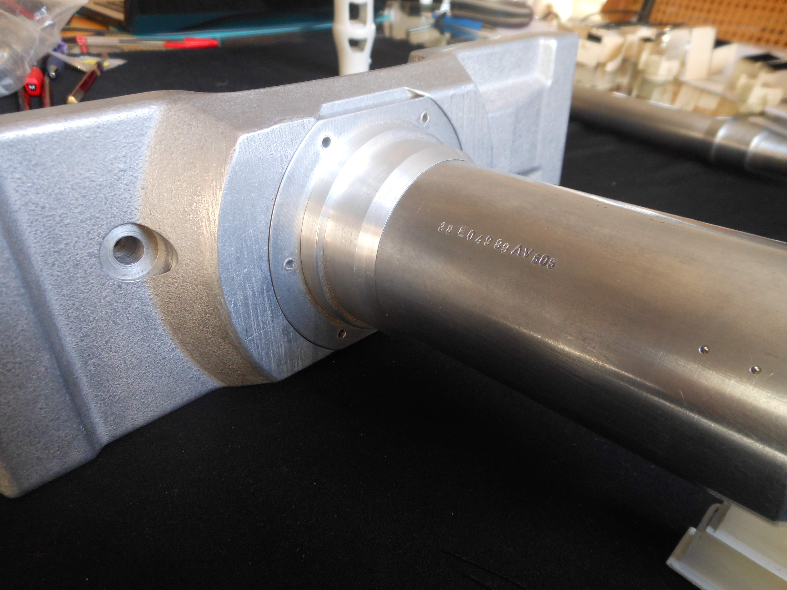

Some canes had very visible codes

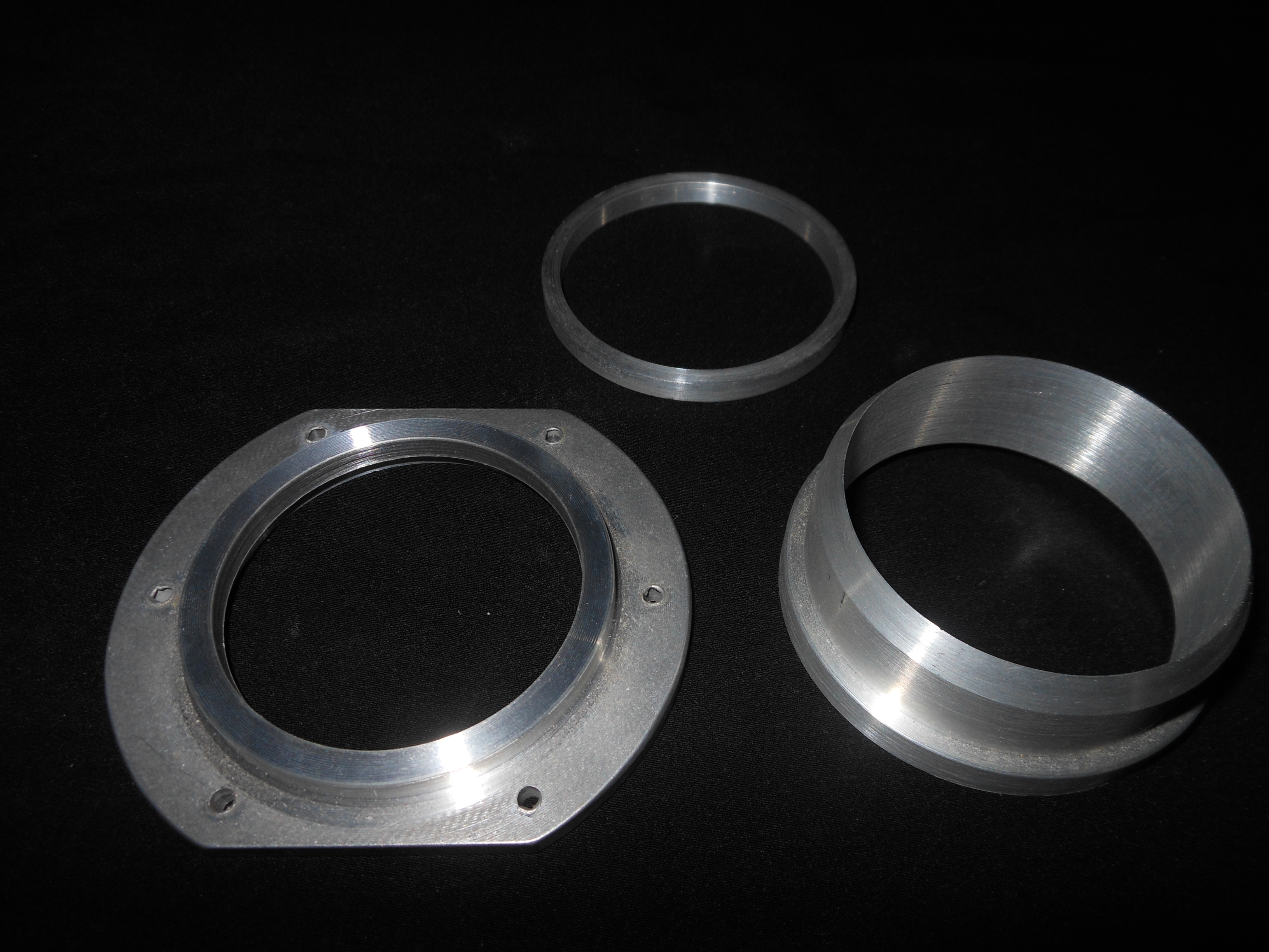

The sleeve has not been redone, only minor changes

Great work as usual Ivano. I think the dimensions of the muzzle brake as shown on tiger1.info are for those fitted on early and mid Tiger1s. The late Tiger1s had a smaller and lighter muzzle brake which was actually the same as fitted on the King Tiger. I don't have these dimensions so do not know how smaller they would have been.

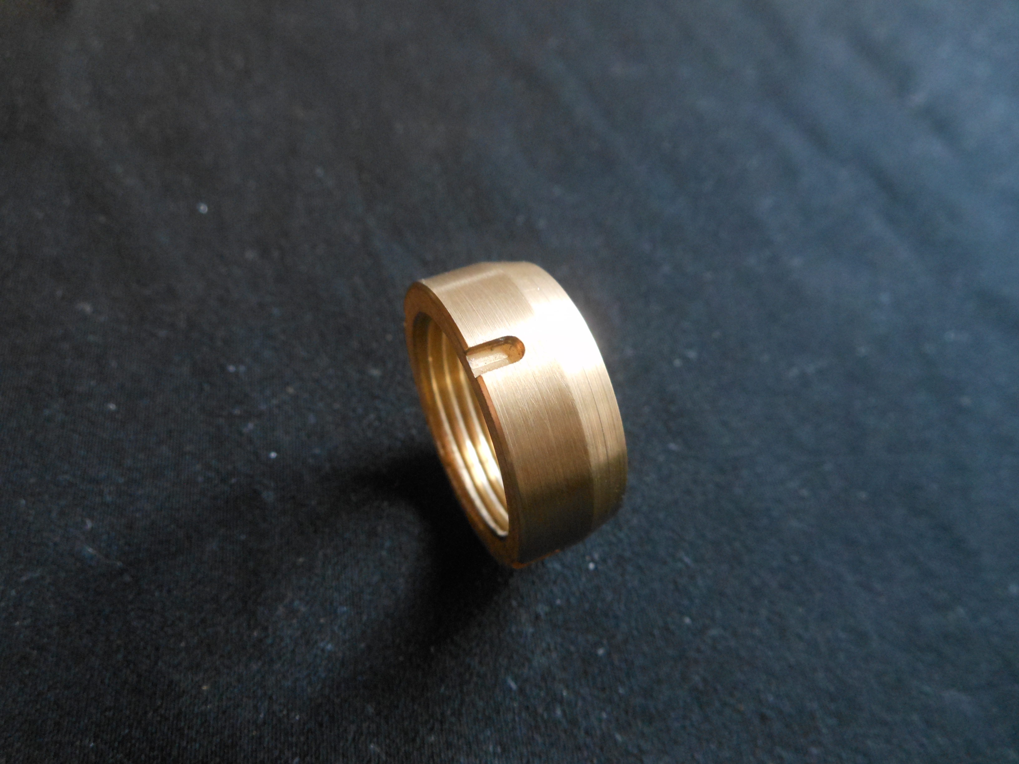

Could you tell me the width of those four grooves in the muzzle brake locking ring? I am thinking of making mine 1.5mm wide.

Hi Vince,
If you refer to these, I made them 2 mm wide and 4 mm long.

Grazzie Ivano. E quello che volevo. (Thanks Ivano. It's what I wanted)

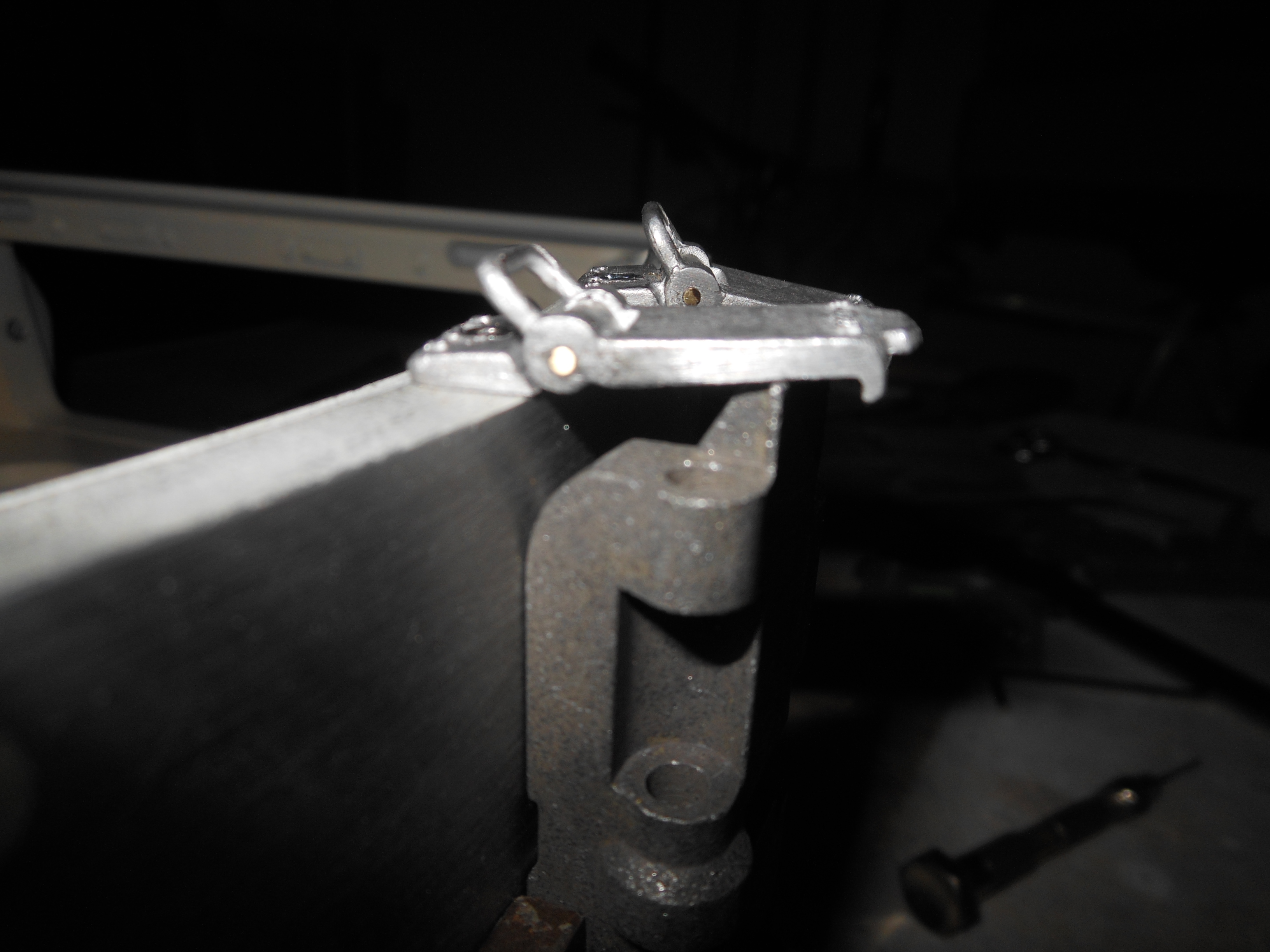

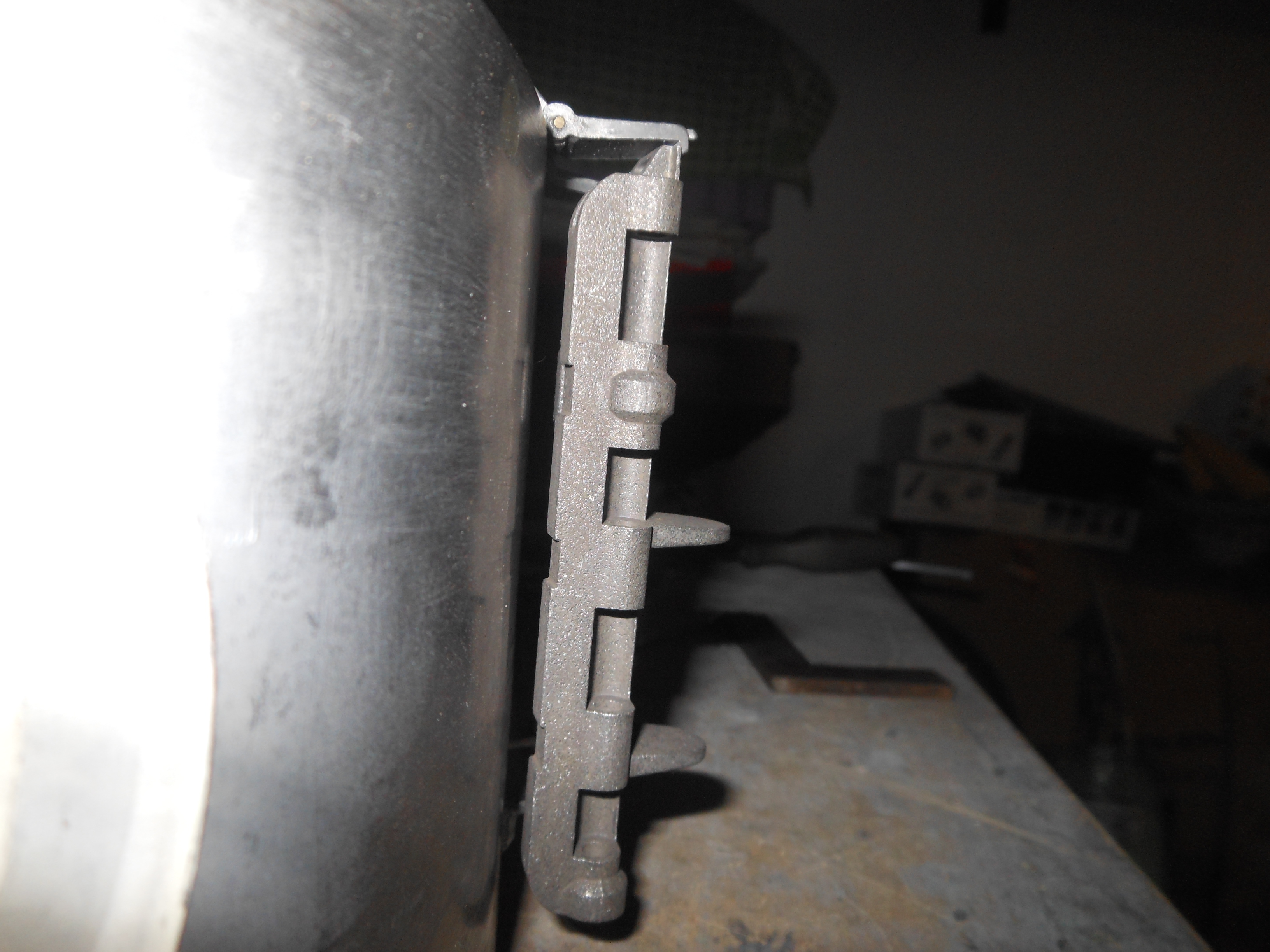

have any of you built a tiger from the old Armortek production? I have this difficulty: my kit (2010) has supports for Armorpax replacement tracks. Once assembled, they look like this. Has it happened to you too? how did you solve the problem?
Thanks Ivano
Away from the turret wall
Away from the end of the hook

Interesting question, I have the same problem!

Hi Ivano.
Will you not need that space for the zimmerit?

Hello Simon
too much space, it's more than 5 mm. the zimmerith must be much thinner, 1 / 2mm.

Had the same problem and i decided to grind down the track link hight that are facing the turret wall.
This gives a ok look and is really not visible in my setup
