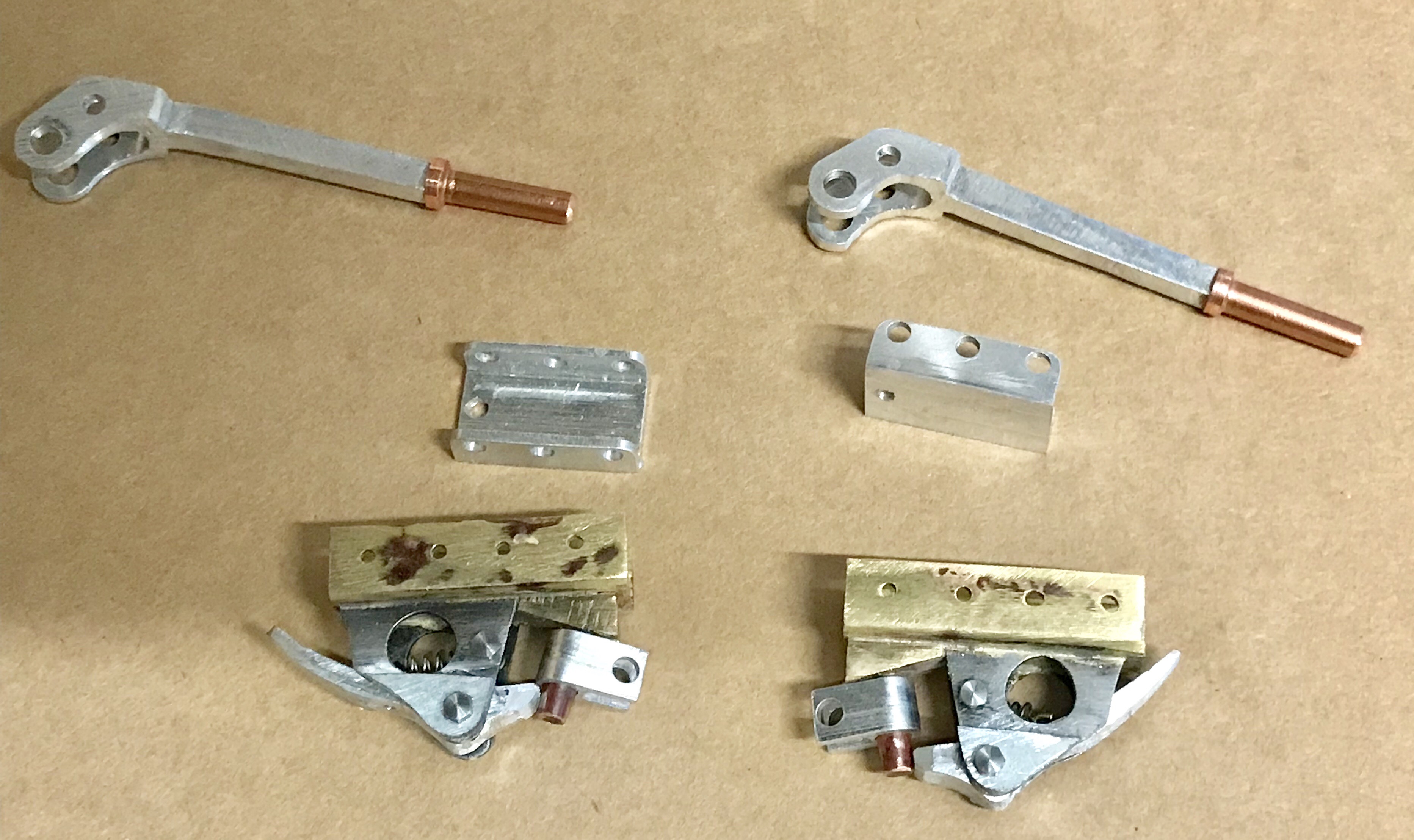

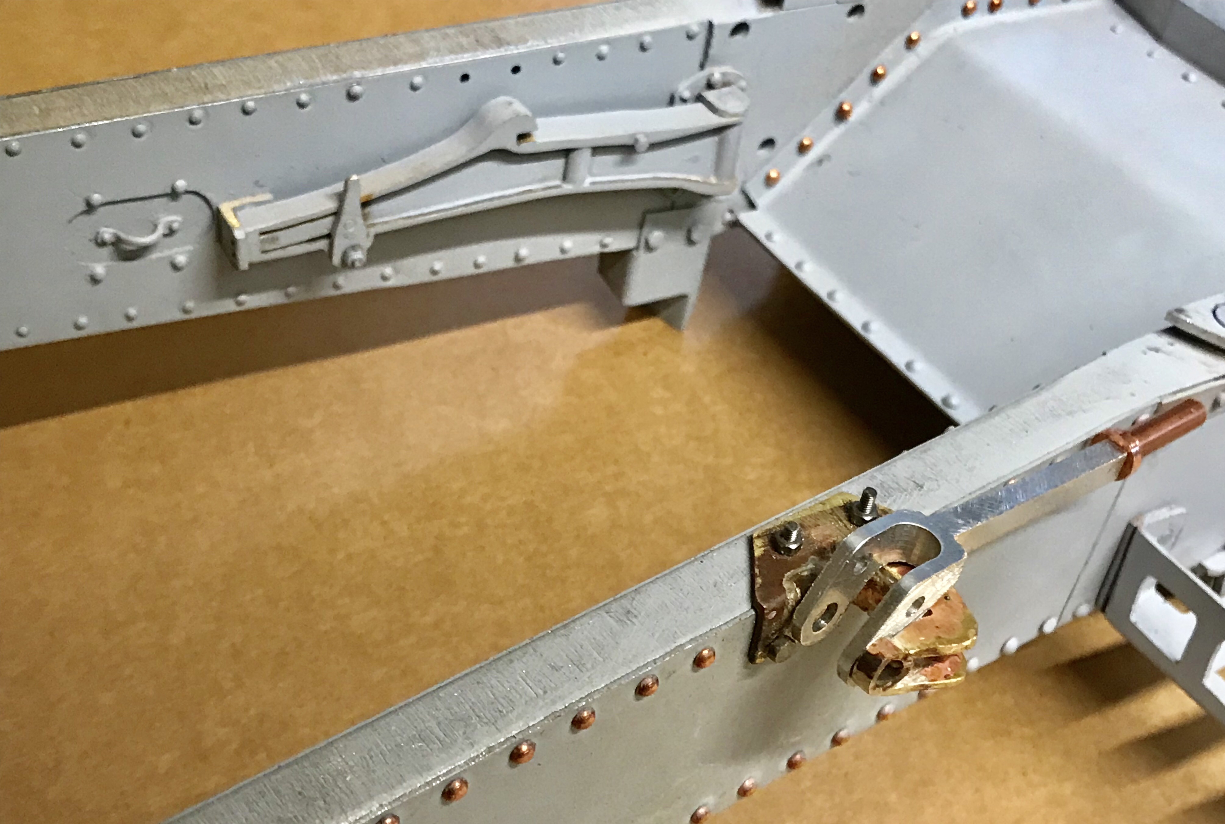

I wanted the stowage shoes to be functional, and tried to adapt the kit ones, I ended up making them from scratch, quicker in the long run they just need cleaning up and the tops trimming to size, also remade the stowage brackets and reworked the levers

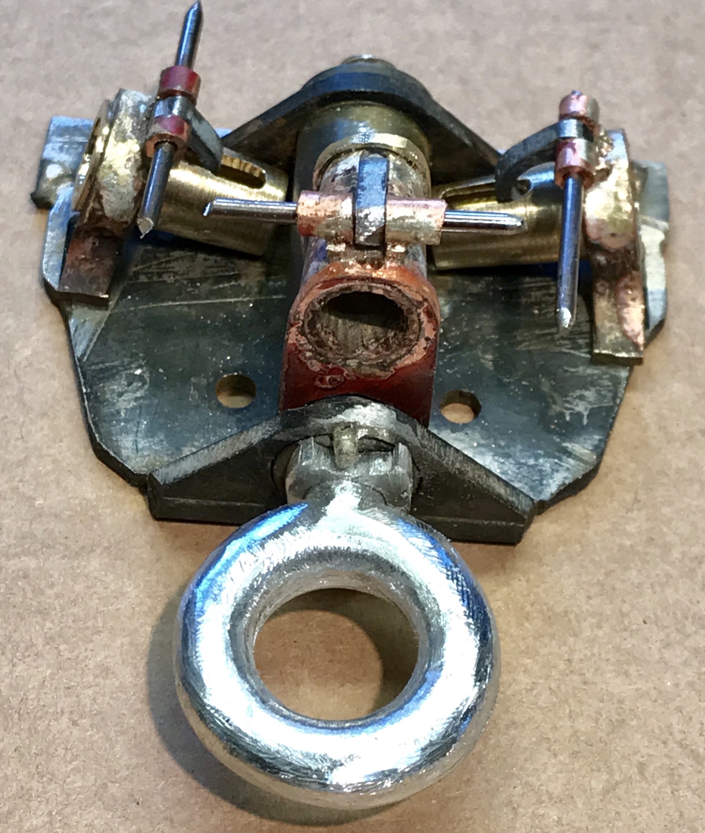

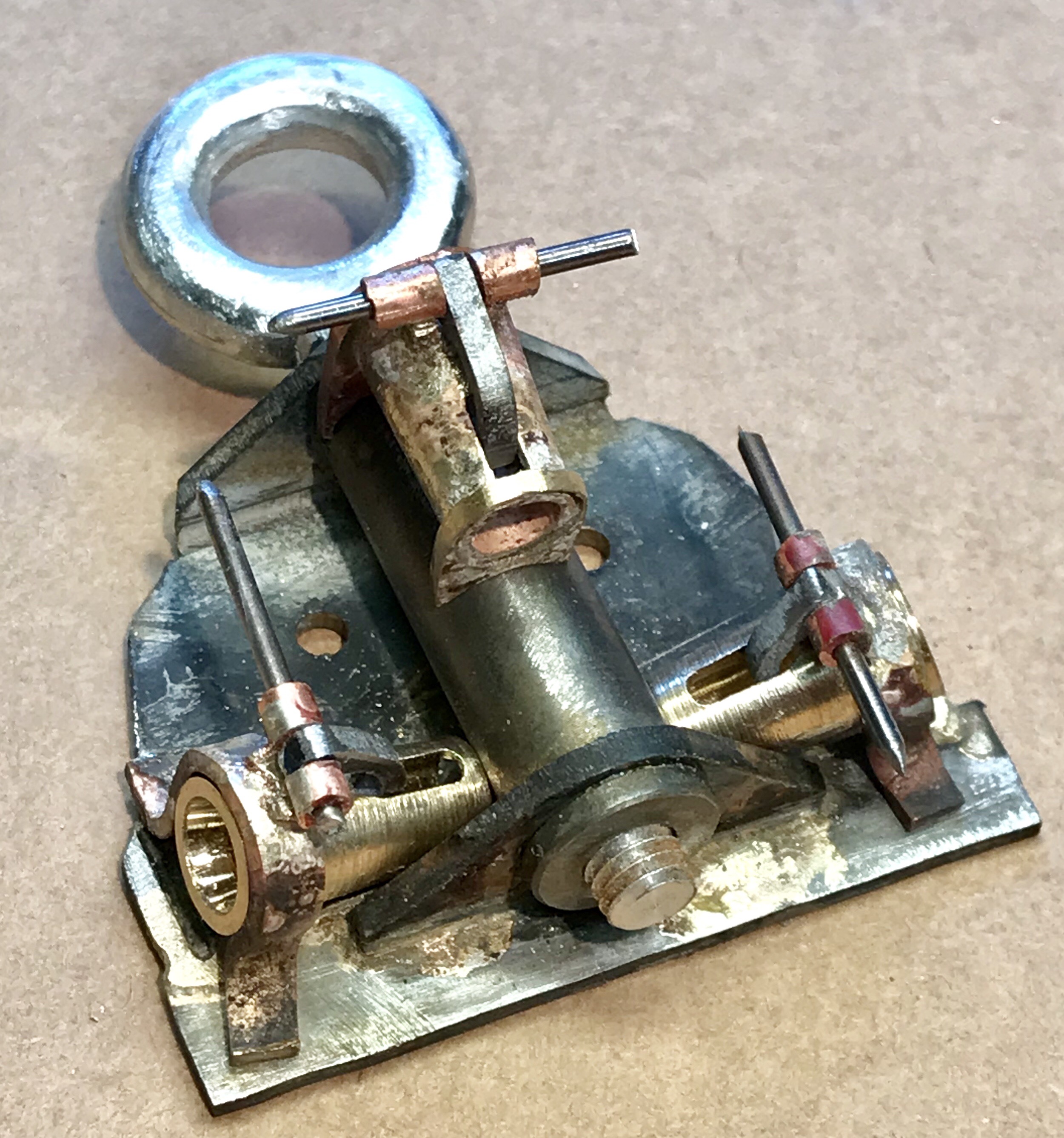

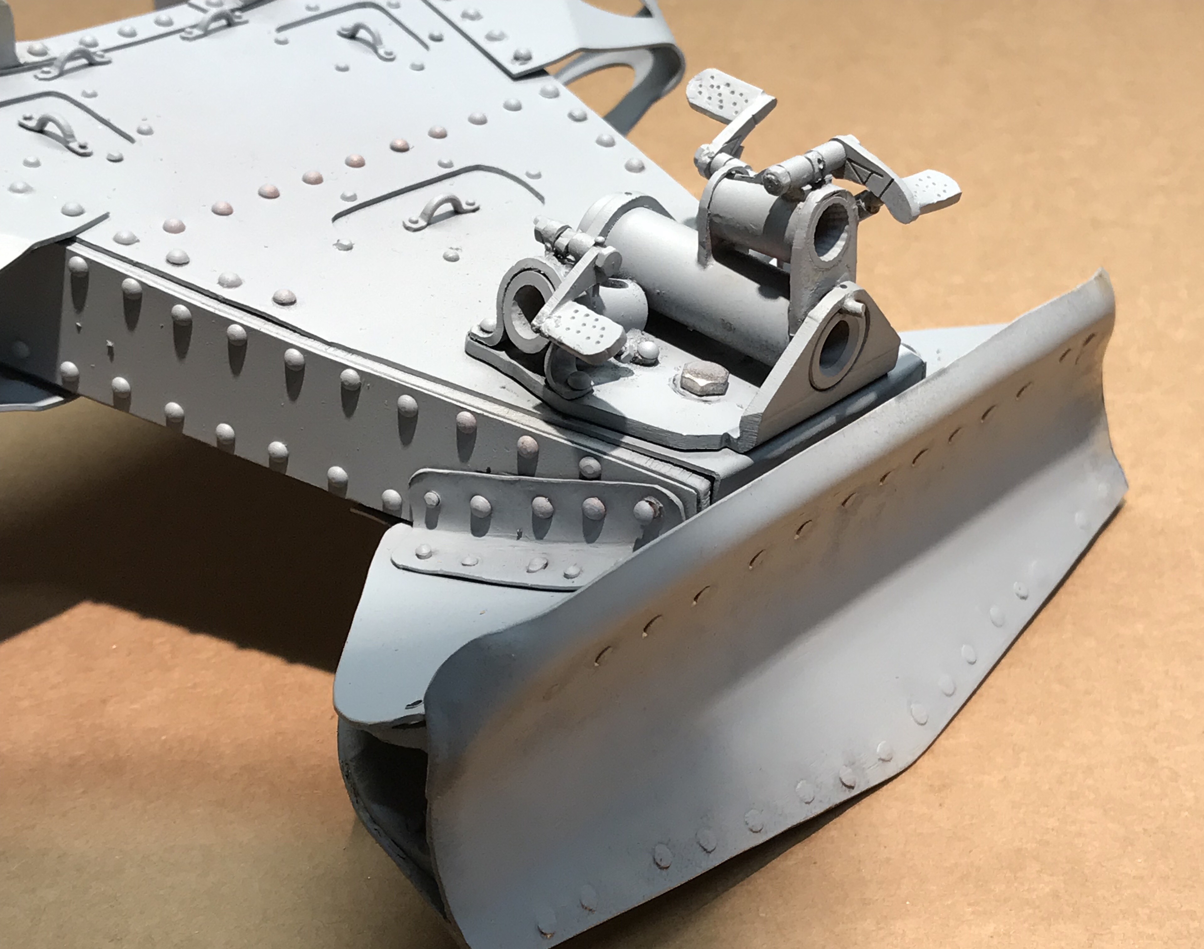

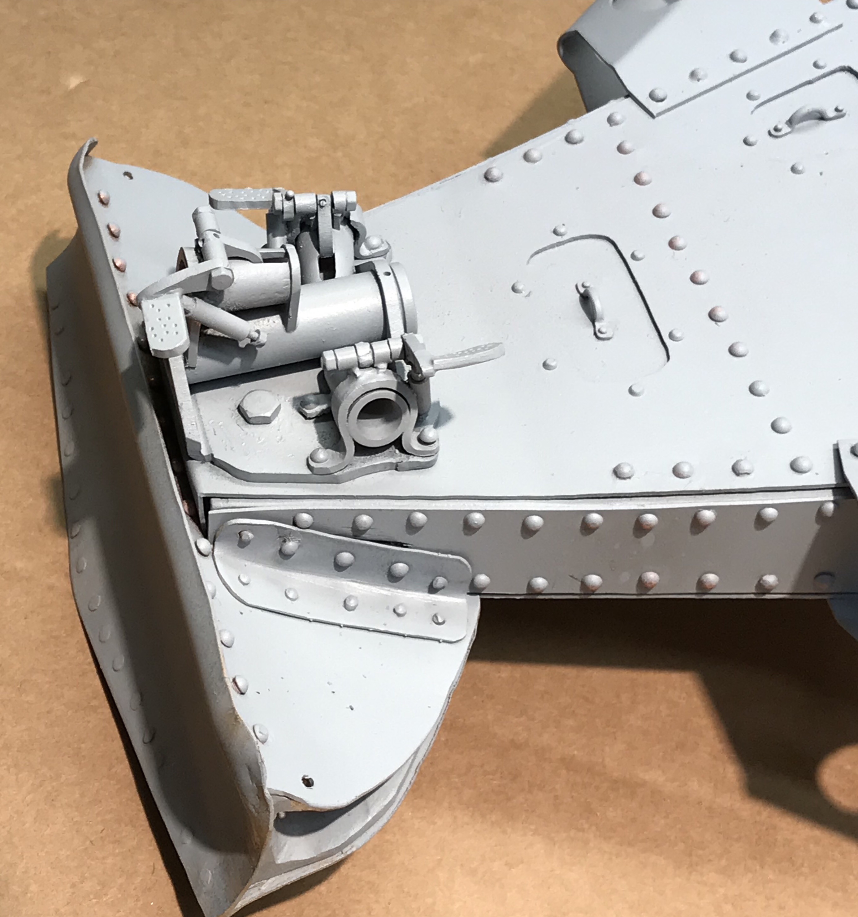

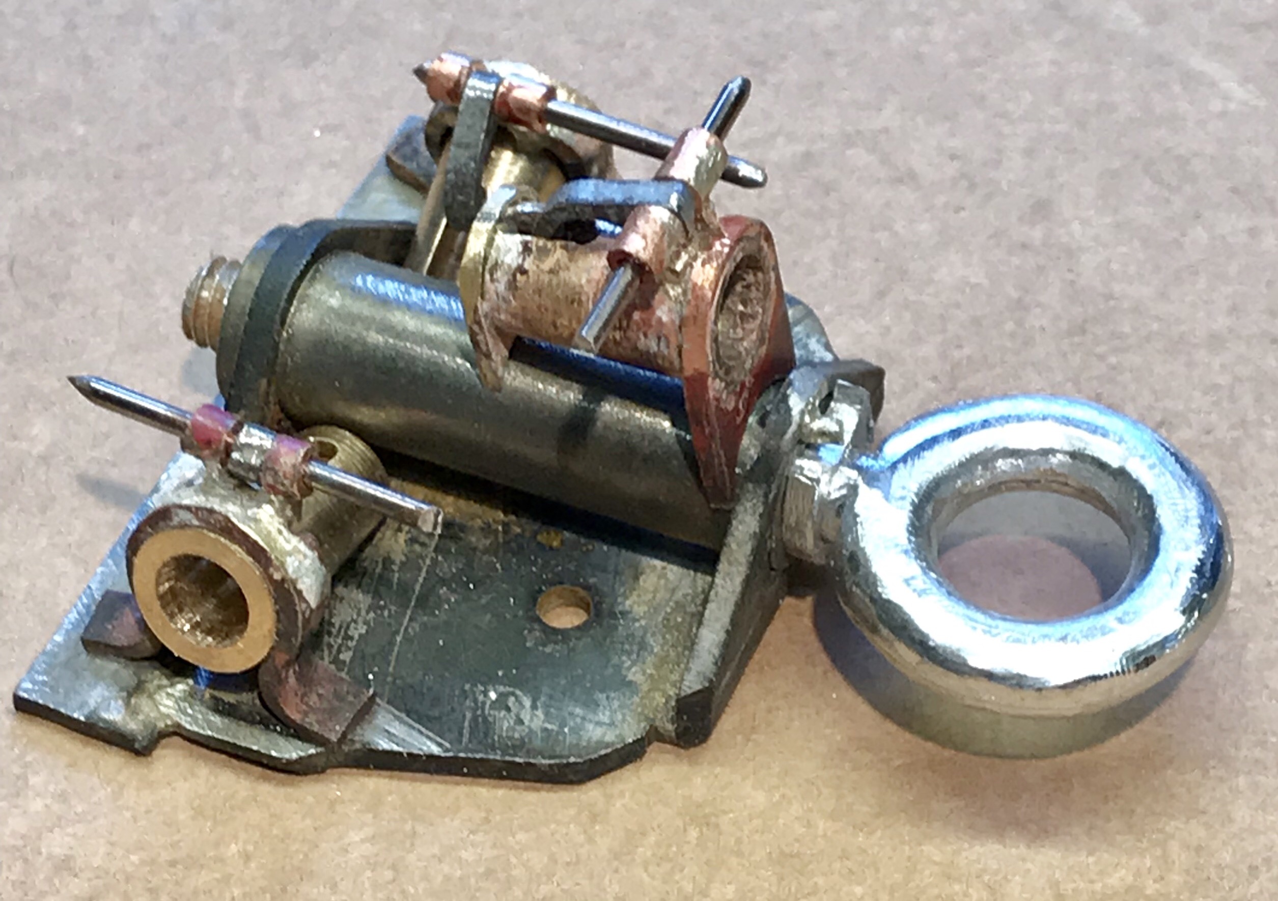

made a start on the lifting lugs for the hand spikes on the rear of the trail, I started with the base, cutting off the three brackets for the cones and adding some extra length to the rear, remade the cones in brass and made the hinged locking bars, they look a mess at this time as I have a lot more silver soldering to do, foot pedals and the spring housings to make, these keep the pedals in place, this is how far I got today

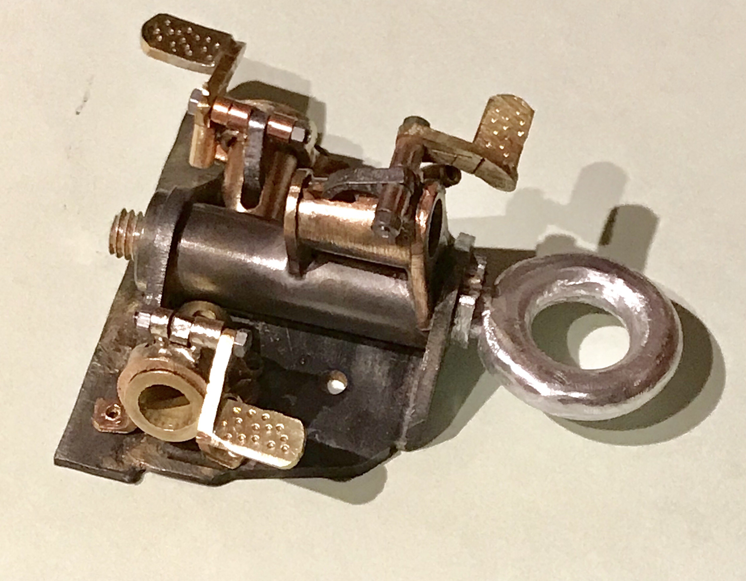

foot pedals made for the lifting lugs, just need to rivet the side lugs into place and shape the base

Awesome Jeff! Even the plungers to keep the catches locked are there (at least their housing/tubes, but I assume the spring and plunger will be in there soon)!

many thanks for the kind words lads, always helps to keep you motivated, hi Marcus yes springs and plungers in, but whether I would bother again to have them working! cross pinning 10 ba thread the result is not that strong, so this is where I finished today

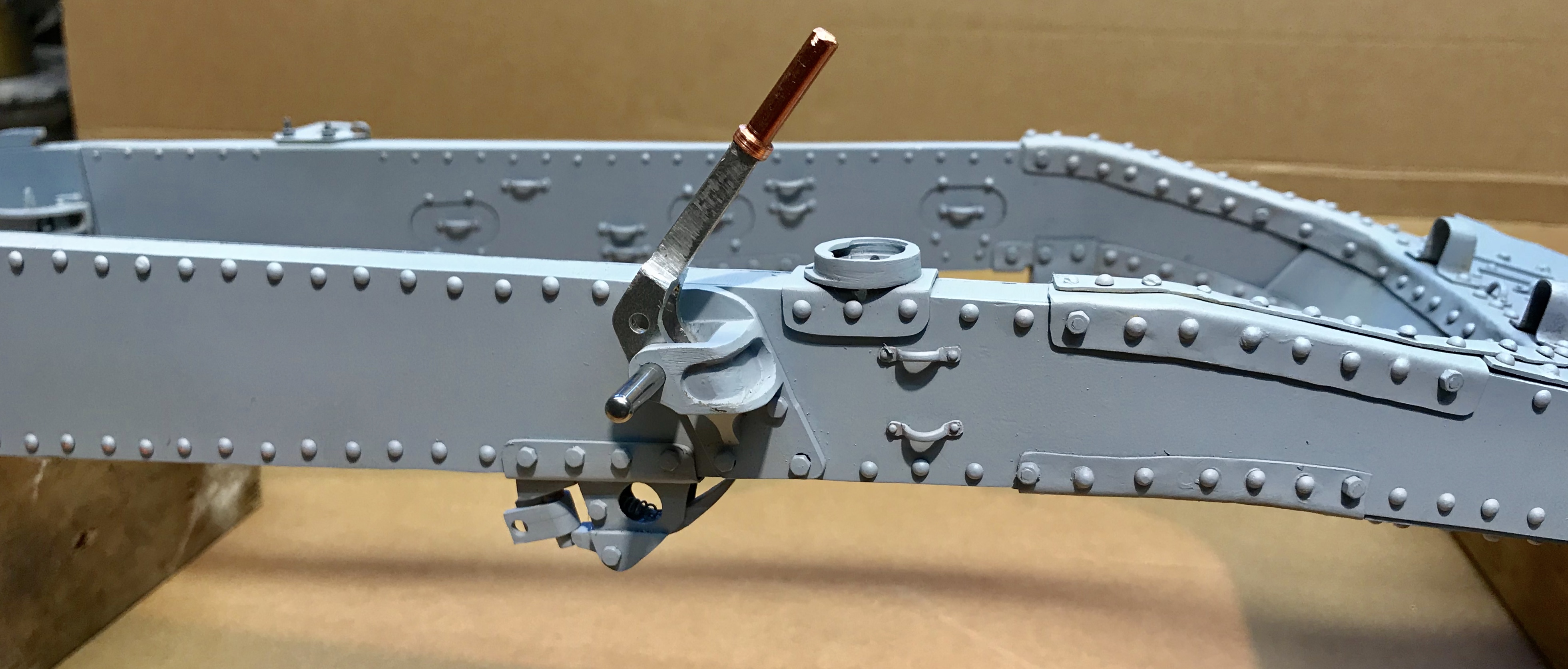

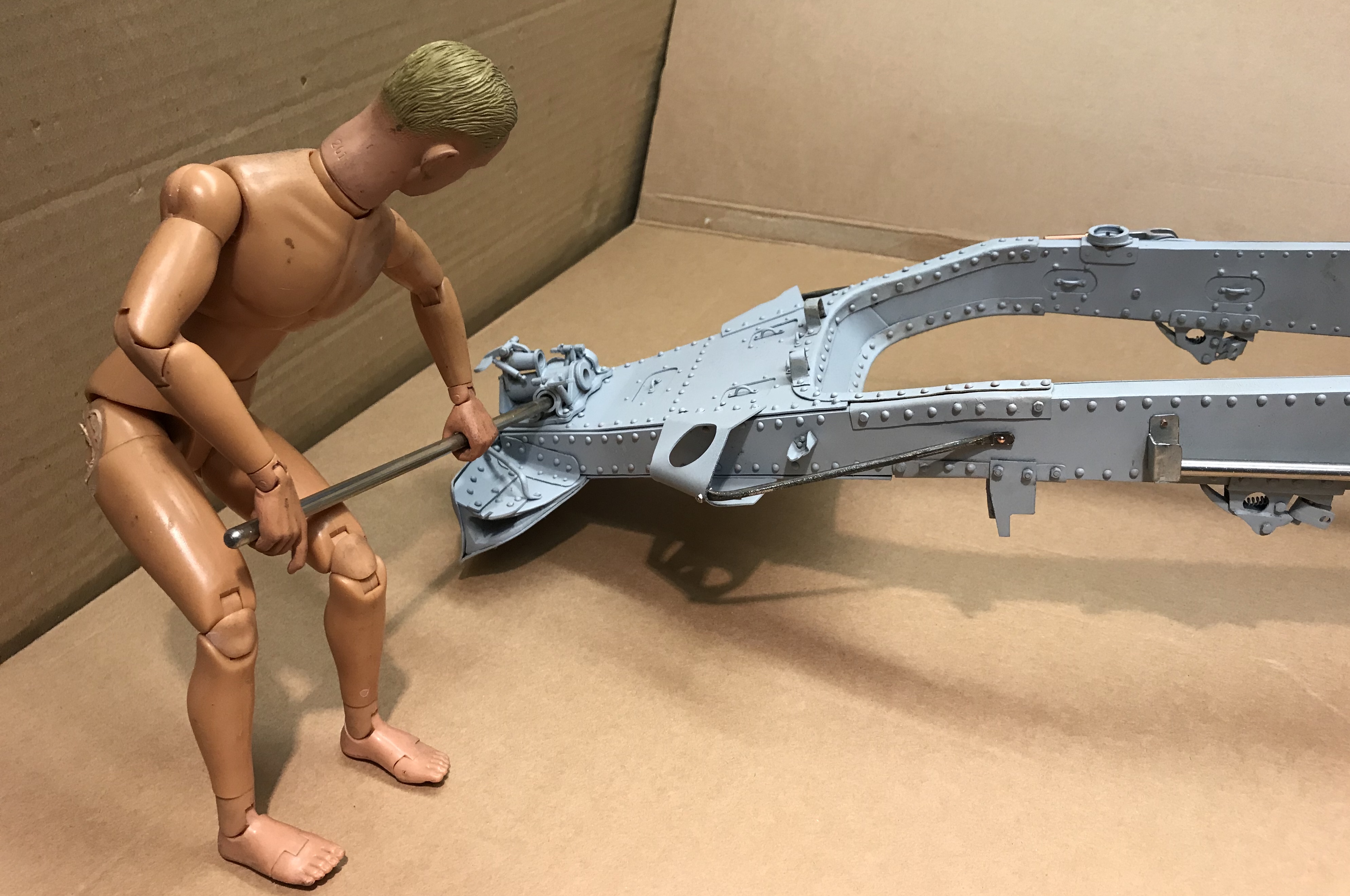

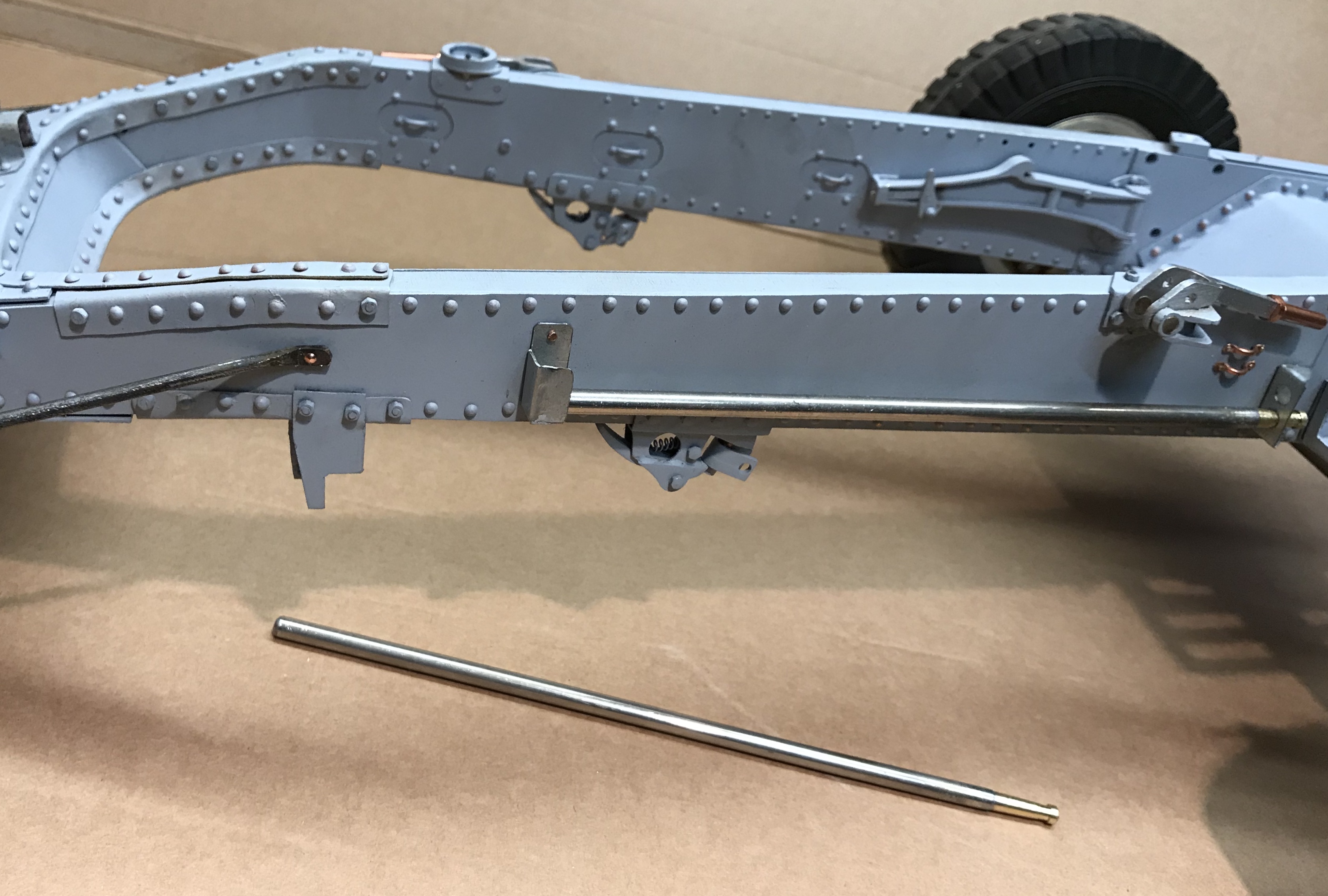

Its has been 3 weeks since I worked on the 25 pounder, (rebuilt my flight simulator) so today I made the hand spikes, steel shaft with brass tips, also the hand spike brackets and the belt loops, as well as the lifting bars to the sides of the trail and spade, I used a 12" figure to check on proportions, sorry no clothes :oops:

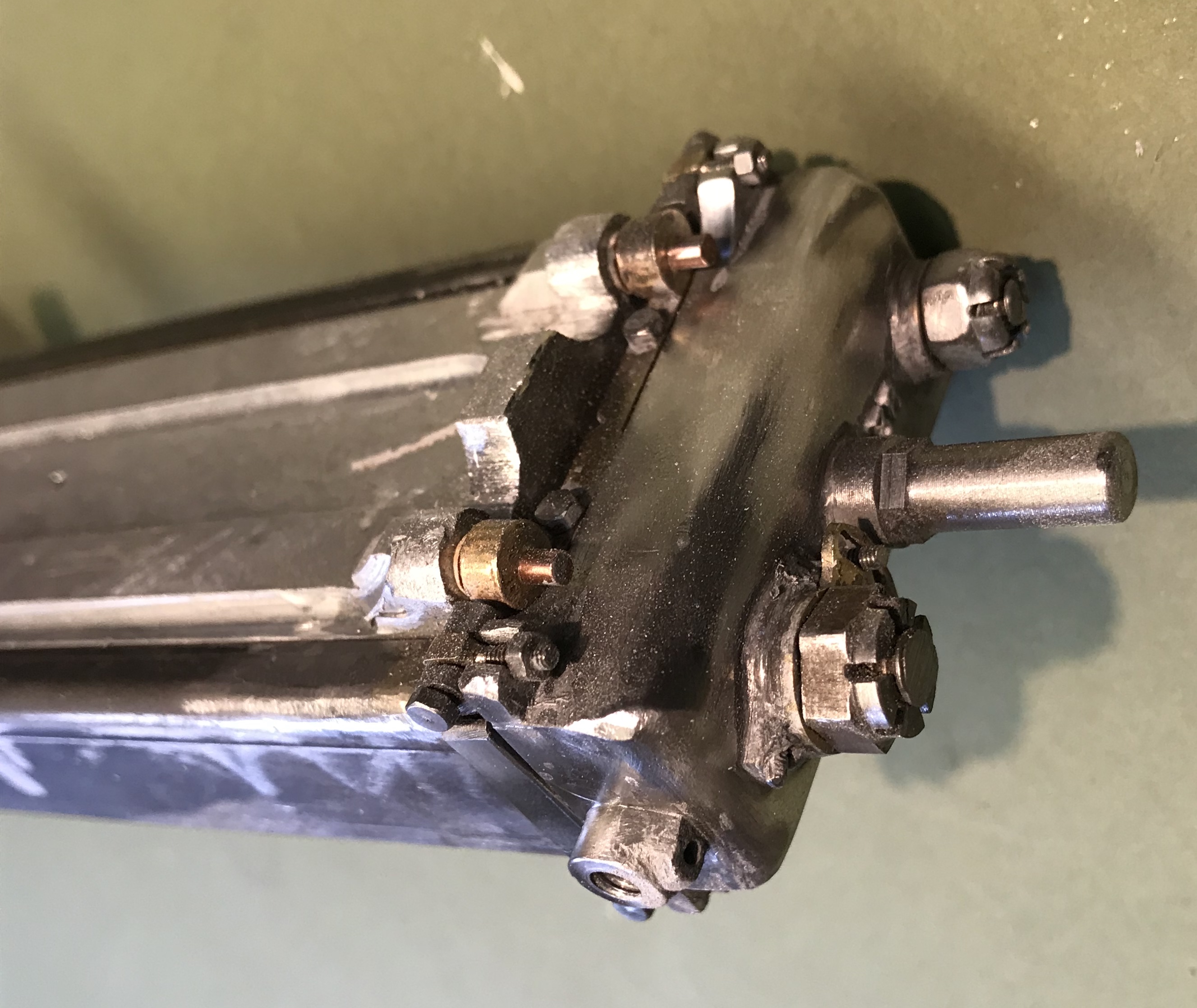

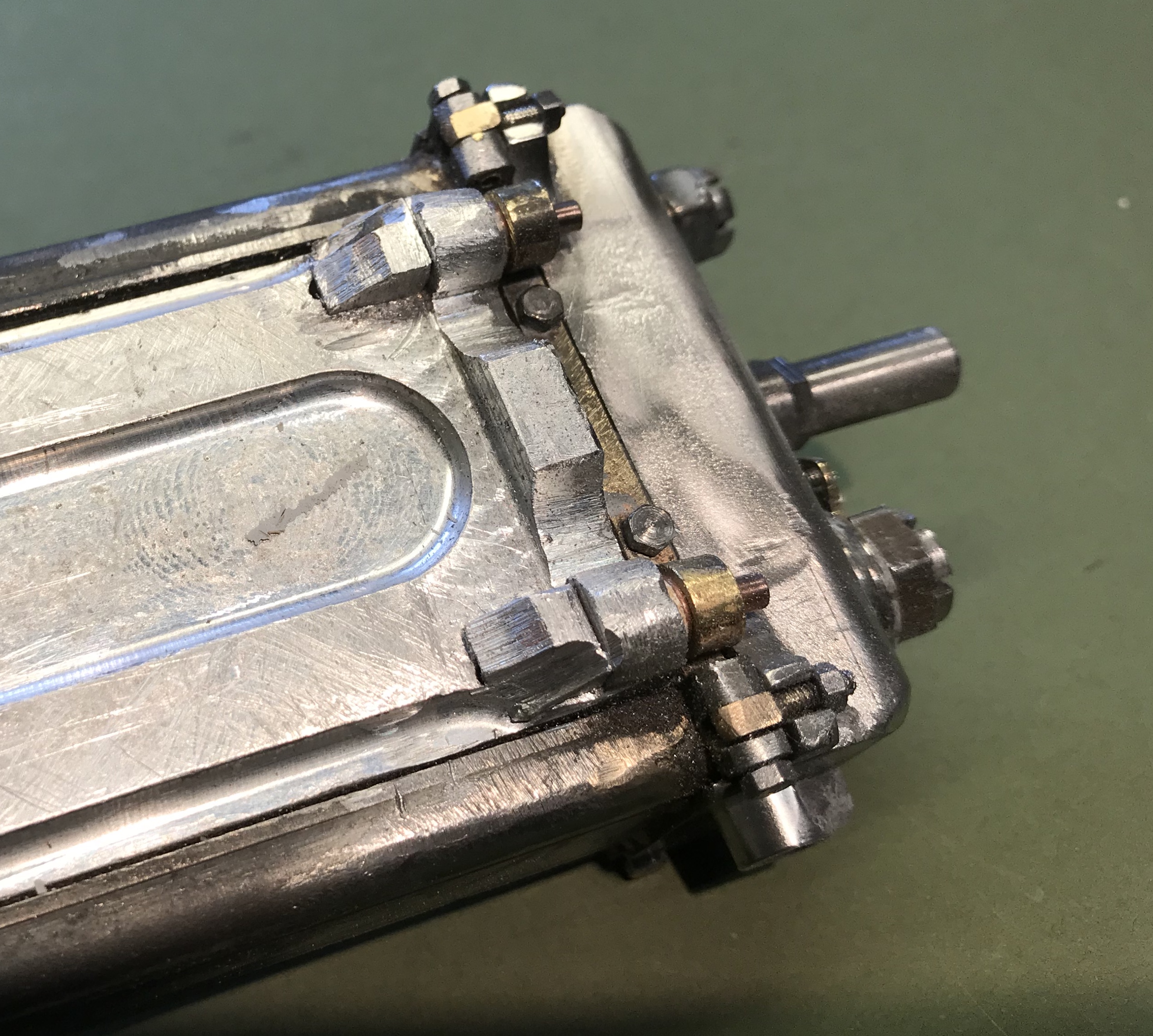

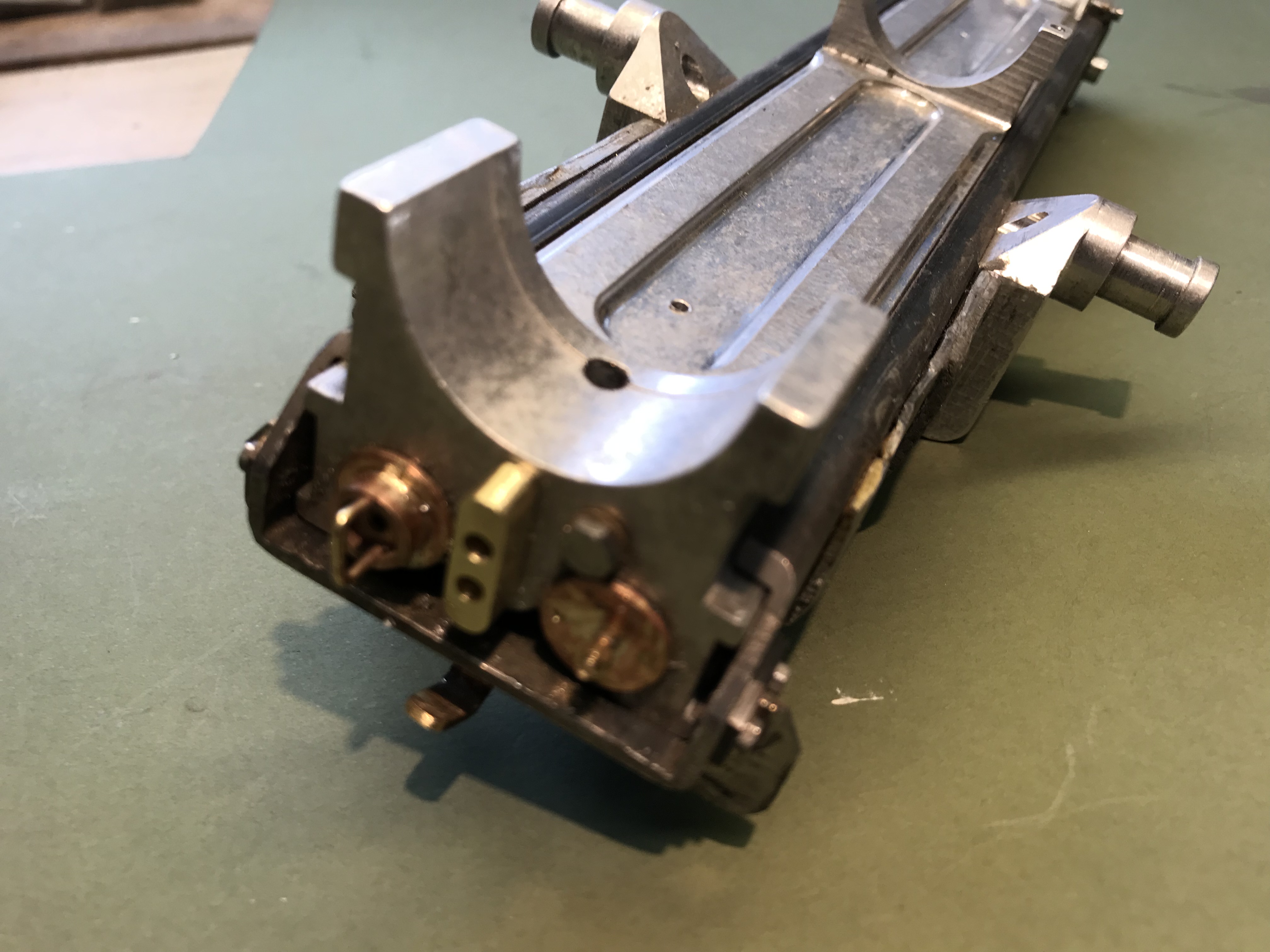

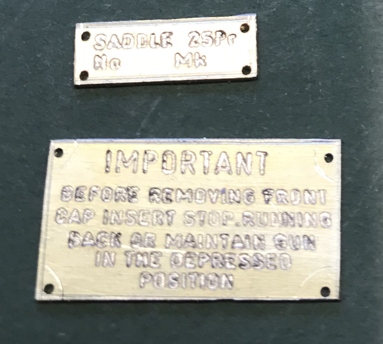

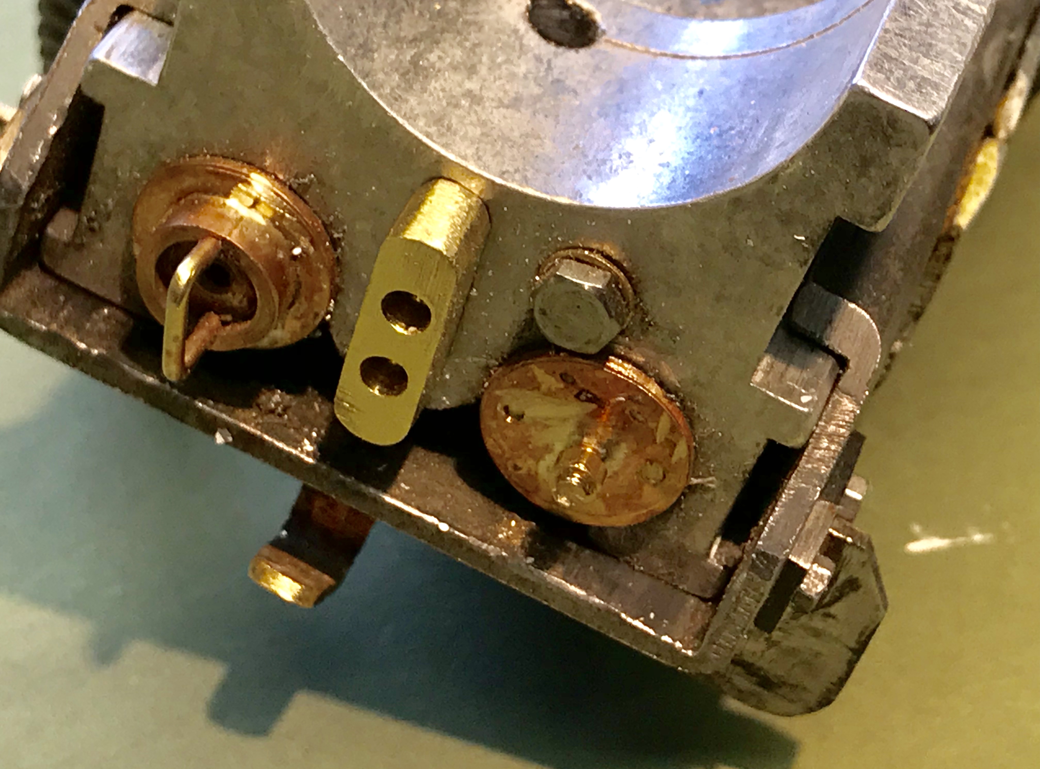

Post by Jeffrey Goff »

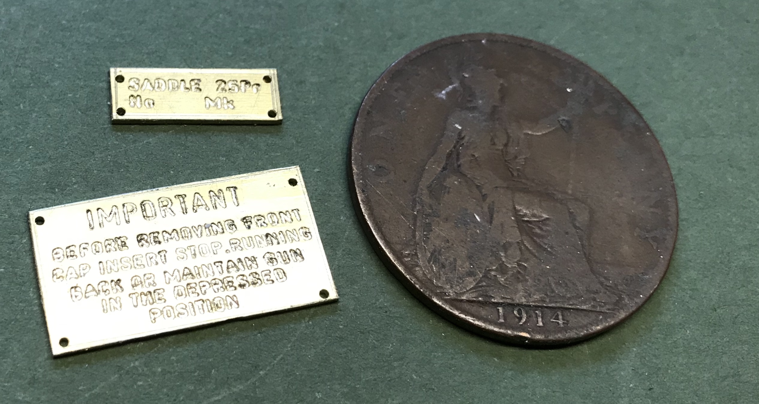

As the trail is mostly finished, I have made a start on detailing the recoil slide, by adding buffer stops, and replacing the kit parts to the front cap, also added details to the rear of the slide, and for fun I had a go at making the two plaques for the side of the slide, they were to small for me to cast so I engraved them, the larger of the plaques is a couple of mm larger than I would have liked but I could not engrave the letters any smaller, while playing I added some detail to breech block and counter weight
regards Jeff
