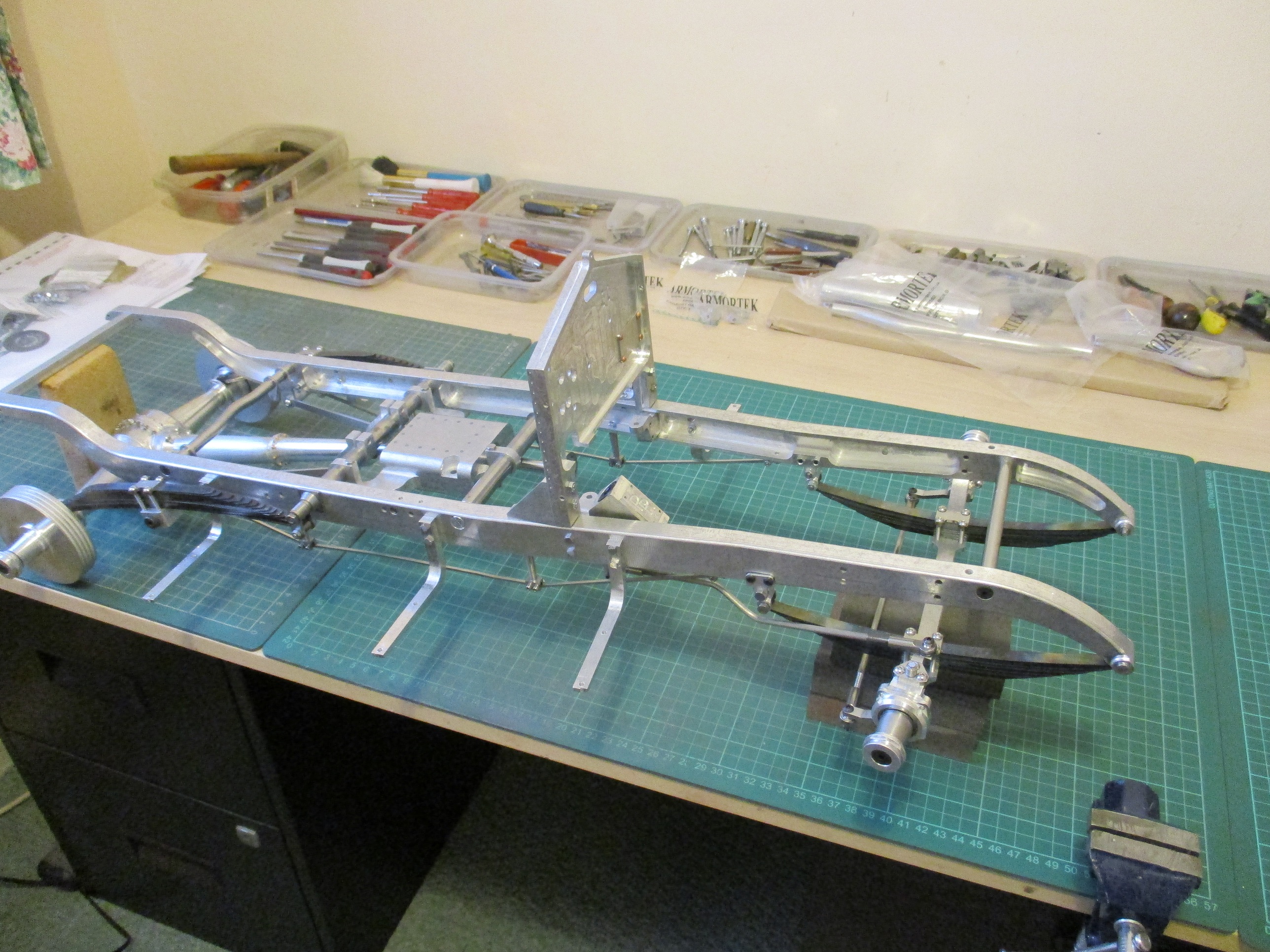

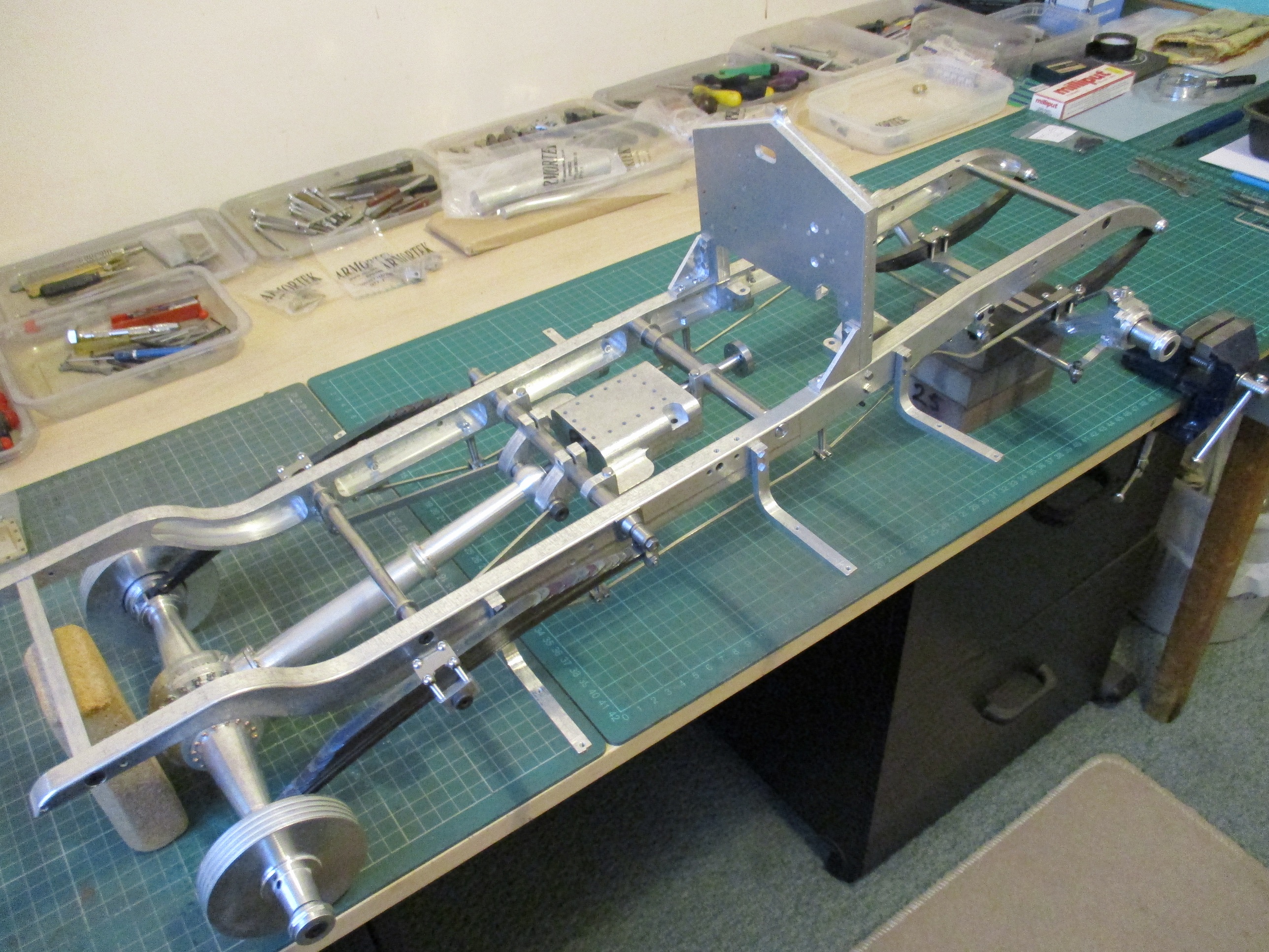

Lovely morning chaps, time to fettle the lawn and nip out the side shoots on the tomato plants. Progress on my 'Rollers' rear end. Once assembled the differential, axle cases, leaf springs and prop shaft cases, are firm and secure. The prop and drive shafts rotate smoothly and freely...so, all is well.
I have 'infilled' the small gap left by turning the axle cases back in order to line up the leaf spring pins, with Milliput. Merely to give a more finished look, it serves no other useful purpose.
Have a nice day...Mick.

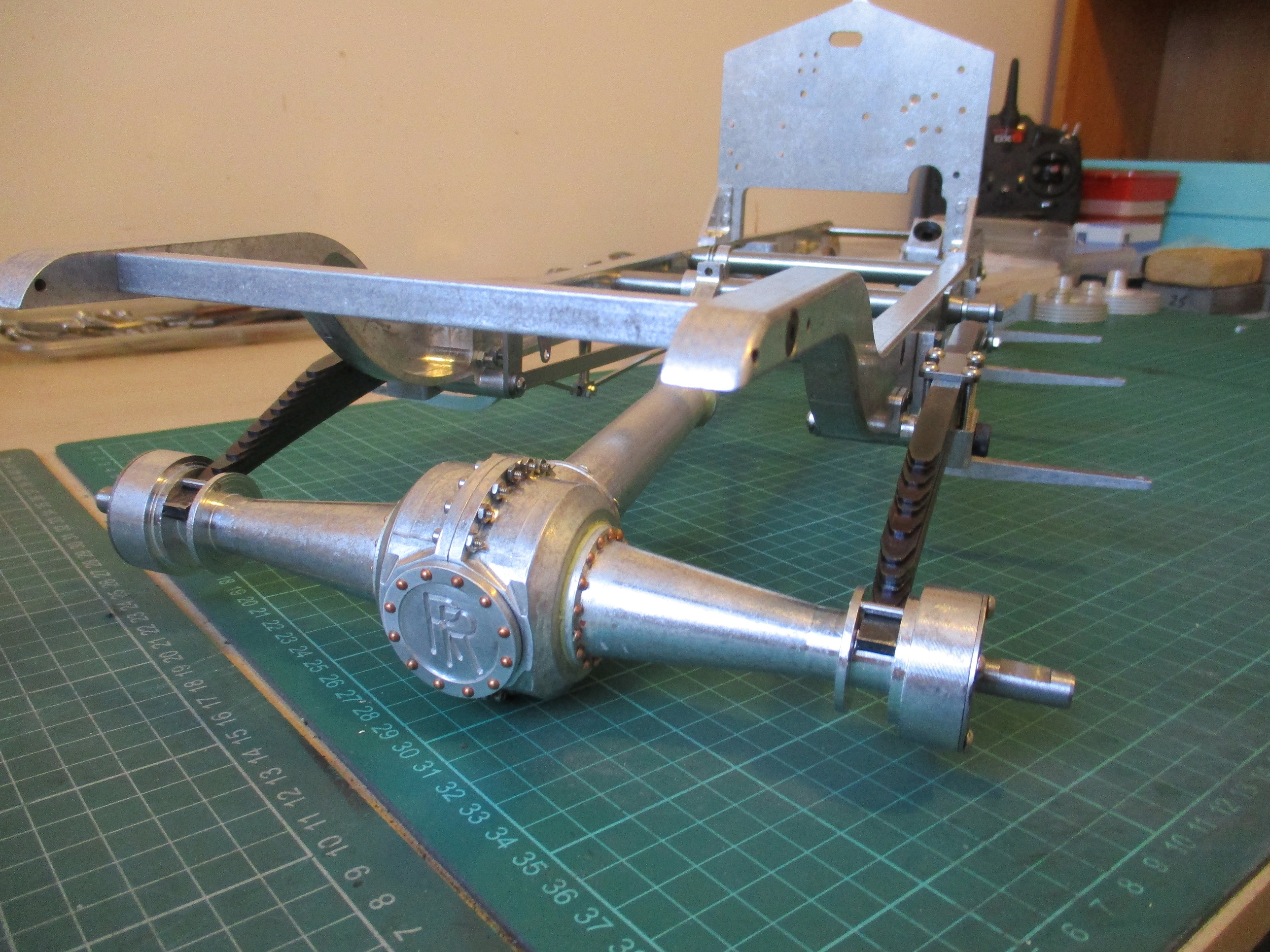

Back to the Roller...the final drive was a little tight....so I stripped the differential down and removed the 'Milliput'. Rebuilt the drive and axles resulting in a very smooth drive train. I did take a file to the part EPO205 at the axle ends where the 'pin' is located, this allowed the axle end to locate and float in the differential smoothly. The drive from the prop shaft to the wheels is good. I was hoping it would rain this weekend...just an excuse to stay in doors and build....sad really....mick

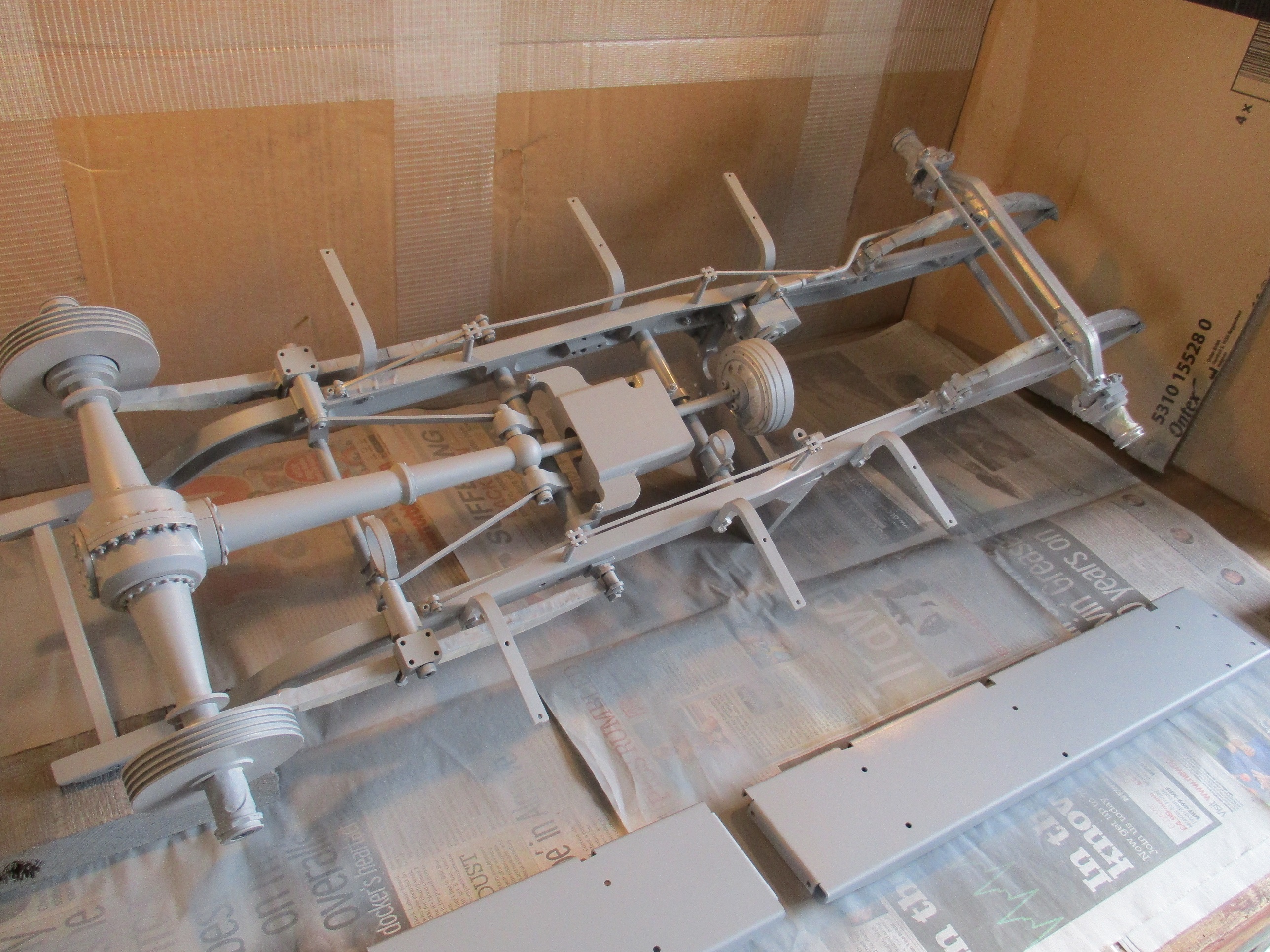

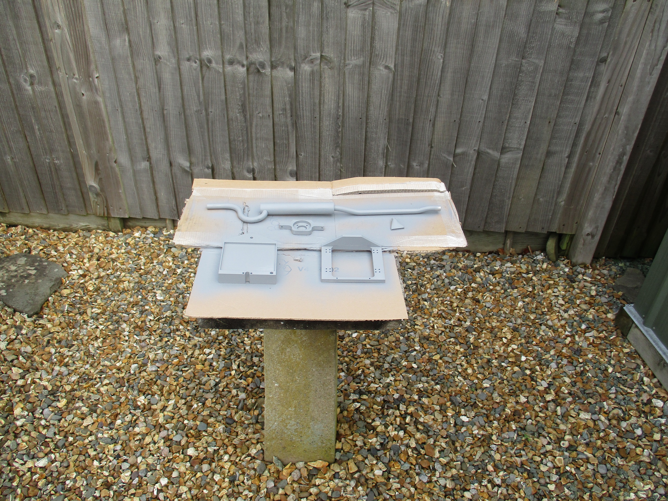

Be careful what you wish for.....I did ask for rain....a deluge no less...I thought I would 'flash' over the chassis with etch primer...stinks somewhat, and I used a mask....Mick

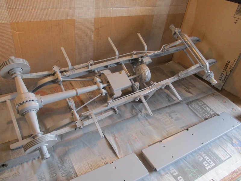

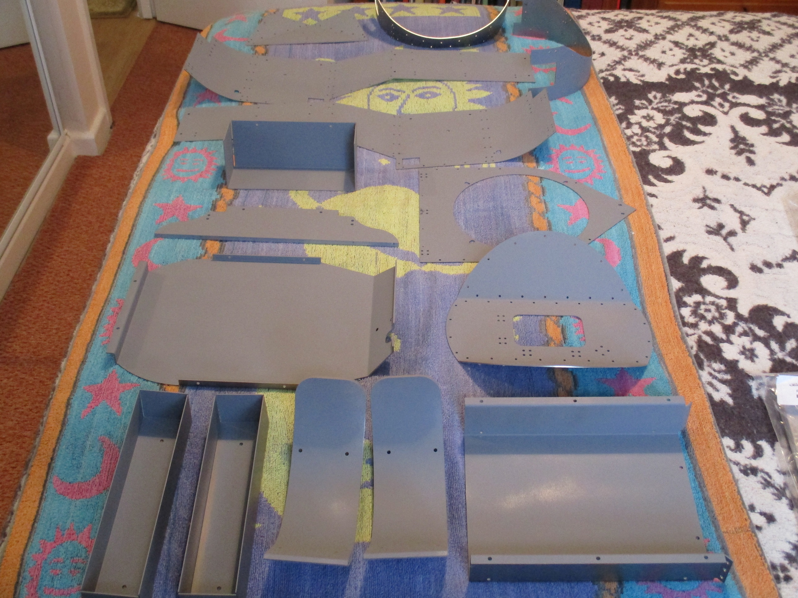

Good morning everyone, mixed weather forecast today however it is dry, therefore on with more etch primer....I had a feeling that old beach towel would come in handy....Mick

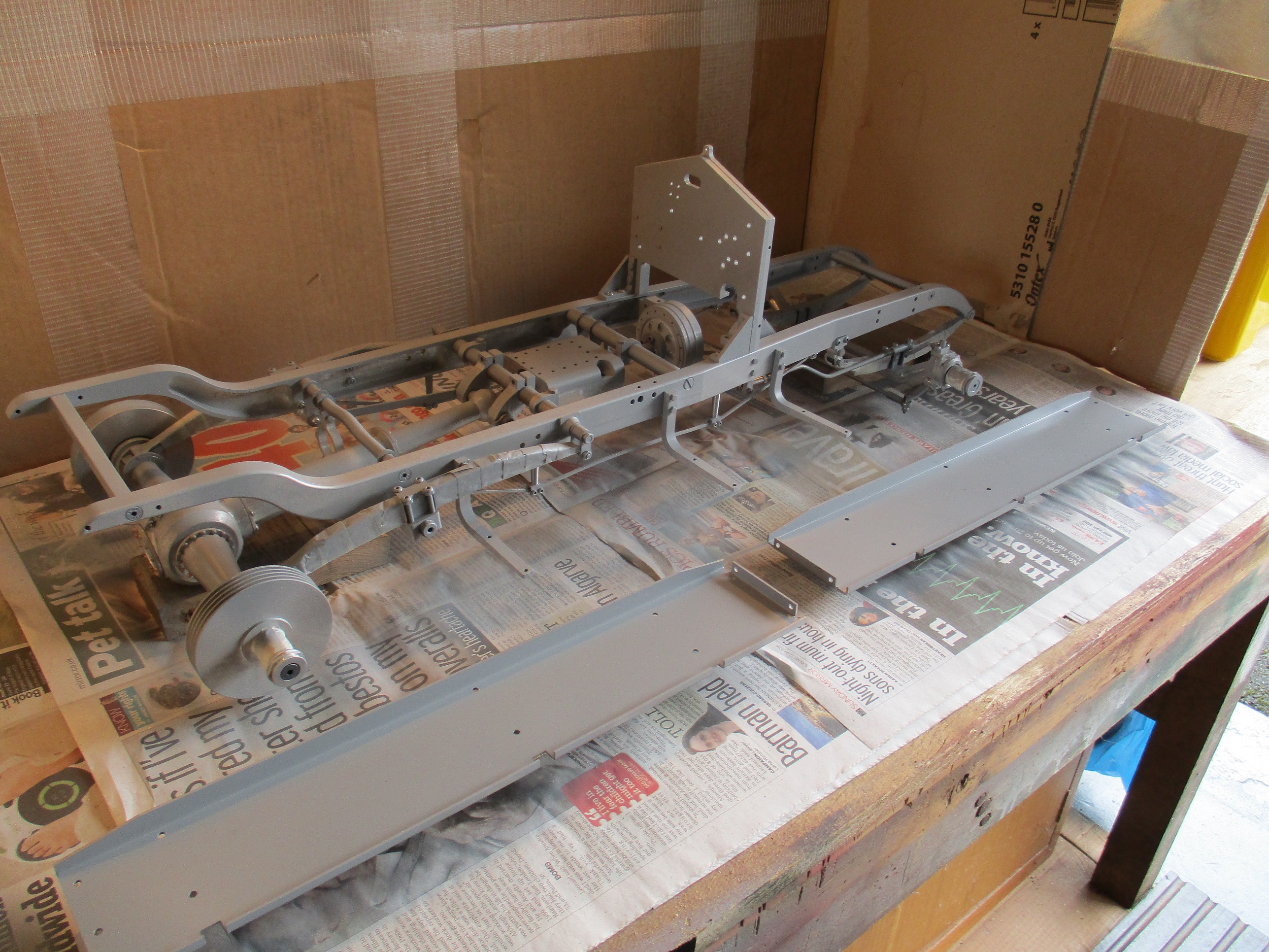

On with the primer....a gentle breeze passing through the garage removes the over spray....well most of it....use a mask...Mick
For the eagle eyed, yes, the RR differential 'backplate' is upside down.

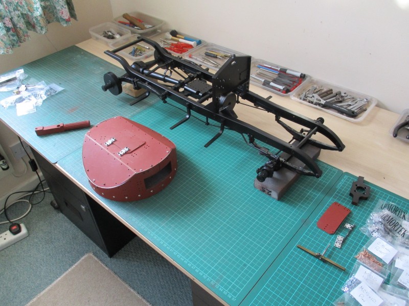

I thought 'Satin Black' looked rather nice

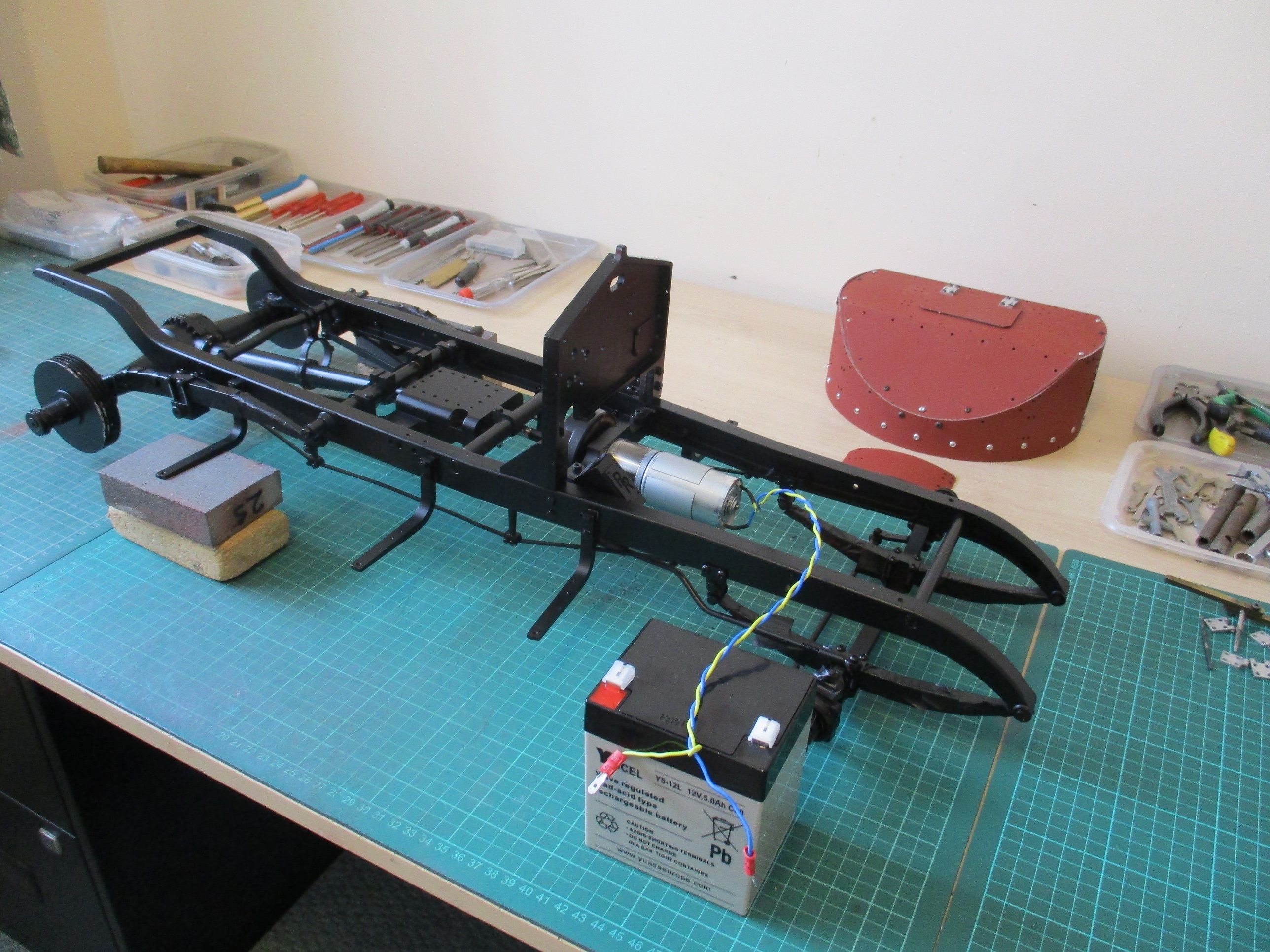

Good morning, couldn't wait to test the drive differential and axles, so I fitted the drive motor and linked it to one of the 12volt batteries. The first attempt produced a distinct 'wobble' on the prop shaft. I started to strip the diff assembly and then realised the prop shaft was not seating properly in the gear box end, cup joint CJO440. The grey matter finally kicked in....I had the flywheel located up against the drive motor...which caused the problem. Set the flywheel back towards the gearbox, which then allowed the prop to fit in the cup joint.....the Good Lord is watching over me....Mick :)

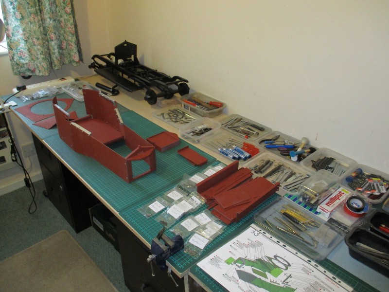

Made a start, or restart, this is my forth attempt at posting, Forum keeps asking me to log on, I thought I was logged in :roll: ...Mick
