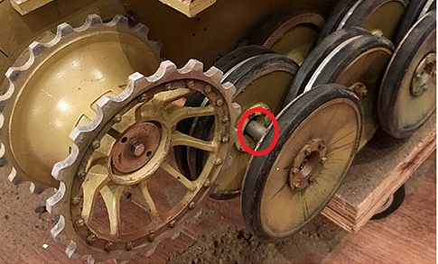

The circled bit just looked odd to me, maybe just my eyes playing tricks on me.

I agree. This is the default configuration:
There were various mods recommended by owners to stop the wheels rubbing on the spacers, so your tank may be wearing one of these mods.
You will see when a wheel starts to rub as it rotates in the wrong direction as the tank moves along.

I think the wheels assemblies may have been modified with a more correct size spacer, worth doing on the older models, nice.

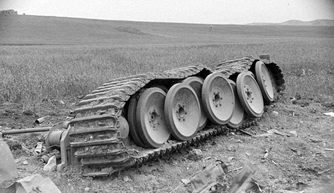

Not really relevant but saw this image for the first time. Bit of restoration needed

Tunisia Feb/Mar 1943. One of a famous series of photos of destroyed panzers at Hunt's Gap. There is no doubt that the tanks were wrecked by demolition charges but attribution is debateable - both the Germans and British reported destroying tanks in this area between 27 Feb and 2 Mar.

Well, actually, the outer roadwheels do not always move along, the spin indepently, at least when I tried driving around in the living room.Adrian Harris wrote: ↑Thu Mar 22, 2018 10:52 pmThere were various mods recommended by owners to stop the wheels rubbing on the spacers, so your tank may be wearing one of these mods.
I do not know about any mods, apart from the fact the owner told me he had all wheels modified to have 'double ball bearings'?
