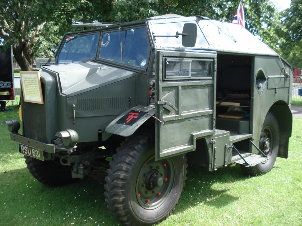

Sorry, finger trouble, previous post now edited with correct Caunter picture from Greece 1941. S
Posts: 4237
Has liked: 2227 times
Been liked: 7003 times
Re: Me Quad.
I reckon you have a nice bottle of rouge on the go Stephen, I'm on my second glass! Now those 1/1 quads look really good in that scheme.
Going back to that truck photo, you can see where the Valentine tank got it's axles/differential from. Oooops I have hijacked me own thread!

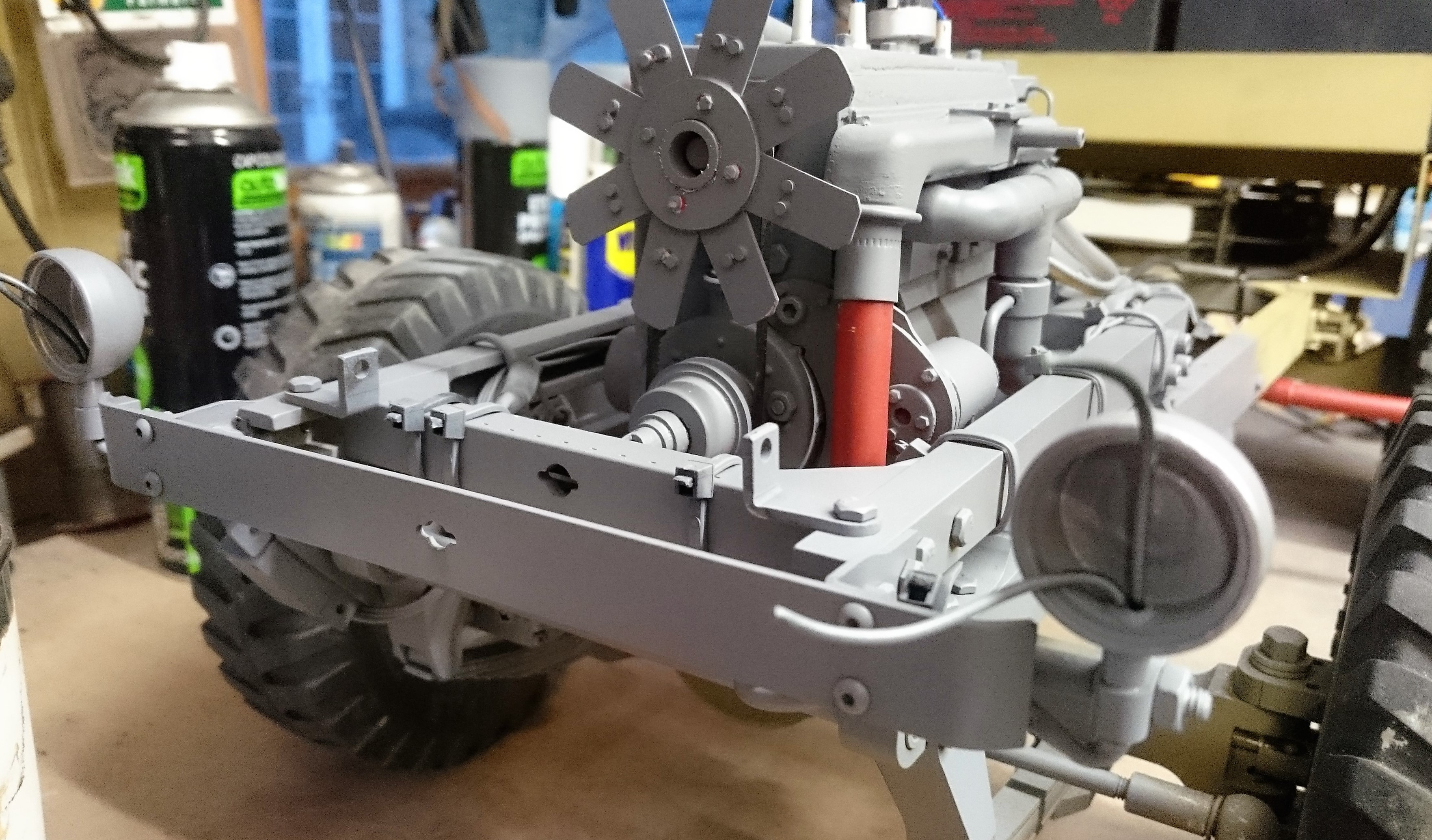

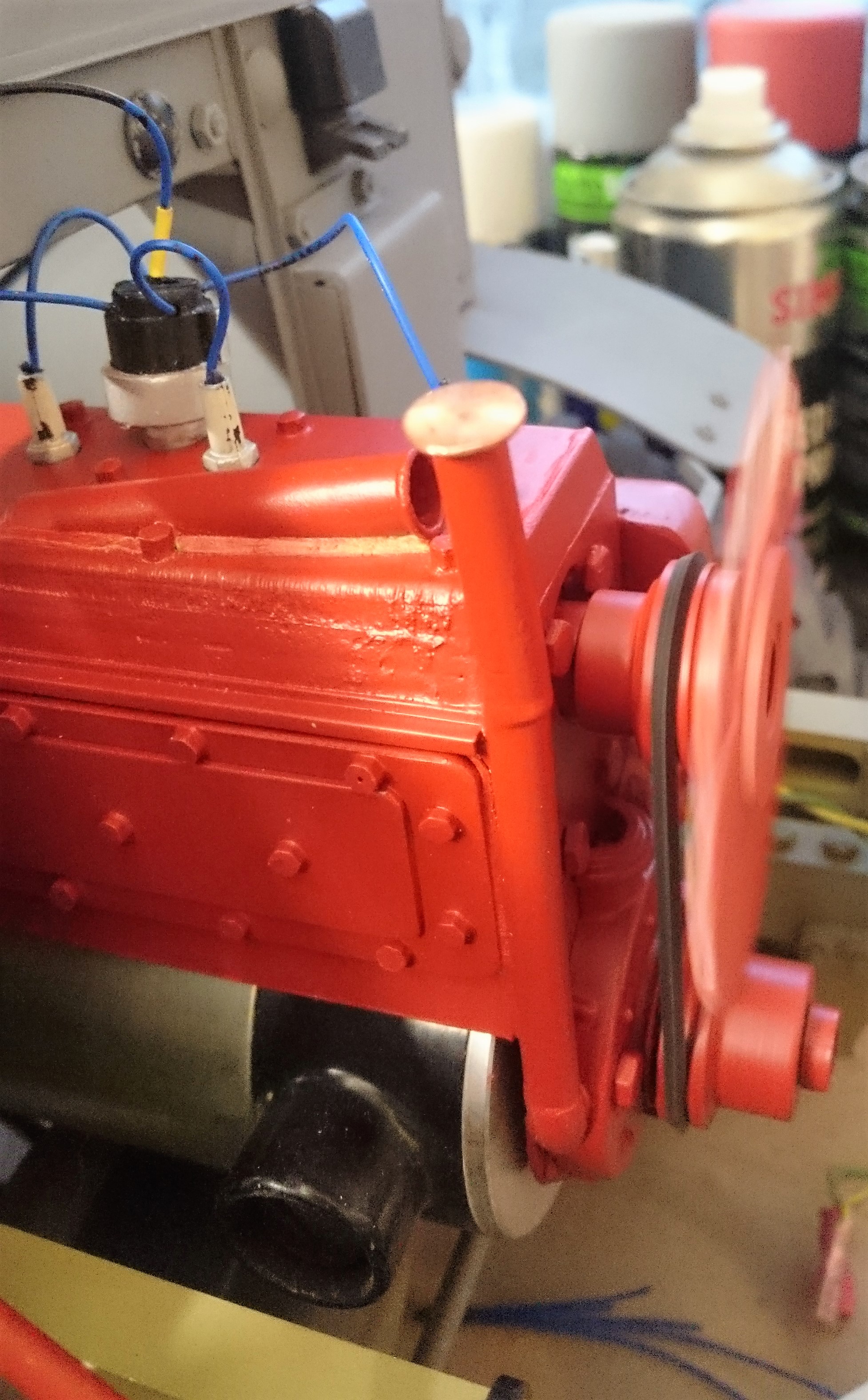

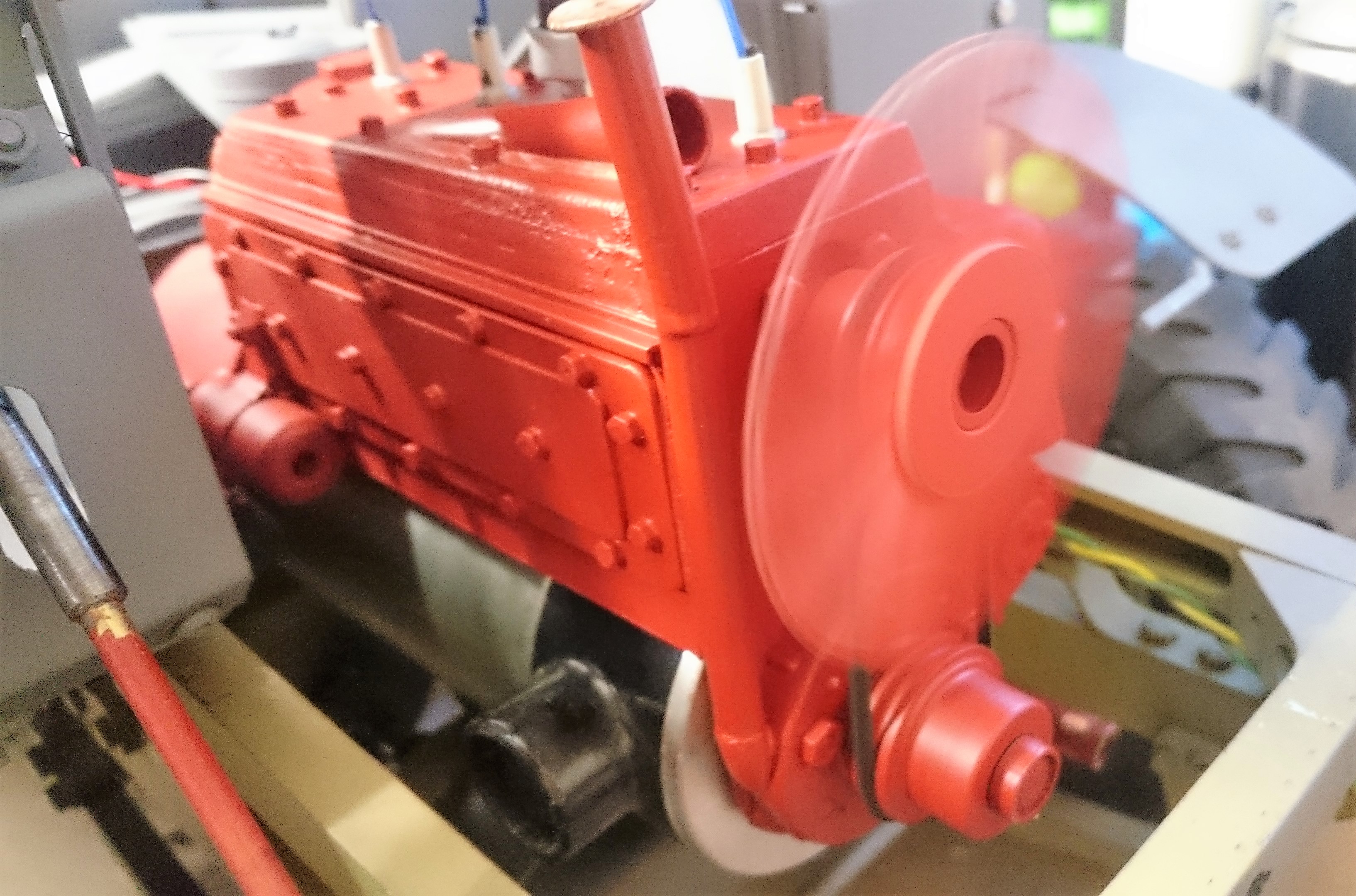

A bit more done, essentials like doors and locker hatch priming. I shall be working on turning a better engine bottom pulley and radiator fan and pulley drive today so photos to come later of that cold workshop exercise.
I have installed the 24v motor with the reduction gearbox for the pulley drives but I am not happy with 4oo rpm, it looks too slow when the engine is ticking over so I have sent for a 1000 rpm unit, the slower unit will do for now.
Time to start improving the engine fittings as I am now happy with the set up and how it functions, so new pulleys and a nice metal cooling fan to be manufactured from scratch. From photos it looks like the generator was turned from enclosed gears off the crank, so I shall work on that today also.

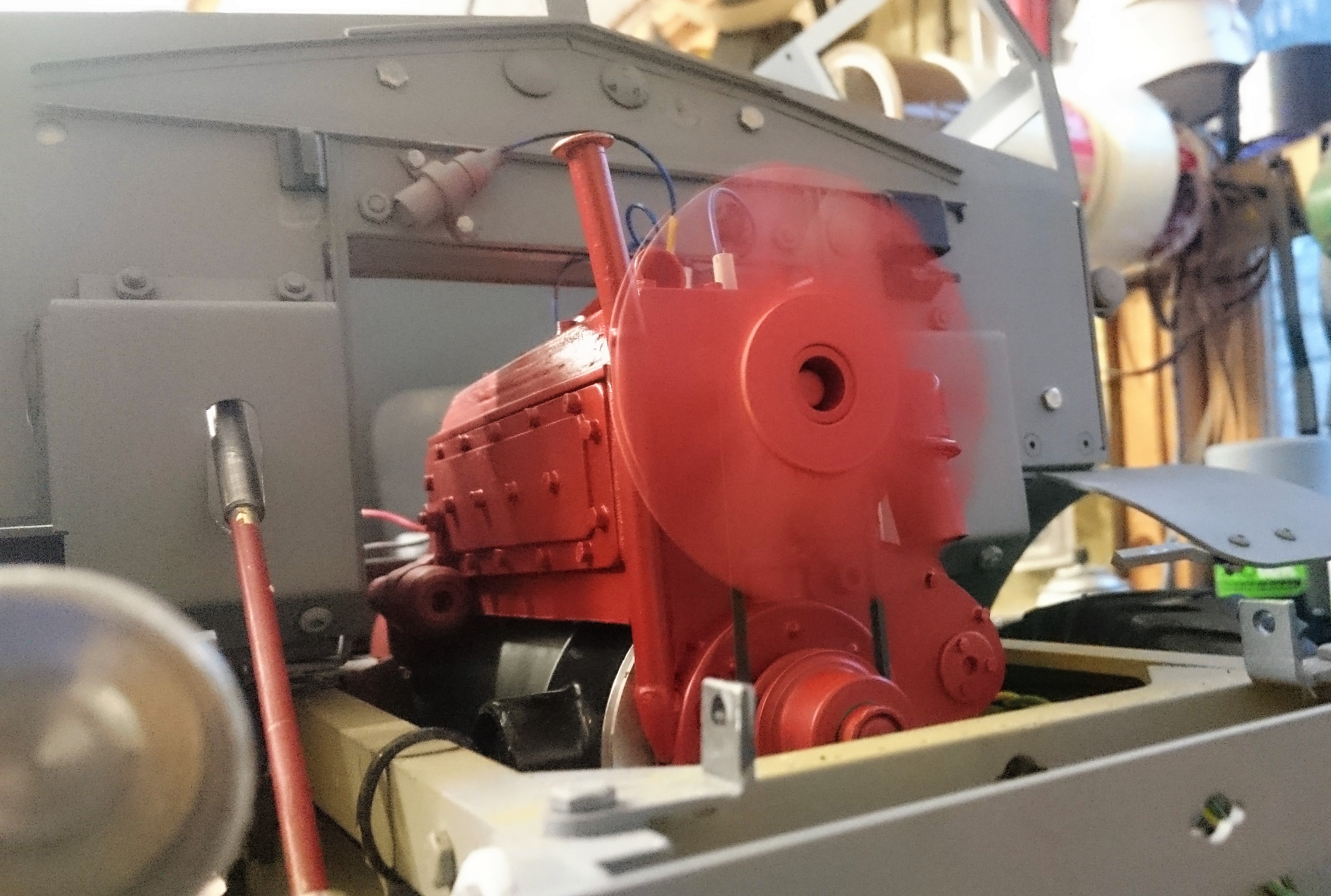

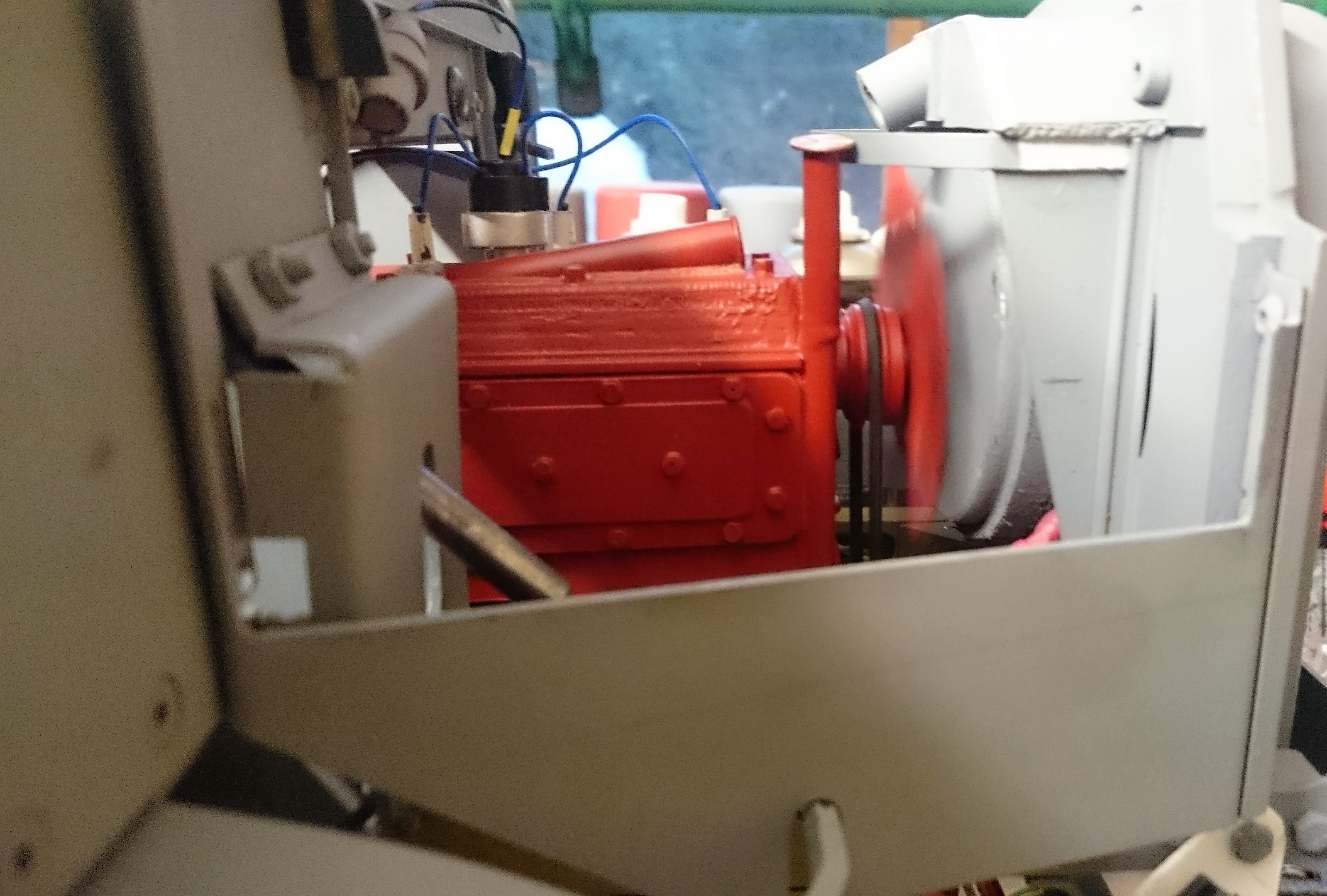

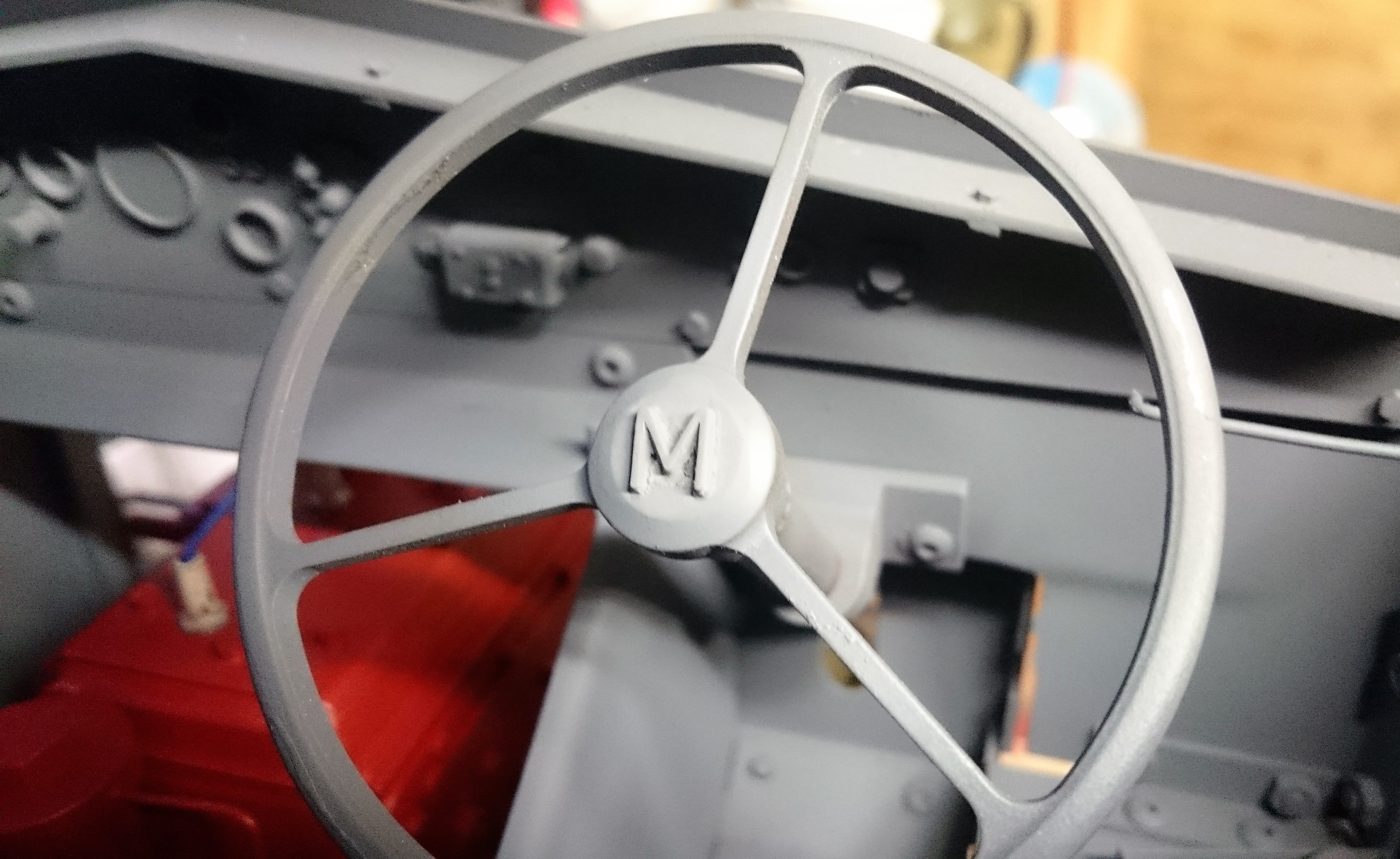

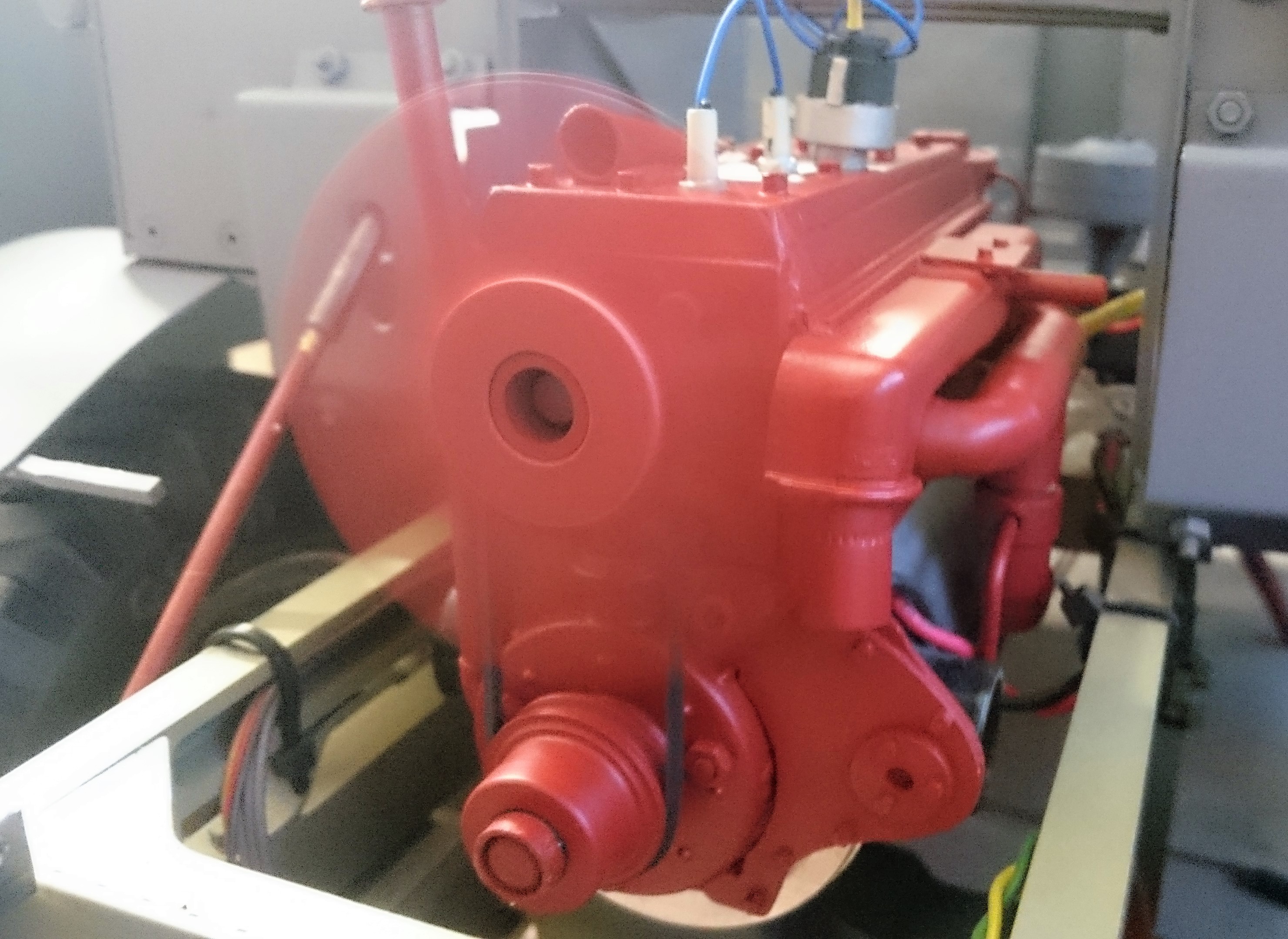

As promised.I reckon more than 40hrs on that dummy engine so far but nearly done.
That's the smallest "M" I got. Should read MCc
Although it looks fast enough on camera it's not to the naked eye on tick over.
The little motor chatters away,but the mechanical noise adds to the overall effect.
Now to paint the drive motor under the dummy, Im not sure what colour as yet but it may be DBG as most colour photos I have seen use it.

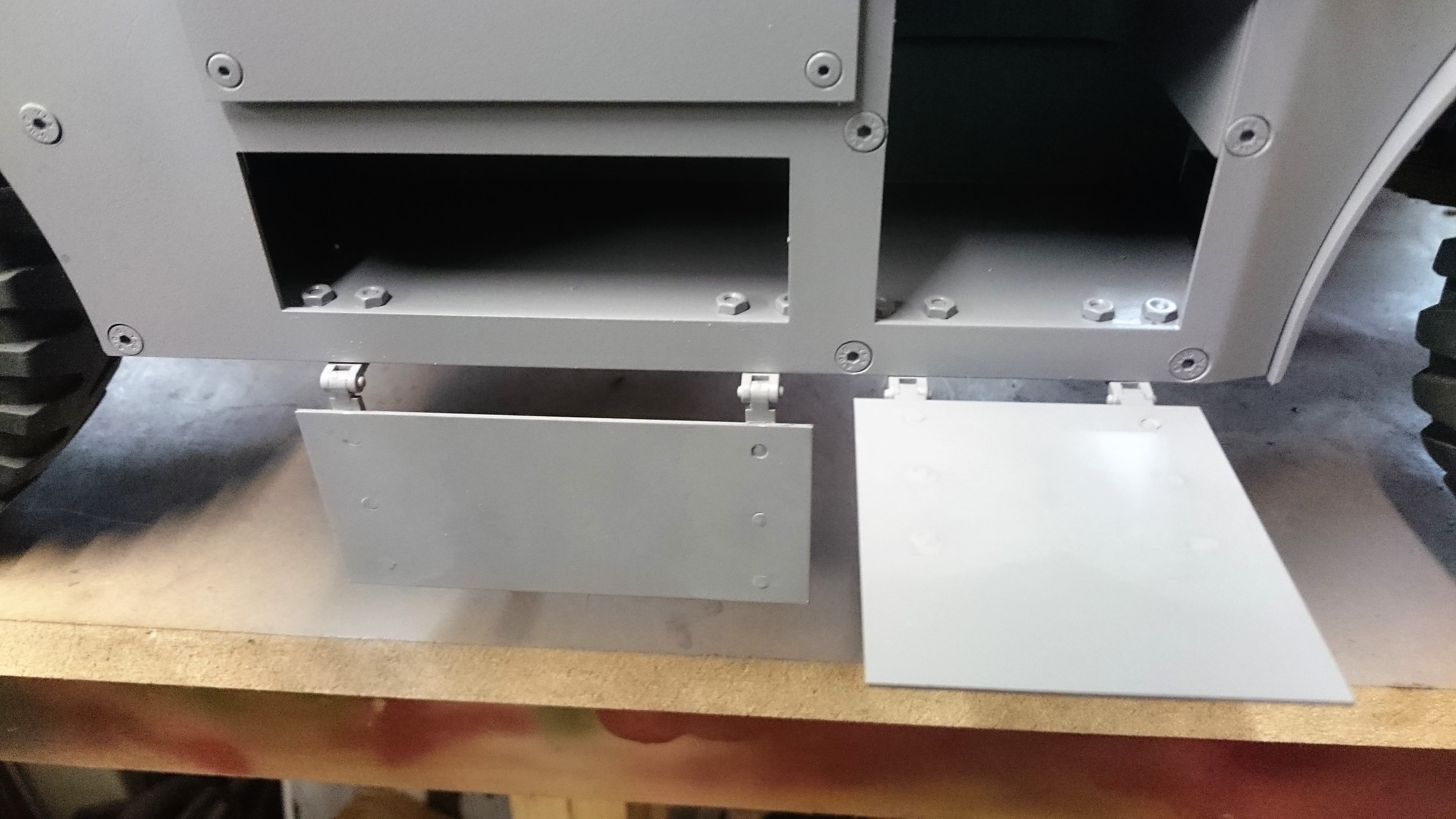

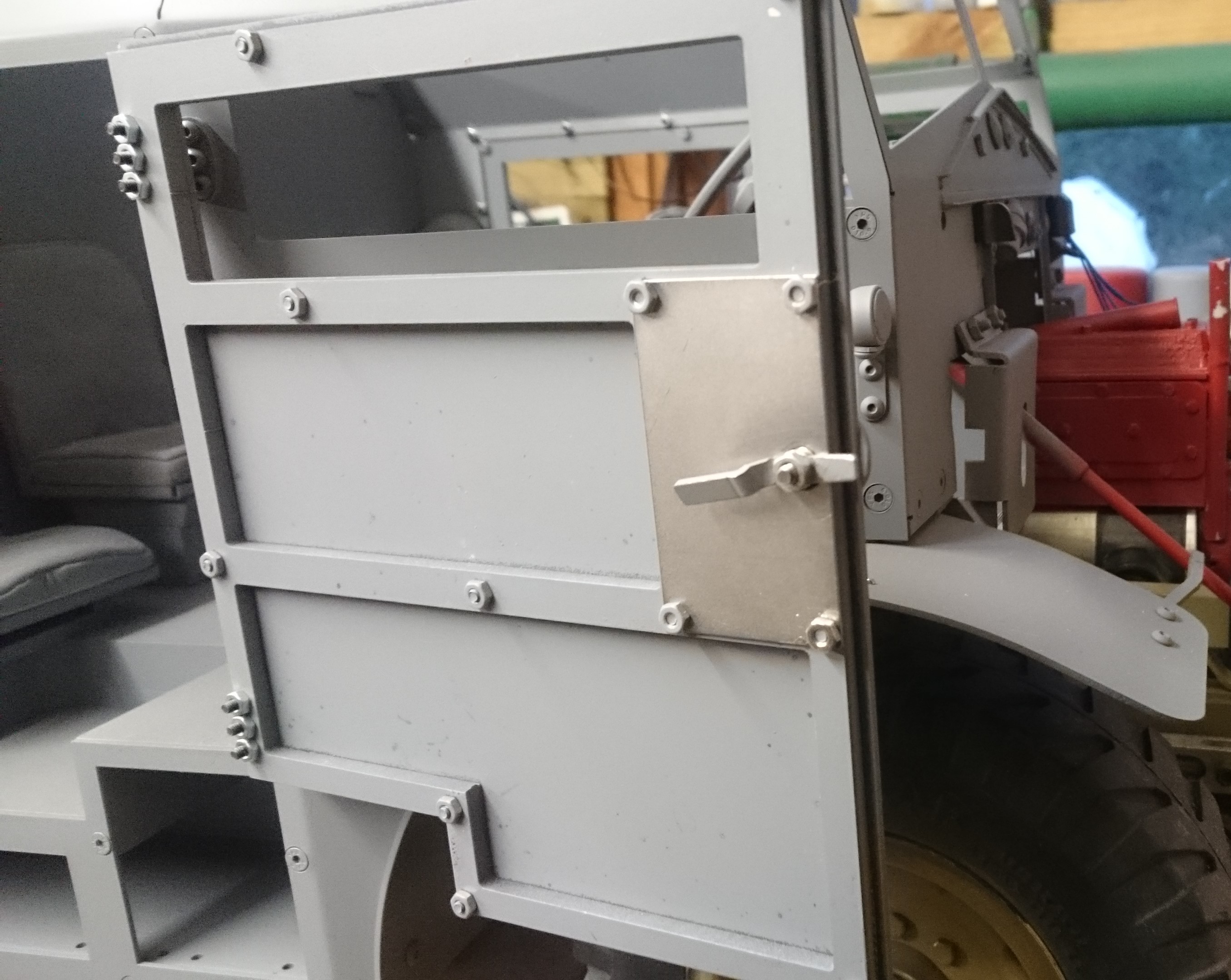

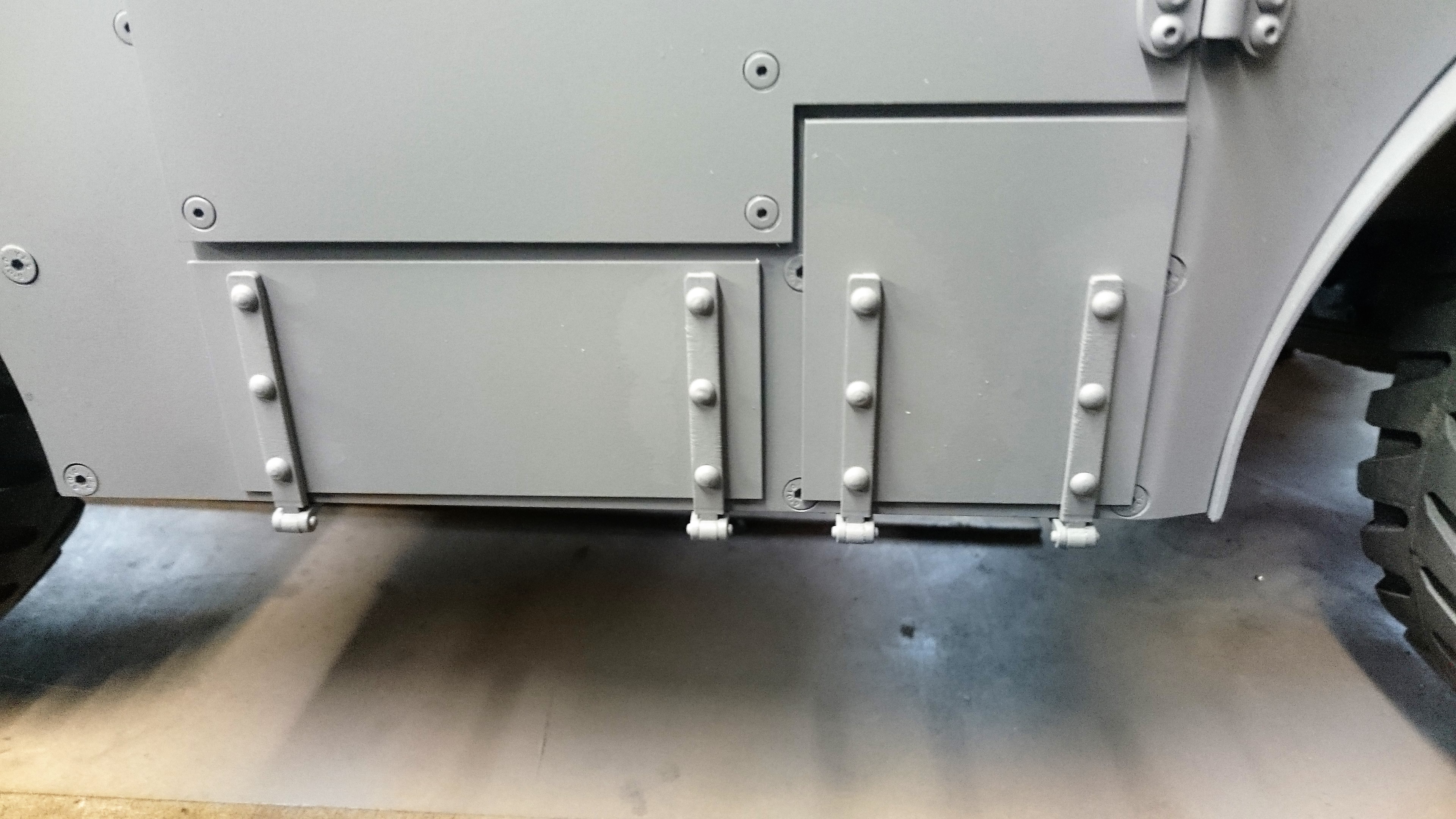

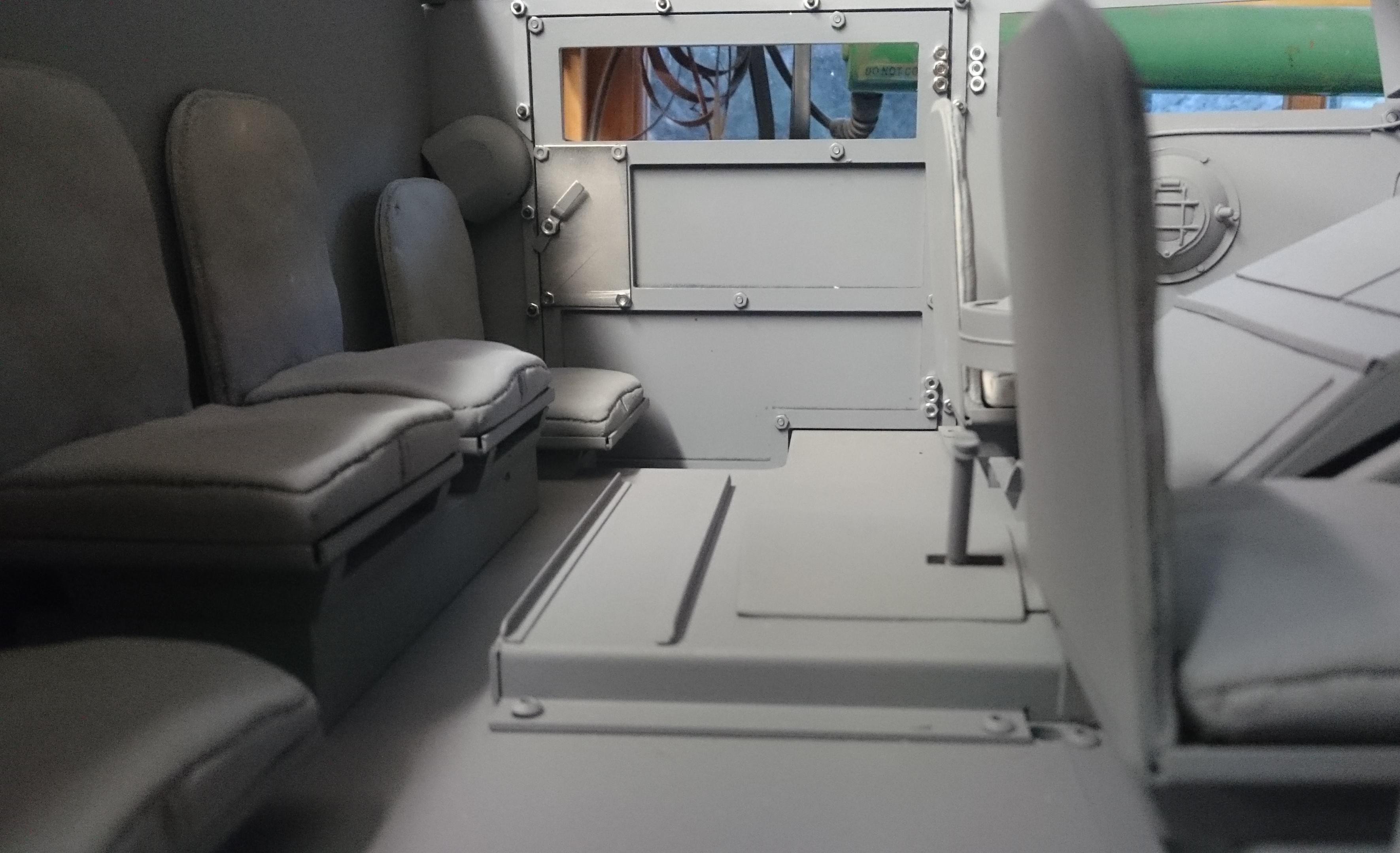

As it's our Lords day and a day of rest I have spent just an hour in the tank shop.
These lockers are little devils to fit. Nice "shut lines"
does anyone know if they had chains on them or did they just hang down.
Plenty of room for all the crews kit , stores and tools.

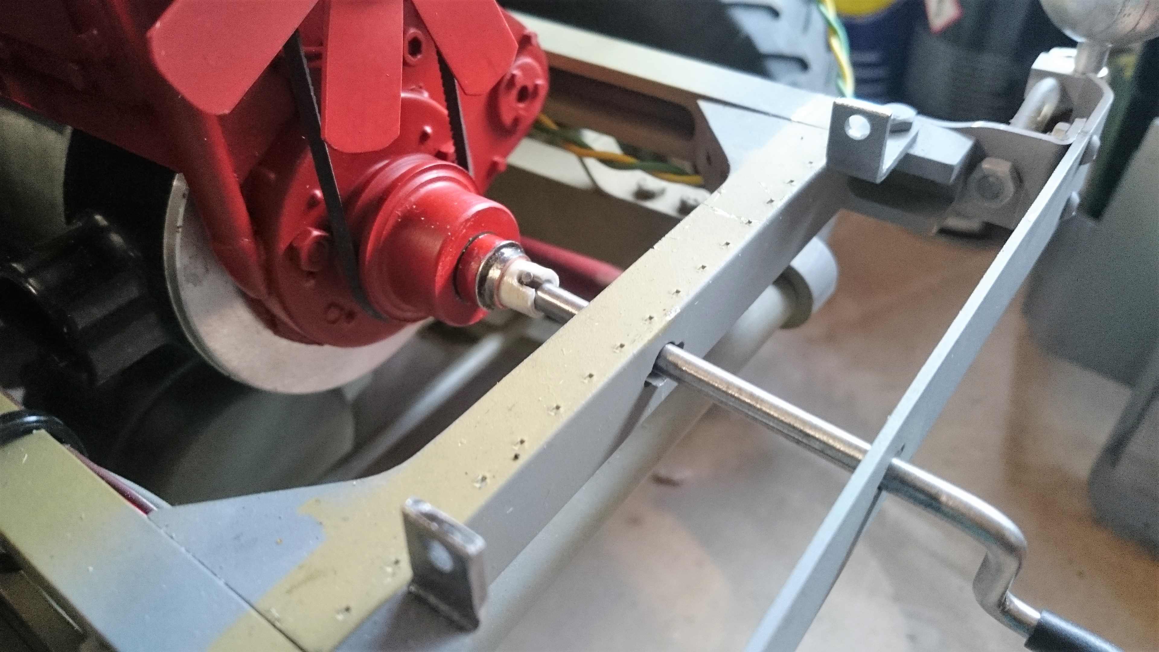

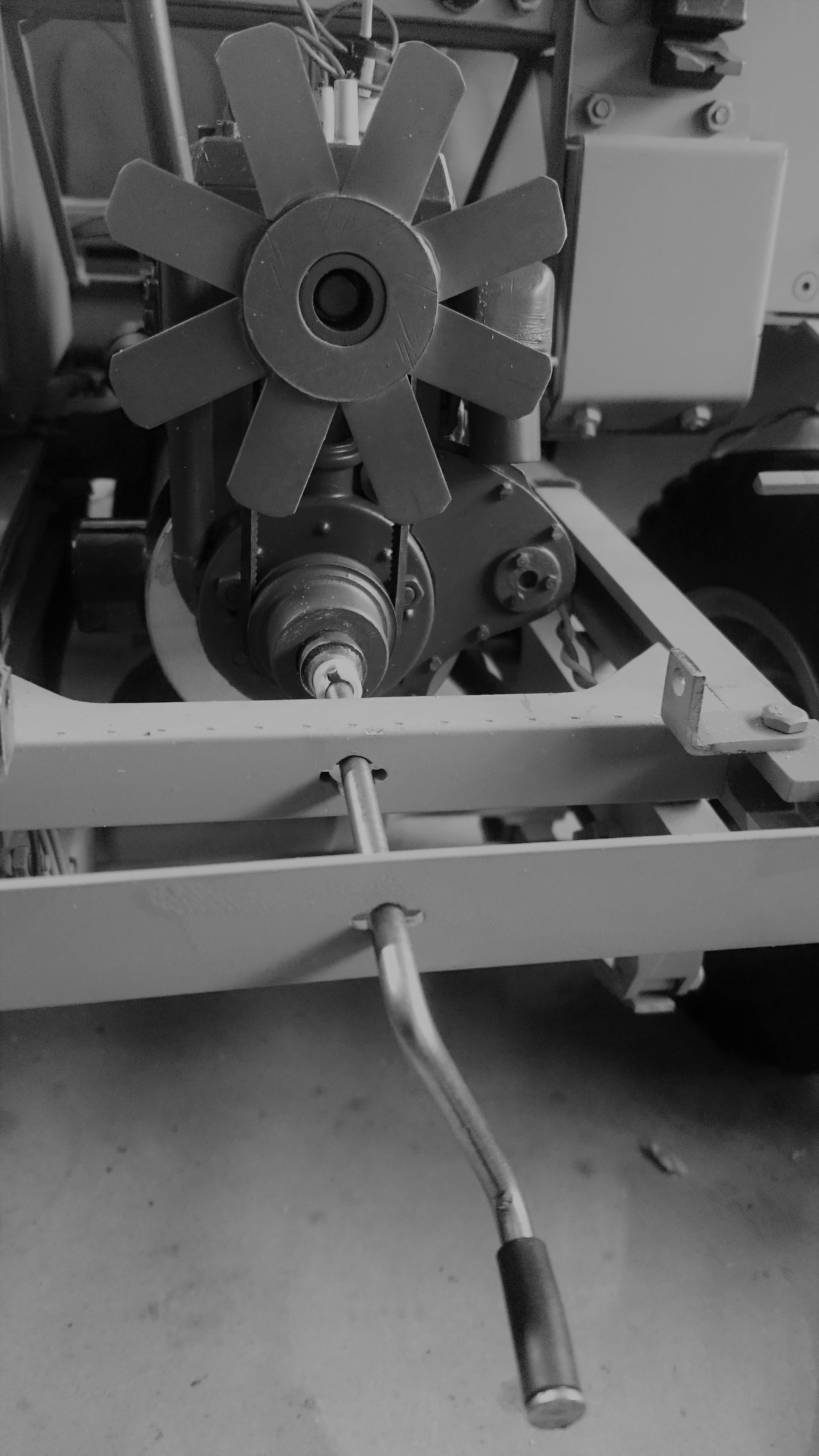

Made a little starting handle, non functional as the crank is fixed. I need to add some rivet detail to that fan.
I did notice that there is no starting handle hole in the radiator frame so I will have to make one.

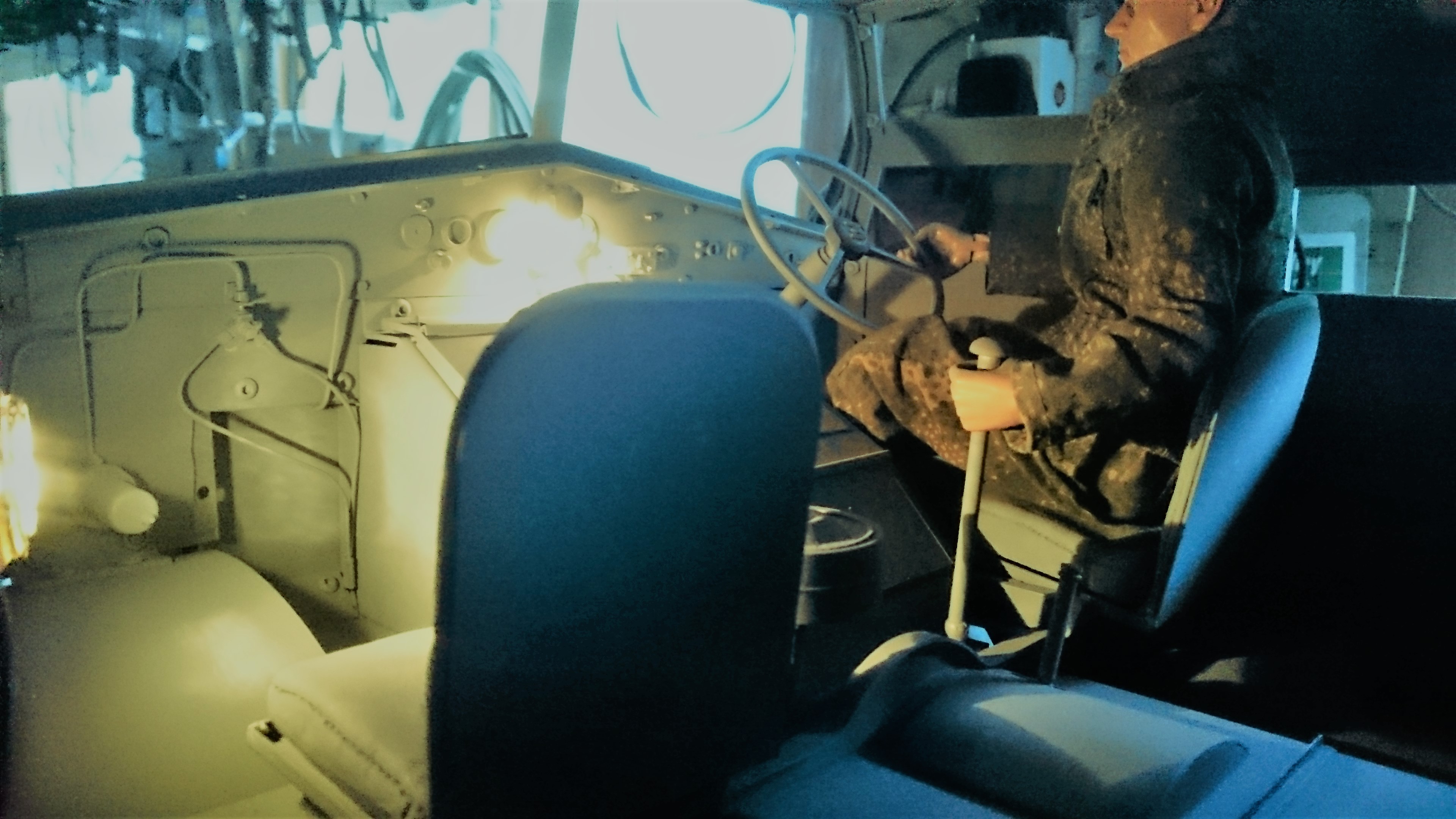

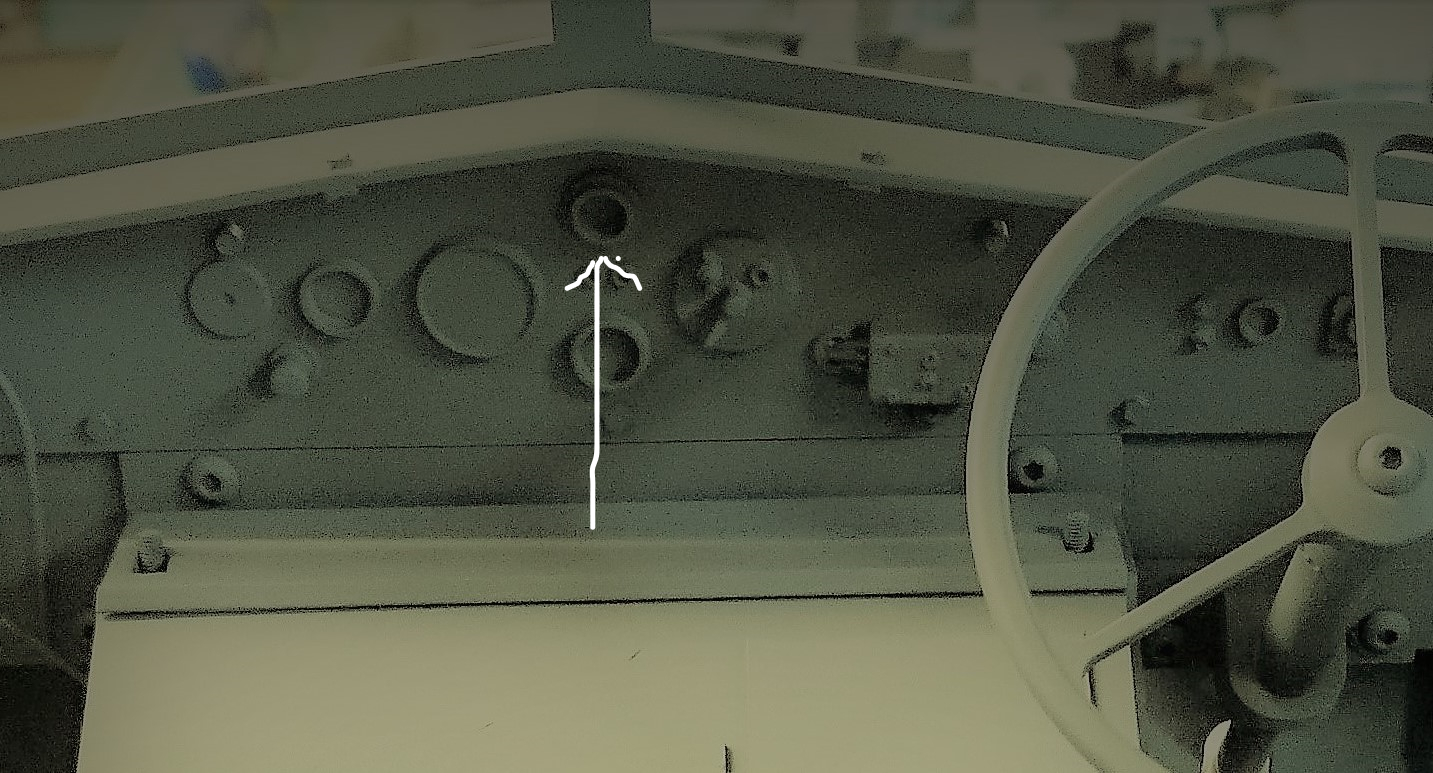

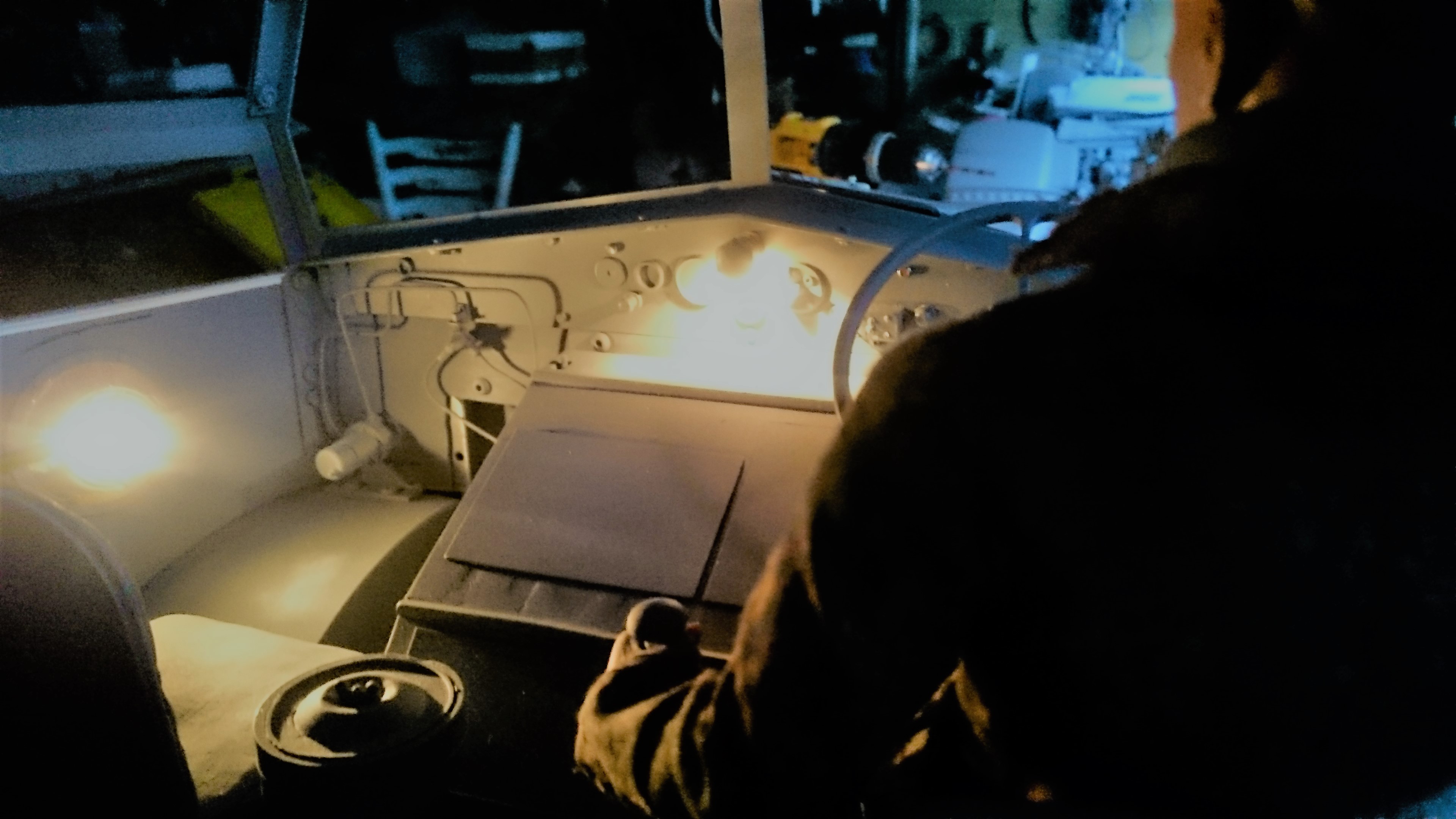

Another question, regarding lighting the quad interior, the bulkhead map light is obvious but how was the dash lit, was it the protruding shaded fitting upper centre of the dash? This would have been switchable during blackout I guess.
Another question, convoy rear lighting?

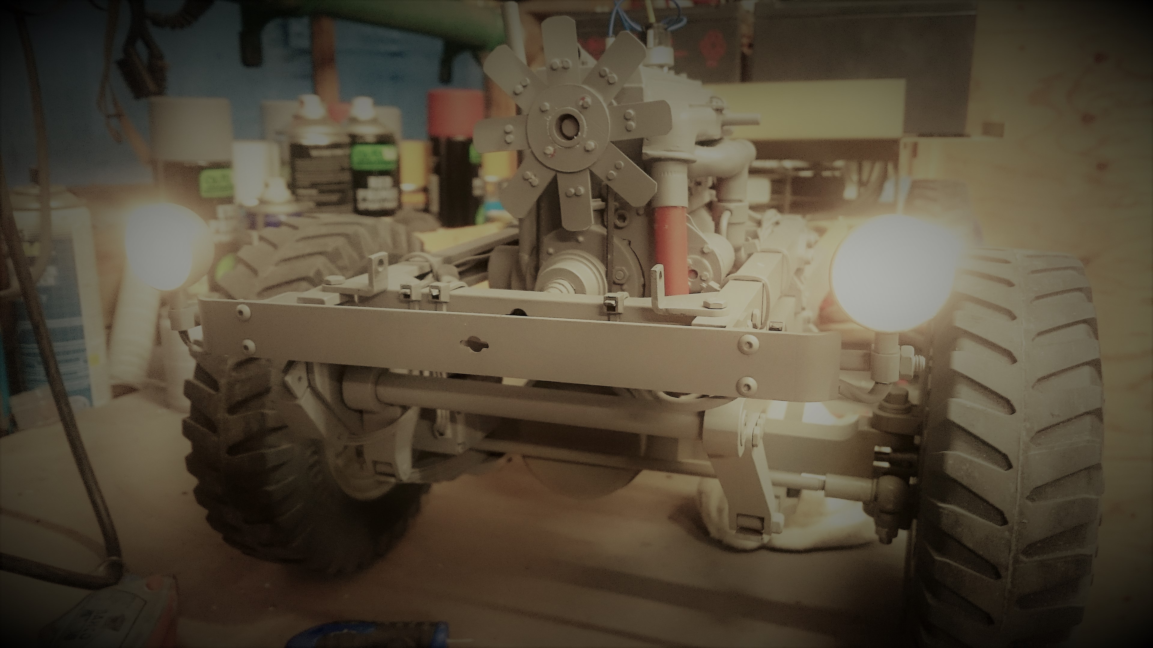

The chassis is coming together. The smoker is test fitted but I'm not happy with it I think it's a bit over the top, it works to well "to much smoke" I will look for a water vapour misty type one and try that.
The lights now have wires threaded ready for the tiny bulbs.

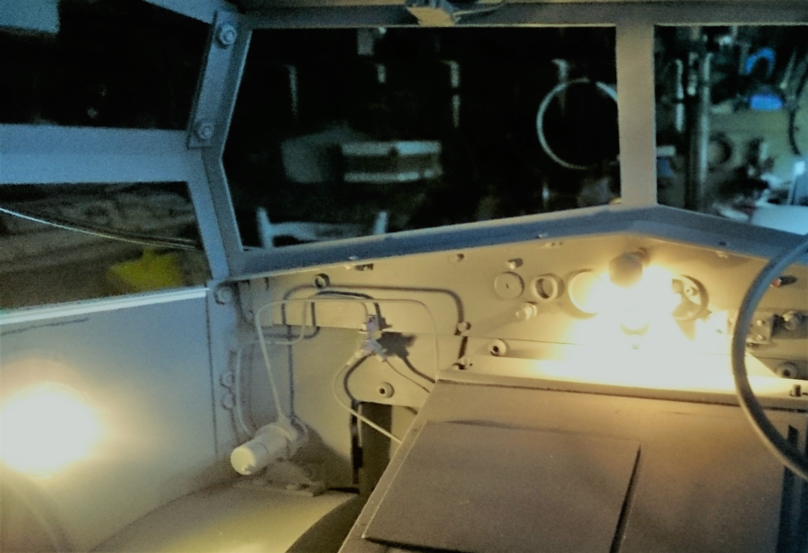

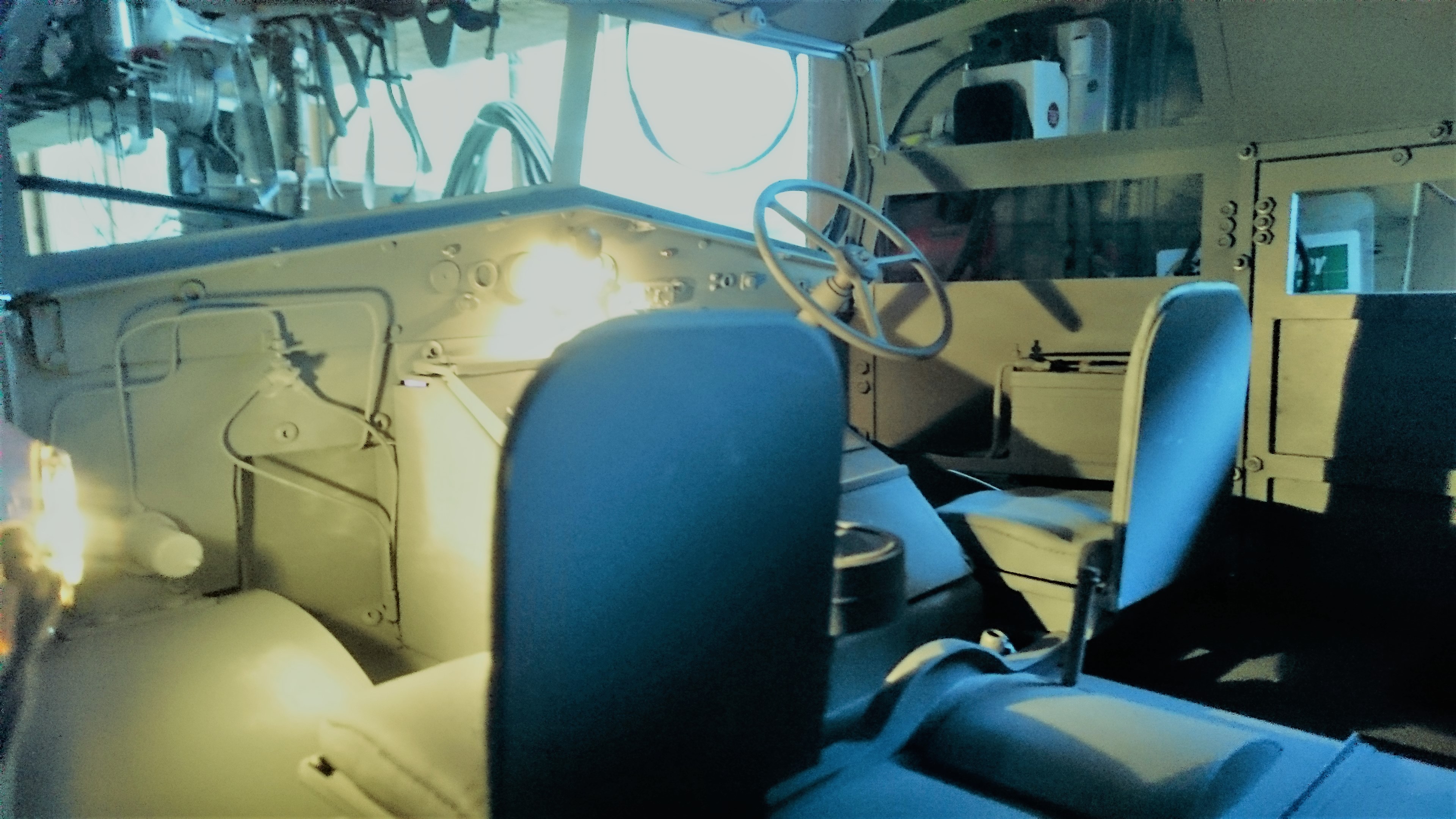

Made a start on the lights. I have also wired the dash lamp and the map/bulkhead light, photos of those to follow.....Phil.
I do like this Quads overall look.
!2v bulbs.
!2v bulbs.
Plenty bright enough me thinks.

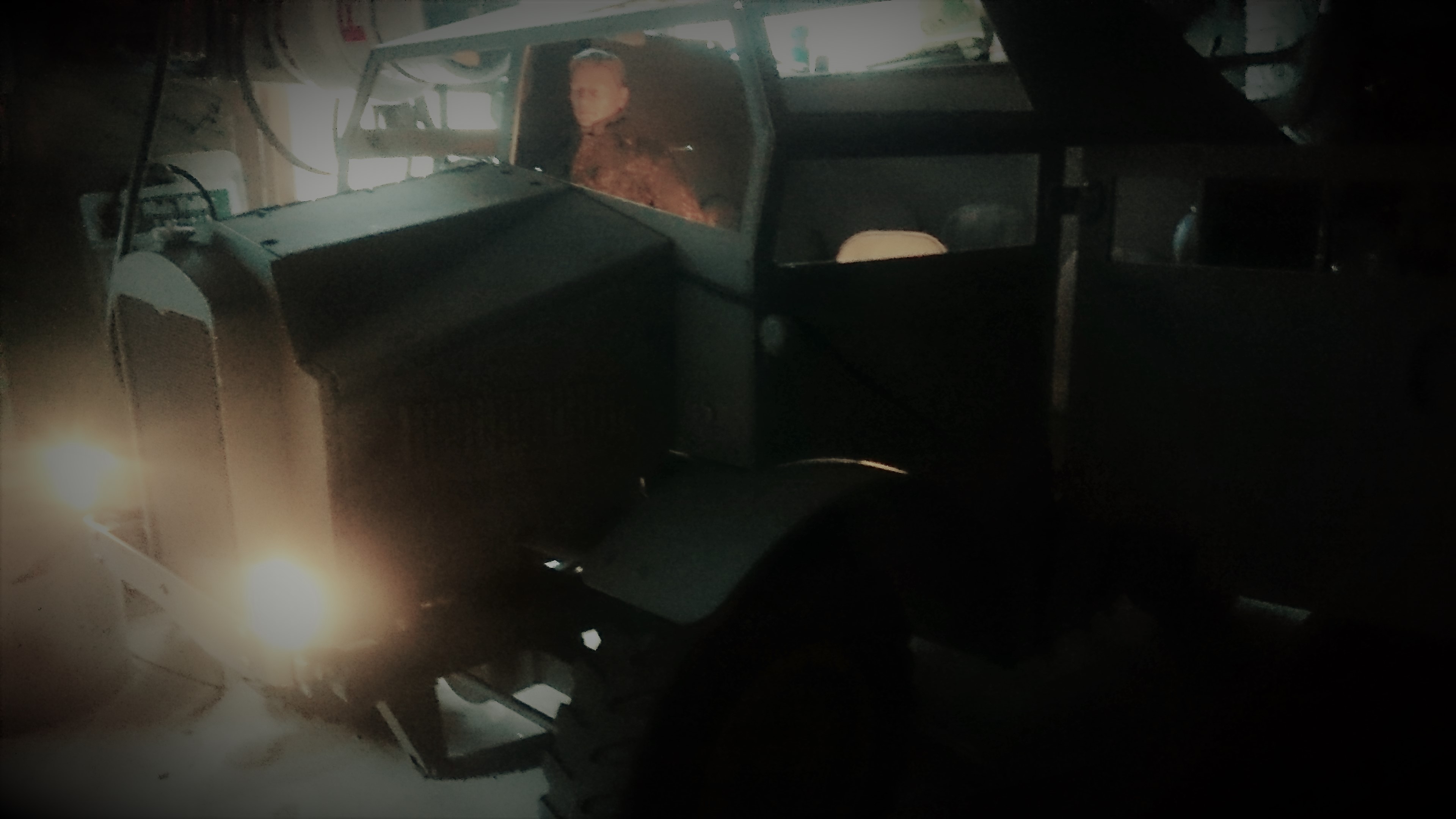

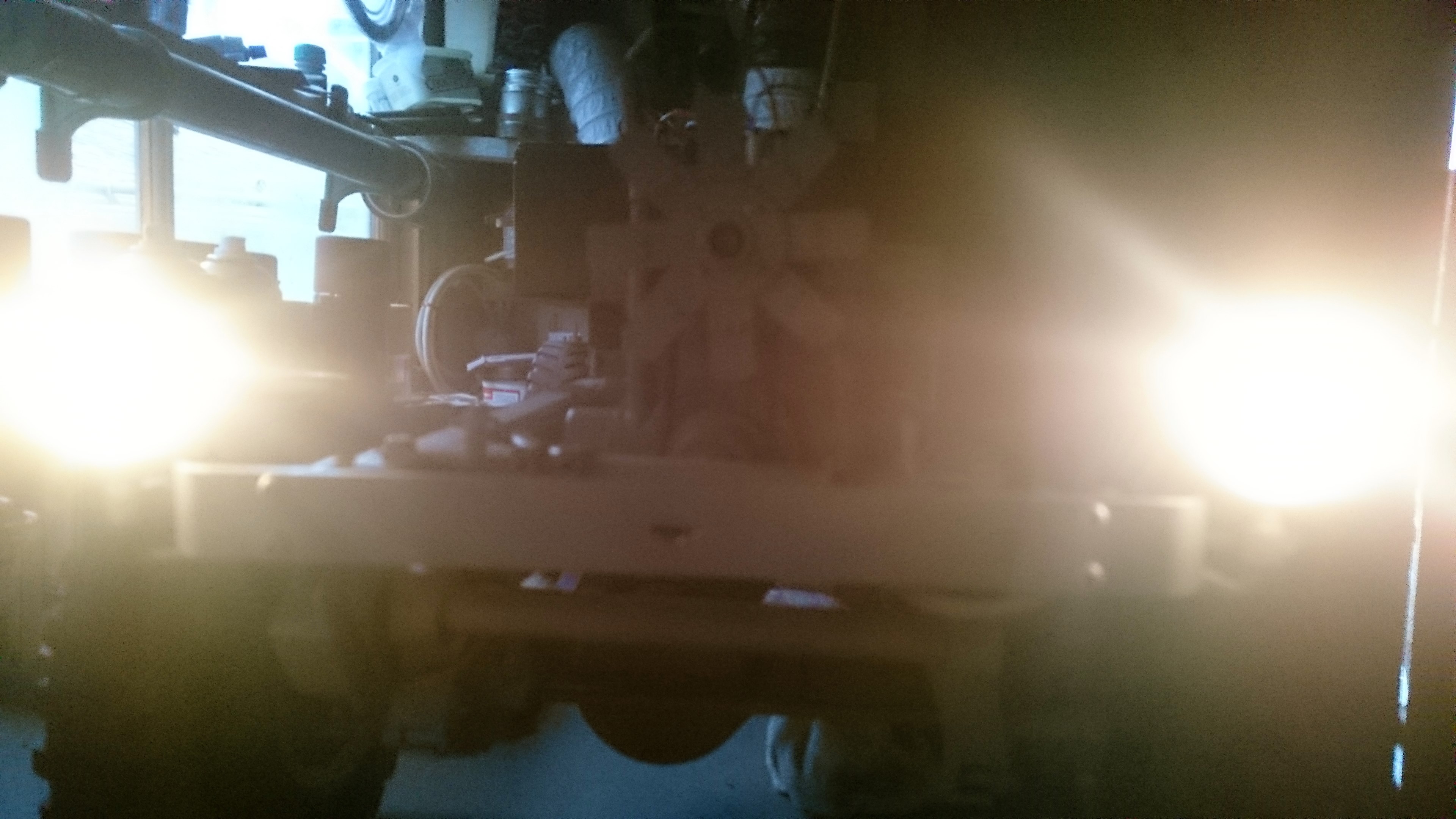

More lighting work, some look ok some a tad to bright?
Maybe a tad to bright.
I may try wiring in series to see if that's acceptable
Cold misty desert dawn?
