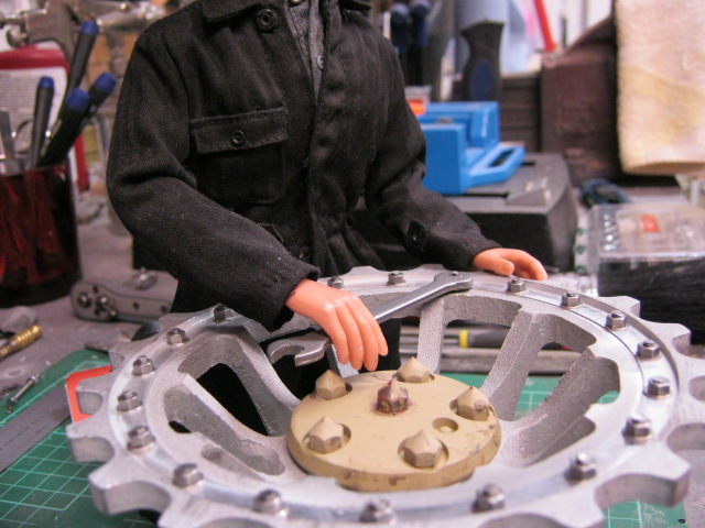

I've not had much time over the weekend so I left the fitters to start building up the new drive sprockets.

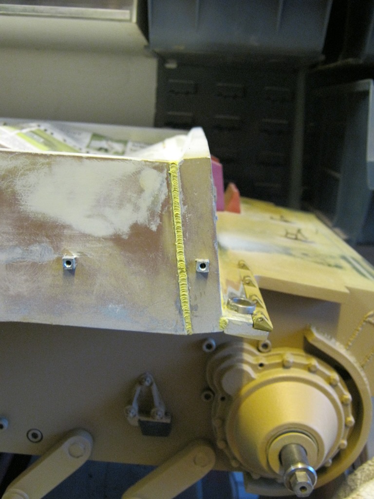

Welds redone

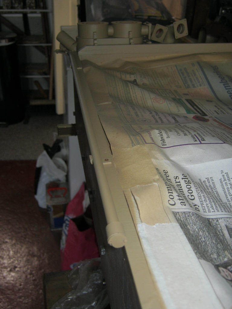

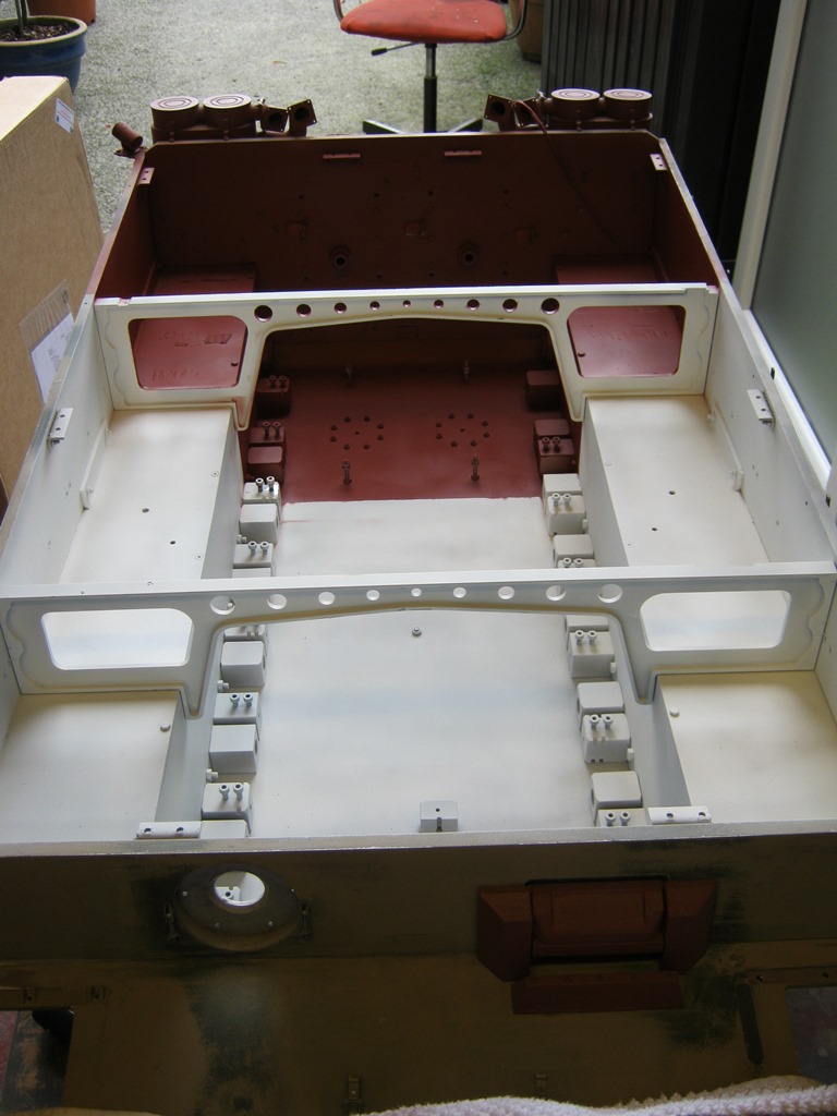

All the suspension is in and I've finished painting the lower hull. I have now flipped her over and I have started on the top.
I have started to add some of the detail to the rear as well as applying the base coat.
Aerial storage tube from Steve Winston

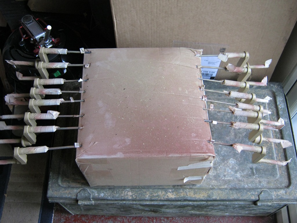

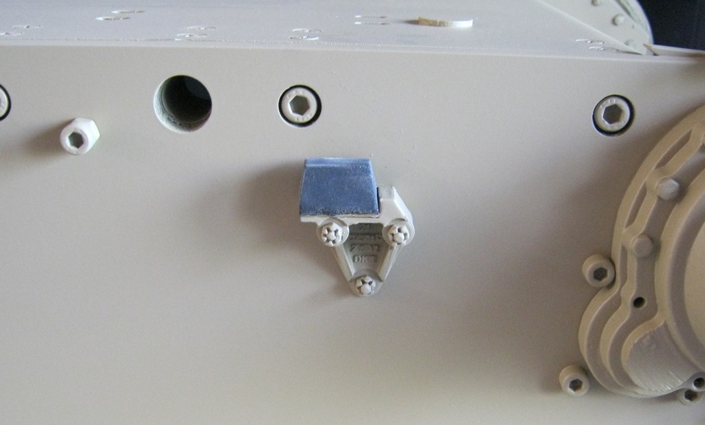

Tim Catton's Fillters and my S-mine launchers
Tool Chest Rack
Tool Chest Rack
Paul. :wink:

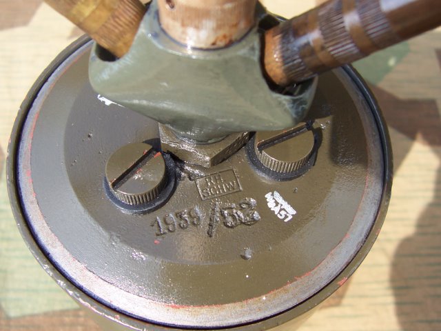

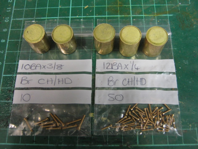

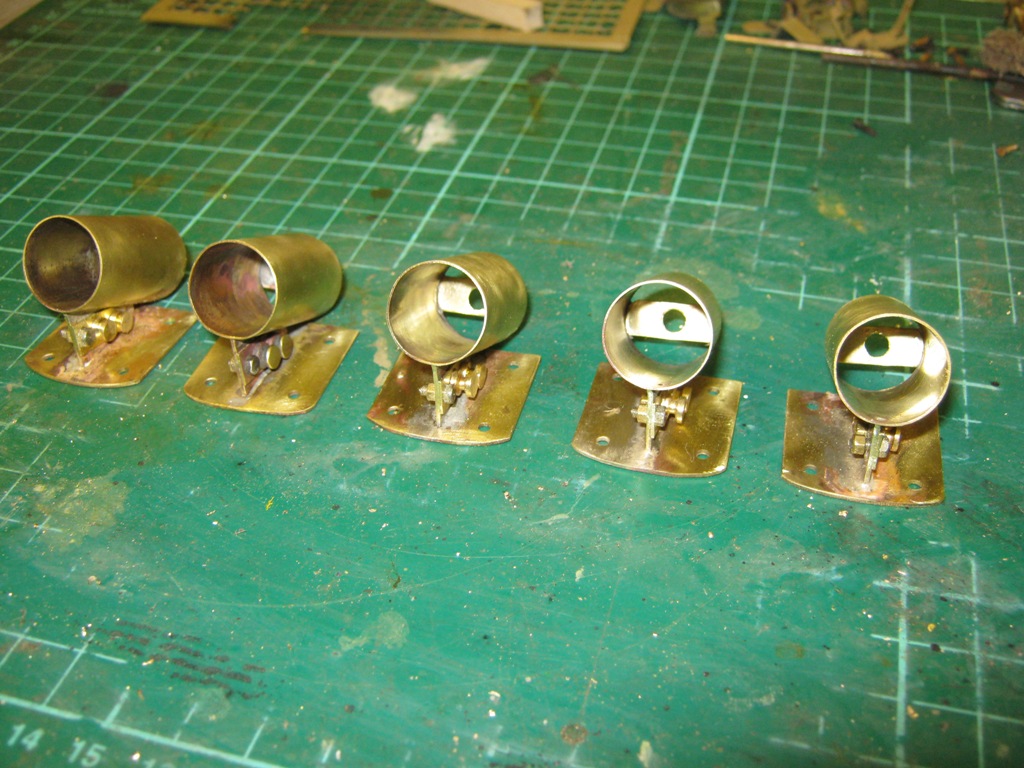

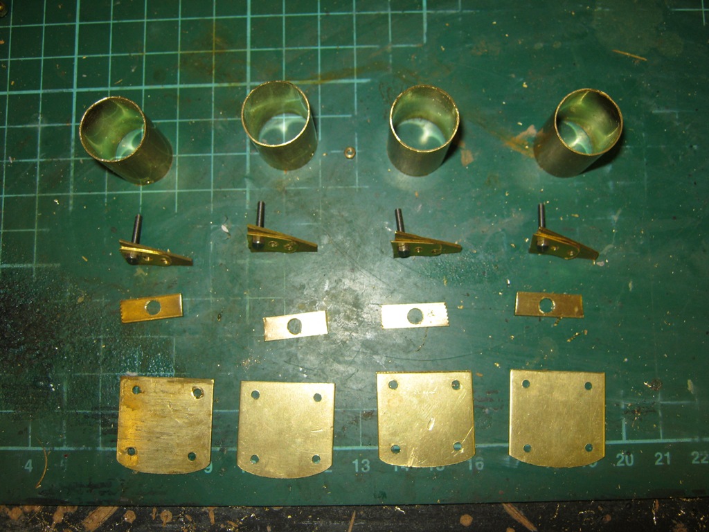

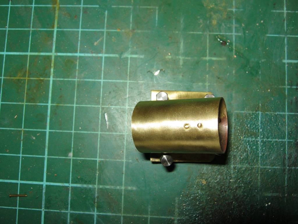

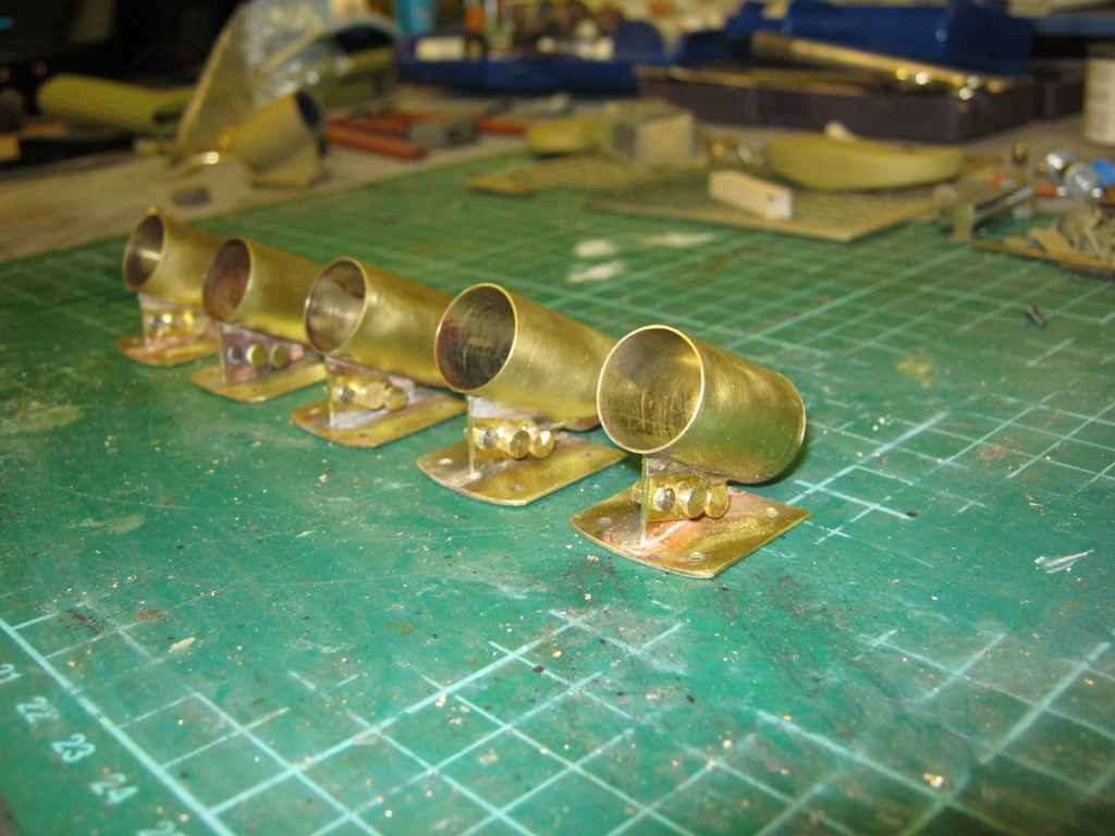

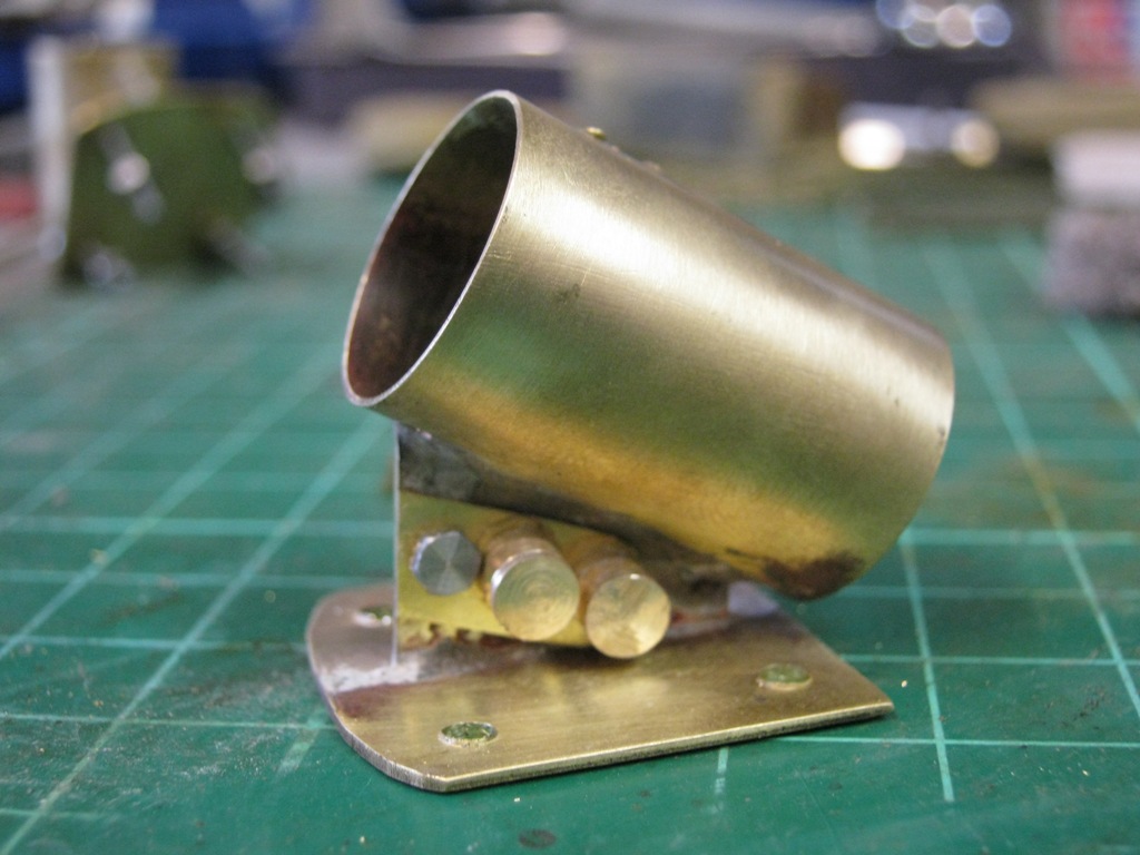

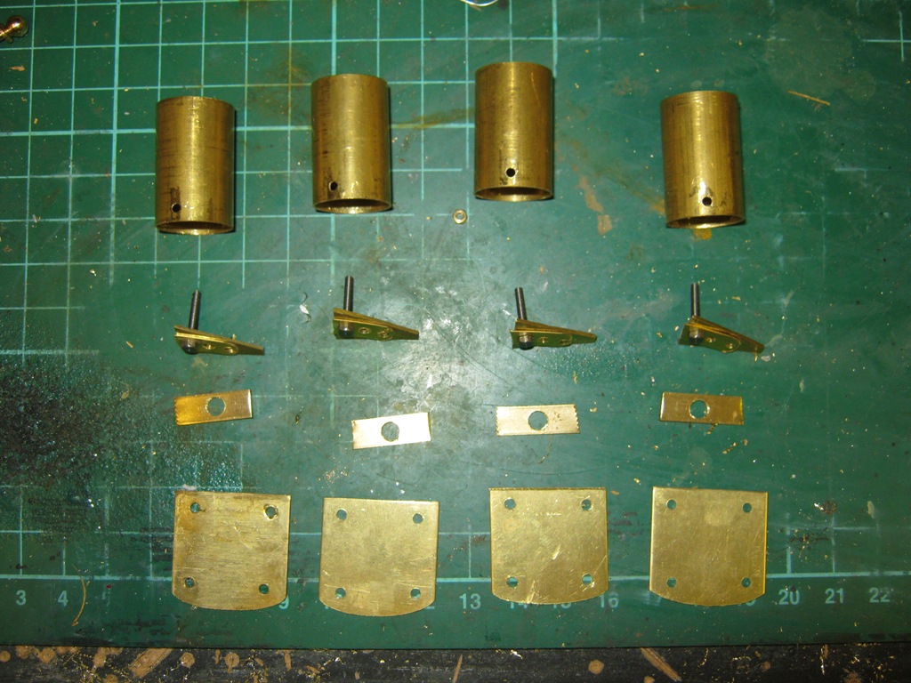

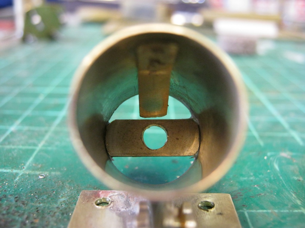

I haven''t had time to do much this week, so I thought I would resurrect this post of mine to show how I made the S-mines and launchers. I made the S-mine launchers and S-mines using David Byrden's drawings as well as the measurements from my own S-mine.
This link is to Davids site and I found him very helpful when I was stuck.
http://tiger1.info/s_mines.html
I used K&S brass tube which was is near as dam it the scale size and some K&S brass strip, some 9Ba bolts and brass bar.
Paul. :wink:

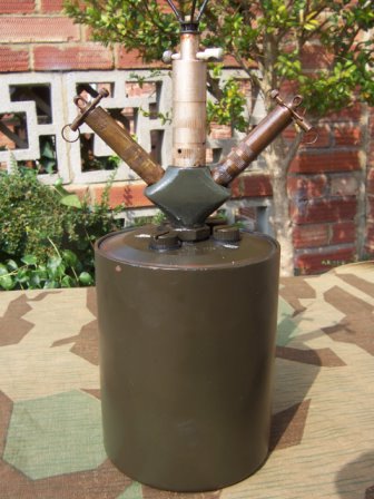

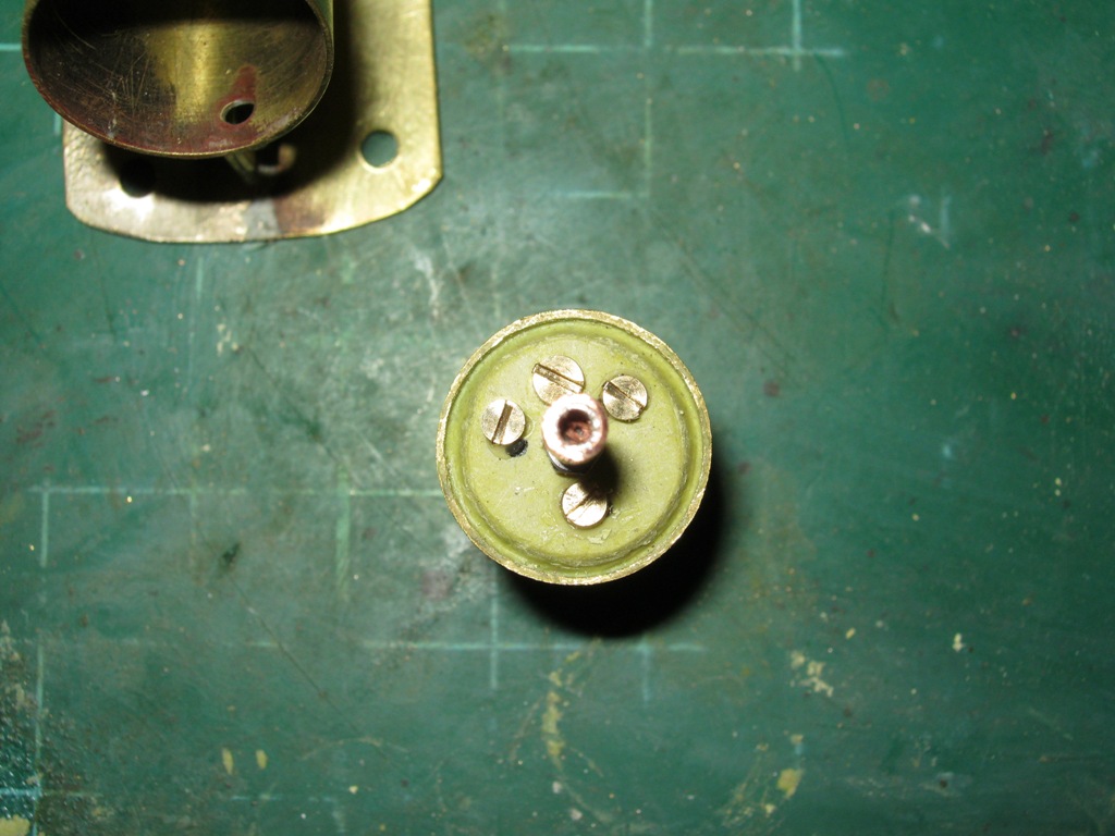

Now for the S-Mines
Paul. :wink:

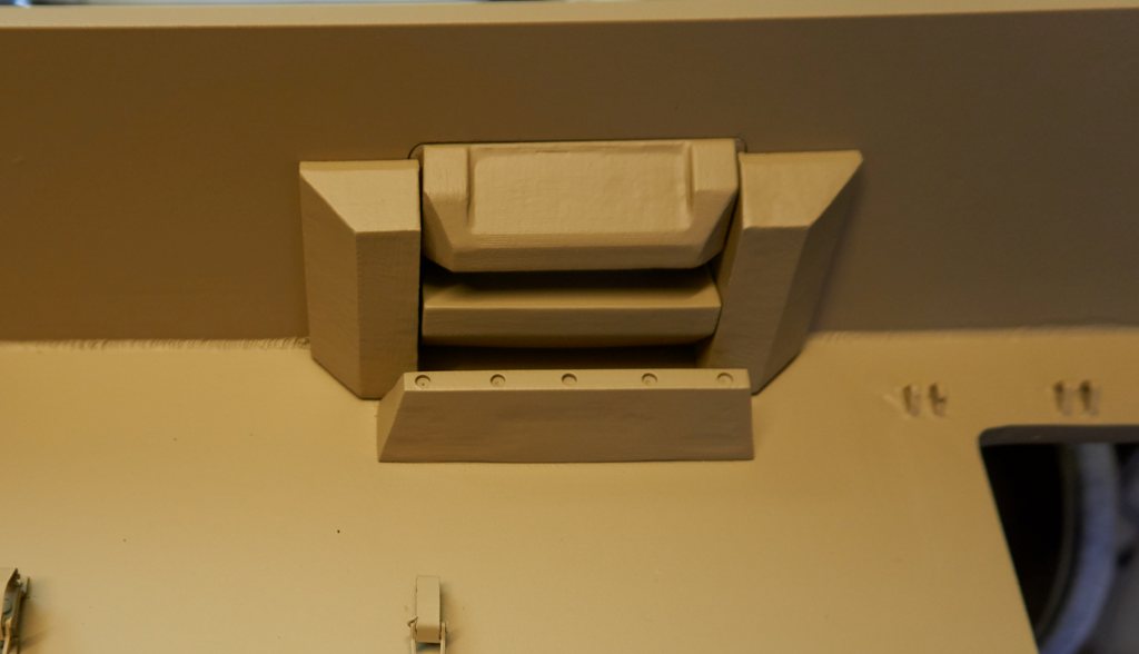

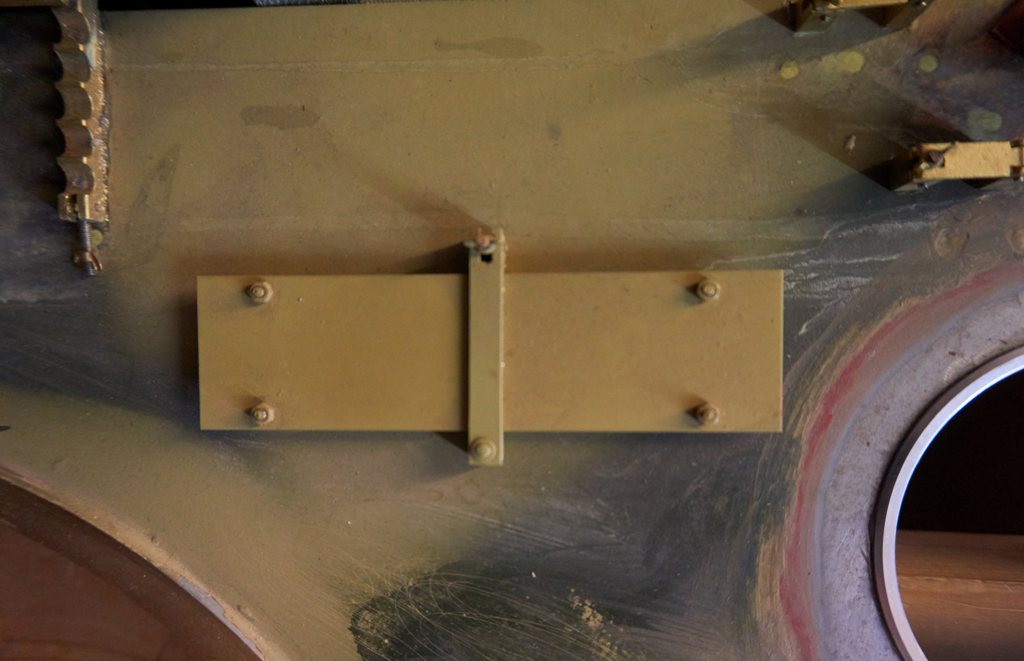

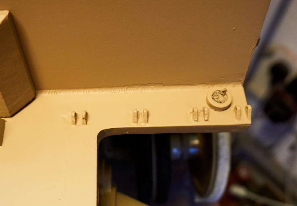

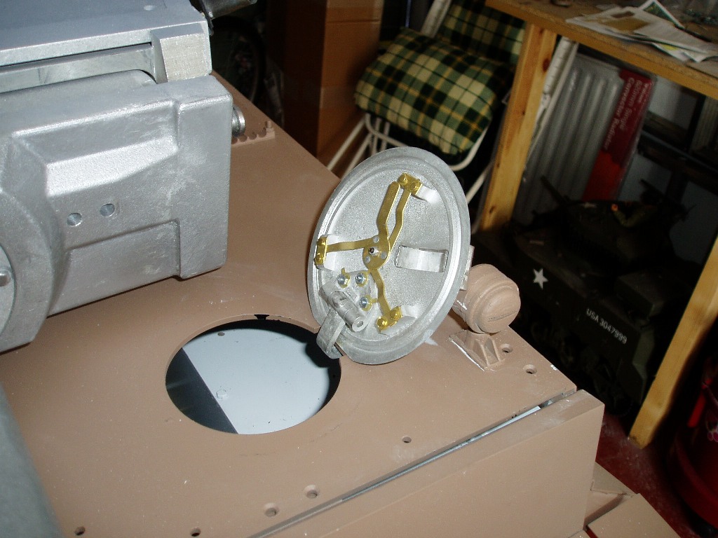

I have finished painting the upper hull and have started working on the deck. I have managed to hide the fillet for the front mudguards this time. a few people said that it stood out at one of the open days, so I've blended it in :roll: :wink:
The original drivers & radio operators hatch openings looked like this.
So I have widened the hatch and added a hatch ring to make it more like the original.
I have also added the engine vent plate as well as new filter pipes to the engine hatch. These where made by Tim Catton.
Paul. :wink:
