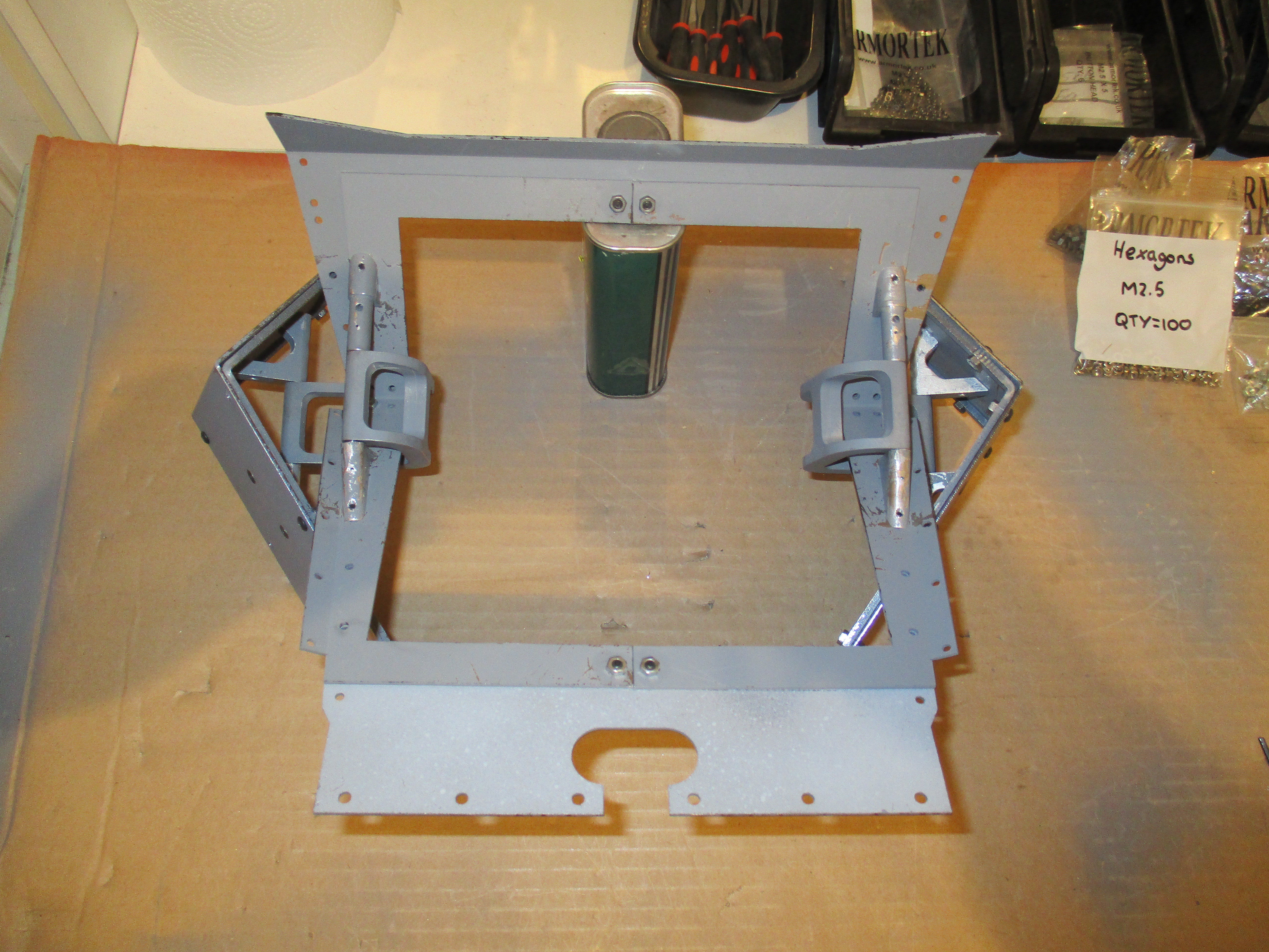

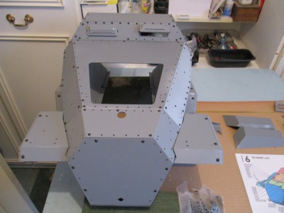

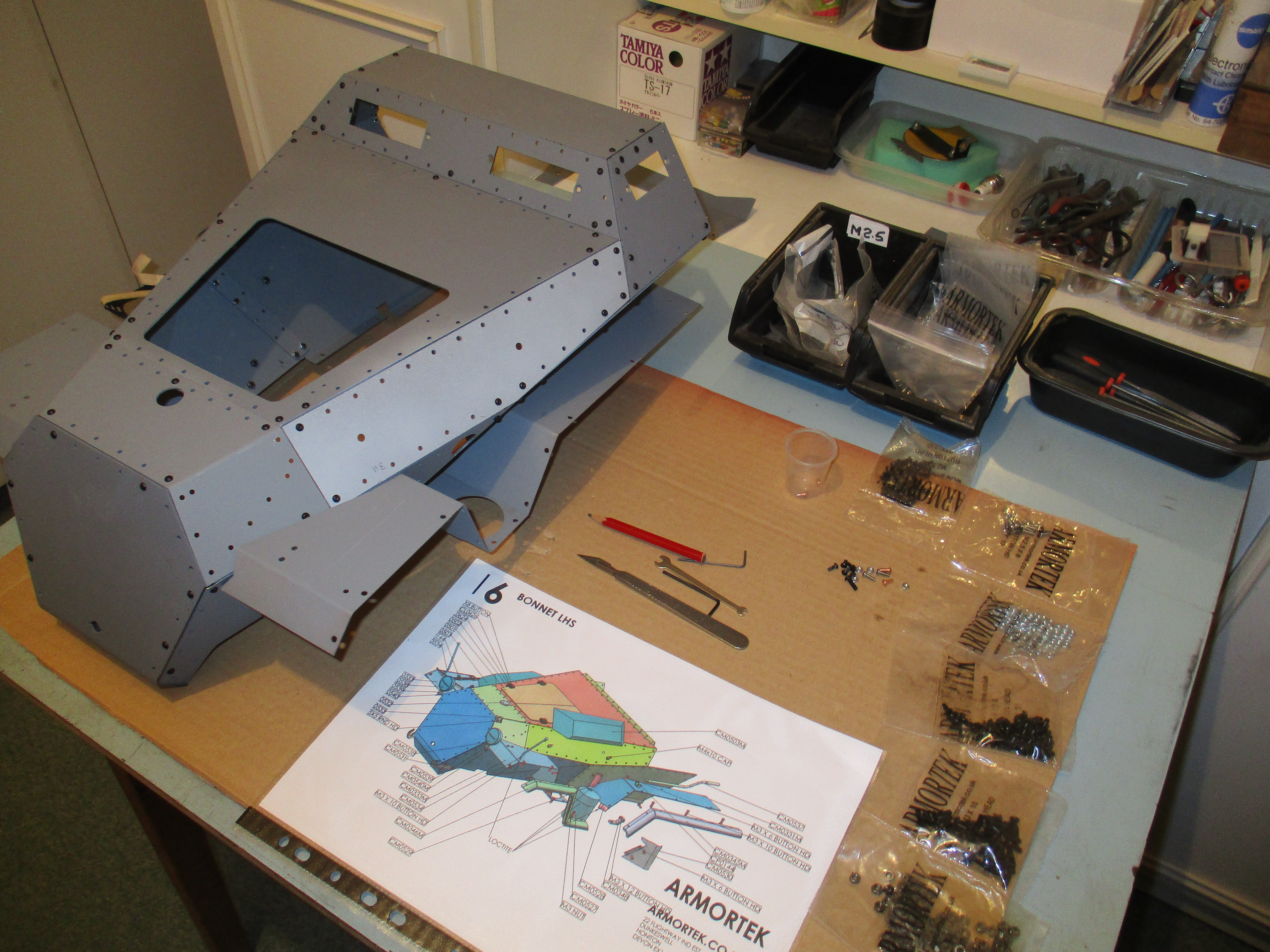

Cleared the decks and started on the 251 front end build, so far so good.....bring on the rivets.

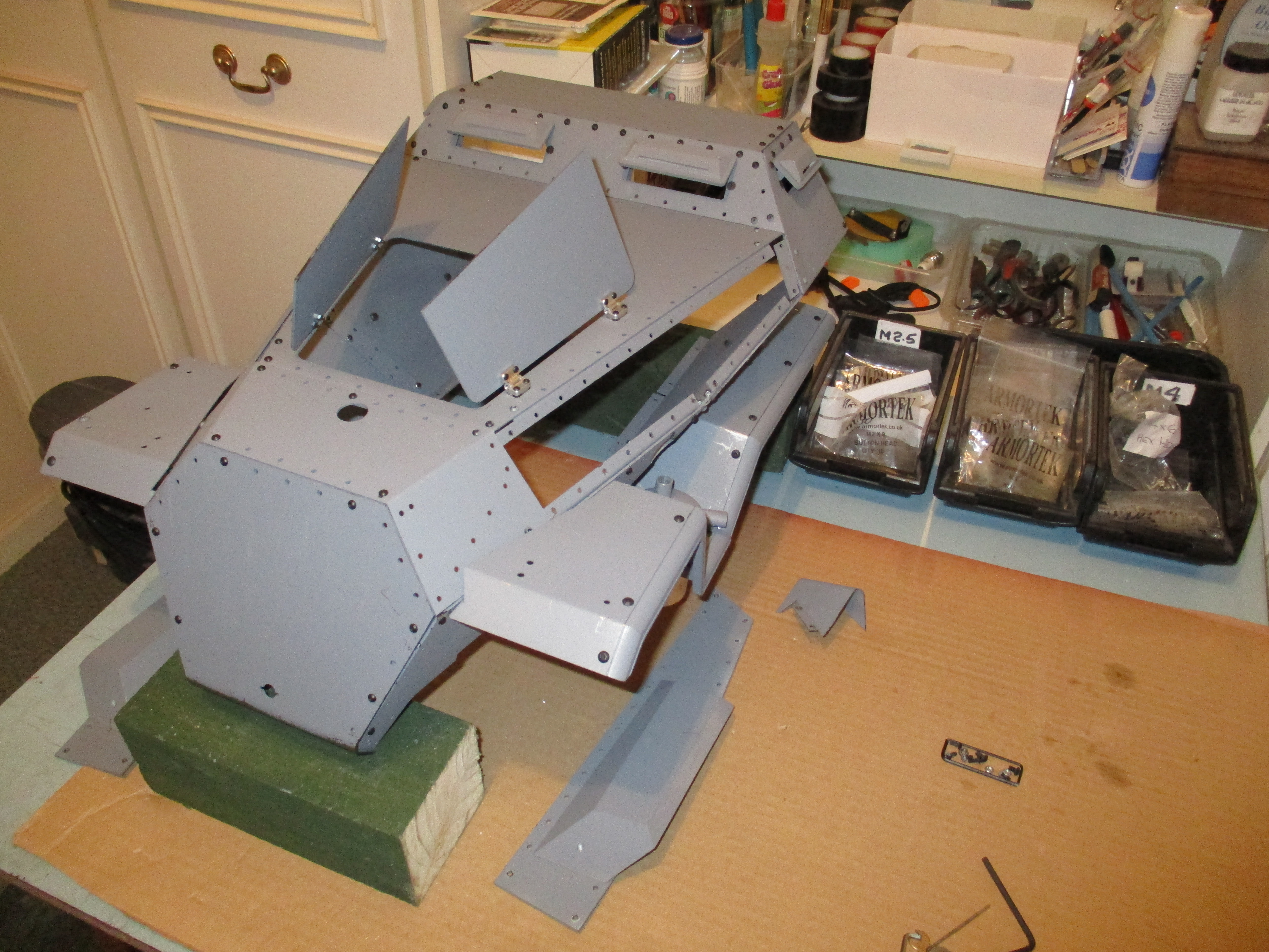

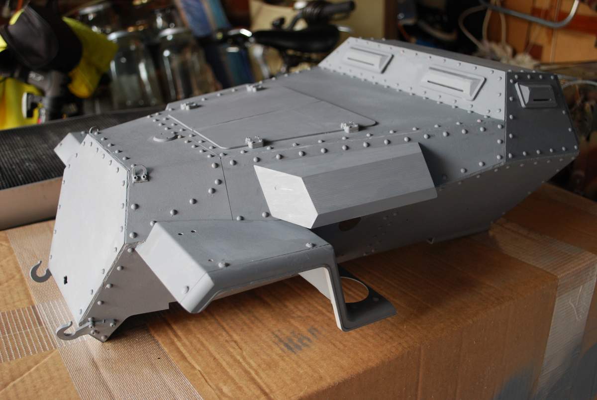

Hi Mick,
You may have to re-drill the holes on CM0311 that secure the side covers CM0503 if you want the top of the side covers to come below the line of rivets on CM0311, I had to. Position them first to see as it would be easier to do before you assemble and rivet. I think my holes had to be about 10 mm lower. Also as you can see from the photo there are couple of rivets that need to be either ground off or left out on the lower edge of the covers. I also rounded off the edges of the covers, looks more authentic.
Dennis.
Dennis.

Hello Dennis, thank you for the advice, I have dropped the engine 'covers' down to expose the line of rivets and fitted a bracket ( as per your photograph) to support the silencer.
Looks more and more like an 'early transformer'......if I close one of the front viewing ports......it winks
