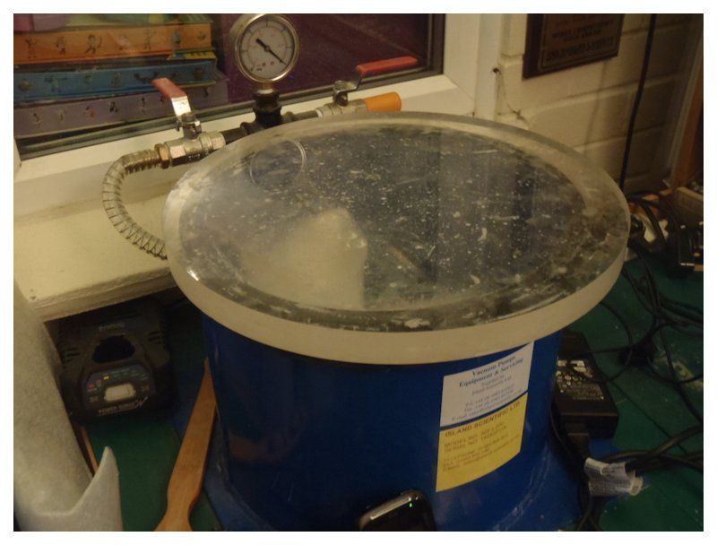

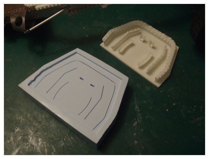

Could you post a picture of the mould? I have no experience with casting but have finished the first brake drum, I might try to cast the second one. The left and right brake drum are identical anyway.

Hi Marcus,
Not sure it will help much as the mould won't deliver these sort of results without a Vac chamber and decent size pump but here you go.

That is some equipment! Way out of my league…….
I was only wondering how you did cast those undercuts, mould is very flexible so to see.

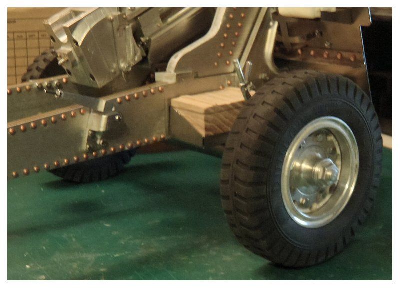

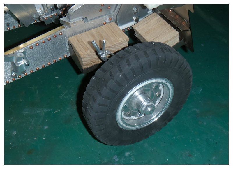

I got up the courage tonight to take the sanding drum and finishing block to the first tyre. Its the same as I did on my WMIK as I felt the profile was too hard and angular.
It doesn't show to well in the pics tonight because of the lighting but if you look at the last pic you can see the hard edge on the rear tyre that has gone on the front one.
Its messy and I don't recommend this unless you are sure you can get a reasonably even profile without cutting to deep. I do however much prefer the tyre with the softened and worn edge.

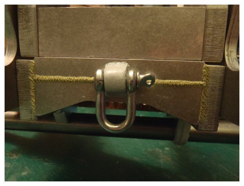

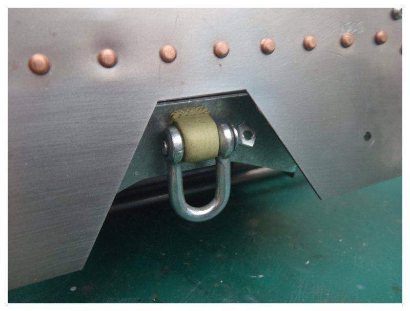

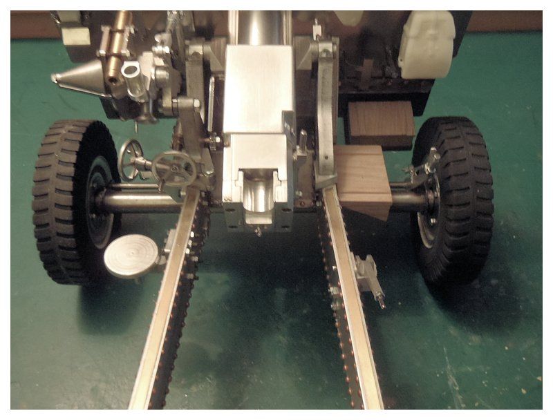

Had a head cold all weekend so building has been limited to simple things I can see properly.
I've made the shackle assembly for the front under the shield and will be offering this with the all the other bits once done.
If I can get the Christmas decorations and everything out of the way I may tackle the axle retainer castings next missing from underneath.
I've bought some more strip wood and sheet to make fully detailed storage boxes for the trail and front shield to replace the solid machined wooden ones.

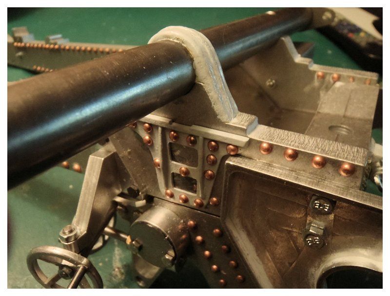

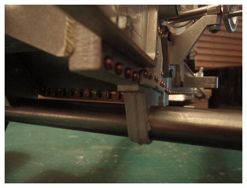

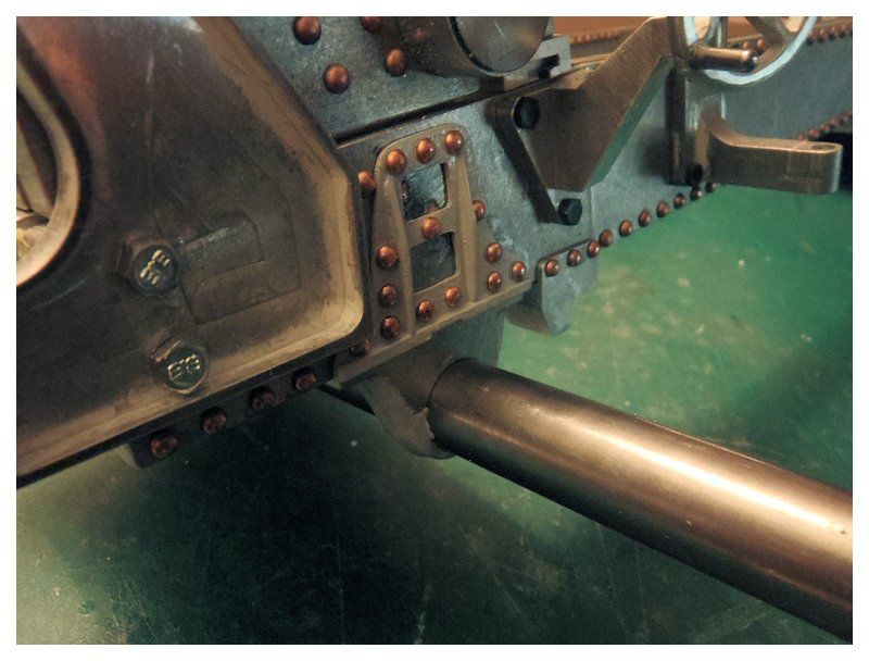

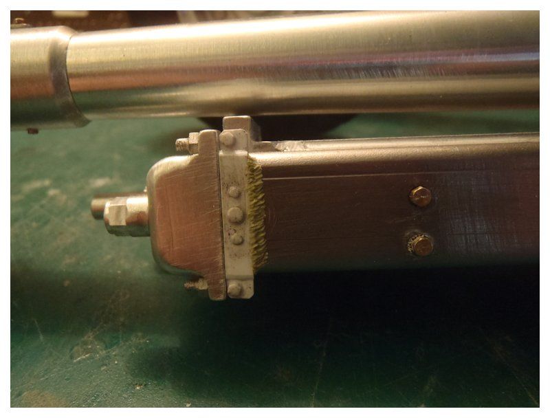

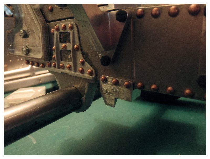

The axle castings have been made and the side detail plate to go with it. Only doing one of these side plates as the other side is covered by the storage box tray. Also made the last bit of detail for the recoil slide nose casting. All these bits will be going into moulds shortly.

O yes!! That looks the part!!
I just finished the same axle support plate...... :D (minus axle castings). You have even fitted the rivets! I have to speed up, to keep up!! :lol:
