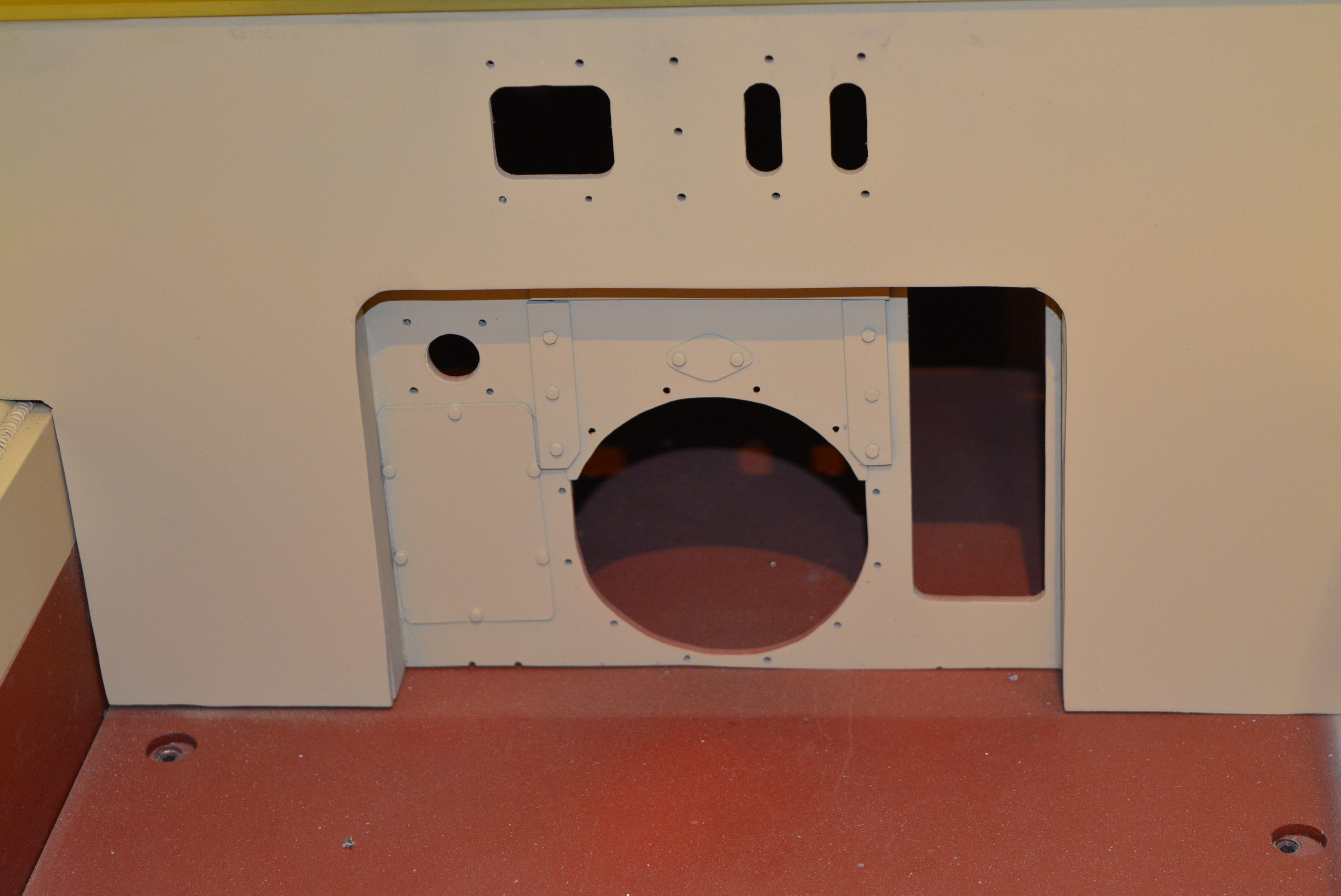

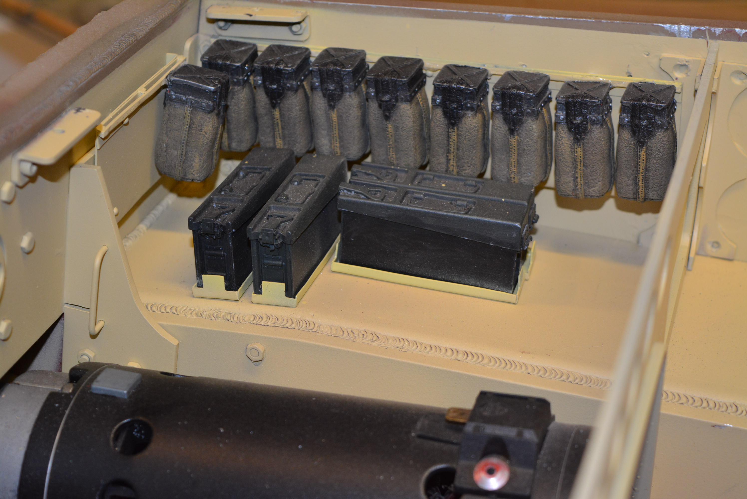

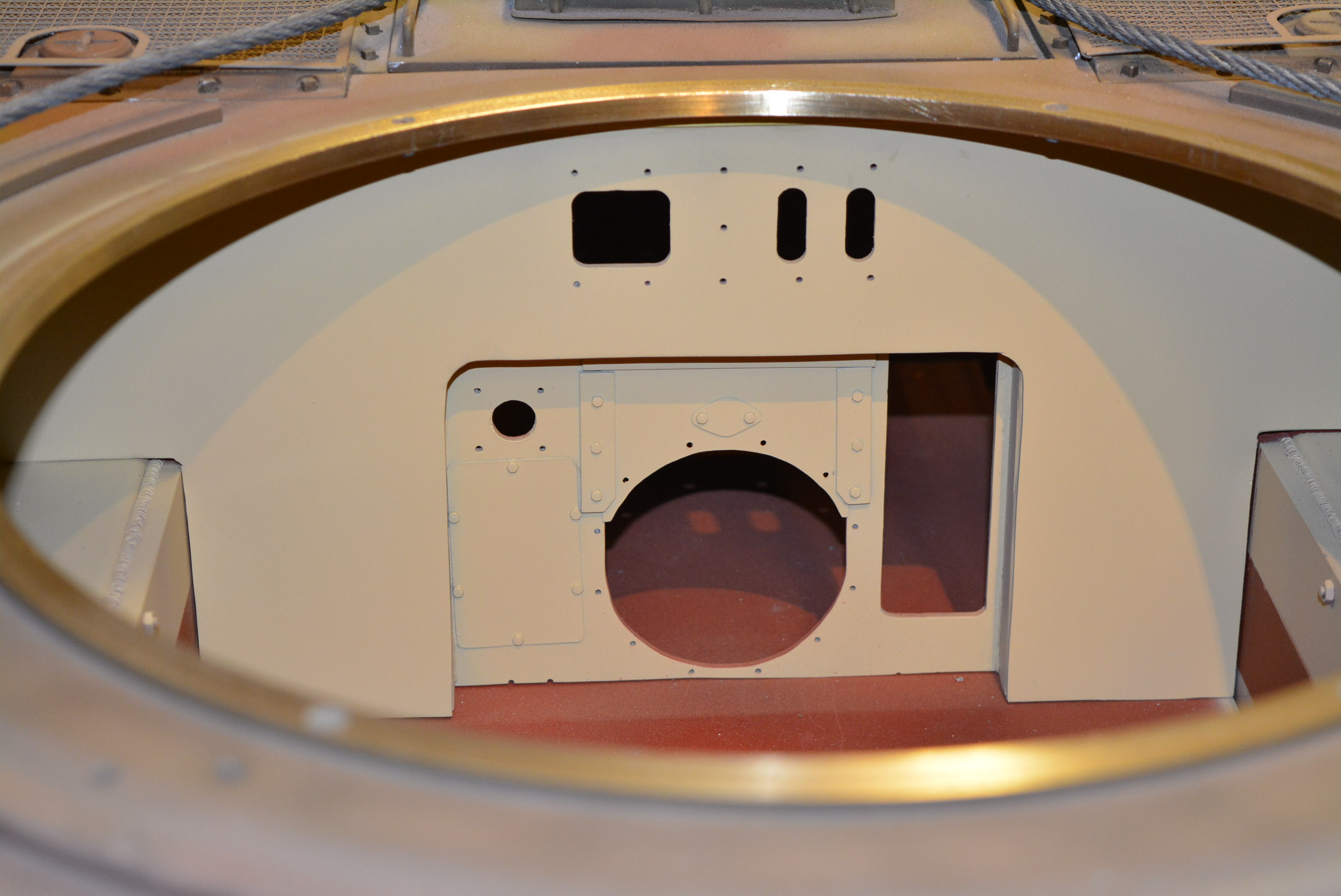

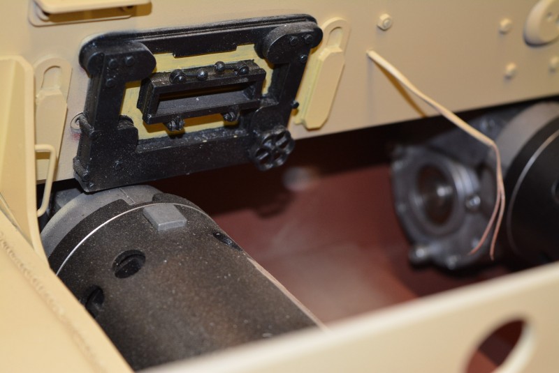

Sorry for the long break in posts. Some work on firewall. More to add.
A few updates
A few updates

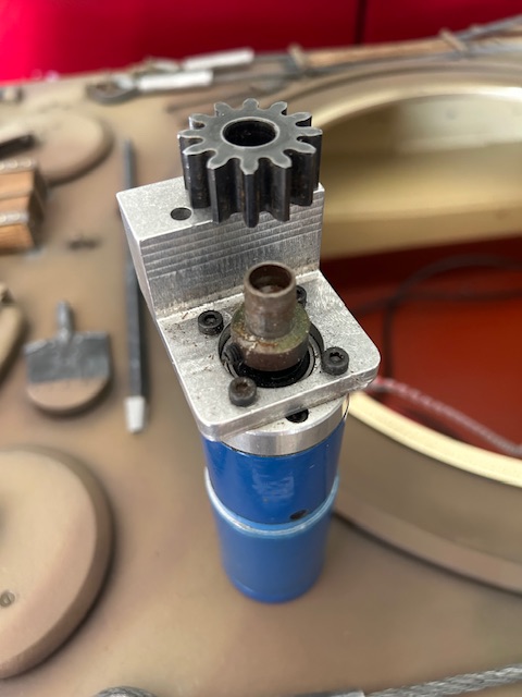

I have now fitted the motion and sound packs to Tiger 312. The packs have been in storage for a long time so one or two problems. I will post a video later. The main problem was the gear to drive the turret rotation. This was fixed originally with an adhesive which has failed with time. Kian and Adrian have suggested correct adhesive is loctite 638. I will try this. Other than this, everything sorted and another Tiger ready for running.

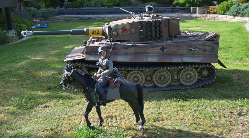

Below, a great picture of Tiger 312. You can see driver and radio operator poking their heads out of their hatches. Not possible from their seating positions so probably on the sponsons or standing.

Here is the problem turret motor gear. To be re attached with loctite 638

In the last video I ended with a turret motor gear problem. The gear has been refitted with loctite 638 as advised by Kian. This appears to have done the trick although I need to file the brass turret ring a little more and lubricate to fully free up turret movement. I did finally get the Tiger off the work table and into the garden for a short test drive.

I have more work to do on the turret. The turret is still a little tight in the turret ring so I am not using turret motion for now to avoid strain on the motor. On advice of Kian I have fixed the turret gear to it's shaft with Loctite 638 and it appears to hold well. More testing to come. I have a short piece at the end of the video on fixing the gear. Hope you enjoy the video and please subscribe to the channel.
