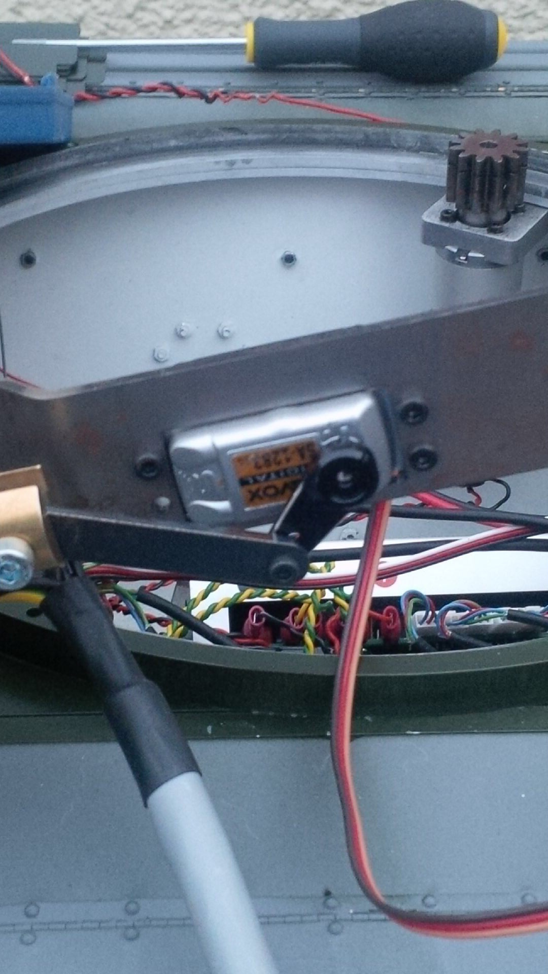

I feel I've reached a milestone in my build, and finally got the recoil working. Well.......almost.
On firing the gun, LEDs flash correctly but the barrel moves forward first then backwards. It also seems to cycle twice sometimes, but not sure if that's down to me not deselecting "fire" quickly enough.
As regards the barrel movement what have I done wrong? I'm convinced that all wiring is correct. Could it be so simple as the servo upside down? My installation matches the instructions with the servo spindle on the right, as you look at it.
Any suggestions gratefully received.
Thanks, Kevin
Posts: 5130
Has liked: 1481 times
Been liked: 1687 times
Re: Centurion #18
Wouldn't it work correctly if the servo arm started at 10 o'clock instead of 8 o'clock, in your photo, so that it starts above the centre line of the barrel :?:

The diagram on Page 7 of the recoil instructions shows the recoil system, albeit fitted to a T34, with the dog-leg of the servo sitting above the centreline of the barrel.

seen the problum with your recoil servo, Had the same problum when building my centruion. the way i worked out the servos setting was. With the servo drop arm discornected at the push arm, I powered up the control system which allowed the servio to innailaise and stop in its full forwared postion. You need to fire the gun and observe the servo arm movement. the arm should swing from approx the 8 oclock postion anticlock wise to the approx the 4 oclock postion, then return slowly to the 8 oclock.
Keep the servo powered up & set the drop arm at the 8 oclock postion. Once you have the correct servo arm swing, ( it took a few atttempts to get it just right) Power off and power on the servo will reinatillise and rest at the 8 oclock postion ( barrel forwared), cornect the barrel and test
Hope this helps you Dave N centurion 25 aka brenda
Kevin Hunter
Posts: 564
Has liked: 605 times
Been liked: 147 times
Re: Centurion #18
Post by Kevin Hunter »
Hi Dave
Thanks for the advice. I did all that per the manual, but with the servo arm at 8 o'clock the barrel goes forward. However....
Adrian. - simple logic, probably obvious but not to a novice following the build manual , :oops: In the Cent manual, the crank arm is definitely pictured below the centerline. My servo arm now repositioned above centre to the 10 o'clock position and .... Bobs your uncle!
Thank you both for your help.
