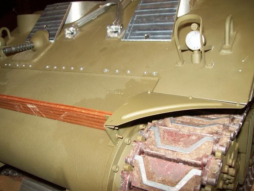

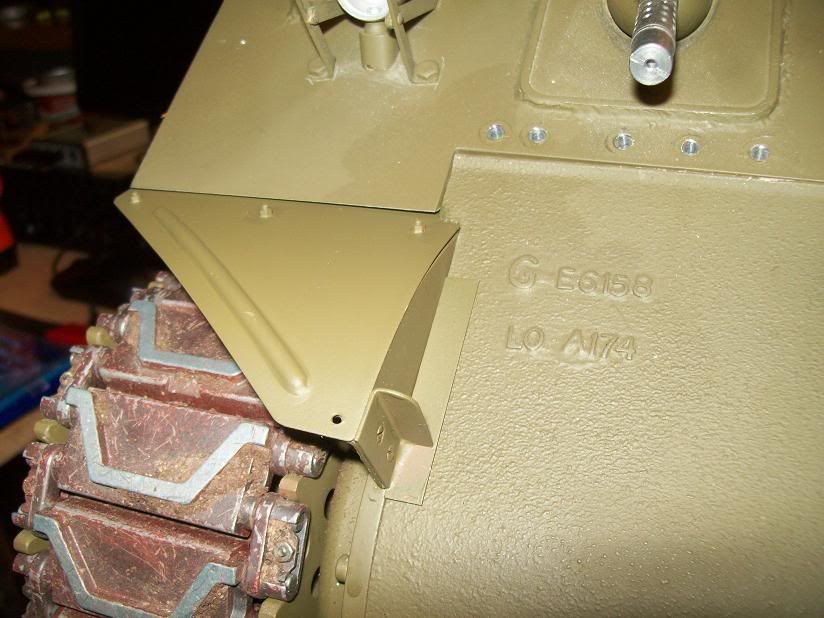

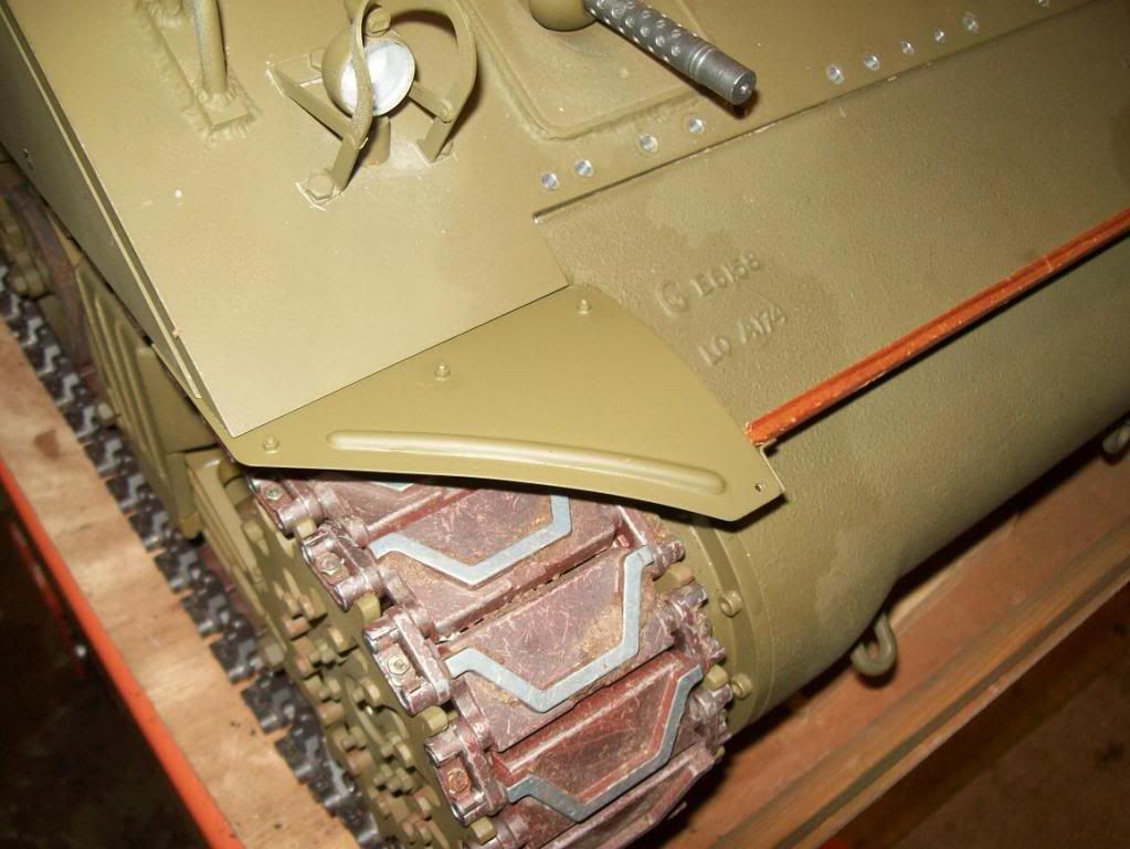

Heres some photos of the new fenders all painted up. Thanks for looking. -Bob

Robert,
I didn't realise that there was supposed to be a plank of wood between the uprights on the mud guards. I presume its for wading to keep the water from flowing up the front. I just thought that the flanges of metal were stiffners.
Allan Richards
Posts: 2351
Allan,

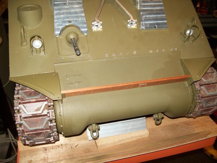

The plank doesn't especially have to be there. It does make a handy shelf for piling ammo boxes and sandbags onto. I cannot take credit for it - resourceful GI's did it during the war. I added it as a "what if ". I'm debating on having the plank shelf or mounting some spare track in the front location on the glassis. Thanks for sharing your thoughts. Regards,

Hello Bob
Leave the plank there. I think that the sherman looks better with all the ammo boxes and ration boxes on it. Have you got the book on the sherman by Hunnicut? If i manage to pick another Sherman up i would put wood planks down the side of the hull. Keep the Piccies comeing 8)

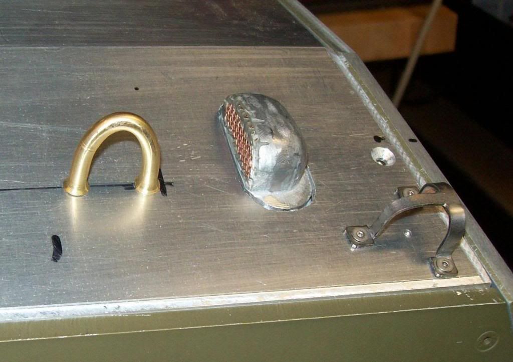

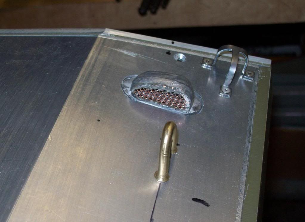

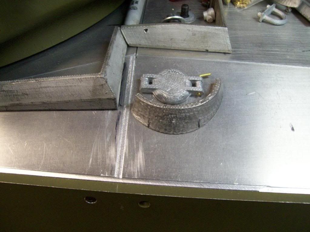

Hi Lee, thanks for the "plank" feedback. Still may go with the spare track links on the front, but I agree with you boxes and bags would look great up front. Esp mini C ration boxes. Yum. :P Don't have the Hunnicut book but I've heard it is very good.

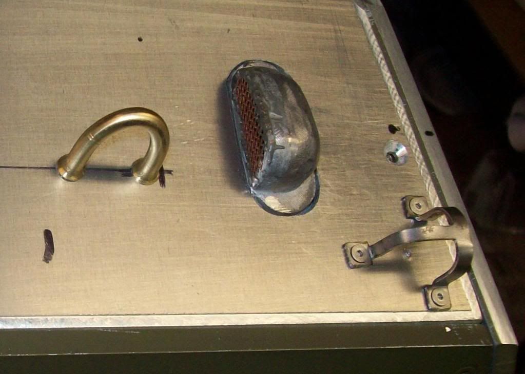

I have a few more pics of some recent but miniscule progress on the rear deck- but progress just the same. Made the lift hook straight then bent it to shape. Machined a slight recess for a weld fillet in the deck plate, placed one fuel filler cap and its gaurd, and installed the tail light gaurd. Hope u enjoy. 8)
