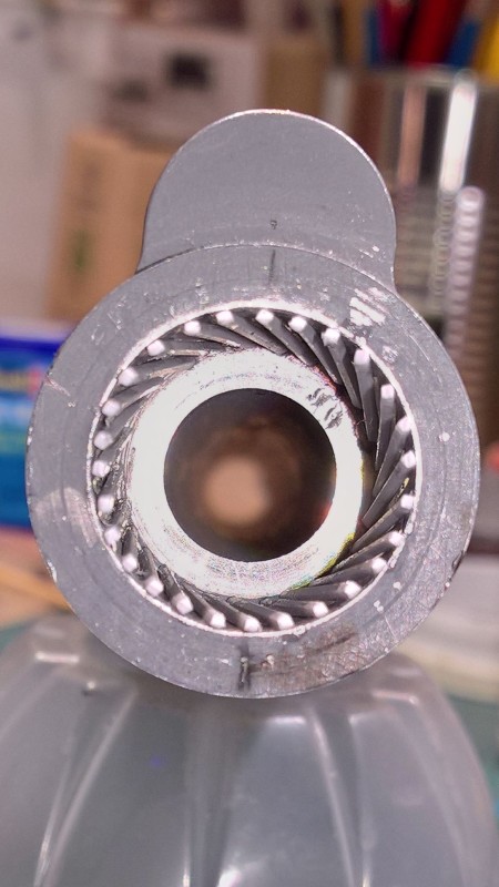

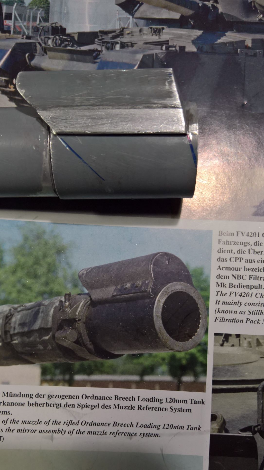

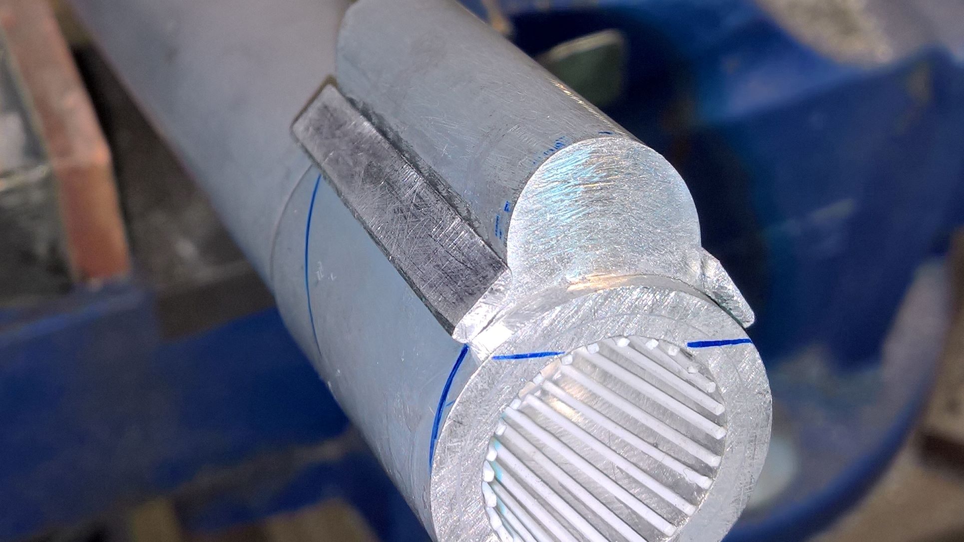

Another little snippet, just to keep the Chieftain interest going. There is a lot to do, don't get me wrong I am not moaning at tall, its a great challenge
The end of the barrel has been sitting in the house for ages, I keep looking at it and the books, it's cold outside: So here goes. I'll let the glue dry before some filler is applied to blend those "cheek" bits in. The little plate will be bolted on afterwards. Cheers for now.
Charles
Charles

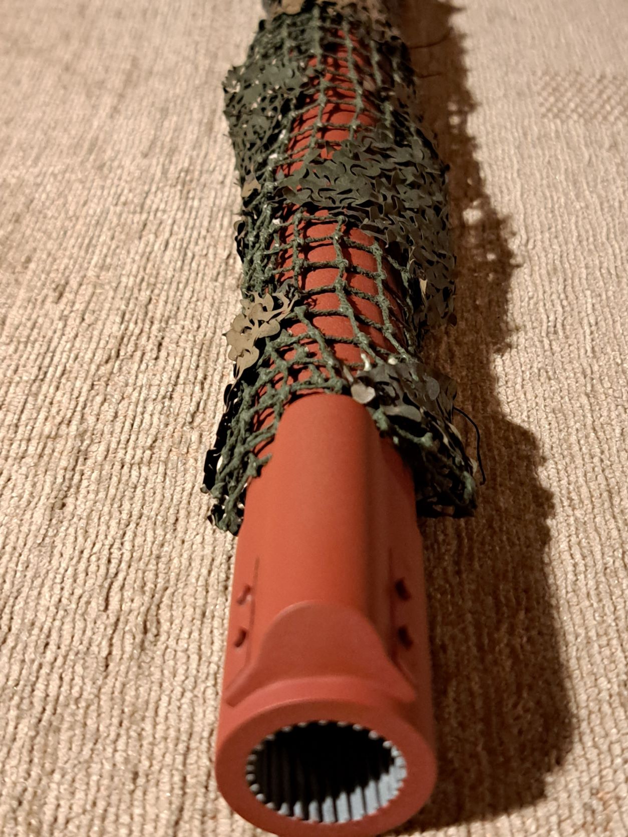

Cold, Again. anyway another snippet, I will not be one for sitting around and do nowt due to the weather, forever pottering, that's me.
Tweaked the muzzle, again, adding the bolts.

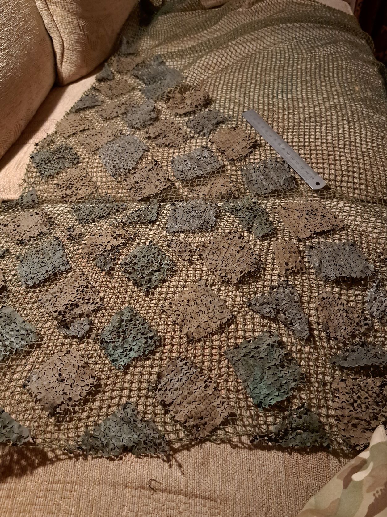

Started "knitting" camo, that's what it feels like, camo for the Chieftain that is, my humble efforts so far:-
Also working on a general camo net for the Chieftain:- This could be tailored to hide all sorts of things, possibly
Cheers Charles
Cheers Charles

Your rifling came out perfect - can't say I would even attempt that. Well done. Love the camo net! Looks great for modern tanks.

Thank you Robert for our post, dark winter nights; sewing a camo net by the fire, it just dosen't get any better

I did try .5mm plastic rod but that tried my patience just a bit, so opted for .8mm instead.
Not being a "rivet" counter, I believe there should be 32(ish) lands, I am happy to settle for 27 as a representation though.
Charles

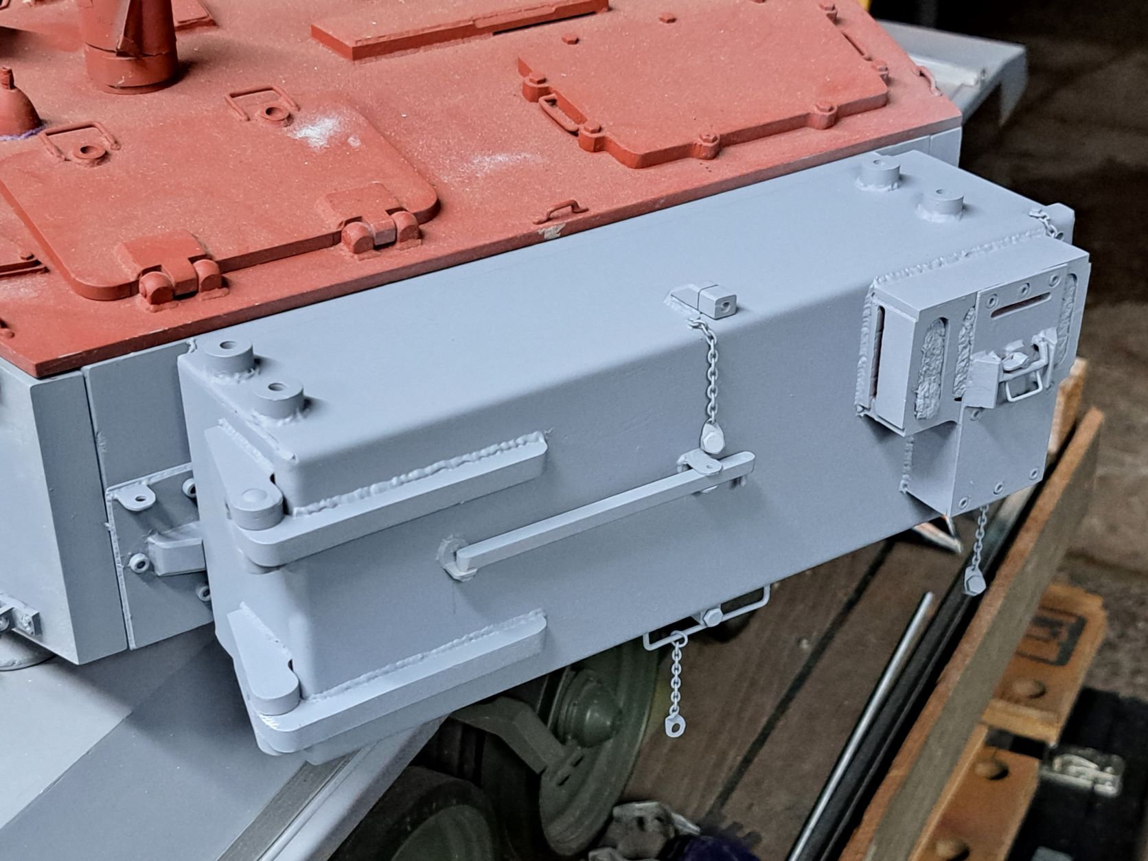

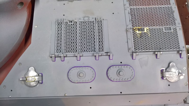

NBC box again; raised the intake unit, as usual I hadn't noticed until after the event. I am working on this affliction though, lots of studying. Scratch built the thingy, which I assume is the inlet to the turret from the NBC pack.
There will have to be a bit more tweaking by way of a compromise, I will let you all in on that at a later date.
Cheers for now.
Charles
At last some warm weather, well it is up here (12deg.C) as we type!!
Cheers for now.
Charles

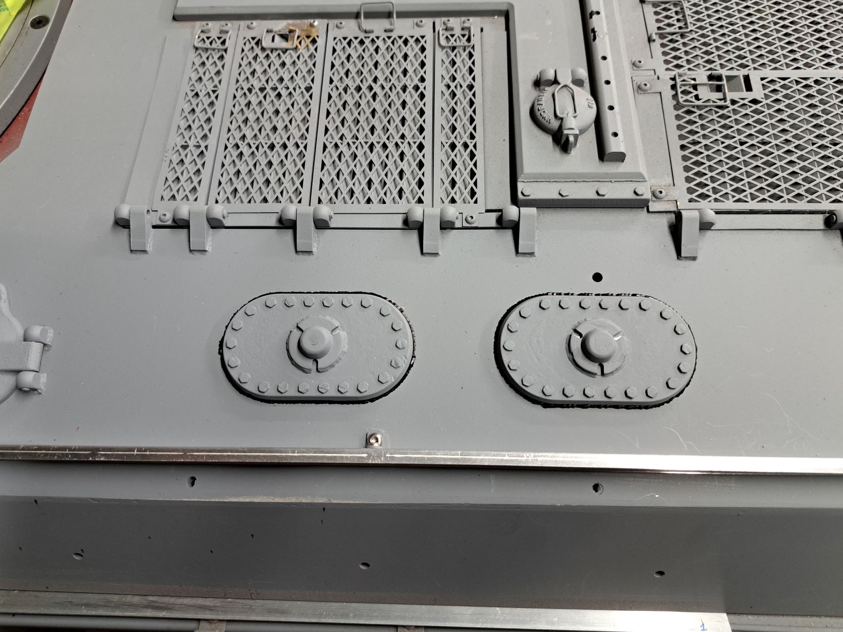

Good evening to you all.

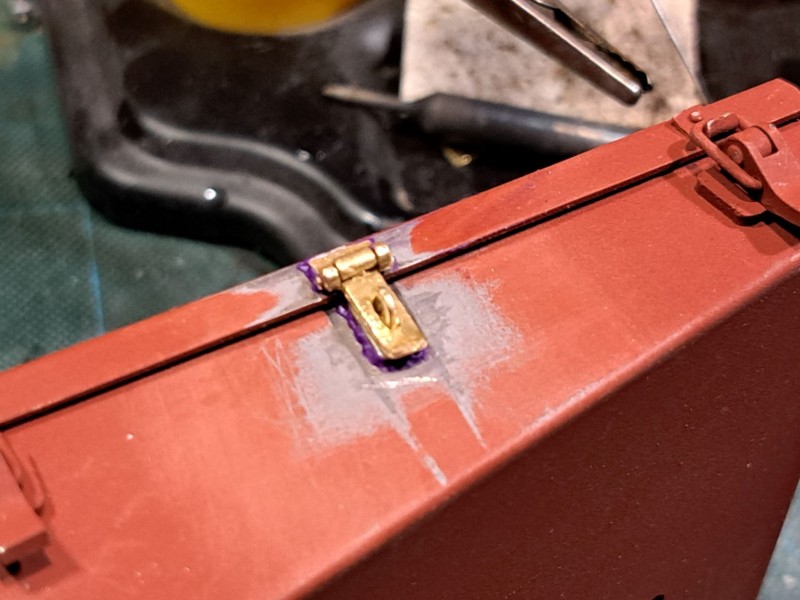

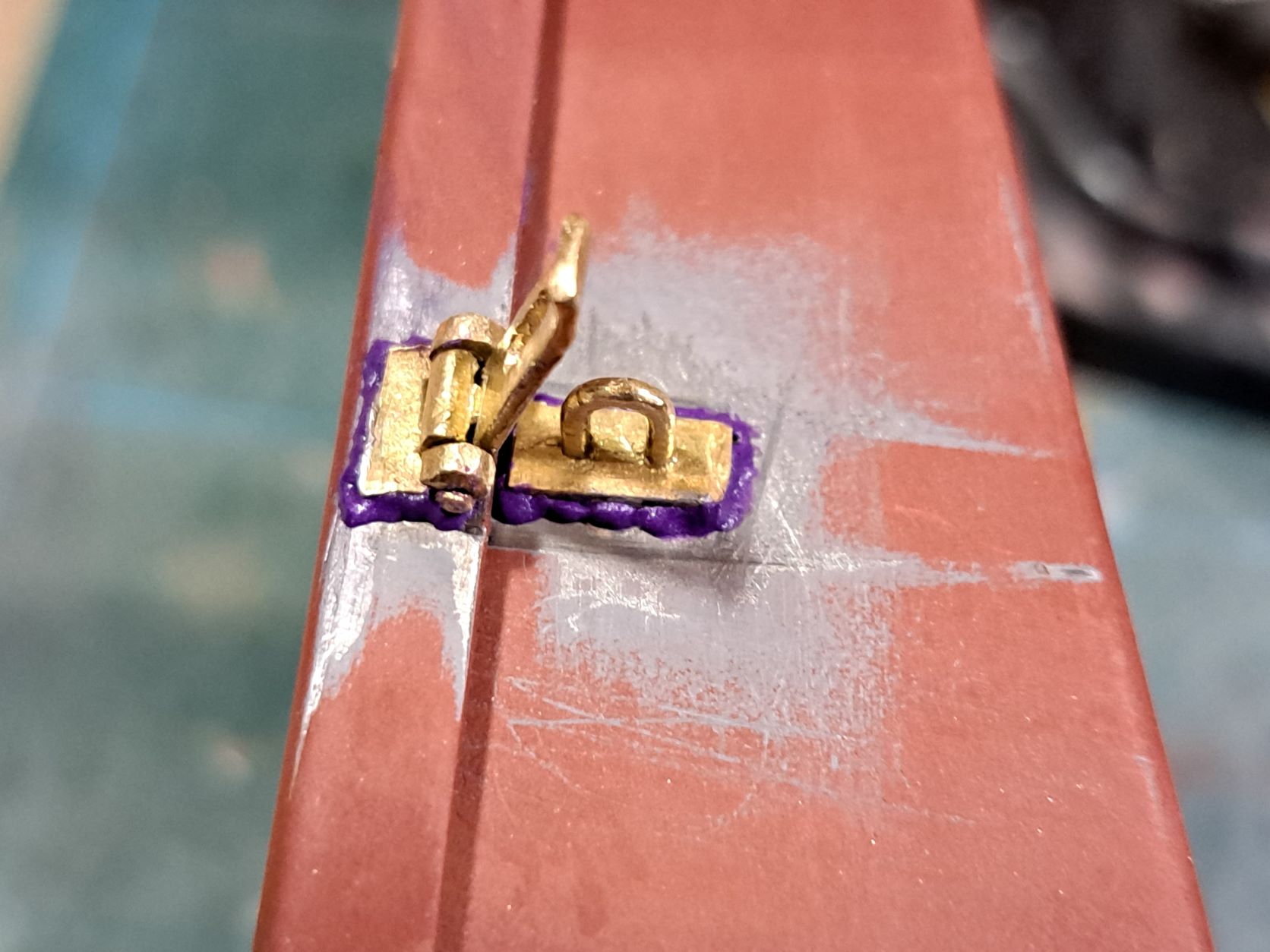

A small job done this evening, only another 10 to do, but as this one went well (I hope). I have soldered the brass to the steel followed by a bit of fabric paint as weld, after sanding it all down.
All seems sound at present, but as always, I am open to suggestions for improvement.

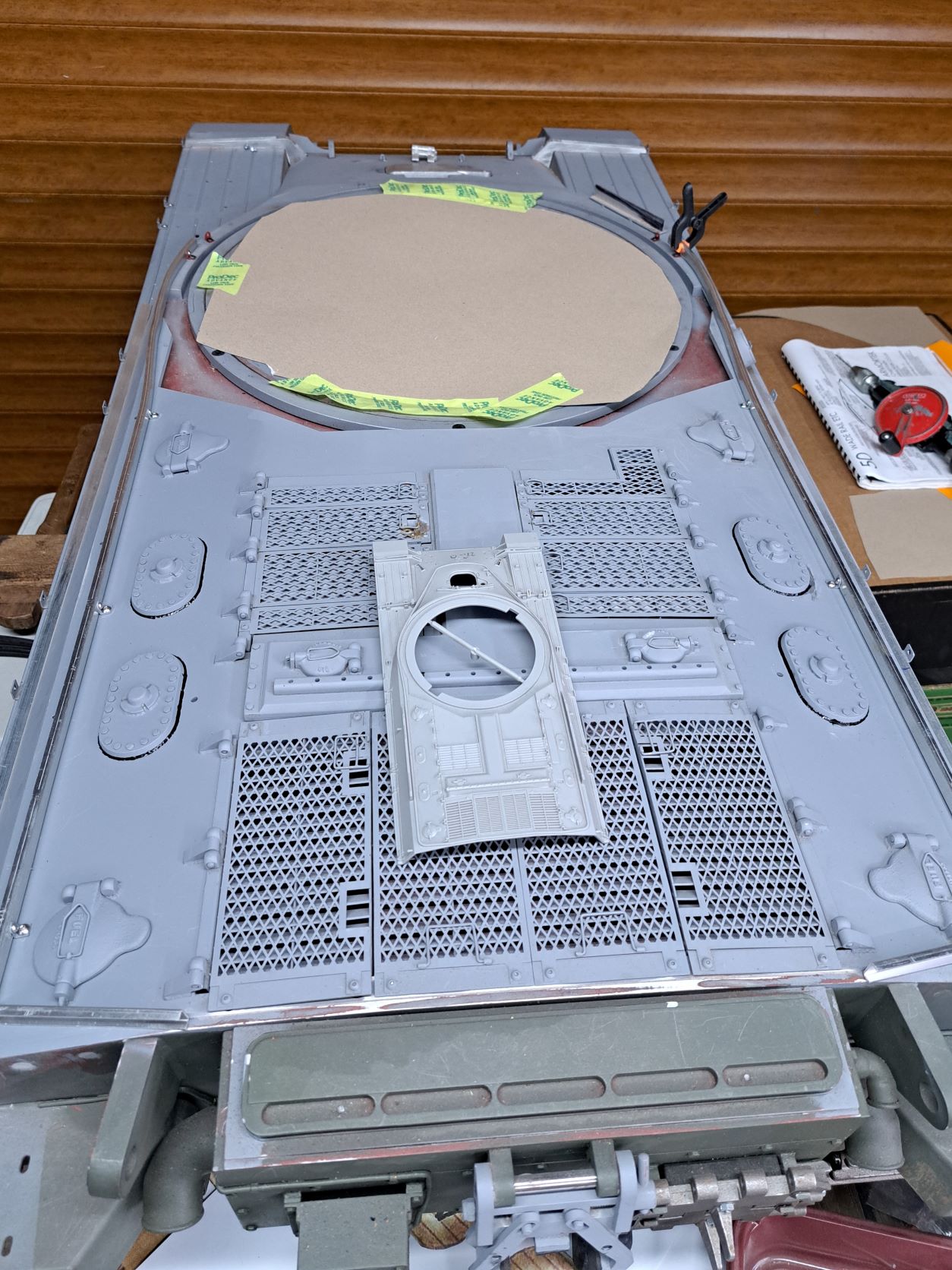

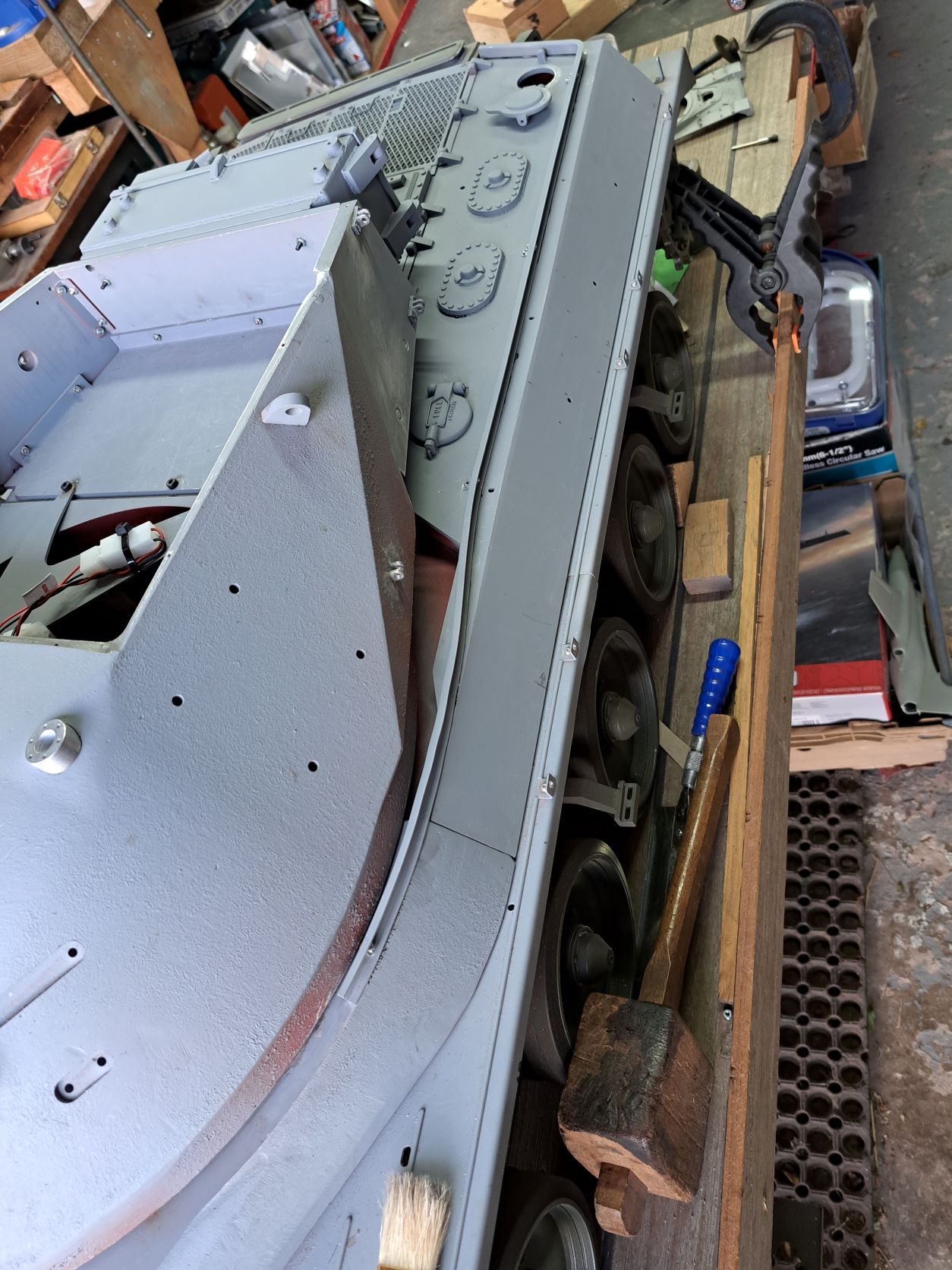

Apart from the above I have been able to do some jobs on the Chieftain without my digits(fingers) falling off after ten minutes. The main things I have been doing is to clean up the boxes and other bolt on parts, then bubble wrapped until the weather will allow me to apply NATO green, like this front box:-

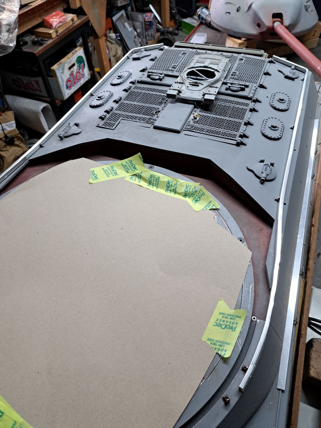

With the enthusiasm of a newby, back in 2020, I charged into the kit (forced to stay at home at the time had something to do with it too). Fortunately I was able to release the previously fitted fuel vents and mill actual vents into (onto) them:-
Today I had a go at fitting the Wading rails, I would like to fit the turret back on to check rotation/clearance, but will have to wait until the wind shifts; Again
before I can open the garage door.
The Takom kit part helped as guide.
Hope you all have a good and constructive weekend.
Charles
The recent weather here is like being on a cross channel ferry(in my experience anyway): open a door and its wrenched out of your hands, followed by a face full of water
All good fun
Charles

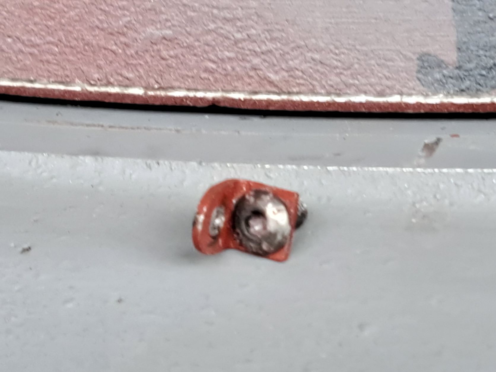

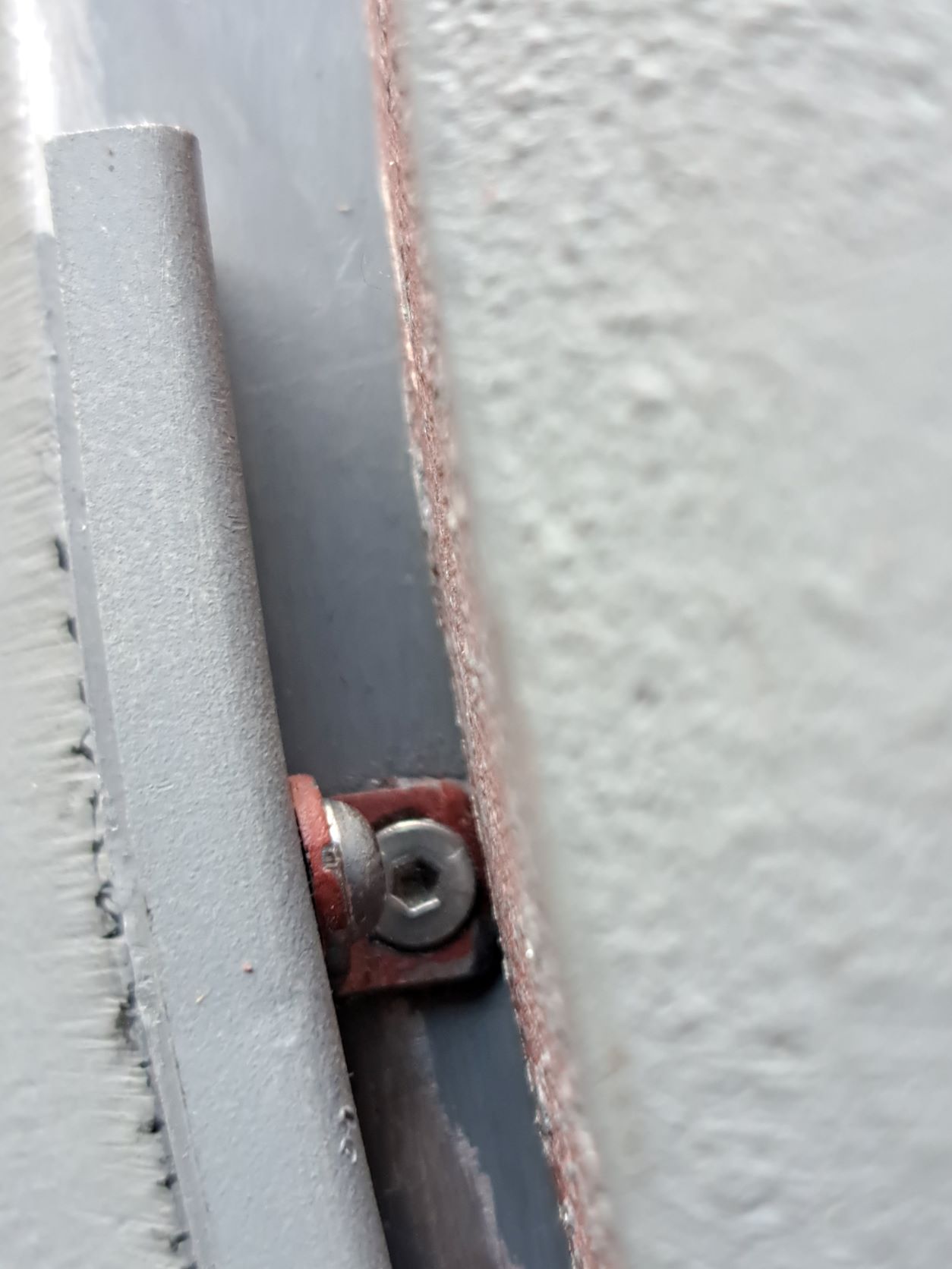

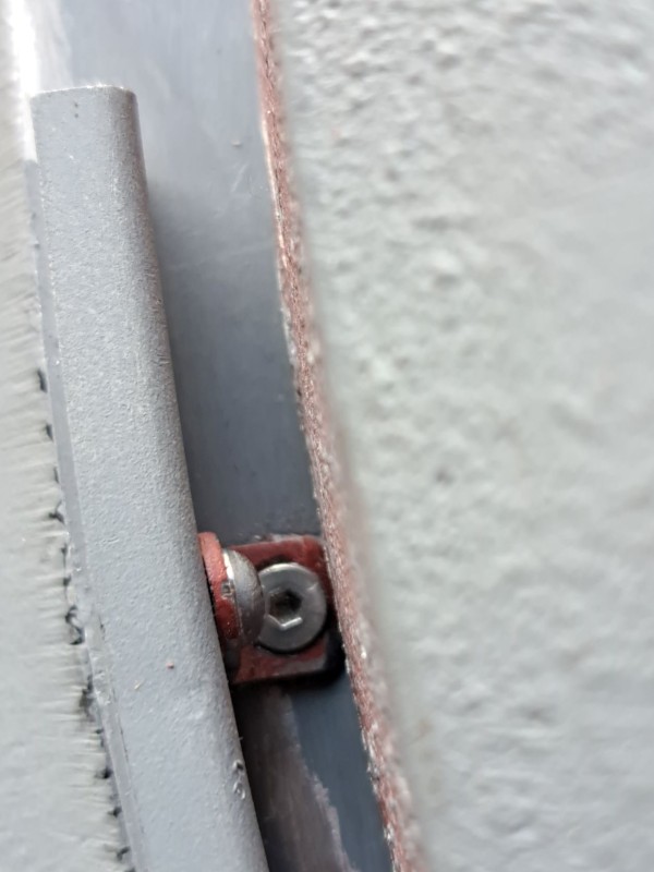

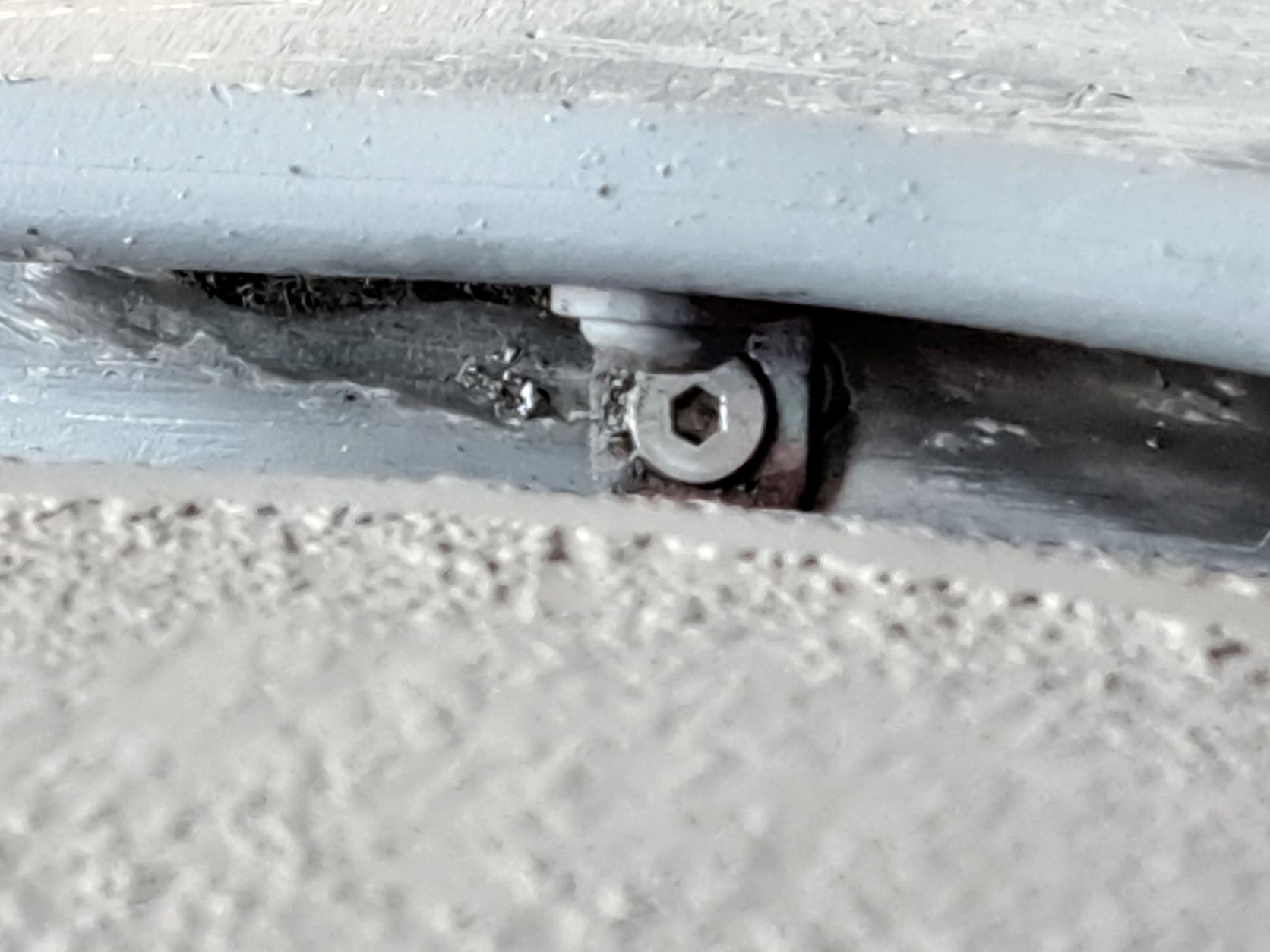

After last evenings post I had some concerns regarding the rotation of the turret and clearance of the wading rail fittings. I was right.
I am open to suggestions as to rectify this issue: the port side wading(photos) rail is in a good position but the st'bd rail needs to come inboard slightly.
Personally I like the rough cast surface of the turret and am a bit annoy it has been damaged, also chaps with Chieftains M3x8 & m3x 30 are a better bet to fix the rail retainers.
Have a good one
Charles
Have a good one
Charles
- Posts: 70
- Joined: Thu Feb 14, 2019 8:34 pm
- Location: Lyon, France
- Has liked: 61 times
- Been liked: 99 times
Re: Chieftain No. 34
Hello.
You can may be use some hexagon screw, and then file them to reduce height till no contact ?
or do the same on the area where button screw are rubbing the turret
Seems the contact is in a very specific area
Just be careful to leave enough of the head for you can still remove the screw later on if necessary
didier
didier

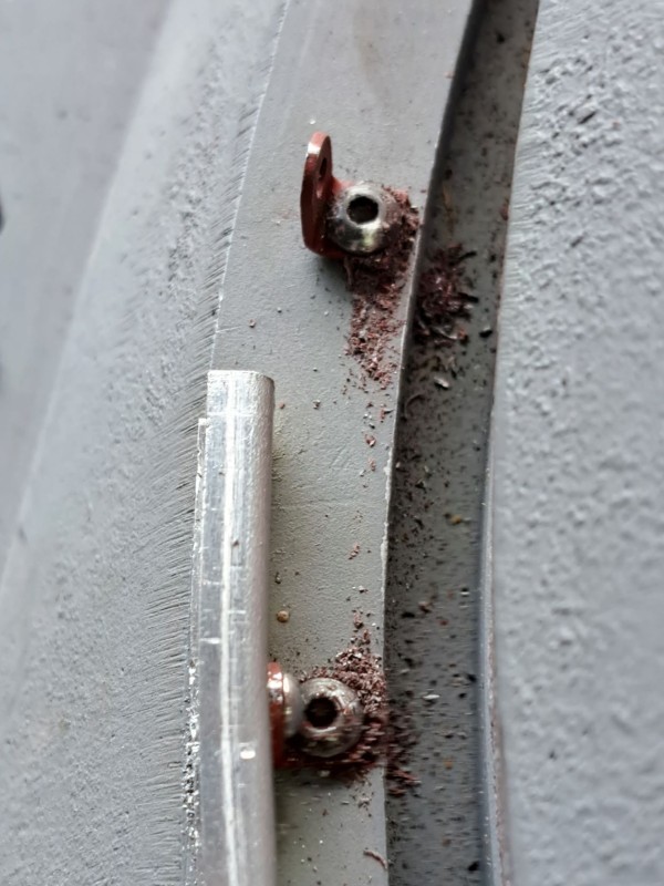

Some progress with the wading rail. I took Didier's idea on board, but instead of a hex bolt I was able to reduce the overall height of the bolt by using a csk. m2 screw.
I filled the existing holes with threaded rod and drilled new holes:-
Just the front bit to do now
Cheers all
Charles
PS What are folks thoughts on out of date super glue, i.e. locktite 480(10/22). Store in the fridge and garage, much the same, cold!!
